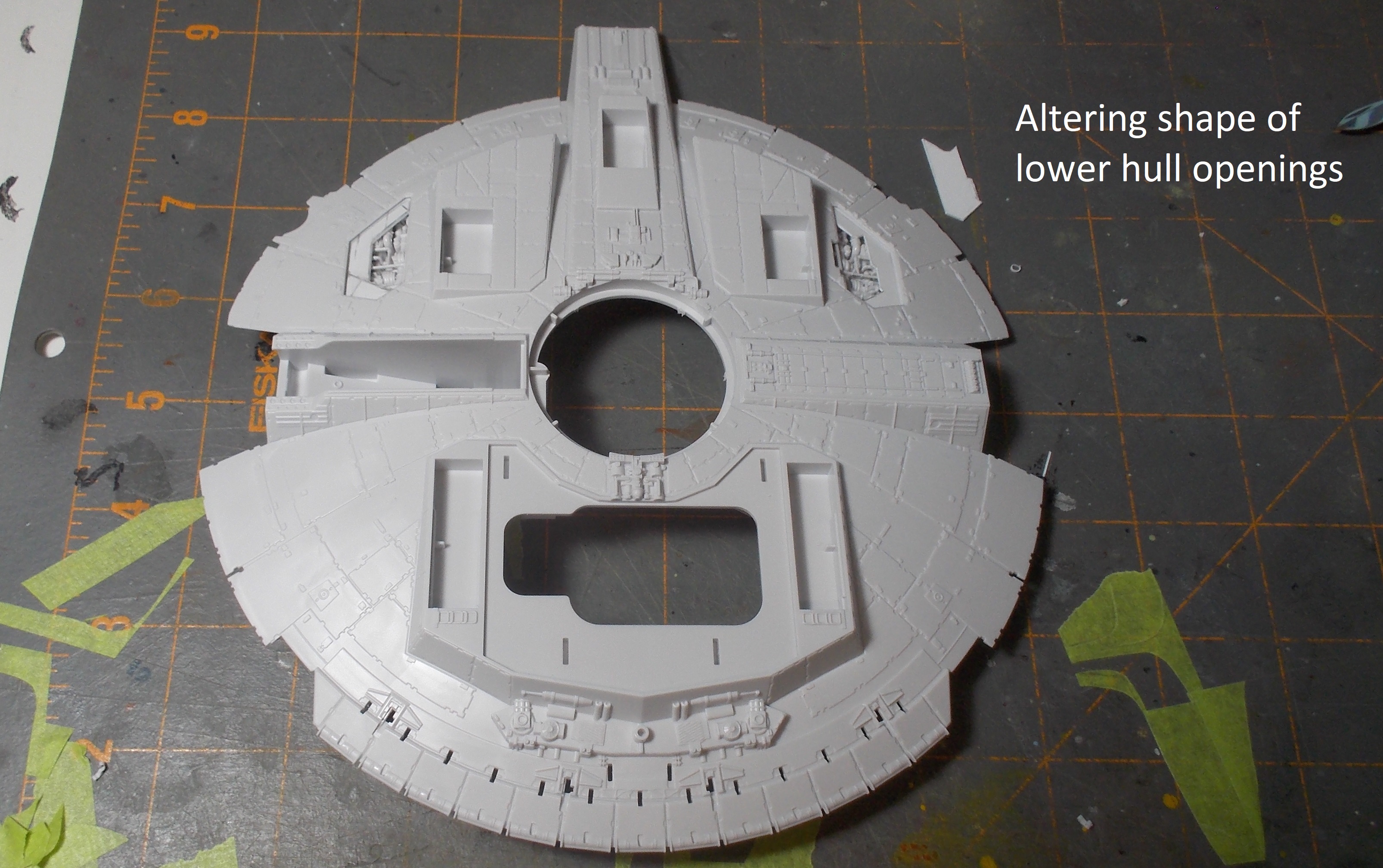

The 144 Bandai is a very nice kit, but it does have some accuracy issues, "from a certain point of view". It's based on the digital files that the ILM FX people create for the sequel trilogy. Though they ostensibly based their digital model on the 5' Falcon, they did take some shortcuts among other differences. I've not finished my kit, but I did mess around with some of the work. It's a side project that I do in bursts among my other works.
Some observations:
The panel lines on the underside are symmetrical about the long axis of the ship, which is not accurate.
The pits on the underside are also symmetrical and neither is accurate to the original 1977 prop nor the 5 landing gear modified version of the same model from 1980 onward.
The radar dish base is inaccurate.
The side panels, escape pods etc. also inaccurate.
The detail along the spine of the cockpit tube is coarse and way too tall.
All this said, it's a very nice kit. Bandai achieved their mission, but were working from inaccurate digital sources.

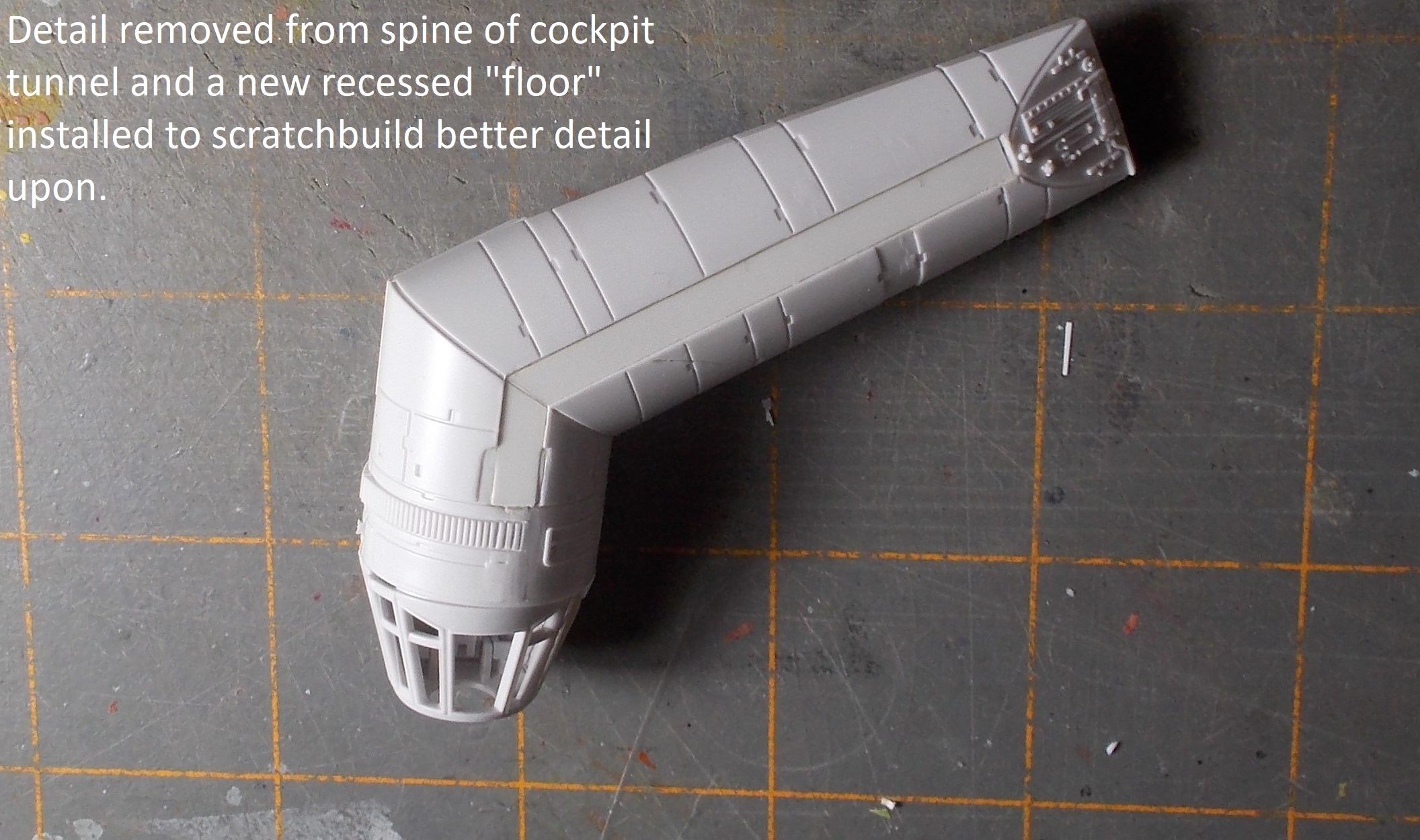

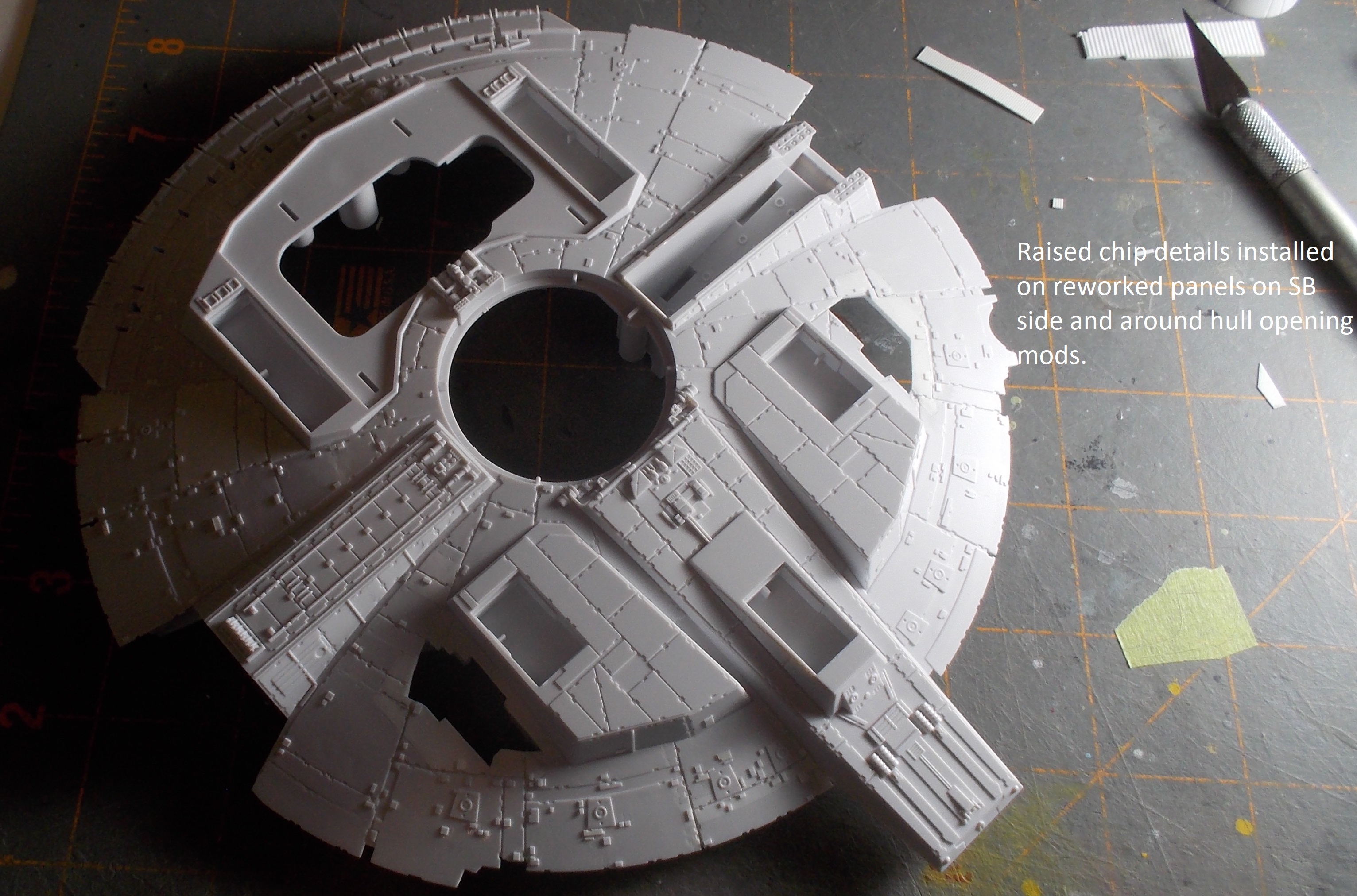

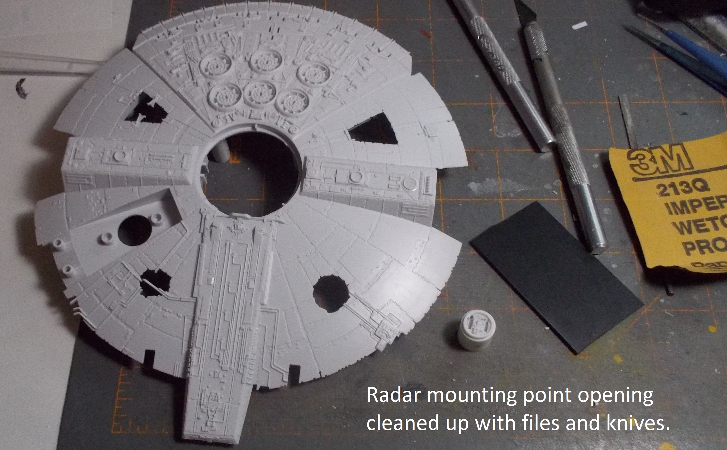

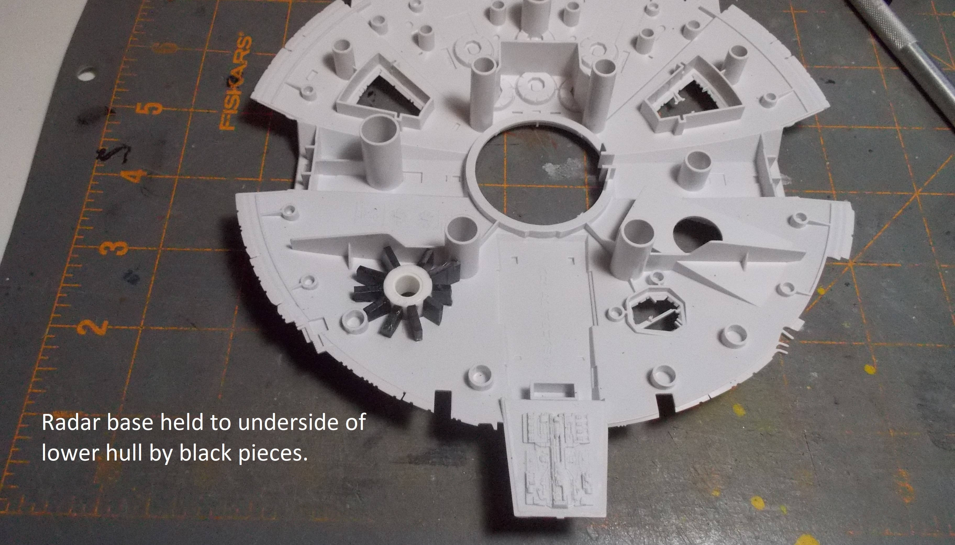

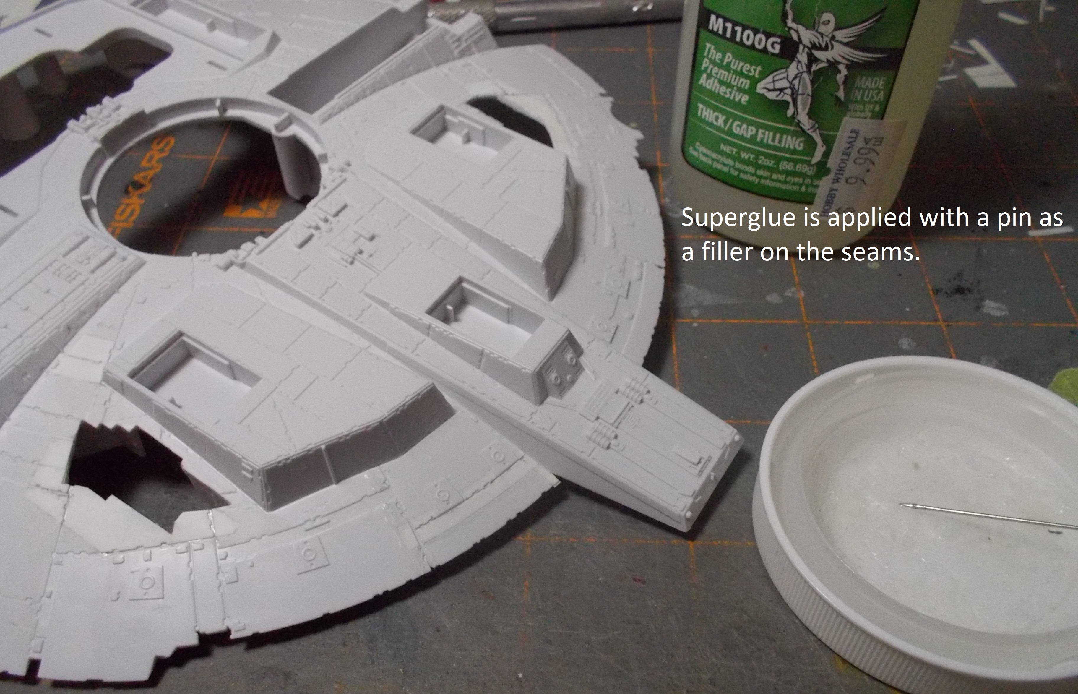

I've done a fair bit of work correcting some of these issues, I'll put some photos here. It DOES represent the landing lights, but not the red "don't bump your head" lights. Look closely and you'll see the white plastic of my modifications here. I didn't go for absolute perfection, but got it a lot closer to the 1980 onward appearance of the 5' model.

Keiko, exactly what I read in nkg/3Dsf's review, linked above. I have sheet styrene and photo reference, and am not afraid to grind off hull plating and redo it, in limited locations. I'm going to make those ventral maintenance pits asymmetrical to match the filming model, and am enquiring after 50% scaled versions of the 1:72 ones. I'm going with aftermarket upgrades from nkg, 308bits/Tony, Green Strawberry, and Paragrafix, plus continuing to search farther afield for ROTJ crew figures and photoetch replacement Koolshade. Tony has the don't-hit-your-head lights as upgrade parts for the 1:72 Falcon, and I'm seeing if I can get those done at half-size also. Between all of those sources, most of the problems will be addressed, and I have the elbow-grease and patience for the rest. Thanks for the evaluation and insight. :)

Oops wait - the 144 Bandai has the plates that were added to the underside of the 5 foot Falcon model where the brass tubes for lighting went. So you can easily drill those out and add fibre optics.
The red safety lights are so small that a simple red-coloured fibre protruding is adequate. They'd be too small to 3D print properly.
