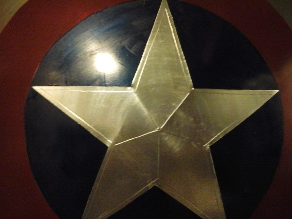

Looch
I built the sled version as well. The star was cut out of a sheet of tin from Home Depot, with a pair of metal snips, then the edges were ground down with the Dremel sanding wheel. 10352342_10153338578155616_584929969004842059_n.jpg
