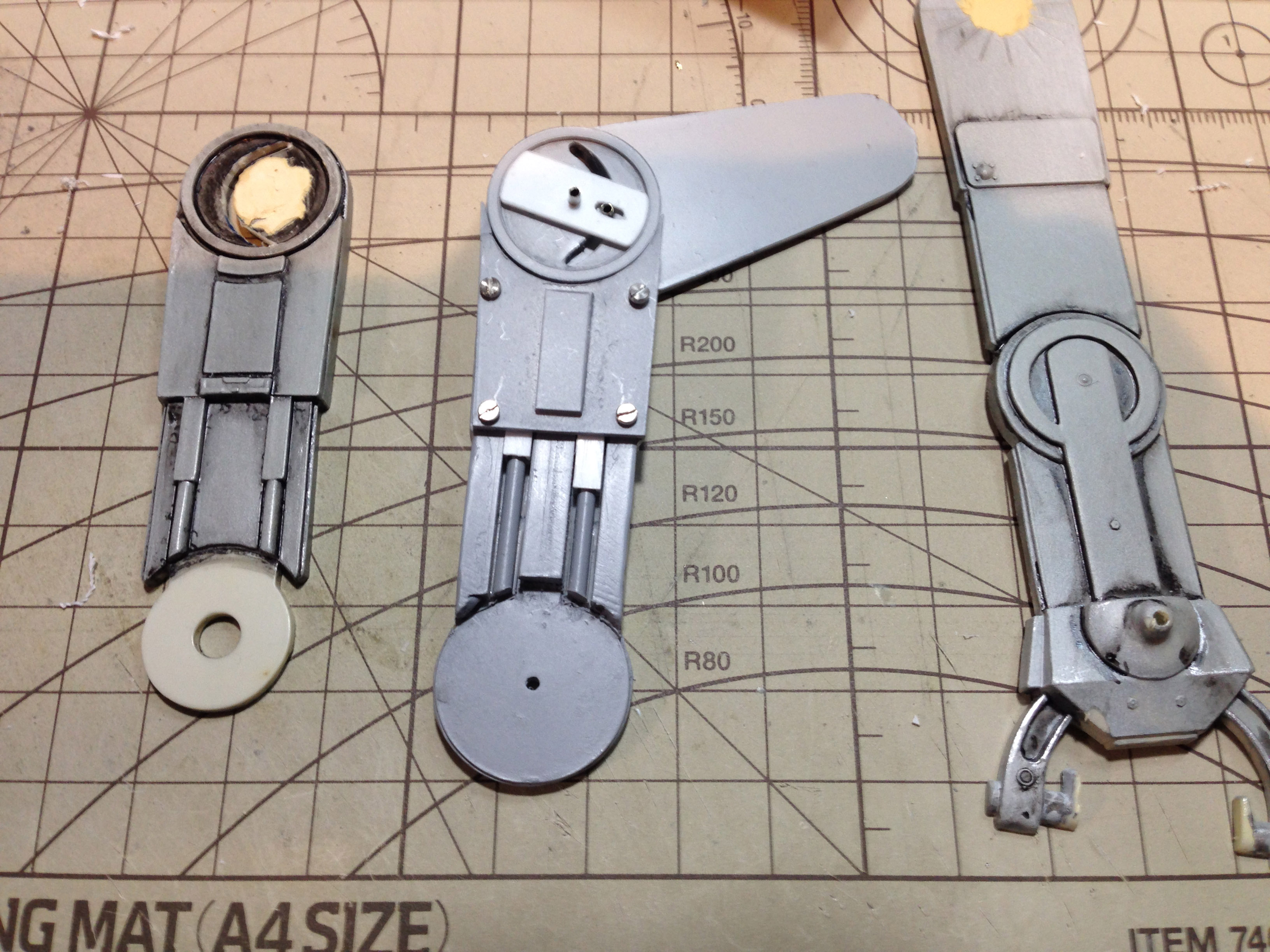

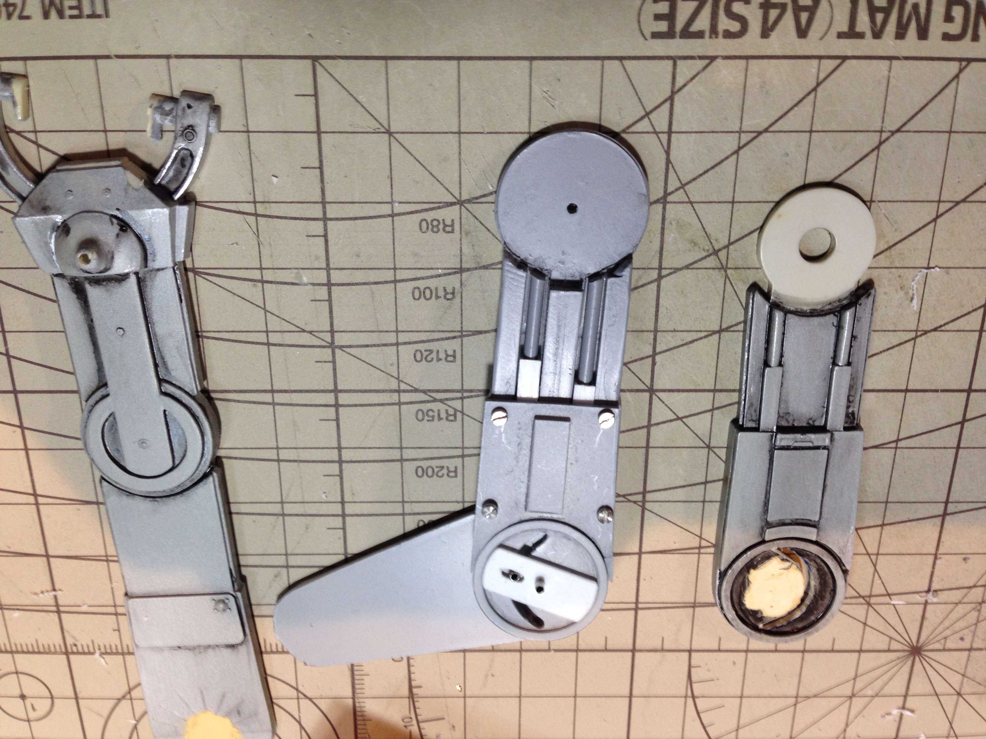

Happy New Year, anamorphicWayne. Your excellent work became my reference to follow, and gave me re-start modifying my MPC AT-AT that was staying in the box more than 20 years after broken down. I have limited environment about metal milling as our country's house situation. I have started leg and piston mechanism by styrene sheet as conceptual work first. Really enjoying to read your thread as well as this site.

Thank you very much for your comments, anamorphicWayne.
I fully agree with you and thank you very much for allowing to show my prototype here.
Let me explain little bit.

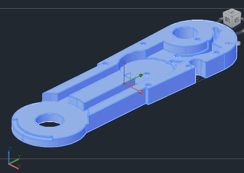

I have traced your uploaded photos at first by using Photoshop and other CAD software. Then scaled them down to fit MPC AT-AT size.
It was made with layered styrene sheets with brass rods and pipe.
As you have pointed out, screw is headache to fit scale. You might feel even above screws are over-scaled. Especially blade head is difficult to get recently in such small size.
With MPC AT-AT, I won't make metal legs but styrene sheets as not making workable stop-mo model. It is just self satisfaction as hobby. However I'd love to have metal legs for my Revell AT-AT in the future, and dreaming, may be after retirement. :D

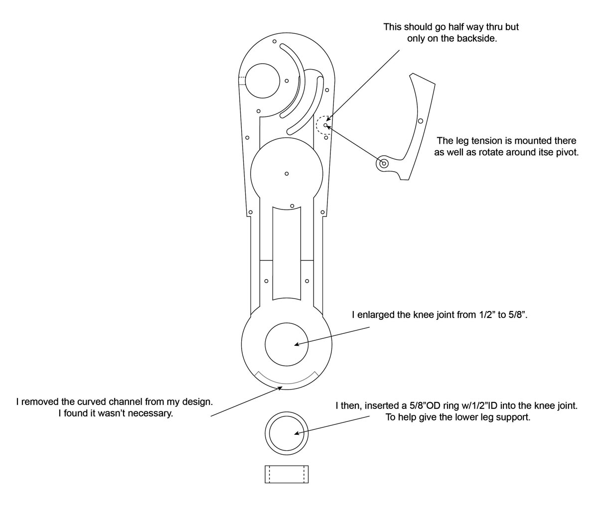

Nicely Done swmodelfan1977. At least you got to the point of a 'working piston', I have no clue how I'm going to pull that off. :confused
However, if I may offer a few suggestions. Basically, the round indent (on the right side/near the top) of the Upper Leg only goes thru half way and only on the back side. The Leg Tension is mounted within the indent and pivots around its screw. The Leg Tension is then connected to the Hip Plate thru its slanted slot. I've also enlarged the Knee Joint hole and added a ring to help support the Lower Leg. I felt the axle wasn't going to be enough. I've also removed the curved channel at the bottom of the Knee Joint. I thought it was on the original model, but have re-evaluate since then.
Your work is coming along. Keep it up, I'm looking forward to seeing more.
anamorphicWayne :D

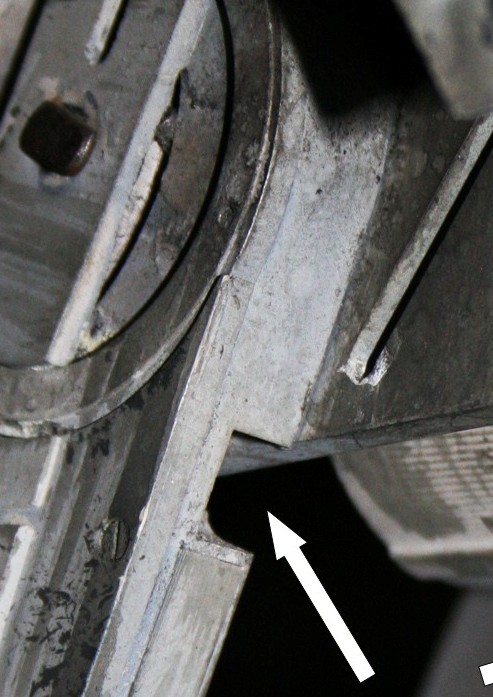

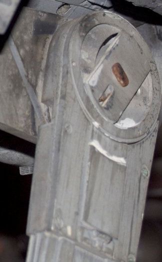

This is amazing to see these metal legs taking shape. It's unbelievable.
I do agree with anamorphic Wayne with regards to the slot for the leg tension though. Here are some images that may help.
Hi anamorphicWayne, Hi Junk Pilot,
Thanks for notice about the leg tension. Yes, I do agree too.:D My 3D CAD model was made by giving thickness after selection of area and purpose to study how should I build layered styrene sheets. Anyway, pics Junk Pilot posted helped how much deep slot should be. :thumbsup Will take all suggestions from you guys and modify my drawing.
Cheers, ta!

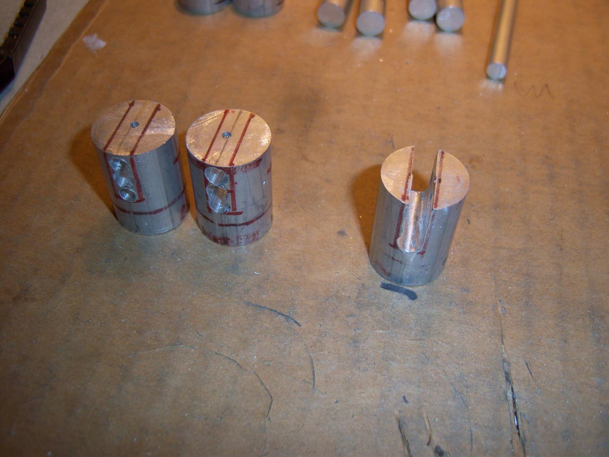

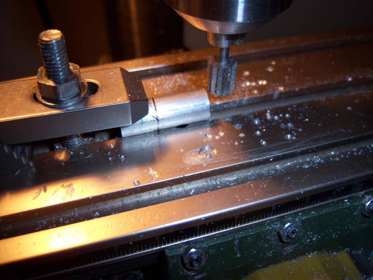

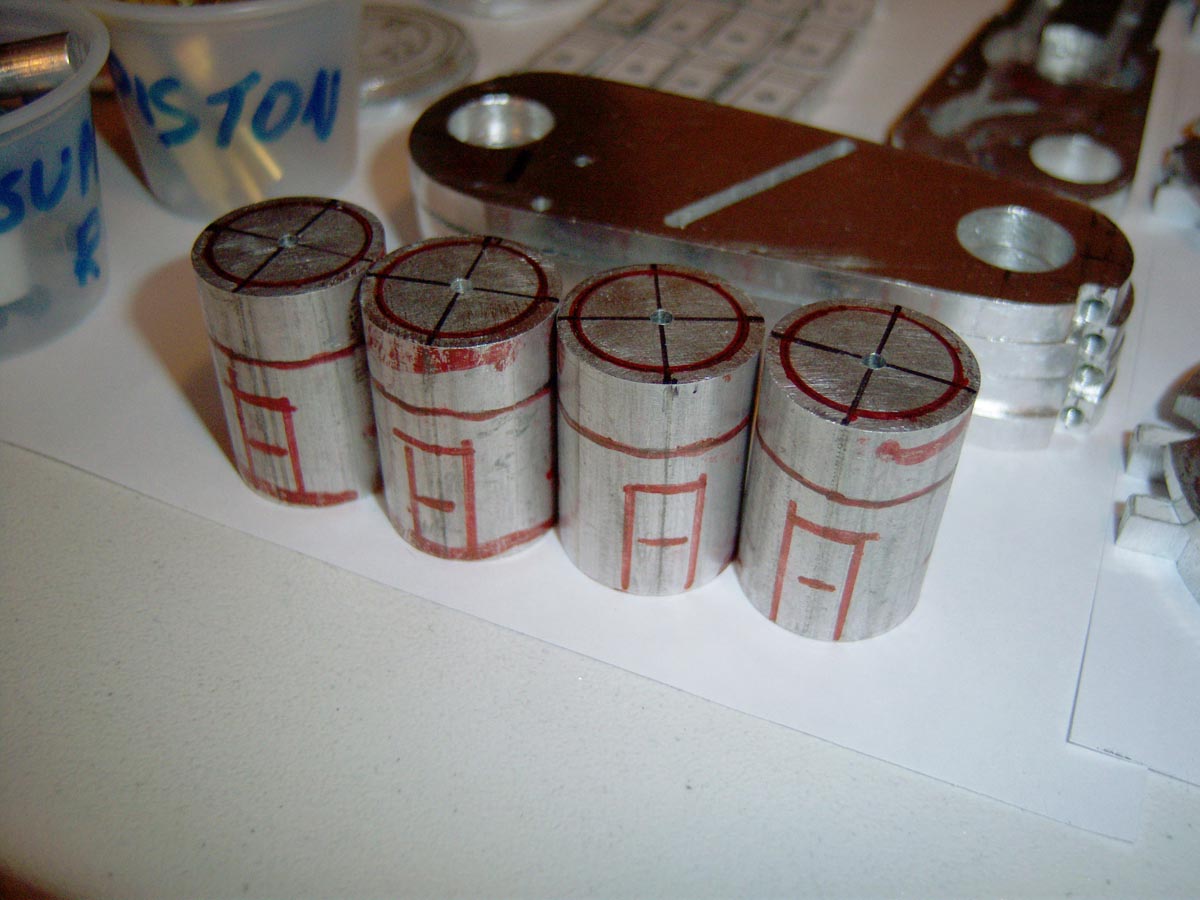

For the Body_Hip Joints, I used four 3/4 rods about 1-1/8 in length.

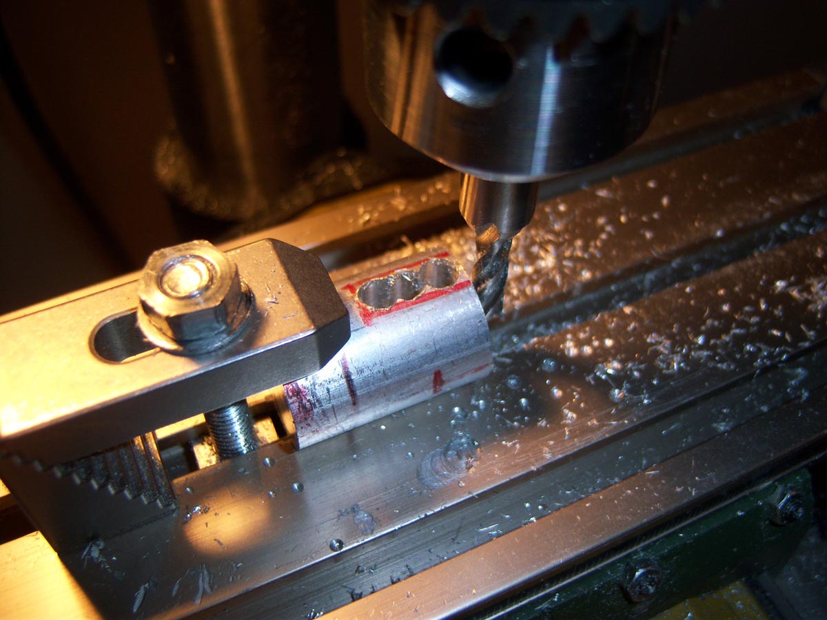

Like the Lower Foot Chambers, I per-drilled holes to help in milling out the channels. These1/4 channels will be connected to Joint Pins which are bolted to the Leg Base Block.

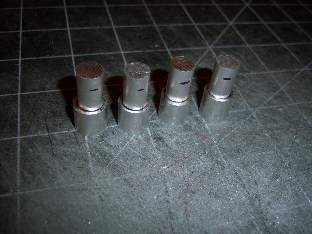

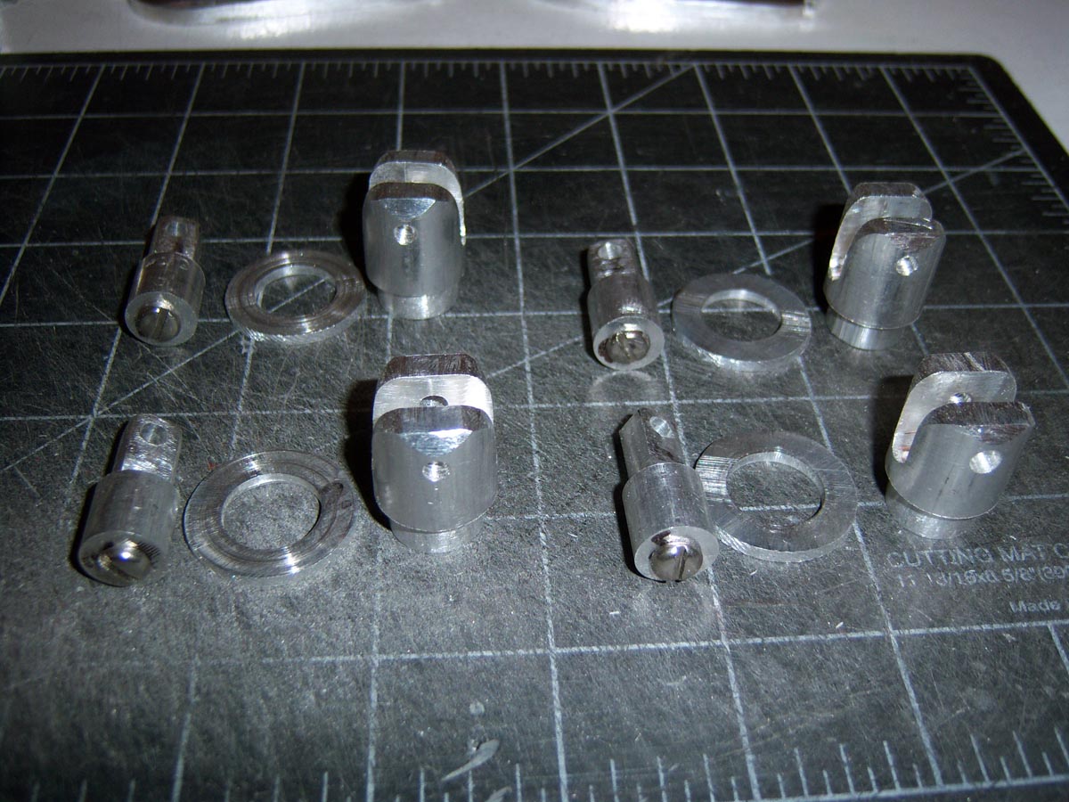

Next is to make the Joint Pins. For these I used 3/8 rods at 1 length and with 1/2 bases.
I shaved off 1/16 on both sides, making 1/4 square posts.

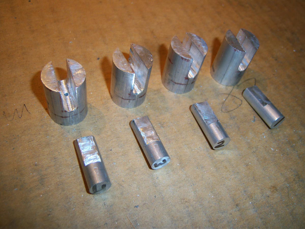

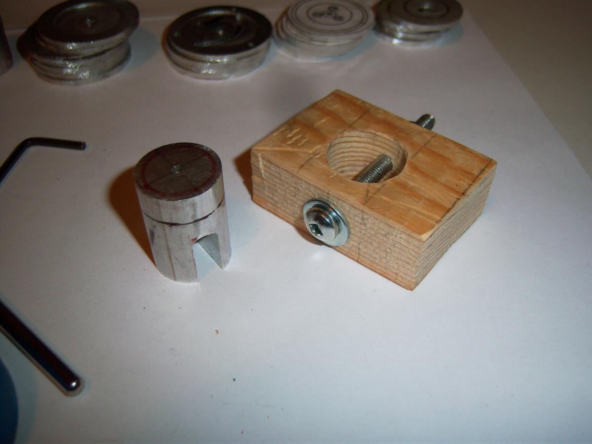

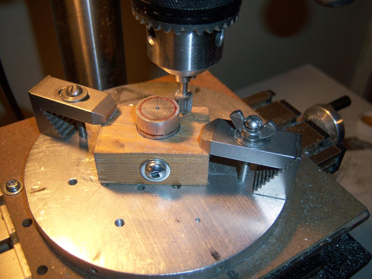

The next step is to mill the other end down from 3/4 to 5/8. To ensure no slippage, I took a block of wood, drilled a 3/4 hole and added a bolt thru the center. The bolt lines up with the channel.
Then it was a matter of milling down to about 1/4, the thickness of the Hip Plate and Joint Cap.
I then had to drill/tap all the mounting holes as well as assemble the Joint Caps. Unfortunately while tapping one of the holes, I broke a 4-40 tap on the last Joint. Opps. I'll have to deal with that later on.
