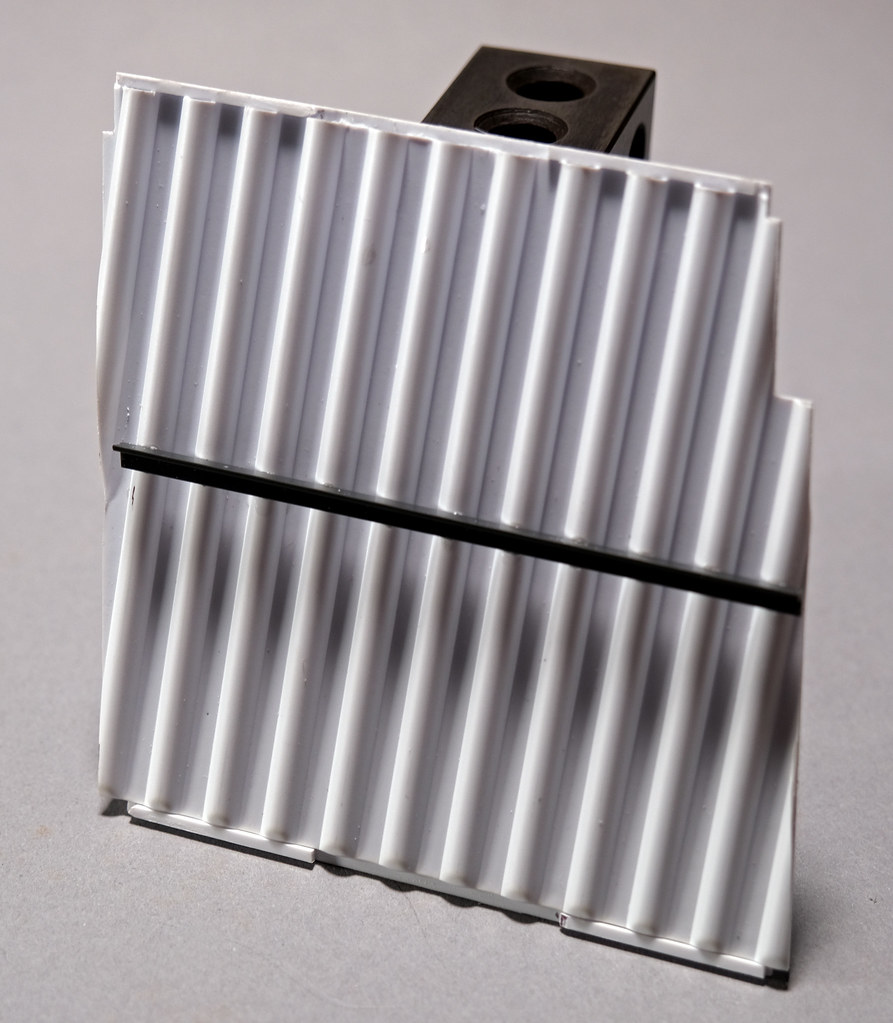

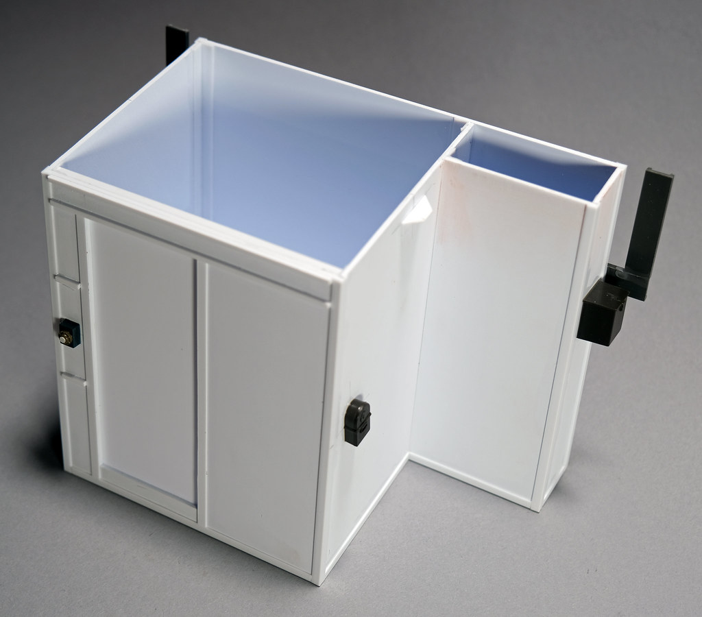

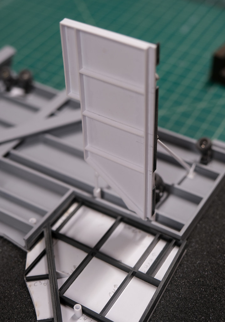

Built a counterweight for the elevator today--
Today I--
  • Cleaned up the counterweight and added final details.
  • Did a quick pass with file and sandpaper over the elevator vestibules.
  • Brushed Mr. Surfacer over the hairline seams in the ducts.
  • Added forty rivets to the stairwell.

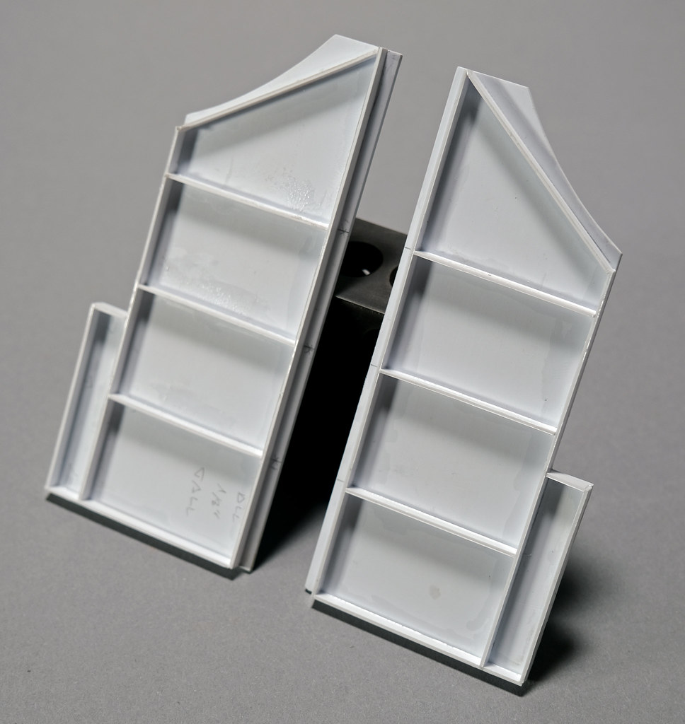

  • Added hinged flaps to station 91.
  • And cut the styrene for the station 99 sidewalls.

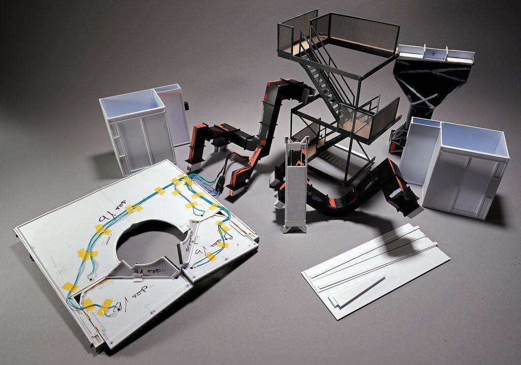

Today was like yesterday: a lot of little things. The service structure build is starting to wind down and pretty soon it'll be at the primer stage.

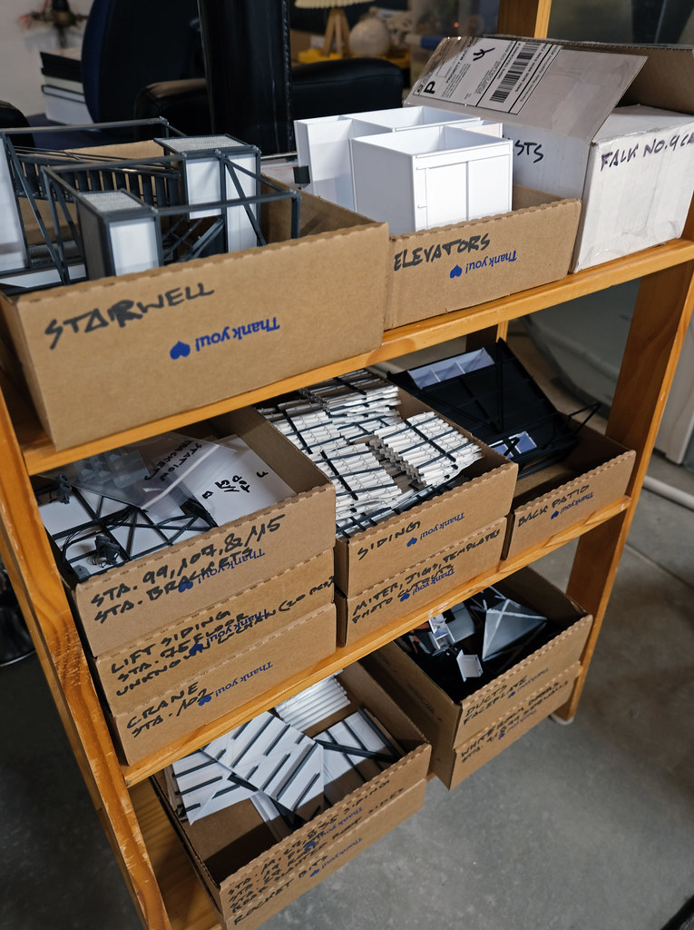

First I organized and labelled all subassemblies.
Then I trimmed 1/8" of L-channel off eight sections of lift siding as it wouldn't quite fit.

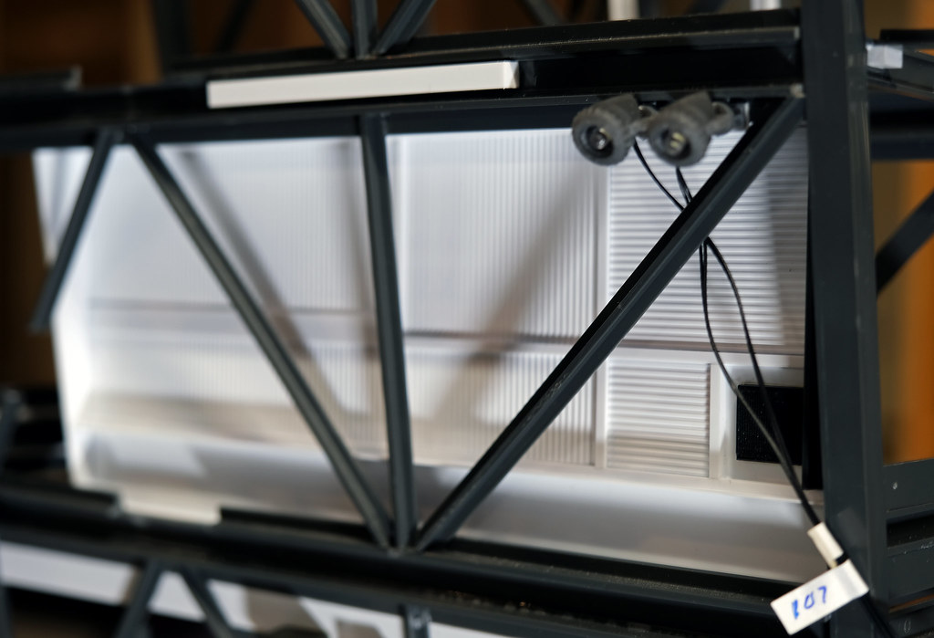

And lastly I added the four remaining hinges to station 107.

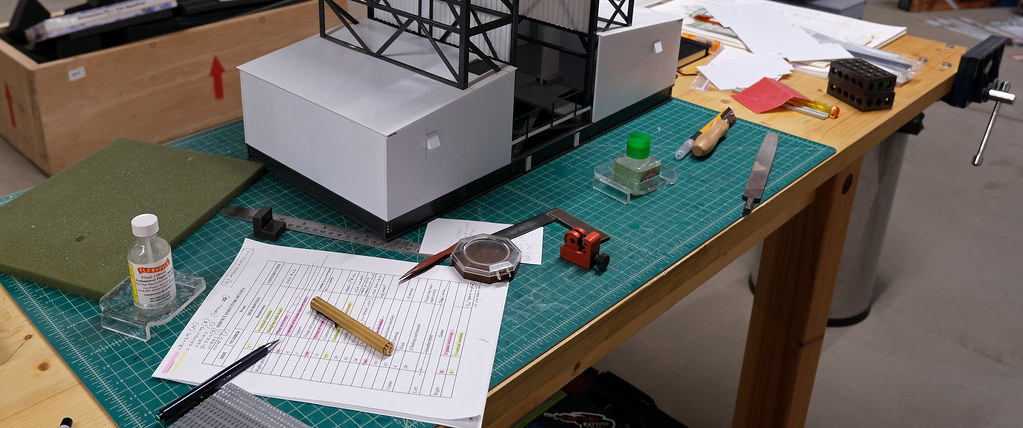

I've now moved on to the detail portion of the build. First I pored over all the hi-res shots of the service structure and compiled the details it will be necessary to add. At last count, there are seventy-three unique details, half of them nuts, bolts, pipes, conduits, and wires (and thus relatively easy to do). I then bought all the **** I'd need (including about a nautical mile of brass tubing) and got down to it.
Here's my bench at day's end. I'm starting with the "bunkhouse" and working my way down. Seven details in the bag already.

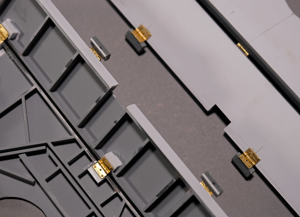

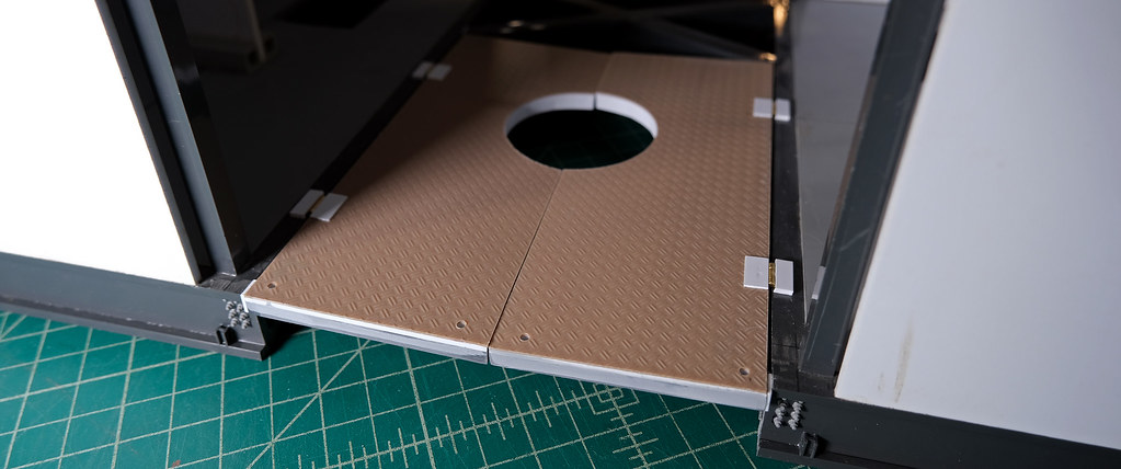

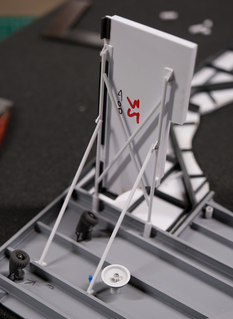

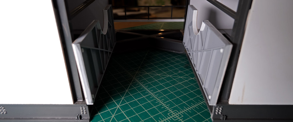

Not shown here, but today I began by tweaking the fit on stations 67 to 91 (a matter of shimming here and there).
Then I added postholes, hinges, and check plating to station 115. Seen here down ...
... and here up.
