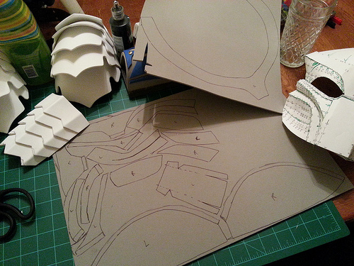

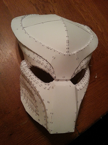

Starting with the Spartan857 pep, I scaled and constructed a pepakura model of the Bio helmet.
From this I marked the paper pep, cut it and used those pieces as templates for an EVA foam build (4mm).

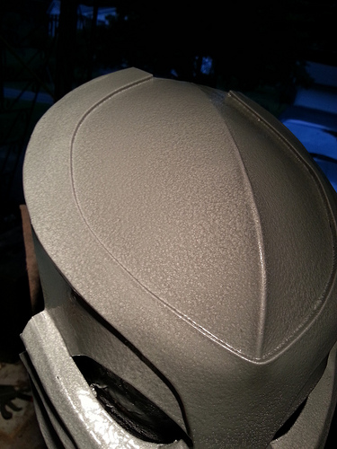

Then I hit the foam helmet with a couple coats of plasti-dip...
Then some Adhesive Promoter (found at most auto-part stores) and then 'hammered steel - metallic paint' that I got at Wal-mart.
Here's a close-up of the paint effect...
After that dried, I 'weathered' the helmet with some black and brown latex paint I had laying around.
Next, I hit the helmet with a couple coats of clear coat (for Plastics).

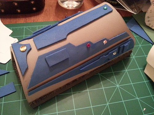

Setting that aside for a bit, let me go over the Gauntlets...
I started with a section of floor matte foam for the top of the gauntlets and a section of 5mm EVA foam for the rest of the wrist unit.
I took some 2mm (maybe thinner) craft foam from Wal-mart and cut out the general shapes of the template just to add texture and details.

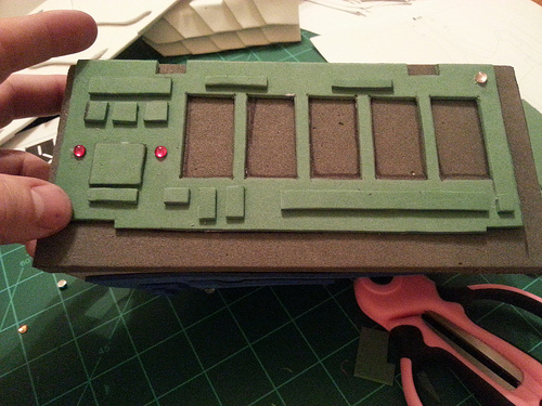

I then created a cover plate for the 'self-destruct' panel gauntlet.
After marketing out the spaces, I then carefully cut out five spaces and installed a battery pack and string of LED's from a set of x-mas lights (a favorite element of mine to use).
I added some ribbed piping and then hit it with a couple of coats of Plasti-Dip.
I followed that with the Adhesive Promoter and hammered steel spray paint.

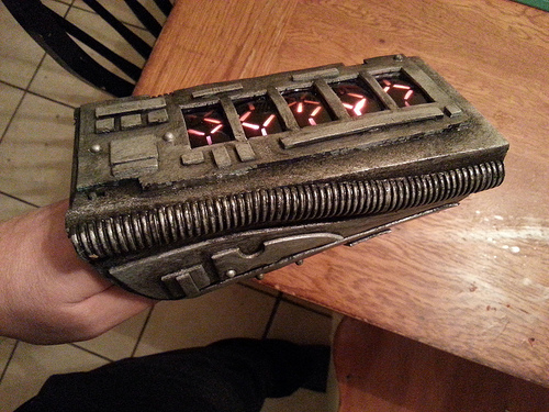

Then I started to work on the five read-out windows. To get the effect I wanted, I ended up using a $1 red plastic folder, some black electrical tape (to black out everything but the xeno-letters and finally some black sunglass lenses (also from the $1 store).
Here are the glasses...
One lens, which I've cut down to size with the red plastic folder piece and black electrical tape...
Here's the flip side...
And this is what it looks like in place...
Finally... here's what it looks like lit.
Finished 'self-destruct' gauntlet...

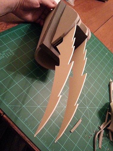

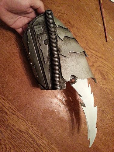

Starting with the same base, I cut the claws out for the 'blades' gauntlet out of stiff plastic and then constructed a simple mounting from foam (no... they don't extend).
And here is what it looks like after plasti-dip and hammered steel paint job.
Finally, here's the weathered final piece...

Unfortunately, I had to abandon Vin's templates for this one and do this with custom poster-board templates I made to fit my daughter. :rolleyes
I built it in two halves (left and right). They are constructed of three layers of craft foam (2mm and 3mm).
