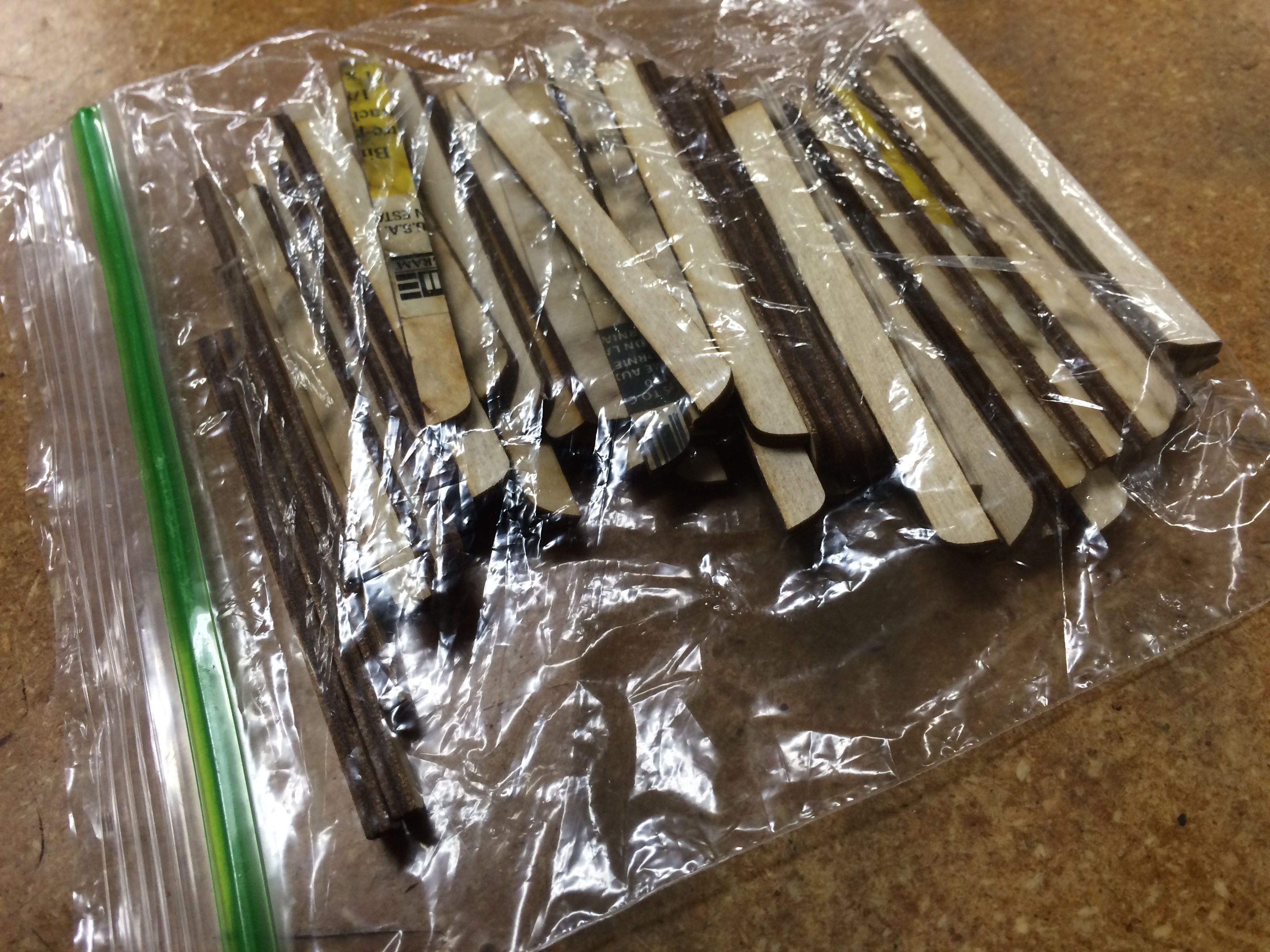

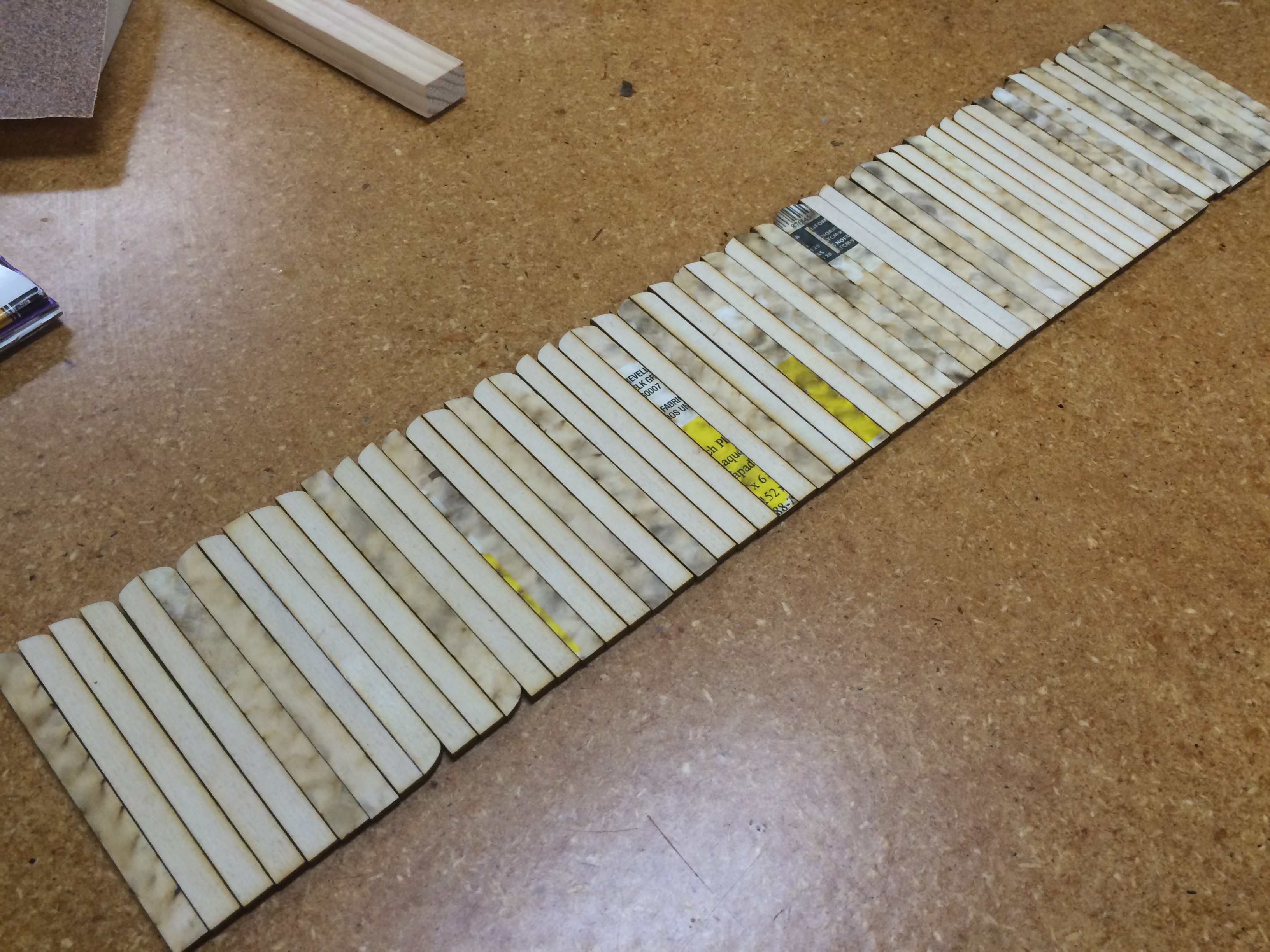

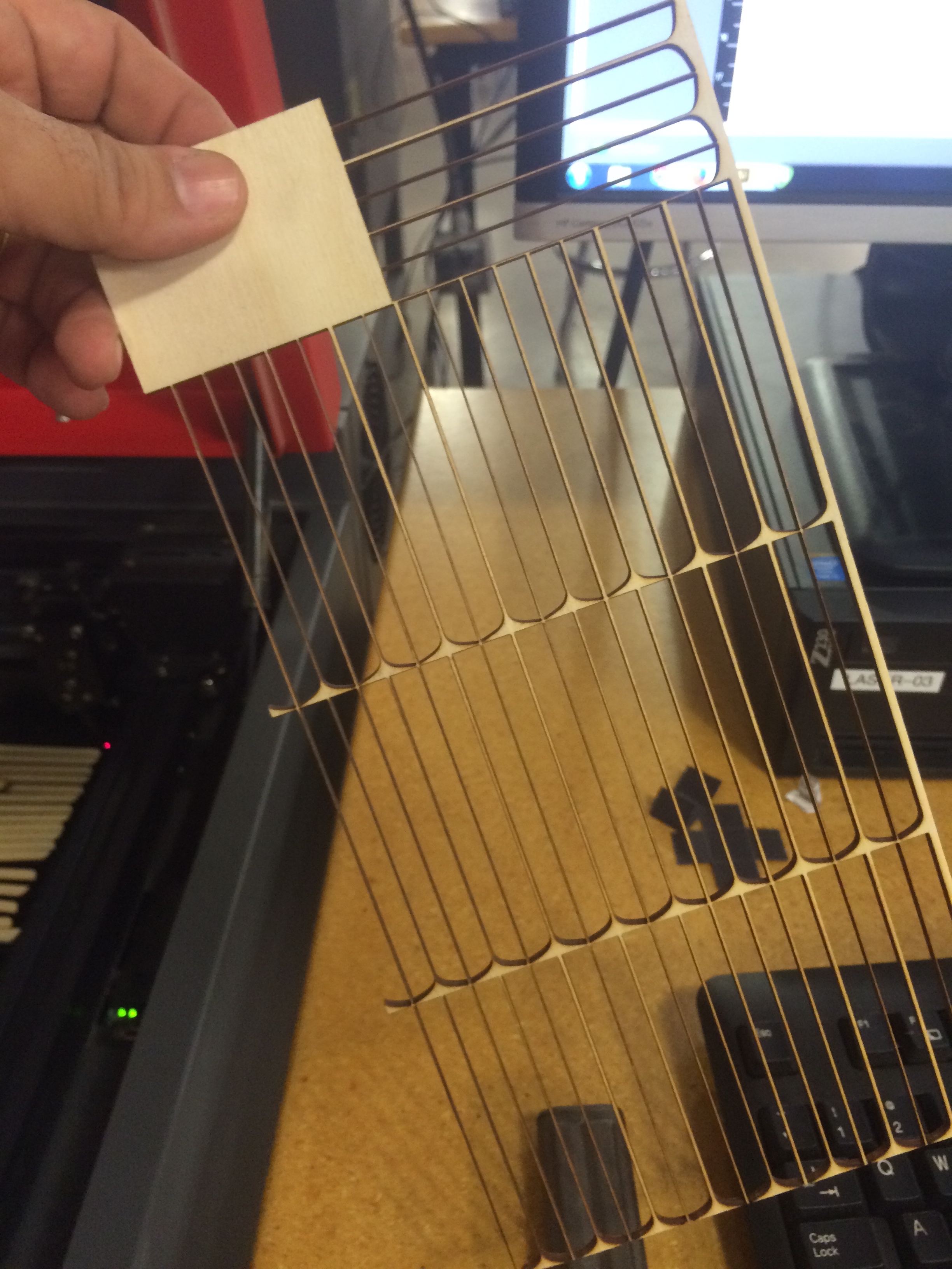

I started with one last trip to the laser cutter (well, last for the time being). I've always wanted a bag full of popsicle sticks, my birthday's coming up, and I was gonna get one. Cutting to the chase:
I'M RICH, MA!!!!
That's 60 sticks, theoretically enough for 15 handles. But if the way I went through brass last night is any clue, I'll be lucky to get three. :p
And I've got the artwork nearly perfect, though the cutouts need a little nudging here and there, and at least there wasn't any wasted wood. So when I run low on sticks one far-off day (or this Saturday), I can just pop out 60 more. Long time and lots of work to get here, but from now on at least making the wood parts of the handle will be very simple, quick, and rare. One step closer to a house full of phasers!

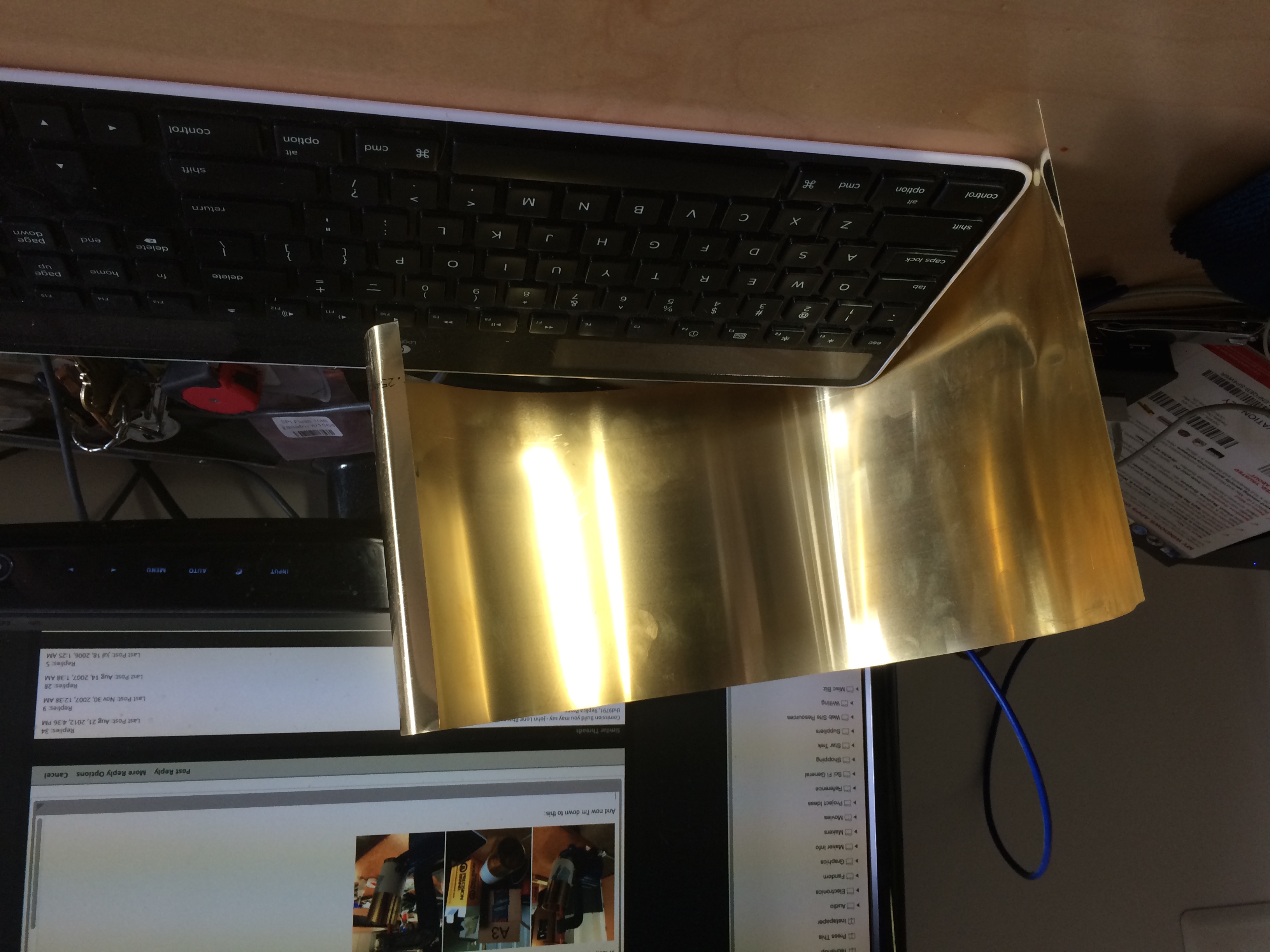

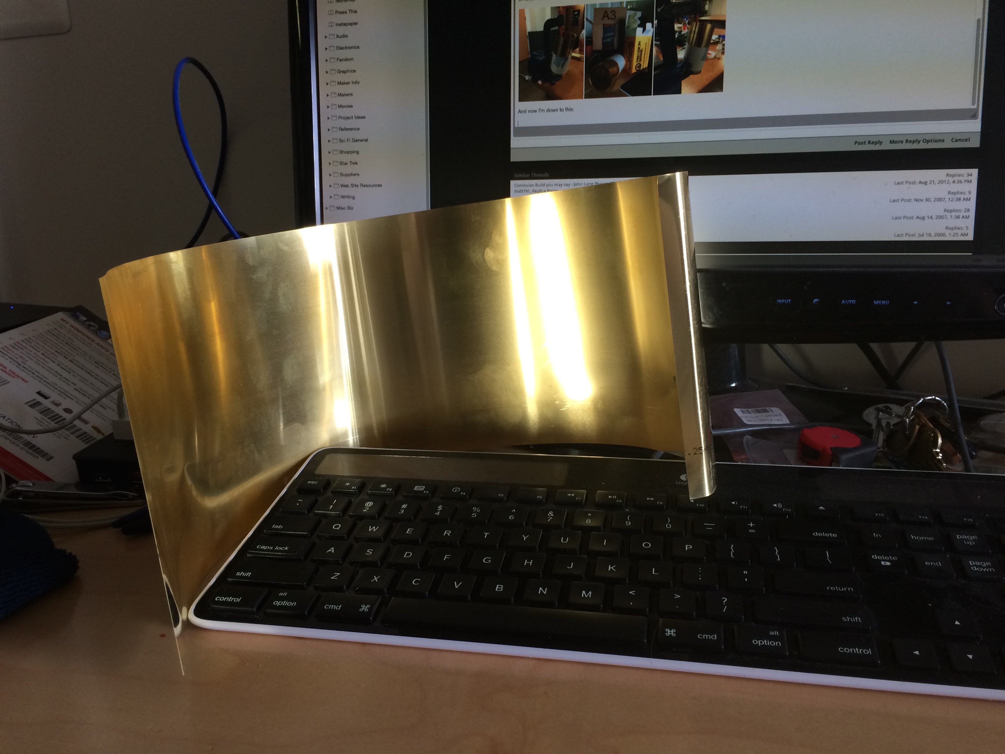

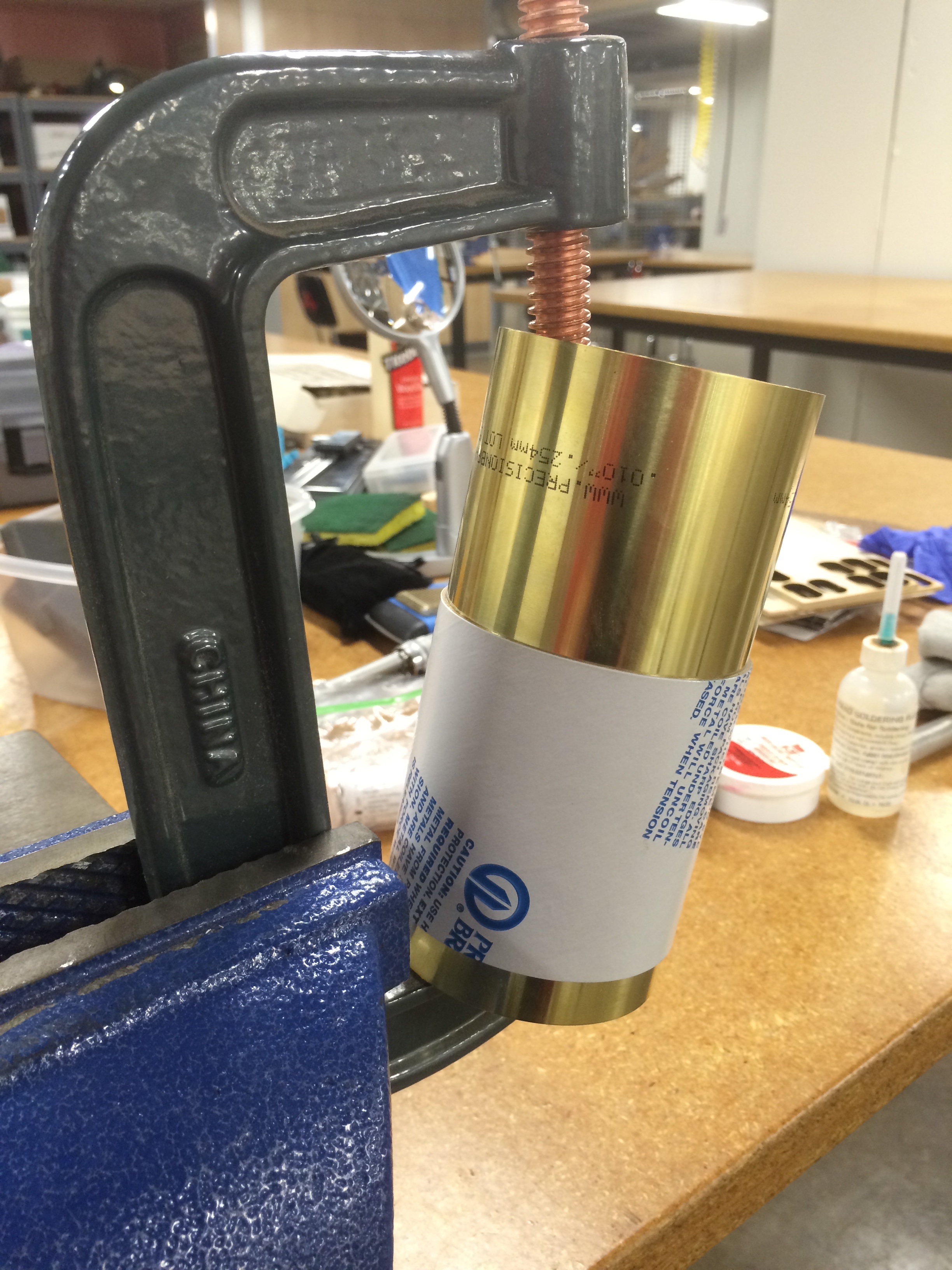

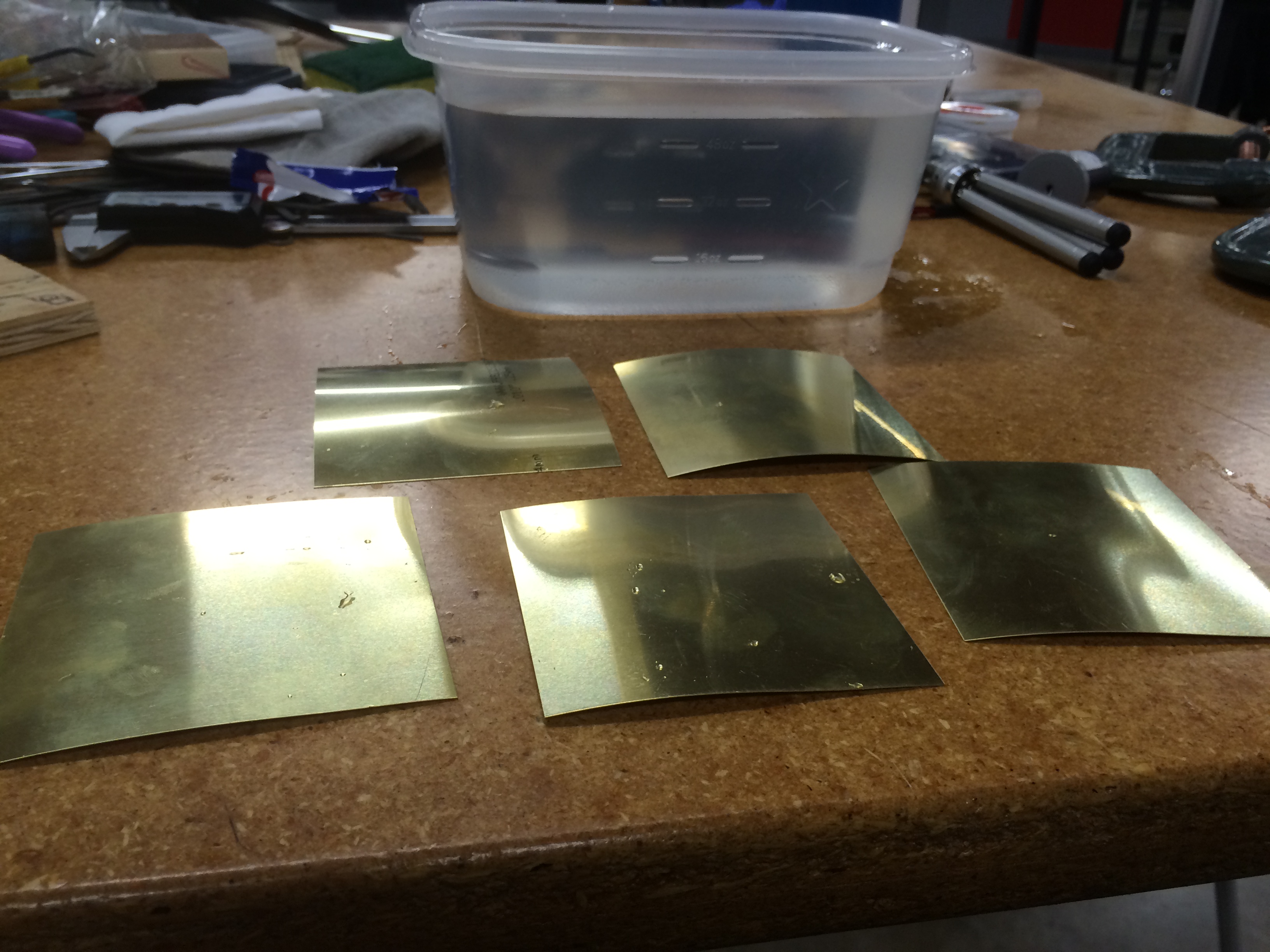

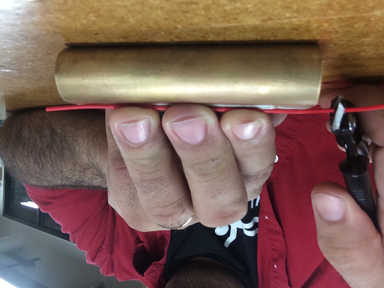

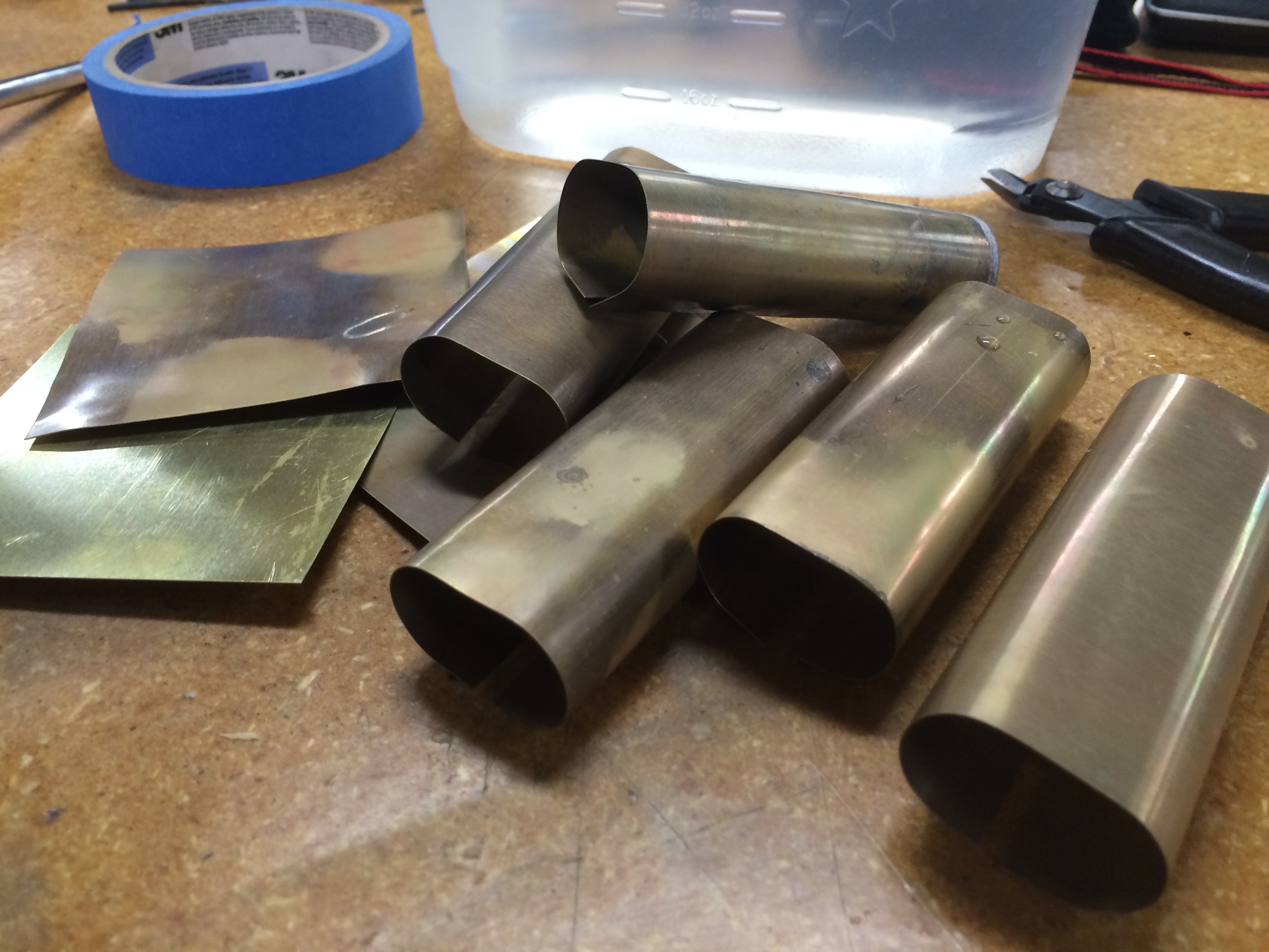

For the record, after much trial and error and much scrapping of brass, the size I came up with is 3 5/16" H X 3 3/8" W. The longer side is the one that wraps around. This got me perfectly butting edges on my form, and a handle that matches the MM one as perfectly as I care to get. Of course, these are ad-hoc numbers and not from measurements of the original. You've seen the process, so I needn't tell you that YMMV. ;)
Most of the waste I generated was from getting the width of the brass sheets exactly right, so they'd butt up perfectly together instead of overlapping, like this:
The brass relaxed a bit in the second photo by a trivial amount because I wasn't holding it closed, but this one was actually perfectly cut. These, on the other hand, were wrong:
So were these:

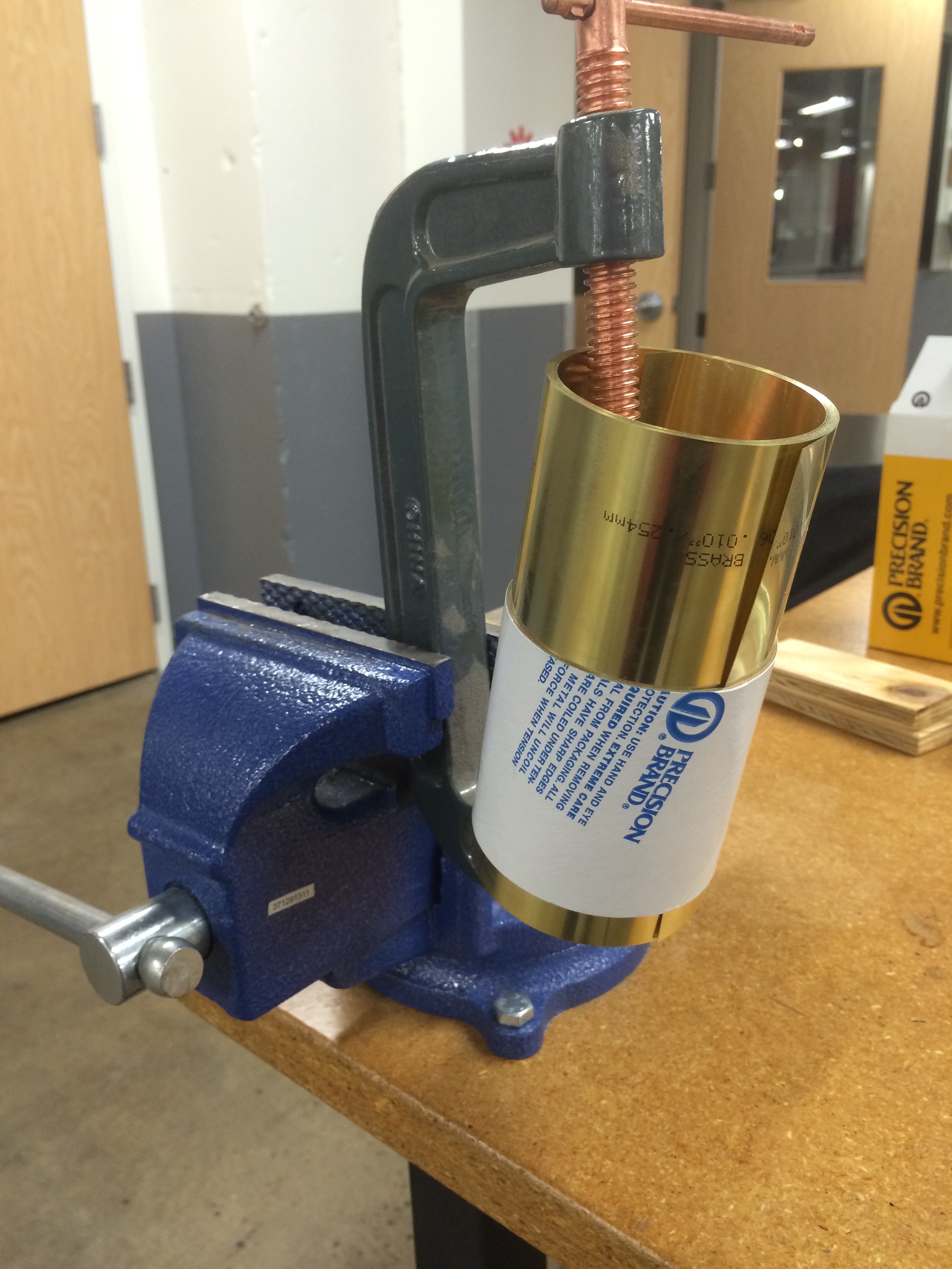

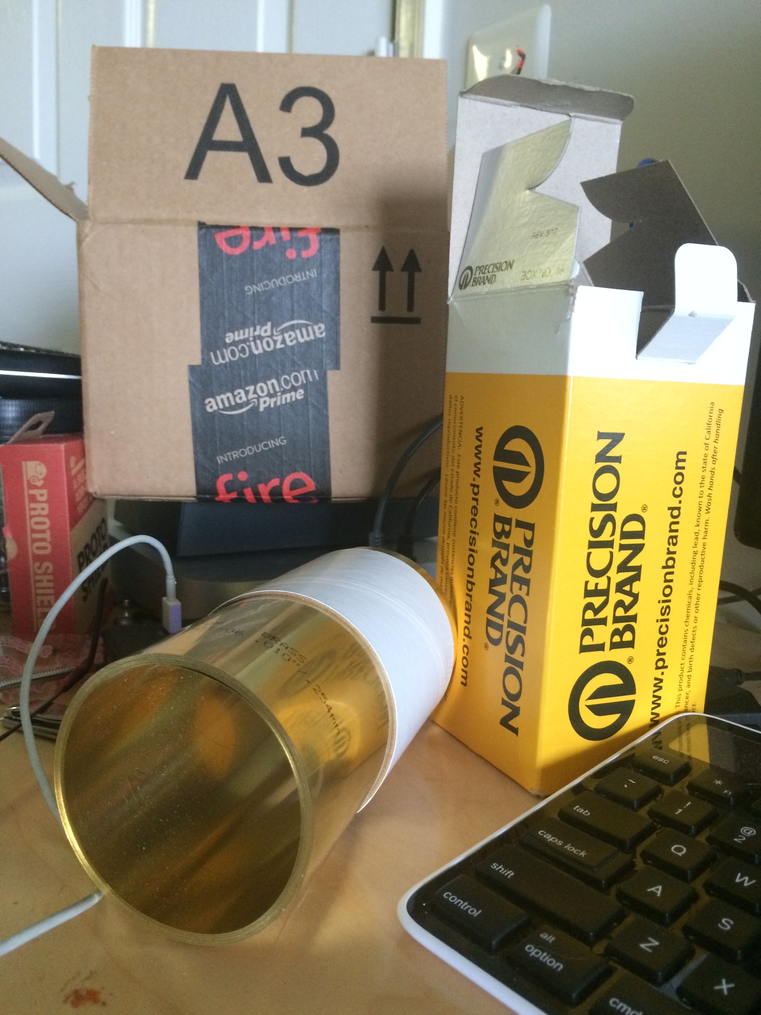

In fact, I started the evening with a roll of brass 6" X 100"...
And now I'm down to this:

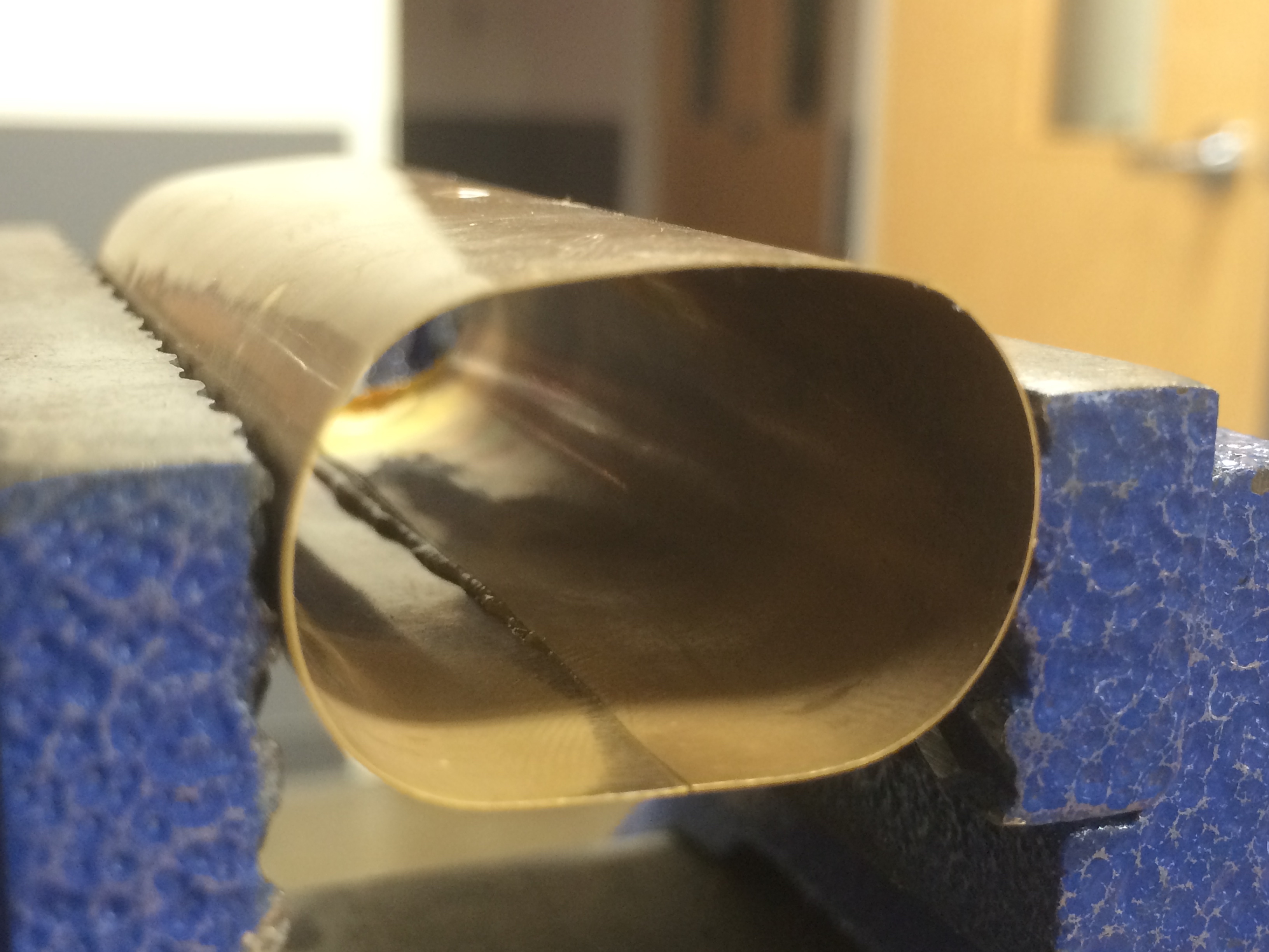

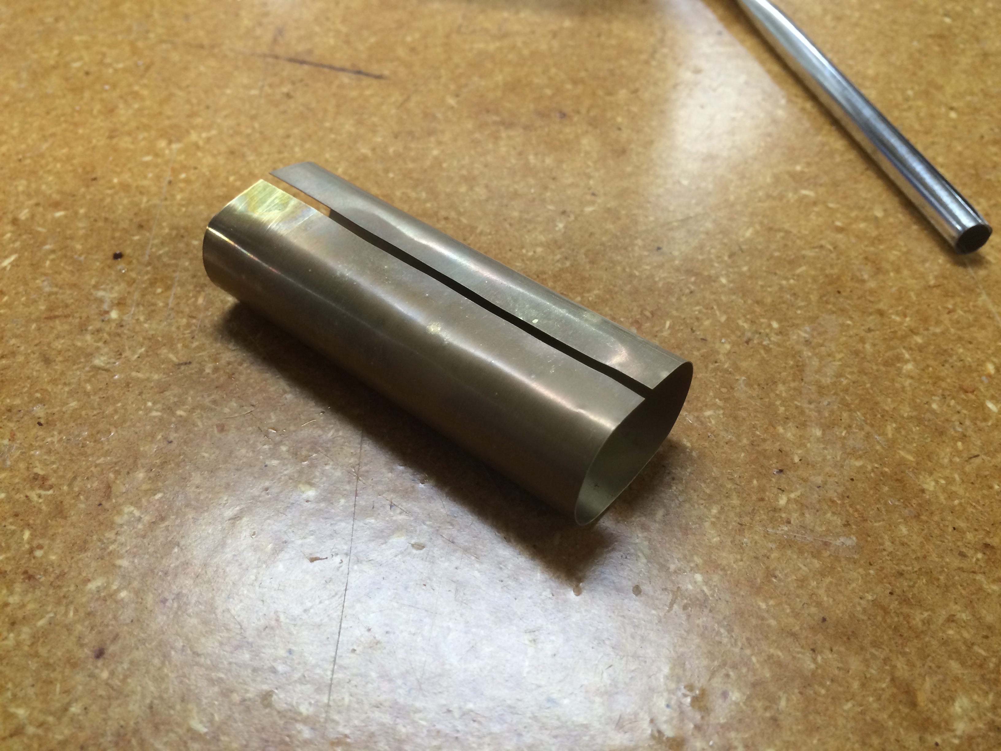

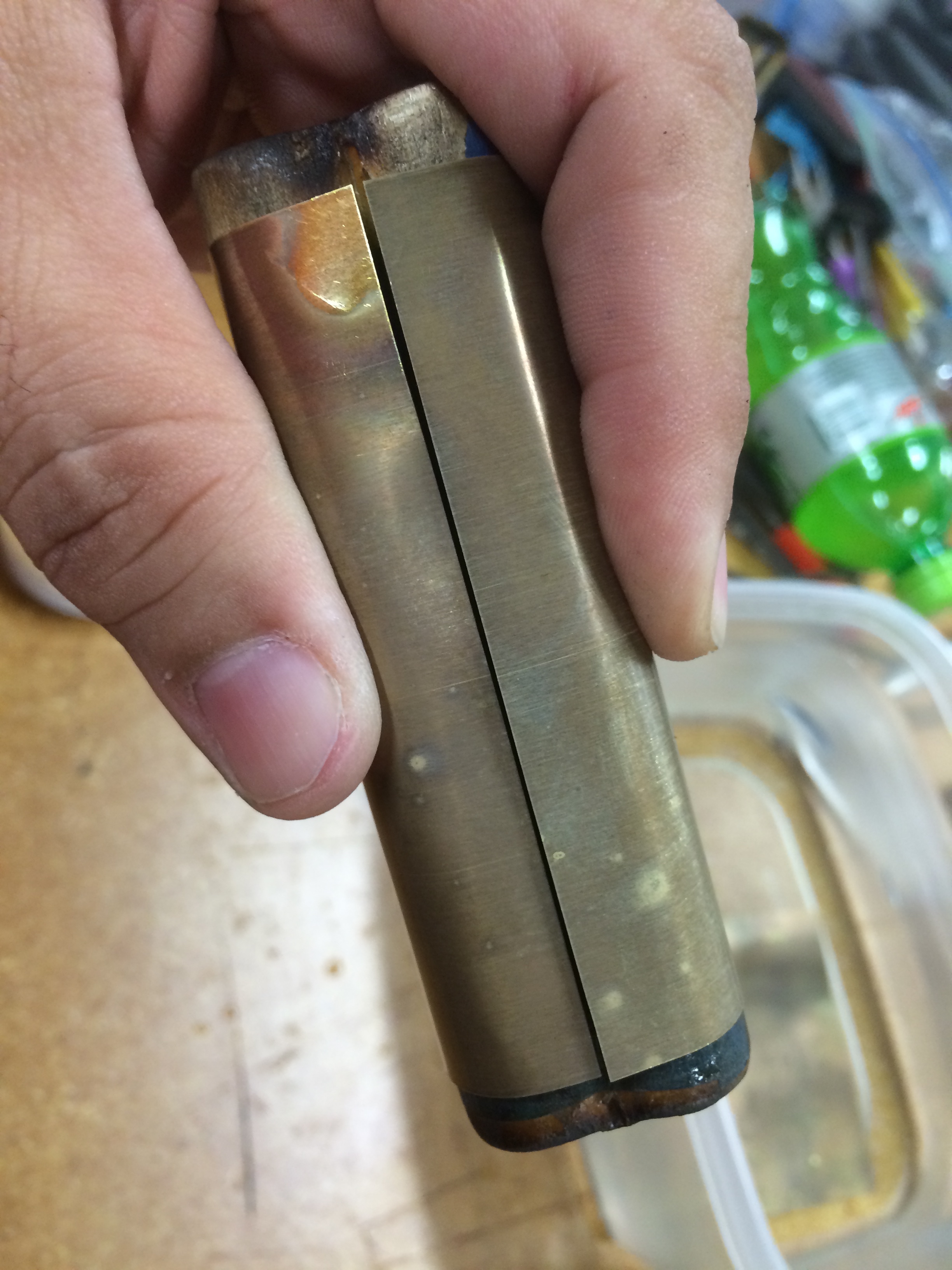

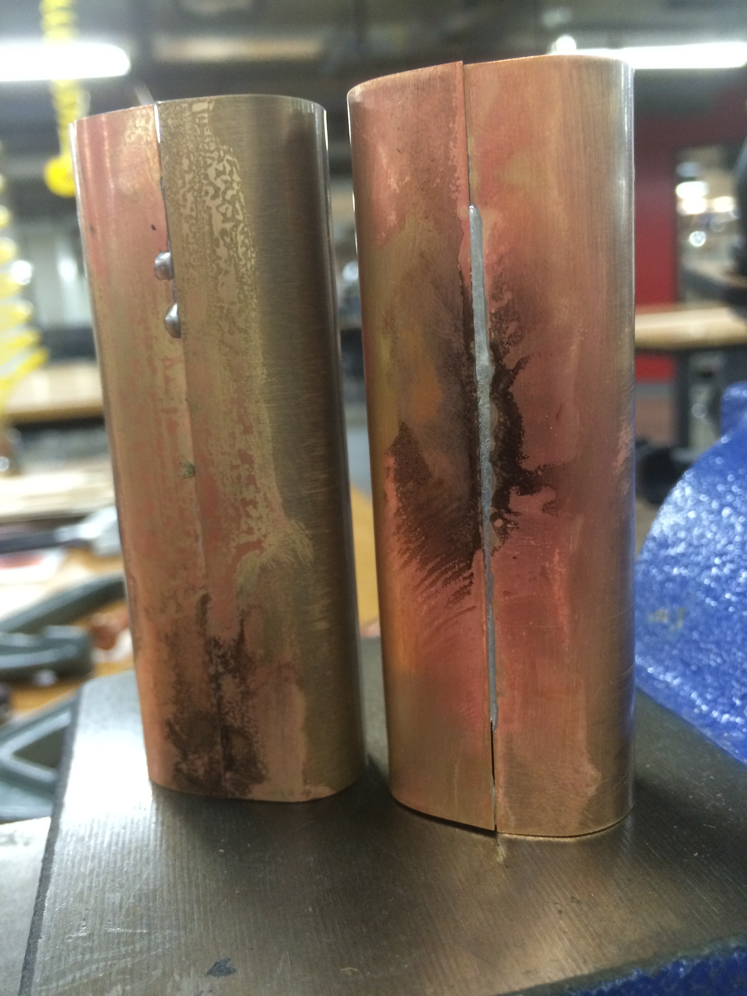

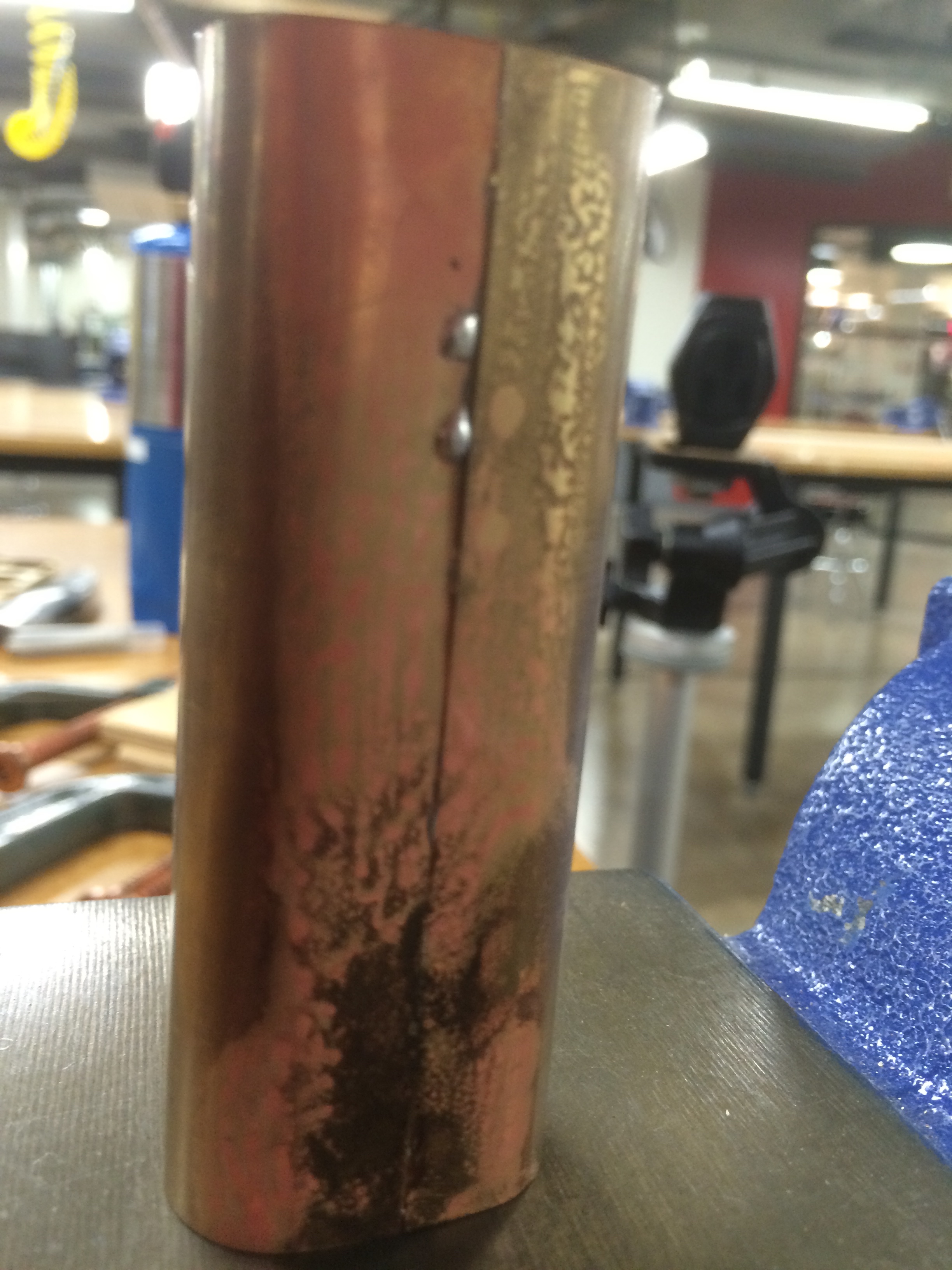

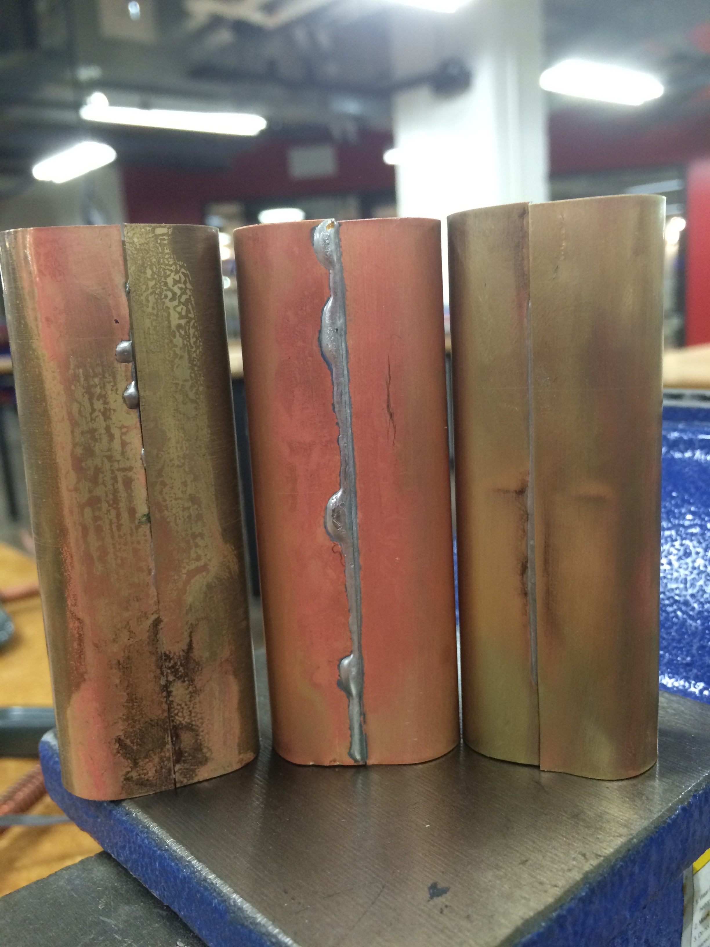

I decided to solder it differently from before, since I wound up with pretty crappy results (those will be in the video, unless I threw them out in frustration). I got the handle edges together by bending them slightly out of shape and putting it in the bench vise and GENTLY squeezing it till the edges butted up correctly. It hardly takes any pressure at all to hold the shape in place in the vise, and just a teeny bit more to keep the edges butted together.
But when I soldered it, I got this crap:

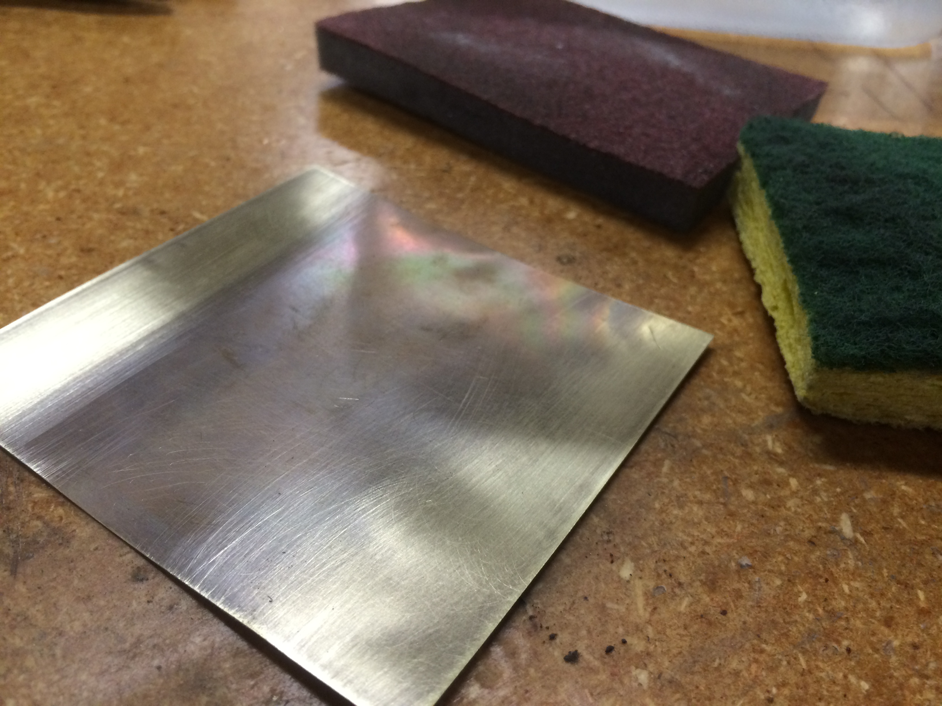

This is what you get when you completely space out on cleaning your soldering surfaces and using flux. Yeah. It was that kinda night.
So I cleaned the surfaces on both sides with a coarse sanding sponge and some Scotch-Brite.
You can use a wire brush, but I hate those. Also a wire brush bit on a Dremel will work (I have several), but I didn't feel like breaking it out and changing collets and bits, even though it would've gone quicker with the Dremel. Yeah, it was definitely that kinda night. Then I fluxed the crap out of it and soldered.
This time, I got much better results:
Eventually I'll get it nailed down to where I can get a perfect solder along the entire length of the joint, but structurally this will do just fine. The third one came out fine as well:
It would have come out better, but I thought I'd get clever and solder it on the outside instead of the inside, and that just gave me a clumpy mess, which I had to re-do. As you'll see in the video, the easiest way I've found is to lay the solder along the joint on the inside of the handle, and bring the torch in underneath from the outside. This pulls the solder downward into the joint very evenly because there's room to work your flame around freely. If you're trying to put the solder on the outside, your flame has to be inside the tube, and that restricts your movement, causes your heat to be uneven, and leads to the crapulent result you see above. The video will show this clearly. Plus it's incredibly cool - I had the shot focused closely on the inside of the tube and you can really see what's happening.

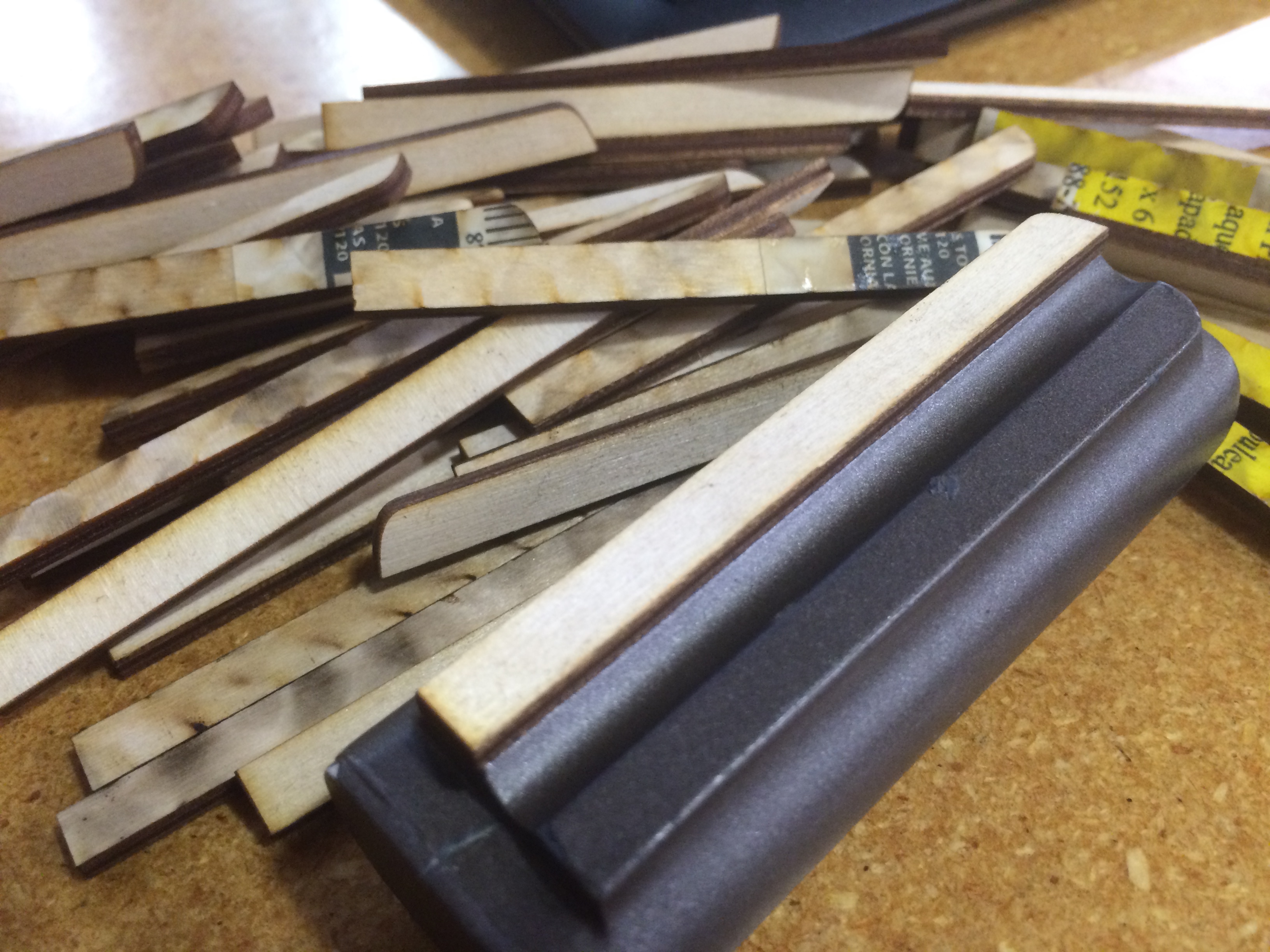

The upside if having the sticks built in is that I was able to precisely copy the shape and positioning of the Jein grip. On that phaser the sticks aren't evenly positioned and I have copied that idiosyncrasy in my model. The price is a reflection of the fact that I made the sidewall as thin as possible and also that I didn't put any markup on it

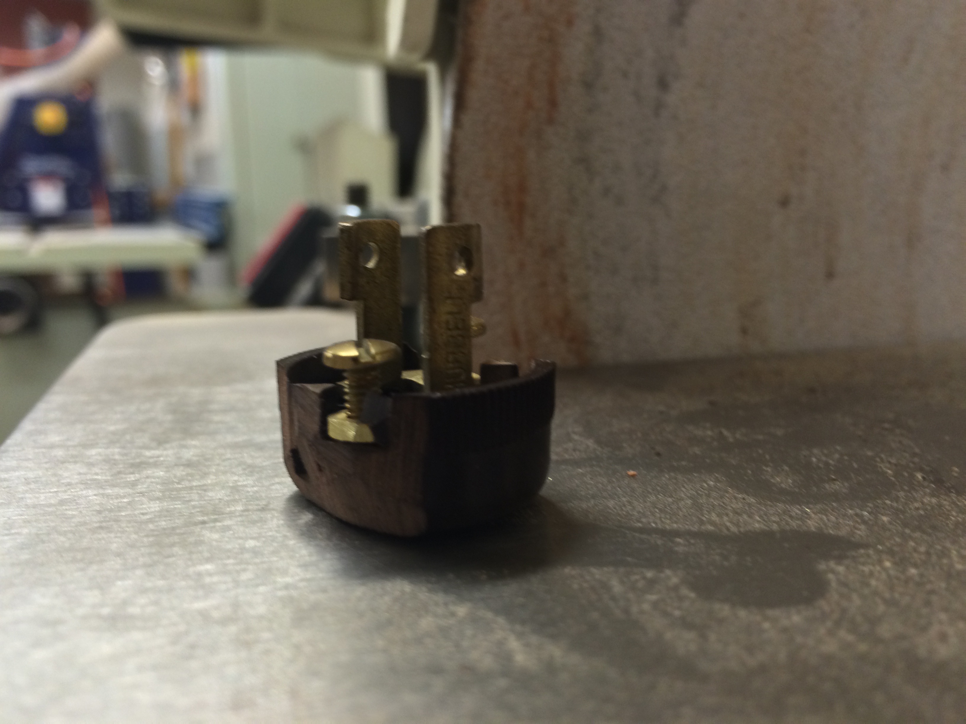

2014-10-26 10.35.39.jpg2014-10-26 10.27.37.jpg2014-10-26 10.34.38.jpg2014-10-26 10.56.02.jpg

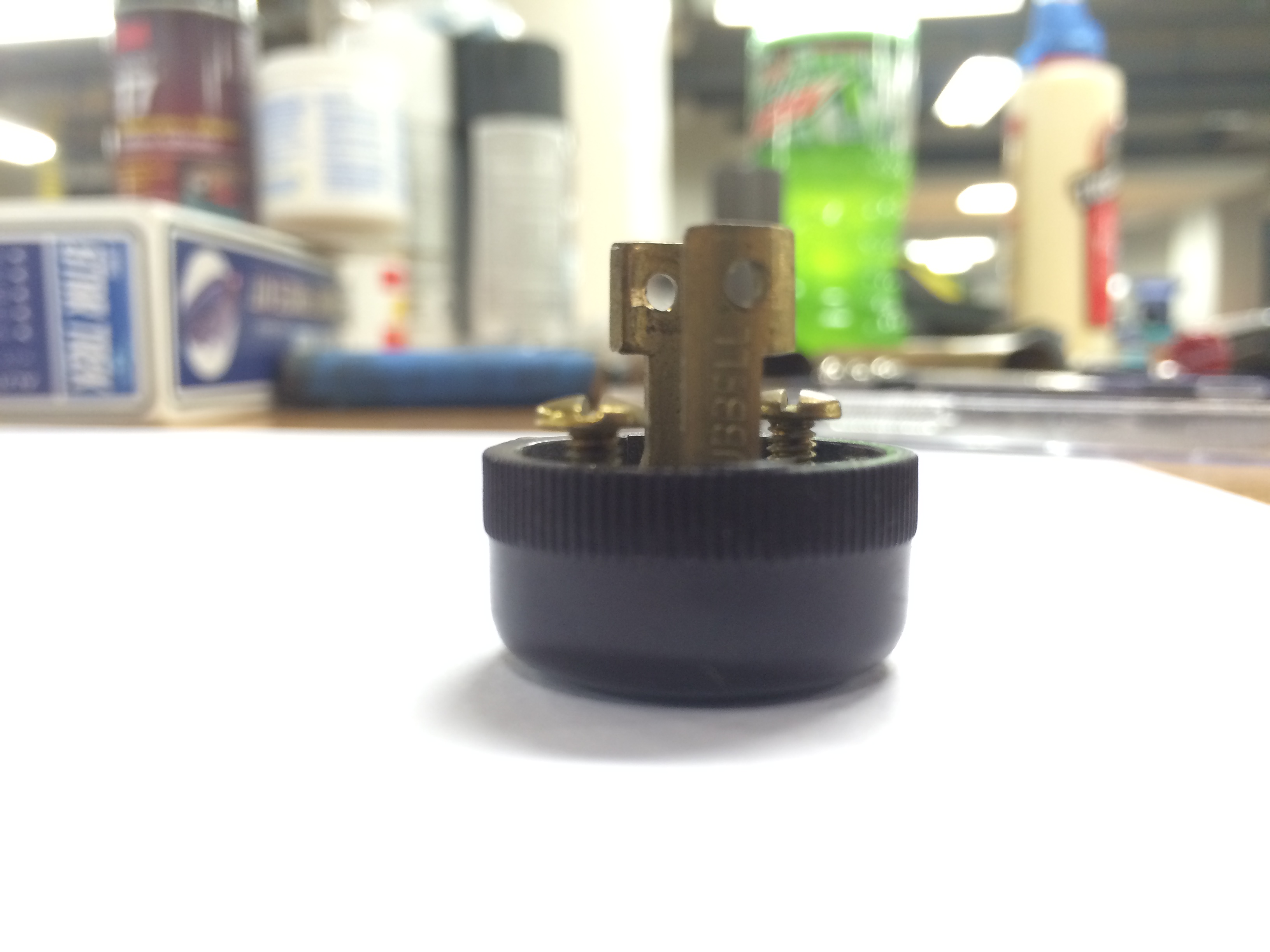

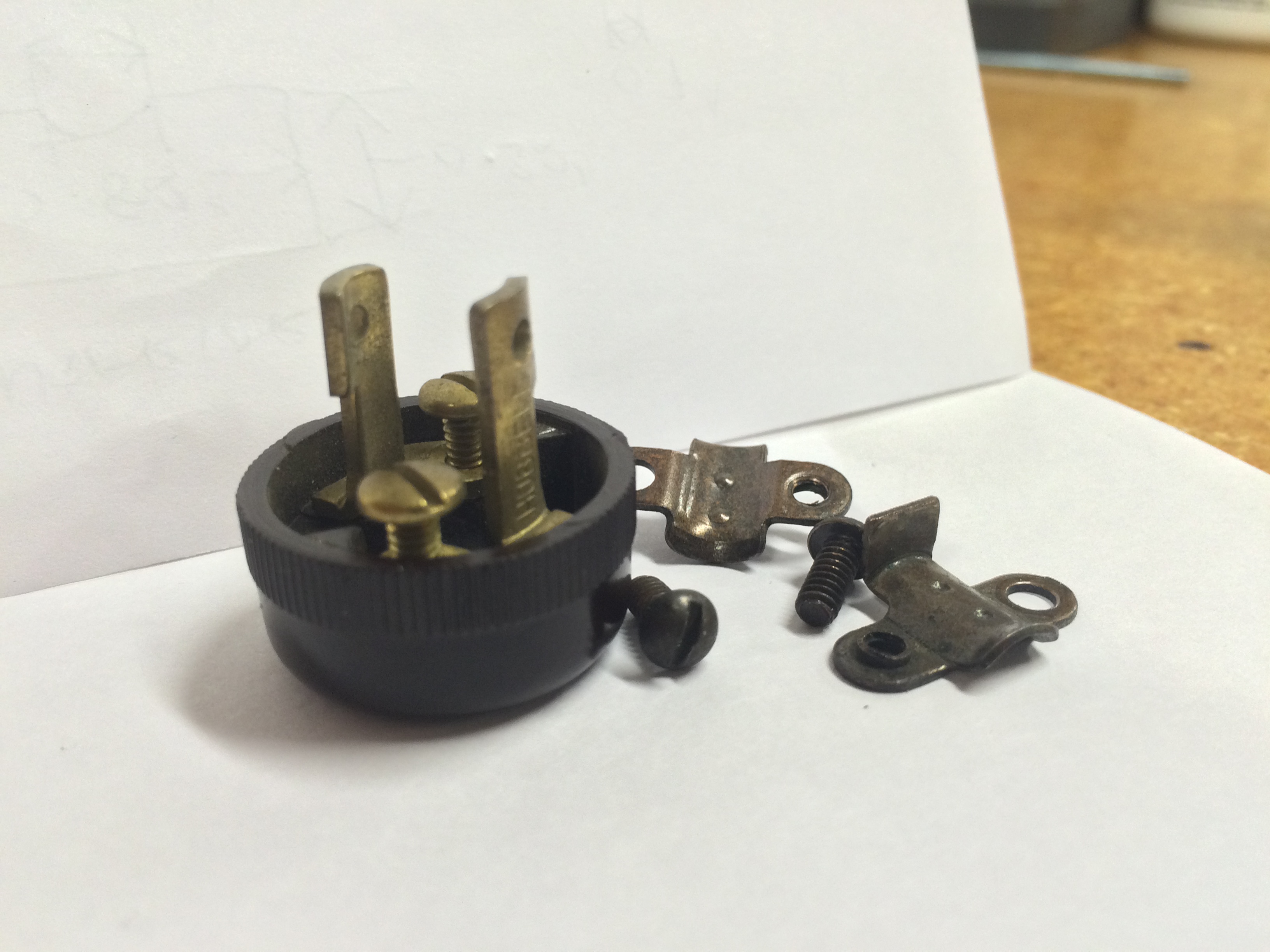

This is a vintage Hubbell Bakelite midget plug, which is what was used on the original handle. I've had this for many years under obligation of secrecy, but now that the cat's out of the bag after a post on another board, I can finally talk about it.
I don't know what model this particular item is, but the modern-day Hubbell equivalent is this one, model HBL7465V, and Sci-Fi Props does seem to have the best price for it, $10 plus $3.95 shipping. They're widely available, you just have to shop around. The vintage Bakelite ones, however, are harder to find, but they do crop up on eBay. What you want to look for when you get your male plug, whatever kind it is, is that both posts are brass. Many have one post in brass and the other in what looks like nickel-plated steel, and that's not what the plug on the original phaser looks like.
The last photo shows the weird texture of Bakelite after sanding, like some kind of brittle resin.
Prepping the plug for the handle is very simple. Sand it down on a sanding wheel, with a Dremel sanding drum, or even a cutoff wheel if you're skilled with it -- you want to avoid biting into the metal prongs. Then, just hook up your wire...

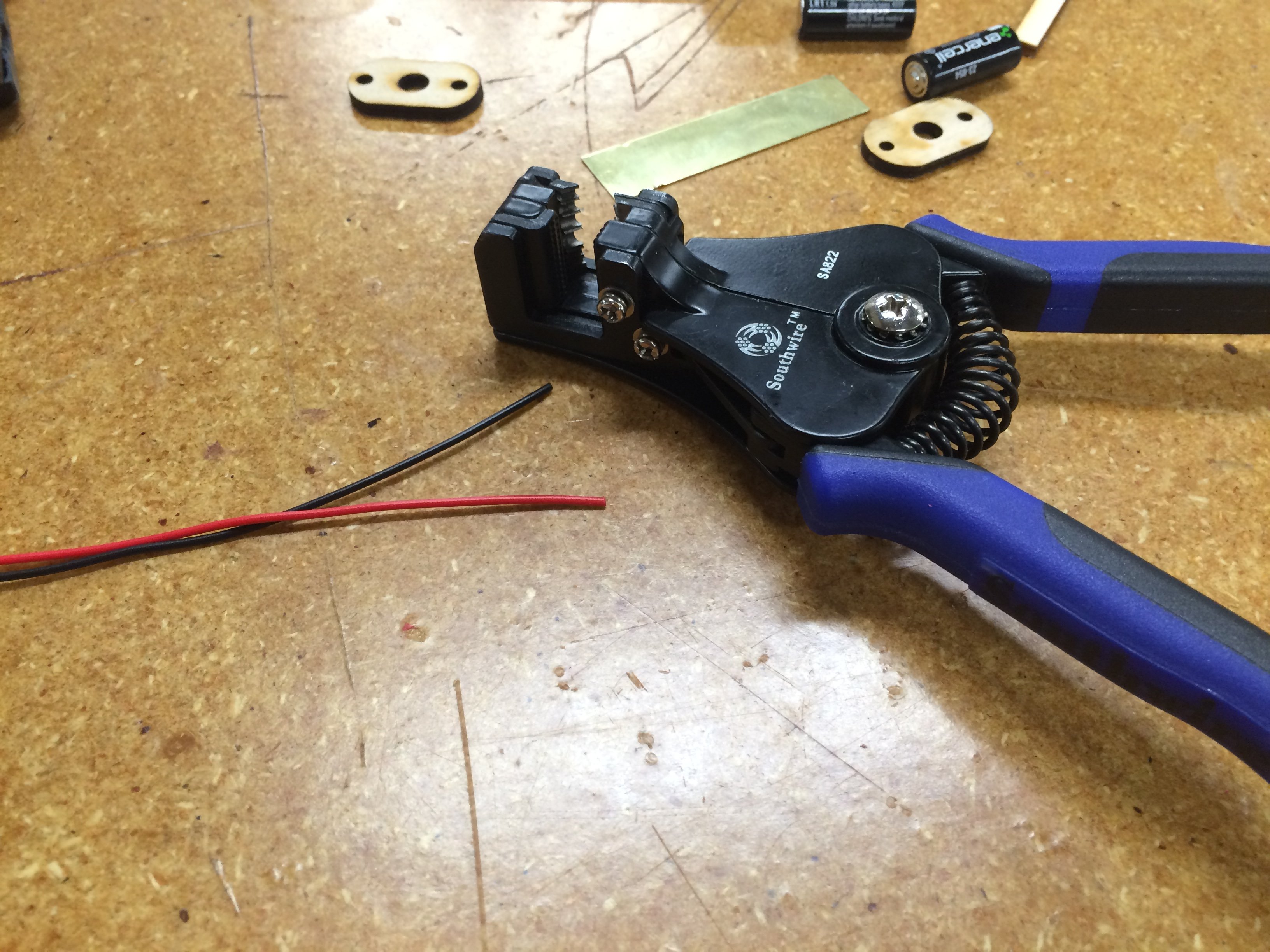

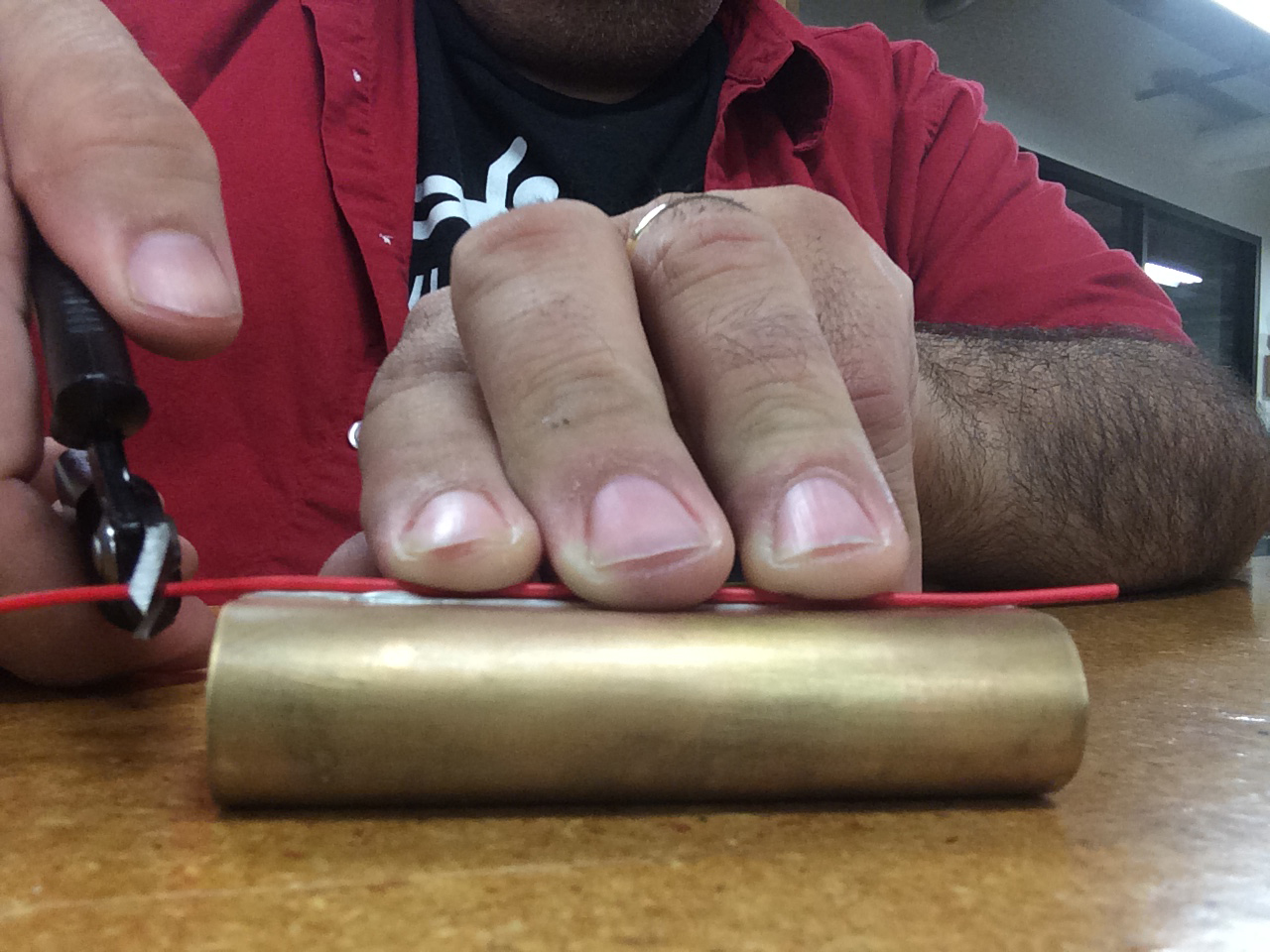

A word about wire. Get yourself one of these ratcheting wire strippers (also called "automatic wire strippers"). They will change your life.
It grabs the wire firmly, then strips it perfectly when you squeeze the handle. It's magic.
Update!!
Here's my YouTube video on this highly complex tool!
As for length, once again I resorted to my :ninjasuper-secret-decoder-ring-prop-voodoo-ninja:ninja skills:
