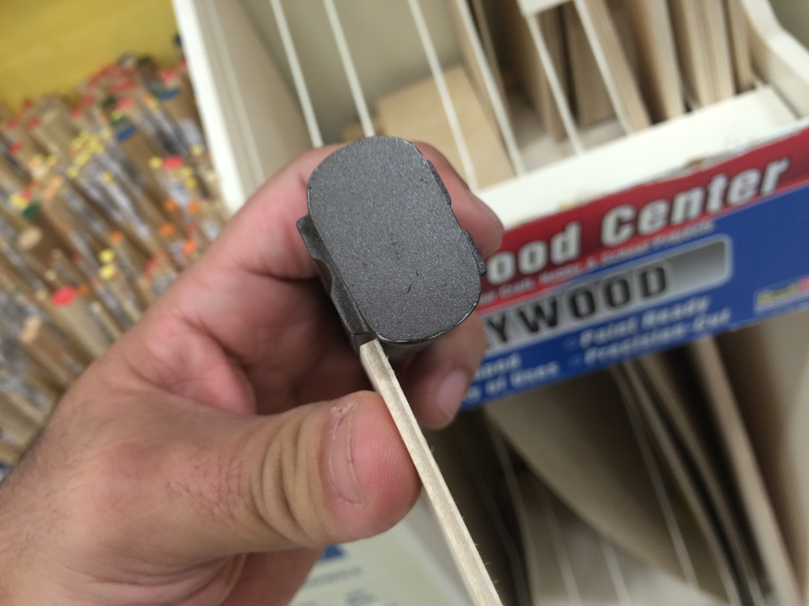

Now the wood for the popsicle sticks and end plug. Thickness is crucial, and after examining photos, measuring my MM handle with calipers and a micrometer, extrapolating complex-polymer shrinkage factors, and other very challenging math and super-secret industry black magic I could be killed for revealing...
It's a prop. Get real.
Besides, it turns out that only the P2 body shrank lengthwise when MM cast it, and oddly enough, the handle shows no detectable shrinkage at all. Can't tell you how I know that, just rest assured that if you have an MM kit, the phaser body is something like 3/32" short in the cradle area, width and heights are fine, and the handle is fine all around. So for length, stick your John Long P1 in there and gauge it (that's what I did), and for the handle, you're probably fine. (That assumes, of course, that your MM kit shrank the same way mine did, which it probably did.) Or if you're truly obsessive, take calipers to your Wand Co. phaser when it arrives (I know I will), understand that they averaged out measurements to correct the original's imperfections and make it symmetrical, and live with the fact that your three-decimal-place measurements will still be off by several thou in any direction.

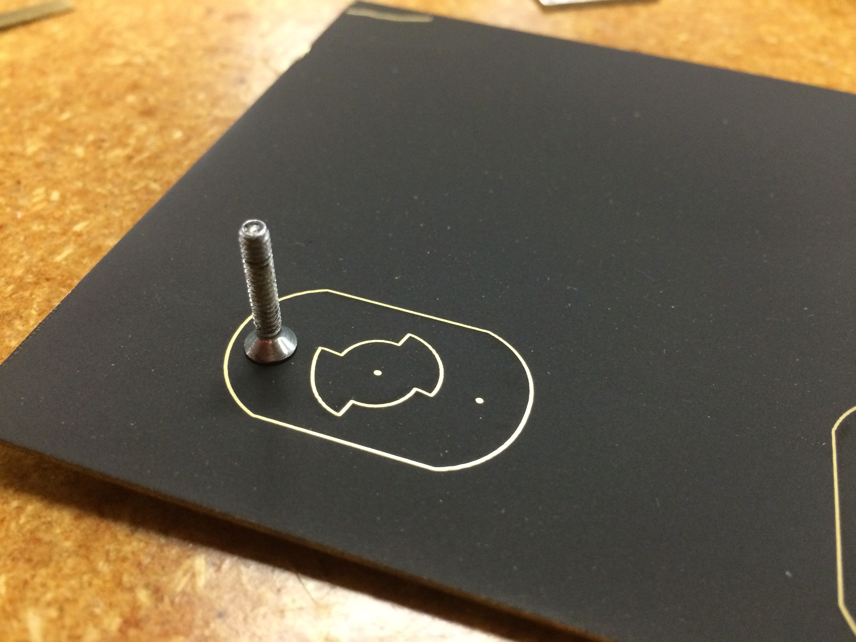

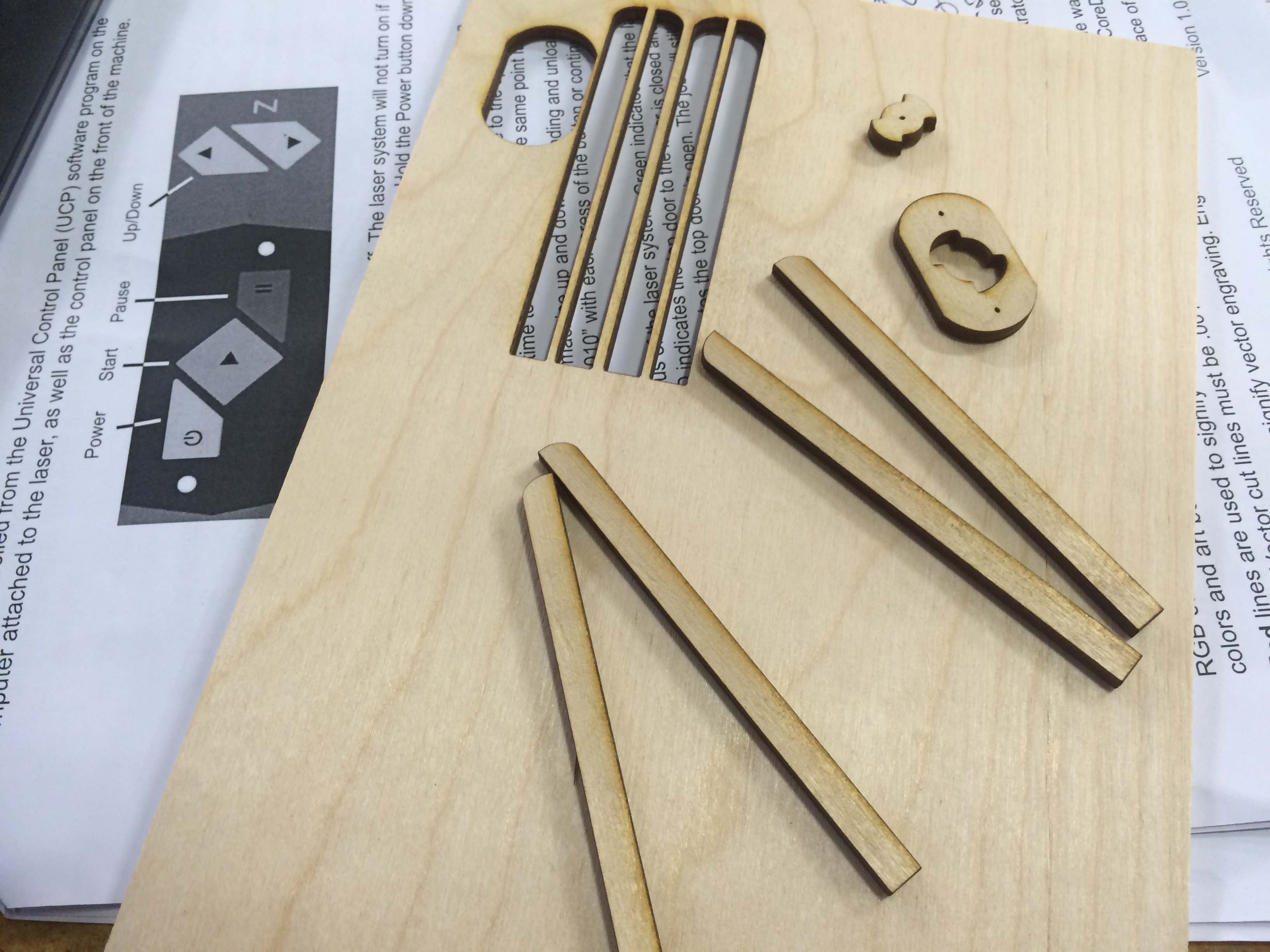

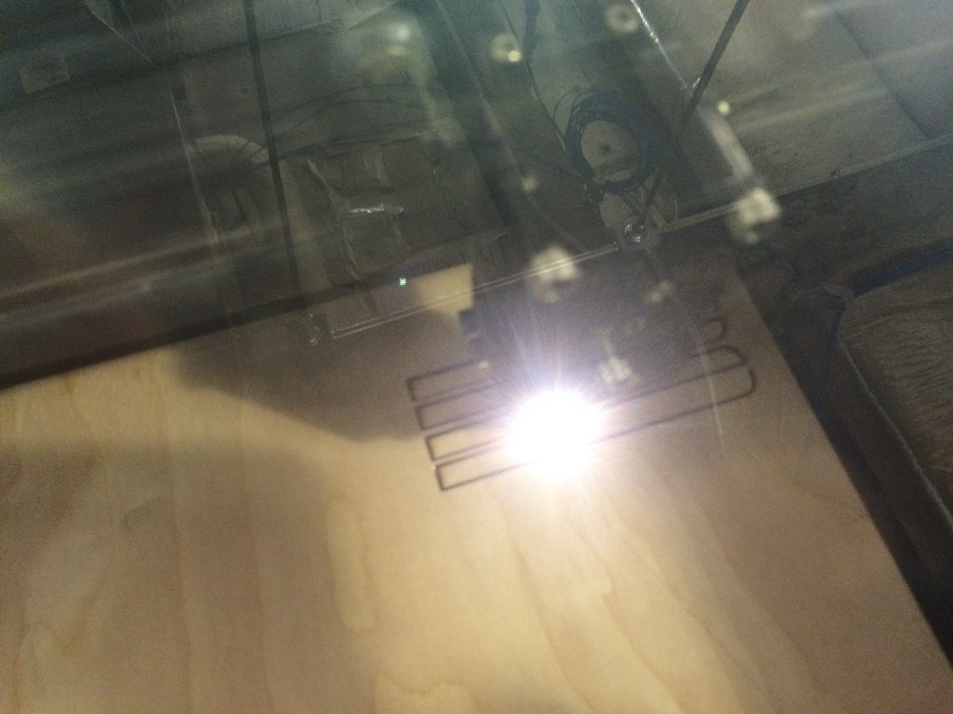

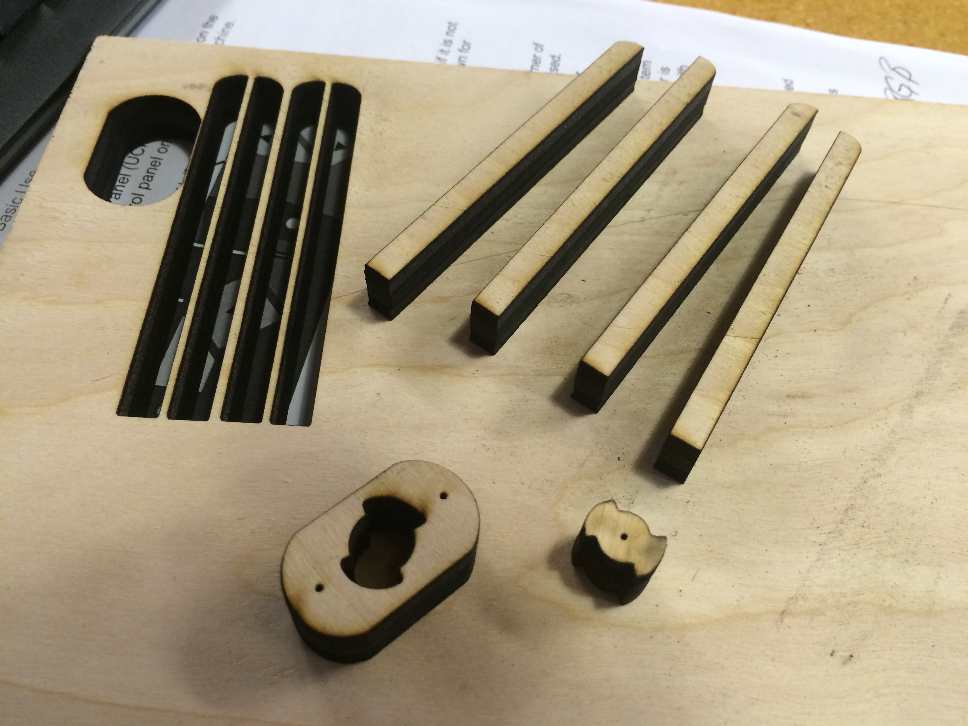

First, I grabbed a piece of scrap pine from the laser cutter scrap pile (they have scrap piles in different places for different kinds of scrap). I loaded up my Illustrator artwork (resulting in one of those delays I mentioned up front), and just went to town. The cuts came out perfectly. No matter how many times I use it, the laser cutter never fails to blow me away.
The popsicle sticks look long because they are. But having just won a 30-minute battle with the computer, I didn't want to modify the artwork in Illustrator. This is a one-off project, not a mass-production, so in this case I will simply use the Holy Bandsaw of Antioch later on.
I ran the actual wood from Michael's for the popsicle sticks and the butt plug (or the bottom half of it, anyway), and also engraved my brass piece to mark out my end plate. To engrave metal, this particular cutter's laser is too weak to ding metal, so you have to paint it or powder coat it (or use anodized aluminum). The laser then actually engraves or rasters the paint or enamel, exposing the metal underneath. Here's one place where thousandths DO matter -- your paint or powder coat will be between 2 and 6 mils thick, or 0.002" to 0.006", and the laser needs to know how deep to go. For the record, I set material thickness for 0.005", which seems to work well enough most of the time. Even precision can be imprecise. :)
Here's what I got:
And here's the laser cutter in action:

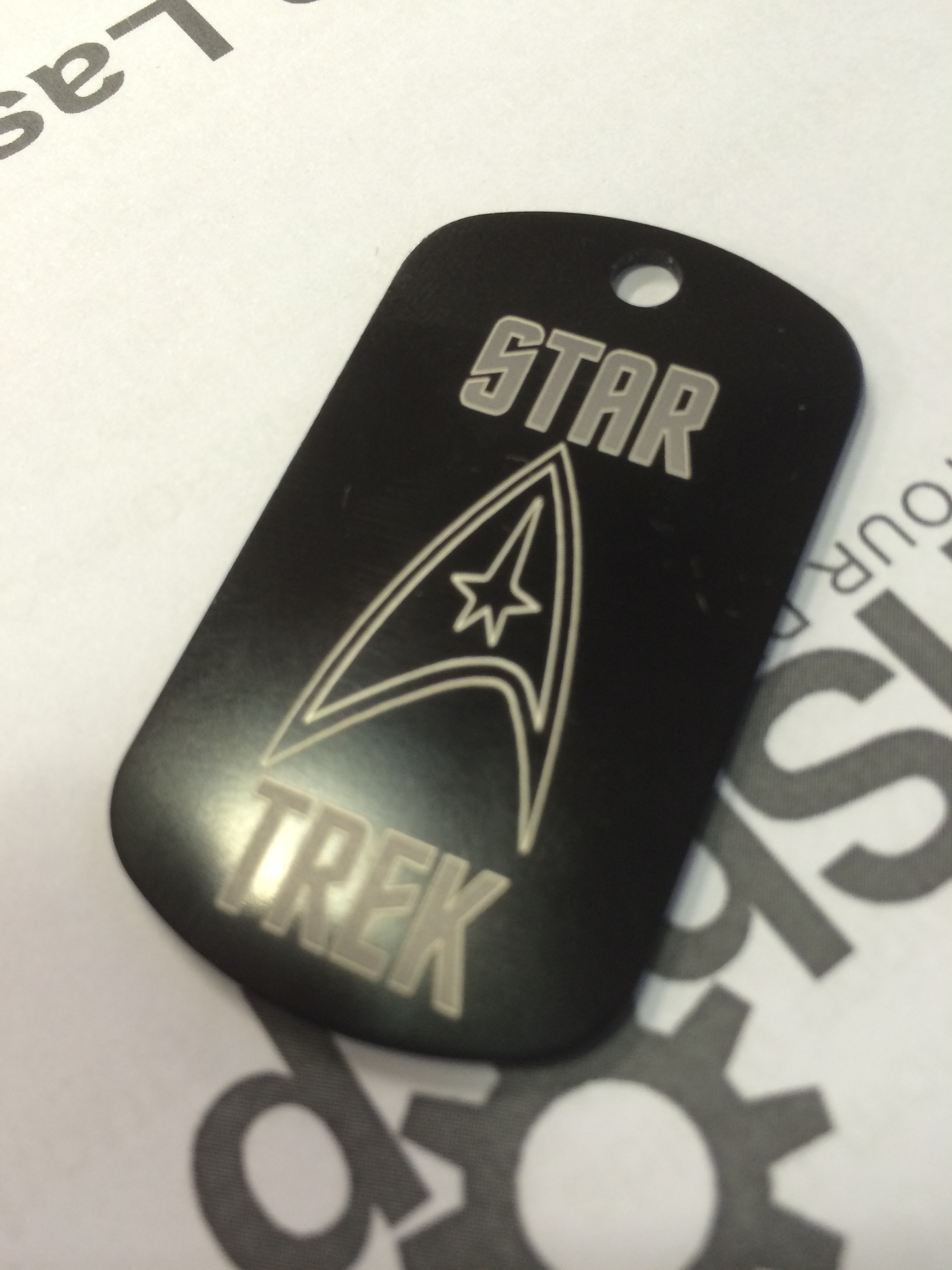

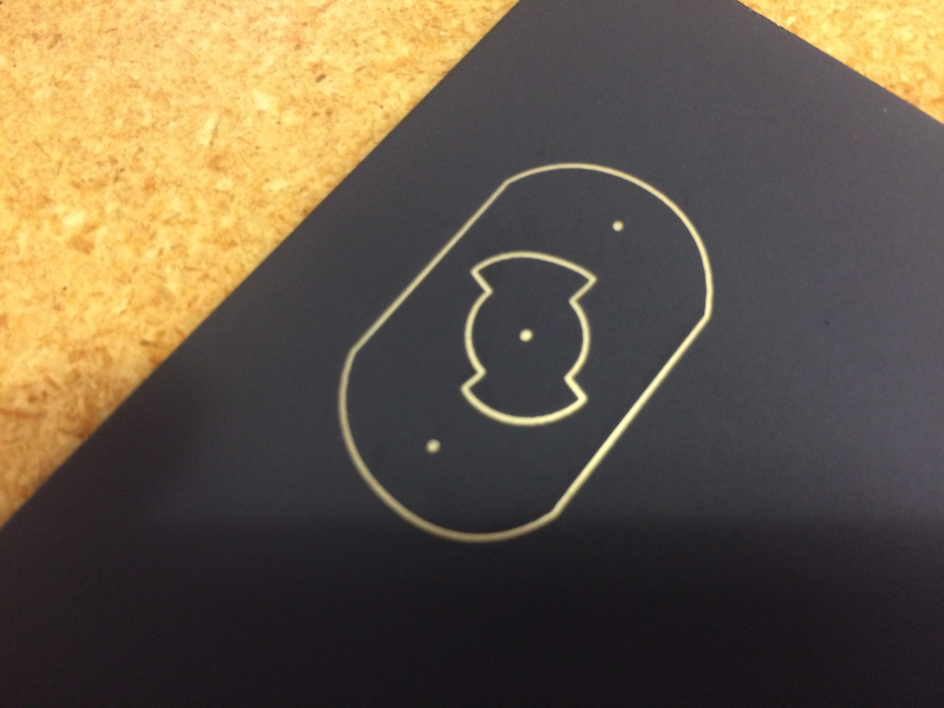

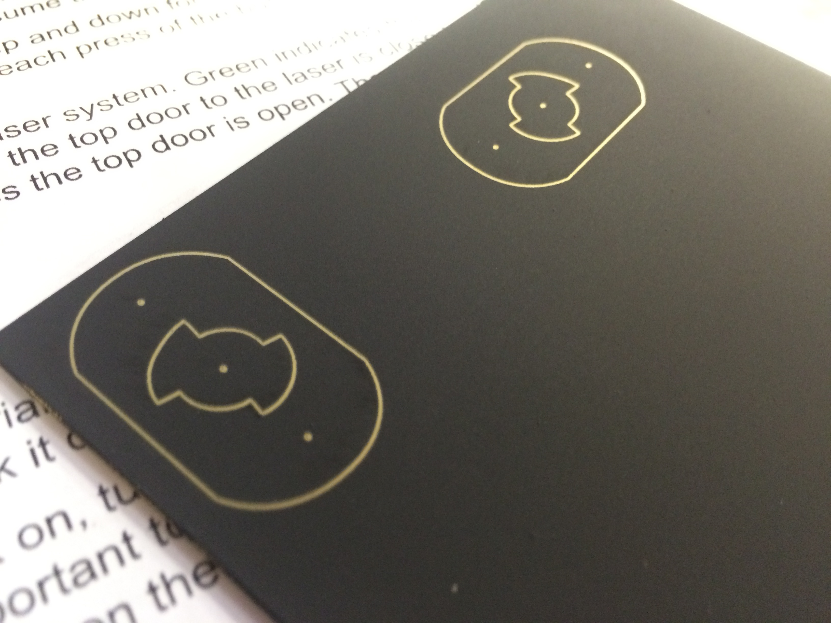

Engraving the Painted Brass
Cutting the Wood Parts
One of the wood cuts below -- I did more but forgot to shoot them all. I also did the bottom half of the butt plug (which is not usually what I use it for), shown later on. I'm going to redo that artwork and cut both halves next time.

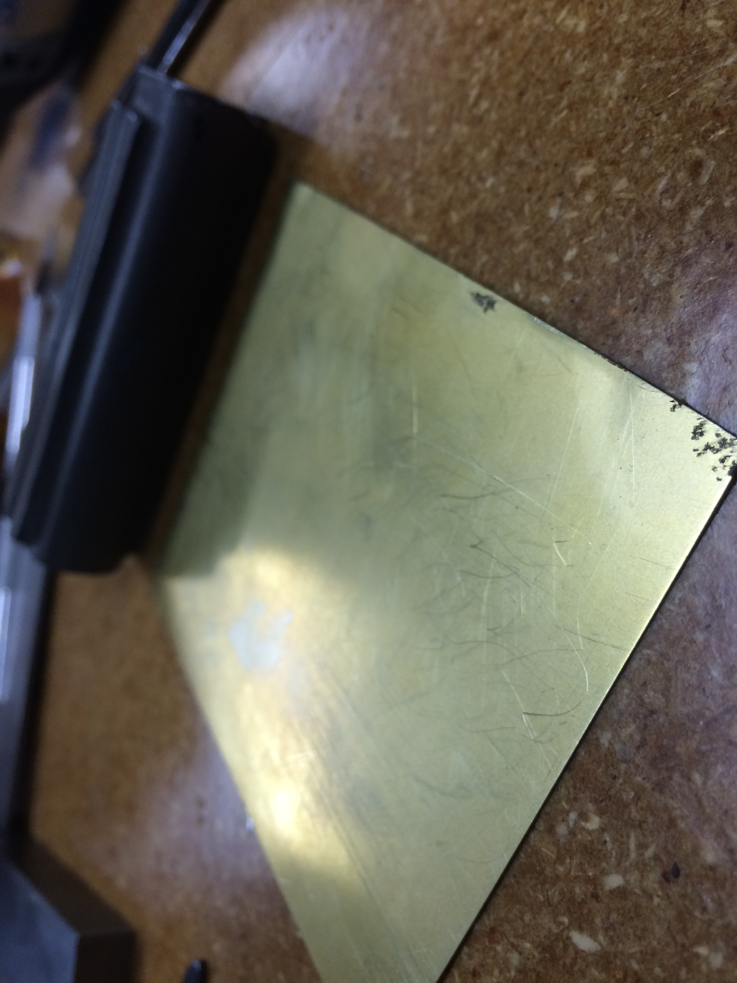

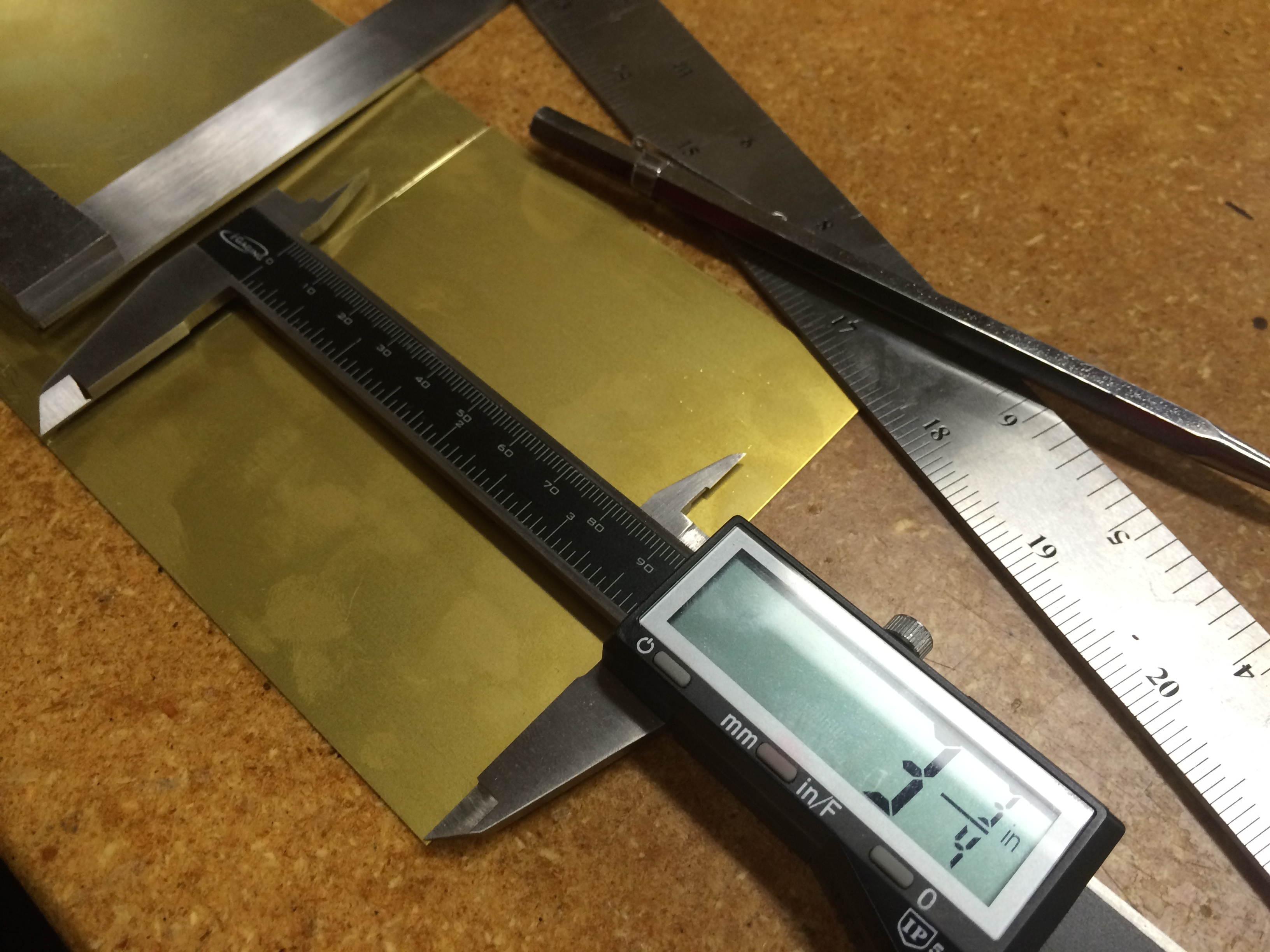

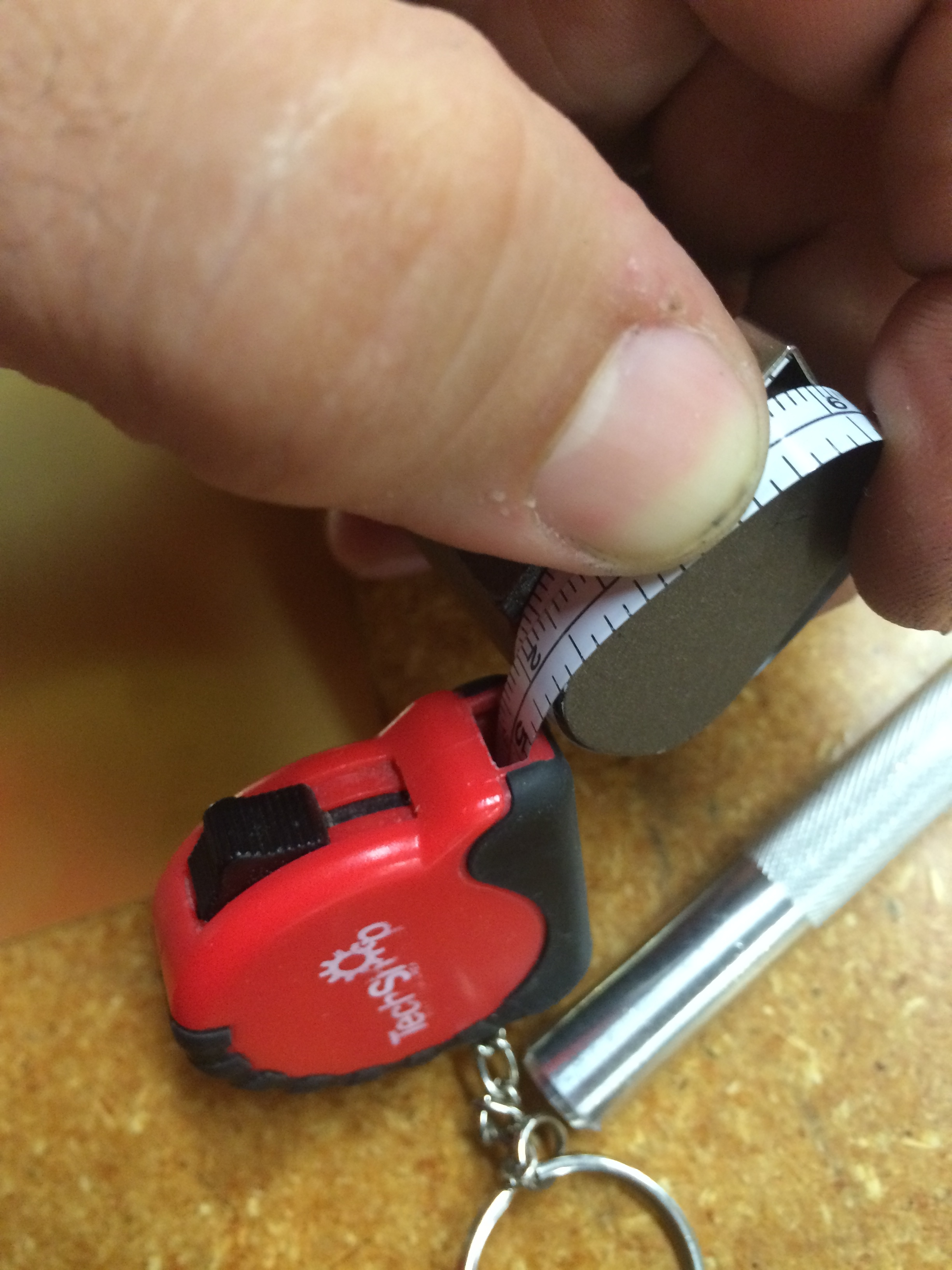

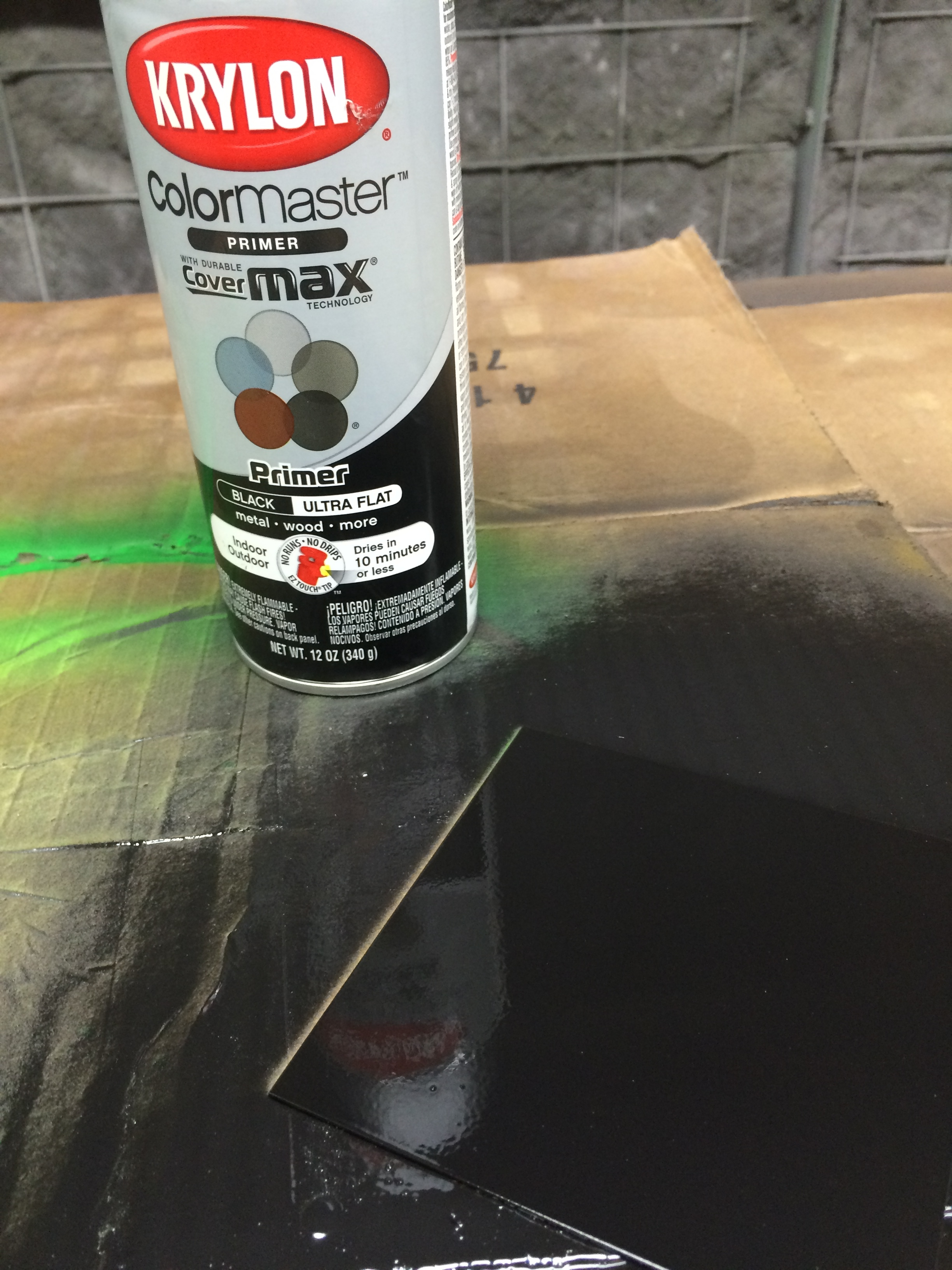

Now, time to cut the 0.010" brass for the main shaft of the handle. Precision is crucial, so once again I deployed a super-secret industry voodoo method to get my circumference:
Yes, that's my Techshop keychain I'm using. Best swag ever. :) But it seems I've taken my point about precision a little too far, and bitten myself in the ass. What I should have done (and will do later this week, after I buy more brass) is wrap a piece of paper around it, cut off the excess so the edges butt up perfectly, and use that as a template to cut my brass. Instead, I just guesstimated to within 1/4", and that became a pain later on. Overall the method's fine, I just have to get rid of the silly demo part. :)
For the record, I prefer to use the fractions display on the caliper when I'm working on a prop, unless of course I'm machining something. Anyway, 3 3/4" was way too much slop, and brass is a little harder to trim than paper, especially after you've formed it into a cylinder. But do note how I marked it: a ruler, a square, and a metal scribe (or use the back of an X-Acto blade, but the scribe is easier). Measurements on props can be loosey-goosey, but marking straight lines is very important.

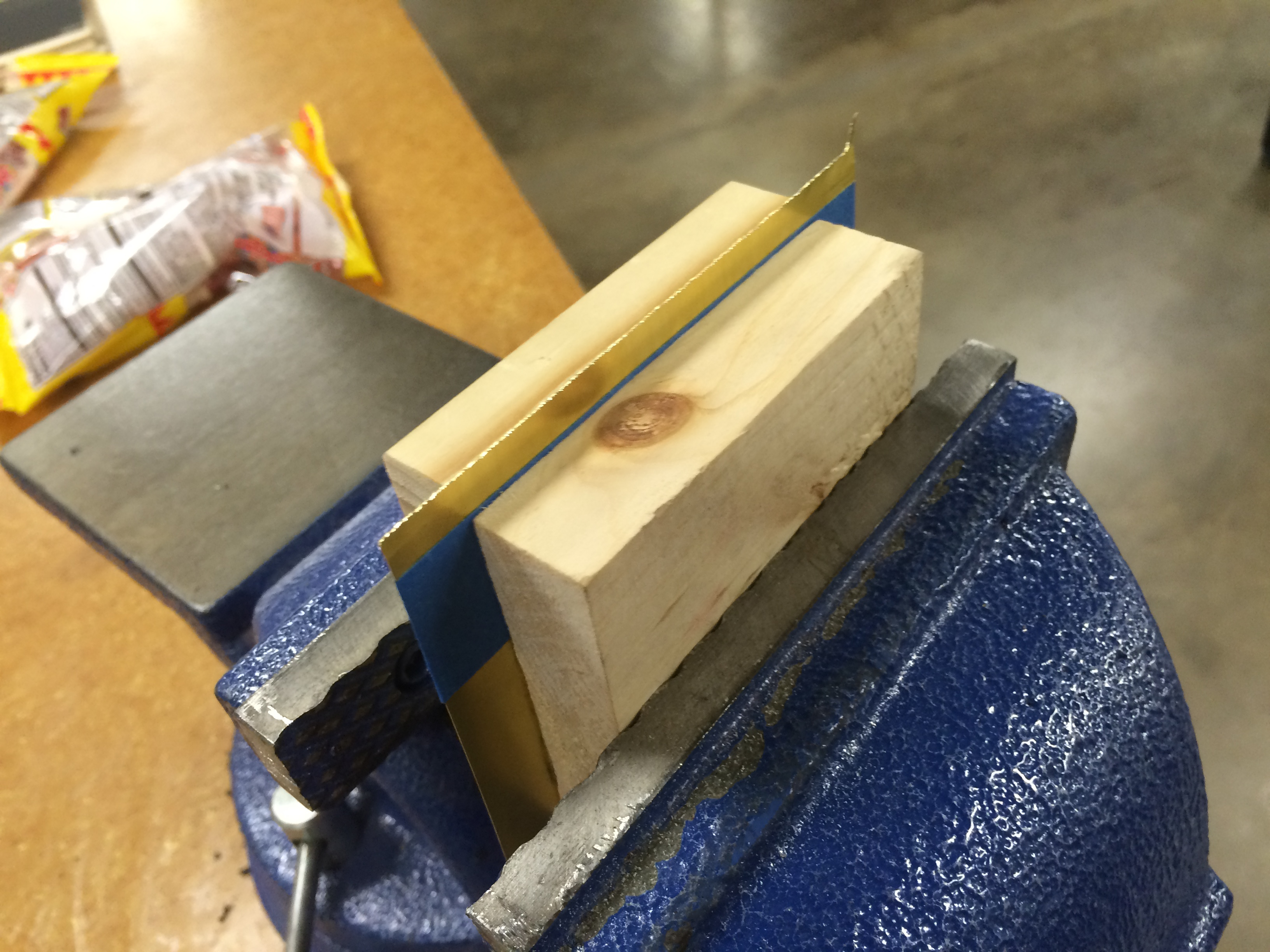

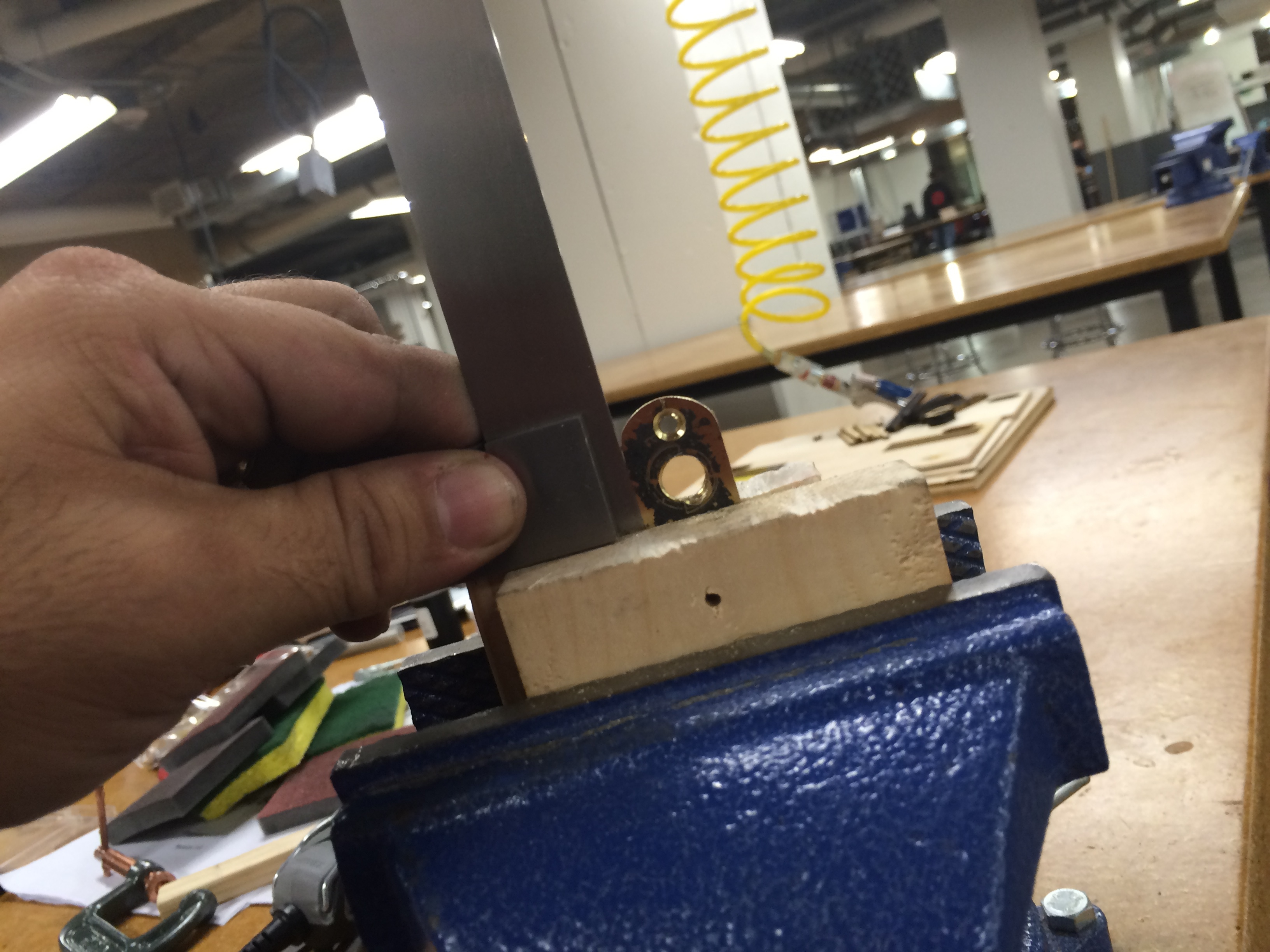

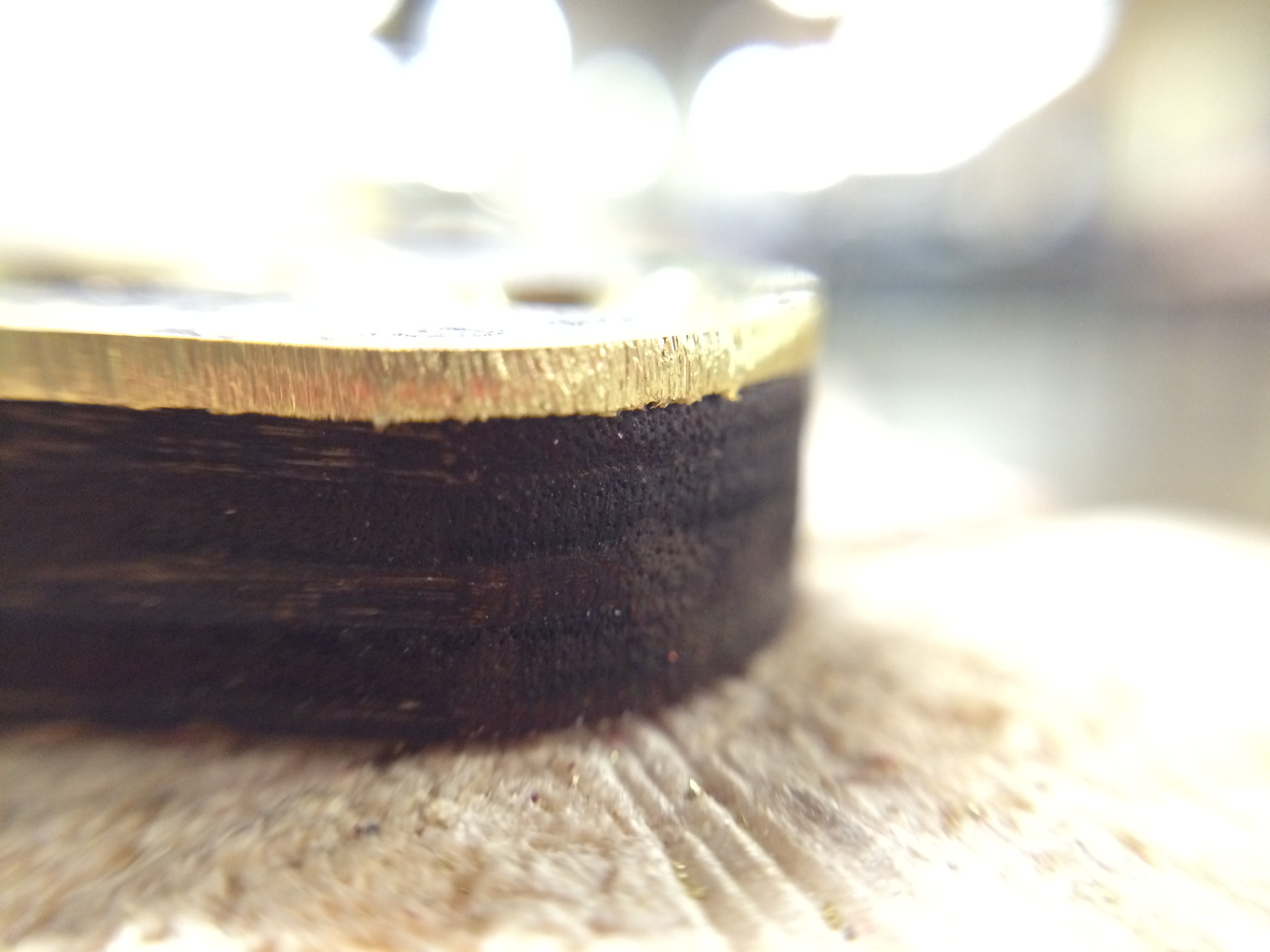

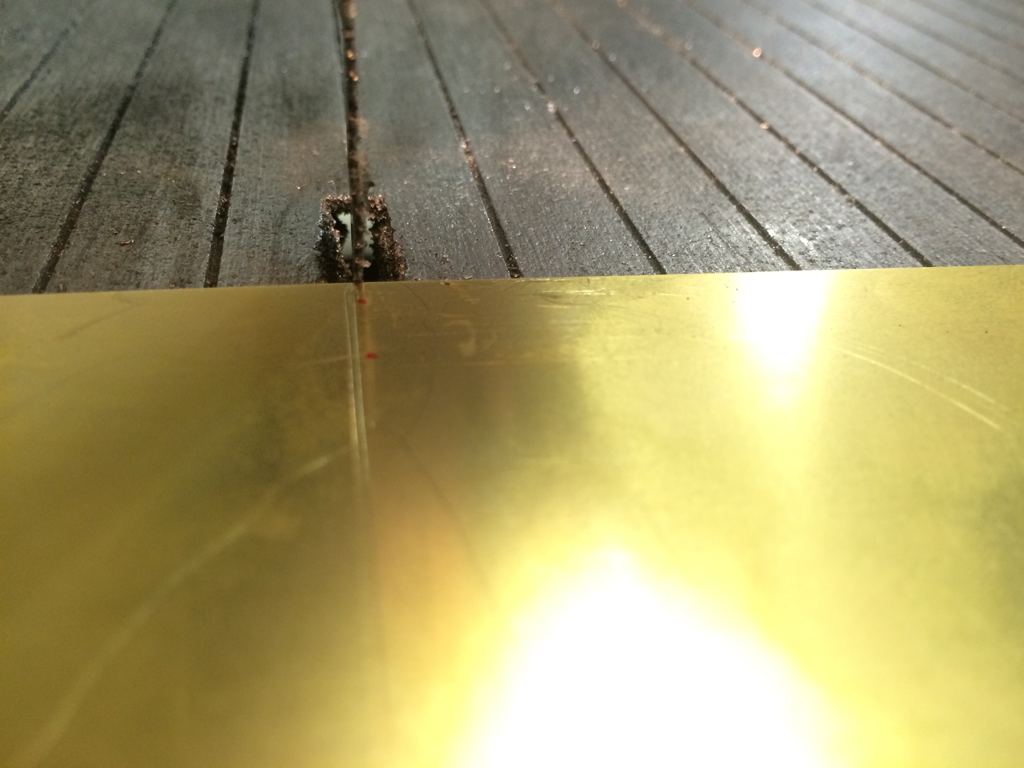

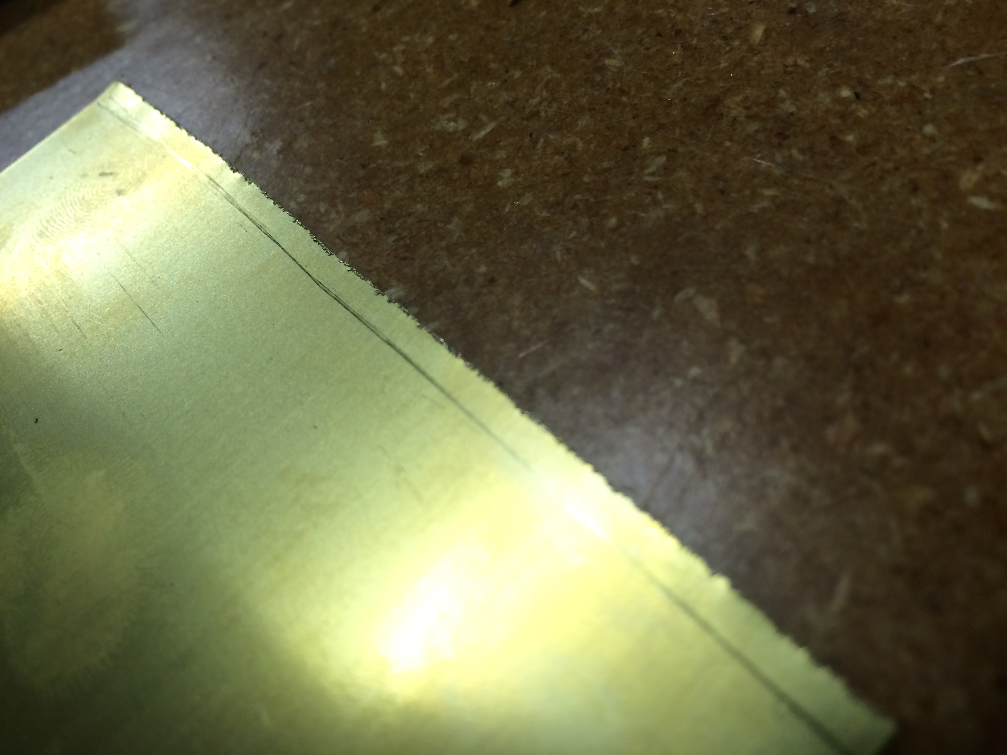

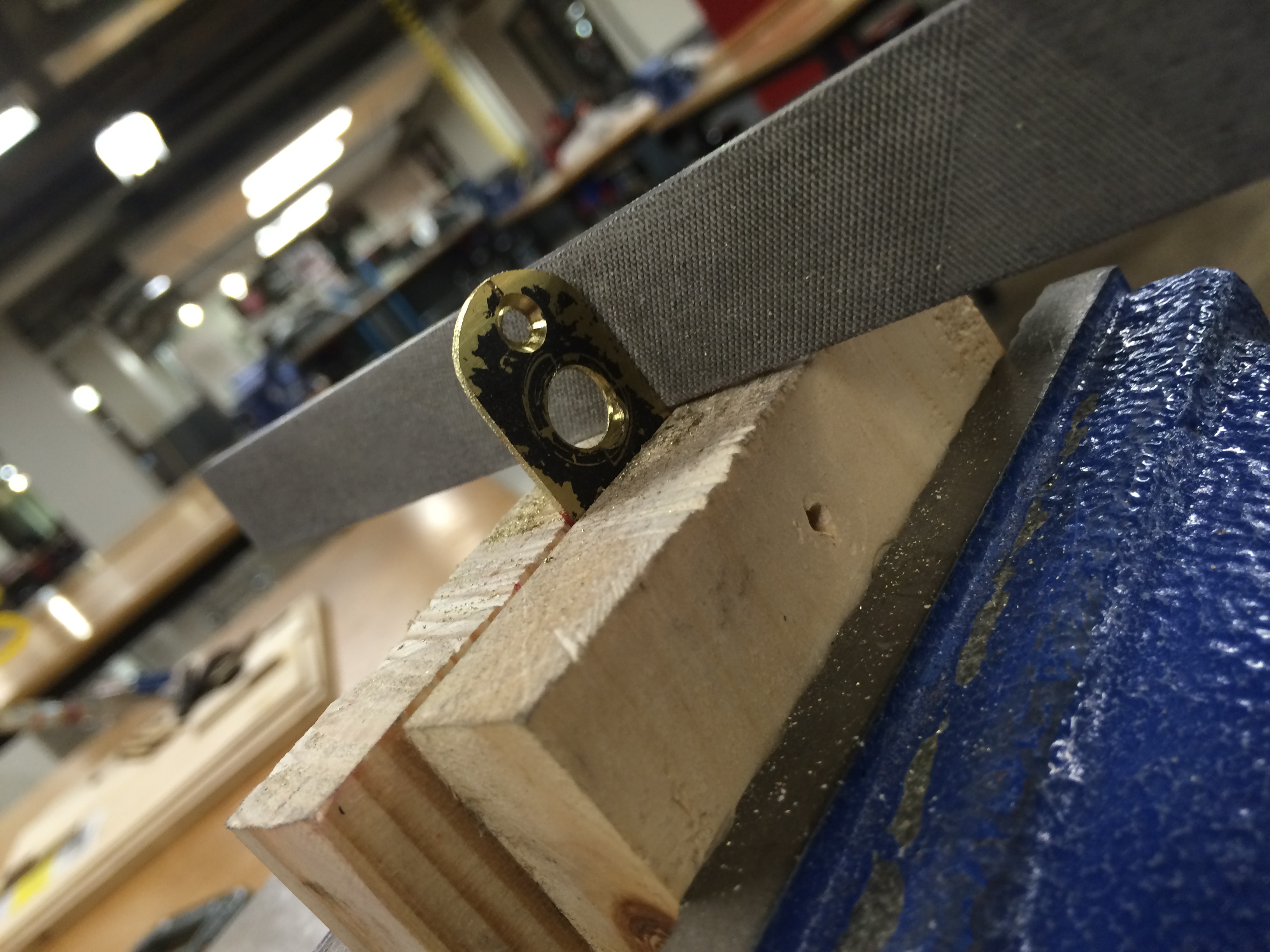

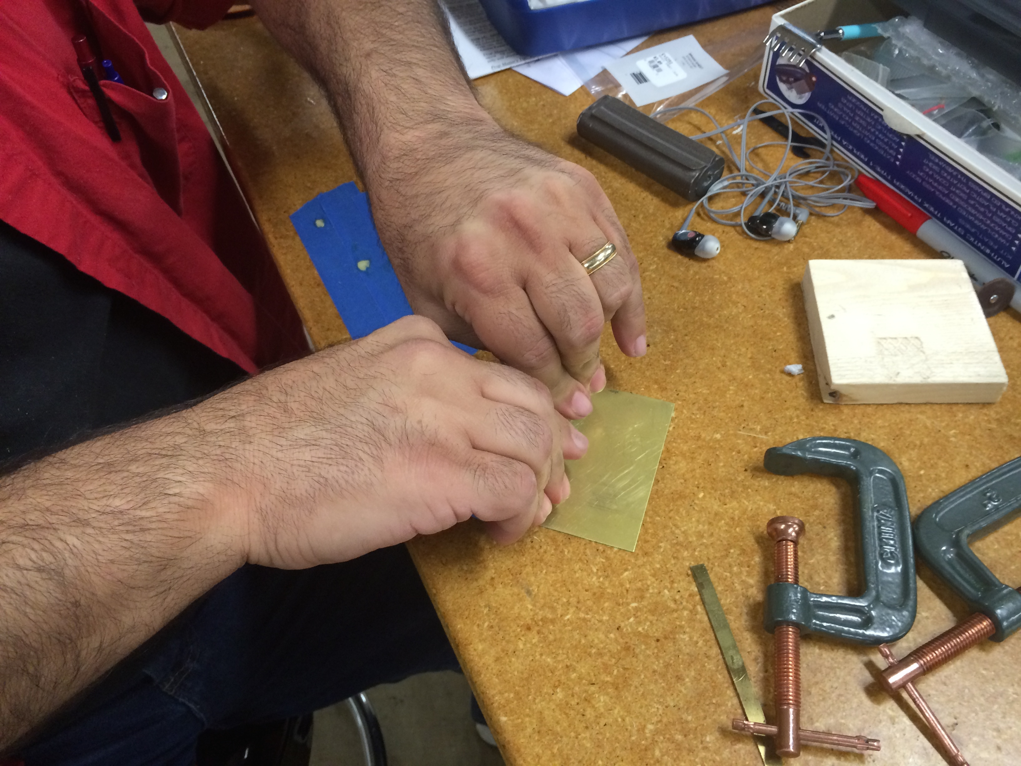

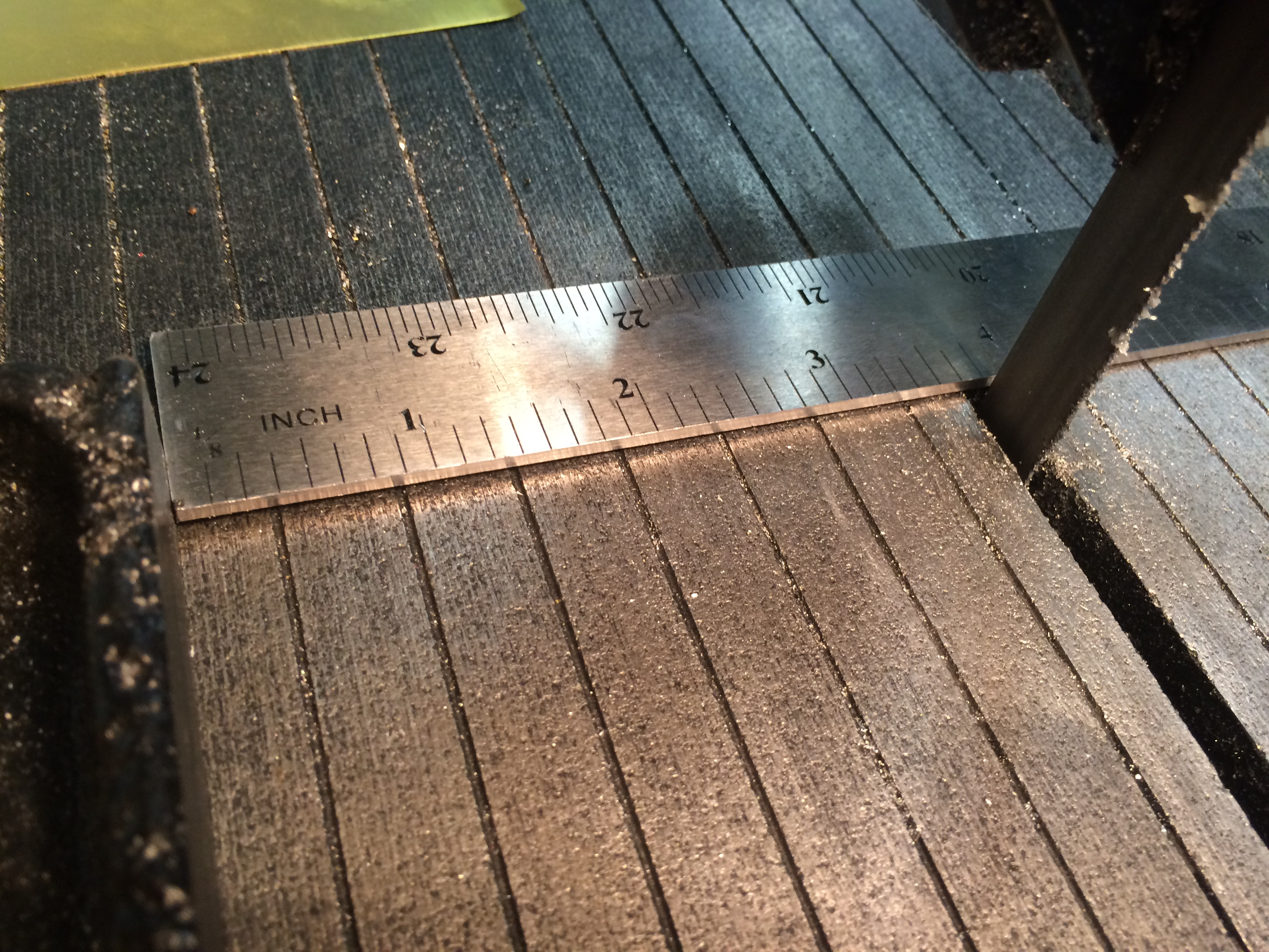

With the brass marked, onto the metal bandsaw. When you set a rip fence, measure between the fence and the blade so that the edge of the blade is outside your line. That way you won't be at your exact measurement minus a blade width (or half a blade width if you cut right down the line). There are reasons to do it those ways, but this is the easiest way I know to get exactly what you measured. Except for the third photo...

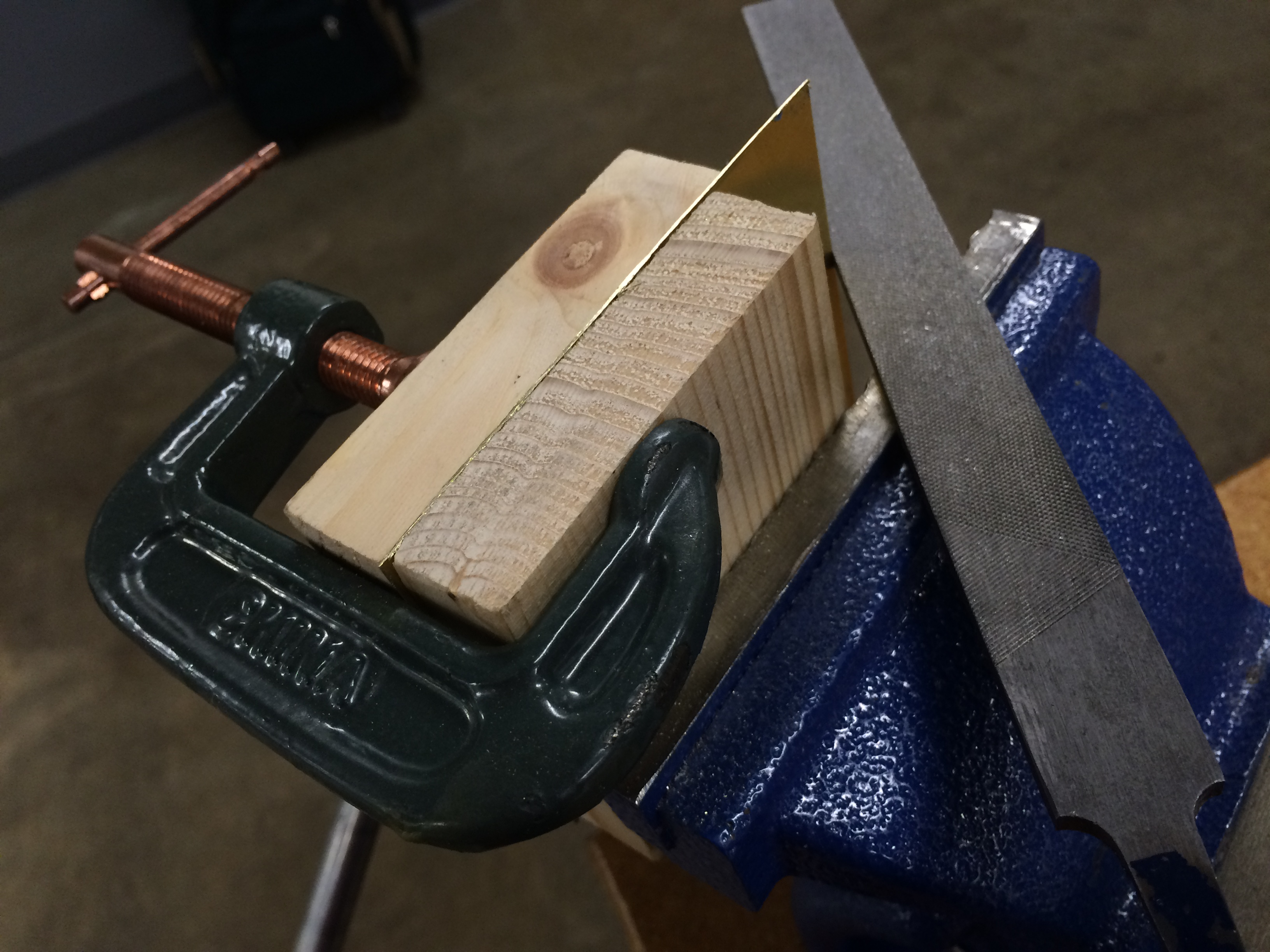

Holy crap!! That's a horrible edge. That's what happens when you cut thin metal with a messed-up blade. The upside of Techshop is there are hundreds of us members, and when we're together we cross-pollenate ideas and techniques like crazy. The downside of Techshop is there are hundreds of us members, and not all members are as considerate of others as they should be. So they'll screw up a machine and not tell anyone because they don't realize it or don't care, and the next guy (that would be me) gets a fun surprise. But fortunately, this is fixable.
Couple blocks of scrap wood, a file, a C-clamp, a big-ass bench vise, and you're in business. Just remember, always file in one direction, away from the handle, away from yourself. Unlike sandpaper, files only go one way. No backy-forthy on the file. K?Thx.
Oh, and no, I didn't file that down a quarter inch. I just moved the brass down between photos to give the edge better support. Result:
Nice, clean edge. Another tip: When you're filing an edge like this, stroke ALONG the edge, not across it. It's much easier to get a straight, even edge that way. Go across the edge only if you've got a big bump or something sticky-outy, and even then I get better results when I go diagonally across it, not completely perpendicular to the edge. 45 degrees or so. When the bumpy thing is almost even with the rest of the edge, go back to filing along the edge. Works pretty well for me.

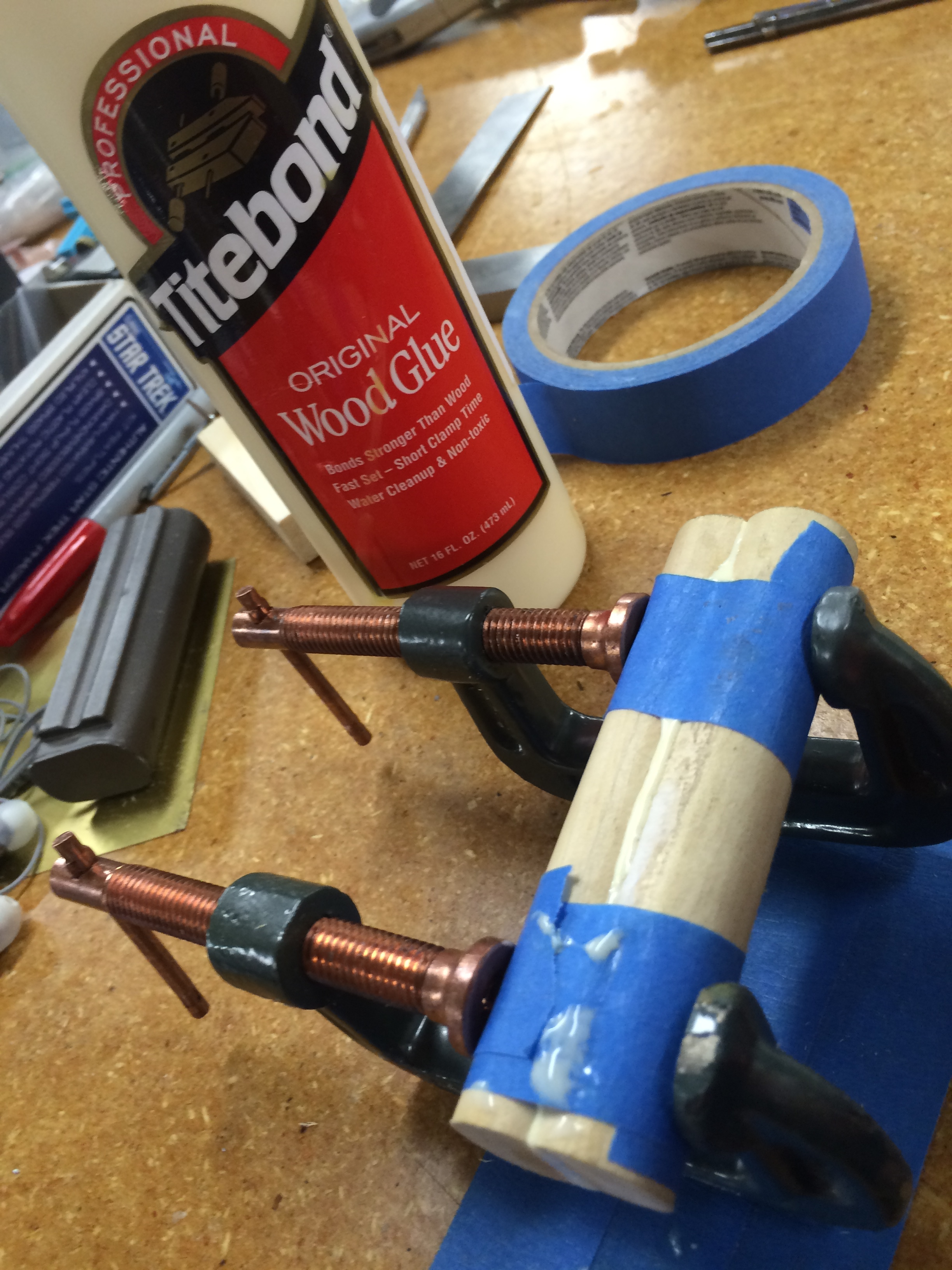

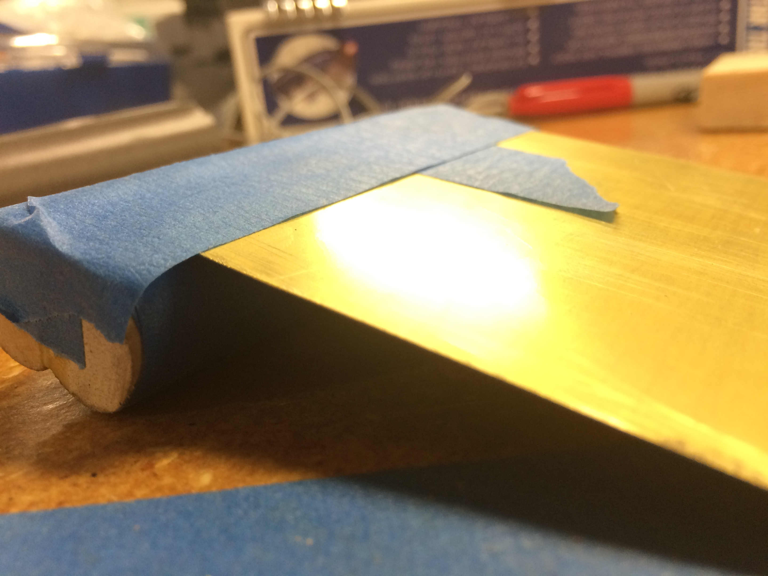

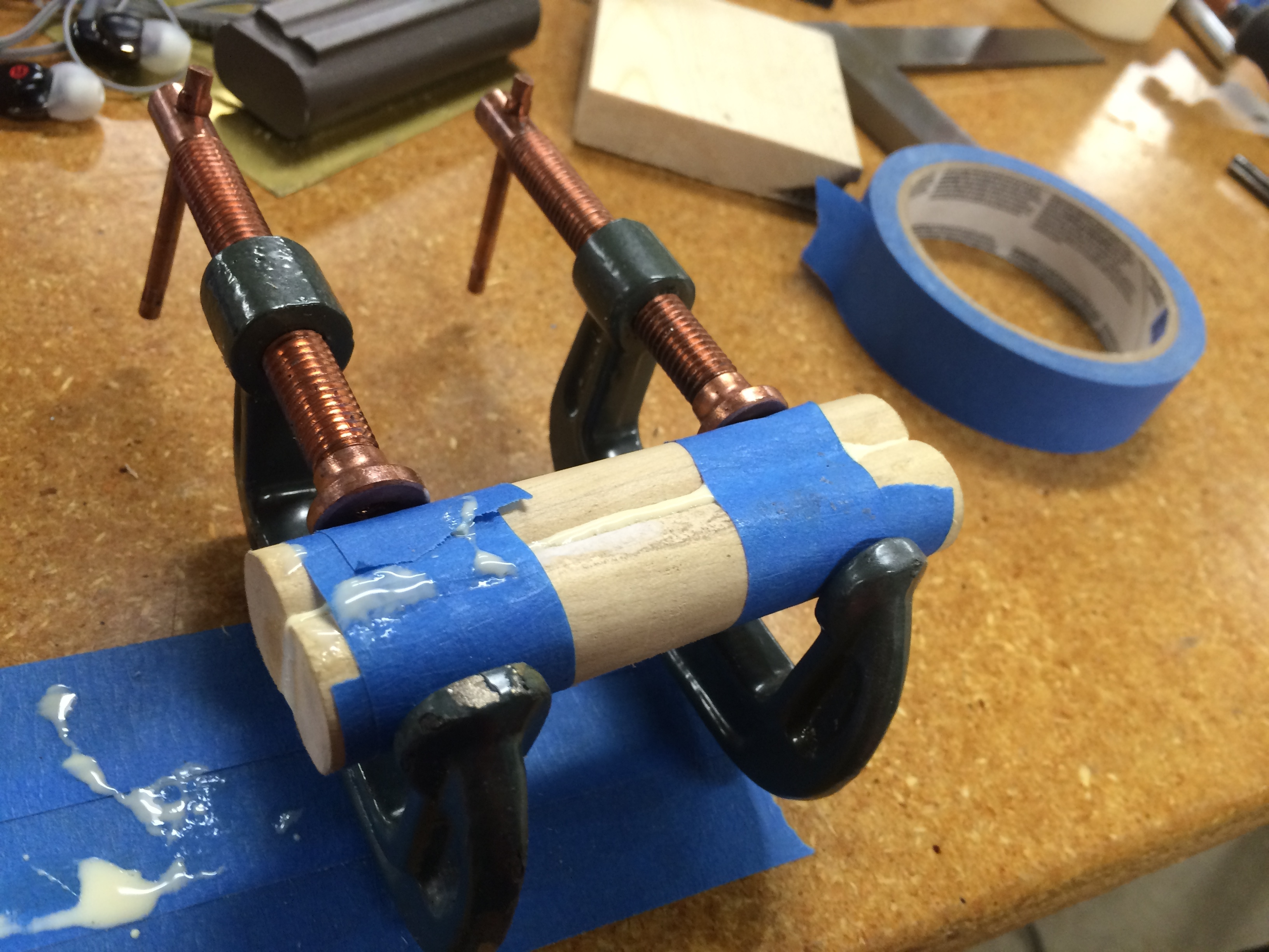

Now it's time to form the, uh, form, so we have something to bend our brass around. I don't have a photo, but I selected my dowel rods using the same super-secret stealth-decoder-ring method. Yep, took my handle to Michael's and compared dowels till one fit. I wound up with 3/4" x 36" dowel. Looks like a pretty good fit - just out to the edges of the handle, but just a wee bit smaller, which is fine because we're only bending .010" brass around it.
All I had to do was shave 1/16" off the edges on the Holy Bandsaw of Antioch, then glue them together, like so:
The glue bottle says to clamp for 30 minutes, then not stress the joint for 24 hours. But this operation will actually squeeze the joint together, and besides, I'm not waiting 24 hours. I'm middle aged and getting middle ageder by the minute. So I wrapped blue tape around the rods to hedge my bets just a little, and then I taped the brass to the center of the form to keep it from wandering during the bend. It was suggested by my metals instructor and one of his students to use a tough green tape you can get at Home Depot, and I'll definitely look into that, but I didn't have any issues with the blue stuff.

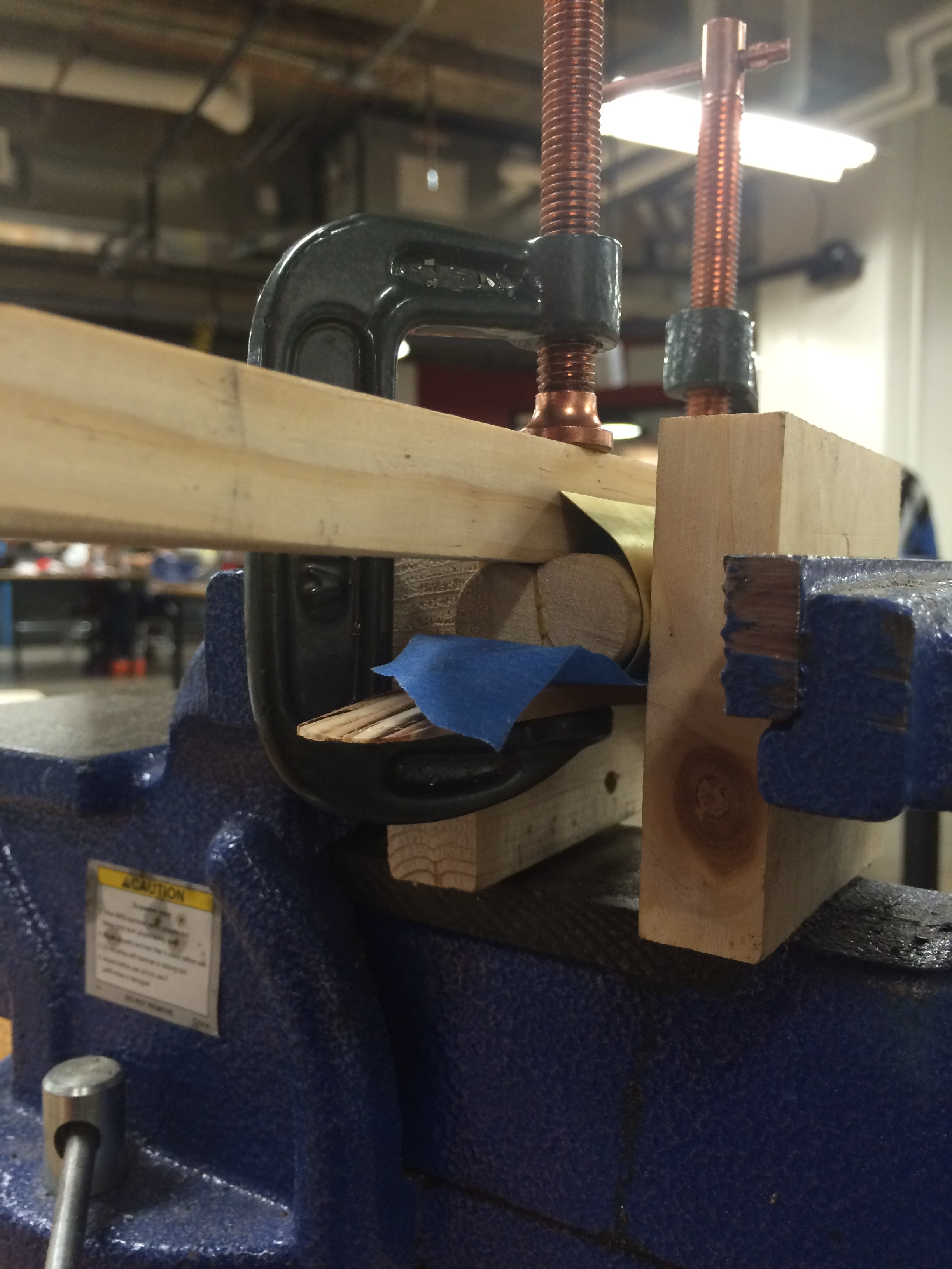

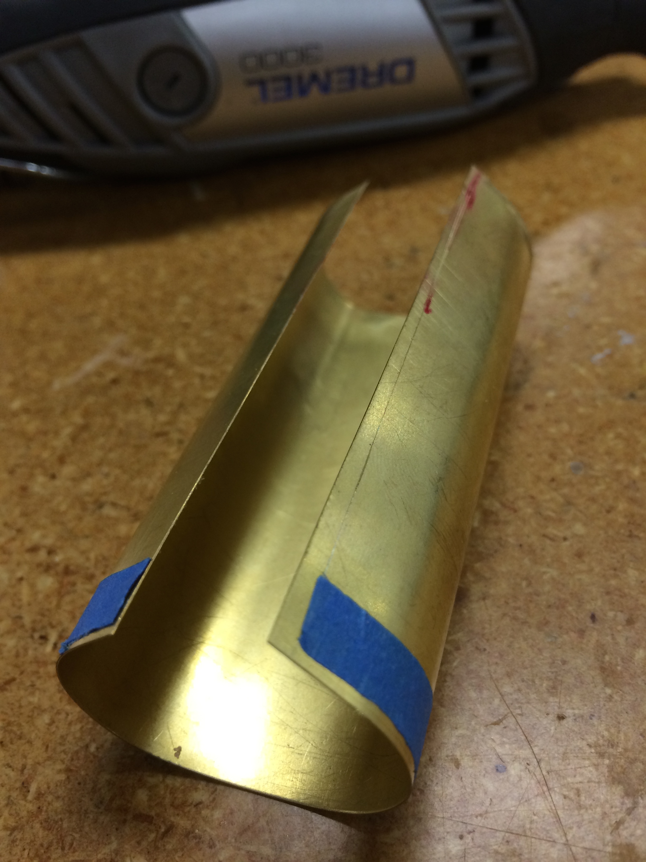

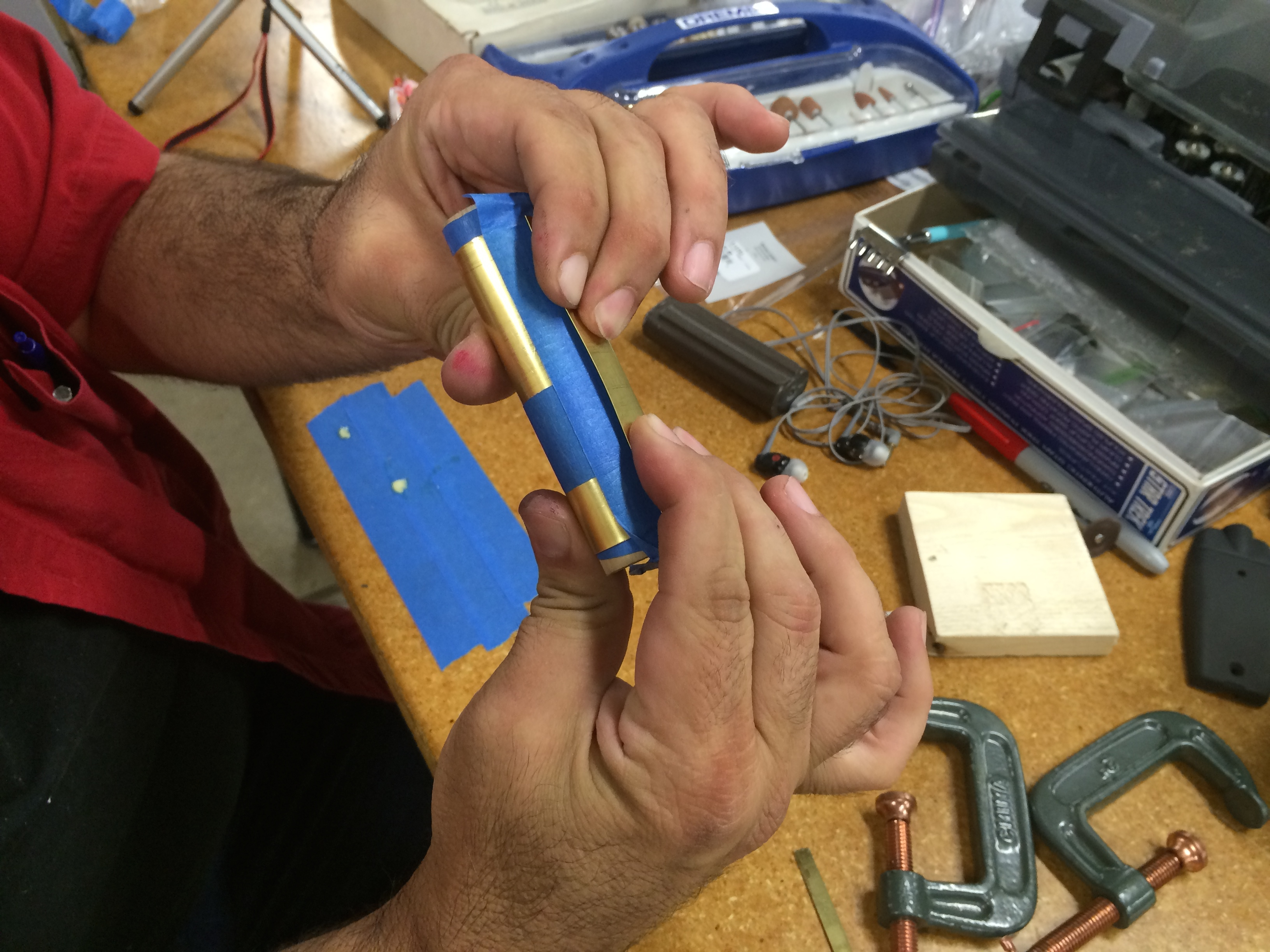

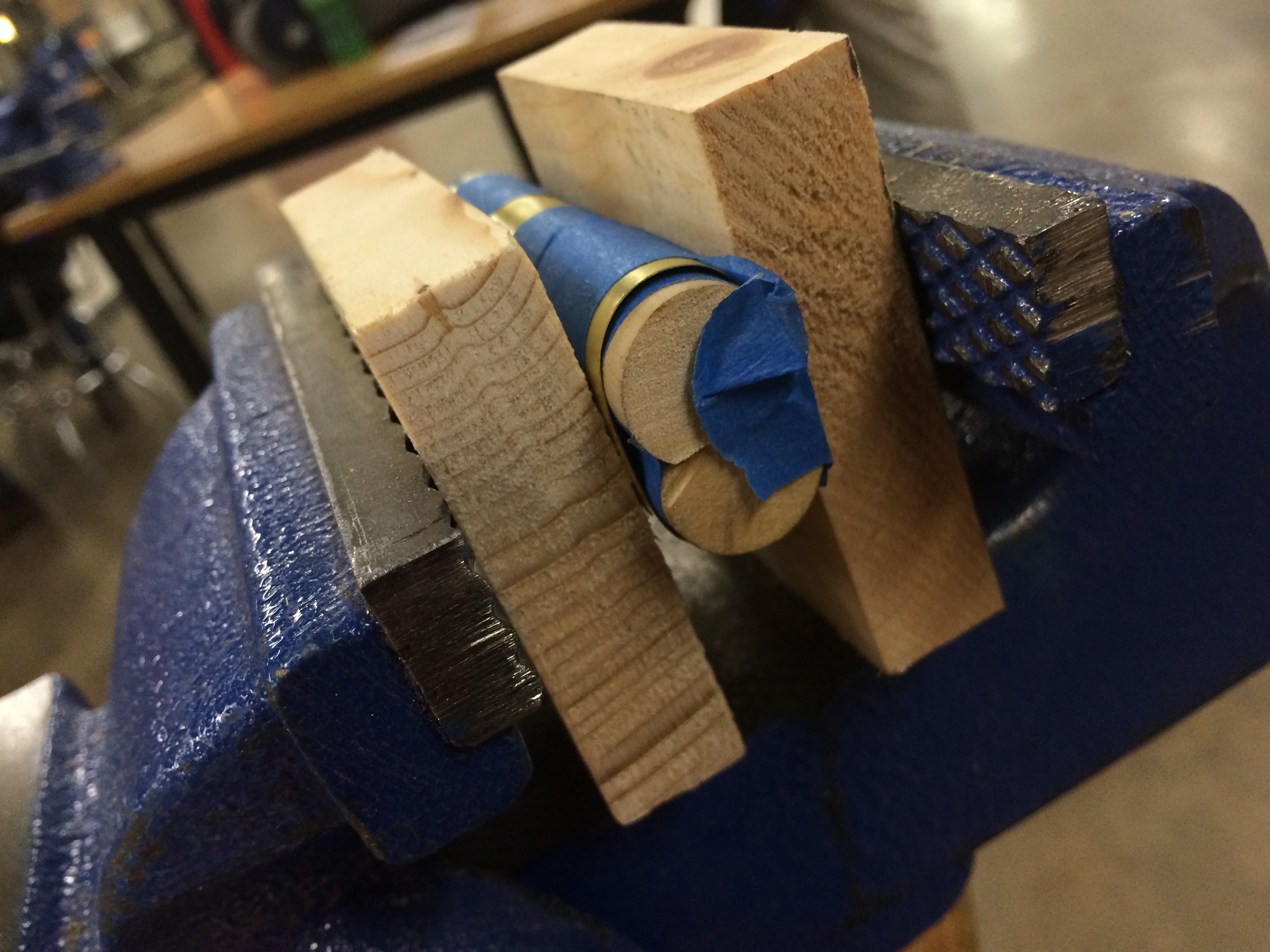

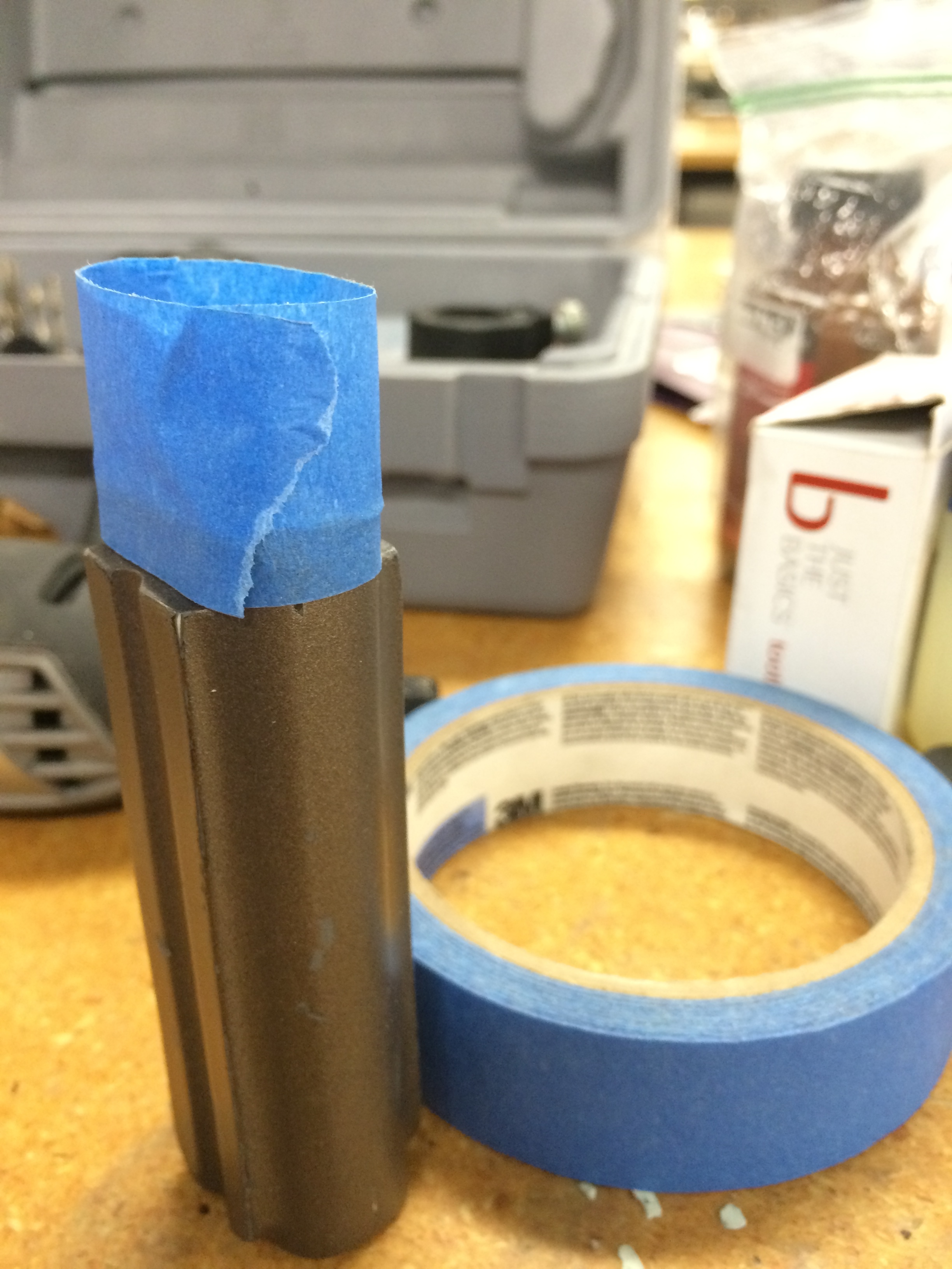

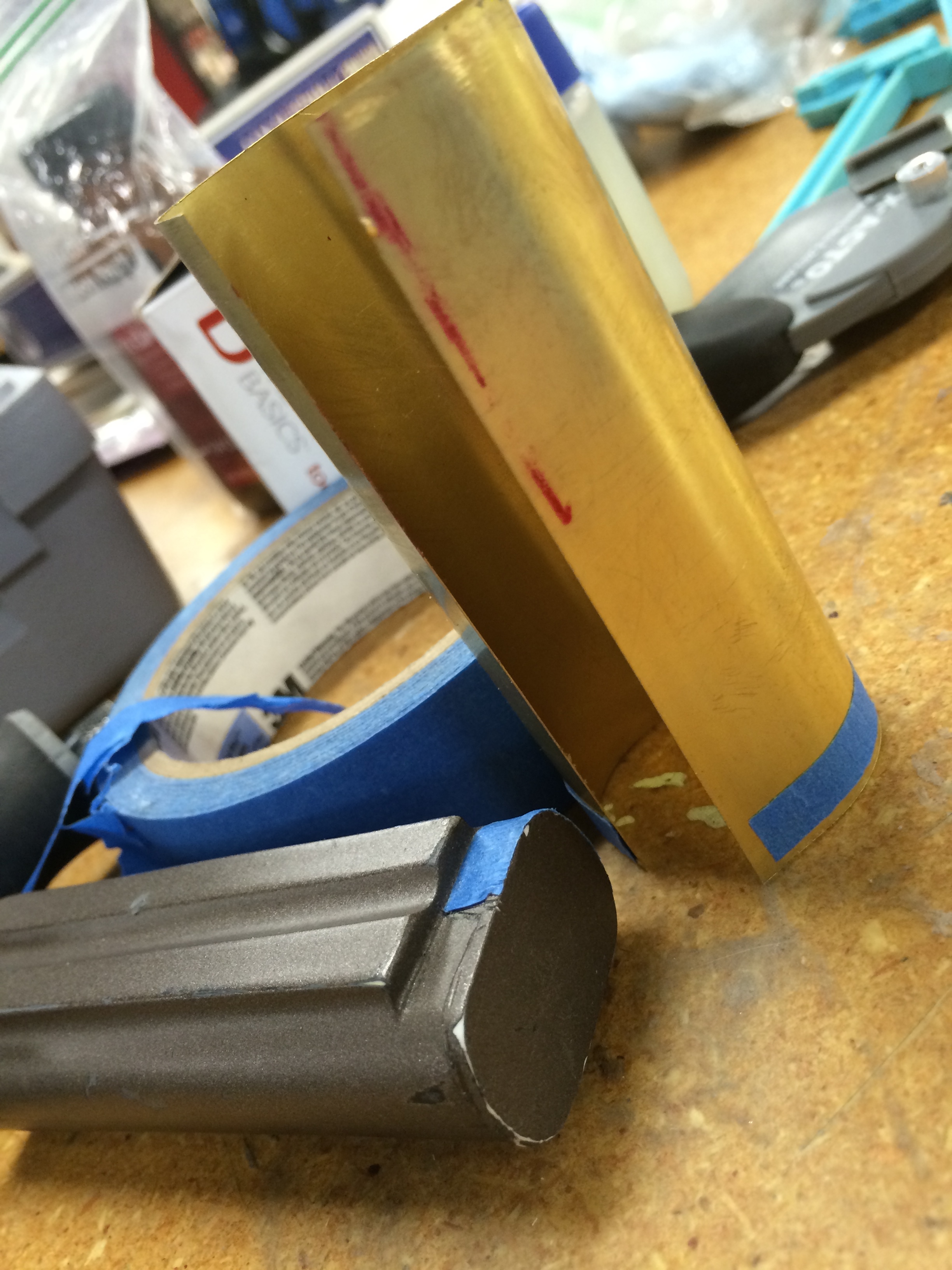

So now we bend the brass. You do it just like the little old Cuban in the cigar shop.
What?
You're NOT Cuban? Crap.
OK, first of all, **** you for not being Cuban. Seriously. There's only maybe 11 million of us, so you're not helping by being something else. :p
Anyway, roll it up like... no... that only works if you remember the 80s... um... AHA! Like a newspaper you're going to swat a fly with. Nice and tight, because that fly is really pissing you off and you want him to know it. Just a minute to roll it full of your holy wrath, and 157 misses before you give up and get the spray.
You have to do it in one continuous effort, keep the wood form pressed hard against the table, and roll. Then clamp the unholy crap out of it.
It'll need to stay like this for as long as possible, but as always I have lots to work on while I wait for a process. Sitting and waiting is very annoying, and I like to keep moving when I'm in the shop. In the industry, whether you're in a shop or on set, sitting around and waiting is only permissible when there is literally nothing for you to do. And if you're a PA, you'd better make you some worky-worky riki-tik, lest the AD spear you and mount you in his butterfly collection. So I got conditioned to work hard, fast, and smart at an early age.
See that edge sticking up? That's the 1/4" of extra slop laughing at me. And after all I've done for it. *******.

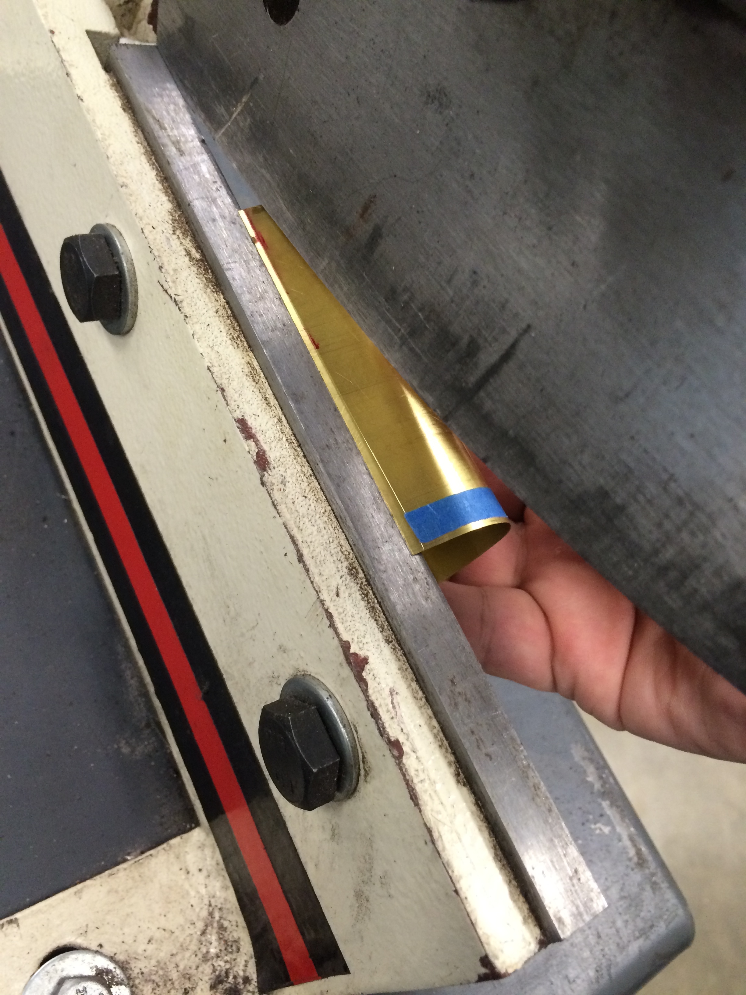

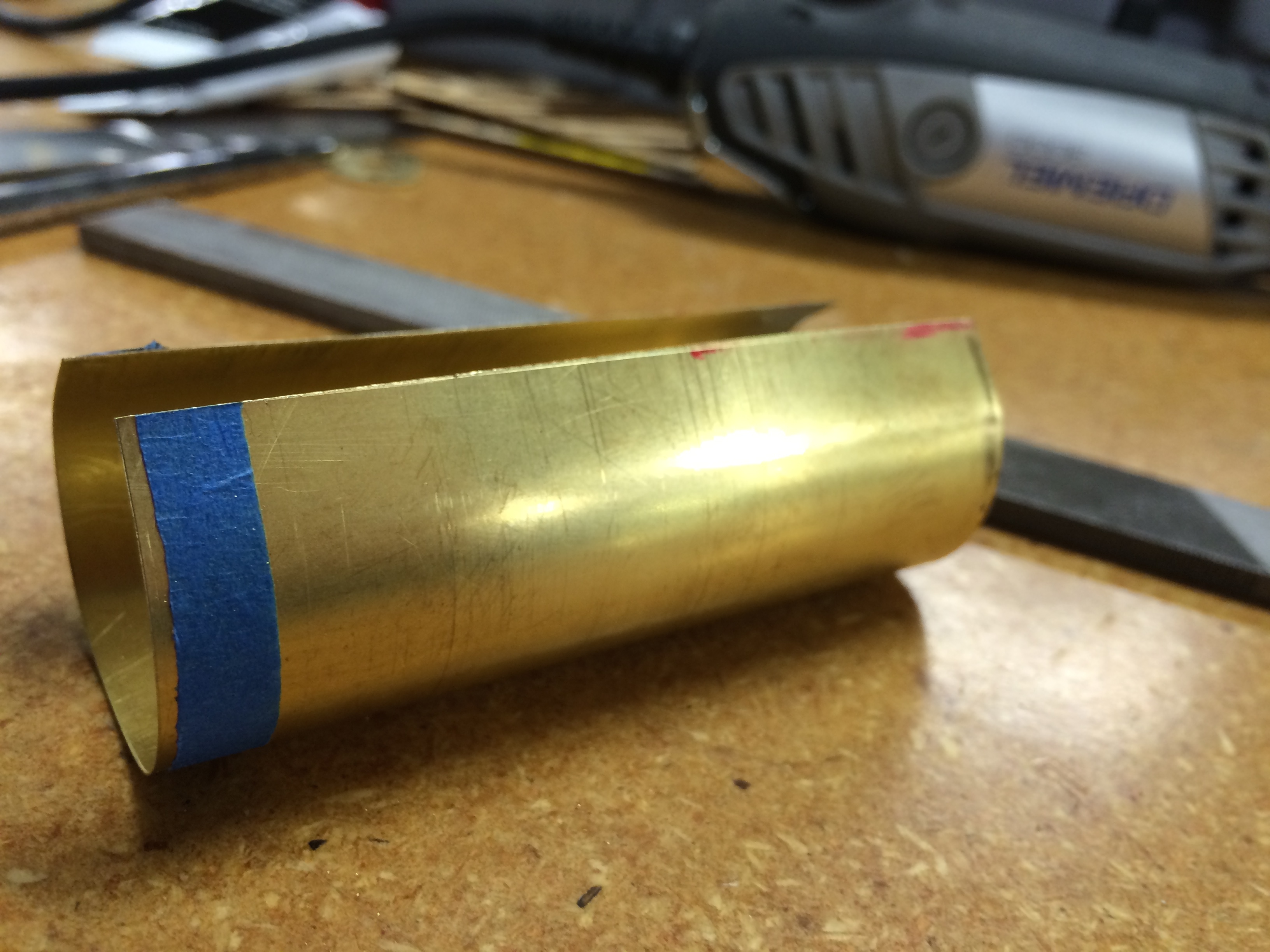

I trimmed some of that off with a bench metal shear (DO NOT use tin snips for this -- you have been warned!!), and I may be able to trim it all the way down, in which case I'll still use this piece - apart from the slop, it came out great.
The other issue is, even though it's only 0.010" thick (and MUCH easier to bend than even 0.015, trust me), I may want to anneal it. If I mess that up (I've never annealed anything this size before), I'm going to have to start over.
Here's a video on annealing. Brass is very, very springy. Springier than spring steel, and that even has the word "spring" right in the name. So when you want to bend it, it fights back. If you're curling it around a form, it fights back even worse. So you grab a blowtorch and heat it till it glows red, then let it cool. After it cools, it no longer fights back. You've broken its spirit, trashed its vinyl record collection, and told it several abusive yo mama jokes. Hence, no fight left. It stays where you bend it.
Of course, it's weaker now, so you have to be more careful, and I don't know yet if annealing it may affect its strength as a handle. Or, it could be the original was annealed, and that's why the handle on GJ's phaser has so many dents. Plus, the cylindrical shape, the popsicle sticks, the end plug, and the Hubbel connector at the top may be all the reinforcement it needs. We'll see. When I anneal it, I'll definitely shoot pictures and probably video. No sense only one of us learning if this goes t!ts-up on me. :p
So now we're onto the end plate. Not 100% thrilled with the ultimate result here, but most of the method is solid and most mistakes are worth sharing...
I started with the phaser 1 screw (the one that holds the door in place) since from the photos, it looks about the right diameter and it's also a flathead. And the eyeball test results are very good.
So that's what I'll use to gauge my progress. Now, I have to find the right bit to start the pilot hole for it. Something very tiny....

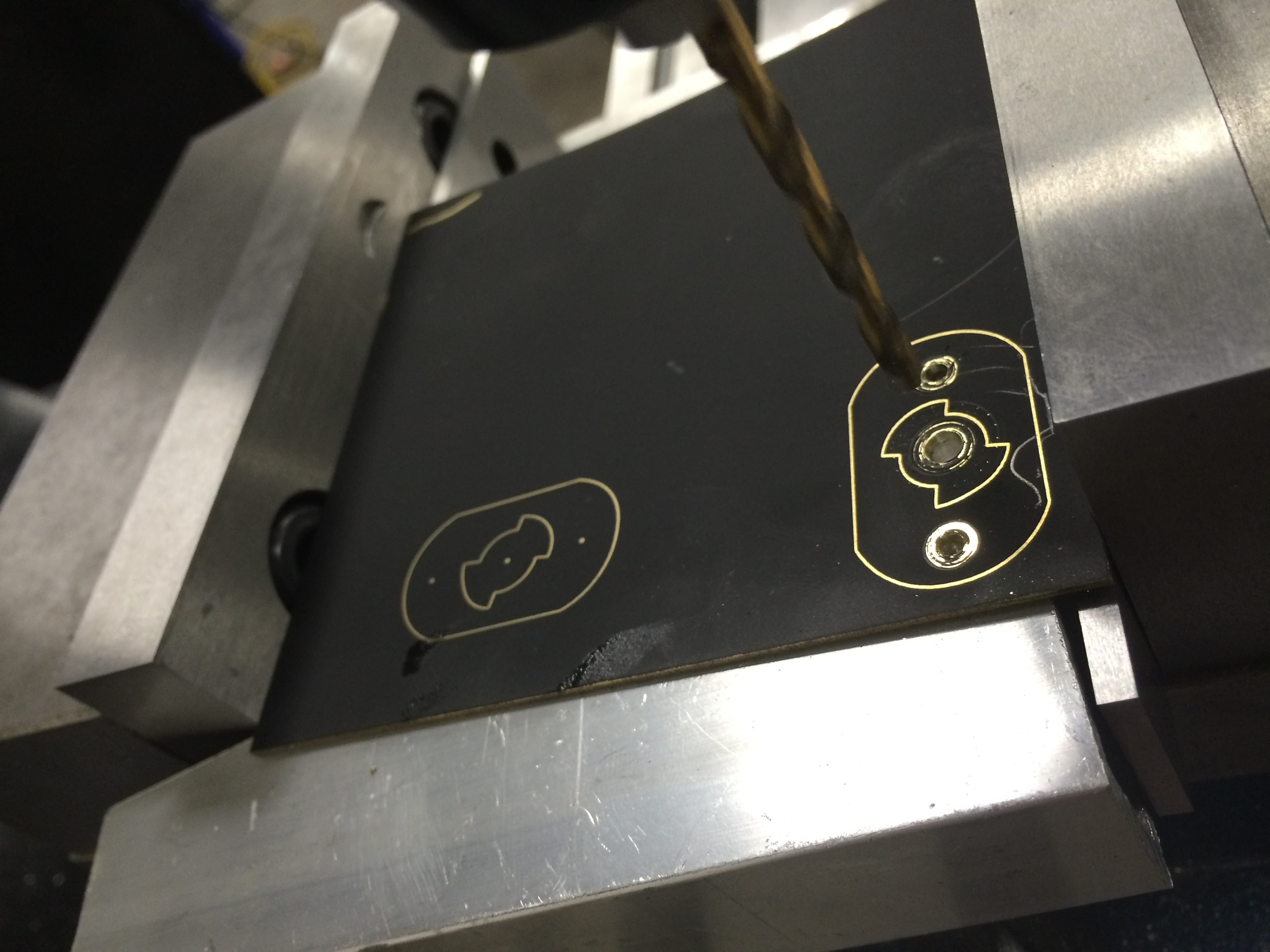

Took me like 30 minutes to find the drill bits. They were in the machine cabinet, right where they were supposed to be, laughing at me. Come to think of it, there was a lot of laughing at me last night. I probably shouldn't have told anyone I was wearing a thong...

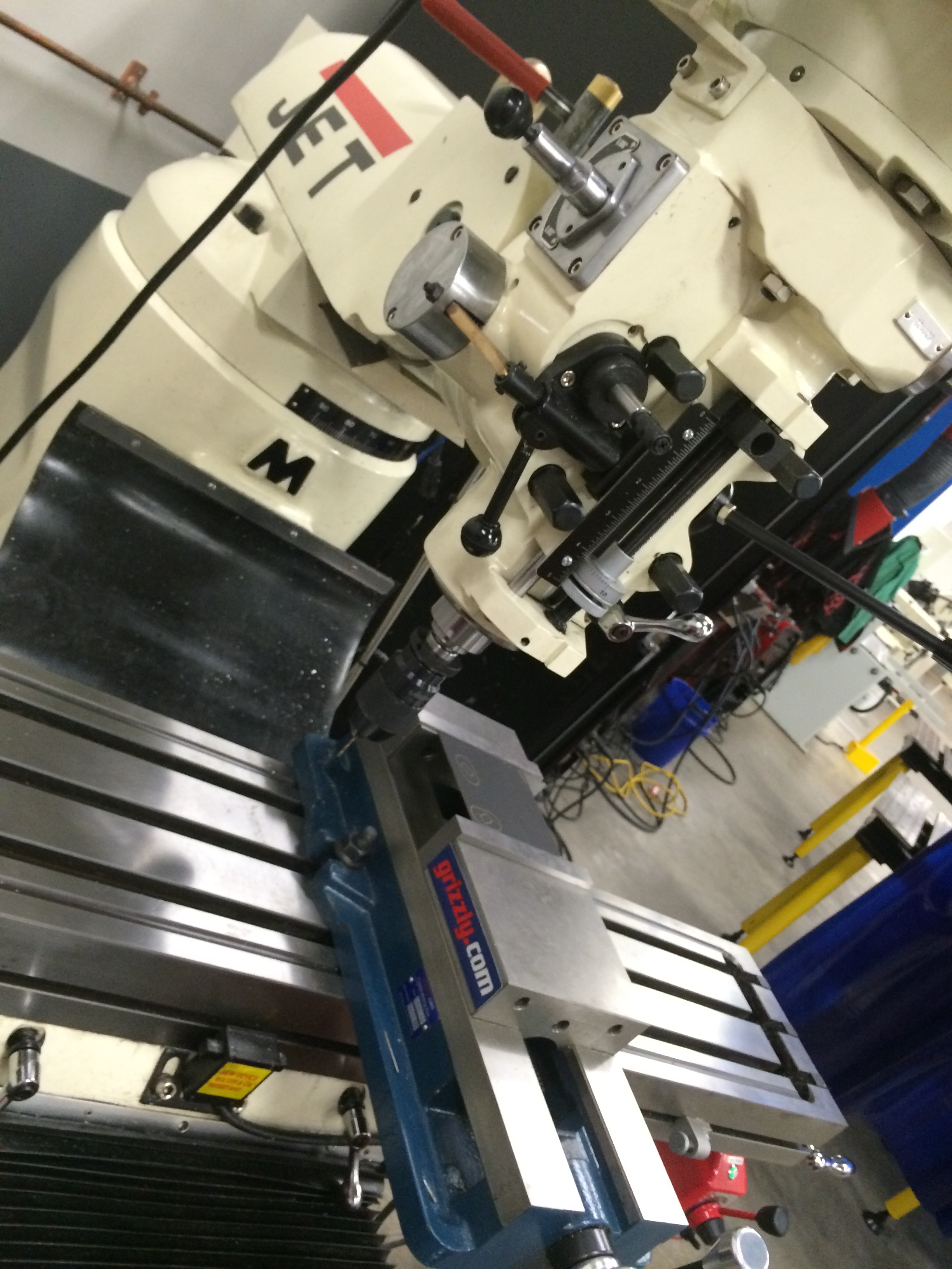

Anyway, I may be doing something wrong, but the drill presses at the shop vibrate like a SCUD missile with diarrhea.
So I use the knee mill for drilling as well as milling.
It's orders of magnitude more precise, which is important because things like off-center holes really jump out at you. Usually not critical for camera, but obvious to the eye. Plus, I want a lot more time on the milling machine than on the drill press. It's more useful, more versatile, easier to use, and easier to set up your work-holding, plus I get a real Tim Allen rush when I use it. :)
Without one, get a decent bench drill press (but check it out before you buy it), or a milling head for your lathe, or a Dremel press, or you can make your own drill press for cheap.
On with the show:
I drilled out the holes with a sacrificial piece of aluminum scrap underneath to avoid bending the brass, starting with a tiny screw and working my way up to the proper diameter. The great thing about a milling machine is the precision table movement. If you need a perfectly straight row of holes, you're in business. Just turn one crank, and you move in a straight line on only one axis. And for R-L movement, it has a variable speed auto-feed, which makes milling straight lines a breeze.
And this is where Fonzie jumps the shark. After this, I was very tired (the hour, as Dylan and Hendrix say, was getting late), and that's when you start screwing up. Don't work tired. You get stupid, and it's actually dangerous around heavy machinery. I won't even look at the lathe if I'm not fresh. And don't try to rush. There is no rush in a machine shop, ever.
So back to me making a sow's ear out of a silk purse:

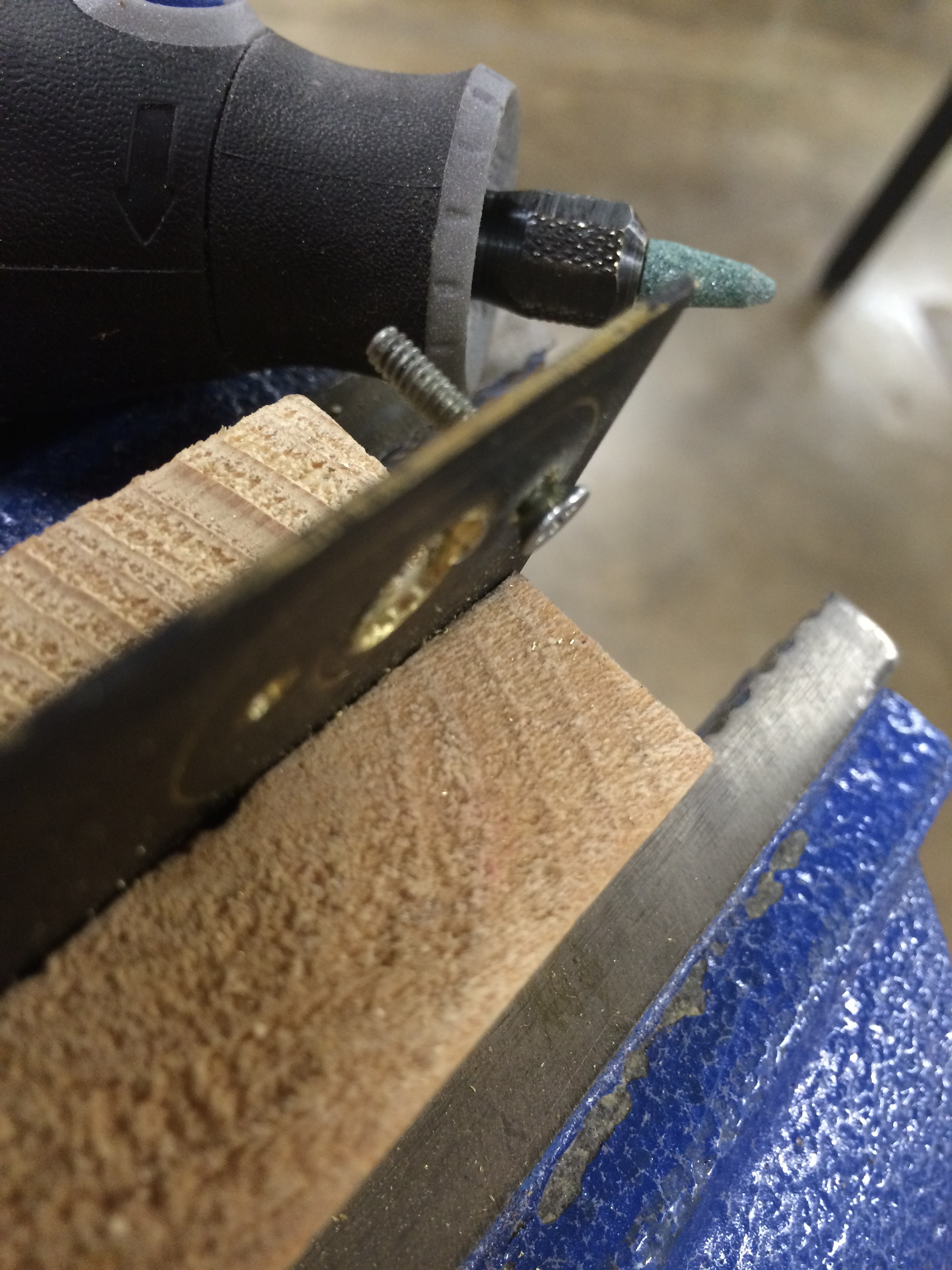

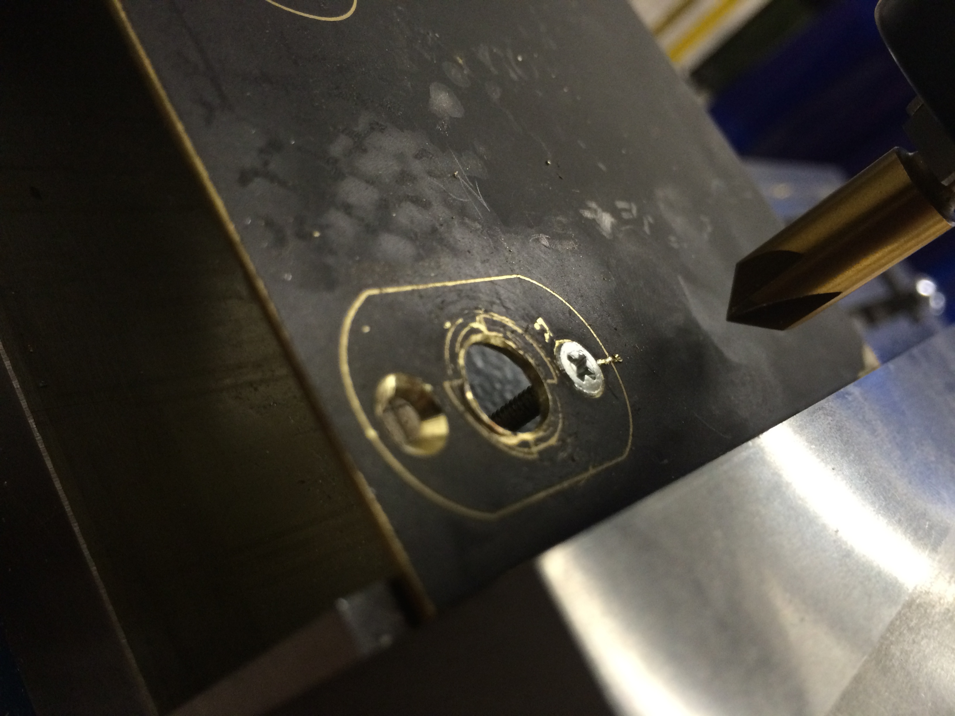

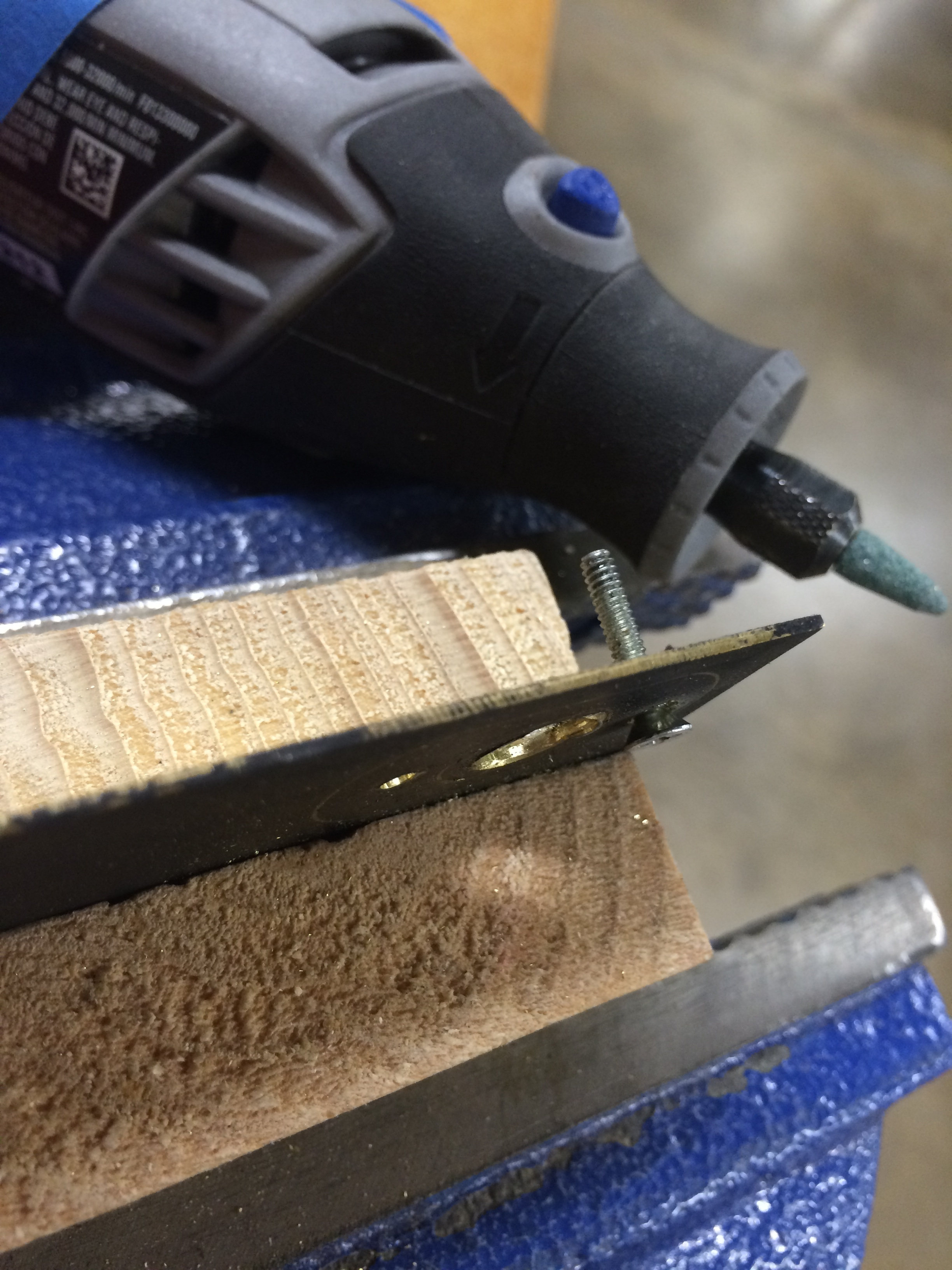

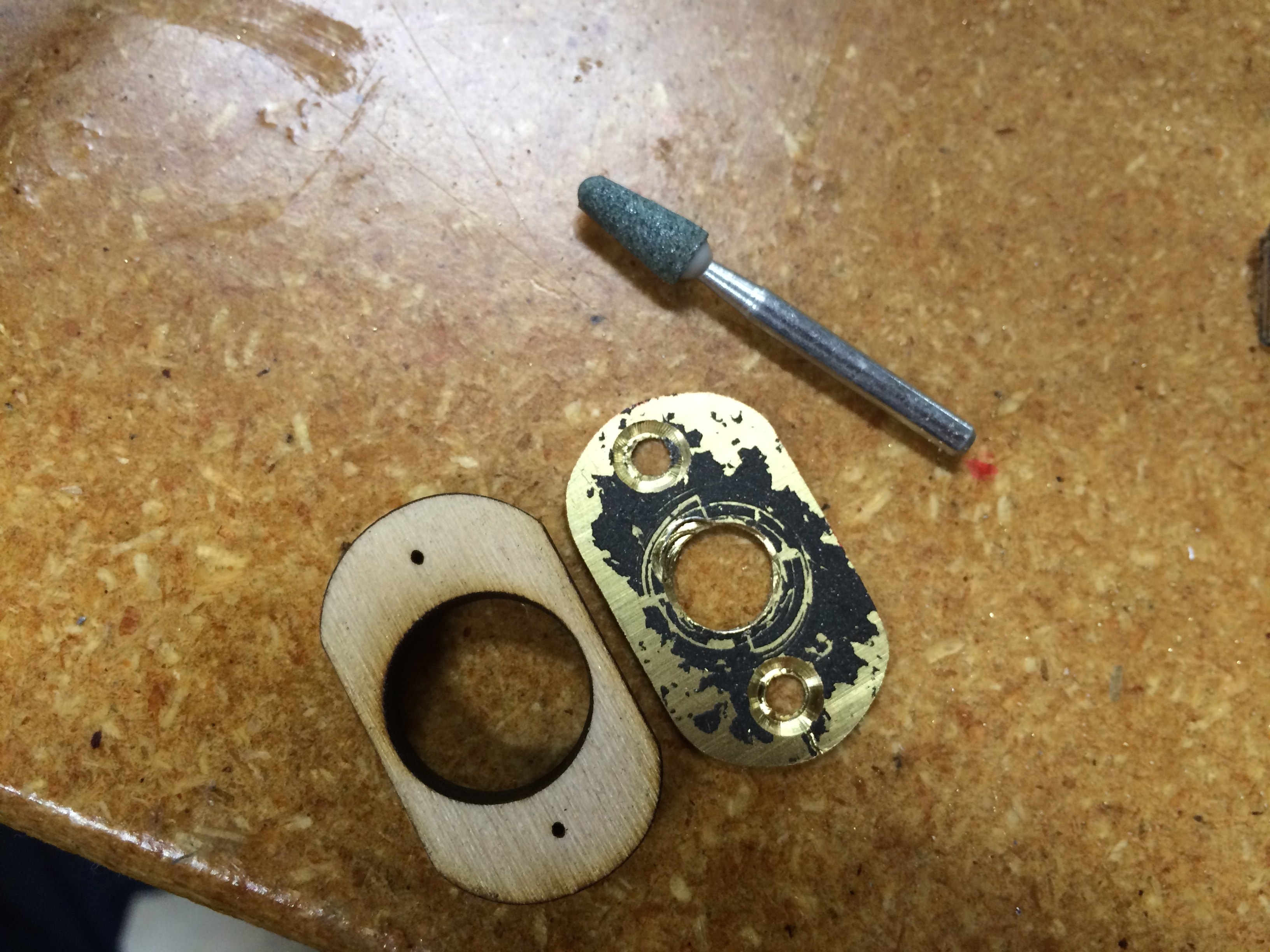

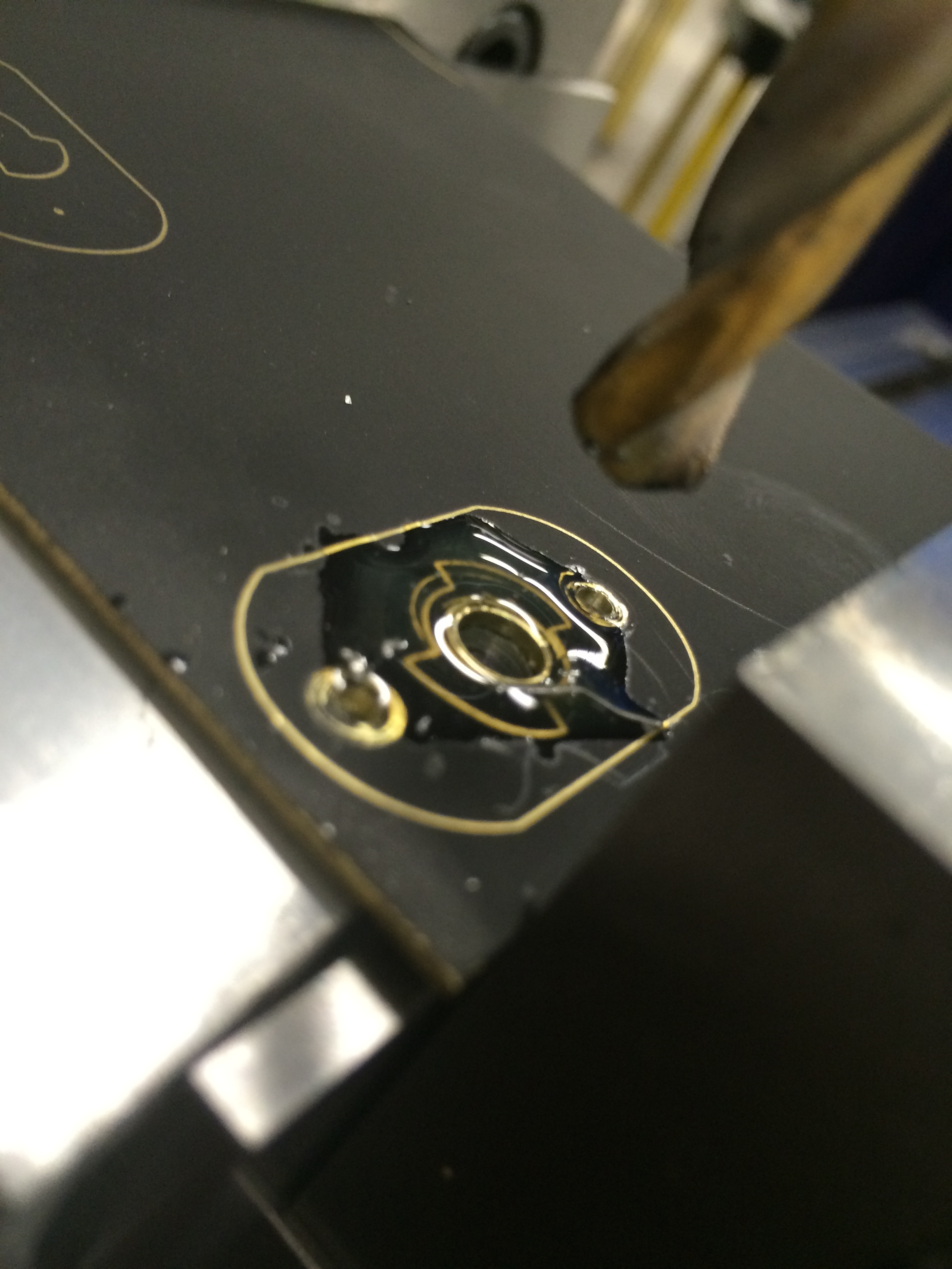

I figured I'd just do the countersink for the screws and the butterfly-shaped cutout with my Dremel, either grinder or burr bits. I see you shaking your head. I was tired, ok?
Made a mess, ruined a couple of grinder bits, and it turns out burr bits REALLY chatter and mess up your work when you use them on metal, and I never got close to completely countersinking the screw. Don't think I can't hear you chuckle. I'm onto you, buddy.

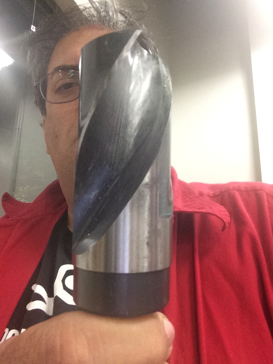

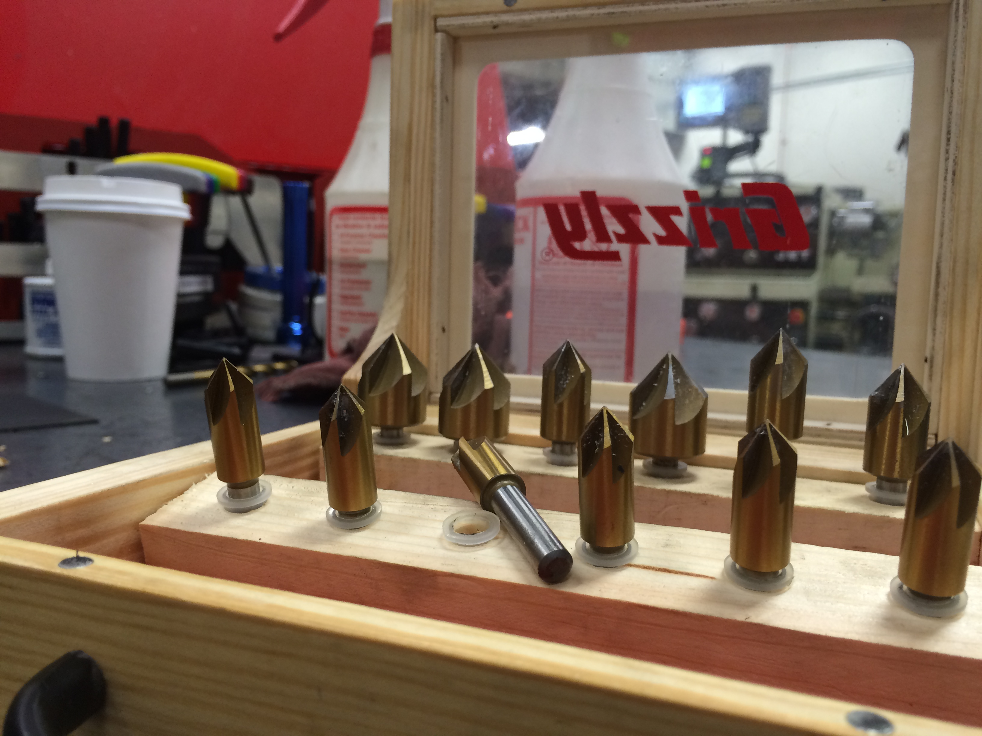

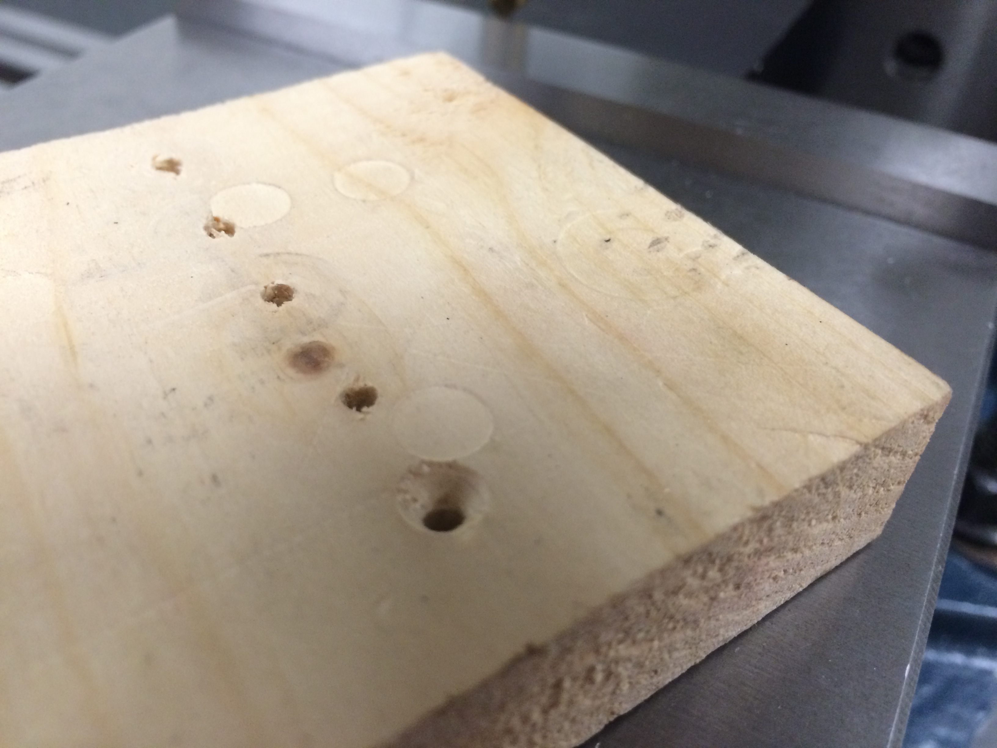

So that was about the time I remembered we had countersinks in the machine shop. Like I said, tired.
You don't need them as heavy-duty as these if you're not a machinist, but they certainly do the job. You can probably get pretty good ones at Home Depot or Lowe's.
To find the right countersink for your screw, just drill a line of holes in a block of scrap wood big enough for the screw, then try different countersinks till you find the right one by making the countersink and dropping in your screw. I lucked out on the first try.
Way more better! Nice, smooth countersinks, perfectly centered... to each other... more on that wee problem later.

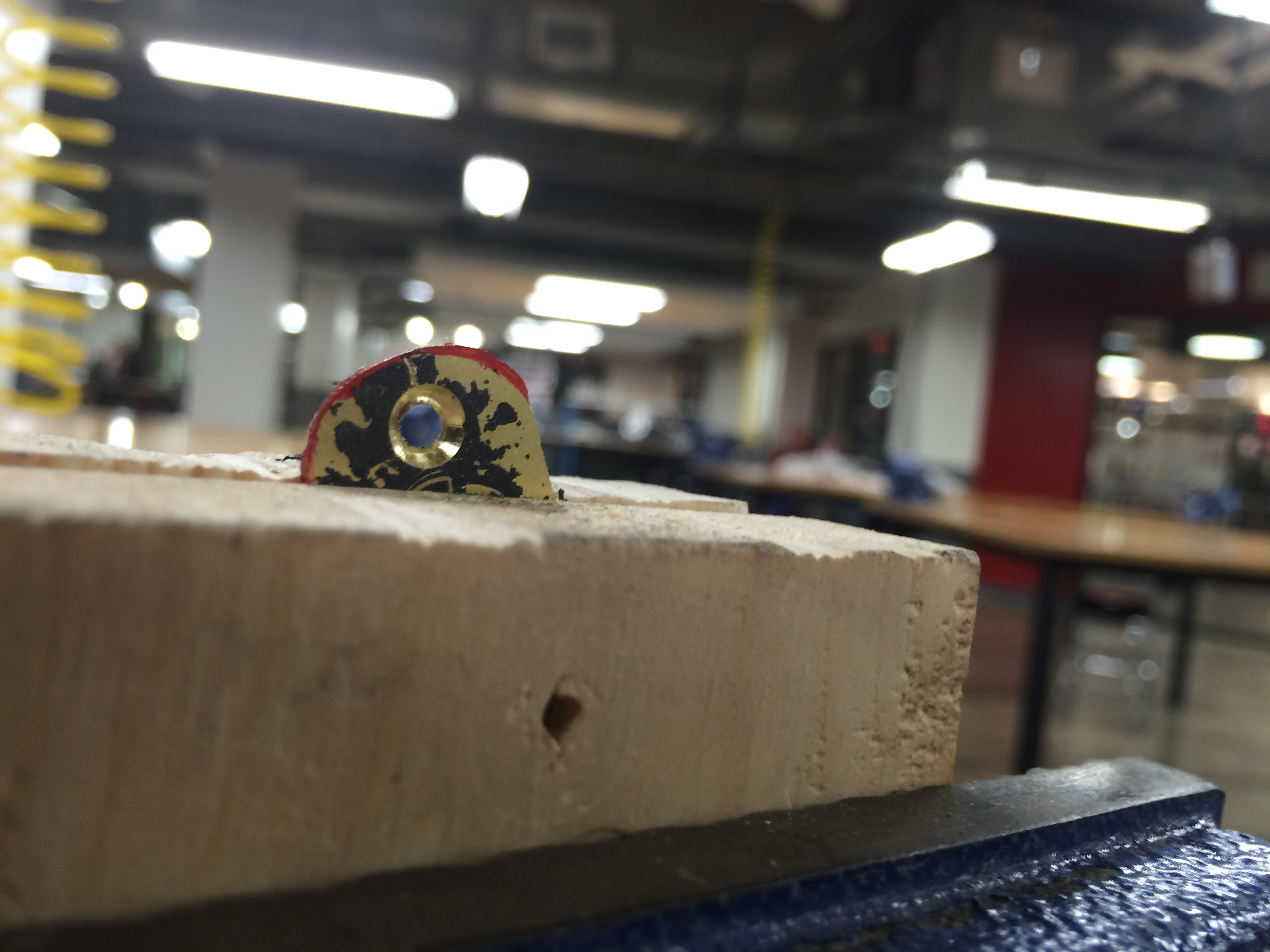

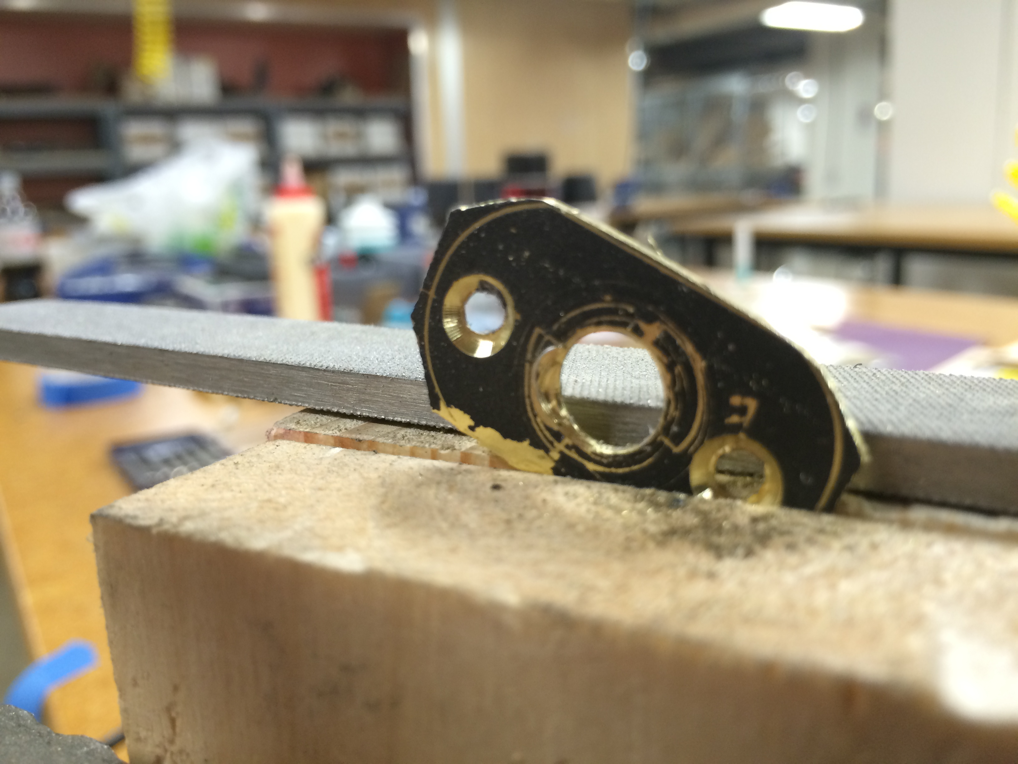

Now that the holes are cut and there's only final shaping left, I roughed out the cut on the metal bandsaw. The blade worked much better on the thicker brass, but I didn't take any chances with the curves. I wanted to file those.
You'll notice the paint is all scratched off after the bandsaw. I certainly did. :)

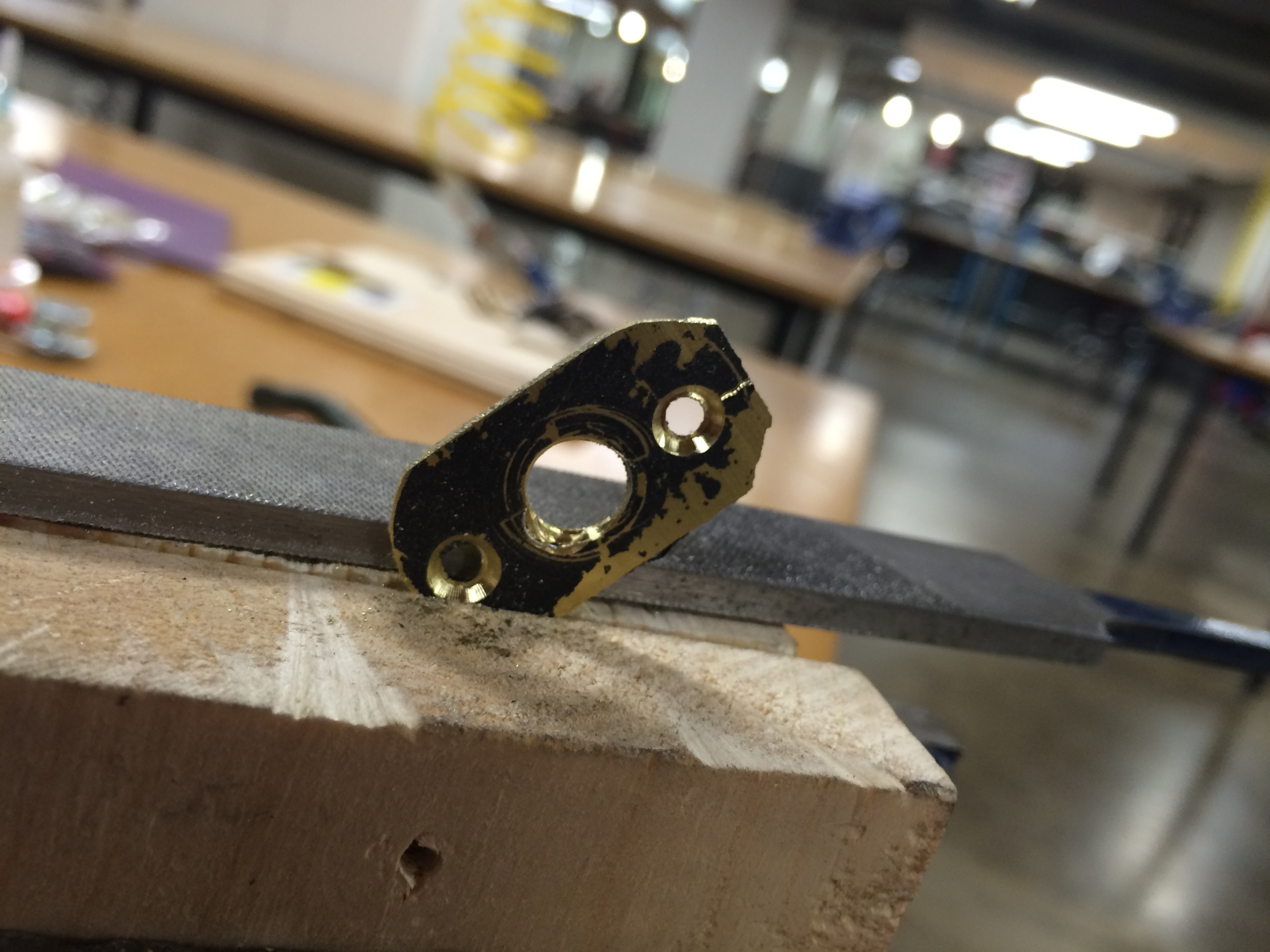

Again, file only in one direction away from the handle and away from yourself. With patience, you'll pick it up in no time.
I put it against the MM handle, and traced around it with a red Sharpie. Just file away the red part.
And for the straight sides, use a square against only ONE of the wood blocks to get the piece perpendicular to that block. If you rest it on both blocks, you'll probably be out of square. You can square up your file against that same block of wood. Use gentle, deliberate strokes, lightly pressing the file against the work piece, not down onto the wood. Otherwise you'll file into the wood and go out of square again.

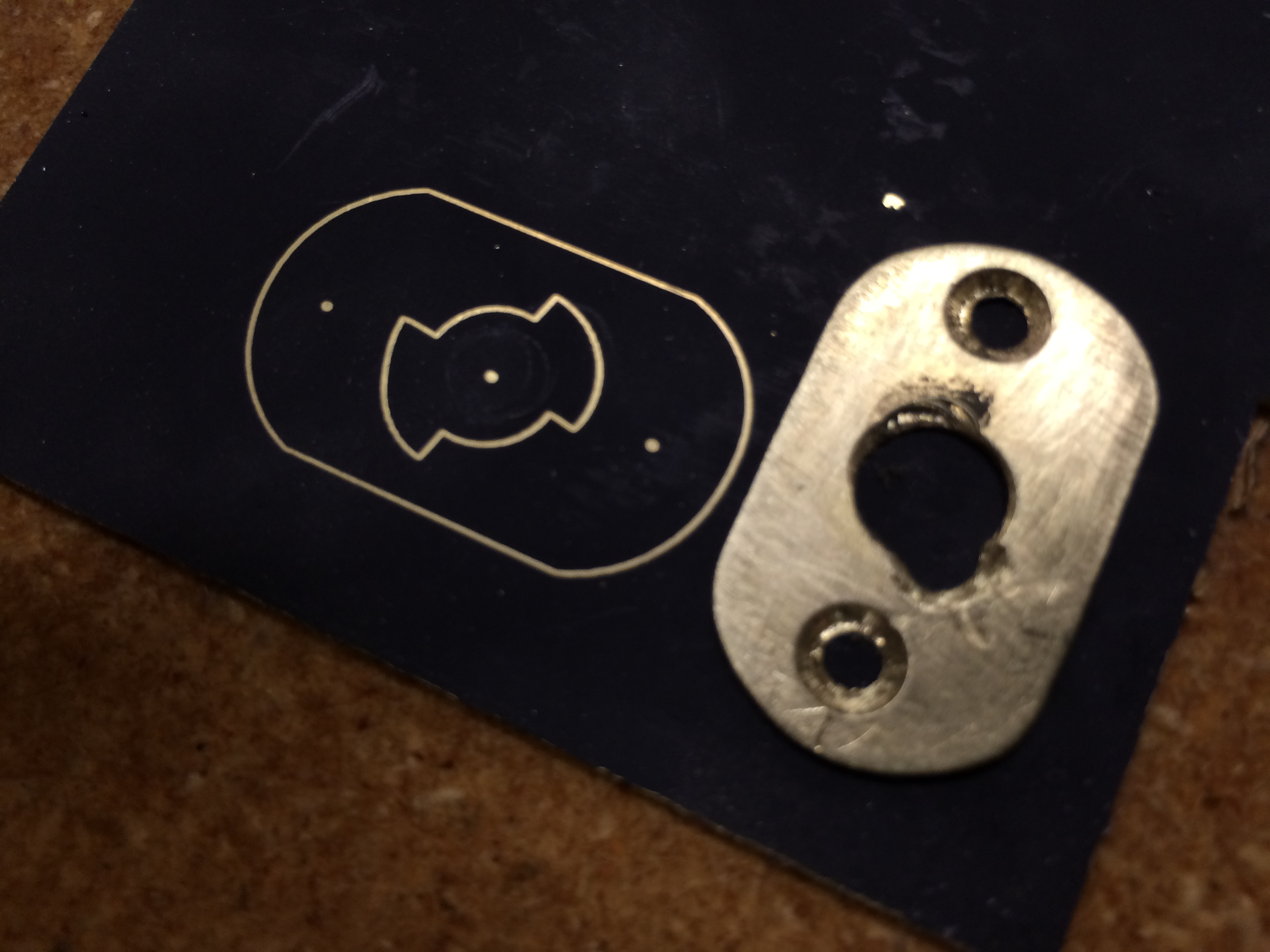

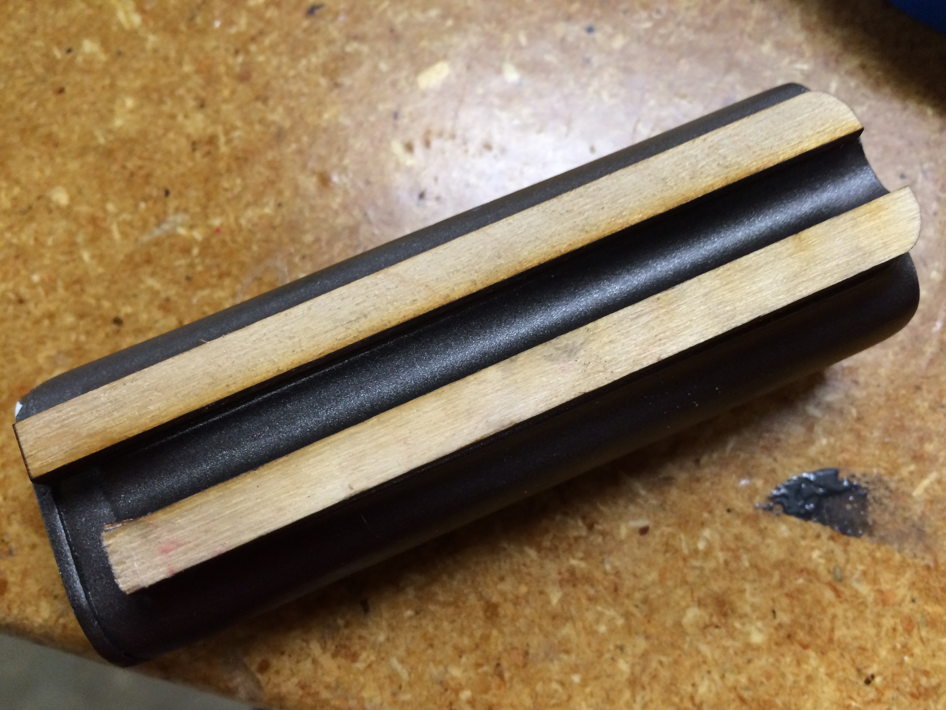

OK, time to wrap up last session's work.
The outside filing came out really nice, and the trick with the red Sharpie gave me a perfect match to the butt plug (that's what I call it - get over it. I coined "crapazoid," so I get to say "butt plug"). :p
I'm pretty sure John taught me the Sharpie trick for filing, but it was a very long time ago and for a few minutes yesterday I thought Nixon was still president, so who knows? :p
Just a hair over on the other side, but I can take that down no problem.

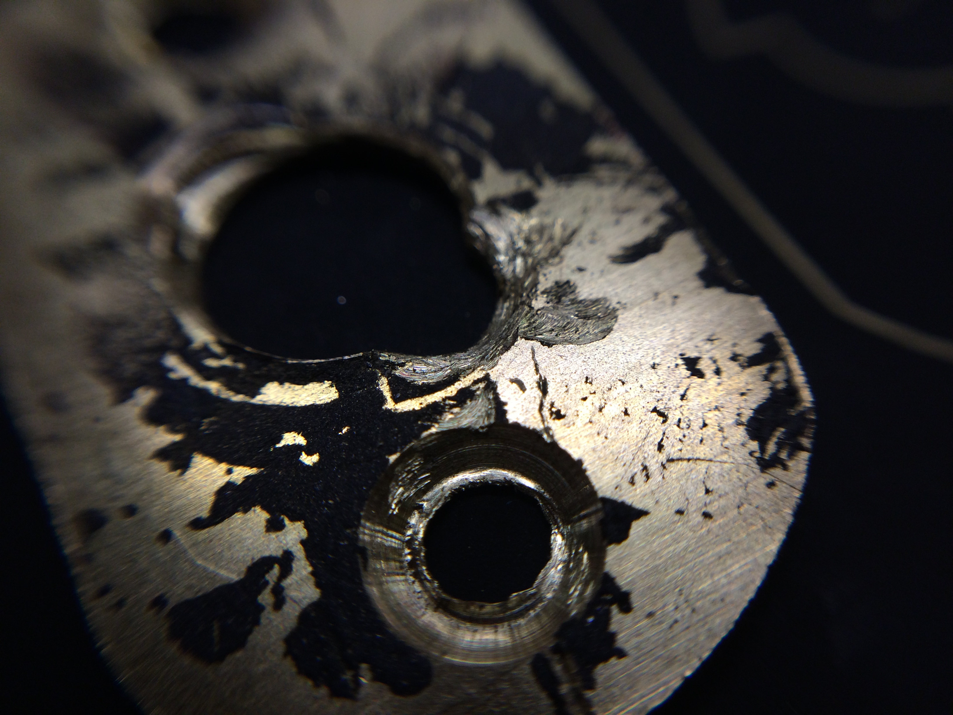

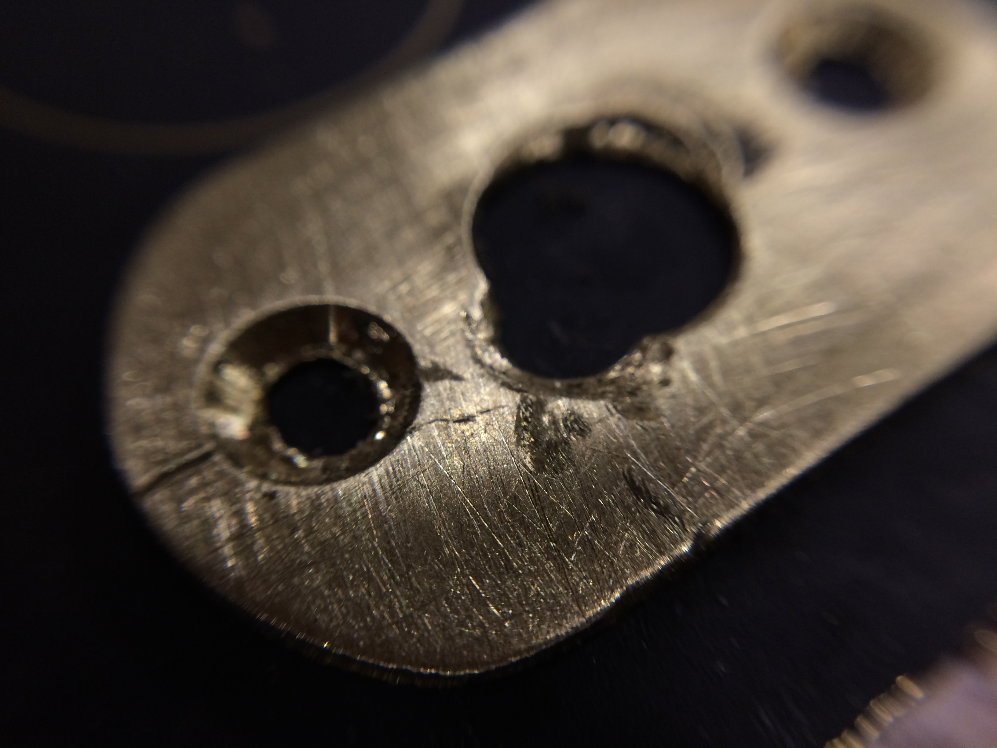

This, however, = problem.
The damage near the butterfly cutout (because "butterfly hole" sounds too much like insect prison porn) is from a wandering grinder bit, and the straight groove you can see on the left in the center picture is from moving the mill table to the side without first dropping the workpiece away from the countersink bit, thus dragging it across my work.
D'OH! Blah, blah, tired, blah.
Finally, and I'm not sure you can tell in the photos, but the countersinks are not centered on the drilled holes. That happened because I took my workpiece off the mill after drilling, and came back later to countersink it, and I didn't properly align my work to its previous position. Two ways to avoid that next time: 1) use the digital readout on the mill to precisely mark the position of the brass plate before removing it, and 2) don't remove the workpiece in the first place, because all that Dremel stuff was a waste of time anyway. If the workpiece never moves in its vise, changing bits and end mills and whatever is not an issue.

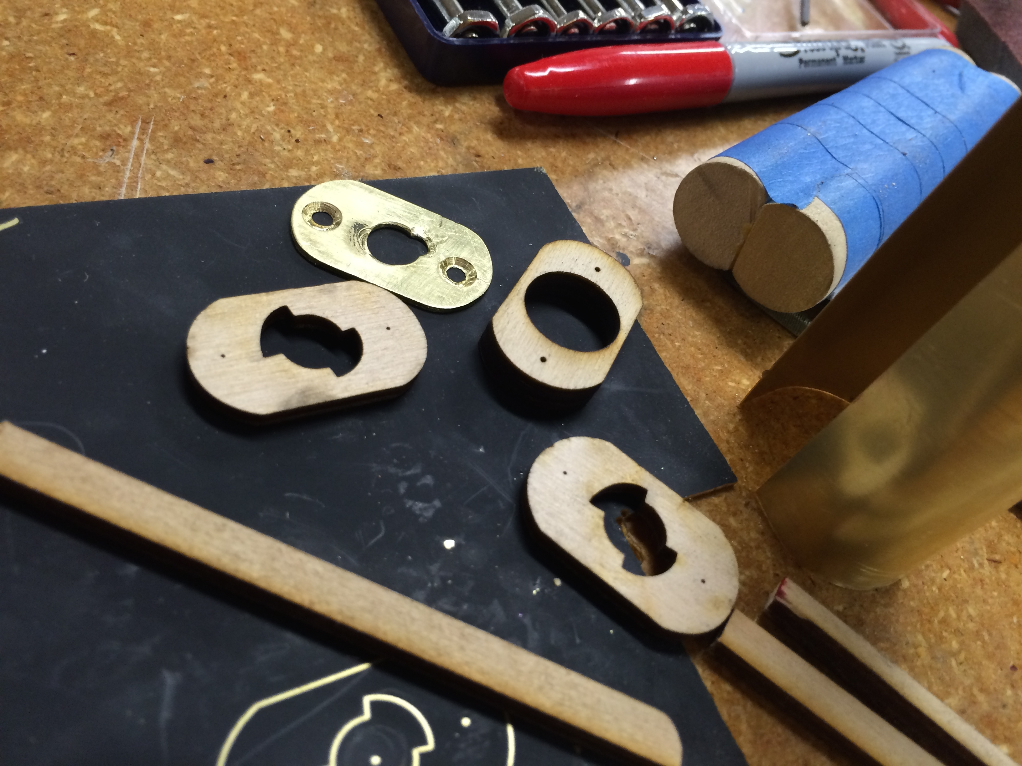

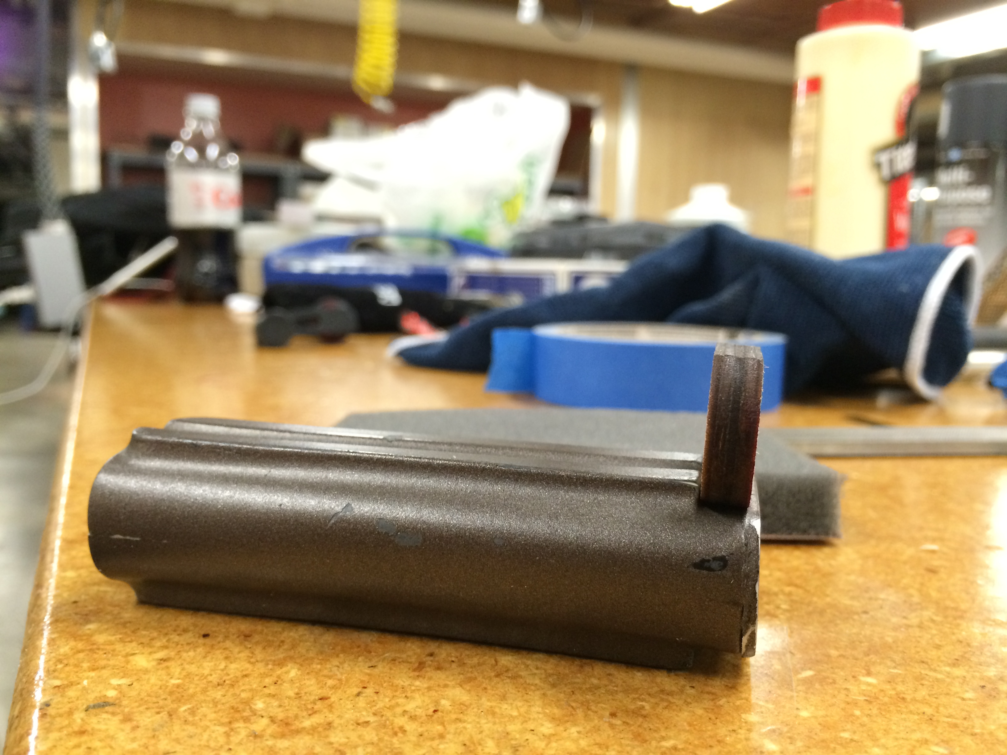

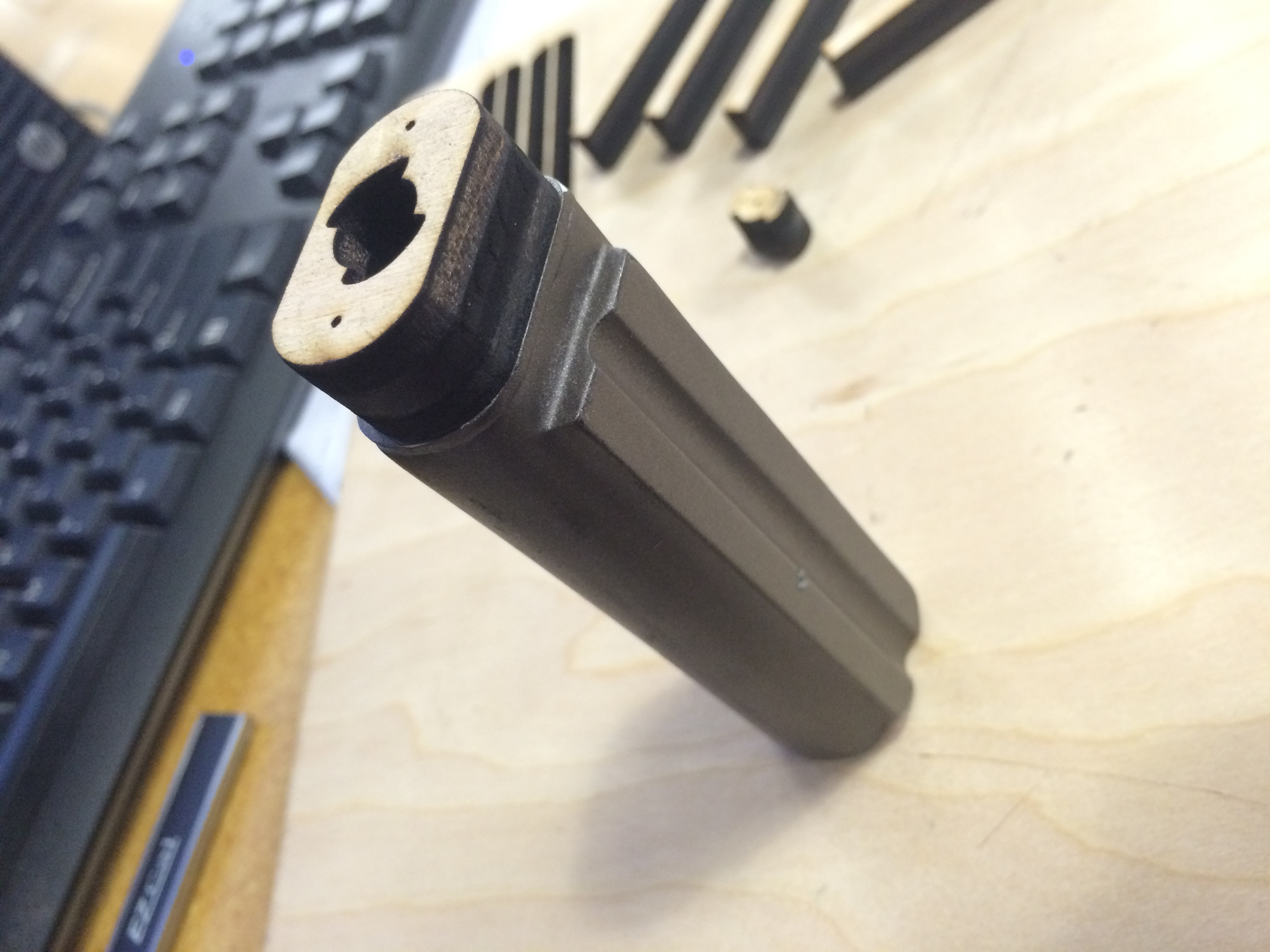

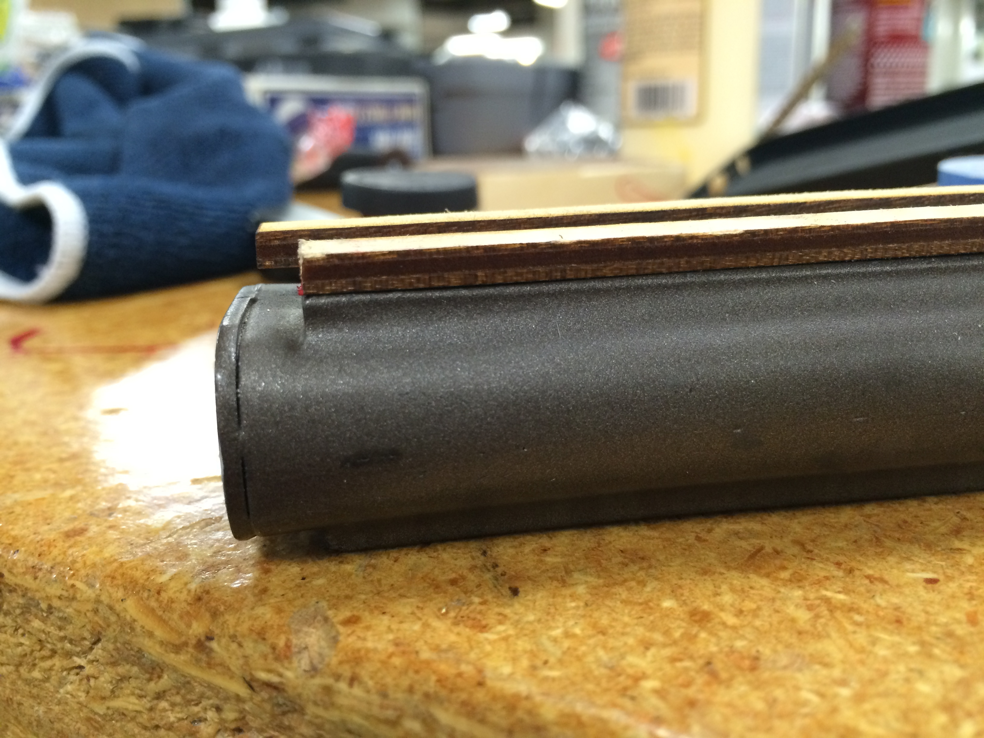

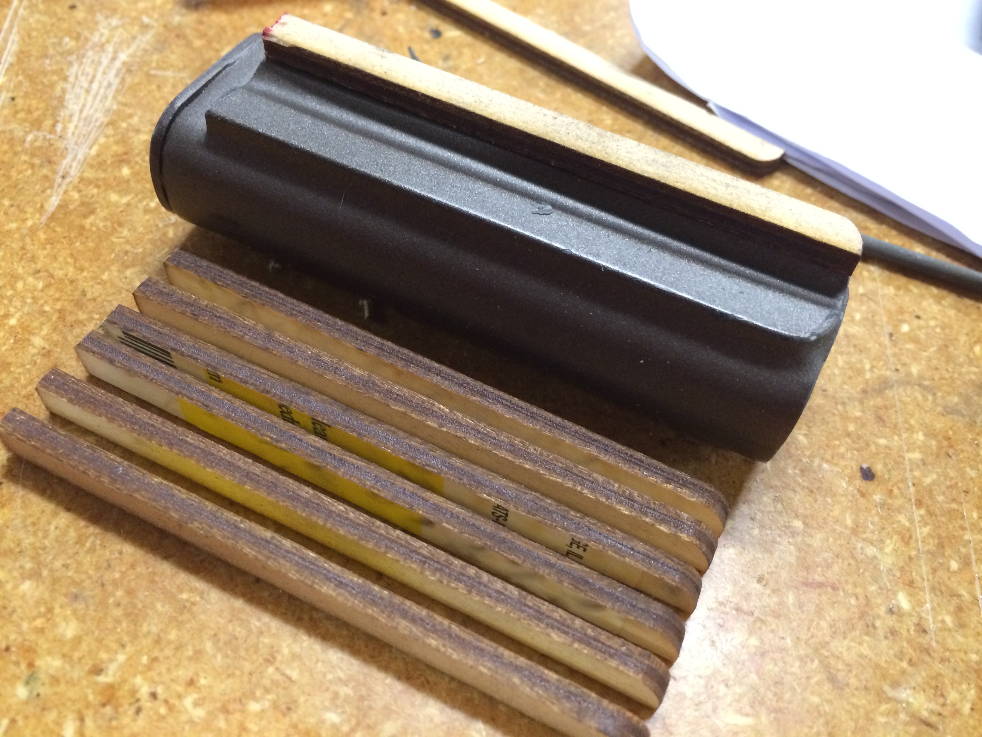

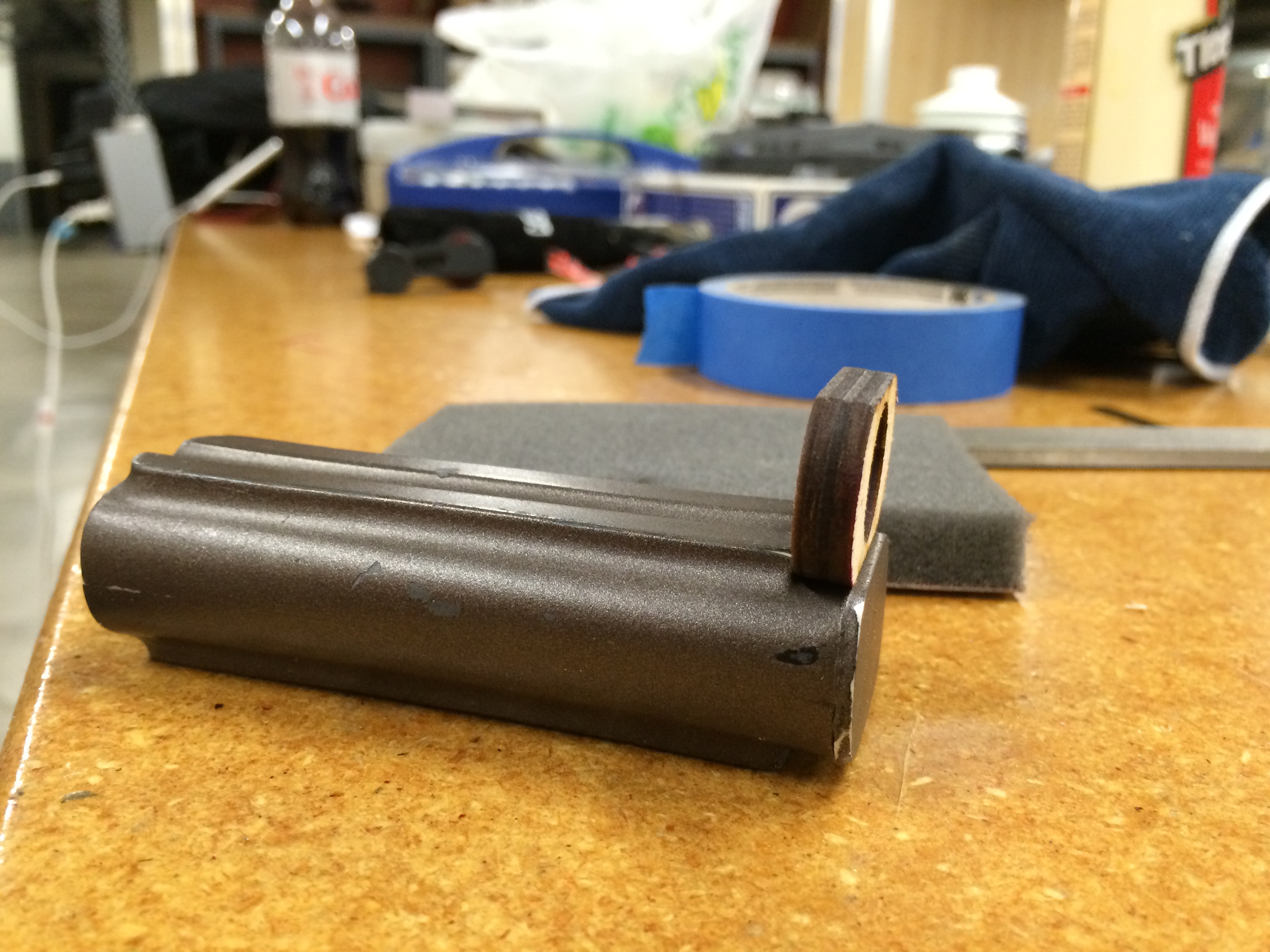

And onto the popsicle sticks. As I said earlier, I laser cut them too long, and here you can see by how much. So I took them to the Holy Bandsaw of Antioch, set up a fence, and zipped them all through at once.
I cut eight rather than the four I needed, and quickly vindicated this choice by screwing one up on the bandsaw, leaving me with seven. They're all perfectly aligned as far as I can see. The first picture shows that pretty well. There seems to be just a hair of extra thickness, and if I decide that needs to go, it's maybe two minutes on the sanding block to thin down all of them. Basswood ain't exactly mahogany. (If I ever had to do a lot of them, I think I'd run the wood through the planer before laser cutting it, and poof! - no sanding.) So, different methods for different kinds of work, using maximum laziness as your guide. :)
Next, I double-checked the butt plug for thickness with my super prop ninja method. Looks okey-dokey!
Finally, here's the session's total output. Not a lot, but definitely progress.

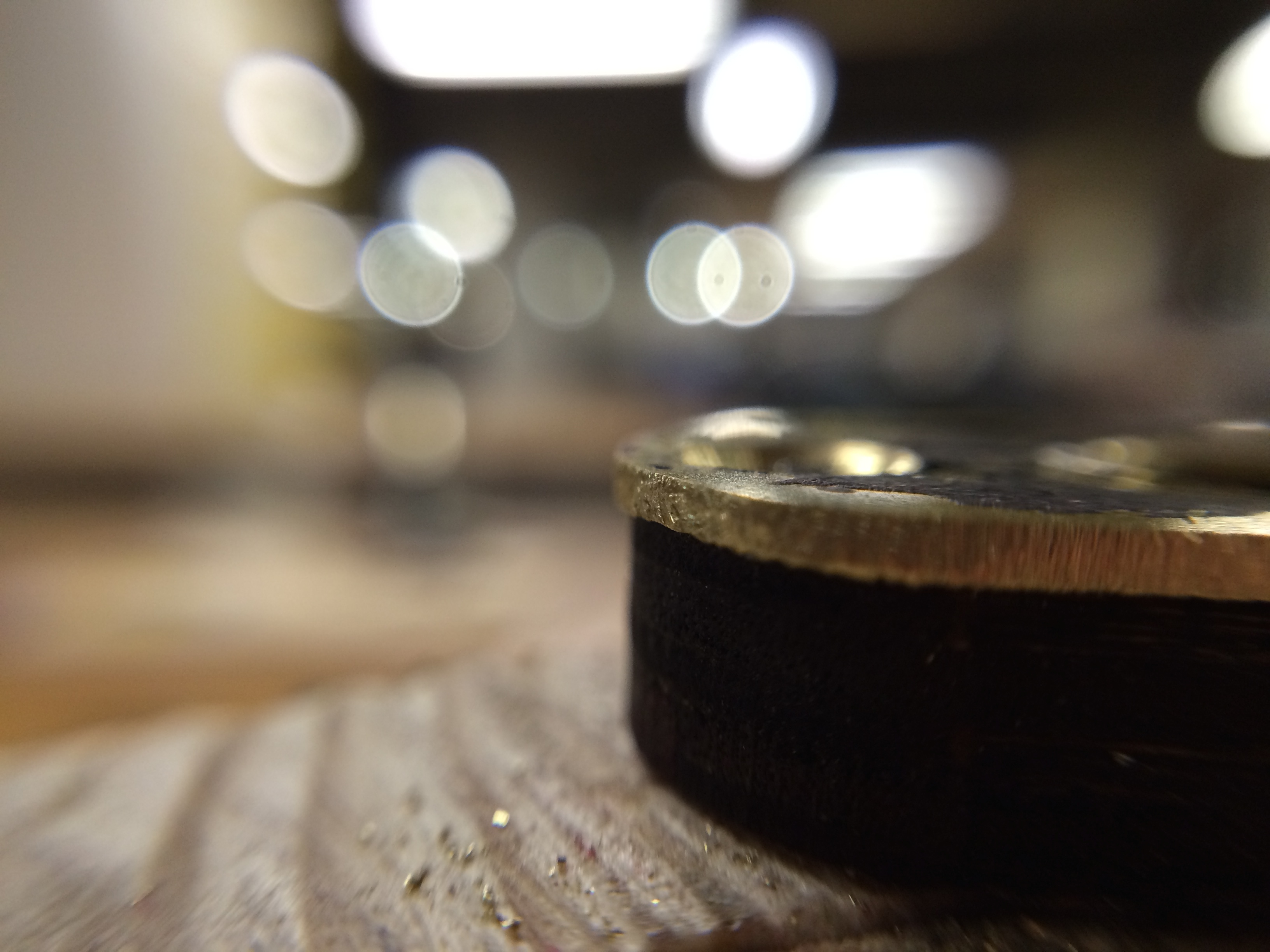

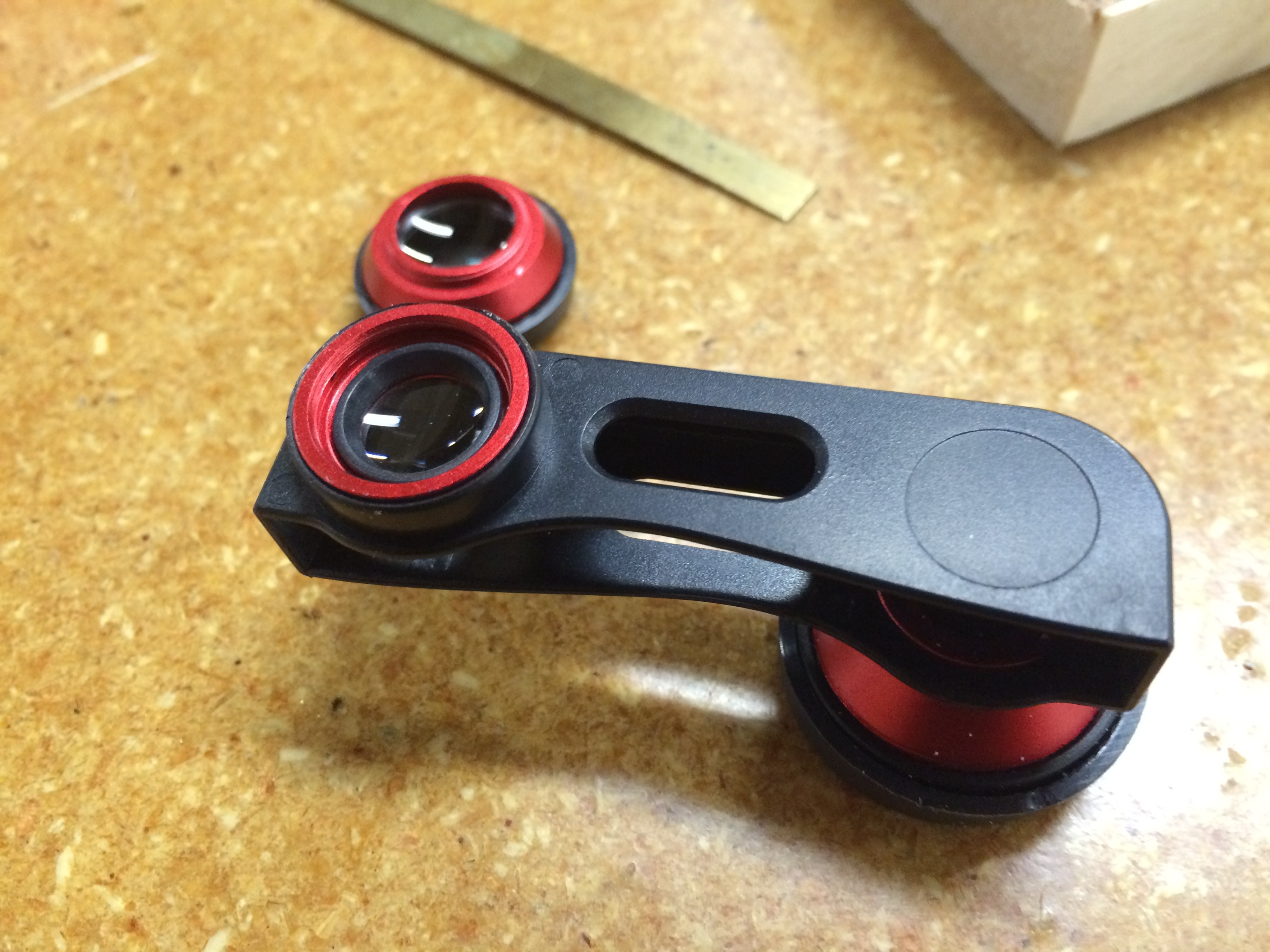

And here's a bonus picture: In case you're wondering how I get those ultra-close macro shots, I just got one of these for my iPhone on Amazon:
They generally run under $40 and you can get them anywhere for any camera phone. That's the macro on top there, the screw-on wide lens on the table, and the fisheye lens on the underside. The fisheye will see some use soon. ;)

Well, the good news is my metal showed up today, and it's a helluva lotta brass for $22!
The other good news is the handle's coming along great! Not finished yet (of course...), but really getting there.
HONEY, I'M HOOO-OOOME!

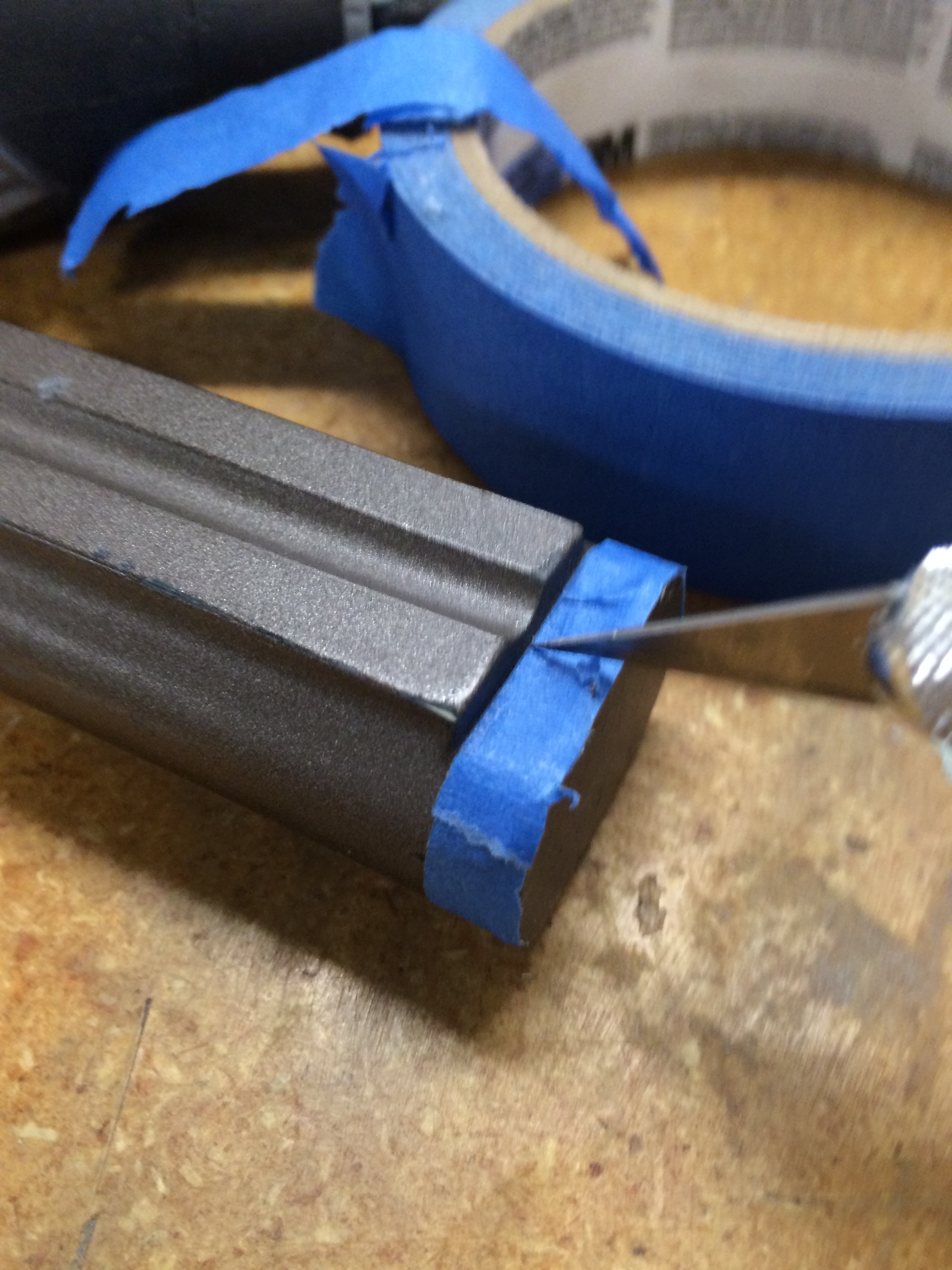

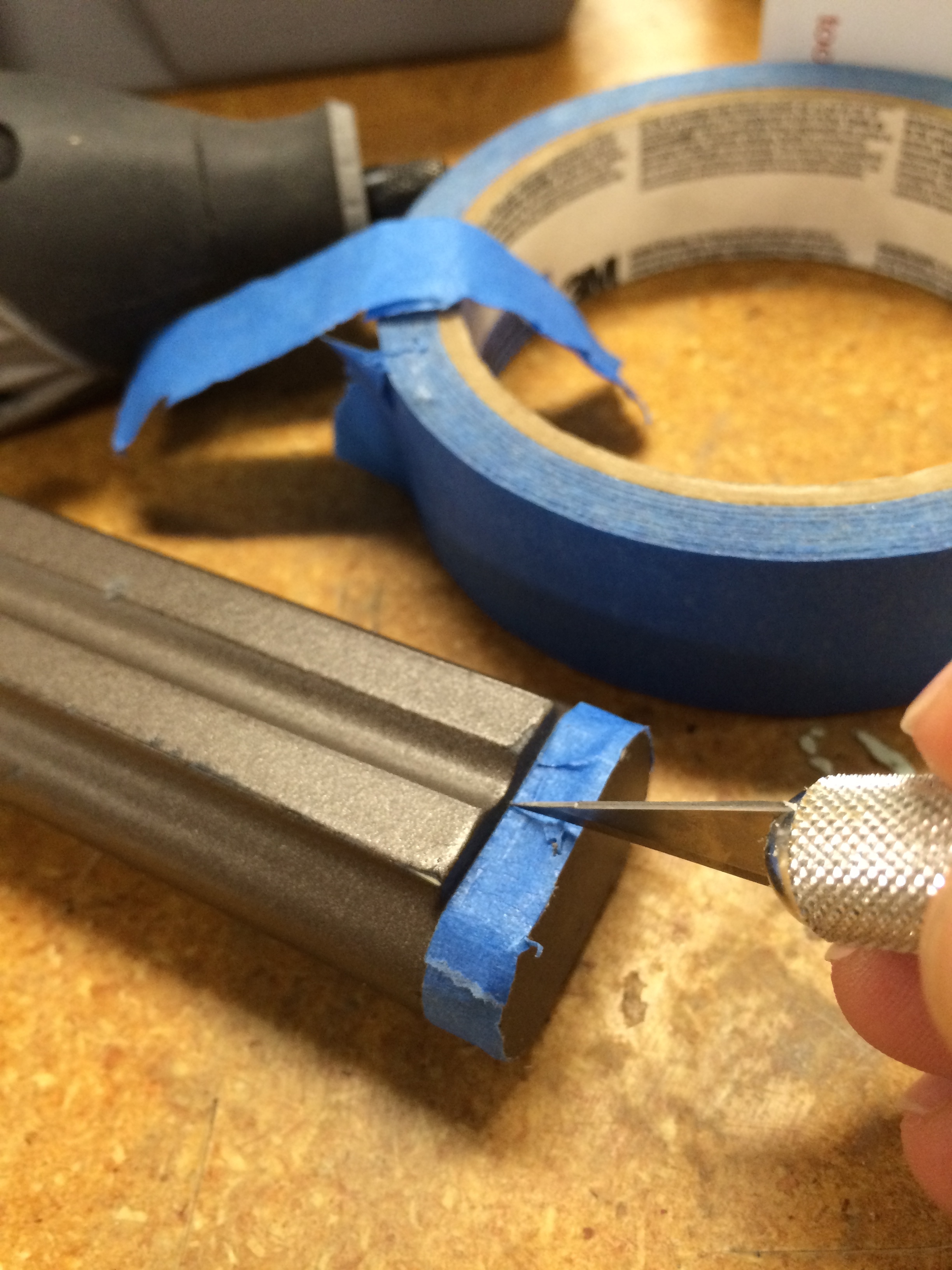

So when we left off, I had some overhang issues with the brass for the handle, and forming it was becoming a pain. First, I needed an accurate guide for circumference. I used blue tape around the base of the handle and then decapitated the excess. The sharper your #11 blade, the better, so I put in a fresh blade. Don't worry about overlapping the tape. Go right ahead.

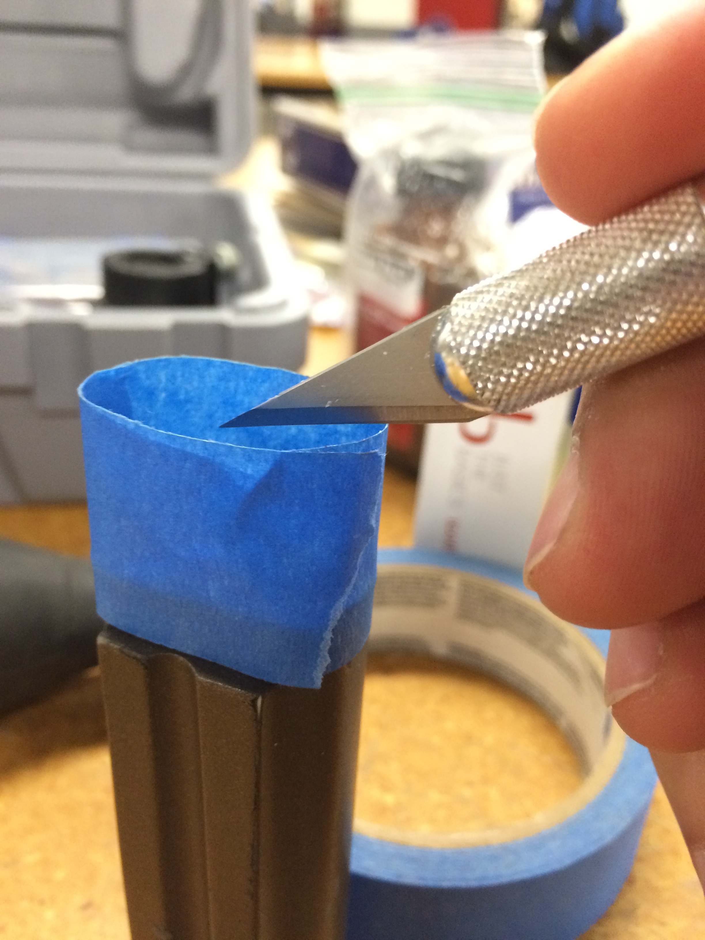

Here's why there's no need to worry about overlapping the tape: you just cut it right down the center, and the overlap is no longer an issue. In this case, it stayed behind on the handle when I transferred it to the brass.
And now I had a very good idea how much I needed to trim. I marked it with the back of a knife blade using a square.
And now the shear...
Note -- this is a huge pain with a curled sheet like this. Next time I'm definitely getting an accurate cut before bending, and that's not the only thing I'll be doing differently. So, after cutting on the shear and just a wee bit of filing the rough part of the cut:
Here we are, cut back to the proper size (well, just very close it turned out, but it was no longer a problem).
And now it's time to take care of the not-bendy-problem.
Time to...
