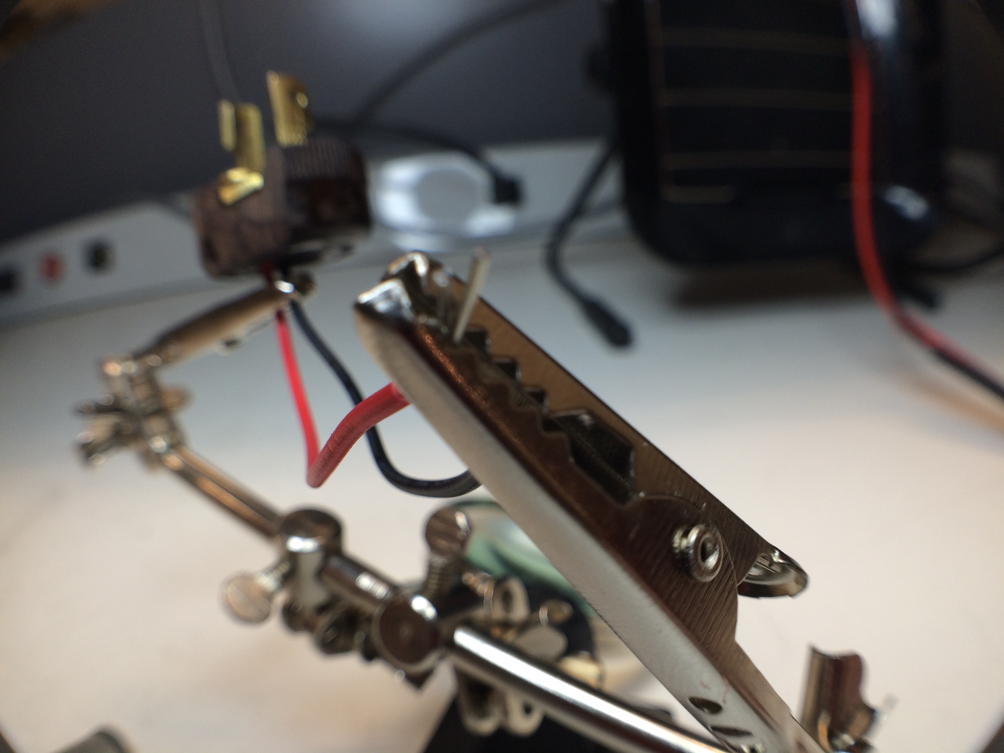

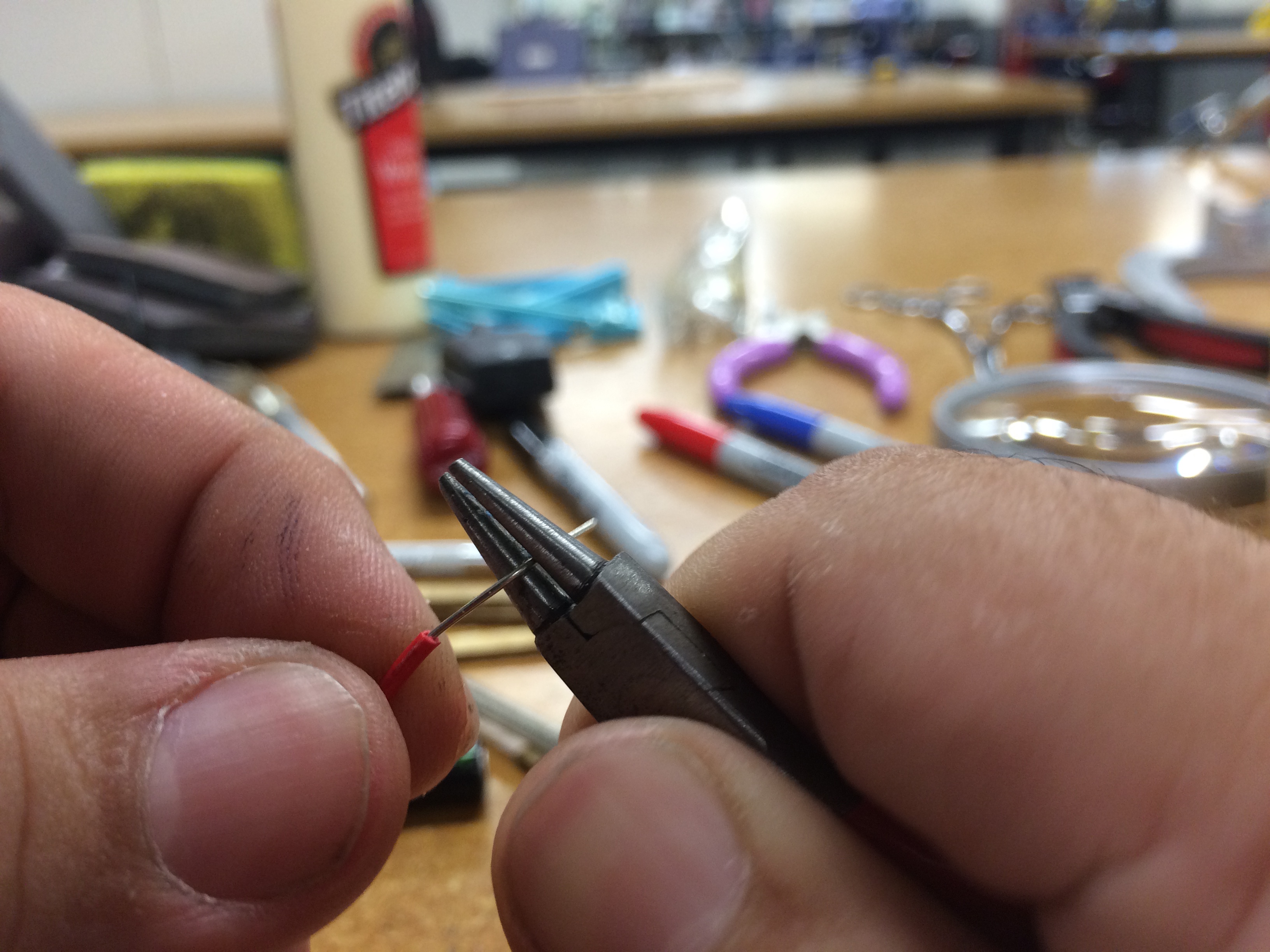

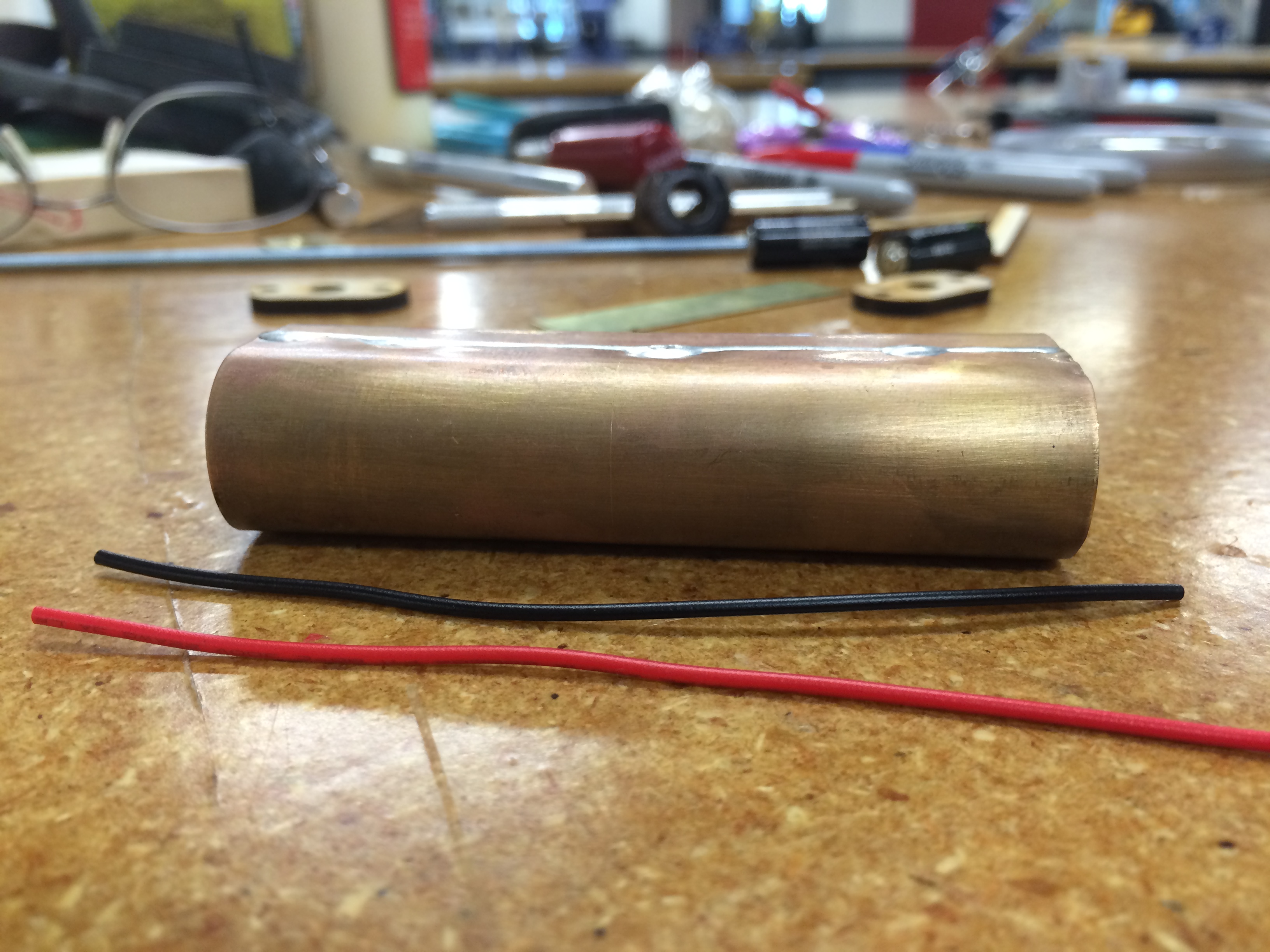

Since it's the power supply, I went with red and black wire. It's true that lightbulbs don't care about polarity. You can hook up power to them any way you want and they'll work. But there's a great tradition in electronics regarding color, clarity, team pride, and a deep and abiding passion for consistency. Besides, it's what I had on hand. :p

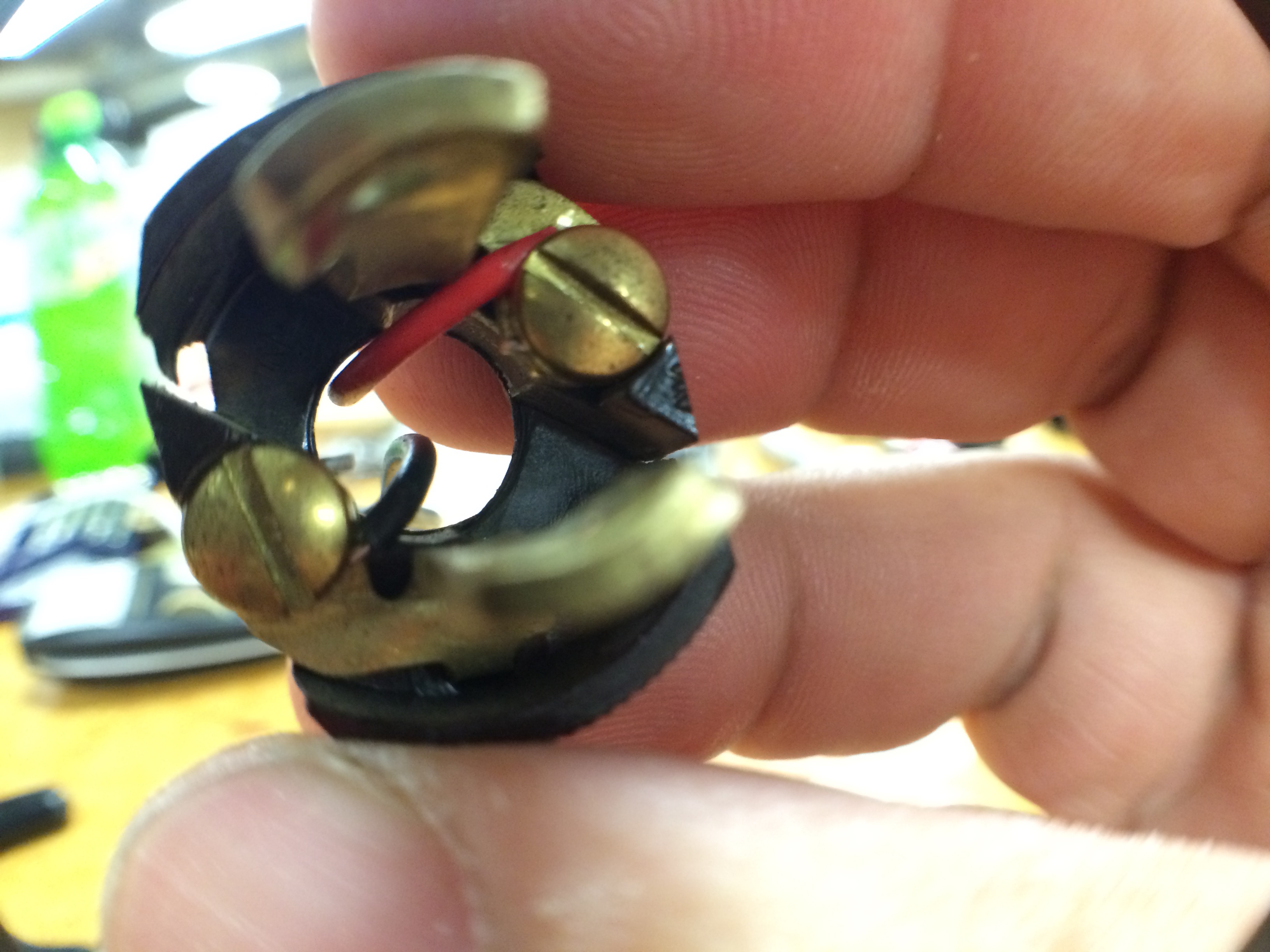

Tools again: you have to loop the end of your wires to go around the old-timey terminal screws in the Hubbell plug, and those of you who've built John Long's P1 kit also know there's a fair amount of wire looping in there. There are great instructions in there on how to do it, but after I discovered jeweler's/beader's tools, I was a new man. They have them at Michael's with the beading tools. As always, never pay full price at Michael's. That's why God made coupons.
I have another one I just bought at 40% off, but I don't have a picture right now. I'll post that when I get to the P1 internals.

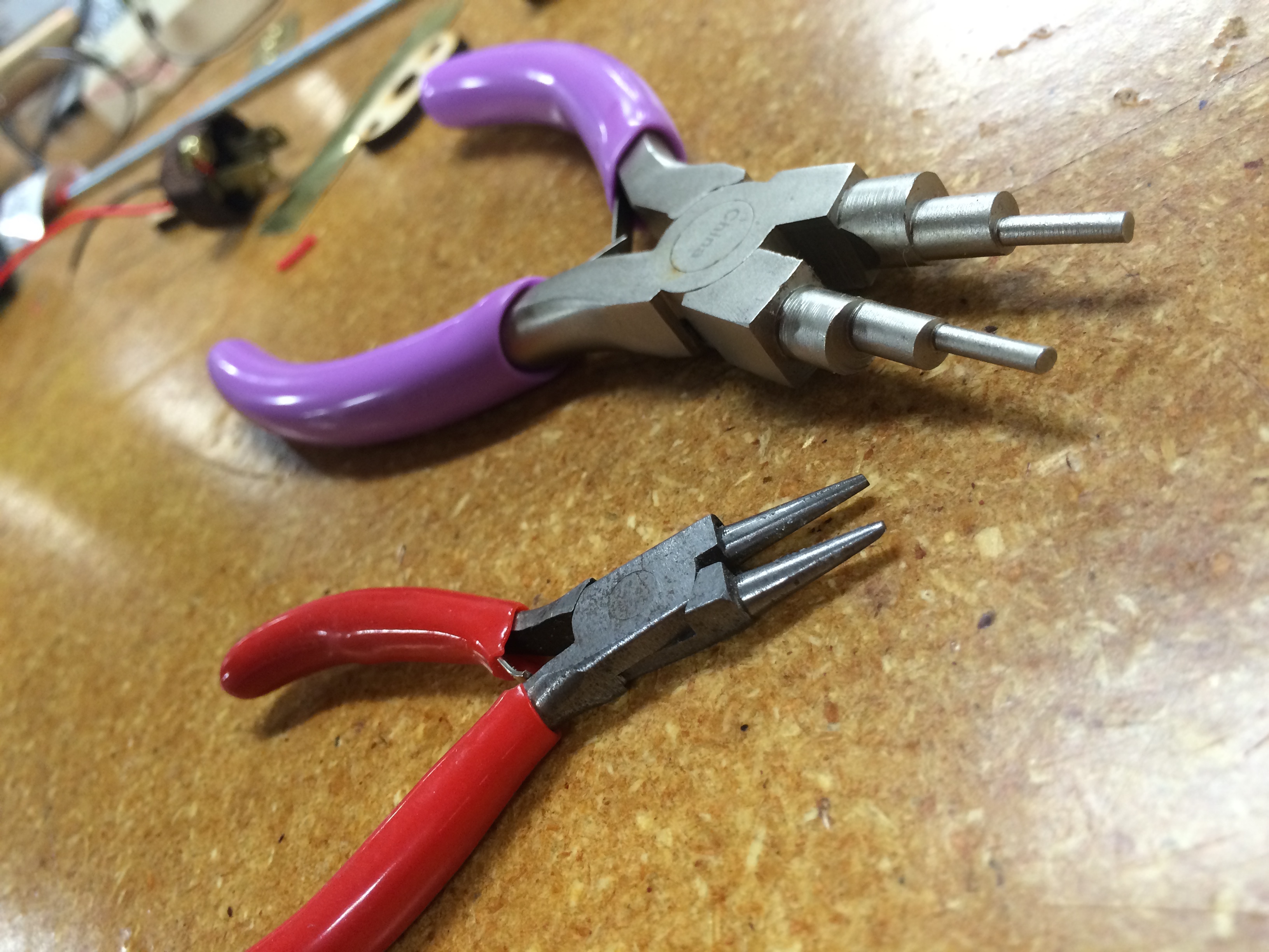

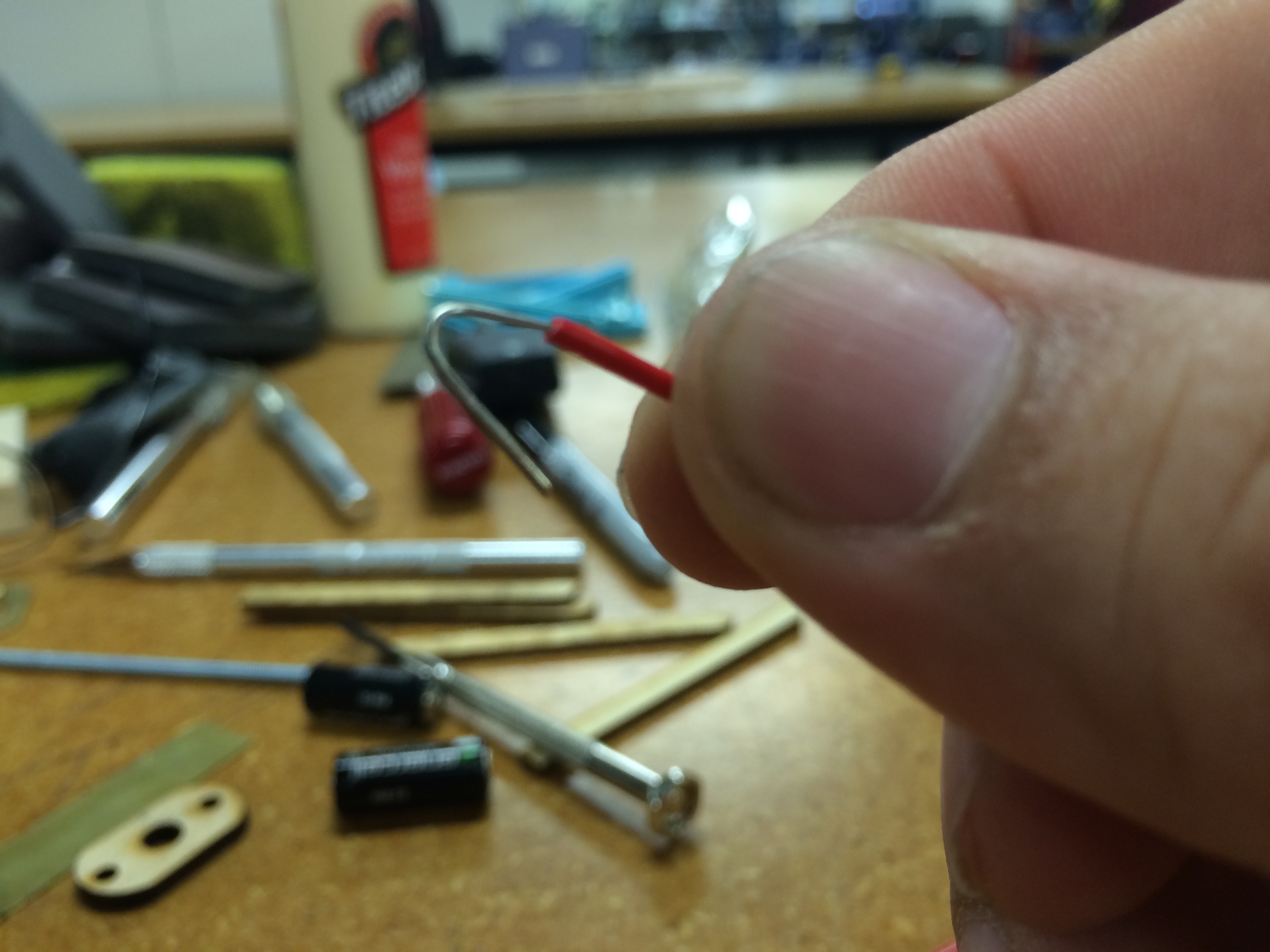

So here's how you use one to put a nice loop in a wire:
I know, I know -- horribly complicated. But I have faith in you. You'll get the hang of it. :p And don't forget to loop your wire clockwise, so that it doesn't try to pop loose while you're screwing down the terminals.
Now, you'll notice I used solid-core wire instead of stranded. I don't even own any stranded wire. Solid core wire can break because it doesn't stand up to bending and twisting a lot, but that's just not gonna happen inside the handle, ever. Plus, it's easier to solder, easier to hold in place, and you just can't use stranded wire on a breadboard. And stranded wire also carries yucky Ebola AIDS cooties. That's really the big one for me.

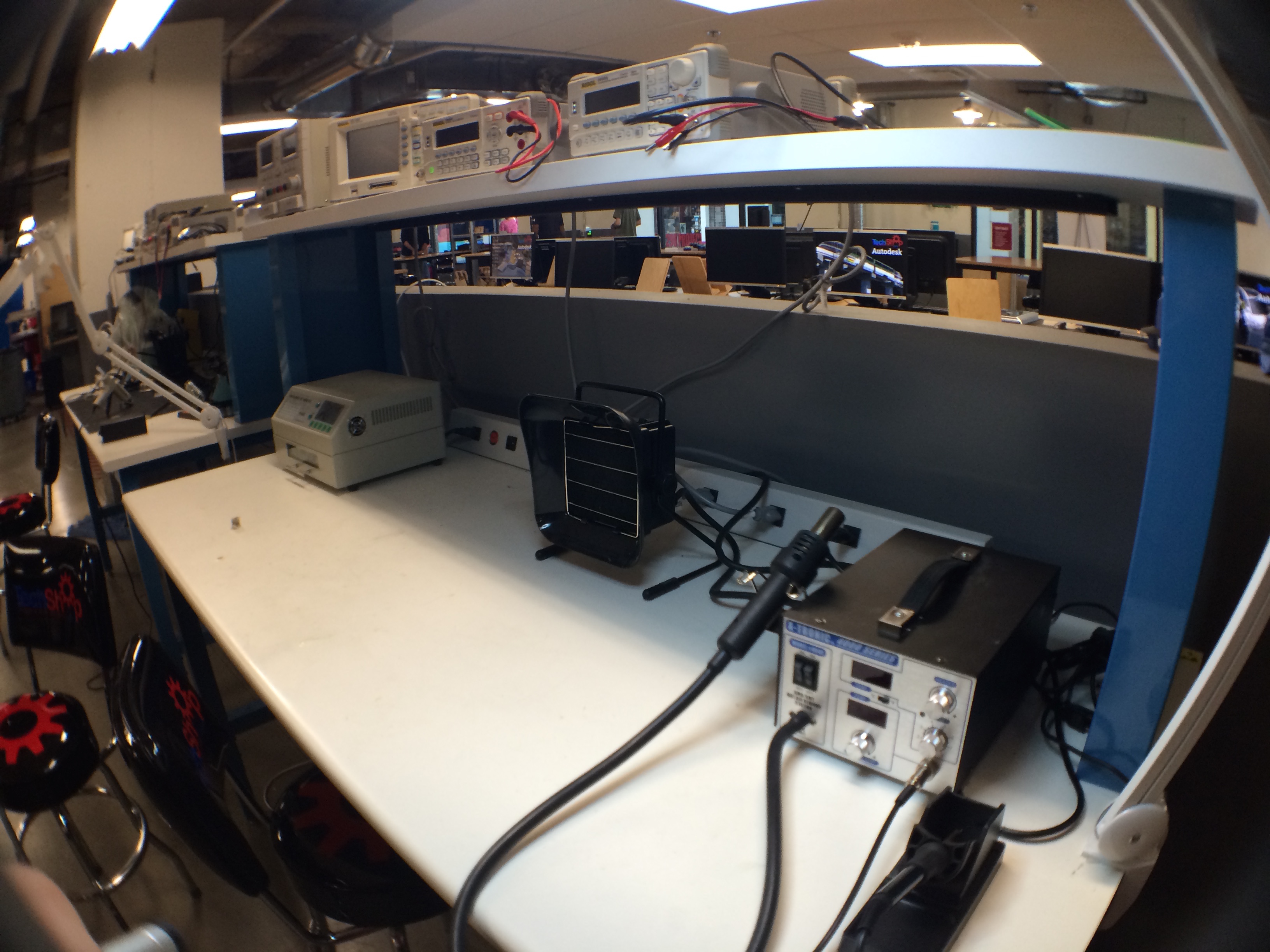

And now, off to the electronics bench! Not strictly necessary, since I can just grab a small multimeter and test for continuity right at my workbench, but come on...
I'd live next to this thing if I could. Me so geeky! Me solder you long time!!

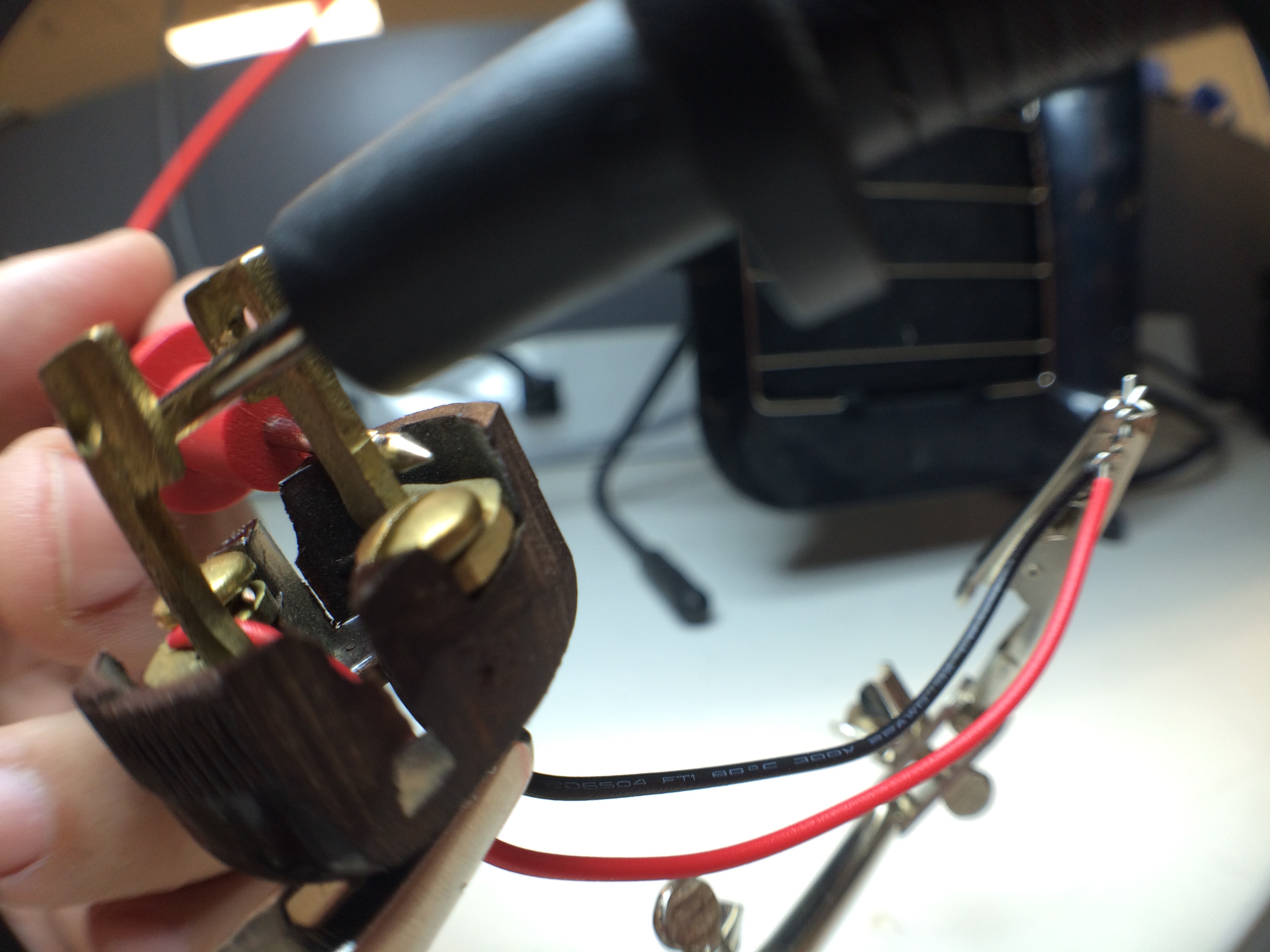

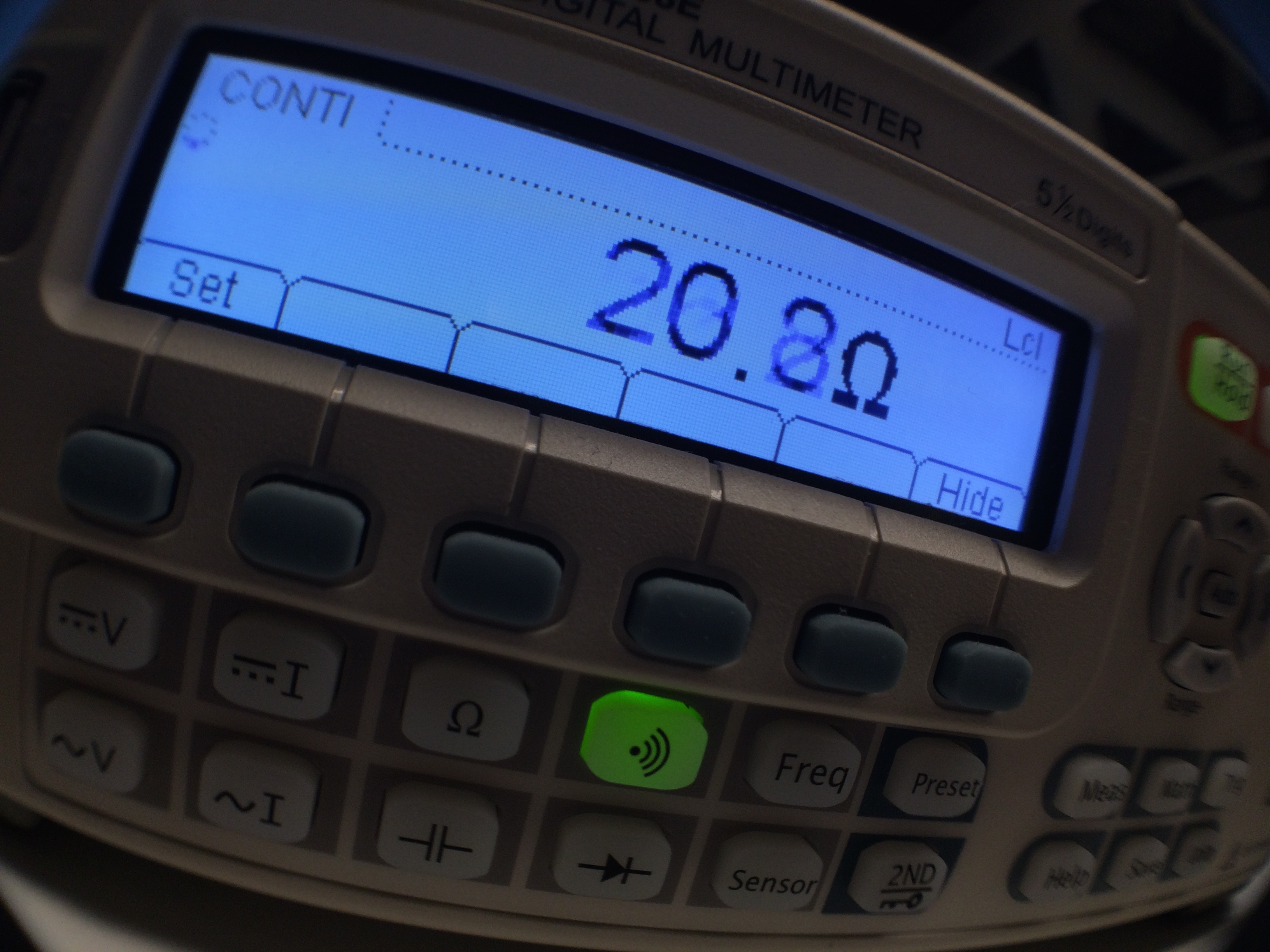

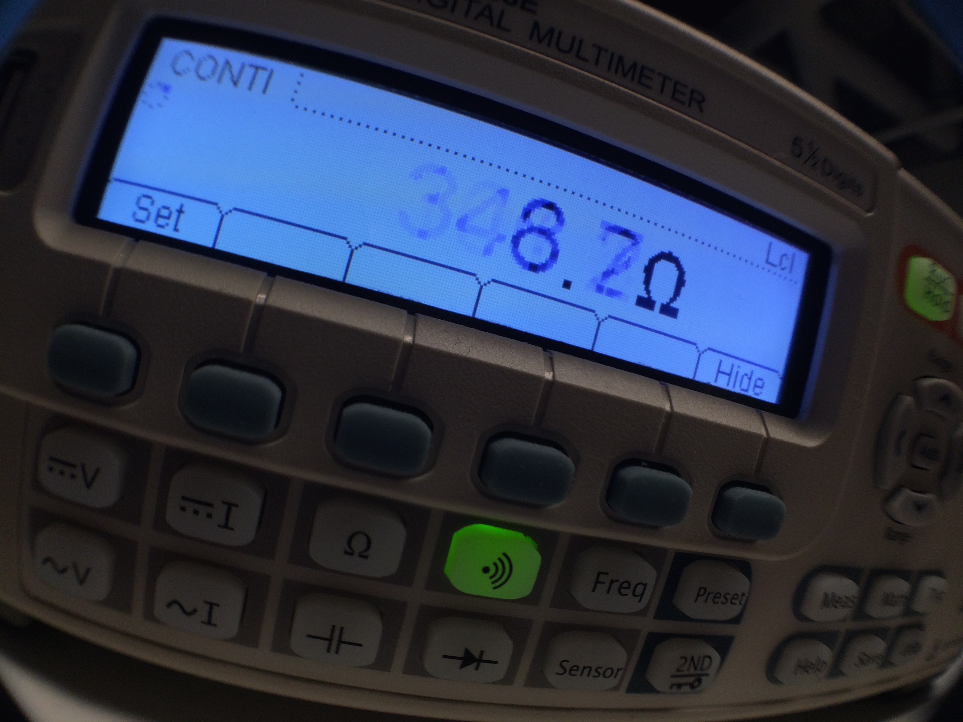

So you hook up the wire to the terminals, then twist the loose ends of the wires together so you can make sure all those happy little electrons can make the full lap around the circuit.

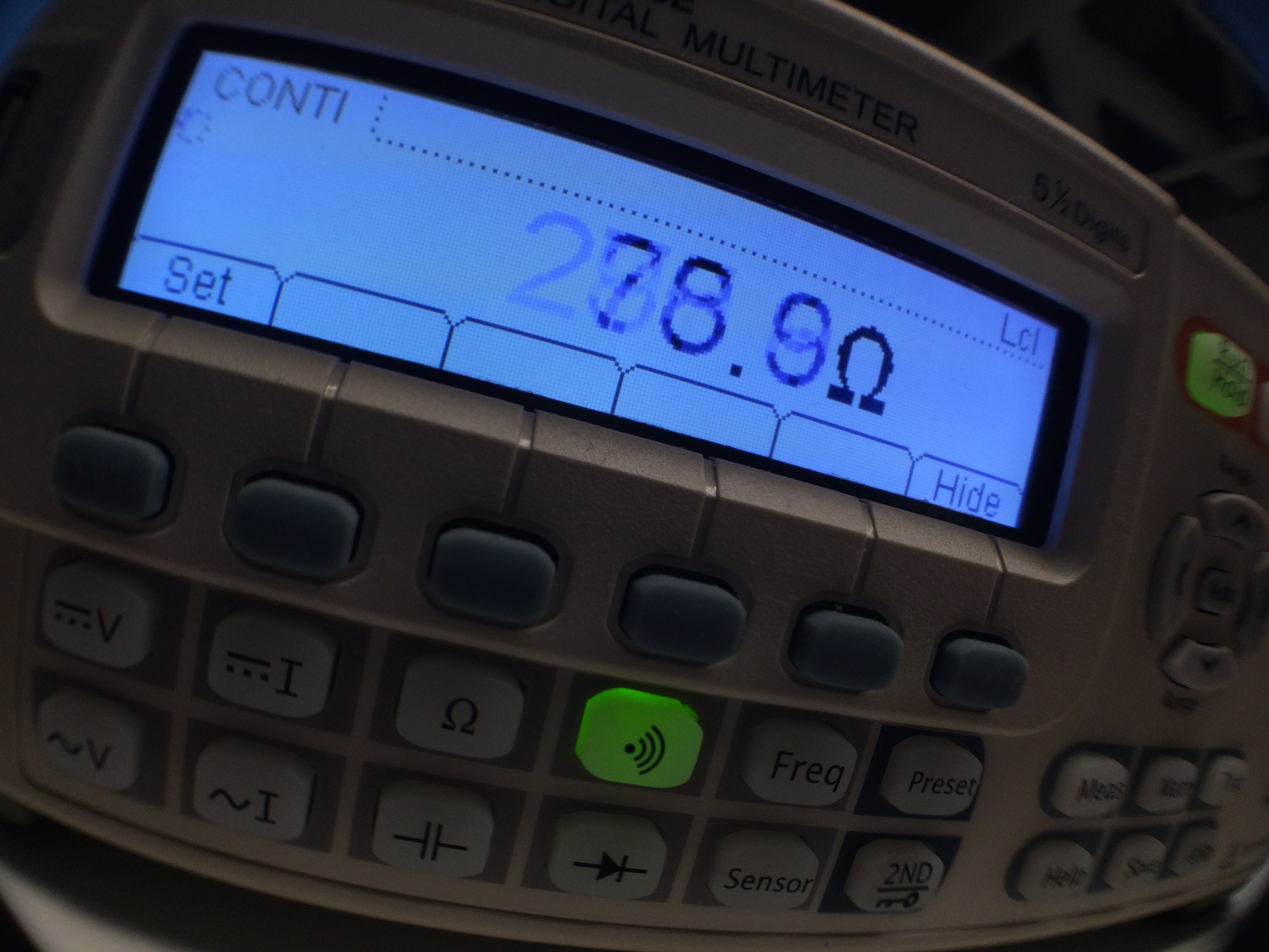

Different models of continuity meters work different ways, but commonly they beep when you have a complete circuit. Pretty much every multimeter you can buy will have a continuity checker. This bench model beeps, and the display goes absolutely batsh!t haywire.
2014-10-26 13.11.30.jpg2014-10-26 13.17.58-1.jpg2014-10-26 13.20.01-4.jpg2014-10-26 13.20.01-2.jpg2014-10-26 13.20.01-3.jpg

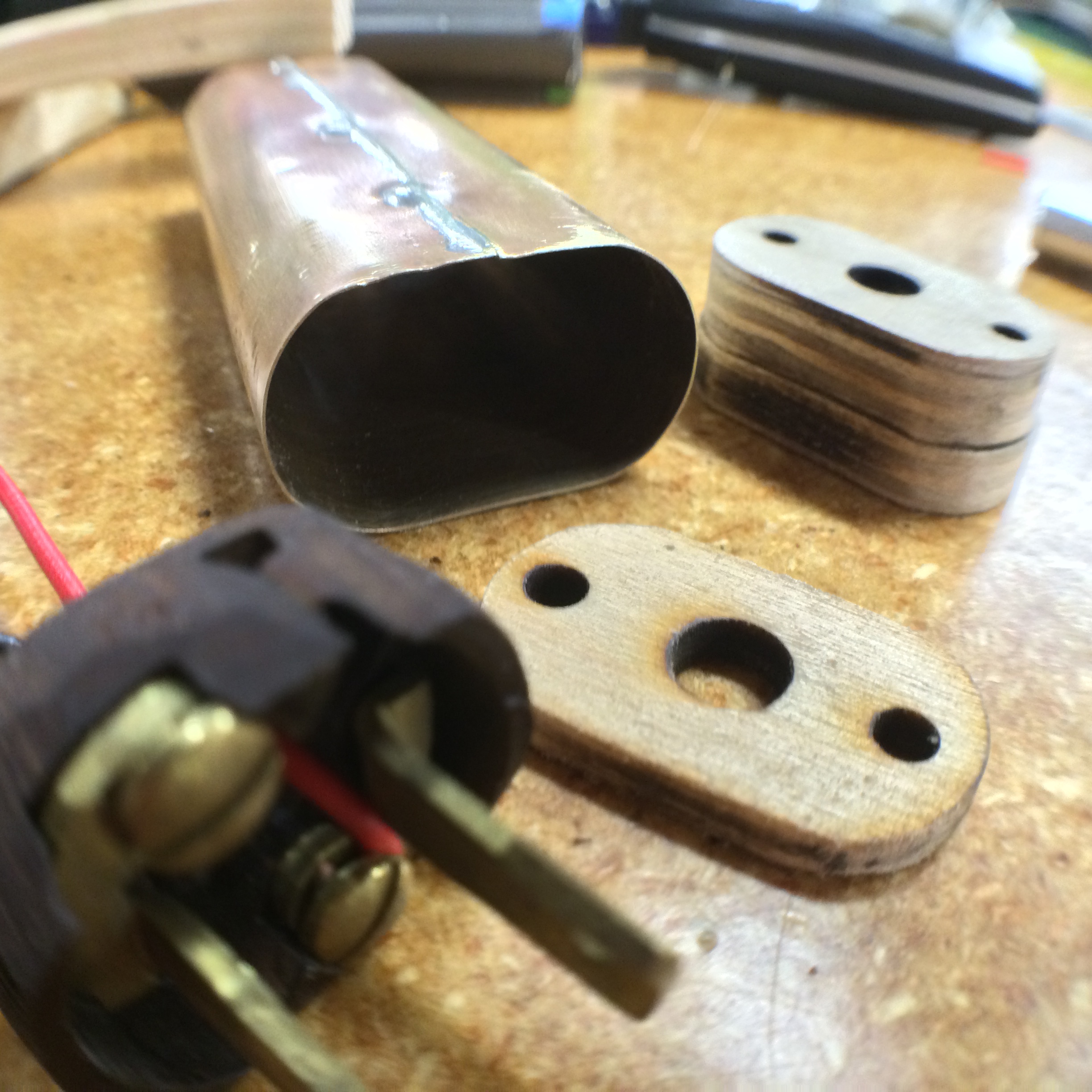

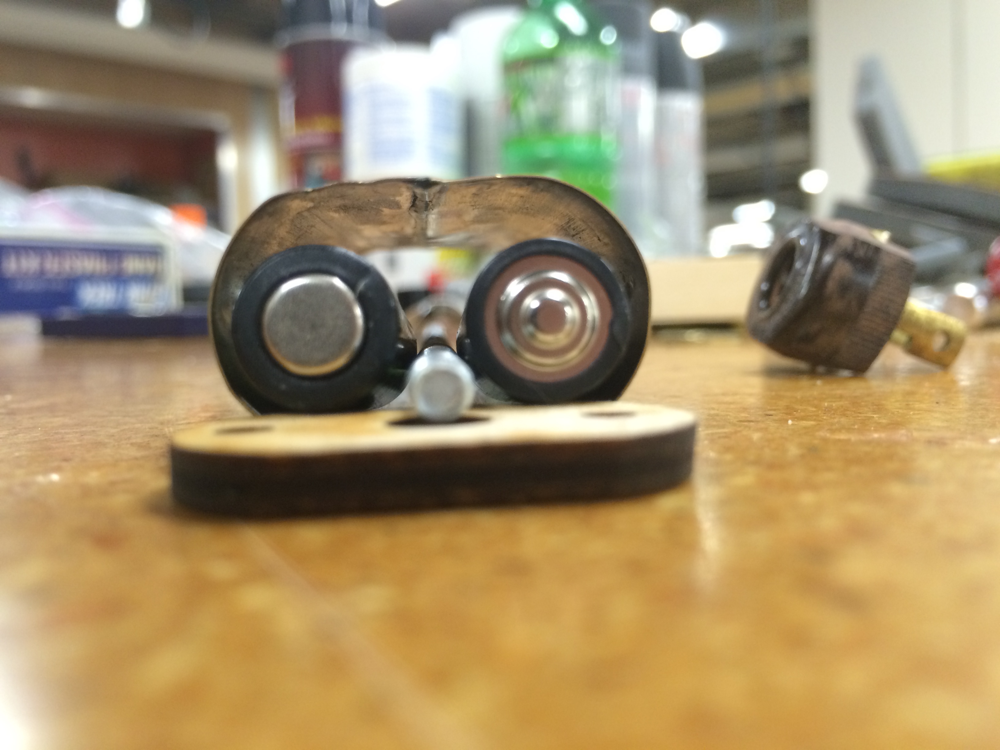

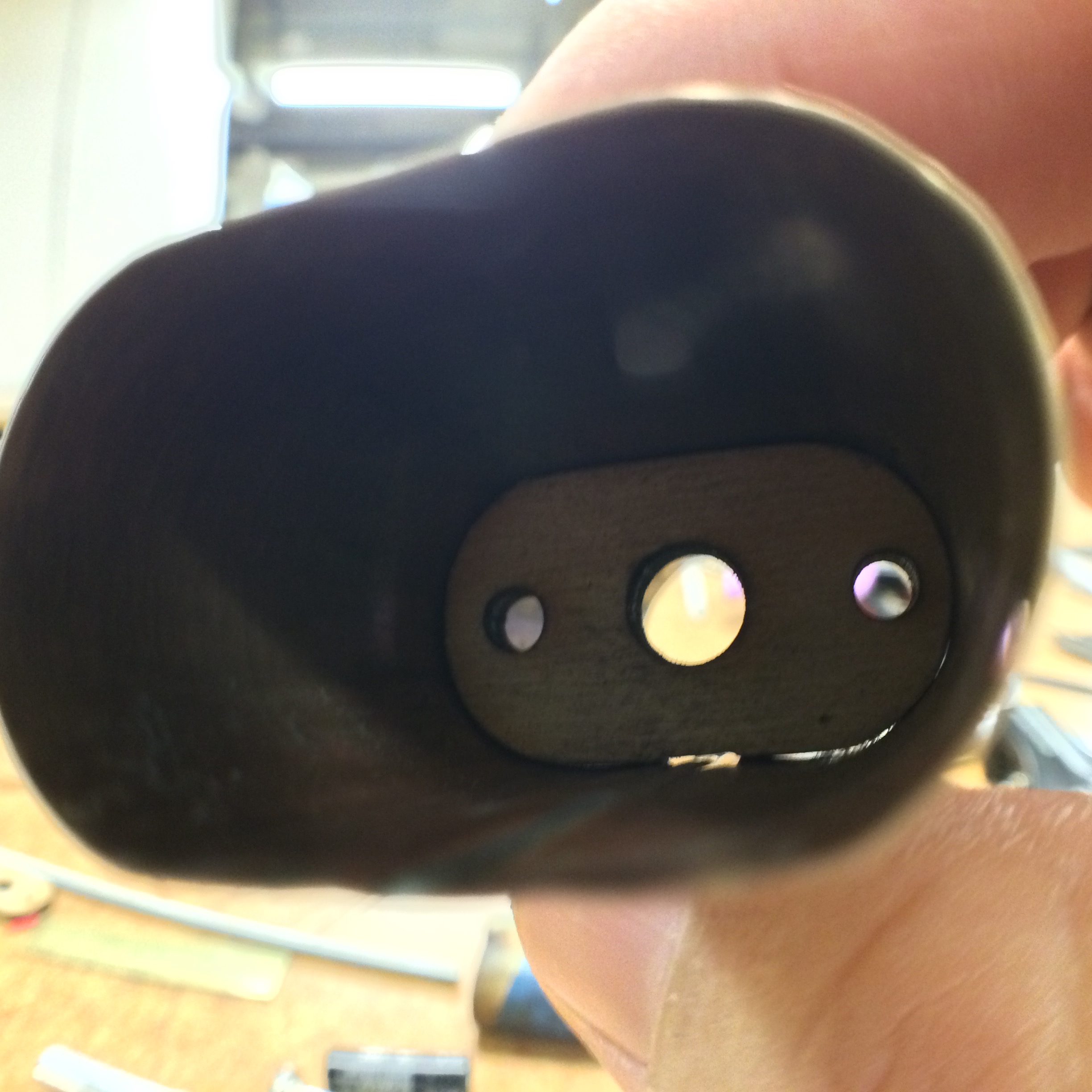

Now that the plug is ready to go in the handle, it's time to get the handle ready for the plug. Back to sanding! Yay! Kinda.

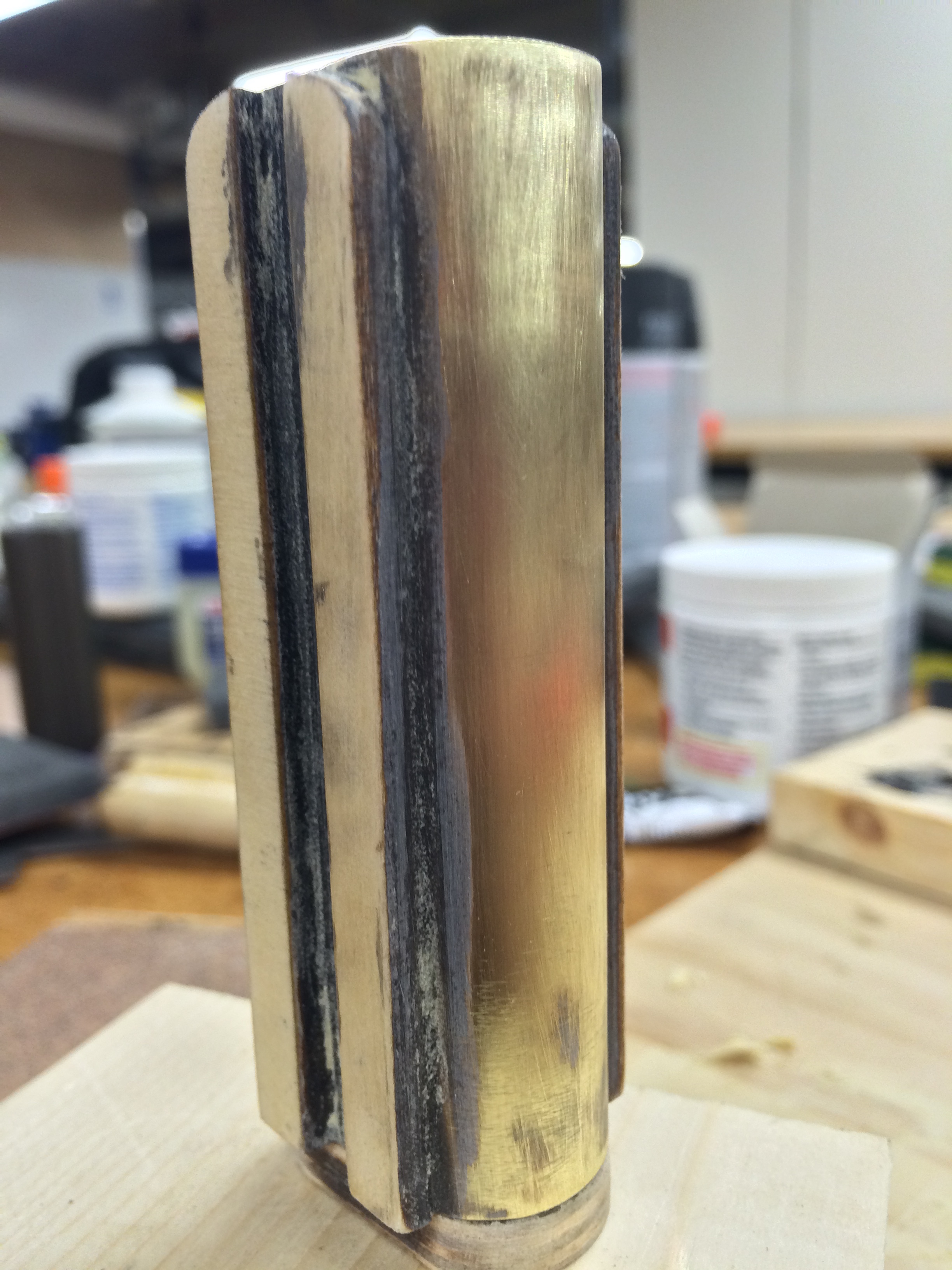

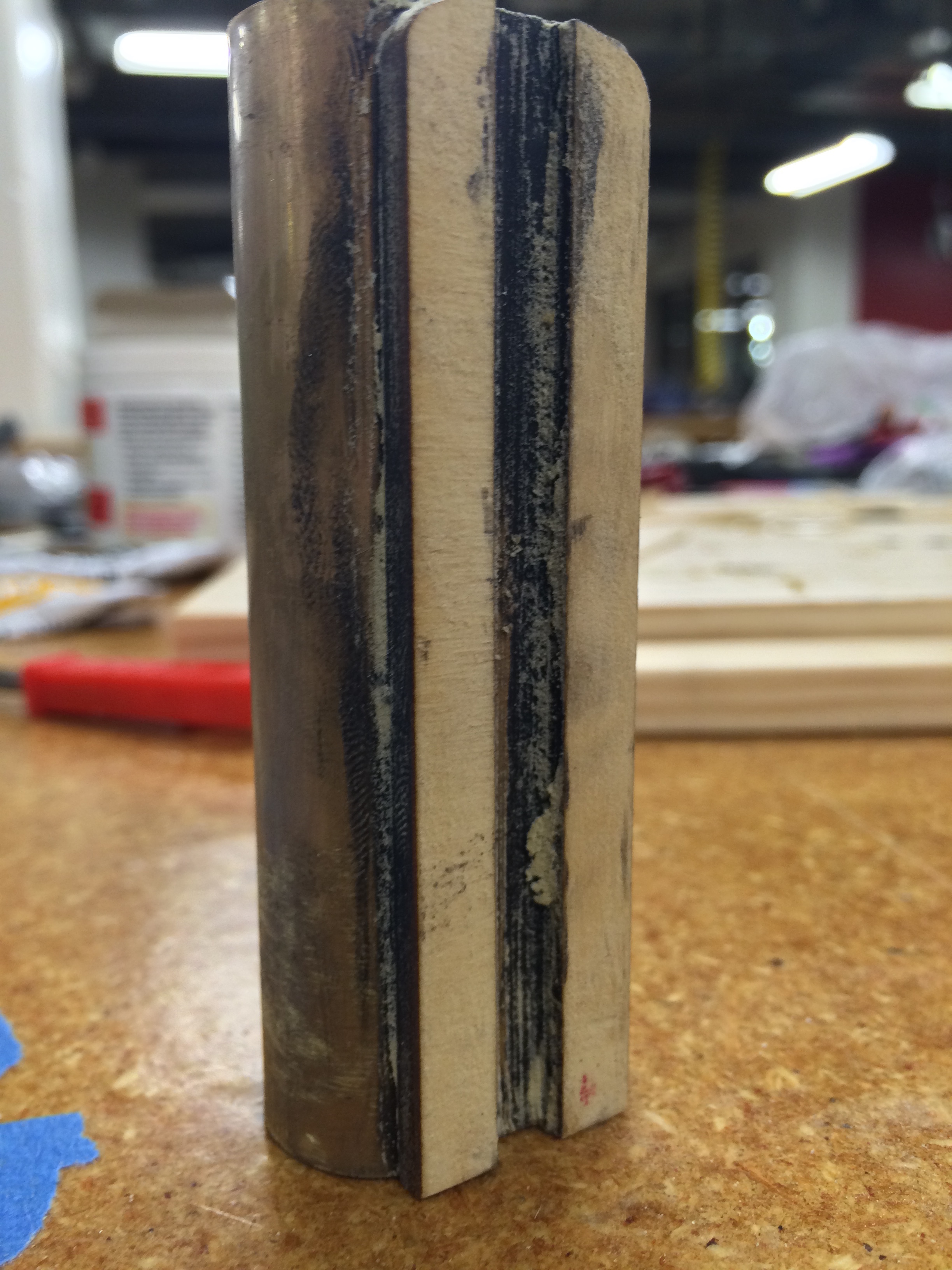

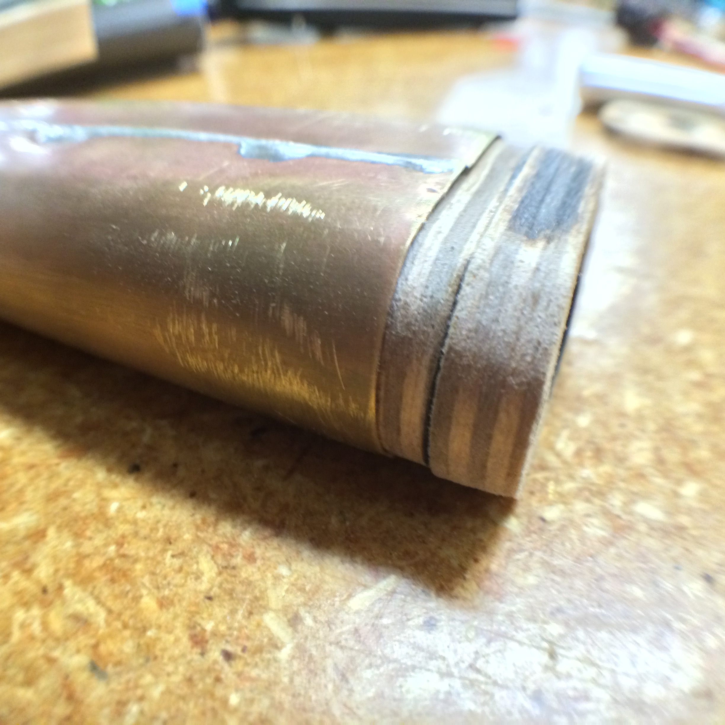

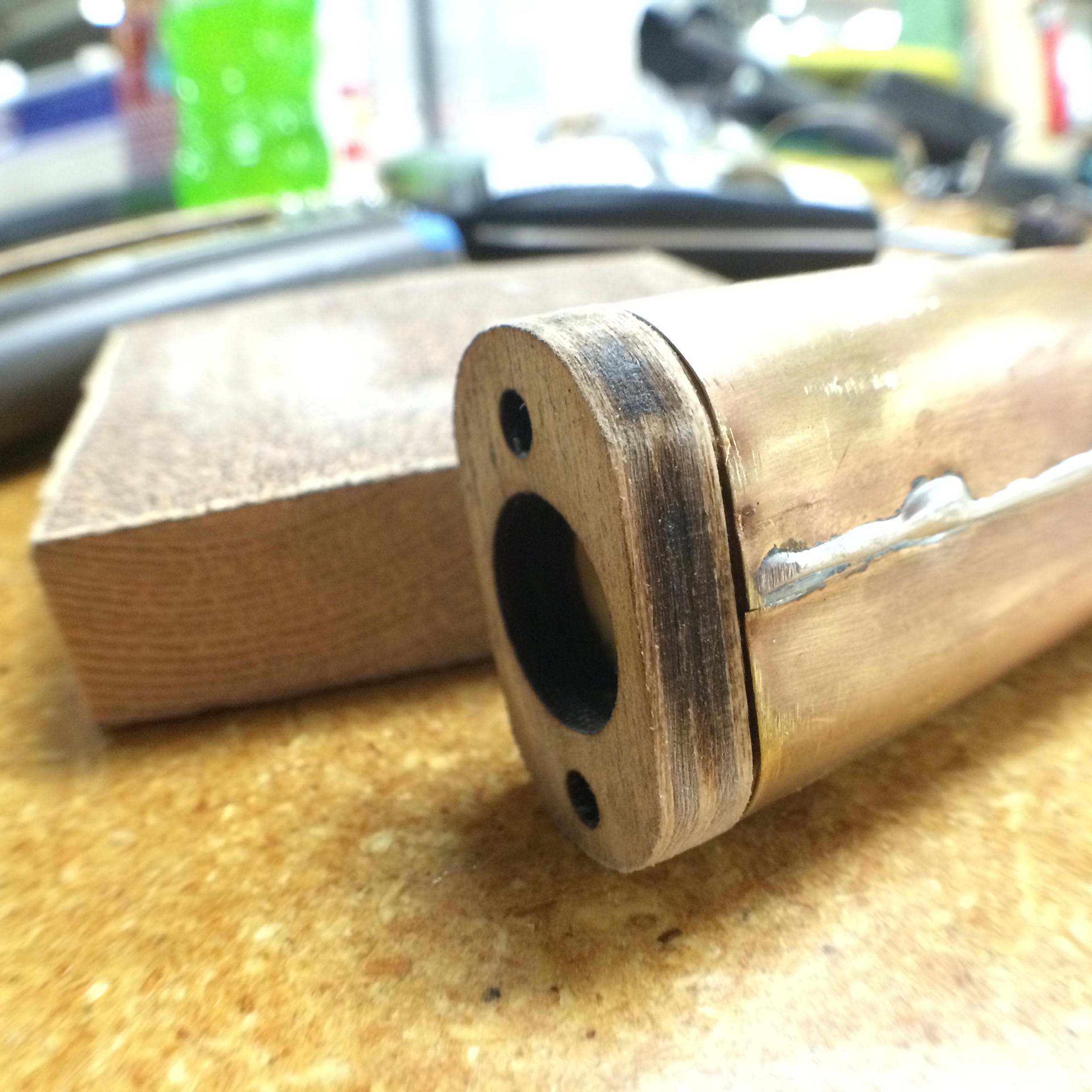

I spent some quality time with the sanding block and my wood parts making sure I had a nice, even joint between the handle and the butt plug. And there was a lot of sanding.
Ultimately, though, I wound up with a very nice fit overall, and now all my parts were ready... for more sanding...

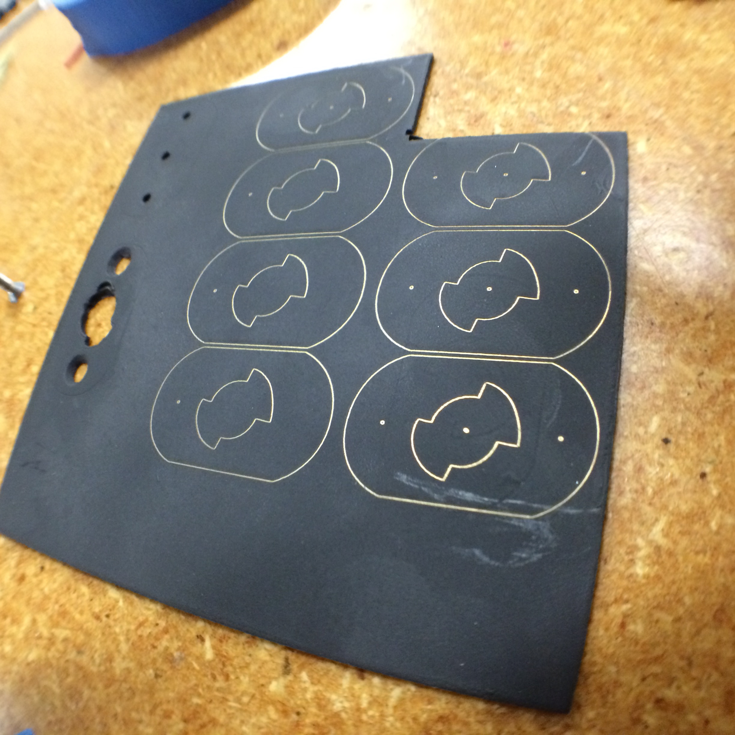

I then made a quick detour to the laser cutter (cuz I got scared), to make some more templates for the woeful ordeal that is the end plate...
This time I meant business.

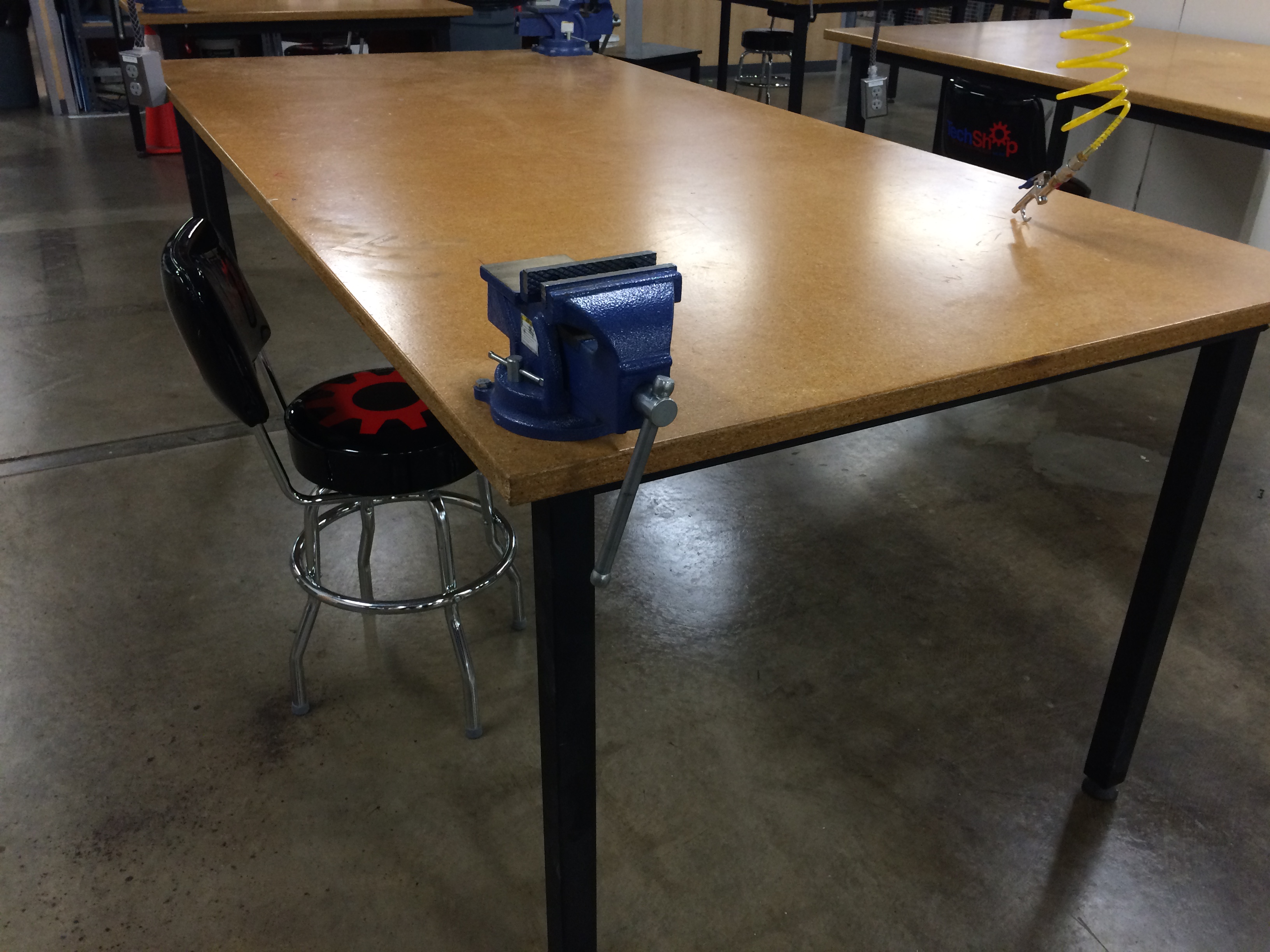

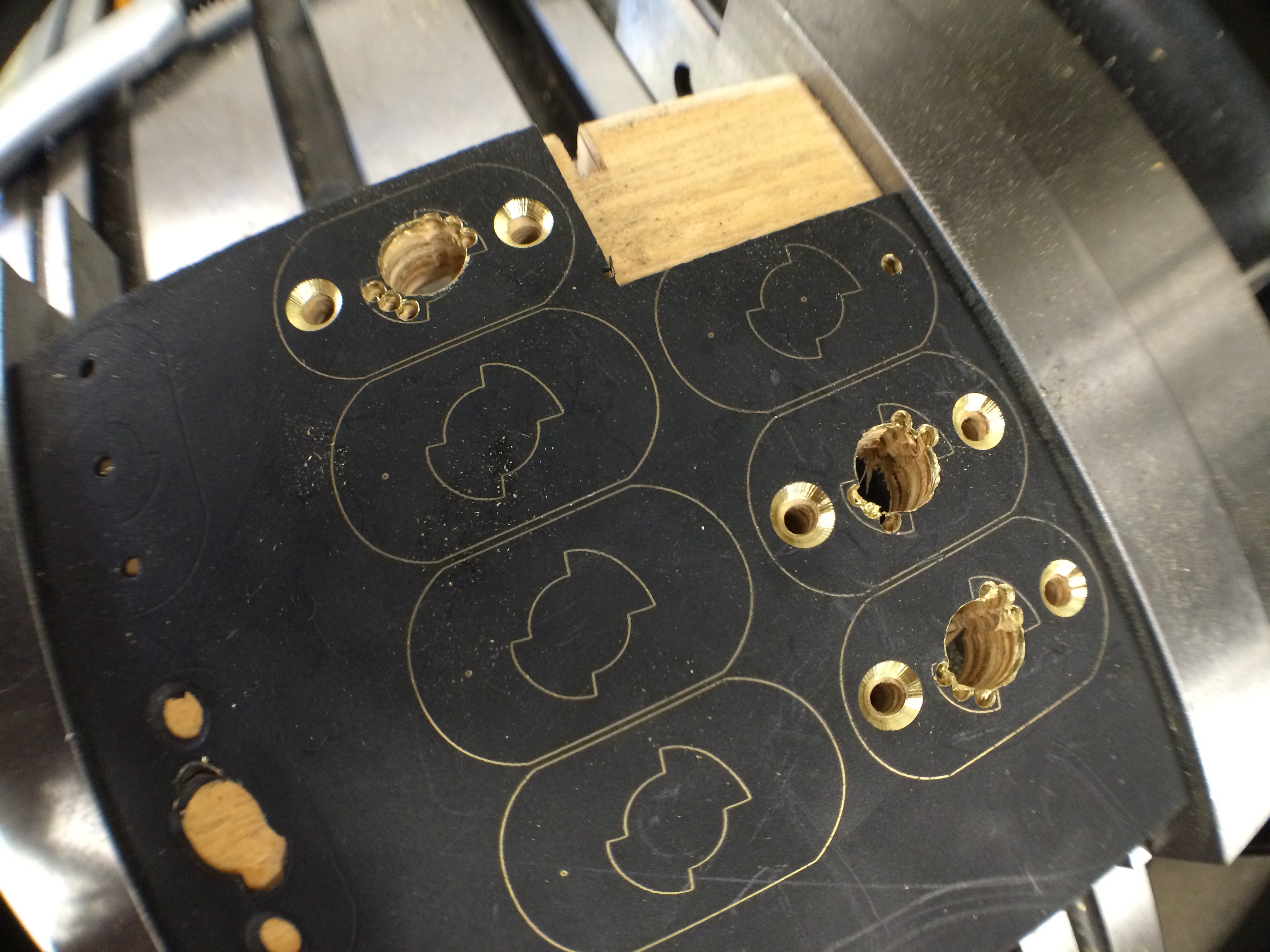

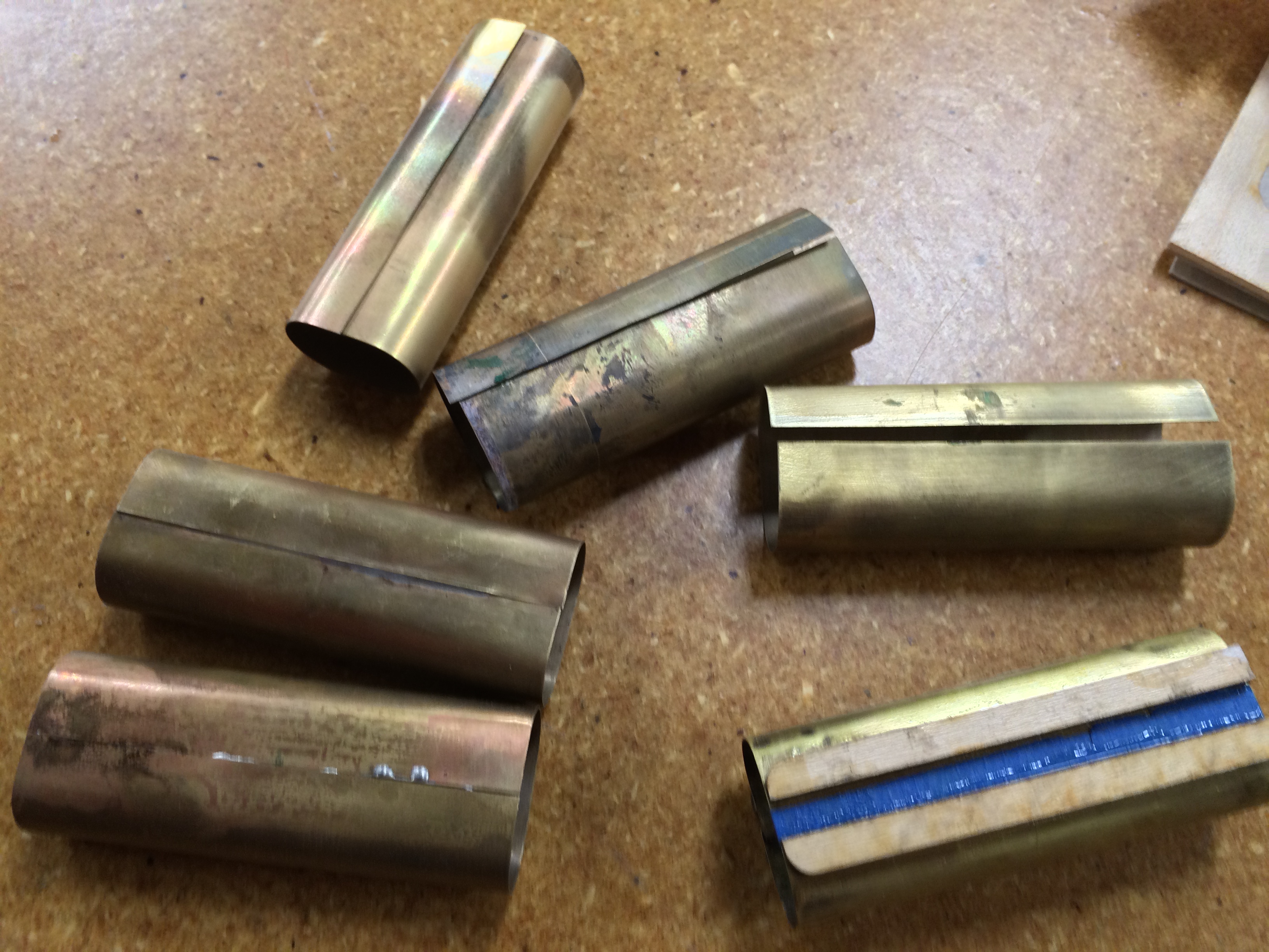

Meanwhile, back at the mill (I always wanted to say that)...
I drilled and countersank three of the templates to increase my chances of getting one good one. I've been doing this work sloppily to get done, and it always bites me in the butt in the end. I did get one completely filed out, but I actually managed to misread my own markings and the big hole looked awful. Still, I'm finally getting the technique down, and I'm perfectly sure I'll get a really nice butt plate in the end. Which is where they go. :p

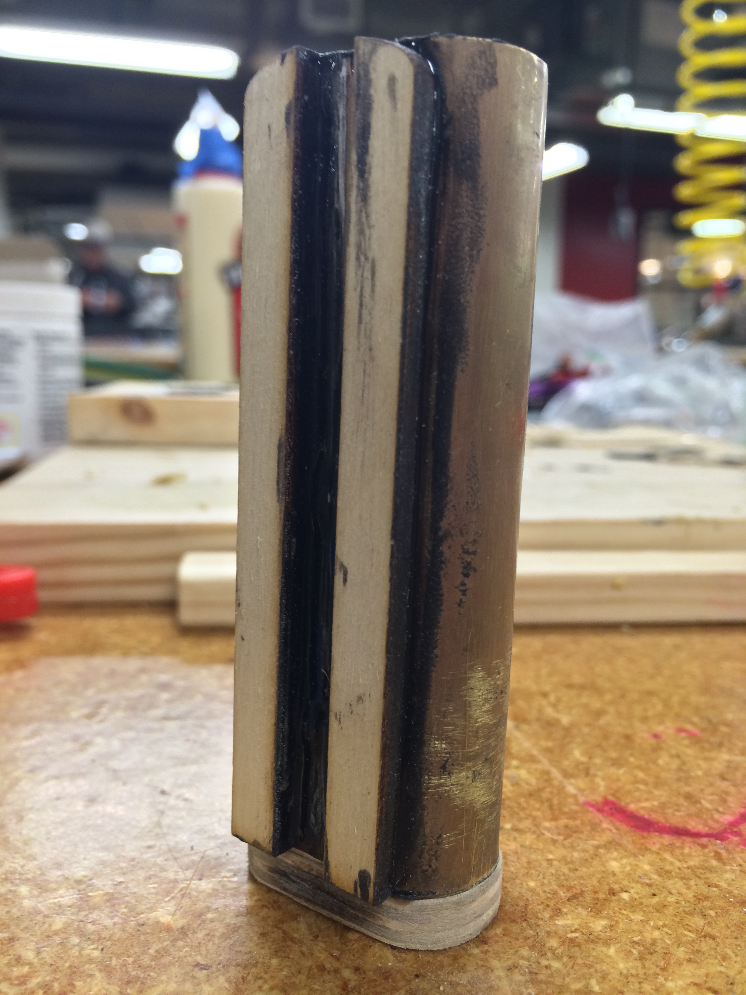

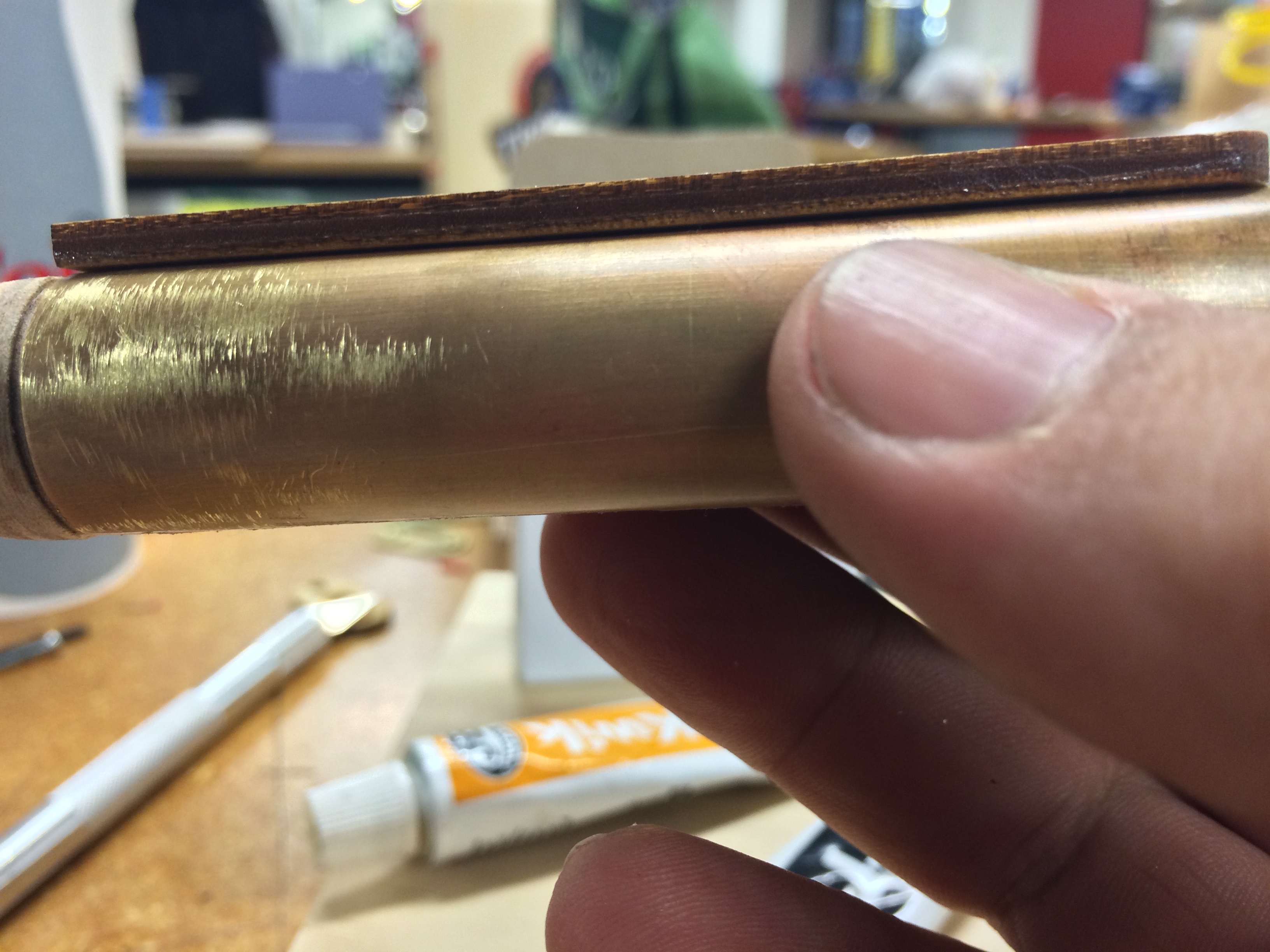

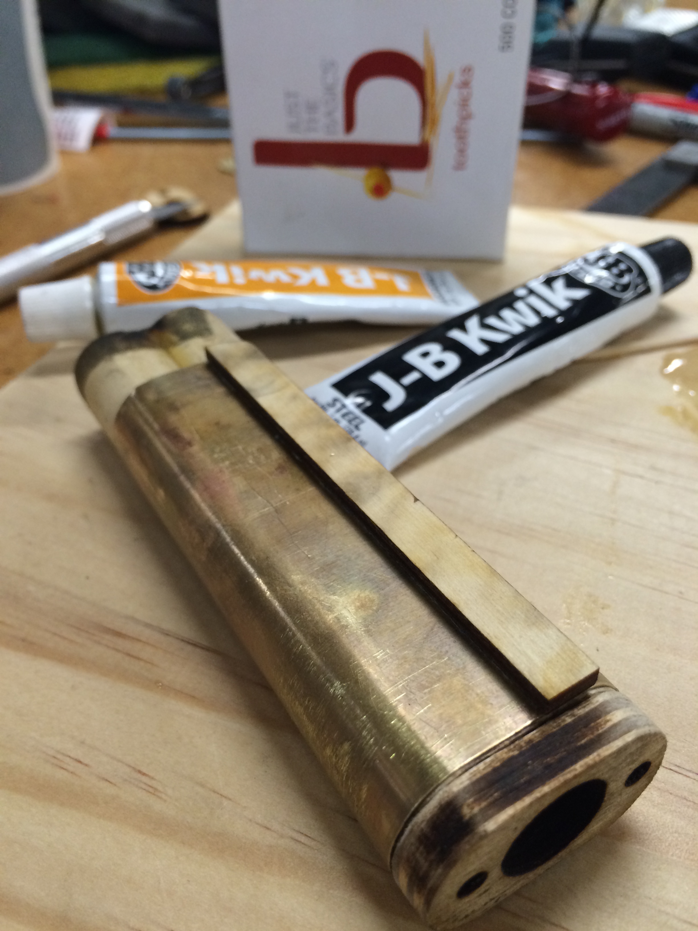

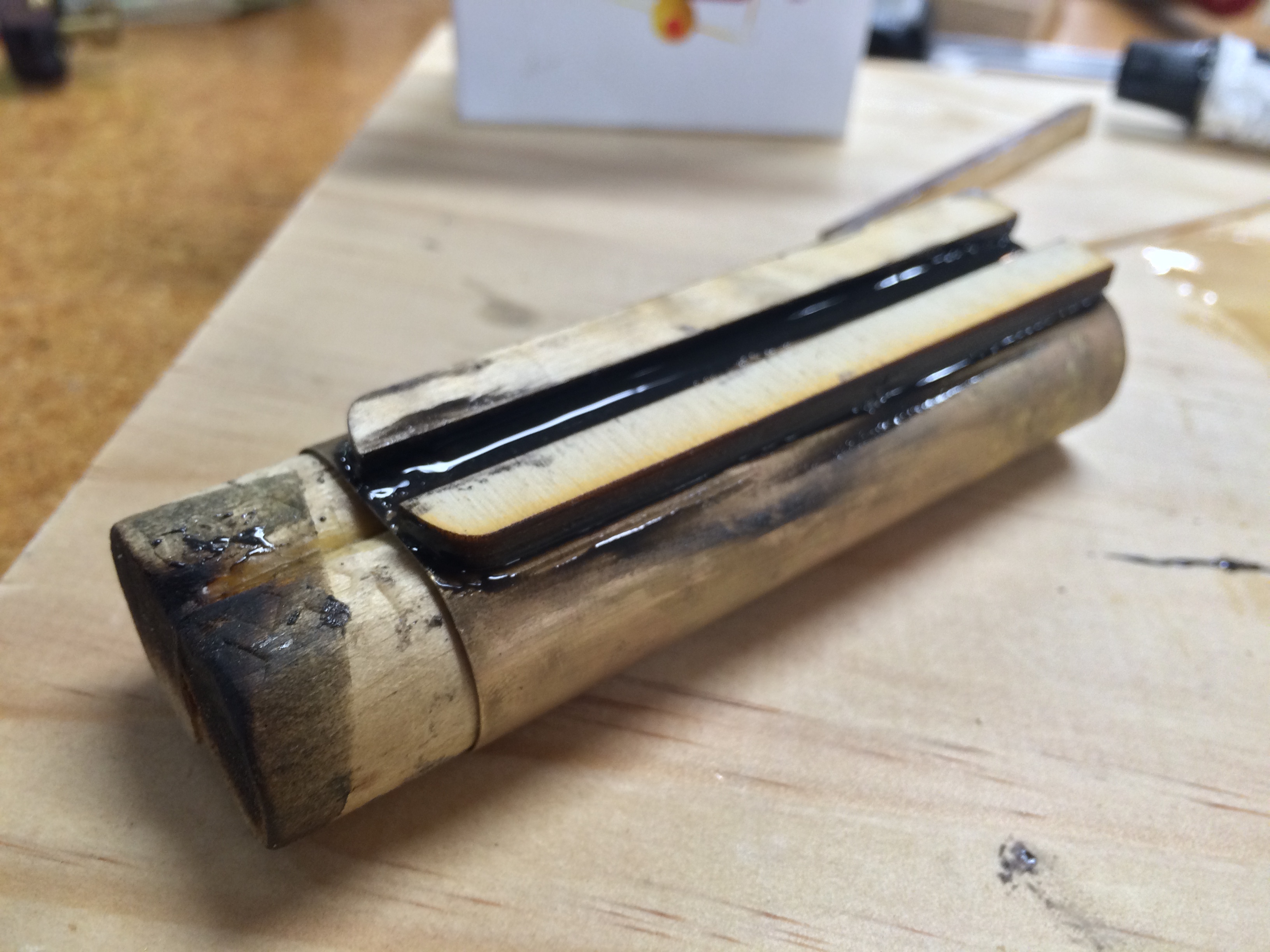

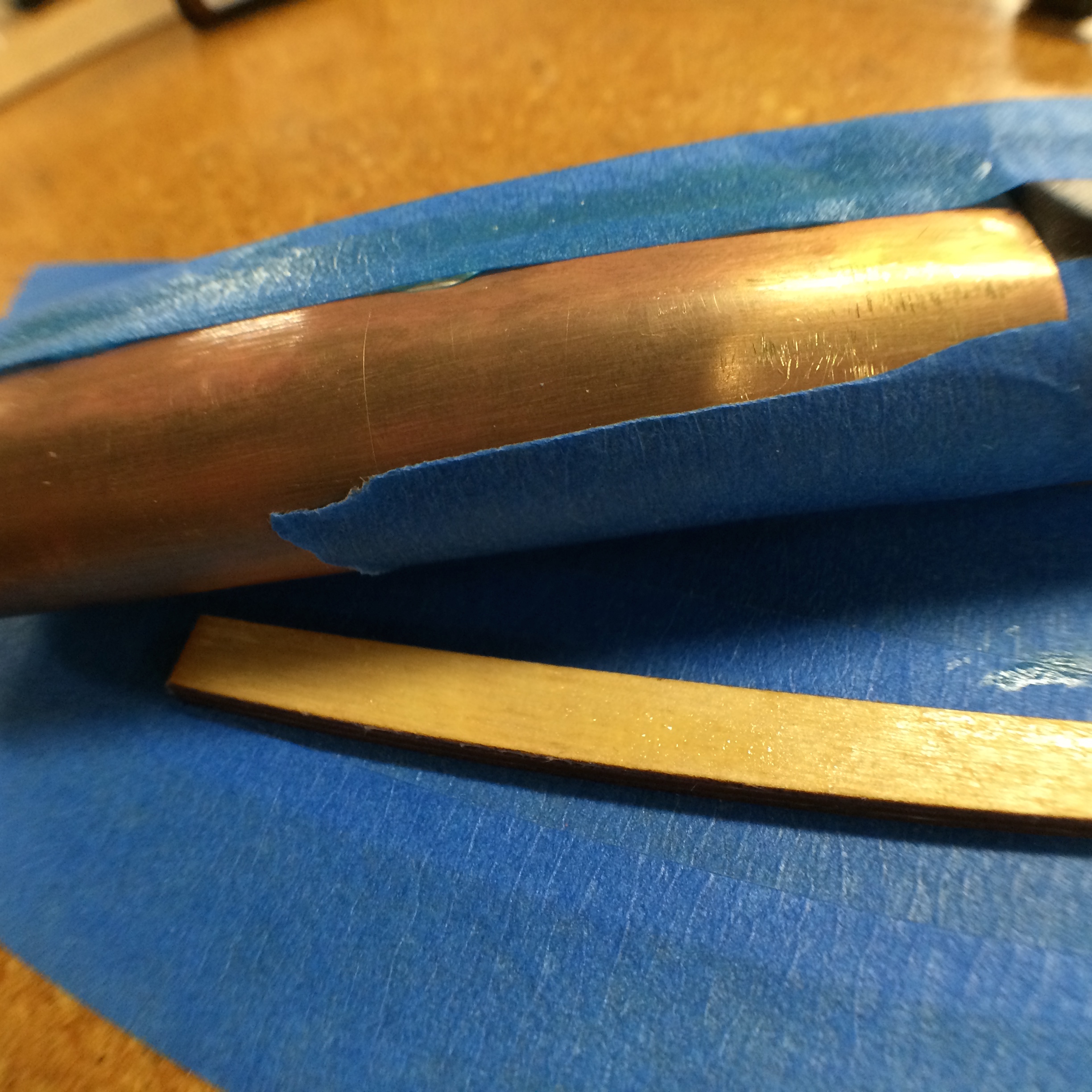

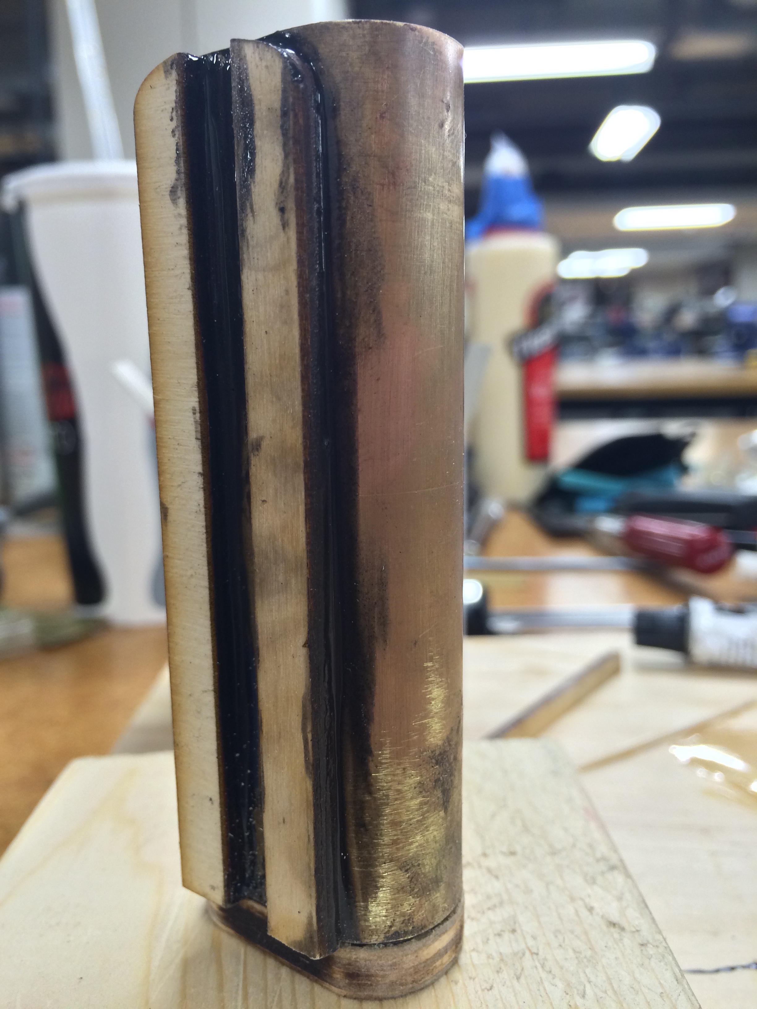

And now we're in the home stretch on the handle. I tried a different method for lining up the popsicle sticks -- tape, scribing marks into the handle, and contact cement to get my initial line-up.

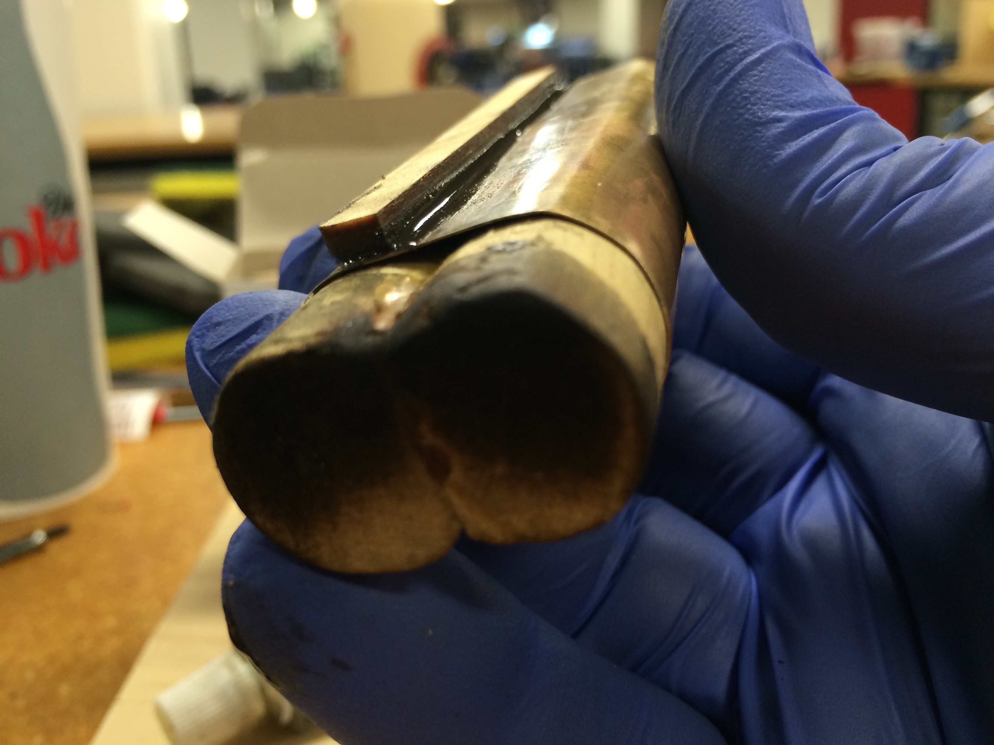

Because of the contour of the handle, you get a gap on the outside, which is actually helpful, because you can work the JB-Kwik right into it.
I use the gloves whenever I work with epoxies and fillers now, since it lets me use my fingers without having to keep cleaning off between steps. Basically I just shoved the epoxy into the gap with a toothpick, laying it down really, really thick, then I wiped off the excess with my fingertips. I used the epoxy very liberally, so I've got a pretty good bond in there. If you pay attention, you'll see I have the handle on the wood form for a lot of these shots. Helps avoid denting or bending the handle out of shape. Even so, I still have to give it the occasional whack with a mallet to fix something. No biggie, the dents come right out.
Once the sticks were all on (which is a bigger pain than I'd like -- I'm spending part of my off-week designing a jig for this part), I gave it a good coarse sanding all around to take down the grungy deposits from the annealing and soldering, followed by a little rubdown with Scotch-Brite.

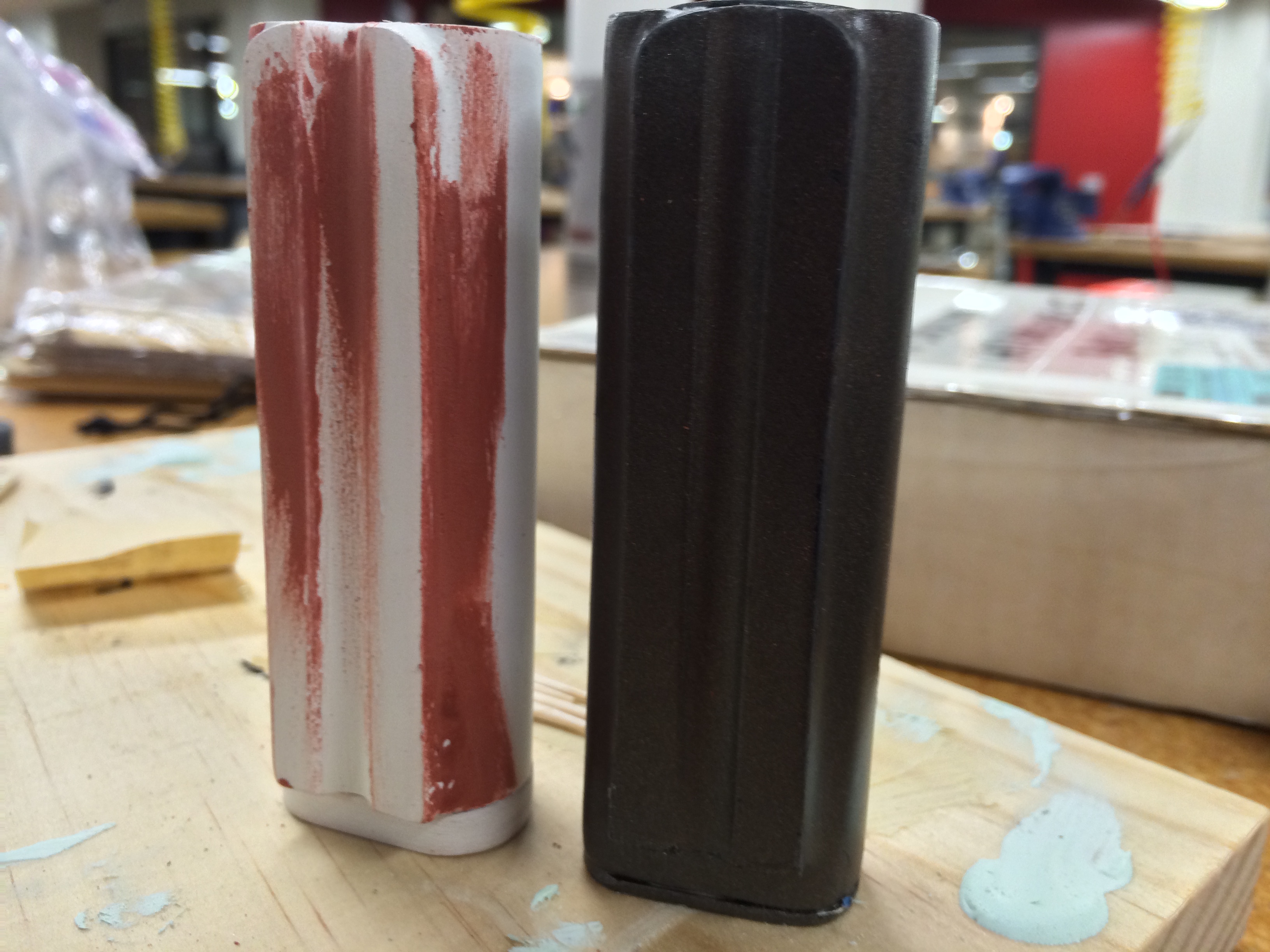

The first couple coats of primer...

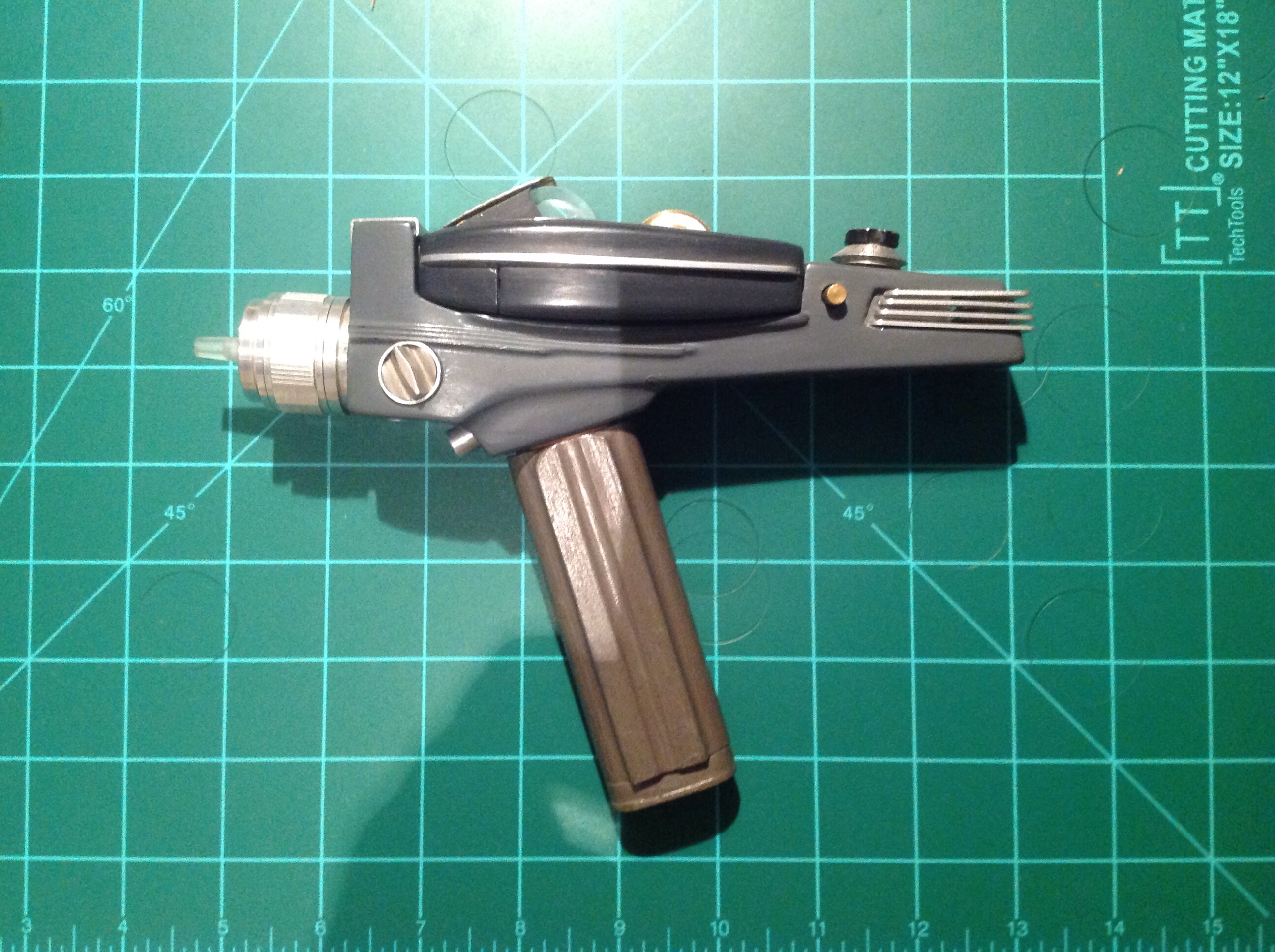

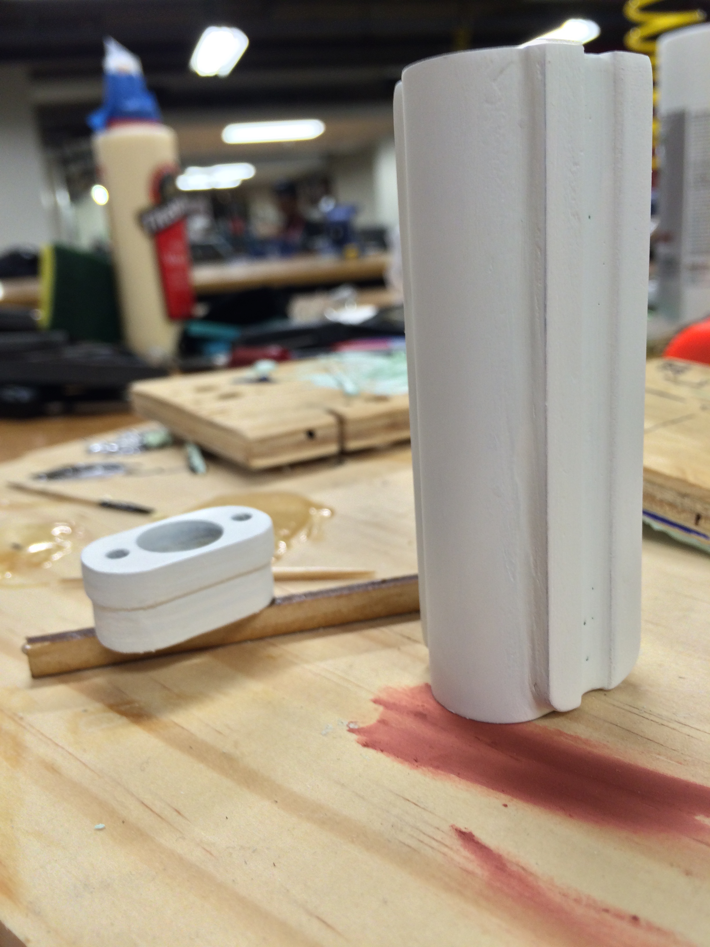

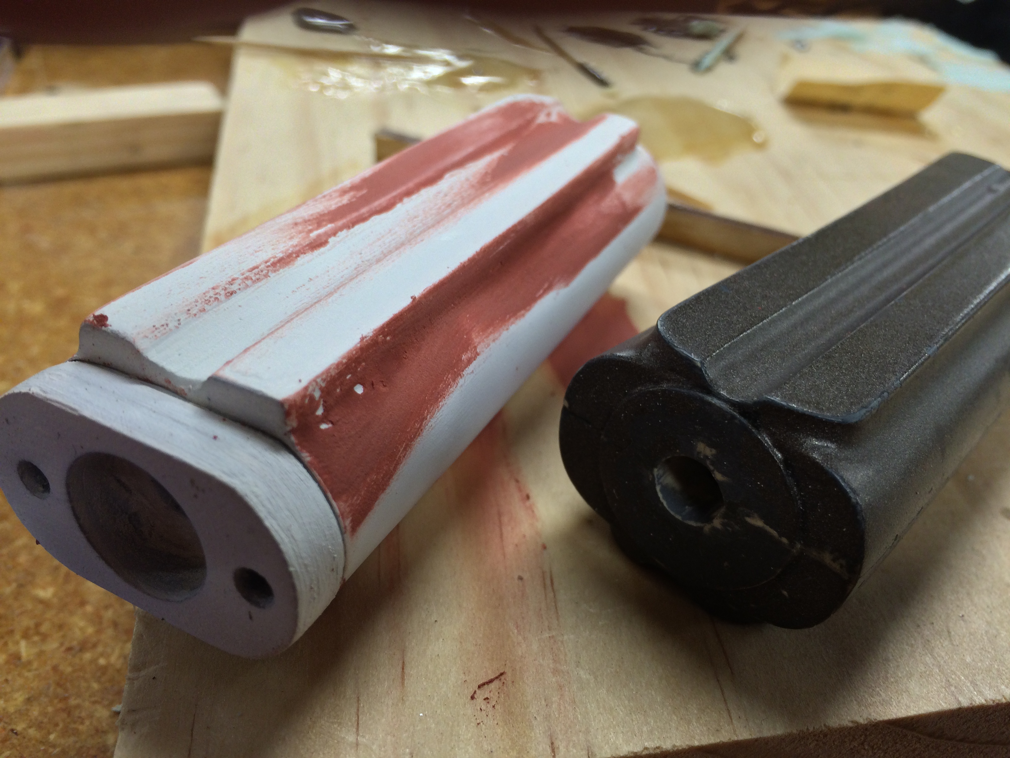

And ye olde Bondo spot putty. Now it suddenly looks like a phaser handle! I'm using Duplicolor white primer at this stage for reasons I know I don't have to explain to this crowd. The final color will of course be the Rust-Oleum Dark Bronze Metallic, which is the only rattle-can color that's ever been visually matched to GJ's original in direct sunlight, and it's an absolutely perfect match. All those other grayish, gunmetal, platinum, etc. colors mentioned around the web come from people who've never seen the GJ hero in person, so I don't put much stock in them myself. Of course, to each his own -- some people like those colors, and this ain't no commie dictatorship. :)
So this handle is now finally turning the corner and heading home. There will be a few more where it came from...
... but for now, this is the handle I'm going with for this build, and I'm incredibly happy with it. Not bad for my first-ever (not counting 274 ****-ups) scratch-built handle if I do say so myself, which I do, so there.

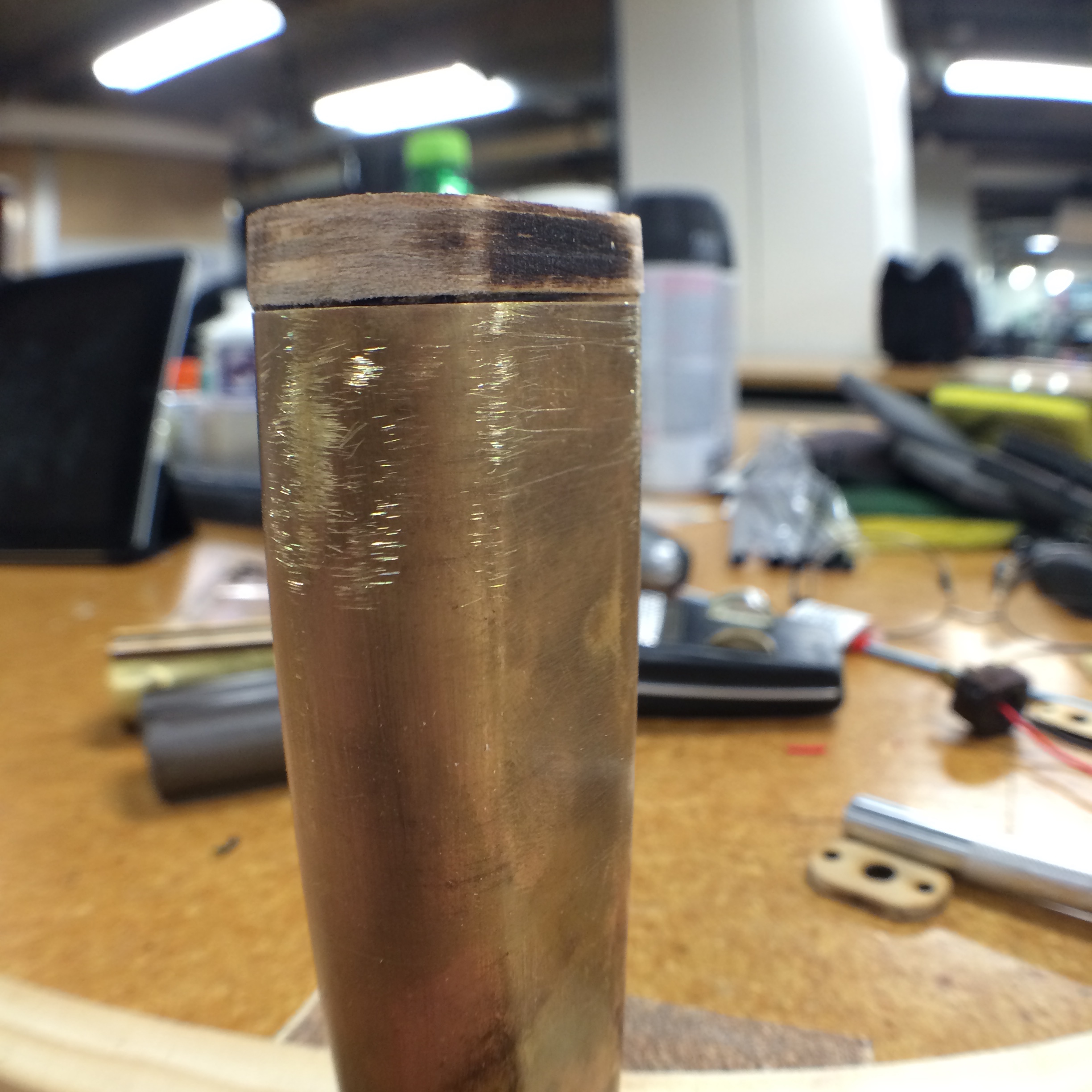

Absolutely. Then I realized it would be getting putty, paint, and primer, so I sanded it down to a loose fit. That turned out to be a good idea. :)
Basically, there's no way to predict the exact diameter of the handle to create a perfect fit beforehand, at least none that I know of. Even 1/64" of variance can throw off the fit. So I always knew there would be some final sanding to shape with the wood parts in that area.
If you look closely back at the photos of the wood plug parts right out of the laser cutter, you'll see I even left in a sharp corner where the straight face of the handle meets the curve. Rather than spend another 20 minutes tweaking the bezier control points in the artwork, I just decided to sand it away during construction, since there's just no escaping the need to use sandpaper to get down to your final contours anyway.
