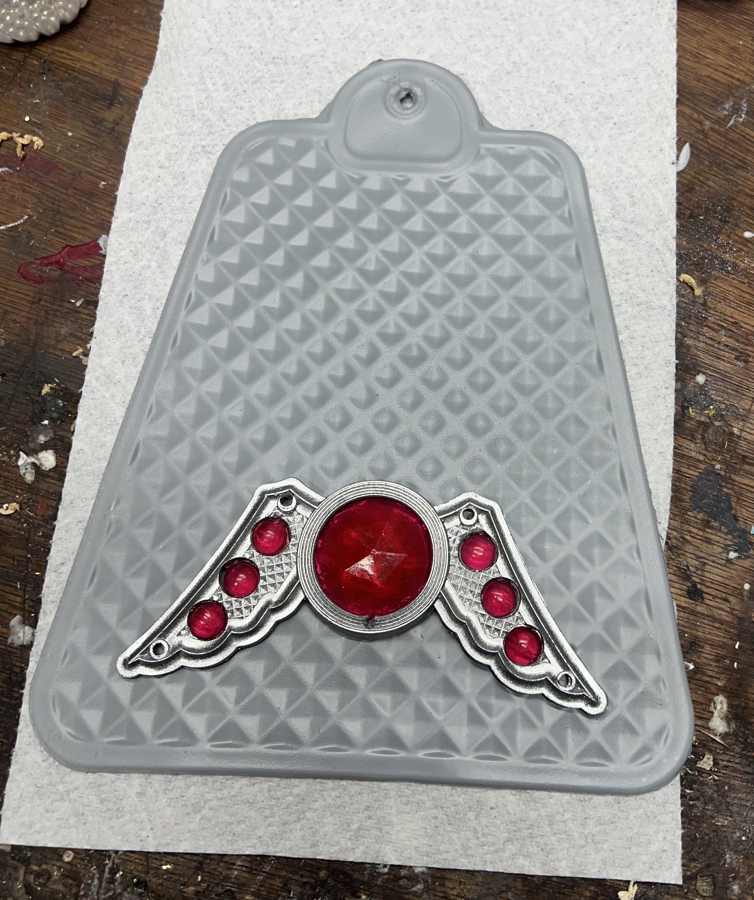

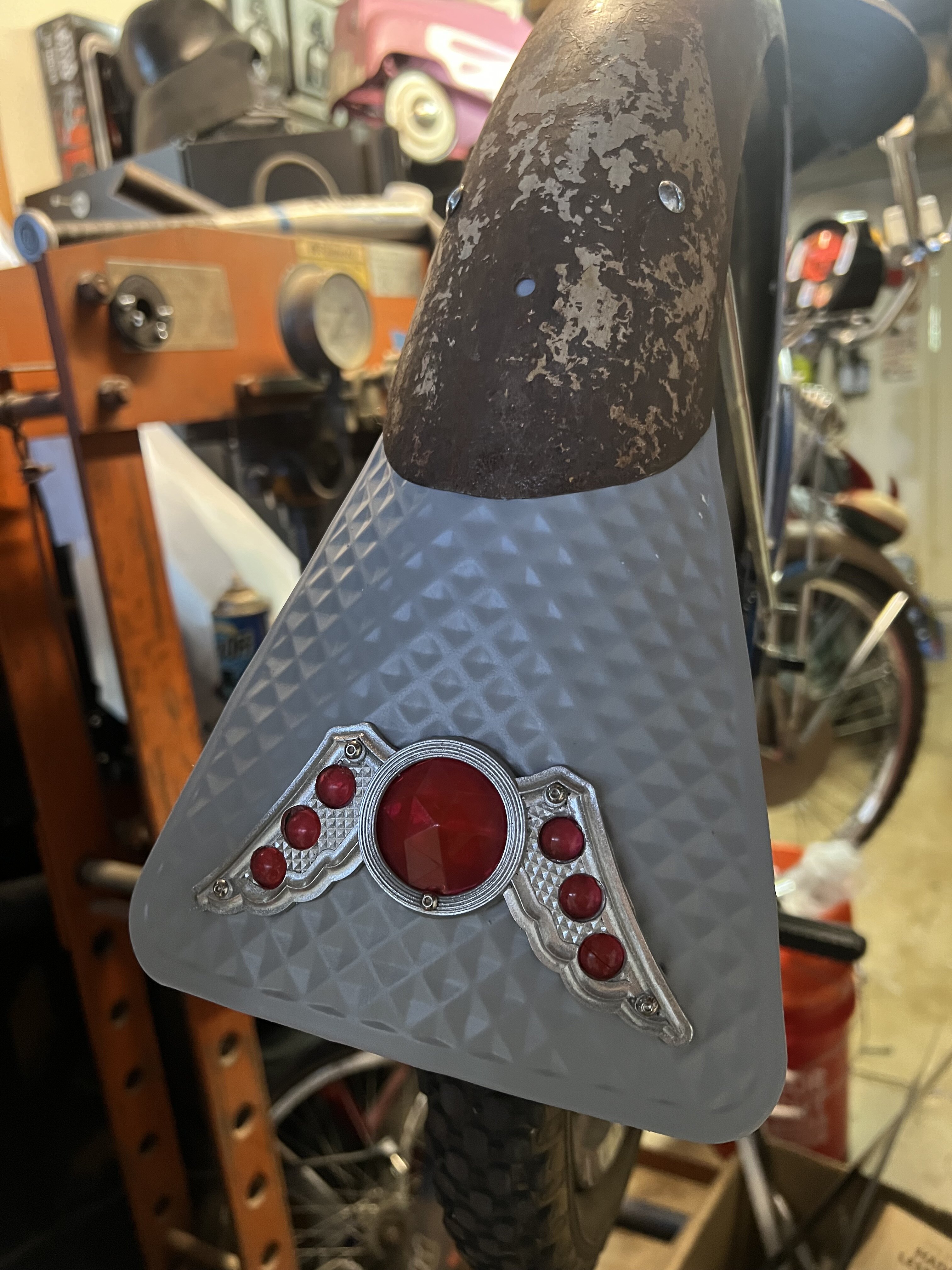

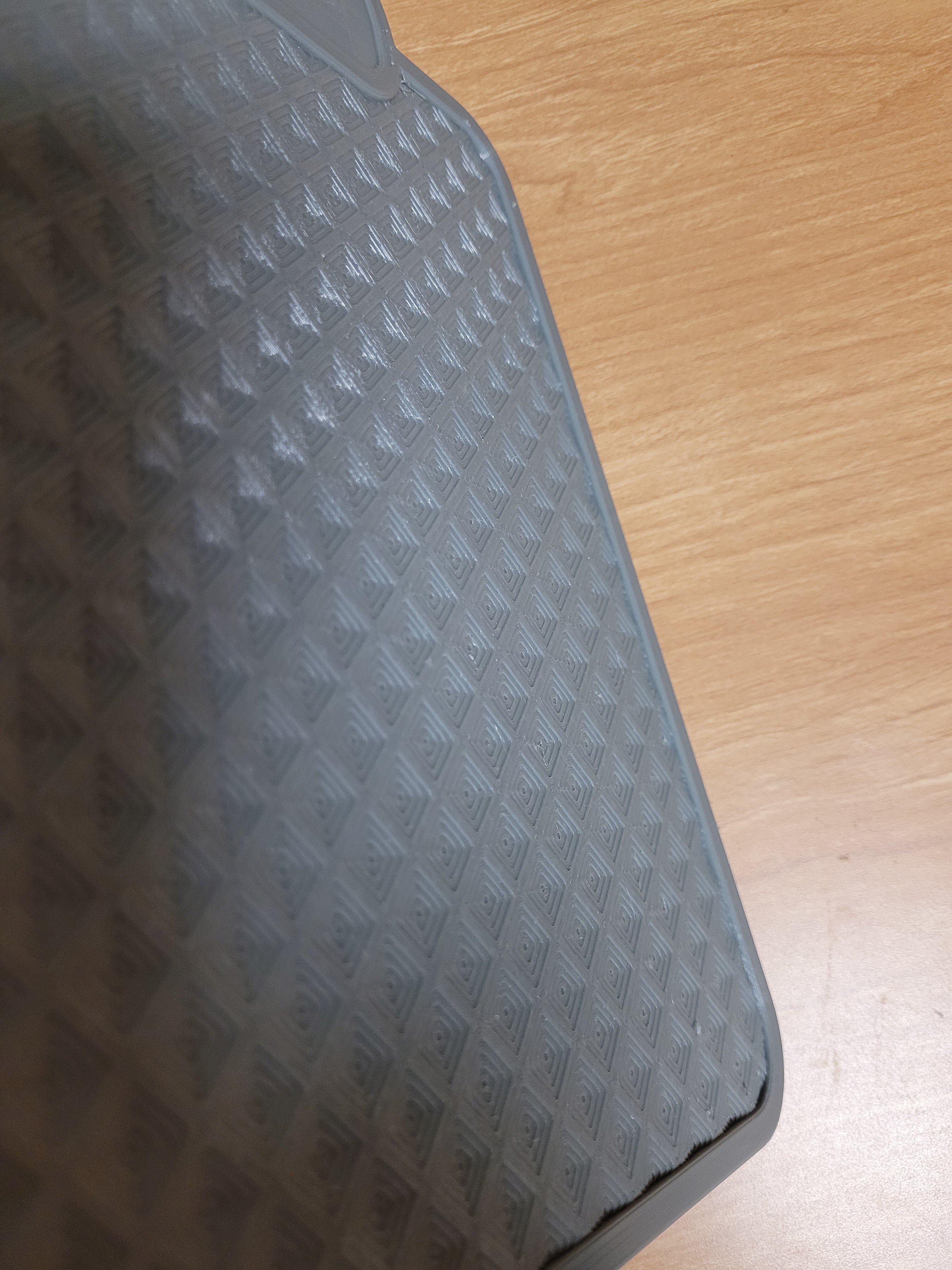

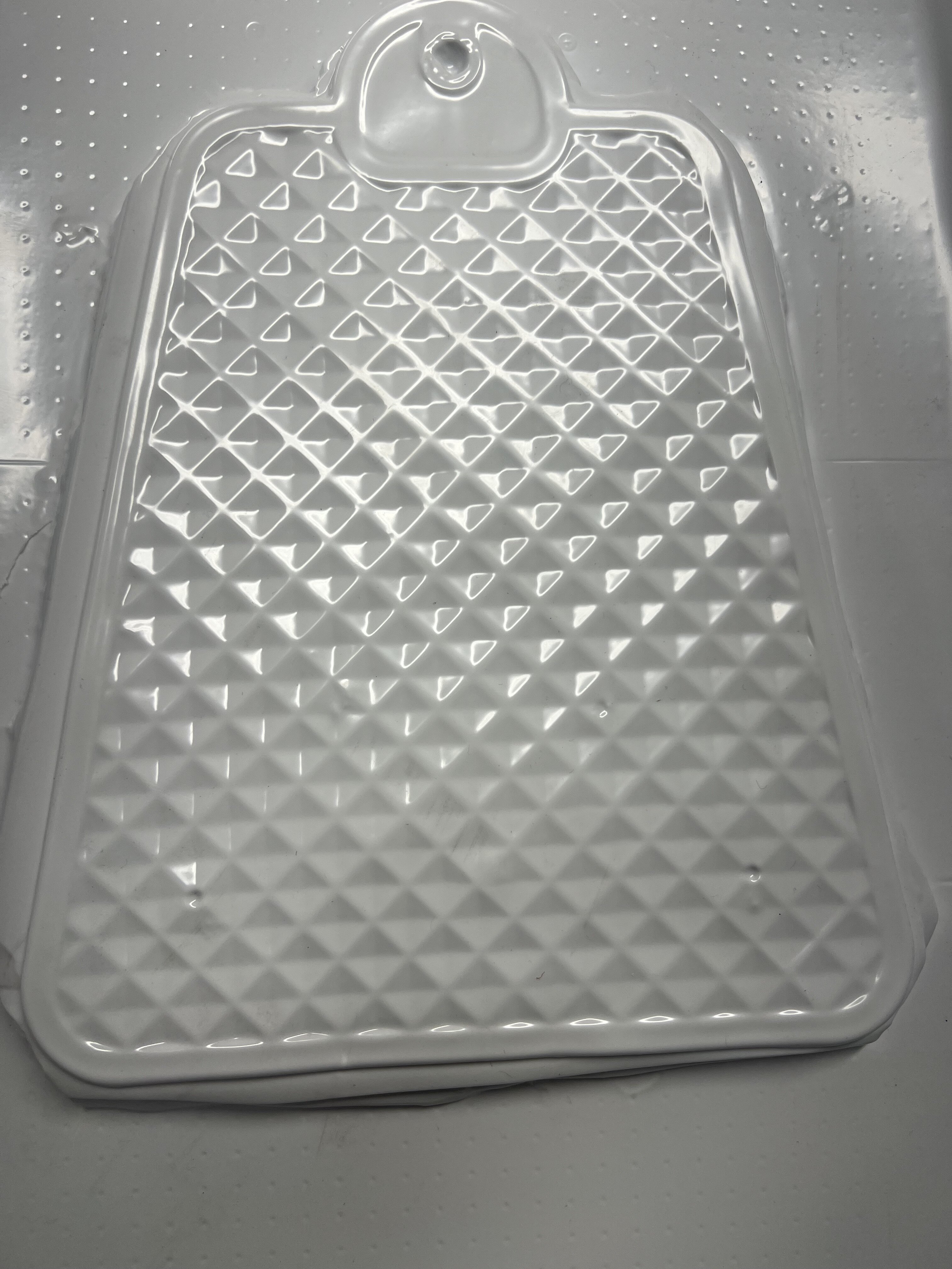

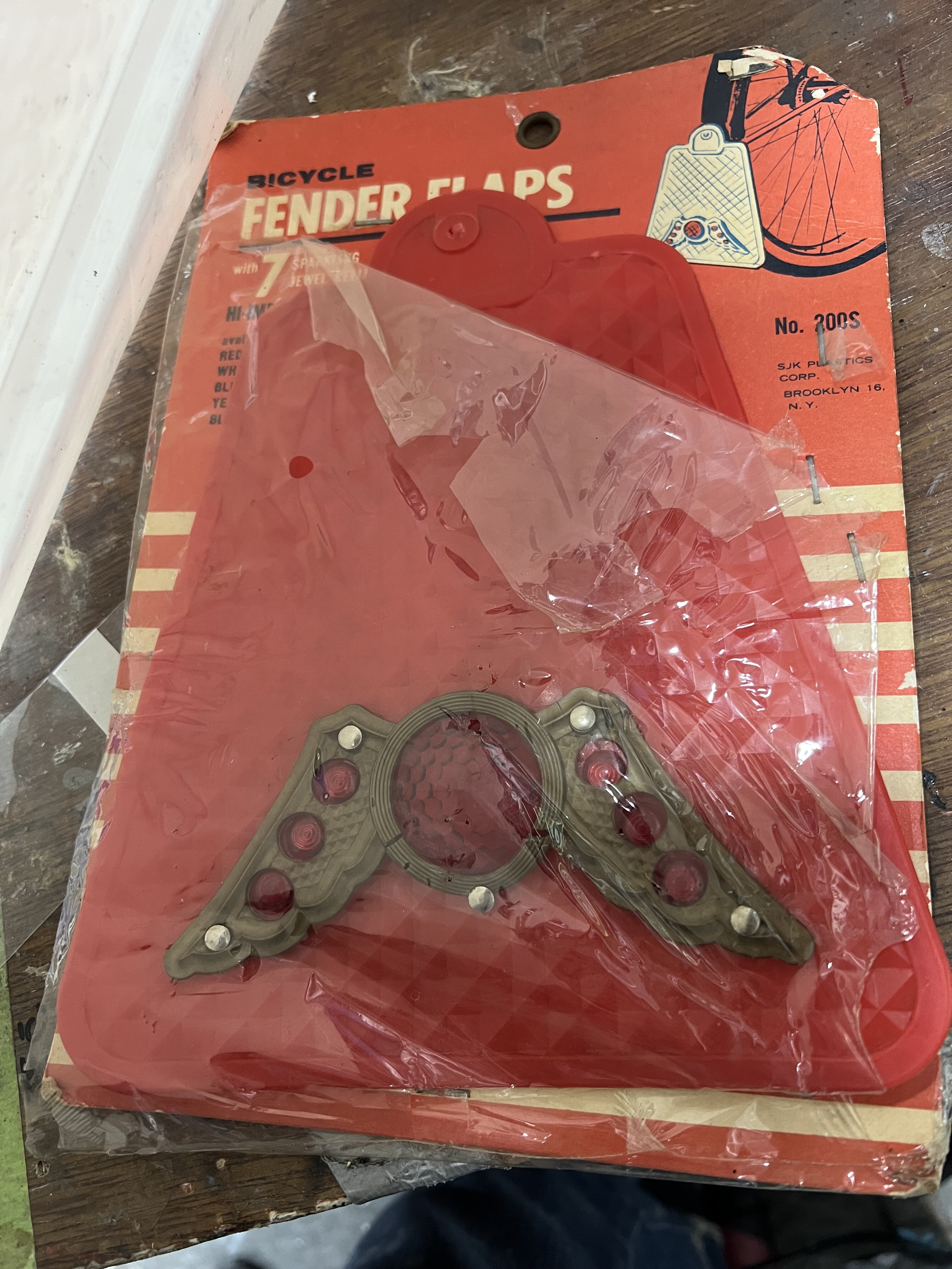

Wanted to try something and I think it worked out ok. This is one of the softer pulls .Got a real mudflap, cast the wing and jewels, then vac formed the flap. I may still cast some flaps in rubber but this was pretty easy. Going to find some rivets to replace the Allen bolts as well

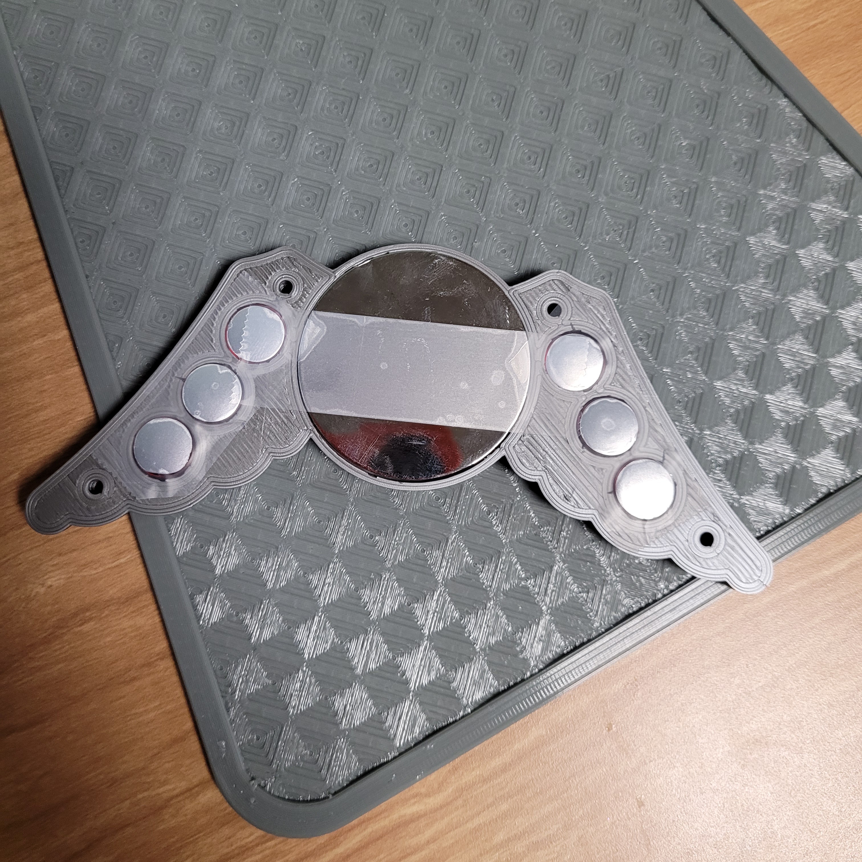

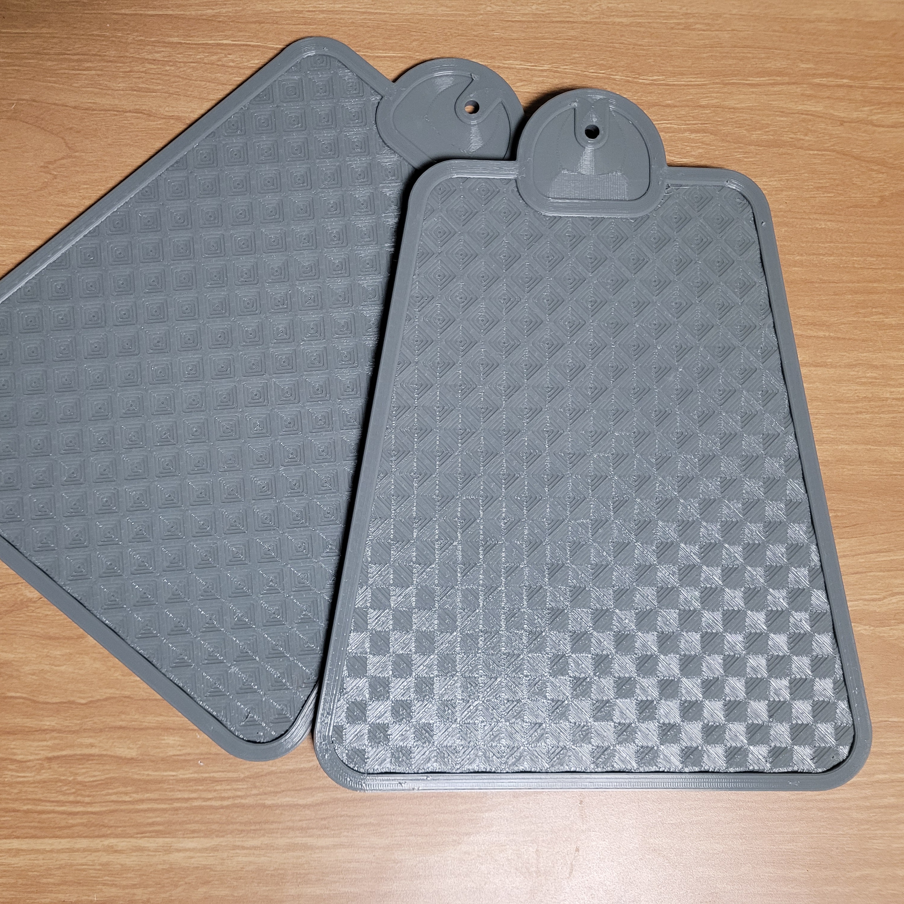

I did revisit my 3D file for the mudflaps. I got someone to print a couple for me in TPU. Definitely better than my attempts.

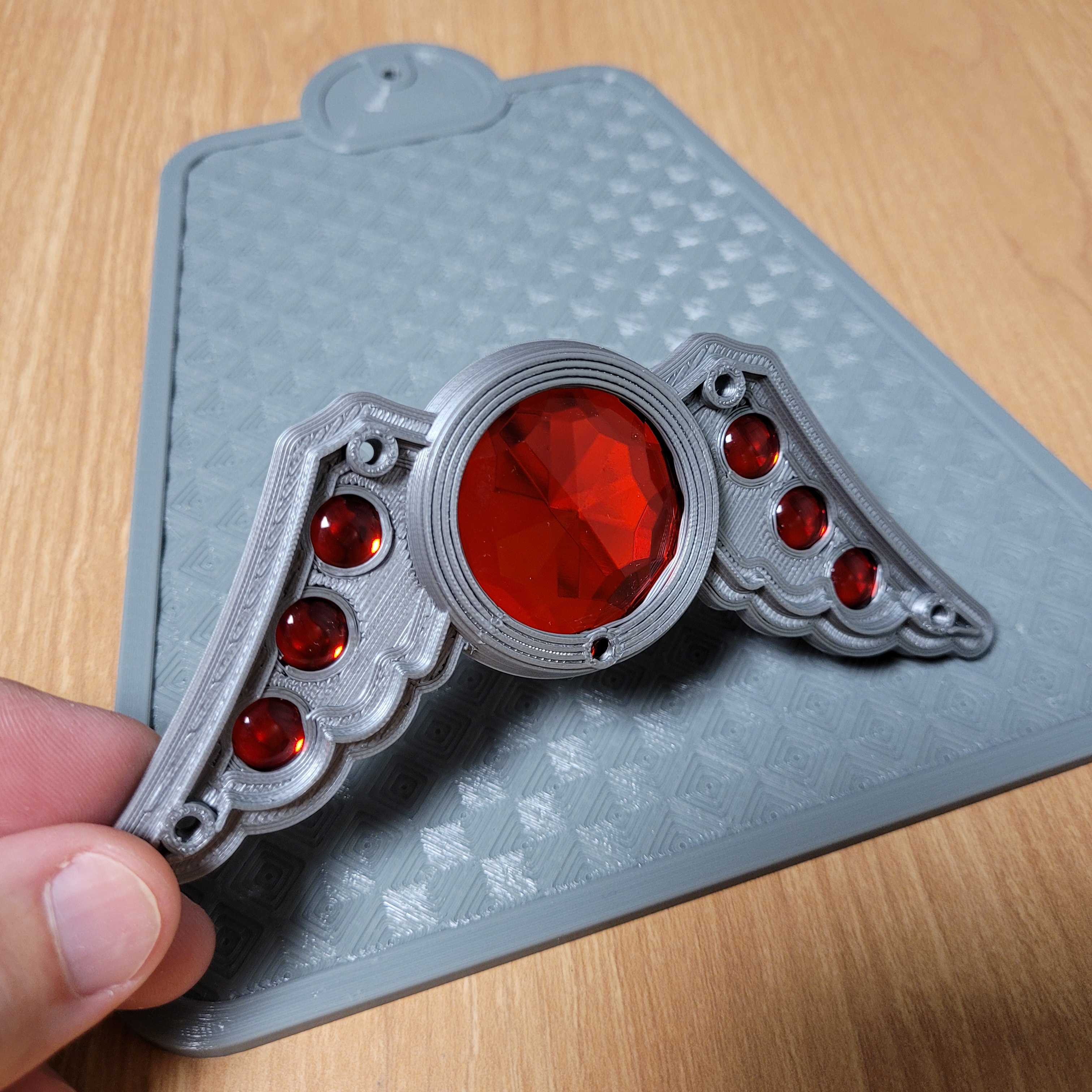

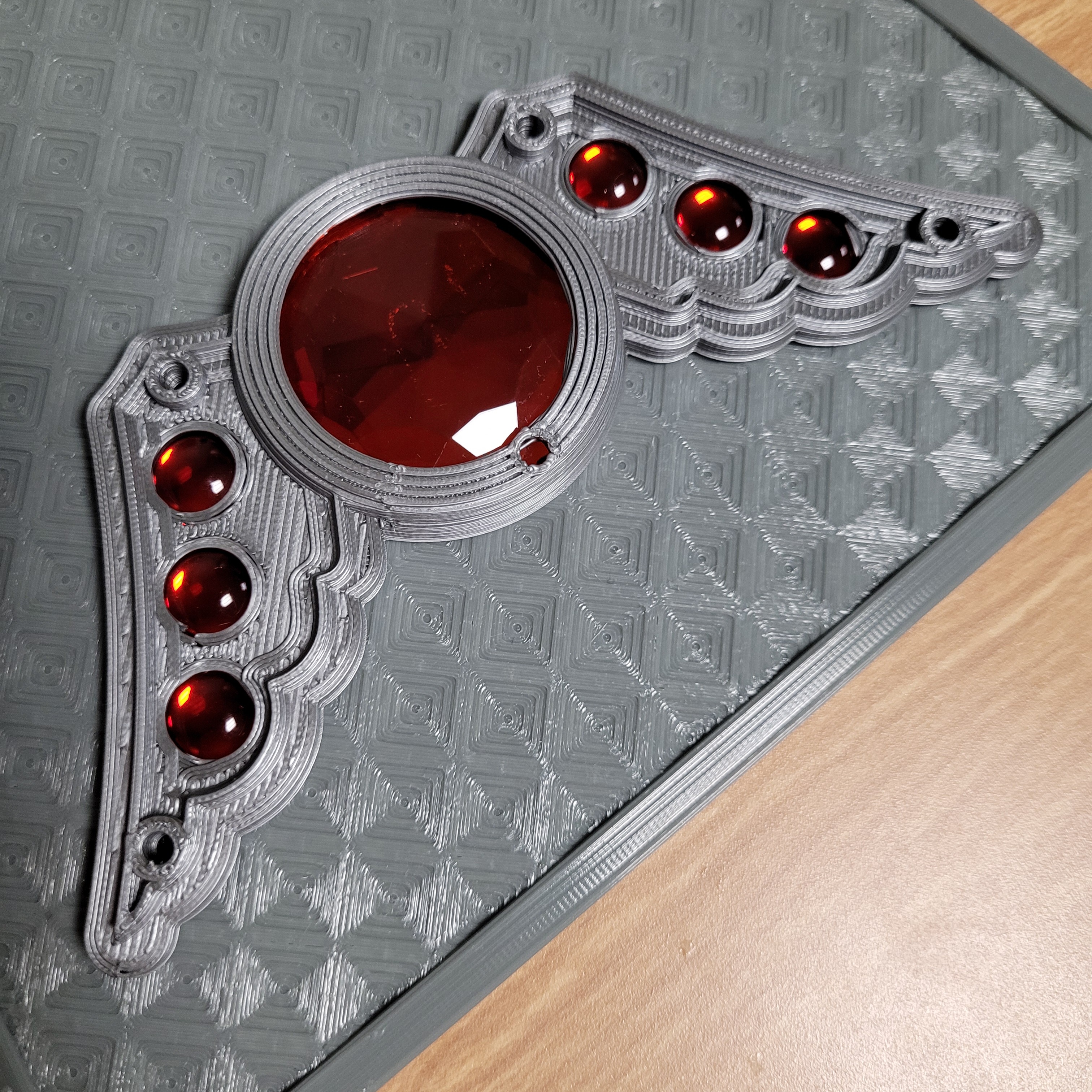

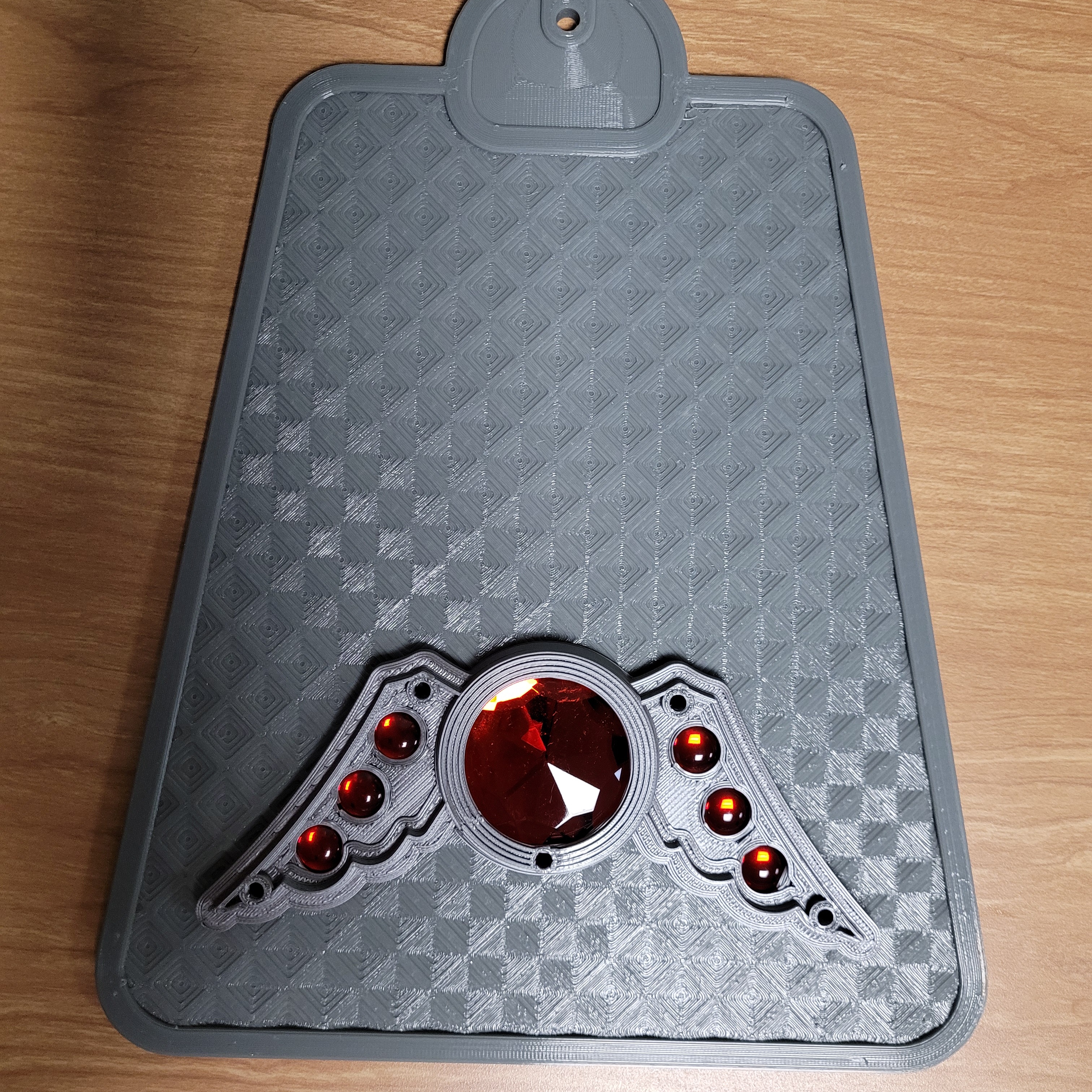

Printed the wings in silver-colored ABS. Jewels are acrylic. Like the durability of the ABS but detail not great.

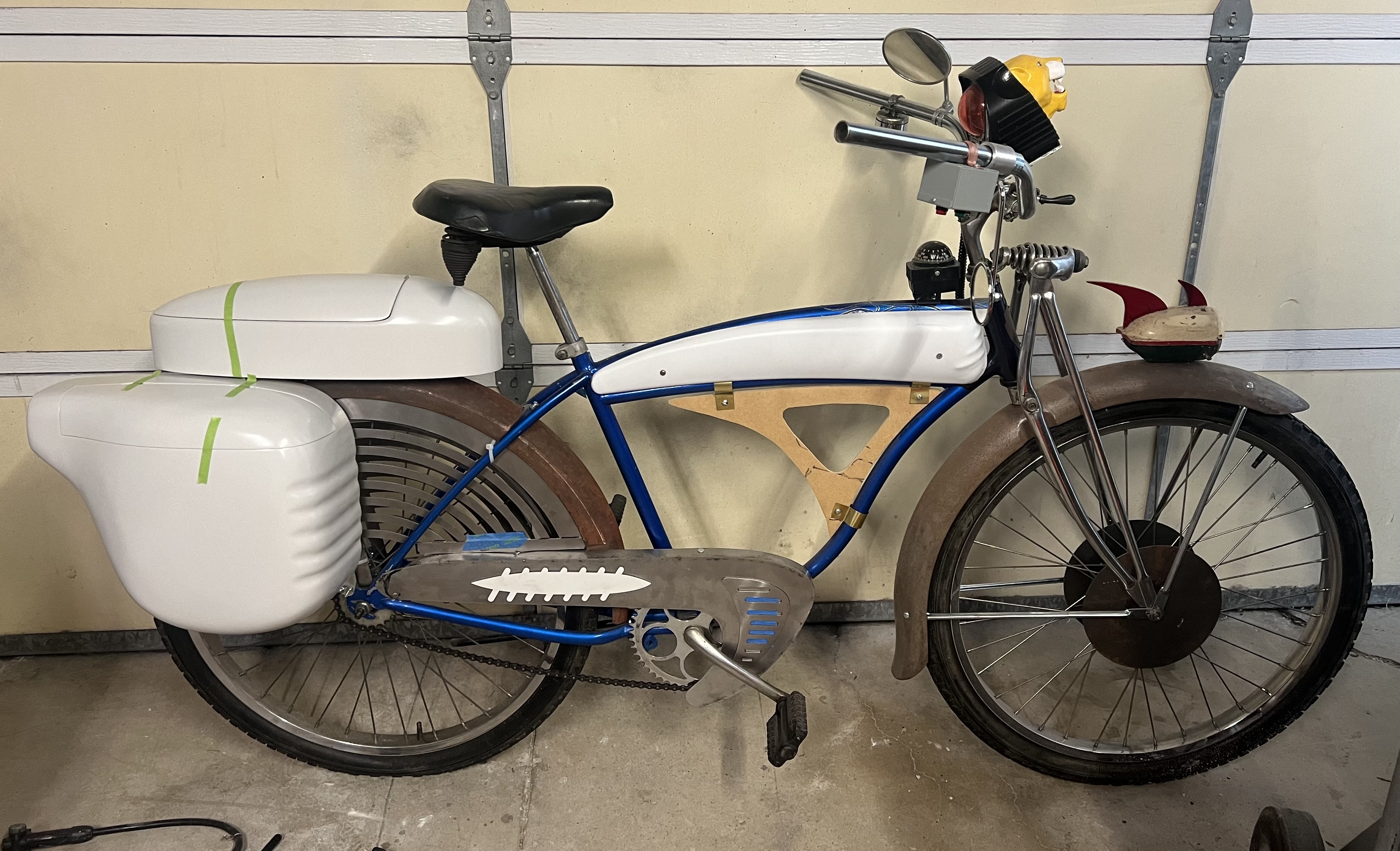

The bike in the top picture (without Pee-Wee on it) is supposed to be the Tarzan bike? Looks like a replica.
A lot of it is real…the side bags are replica and obviously the tiger..also the center skirt..and there’s some wrong parts used, but it’s the Tarzan bikes bones for sure
