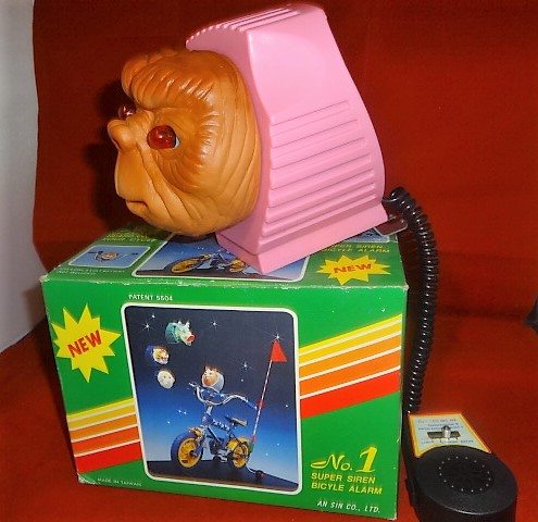

So this is the "Dragon" siren it comes from the same company. If you have the Green Box tiger siren you will see the artwork on the box has a picture of a Dragon siren. The guy that is selling these had like 7 of them, and its the first time I had ever seen one in 6 years or so its pretty remarkable he had so many. There is also a sheep and monkey version but I have never seen them for sale, just on the box.
Yeah, those are cool, I may have to get one for my collection, you forgot the dog, the elephant and the hippo, and they made some that wasn't on the box, like this E.T. I found a while back, the eyes flash with the sound FX, which is extra creepy.

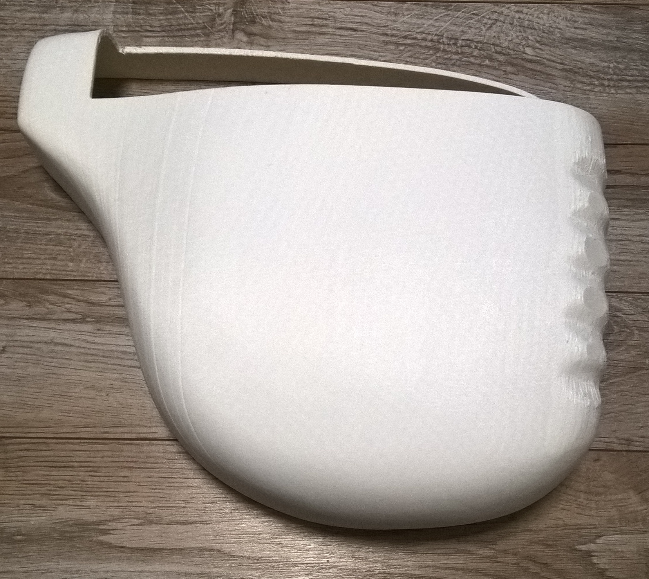

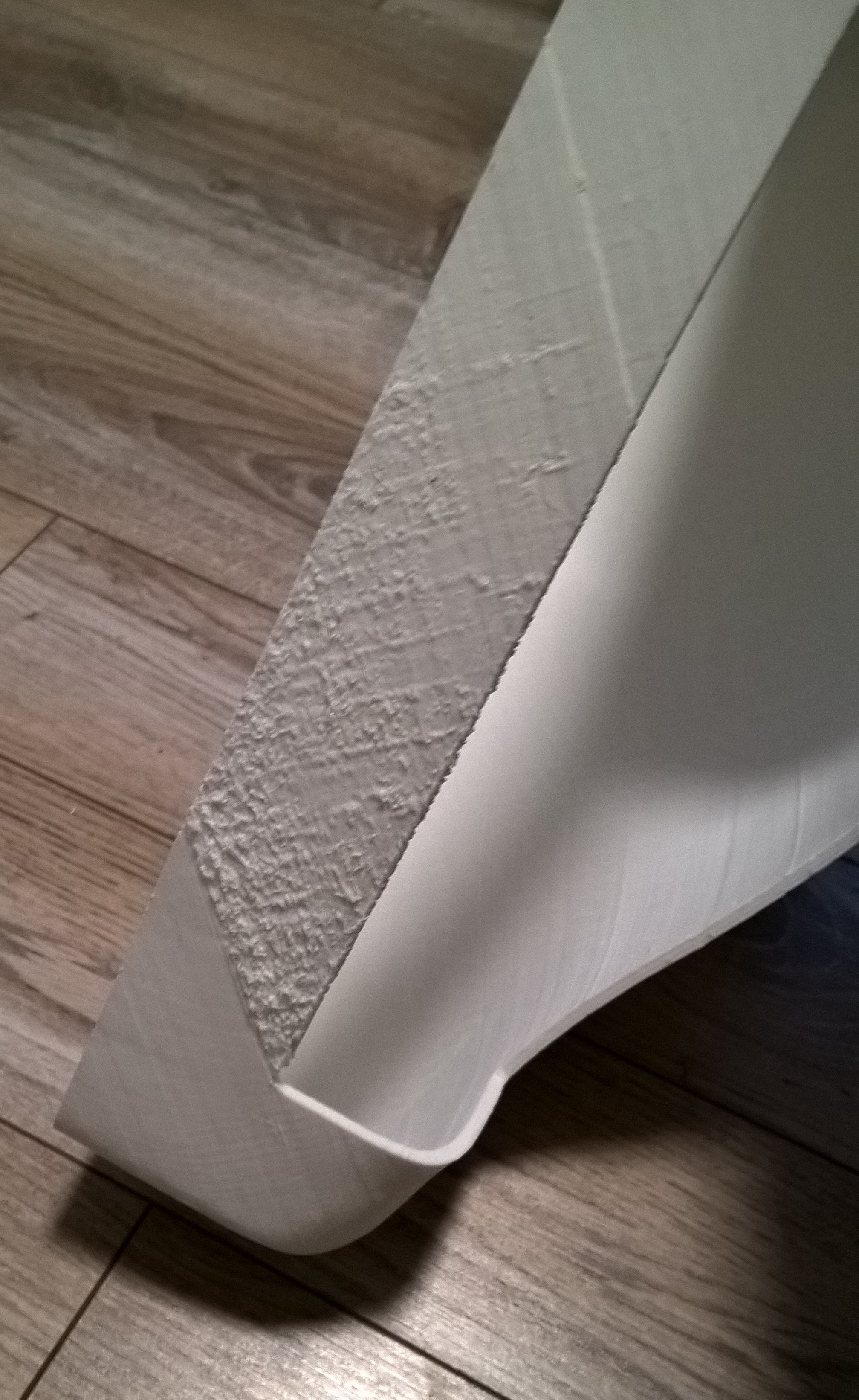

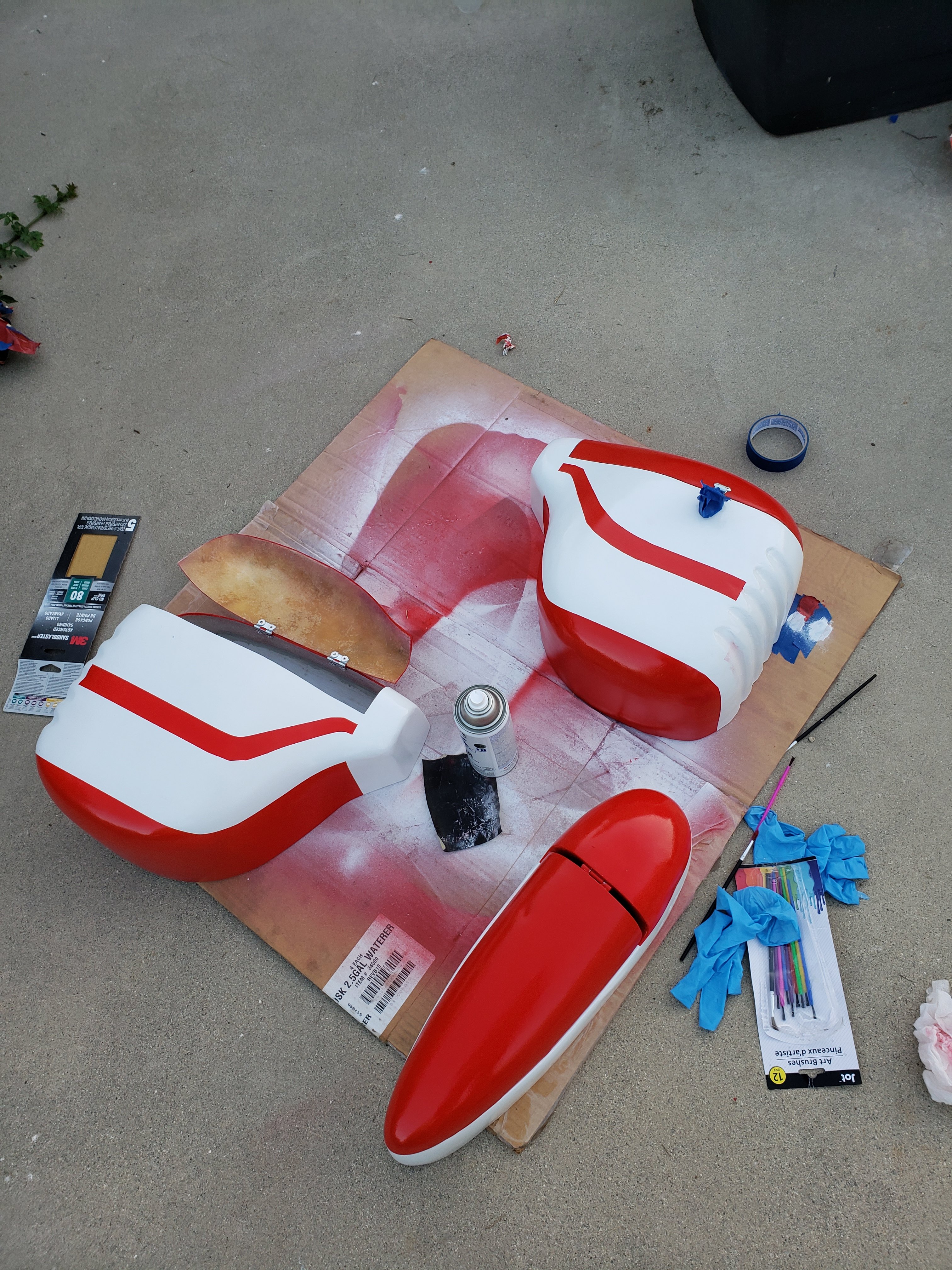

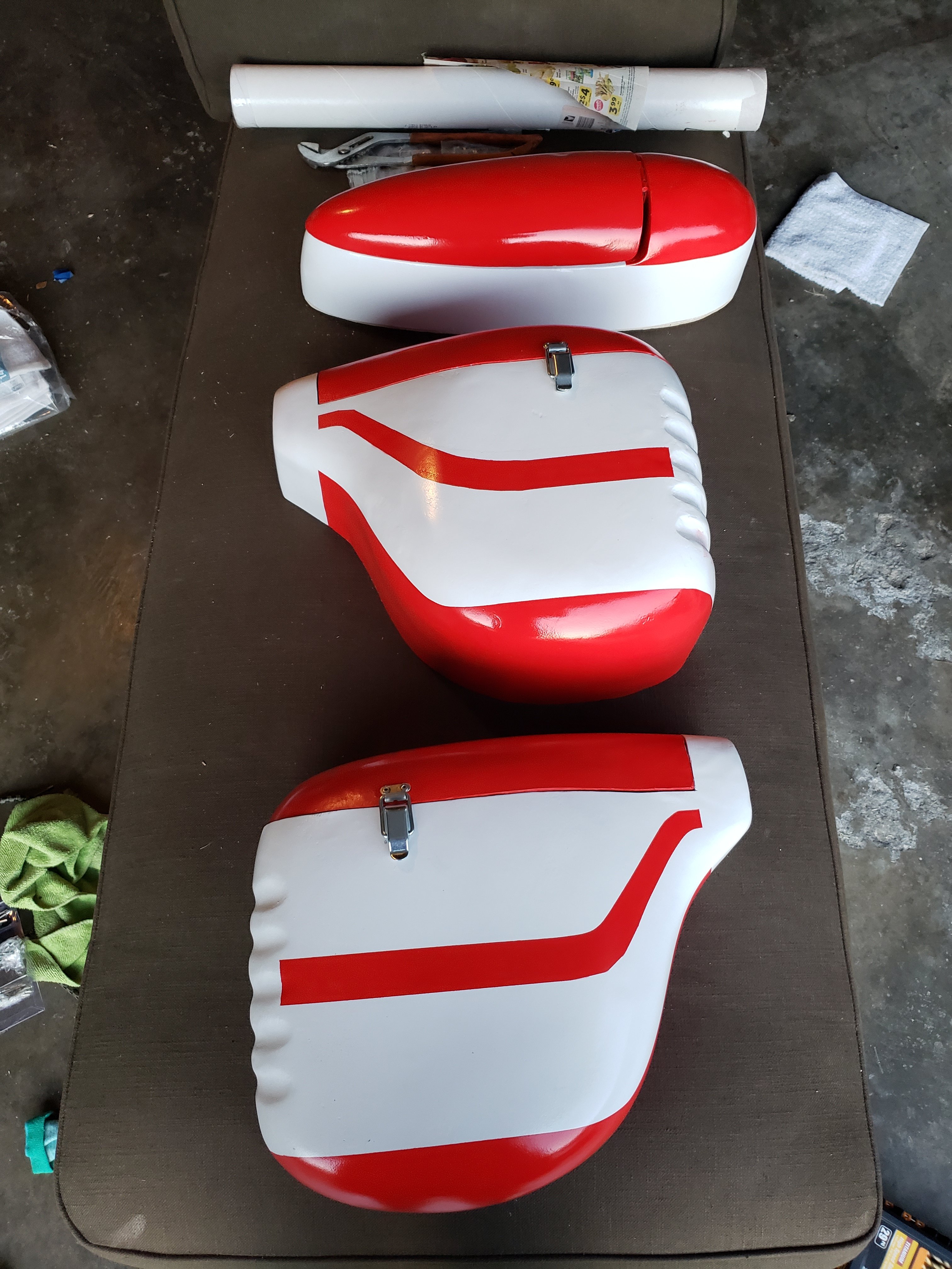

It JUST finished printing!!! Only kidding :) But it did take 4.5 days. Right now I'm just trying to find an optimum print orientation to cut down on print time, and I have added in the door. I am also trying to eliminate as much support material as possible to make finishing a bit easier. Below is a picture of a saddlebag with the door cutout (print time 3.5 days). Its positioning was not ideal and the back strip portion started to vibrate during printing. So, it is a little rough on that strip. I have one printing right now that looks more promising. It should print within 3 days and has much less support material.
Pretty Cool, it looks nice and thick, can't wait to see the first full set printed out, with a console and all, you're making history PWF!, keep the updates coming.
does look like a lot of finish work though, I wish you could print things out like they do in the movies, maybe someday, after all, we're suppose to have flying cars by now too,lol

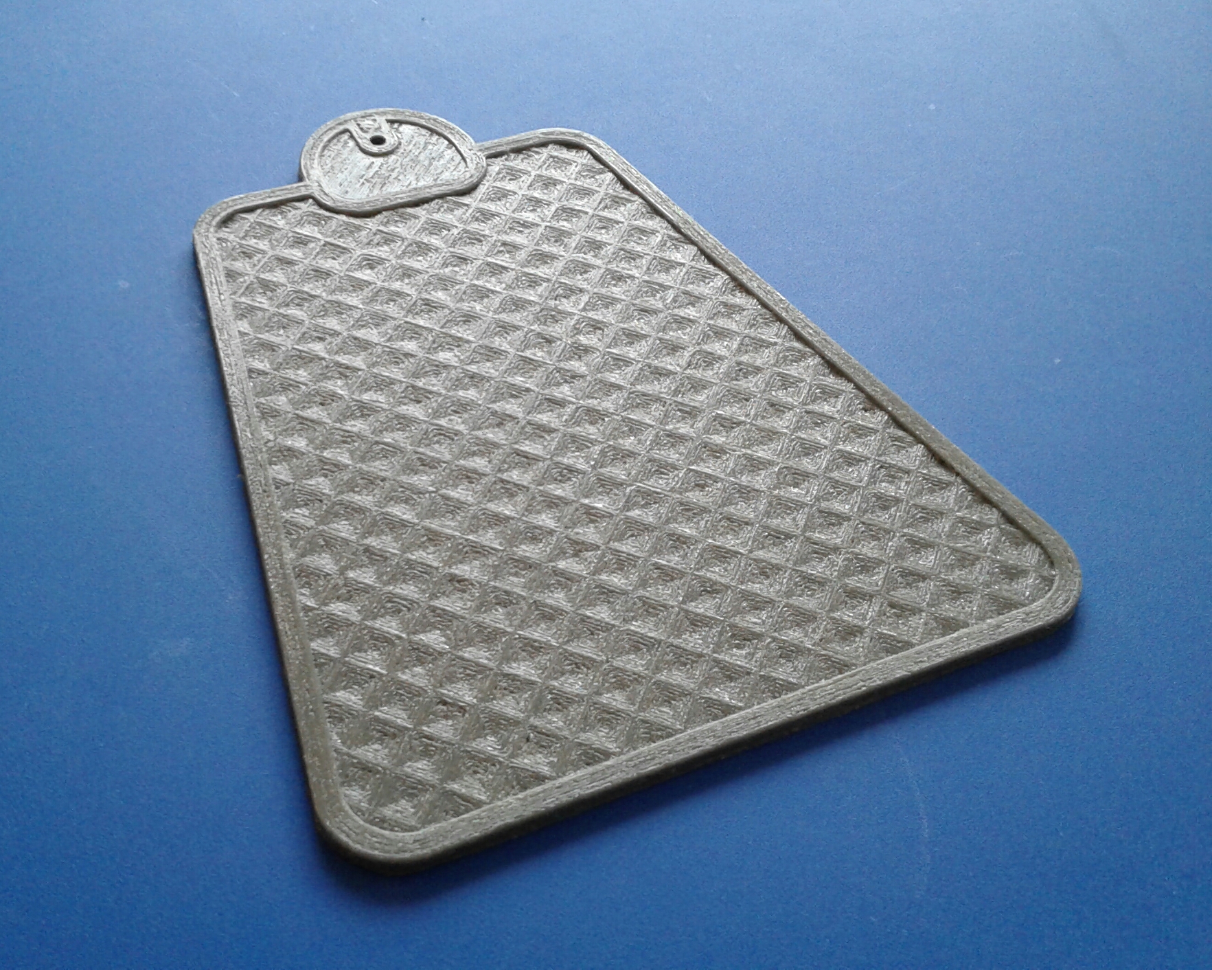

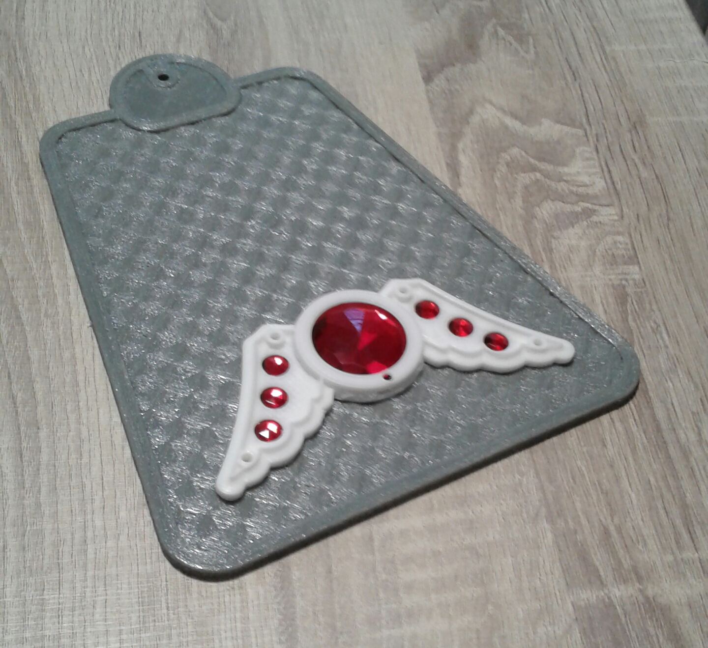

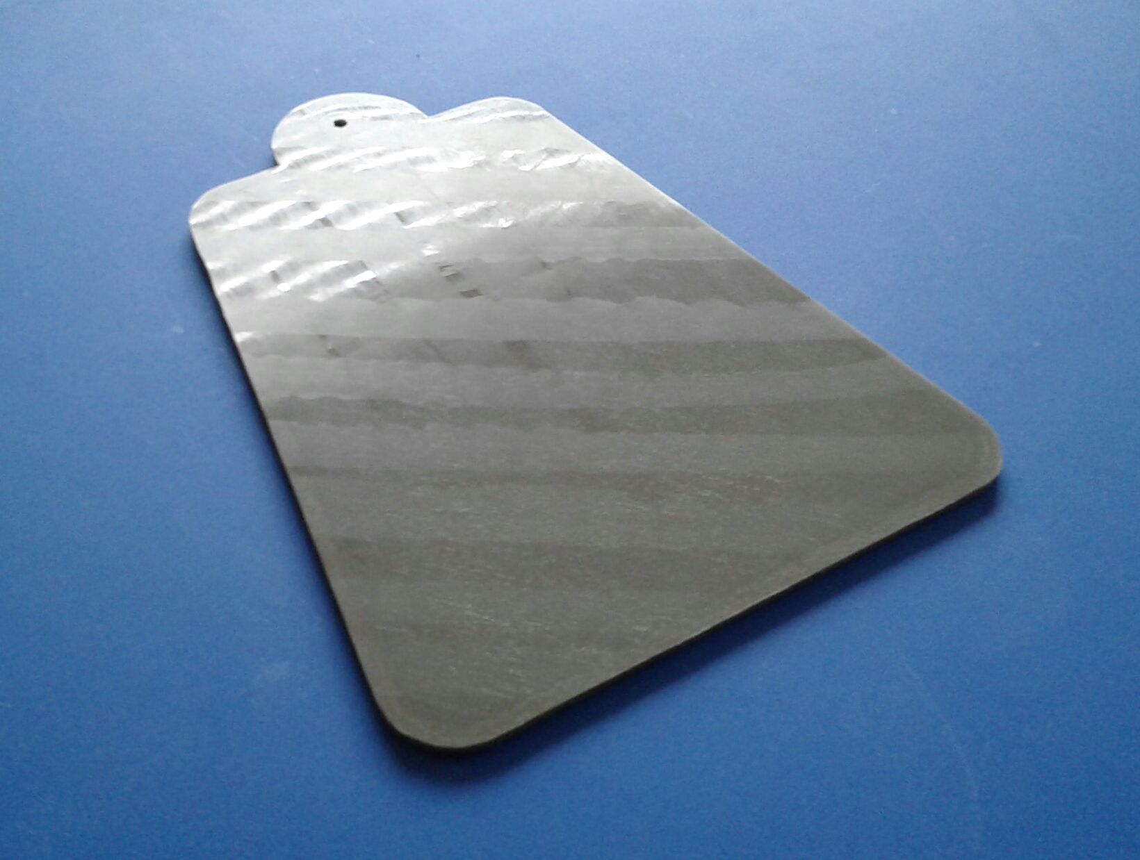

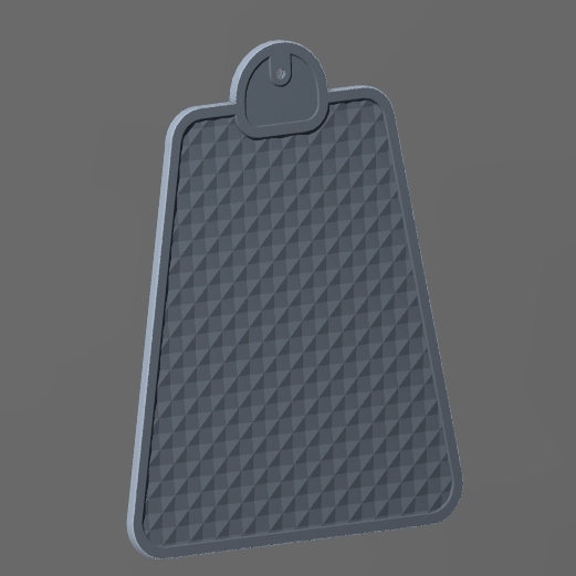

Found a little time to tackle 3D modeling of the mudflaps. Used one of the rubber/resin replicas for measurements. I am thinking of printing the flap using TPU filament. Looks like there are also some nice options in silver-colored filament for the emblem. Actual reflectors are probably not an option. So, considering using acrylic gems/jewels instead. Once I find a good source, I can modify the emblem to accommodate.

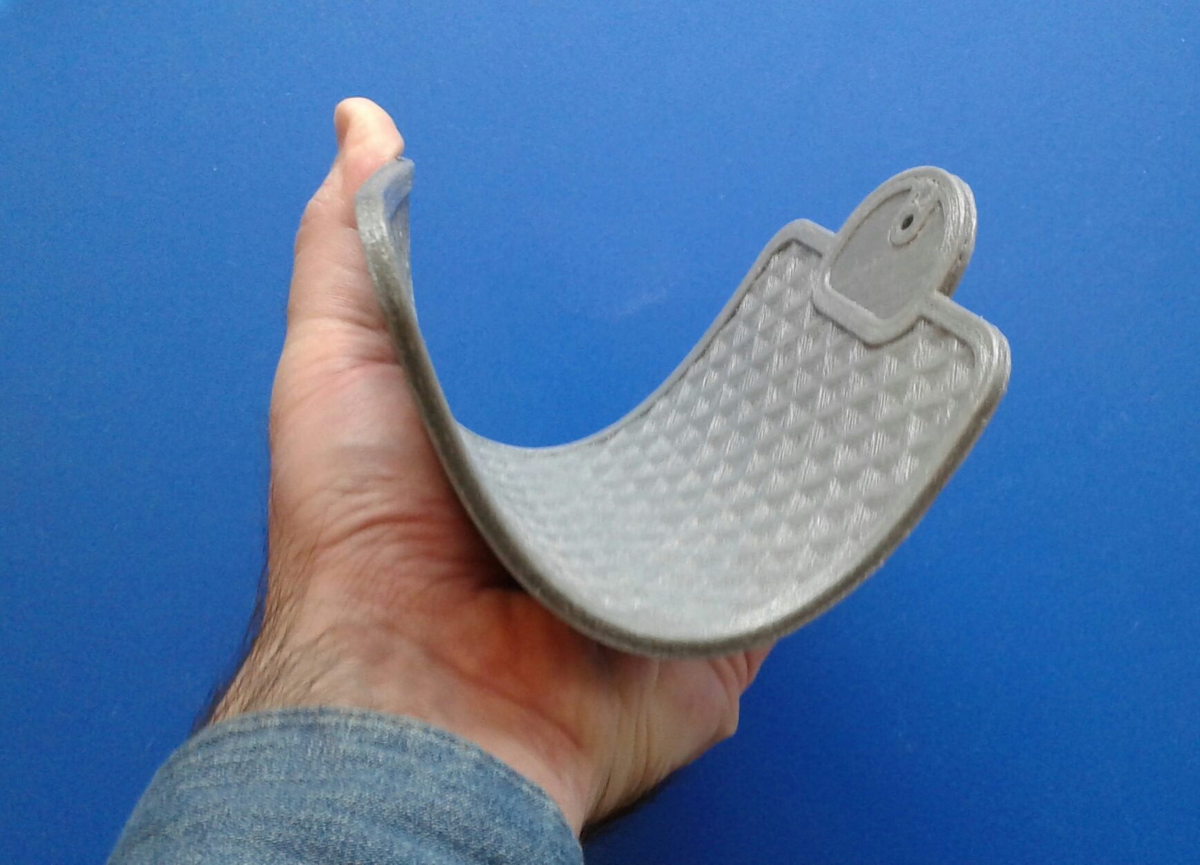

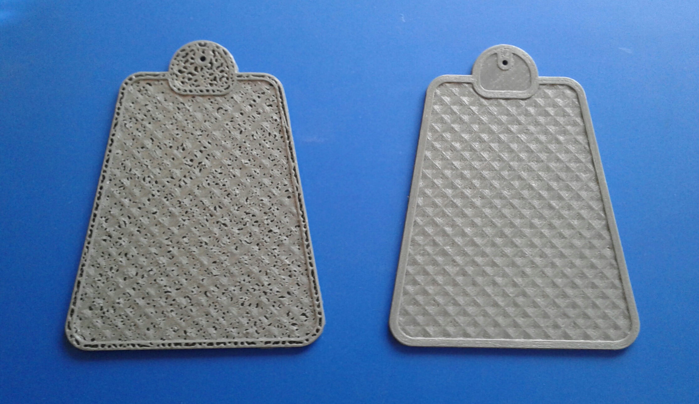

Thanks! I finally got around to trying the TPU. It certainly behaves differently than PLA and ABS. My first print did not have enough infill and outer layer thickness - so it had a lot pores. Overall, I think the end result is pretty good. It's flexibility is very similar to a real mudflap.
