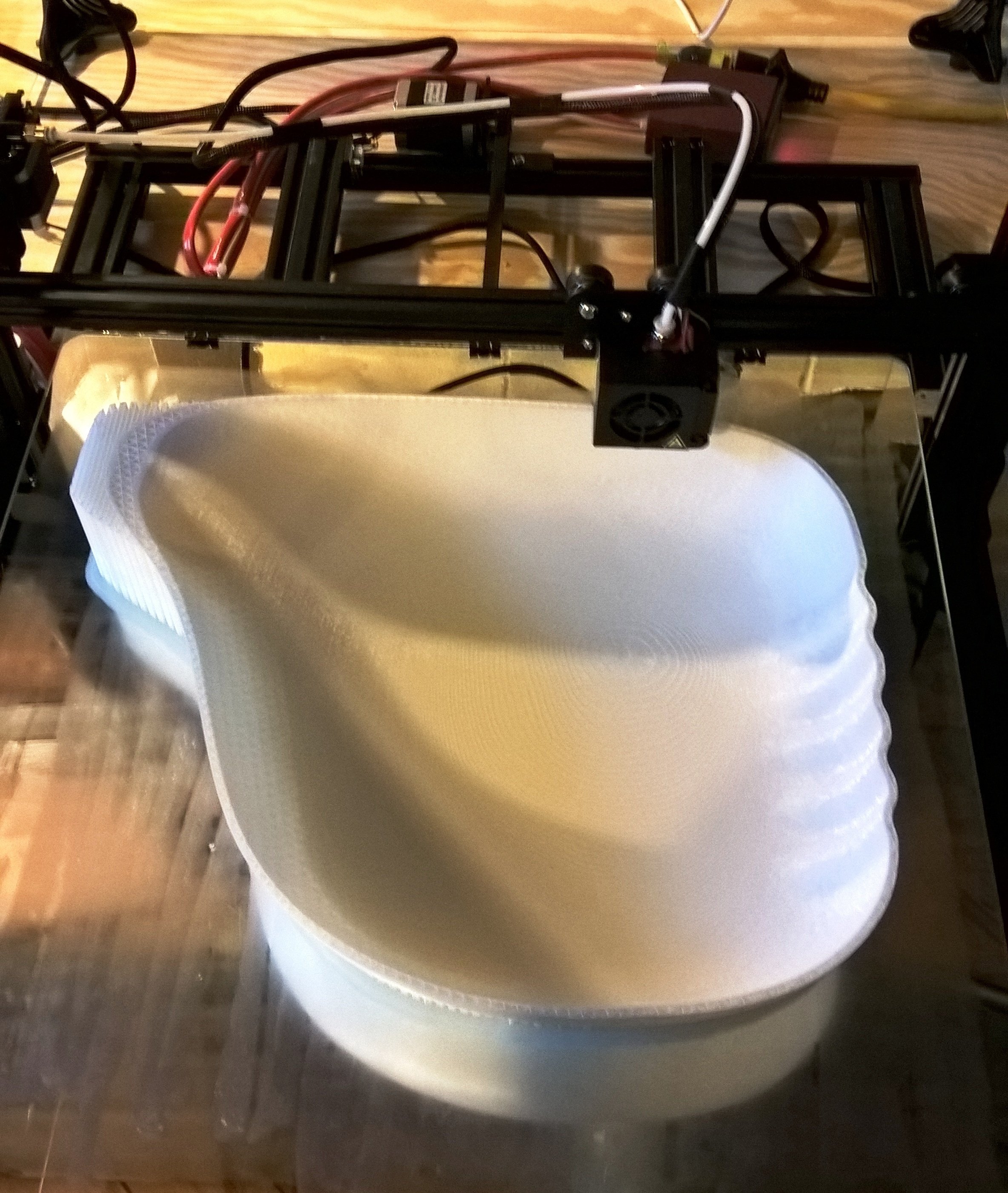

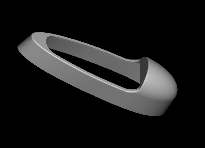

I did some more work on the top console 3D model. Added in some features to aid in mounting a latch.

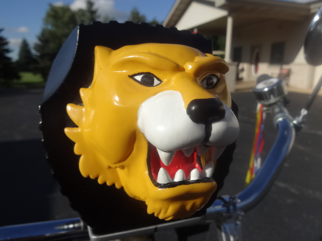

I don't know if there is an actual code for the tiger head, when I did mine, someone said they used Rustoleum School Bus Yellow, so I tried it and I was happy with the results:

I have used Chevy Yellow and New-Holland Yellow on sirens. School bus yellow sounds good, too. In general, the yellow is a deeper yellow.

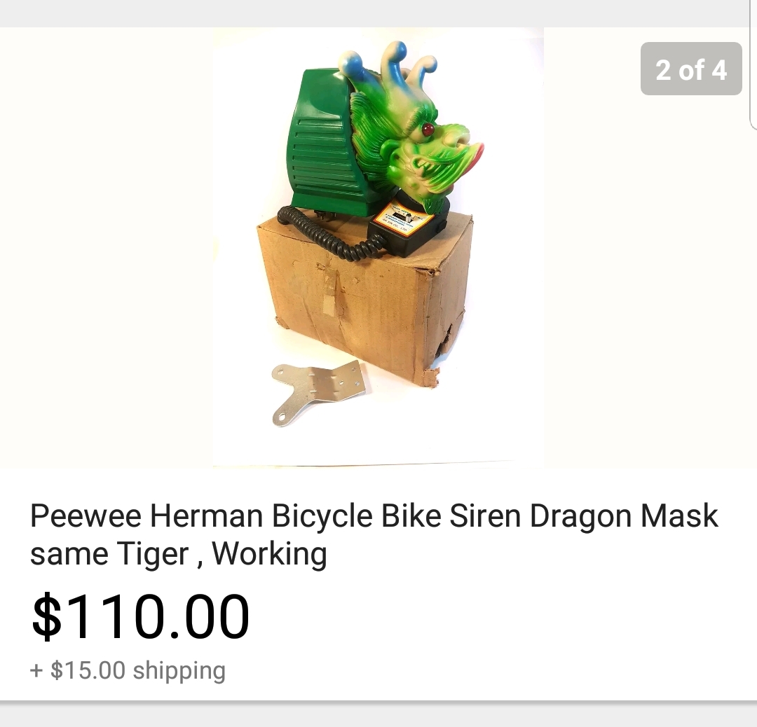

Screenshot_20181026-152007_eBay.jpg just bought this for my build. Looks pretty much same as the tiger. Hoping to find a replica head at some point. Can anyone point me in the direction of what kind rims and fenders I should buy.

The tiger siren, the heads been resculpted but not too crazy changed,
There are two style of housing a large one (rare), and a smaller one common to find.
