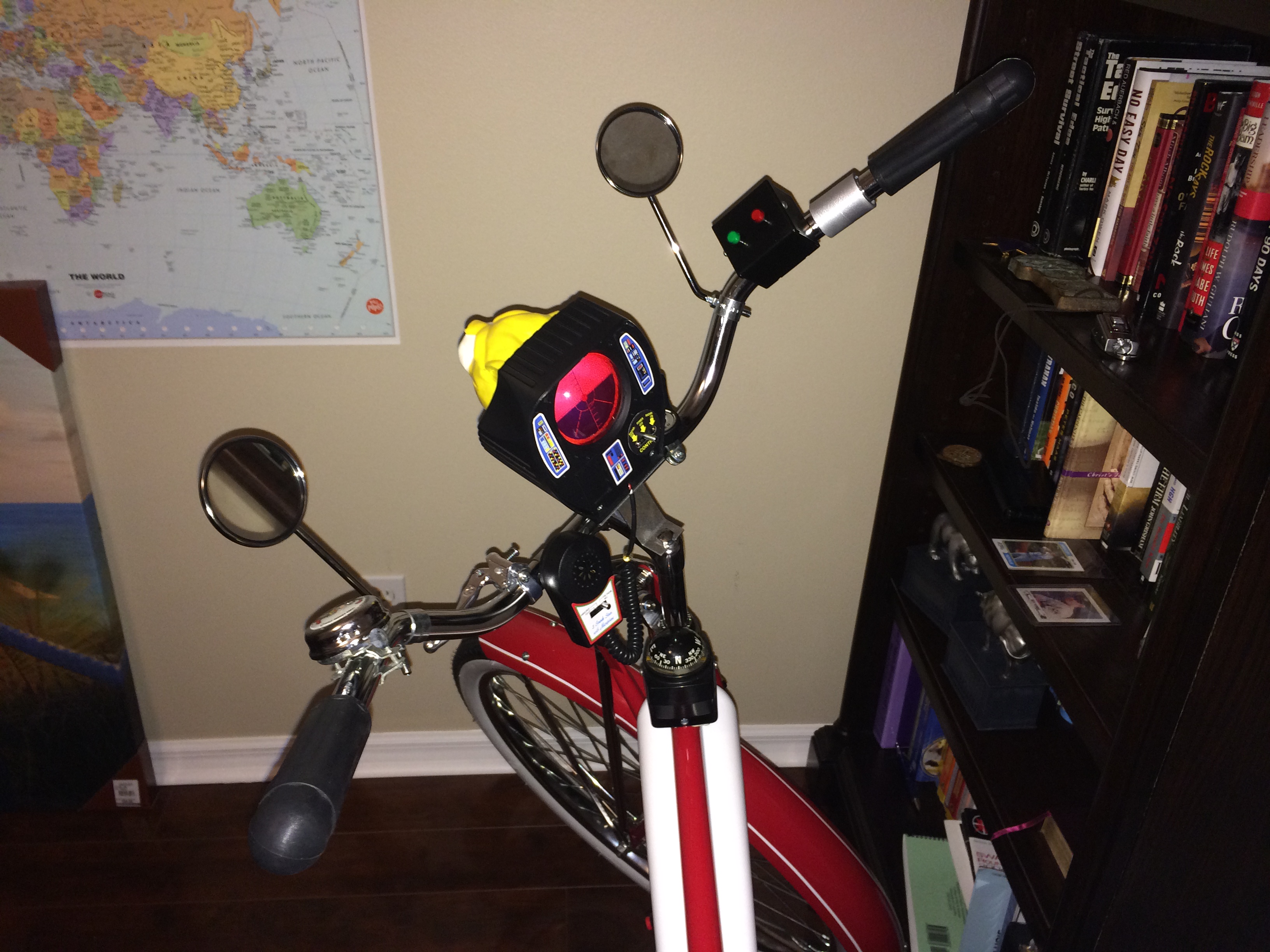

Installed my handle bar grips. Used hair spray to slide them on and installed my fake machine collar piece. Since I could not find a real machined collar piece, I used a 3/4 inch PVC sprinkler connector that I spray painted silver metallic. Found out the hard way that you need to spray plastic with primer. First mistake cost me .30 cents. Live and learn :)
Thanks Ryan! I will definitely do that. I wrapped some tape on the handle bar to make up for the space as well. You guys are such a big help to me. I'm useless with tools, so I'm learning. Great project and a lot of fun. Can't believe I have this bike!
