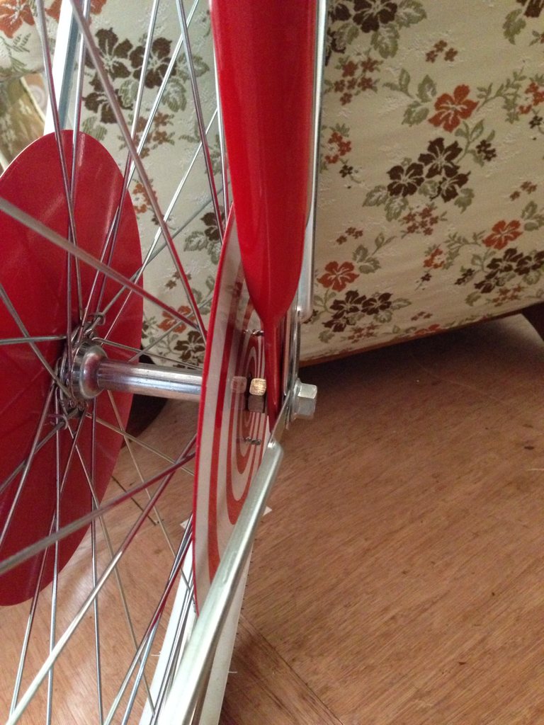

The fender I am using is after market. I have some vintage fenders and the vintage fender is about an inch longer. The width measurement is the same as yours. I might be able to space it out at the hub. Any suggestions for doing that?
Here is how mine looks. I had to put in a few washers to make clearance for the spinners too.
Excellent. I will do that and see. The vintage fender would probably be a better look. It's longer. I just need to do all the paint prep, etc. The never ending project :)
Yeah. It NEVER ends. The vintage fender will look better too. After looking again at mine I realize I have a little work to do adjusting it. Gotta love these bikes.

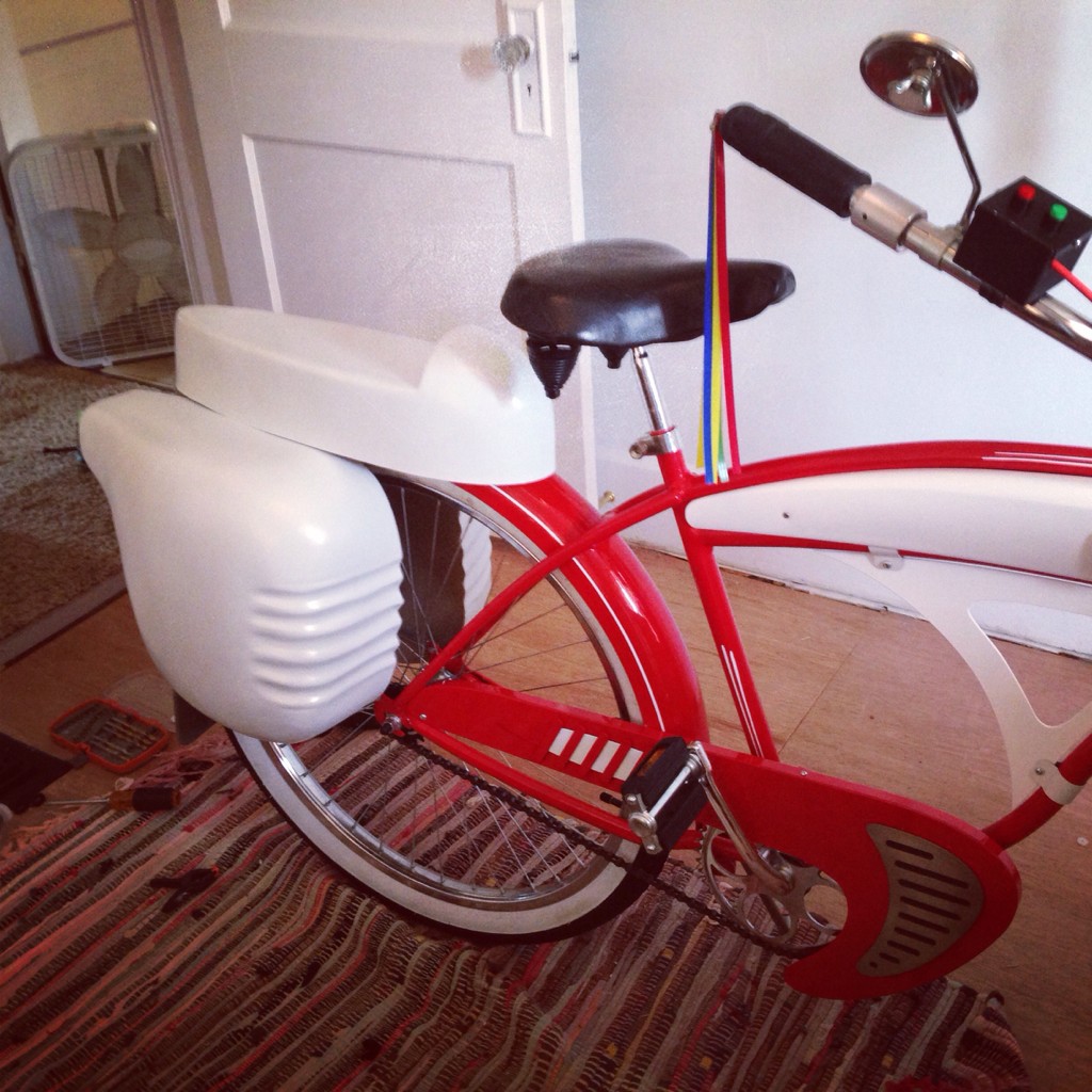

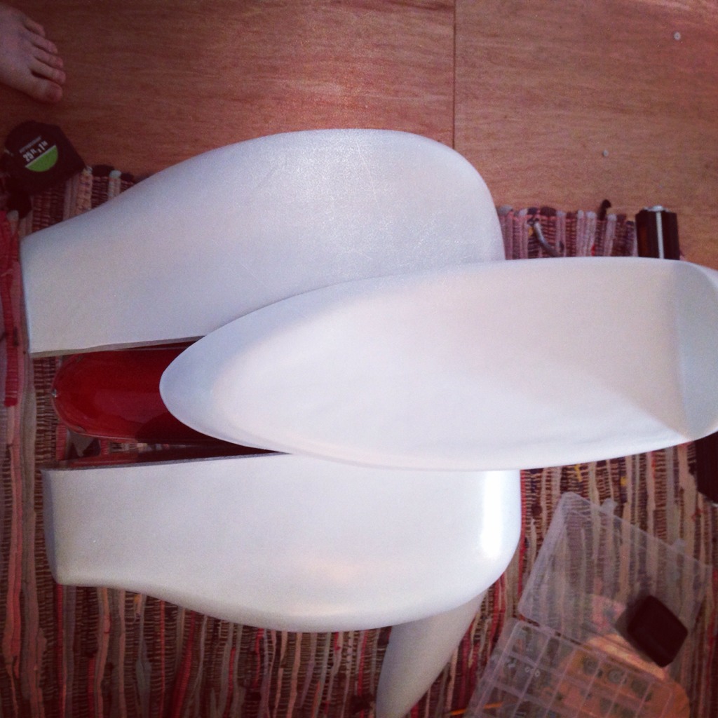

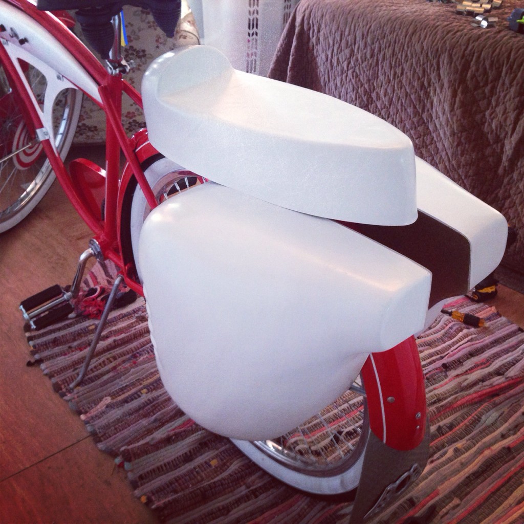

Did a test mount of the bags today and I'm really happy with it. The bags will be mounted with a screw and keyhole system so they will be easily removable and the top console will screw into the fender, essentially locking the bags down so they won't bounce off.
I still need to do a lot of prep work, but I think this is going to work.

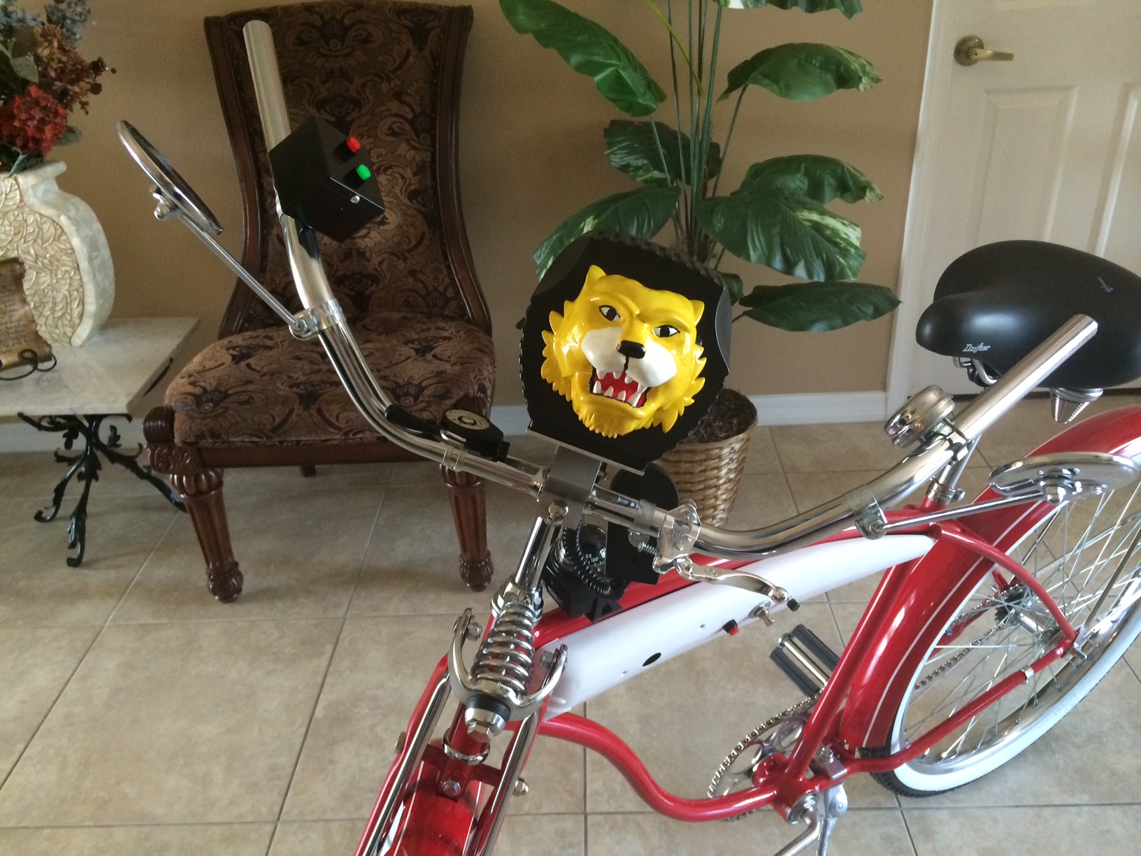

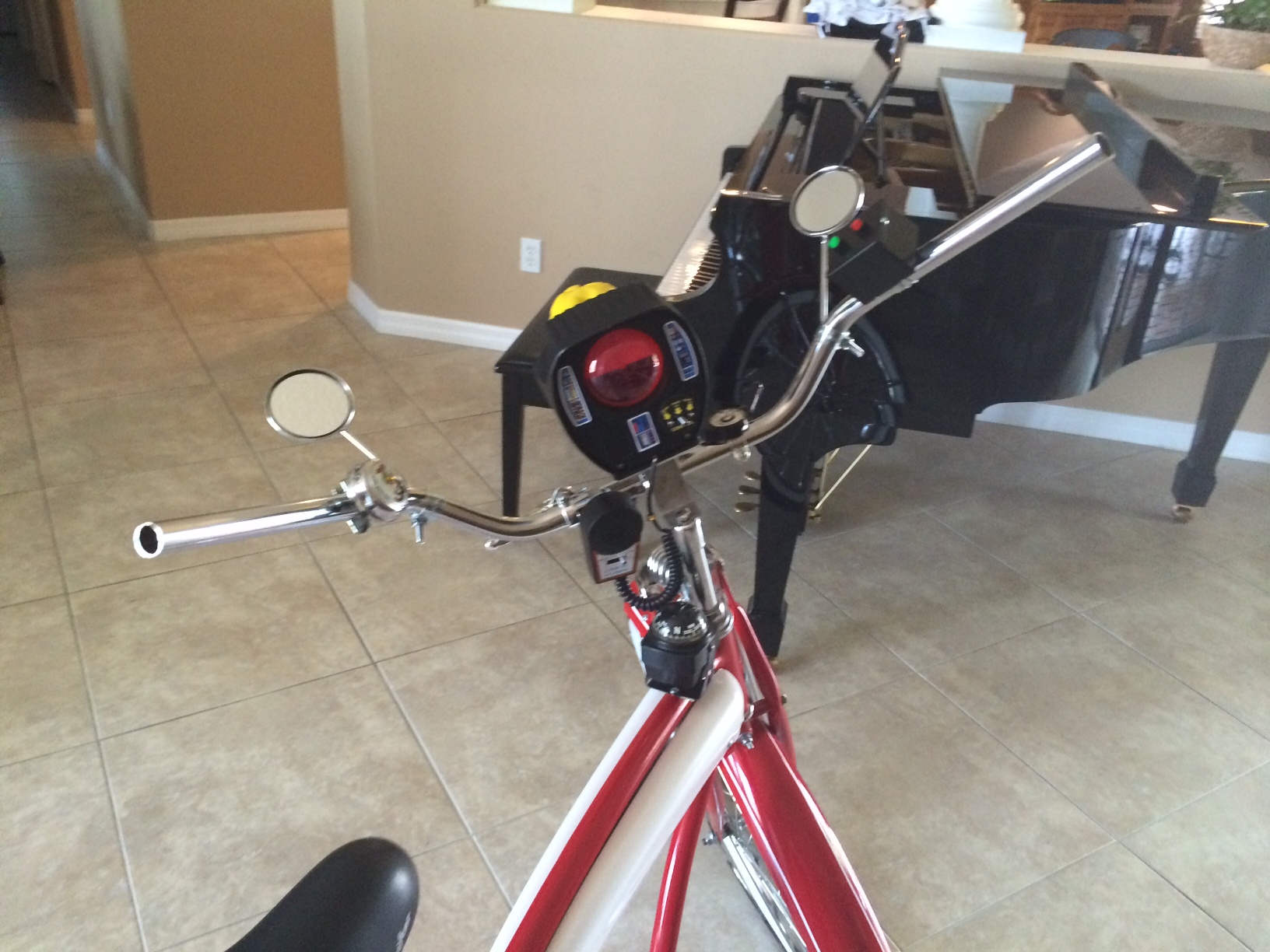

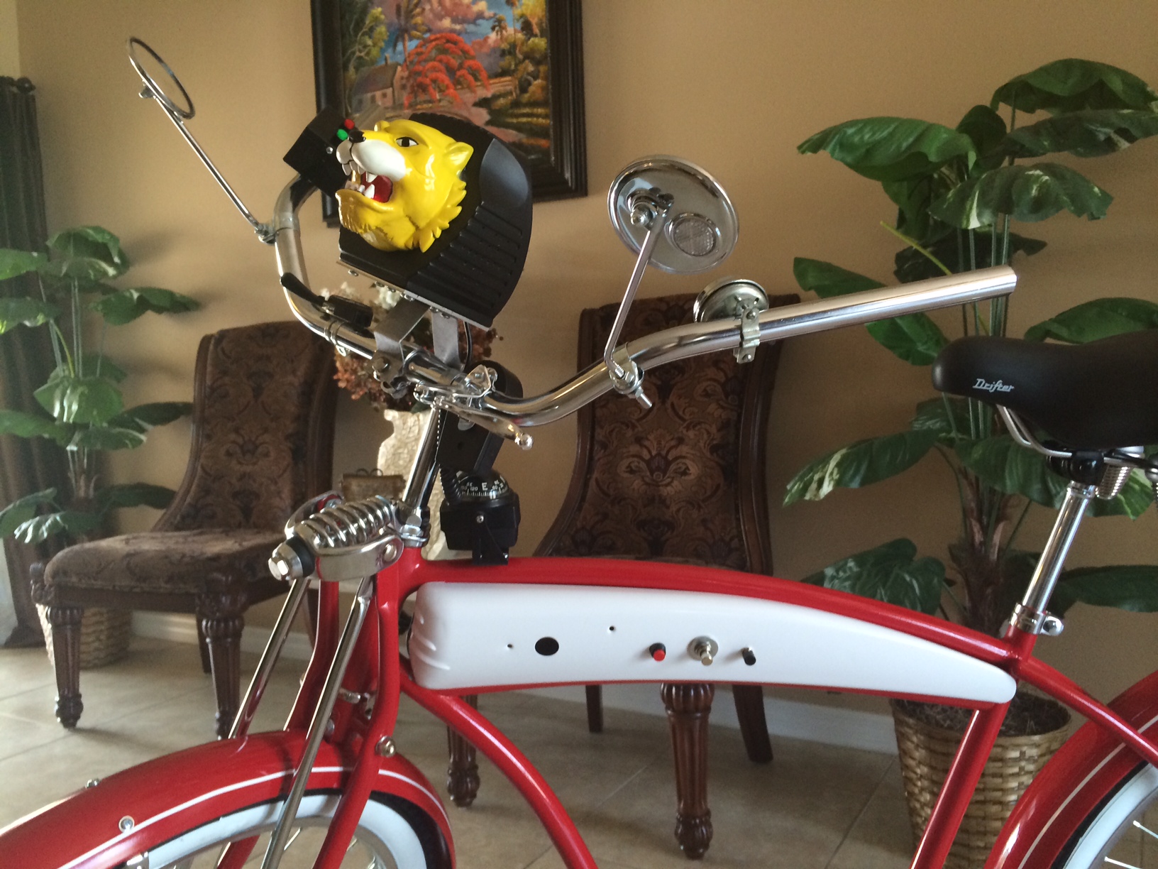

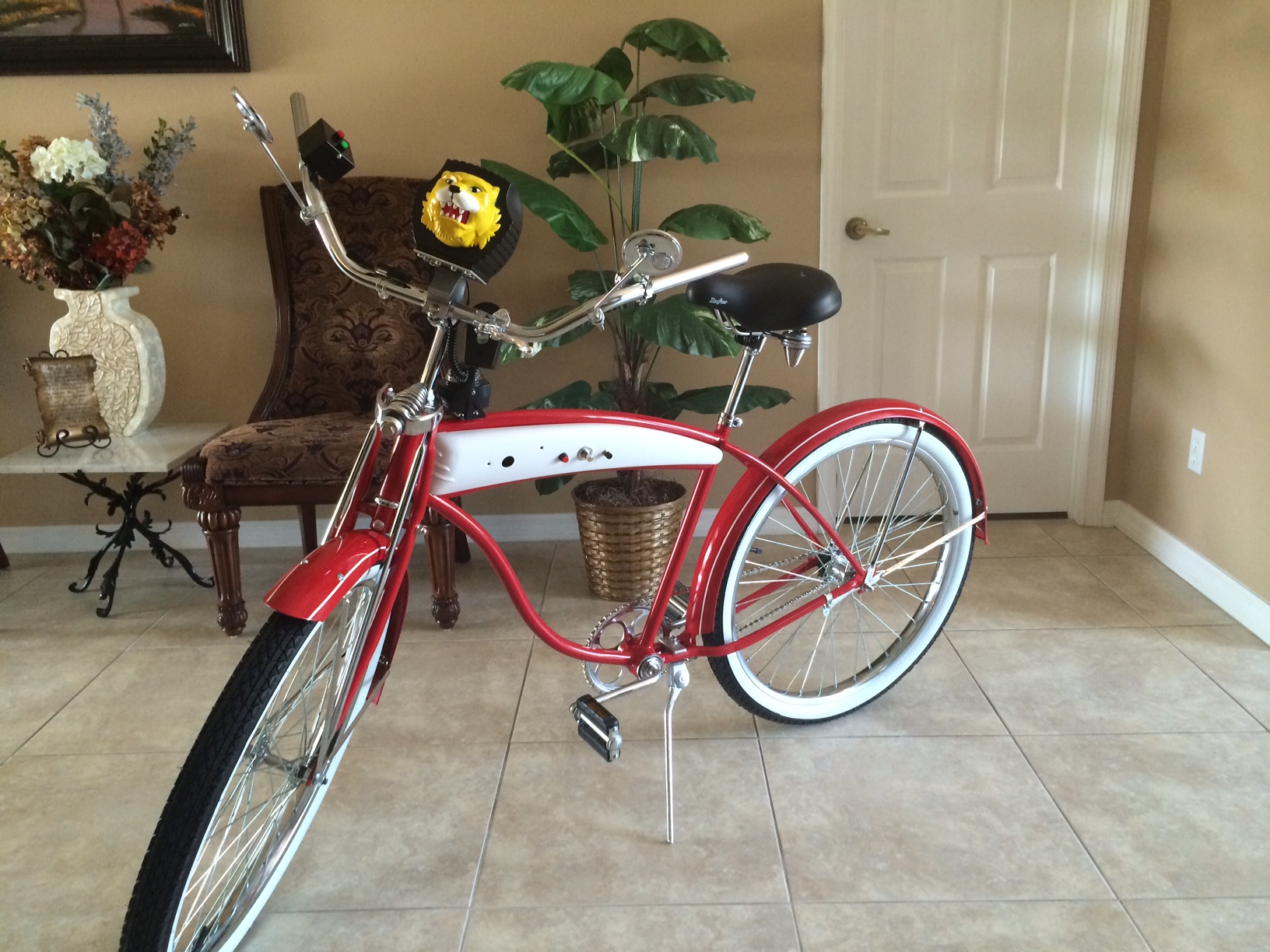

What do you guys think? I finally got some of the parts together. Lots of work still to do, but this is definitely a fun project. Big thanks to Abe, Ryan, Gregg, and Kazxbug. Thanks for all of the help so far - Turk
Bought the tiger head off Abe. He did a great job making the entire tiger siren. I can't stop saying "Argggggh" My wife wants to kick me out. LOL.
Man!!!! I am glad you guys are throwing up pictures of the bikes getting closer! Makes me what to get back on mine. Nice work Turk!

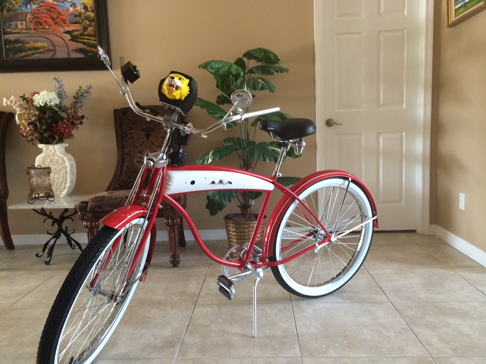

I'm going to stick with the aftermarket fenders for now. I was finally able the fit the front fender with some good ole hand bending :)
As far as the brake lever, I used the Dia Compe style Tech 3 lever. Not sure if that is what you were looking for.
