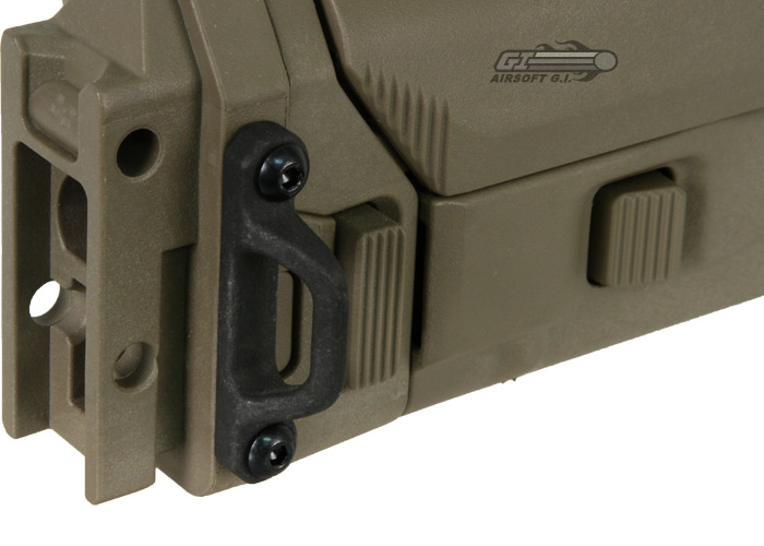

In case anyone needs the rear sling mount, Airsoft GI has them back in stock.
WS, were you thinking you'd have the whole kit available before DC, or only the airsoft
conversion parts?
Re: Oblivion Movie Rifle - Taking Deposits!
Thanks for keeping lookout, but Mal has the sling mount already :)
The items I struggled with was the 10 round mag & the flash suppressor. The suppressor I got was not the exact one, but with a bit of work will be screen accurate. RarestRX has fixed the mag issue
That's the one I was referring to.
What's interesting is Tom/Jack wields the rifle left handed. The ACR/Masada does NOT have a mount point
for the sling on the Right side, only the left side. They actually mounted the sling mount to the folding stock
itself. :)

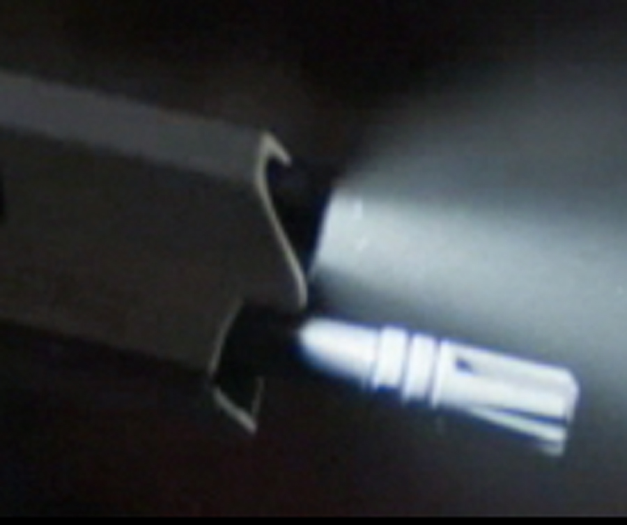

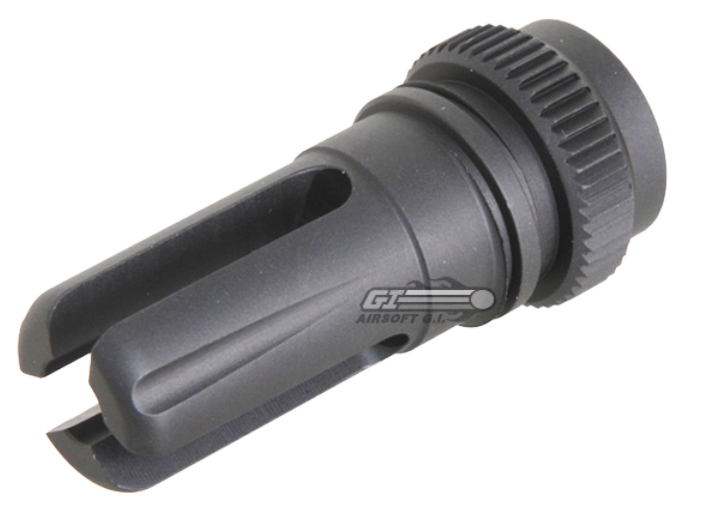

Also, regarding the muzzle brake, I ordered a "mostly" correct version. Near as I can tell,
the airsoft version has a serrated/knurled ring running around the base of the brake.
The one used in the film has the same back end as the M-16 style birdcage that shipped
with my rifle.
Now, in theory, it wouldn't be much work to pull a quick mold and mate the 3 prong flash hider
to the correct threaded base. In theory. :)
Rook, I had originally sent a similiar one with the Masada as basis for molding (with view to moding it as you describe) -interested to know how you get on
For accuracy on the build there is an AAC BLACKOUT NSM flash hider on its way to wondersquid.
