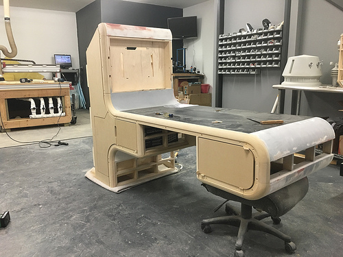

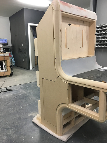

This is starting to look like the desk I have envisioned in my mind!

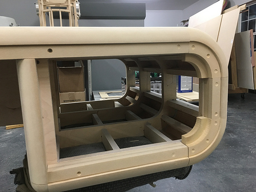

Ran into a bit of a snag here. I always saw having drawer slides mounted on the side of the drawer, but the curve of the desk won't let that happen. I'll need to swap to an under mount slide. No worries, just a change in direction is all.
I am cutting the door and the drawer front today. I'll change out the drawer slides and build the boxes for the drawers next. Then its time for full disassembly and paint!

Thanks! I have made furniture in the past and do the occasional commission, but mostly I am just a geek like everyone else here. :)

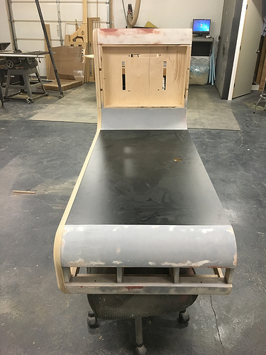

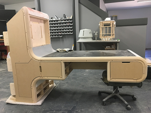

All, the trim pieces are now cut. I do think I may end up redoing the drawer fronts though. Trying to fit them in with spacers and they both appear to be an 1/8" to narrow. Not a big deal, but will need the drawers installed to be sure. I'll cut those next and figure that out.
Once done, then it will be time to disassemble and paint.
-Eric

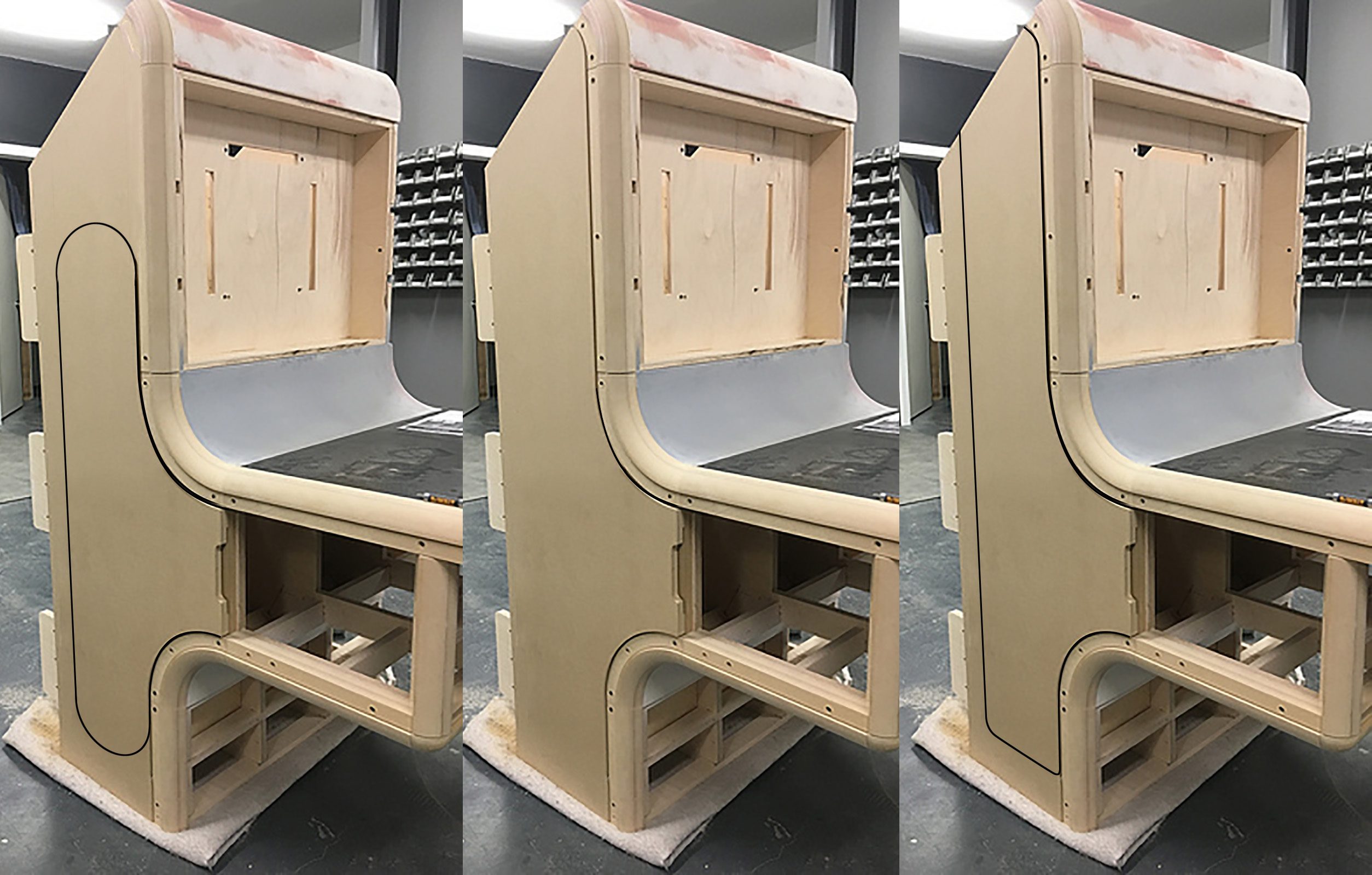

Sorry for the late reply. Any opportunity to do some different part lines for the door? If you don't, it still looks great!
I took a quick stab at some different part lines.
I played with this a bit. The door is for a computer tower so it needs to be as wide as possible.
You’re second two designs is what I wanted, but the room has an angled ceiling which would cause the door to hit the ceiling when it opened.I looked at having the seem line up with a break in the trim too.
I eventually got frustrated with all the choices and just made a decision. The panels that don’t move are glued in so I am committed now!
