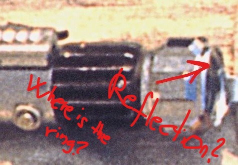

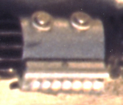

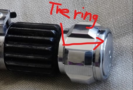

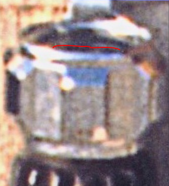

Also what I noticed while making this picture is that to my eyes this little highlight is the "C" letter , although I can't say for sure maybe someone that have a "h" cap can compare
The cap is missing on that one. It is an optical illusion, like when you can't decide if the box is inside or outside. If the cap would be on, we should be able to see the ring of the plastic ring.
If it would be the cap on then what we would see is the reflection of something that gives those vertical lines. But then those lines should be broken by the ring of the plastic rings. There is no such thing on the photo.
Therefore it is very certain that the cap is missing and we see inside of the handwheel. The part that you have circled must be related to the hook they use to keep the hilt on the belt.

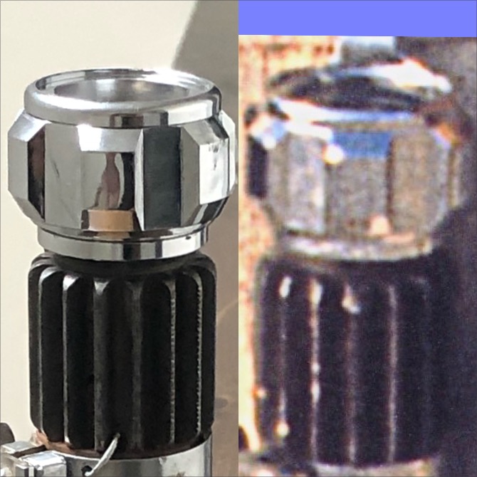

When I made that post I was just starting to look into Obi's saber details. I've read in the lightsaber guidebook something along the lines of "the discussion is still going on if it is a C or H cap" so I didn't at all consider that the cap could be missing.
I'm long since convinced that the cap is missing on this picture and also in the movie.
Roman's FX replica does not have this detail, but if you compare the shot to a real handwheel or a static replica I guess, there's internal step just where it can be seen here:
View attachment 1529207 View attachment 1529209
second this, I very much believe this is correct. I have also seen the alternate version here - a straight sided rim instead of a rounded one seen in the chronicles pics.

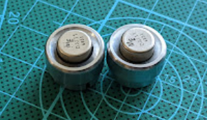

Check out the two little spiders that crawled out of my mailbox today ! I think must be some seriously rare and endangered species ...
Thank you for making this happen (you know who you are :)) !
Looks like that pest invasion was spreading ...
I guess it is old news now looking at the date, but I've only recently noticed that Roman props now offers stamped transistors replicas.

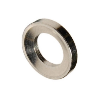

Another thing that I've recently found is that the Campagnolo brake pad adjustment washers are a really good match
only they are m6 so the hole has to be drilled to 8mm or so for the transistors to fit in.
Here's what the Campagnolo washers look like installed:
Another interesting found part :
obviously needs some shaving as they are much taller than washers, but they are hollow inside so it will be very easy to do. Being hollow also makes them a good option for FX builds where the transistors are used as buttons (or at least this is what I'm considering using them for).
These are from a Nikon BC flash.

The main issue is the point. There’s should be a square top. Take a closer look at the reference material. It might be better to just flip them over.
I'm not sure what you mean. I'm after some found parts that would look like this with no or minimal modifications (like enlarging the hole so the transistor can fit in):

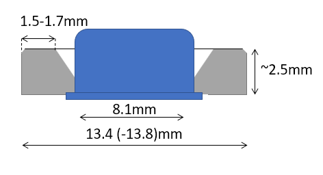

My idea of ideal washers would be something like this:
I could be wrong on the whole thing (except the transistor diameter), but I have some made from scratch to this spec and they look right to me.
