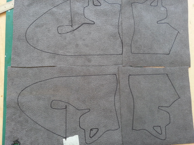

So the 6 points of alignment are centre of the back of the heel to the 2nd toe, not the big toe. Who knew? The other 4 points are the small bony bits on the side of the foot behind the toes (either side of the ball of the foot) and the two at the back are directly beneath the ankle bone.

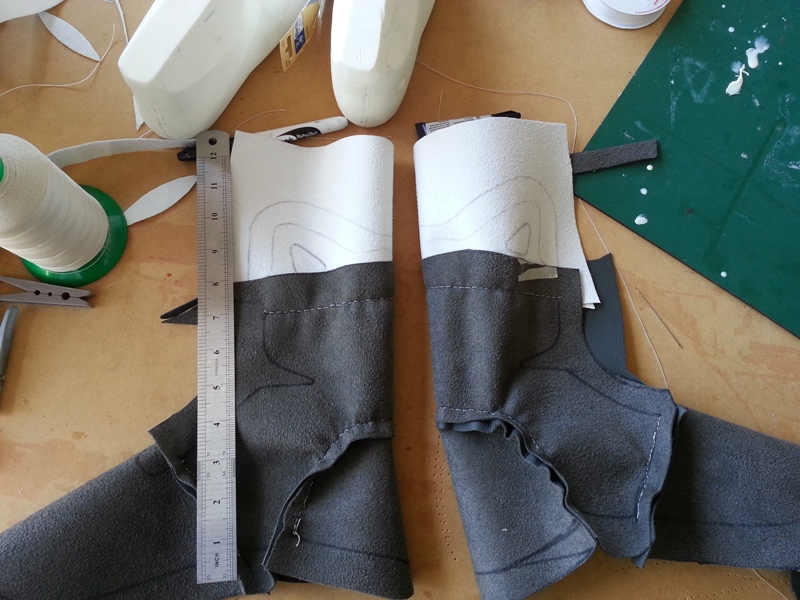

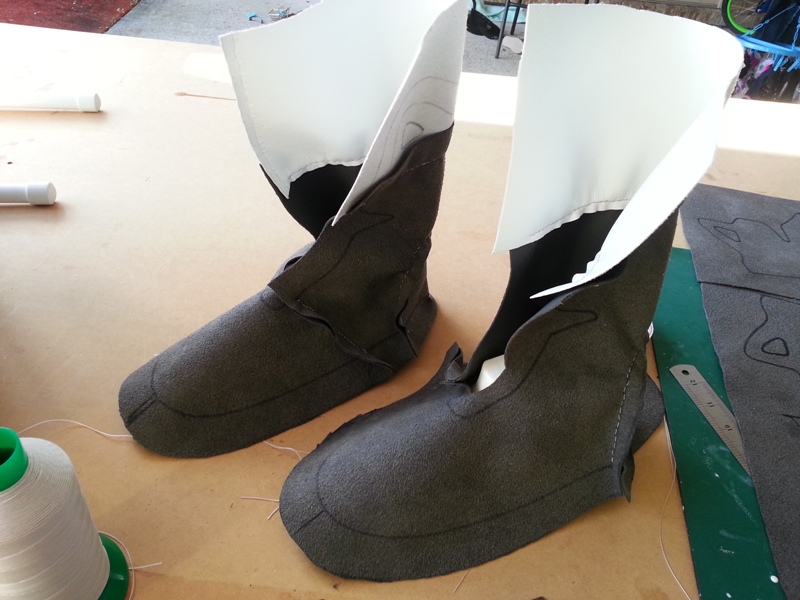

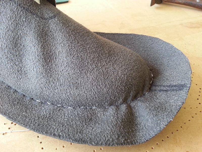

So I have almost finished the liners, then I can sew up the outer shells. I am hand sewing all of this by the way. The machine will sew it, but snagged serveral times yesterday, so took a salad fork with a hammer to create my self a stitch spacing and hole punching tool and off I went. Running stitches are quite easy because you do the first run which looks like - - - - - - and then come back and fill in the gaps to make it -----------

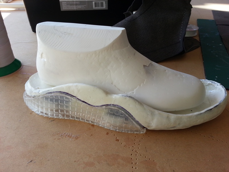

A Last in a mid-sole

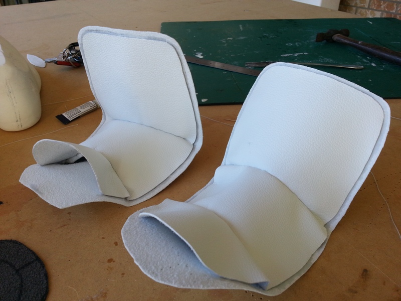

Tongues. Not really looking forward to edging these...

Liners with the cuff attached This is how that seam is hidden.
attachment.php
attachment.php
attachment.php

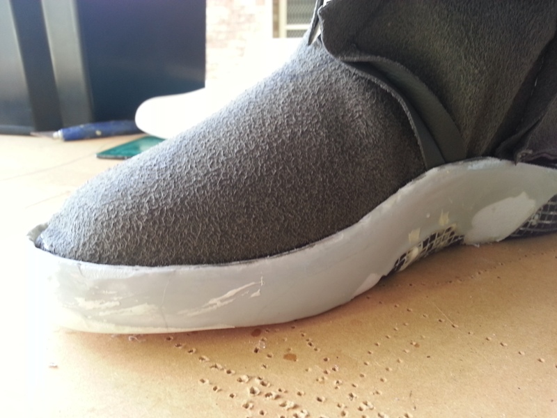

Outer shell
attachment.php

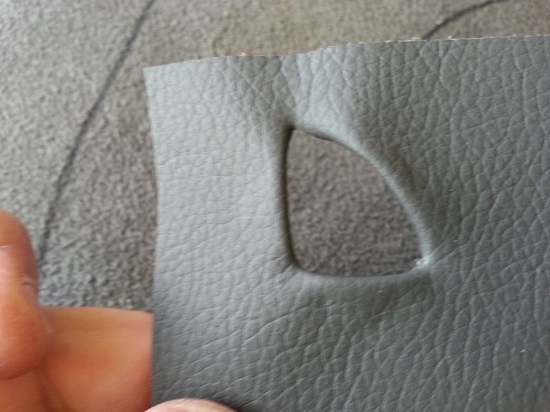

Test on finger pull hole.
attachment.php
This stuff is way too dark with the white and what would have been nice is to use this grey as the trim (cuffs, tongues and straps) on a black pair.
Anyway the point of all this is to solve the mysteries of the MAG and hopefully end up with a few leather pairs.

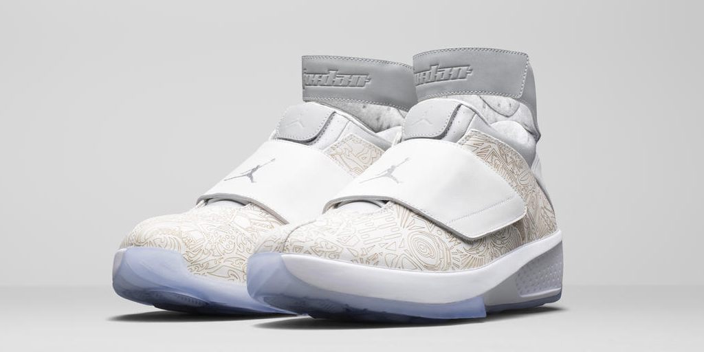

Anyone have Jordan 20's? I've been meaning to post and discuss these for a while.
attachment.php
My pair is pretty beat up now (bought them back in 2006), and as it turns out, there are a few things these have in common with the MAGs. Both the MAGs and J20s share the same base pattern shape. If you fold back that big lace strap, you will find a single seam on the inside of the shoe, centered between the 4 main laces (though J20s have 5) just like the MAGs. The toe is clean, except there is a toe cover added over the big toe which I wish was not there. And like the MAGs, the whole outer side is clean, broken only by the lace strap. It is a very cool look. The heel is different though.
attachment.php

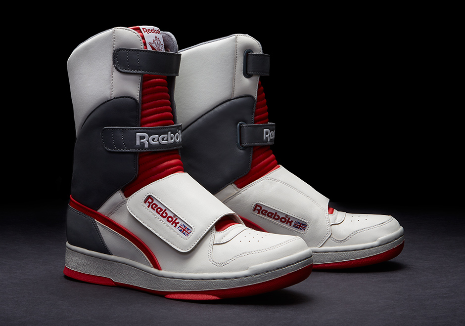

So this vegan leather I am playing with right now is about as dark as the grey on these stompers, And given I can't make true MAGs from the stuff, thought today about a cross over borrowing the best parts from each. Well more like a MAG'd version of the J20 because I want to keep the clean toe na basic MAG styling. So I am thinking seriously of adding the big lace strap to this pair.

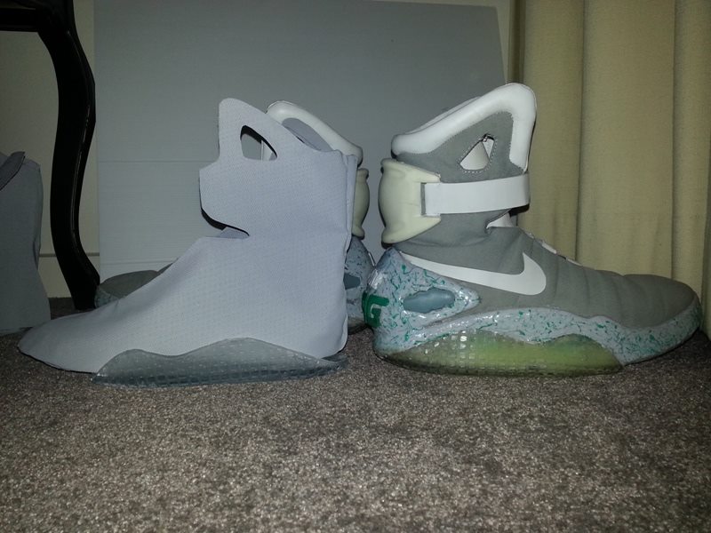

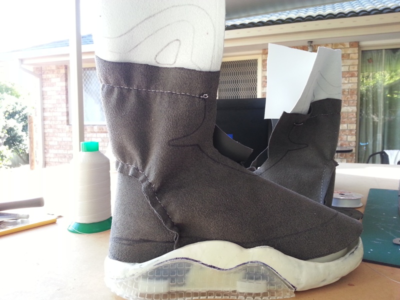

Stitched this up today and it seems a touch small for the US10 but fits really well into the US8 soles.
attachment.php
attachment.php
Weird part is, I an sure I used the same patterns to make this pair which fit my foot really well.
attachment.php
