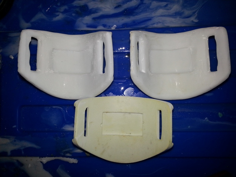

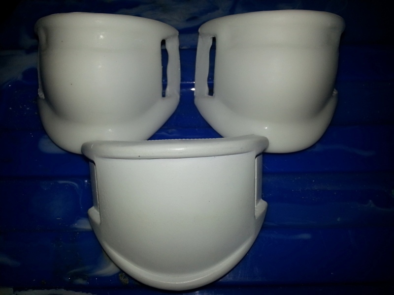

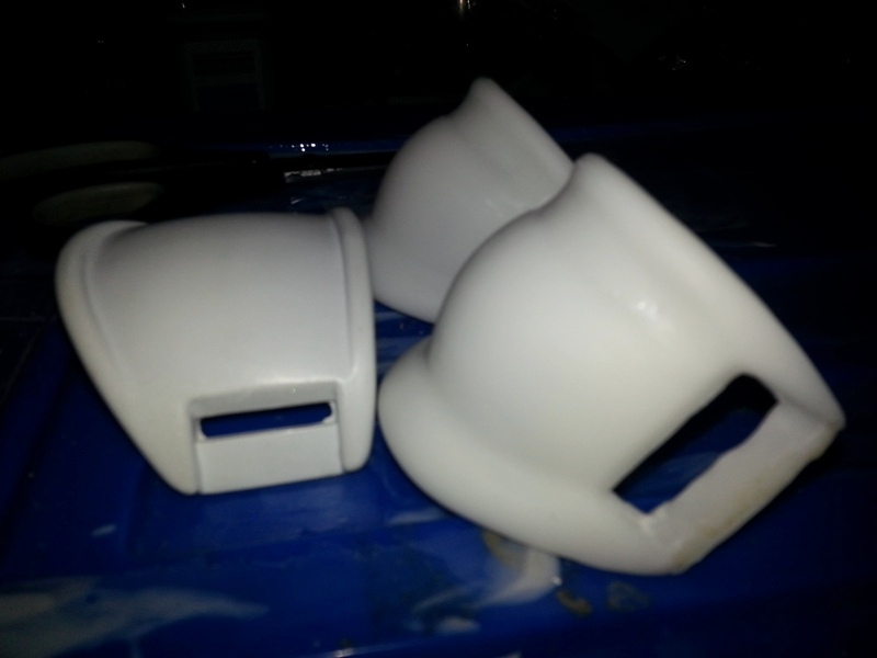

And here are the two new parts after all the flashing has been removed. The part on the right is the master part and the other two are the clones.
http://www.therpf.com/attachment.php?attachmentid=616934&d=1461157694
I am glad I removed most of the flash whilst they were still soft. Now that they have set, they are pretty hard. As I said in my video, I don't think it is important for these to be soft. The strap and buckle are part of the support. The new heel cups will have to be soft to allow flex when you walk.
These are looking nice ! Can't wait !

those look damn good!
perfect.
how much space is there in them?
perfect.
Thank you. I am liking them.
About the same as the original factory part. You could mount the inverter in there. Maybe a coin cell.

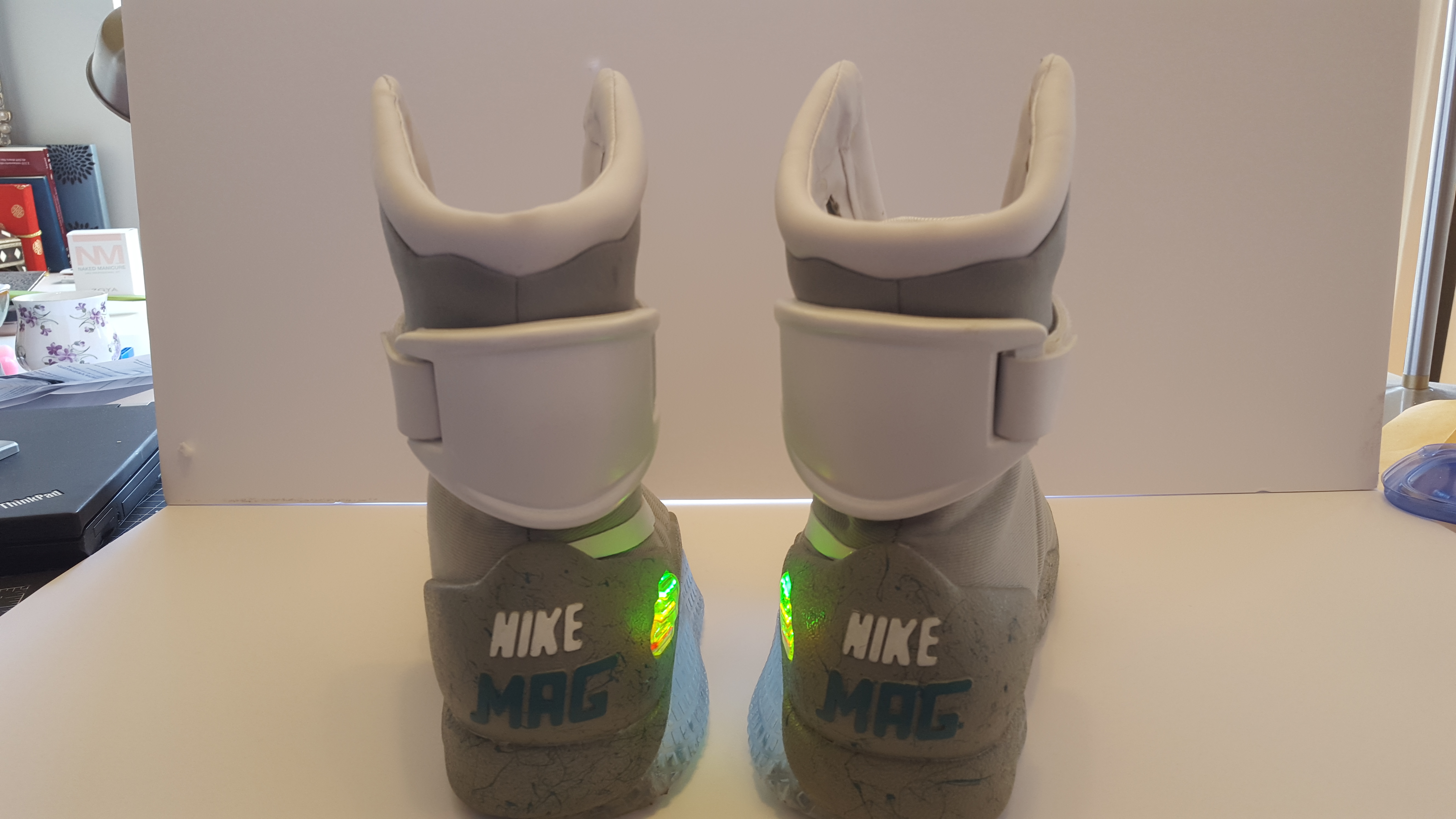

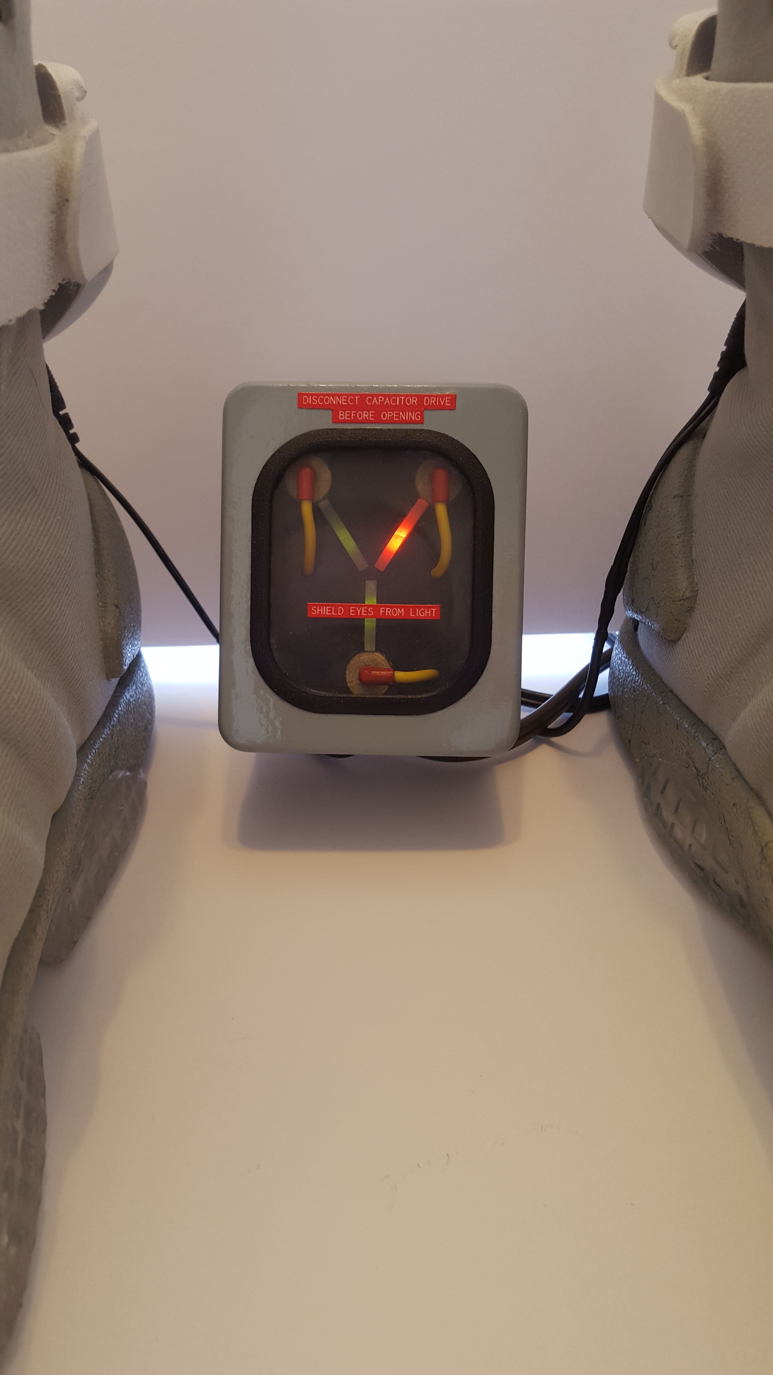

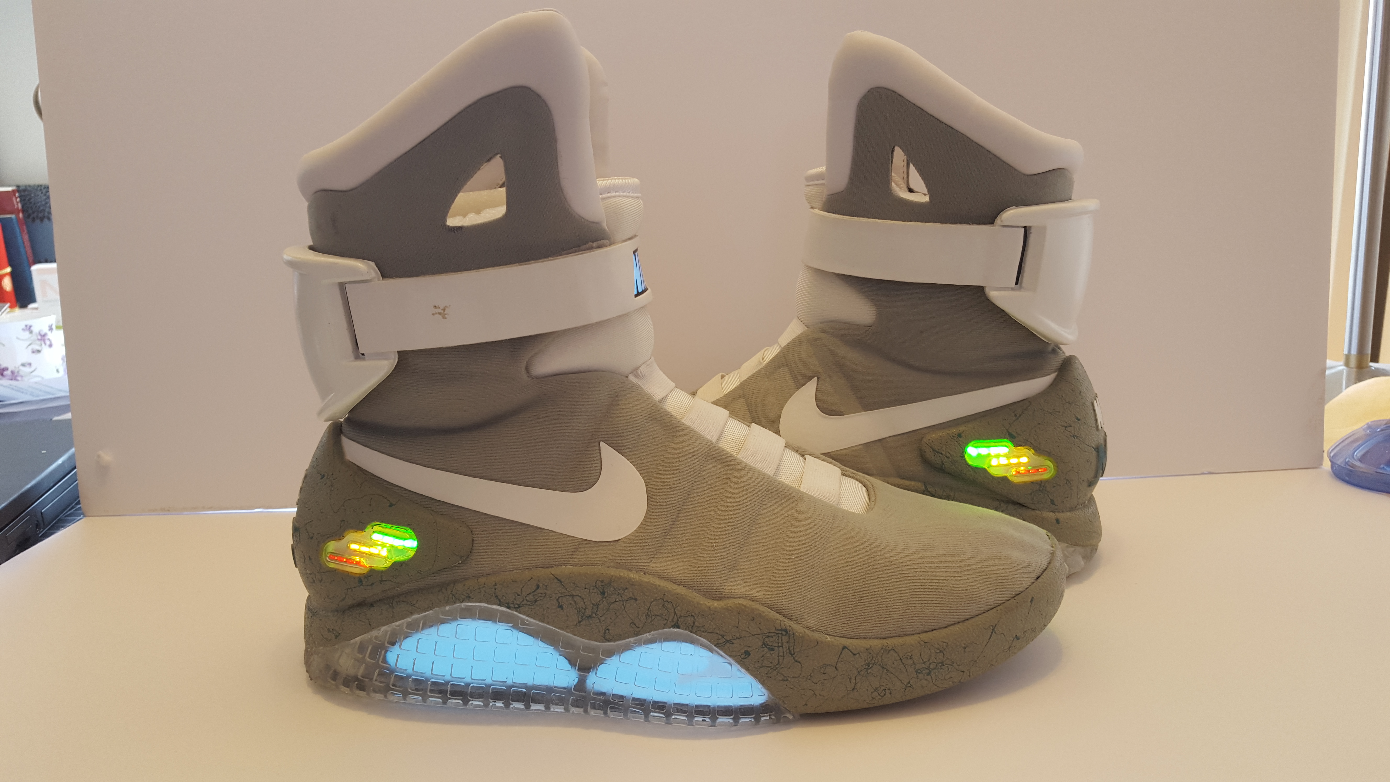

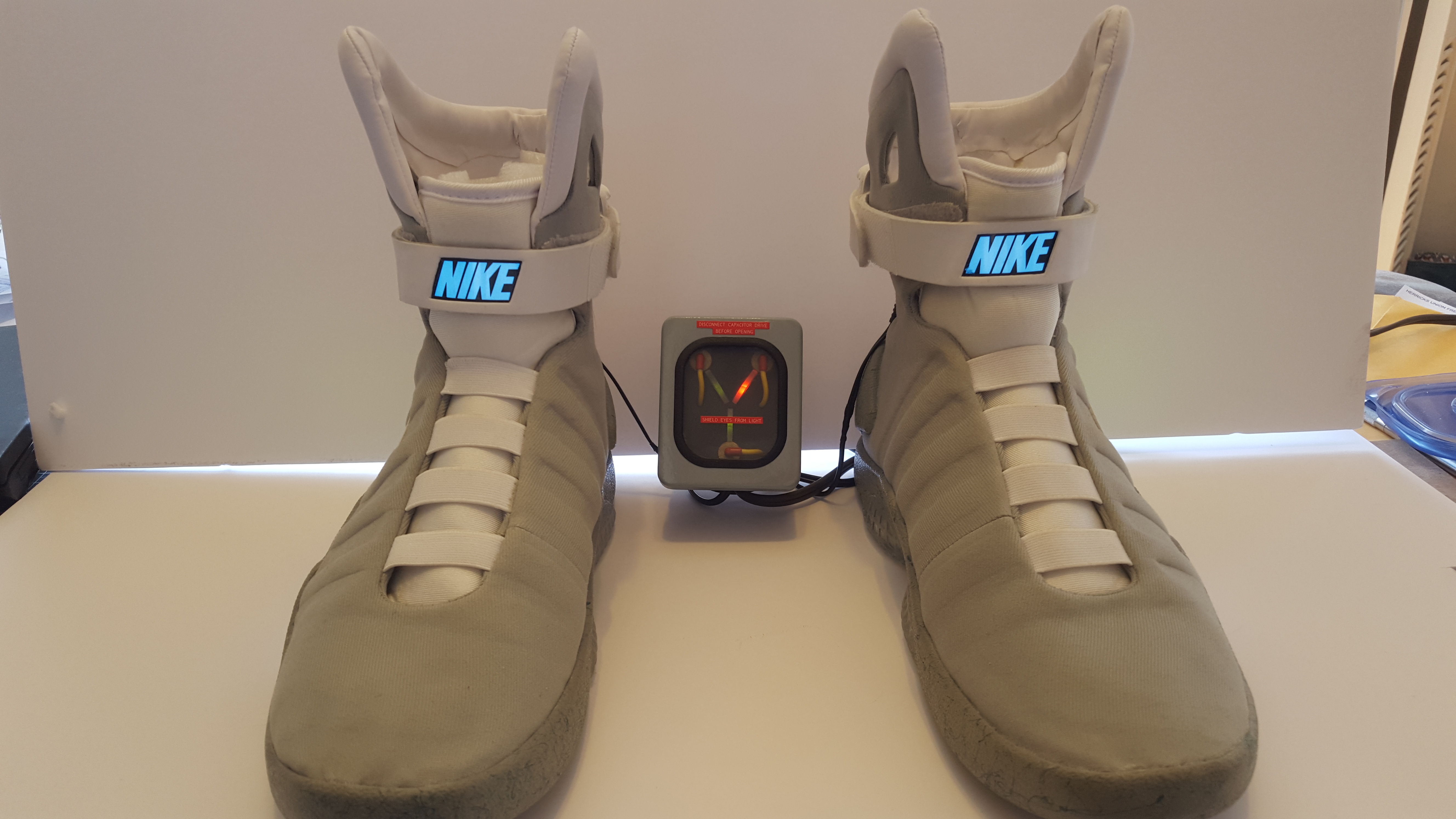

Finally finished my Mags! Thanks Cavx for the clear soles and Jedifyfe and Cavx for the tutorials and everyone else who contributed to this forum. Also used RVLF's tutorial for the upper but used the fabric from the insoles that I peeled off and metal boning for corsets to give the uppers more shape. I made a flux capacitor charger that I 3D modeled, printed and painted. Used the guts from the original charger added an extra led and put it inside so that it lights up.

Nice man! they look sweet.
That charger is pretty cool as well.

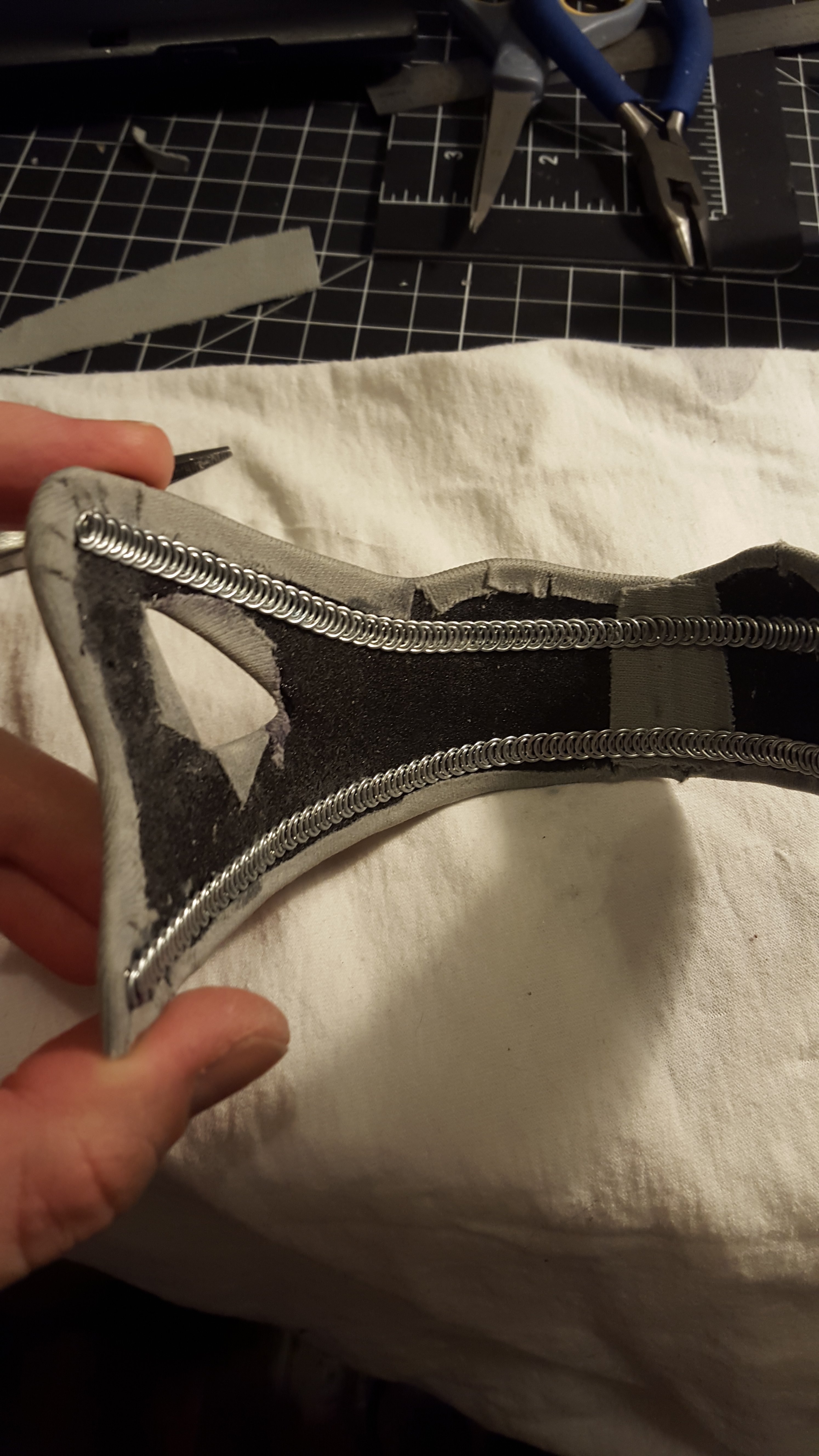

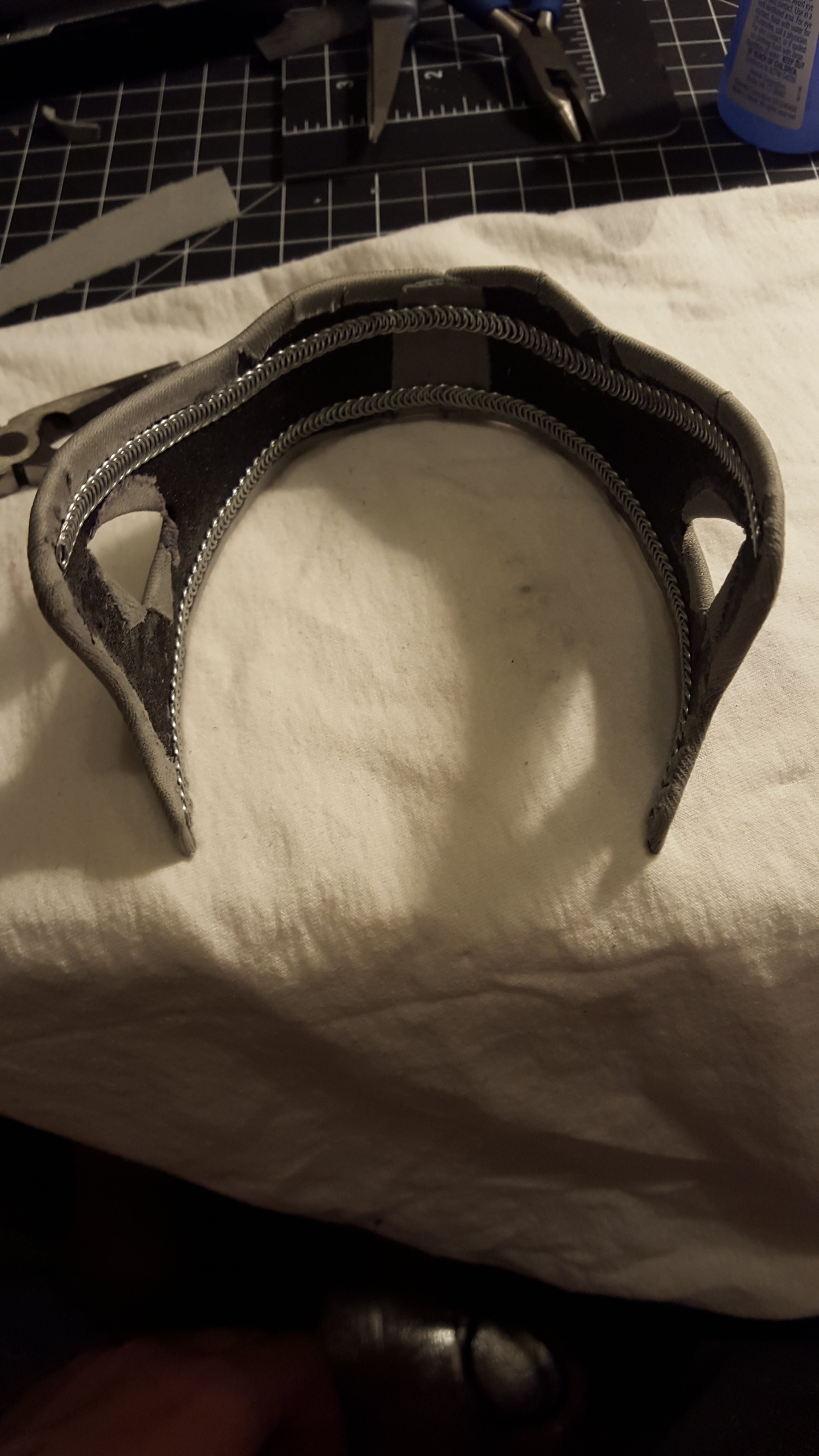

Amazing Job ! those new uppers you did make it soo much closer to the RD ! you said you used fabric from the insole ? how I would really like to do this on my next mag mod! I remebered I did metal boning in the whit colar too ! where did you put yours ?
I only did it in the colar area up toop I didn't extend down to the white near the front (so it didn't retain the shape like yours)is that what you did? I can also sorta see you did something diffrent with your clears ( if im correct) did yo give the inner out riggers the elips shape the RD have ?

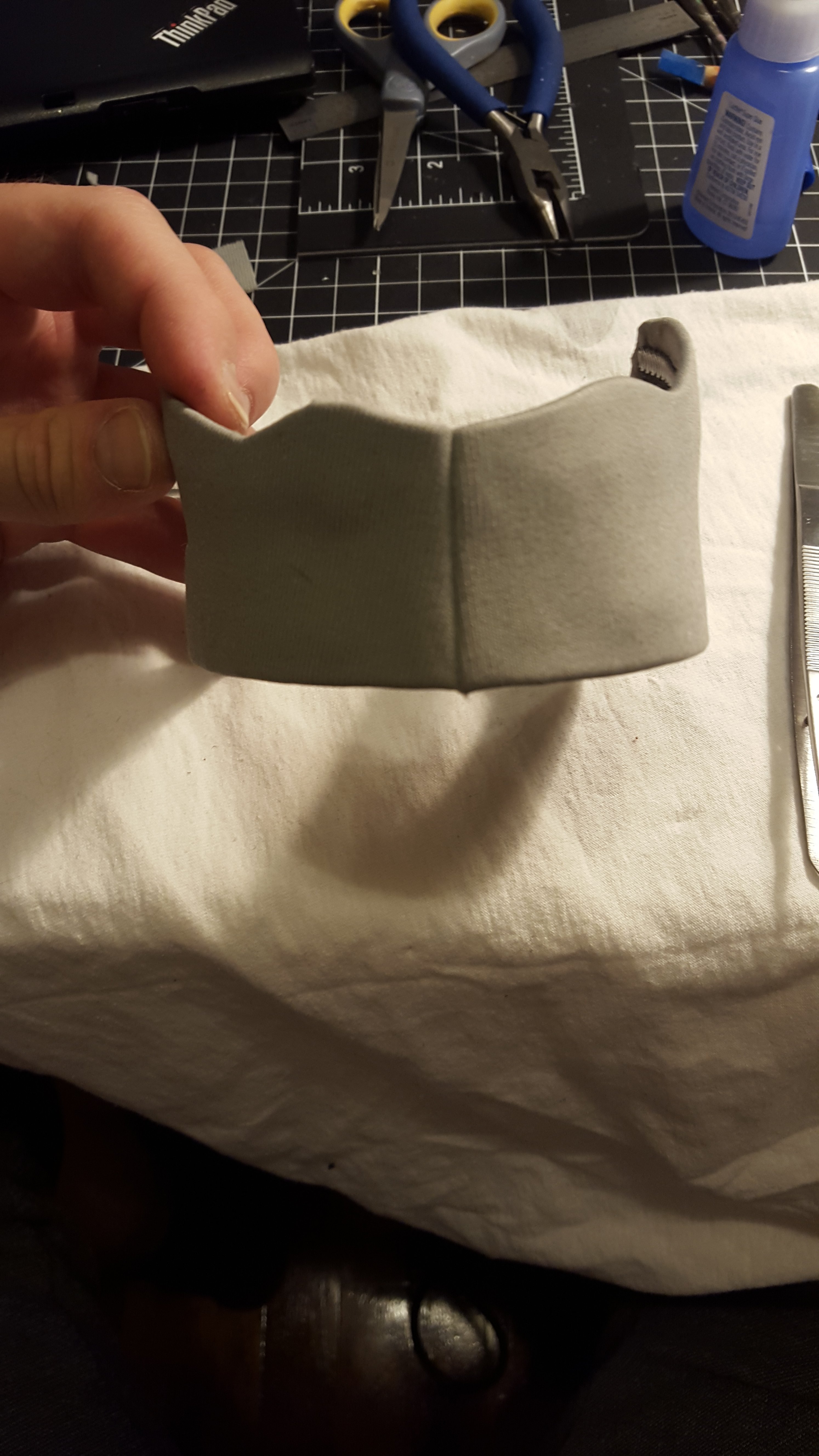

I peeled away the fabric from the white foam insoles that came inside the shoes. Here is where I put the boning20160224_185144.jpg20160224_185154.jpg20160224_185200.jpg
Nice ! these are cool ! how about the clear ? did you do anything diffrent ? it looks diffrent mainly the inner outriggers in your photos like in the third and fourth photos.
Yeah especially with the one on the right I dremeled the grey sole a little so that the edges of the clear sole sat flush with grey sole.

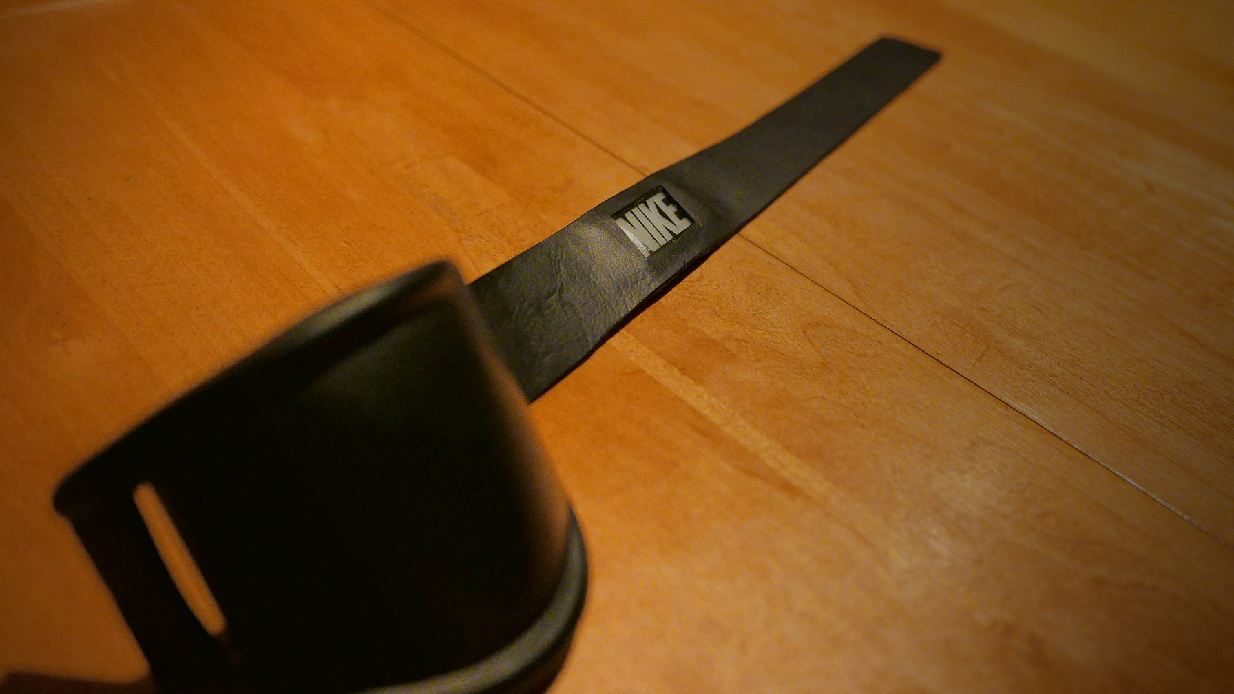

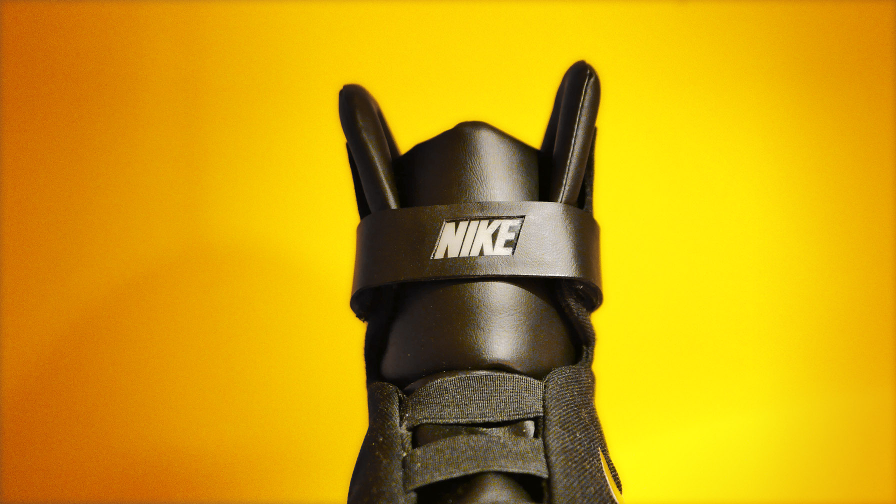

And here are the GITD straps (next ones should be EL if I get some answers :) ) :
