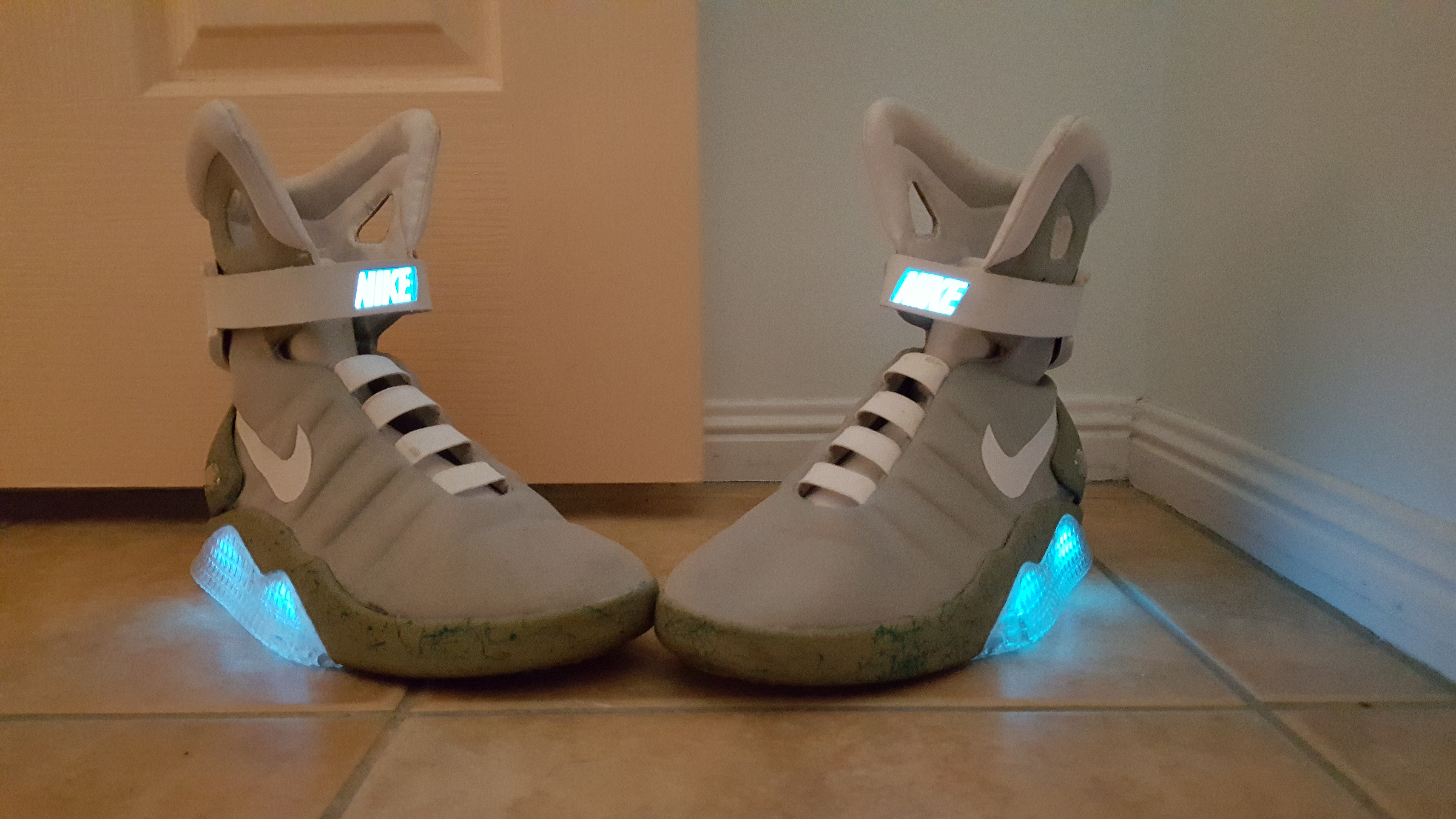

Here are my MAG's with cavx clear soles, we are working on using an EL sheet to mimic the LED's so we don't have to use them.

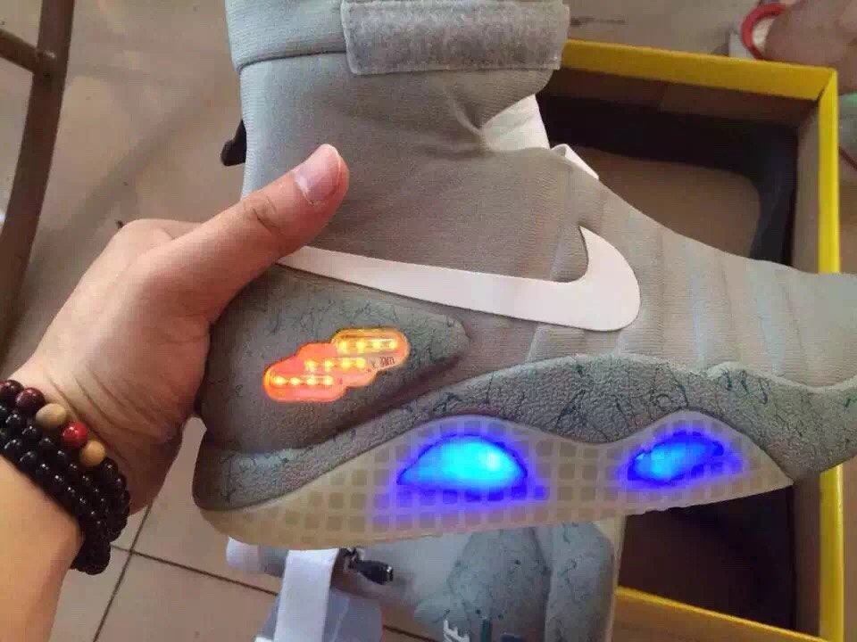

Hi, Do any of you know if this is a sport or if it has nike sign because it almost absolutely looks like the nike sign has been photoshopped off. Anyways, This looks like a good mag and is 40 dollars cheaper than normal (200 dollars) because it is 160 dollars. My main problem is I want nike sign and I don't want to be ripped off and the good price tag seems a little sketchy but the fact that it doesn't come with a box is probably why. Thanks and have a great day. Here's the link in case your interested in the amazing price:
http://m.aliexpress.com/item/32482753979.html.
The seller seems to be legit, they also sent me a pic of the shoes. I'll be placing an order sometime this week
Here are my MAG's with @cavx clear soles, we are working on using an EL sheet to mimic the LED's so we don't have to use them.
And extend battery life out to maybe 20 hours.
Right now, I only have EL in the straps running off 2x AAA (3V). One of my shoes was turned on (or left on?) and when I found it, was still lit up, though way dimmer than the other shoe. I worked out it had been on for over 24 hours so a 9V running the entire shoe should be pretty long lasting.
By the time I get EL in the soles, I will be running off 9V.

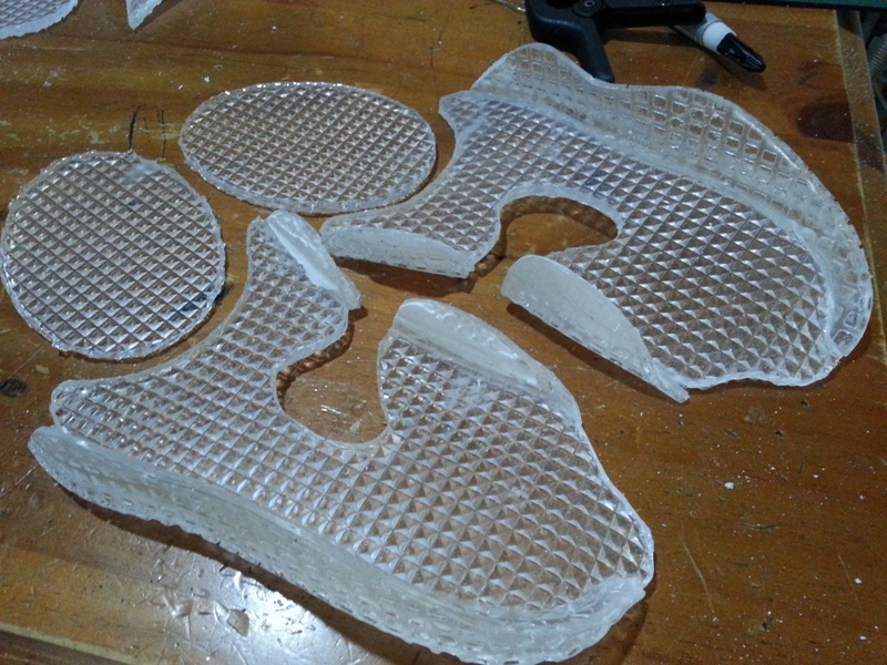

Basically, I have a found a UV stable clear polyurethane with a shore of A65. I have also found a variable shore elastomer, but I need to test that products UV stability.

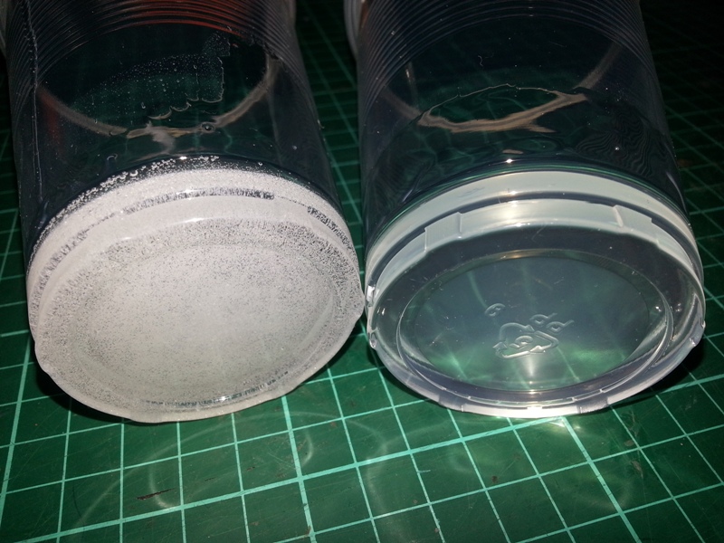

I have a vacuum chamber that pulls a full negative atmosphere and have learned how to mix, degas and pour bubble free now. It has taken time and a lot of money, but it has been a fun road to travel.
You can't make these without the vacuum chamber.
attachment.php
Both cups have the same amount of product. The cup on the left was mixed and left to to cure. The cup on the right was mixed, degassed and then left to cure. Big difference.
Once the rubber is degassed, it is poured and then after the parts are trimmed, you should parts that look like these.

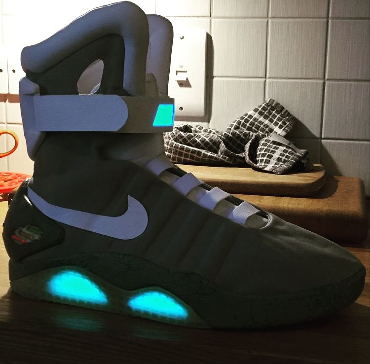

Hi all - This thread has been so helpful over the last few weeks that I thought it only fair to stop lurking and start sharing myself!
I started off with HC Mags and that very quickly moved to me realising that I needed to work on some V2s to really get the best result! I haven't done any soldering or craft work in a long time and it's been real fun so far getting my hand dirty with this Mags project!
I need to say a big thanks to you all for sharing so much. It's made my life a lot easier - and I'll definitely be sharing my ongoing efforts!
So - here's where I'm at so far - one Mag almost there! Judco switch is in the mail. Time to move onto the next one!
I think that I'll need to go back and tweak the EL at some point - but not too bad for a first effort! I may also re-visit the LEDs, as they look ok to the human eye, but don't look too bright on a photo. They could do with being a tad brighter also!
Not only do I degas the rubber for the soles, I also degassed the silicon I used to make the molds as well.
EL looks good. 3V or 9V. Maybe a smaller resister on the LEDs?
Running 9V system with 12v LEDs. I did a test run without resistors and they lit up fine, so I didn't end up using any in the end. I may have to do some trial runs with different LEDs to see what works best.
It is currently using an off the shelf 9V battery. I just had some 300mAH batteries arrive at work today - so I will see if they make a difference. Although my understanding is that mAh should affect longevity of power and not LED brightness.
