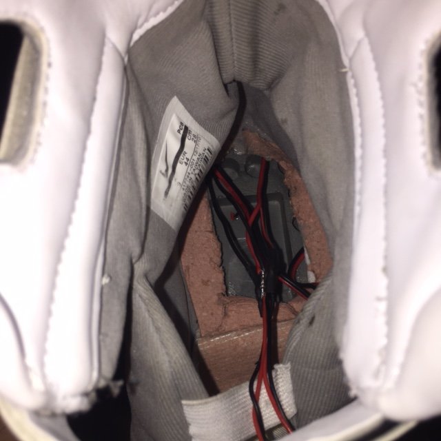

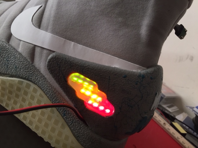

Well guys, I figured out the LED wires and resistors.... Safe to say after just a few days I am very happy with how my MOD has turned out.
I've done everything except the toe slim. I'll probably do that, but am a little concerned. My foot is an 11, I have a size 10, and the shoe fits perfectly. I'm concerned that if I to slim it, they will be so tight on my toes, and even have my toes poking out. We'll see.
I've never done anything like this before. I've seen my dad solder about 15 years ago, and I have no idea how all the electronics work. So anyone that comes after me, it not that bad. Just follow @jedifyfe and @cavx tutorials, and you'll be solid.
A cheat sheet for those that can't/wont read the whole feed:
18 guage wire.
wire tape
3mm 3v LEDs
220ohm 1/4 watt at 5% resistors
use WIRE GLUE on anything that deals with the EL sheet connections... I f'd up one soldering it cuz I was on a roll.
Not sure if this happens to anyone elses, but as my battery dies the green LED dies, then the yellow, then the red... then all the lights.. I wish they all stayed lit, but its kinda cool because it's a real time battery level.
Thanks to all those before me! I'm too stoked.

Congrats on doing an awesome job! Nice to see a new person in this thread putting in the full effort.
My LEDs do the same thing with the sequence of them fading out. Pretty cool how it does that without us trying to do it on purpose, huh?

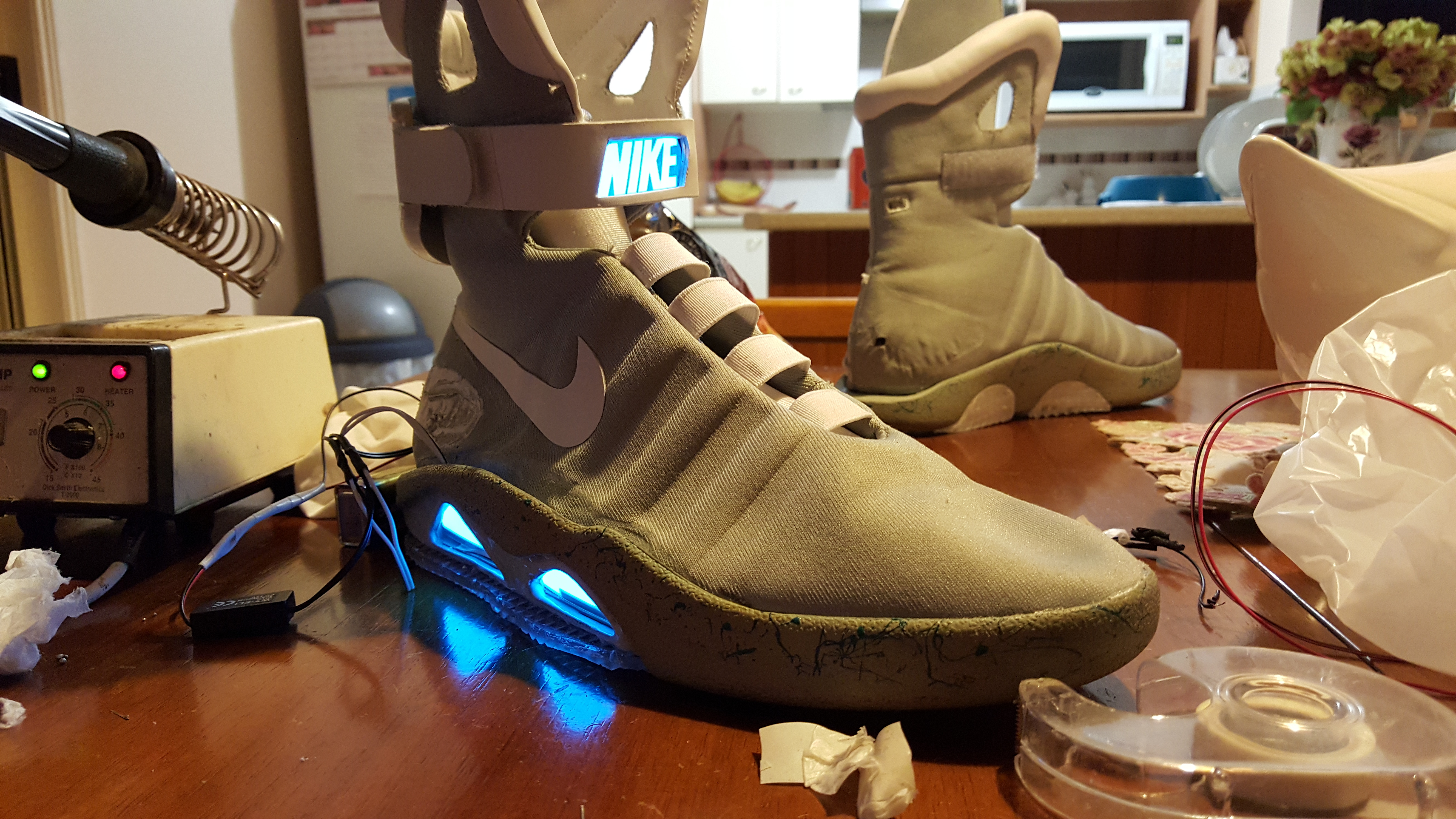

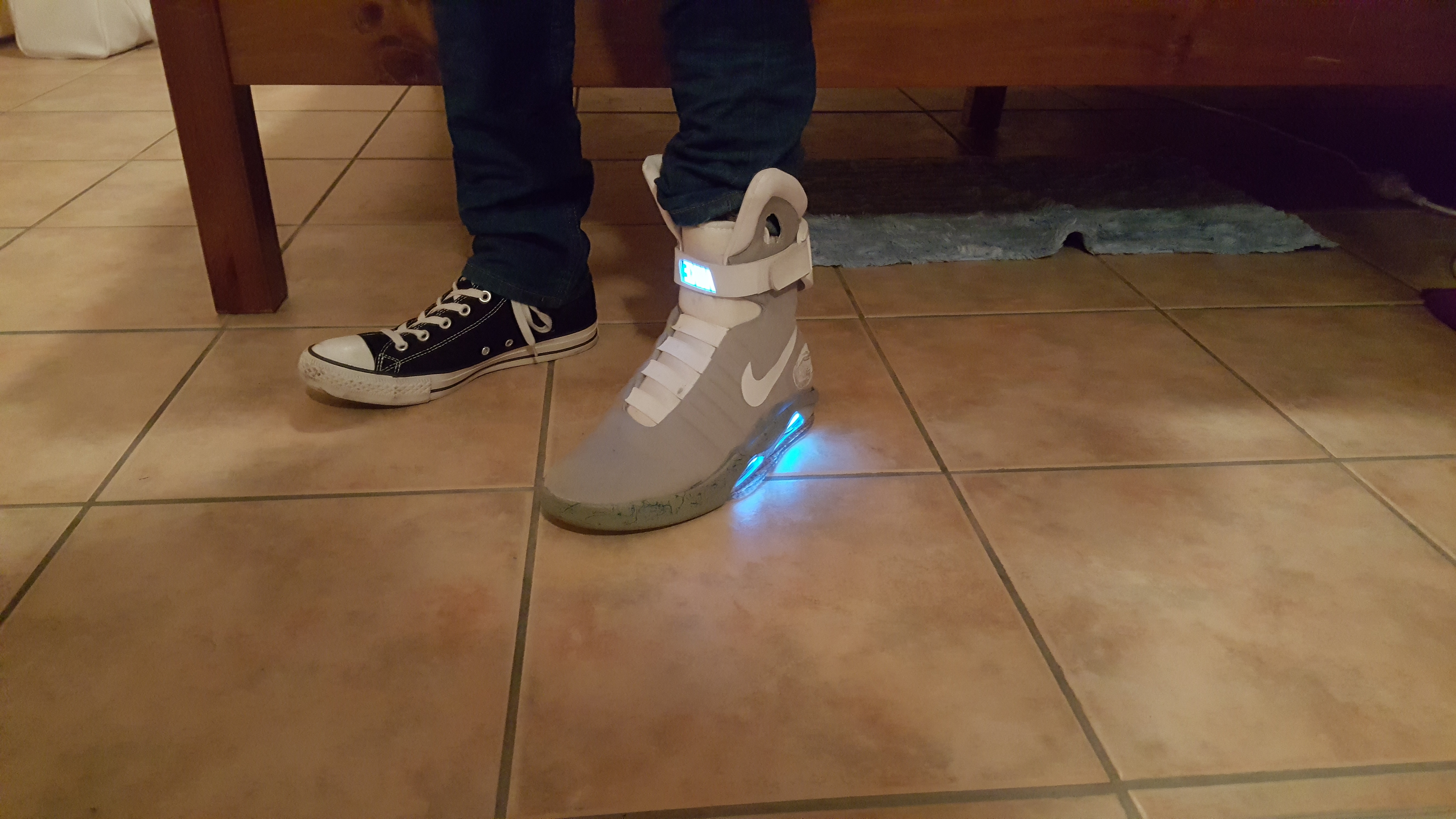

Just received my clear sole from @cavx! They look awesome!
Here's a little test light on my white painted soles:

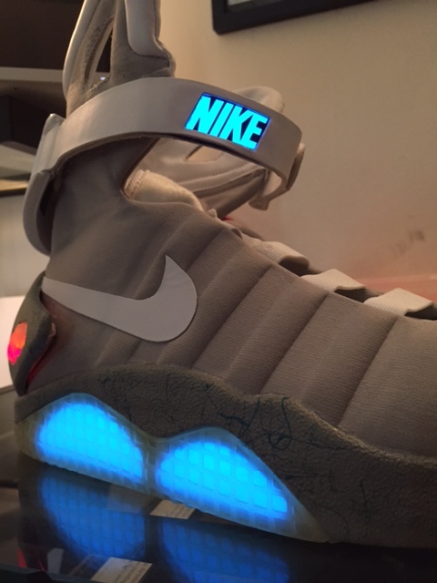

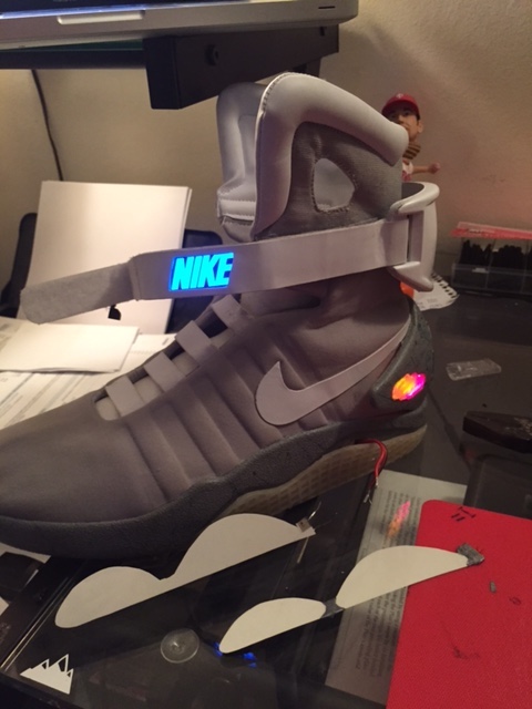

They look awesome vormz, I am yet to get my leds working (@cavx is working on that using EL sheet). I actually mounted my EL sheets on the inside of the midsole;
