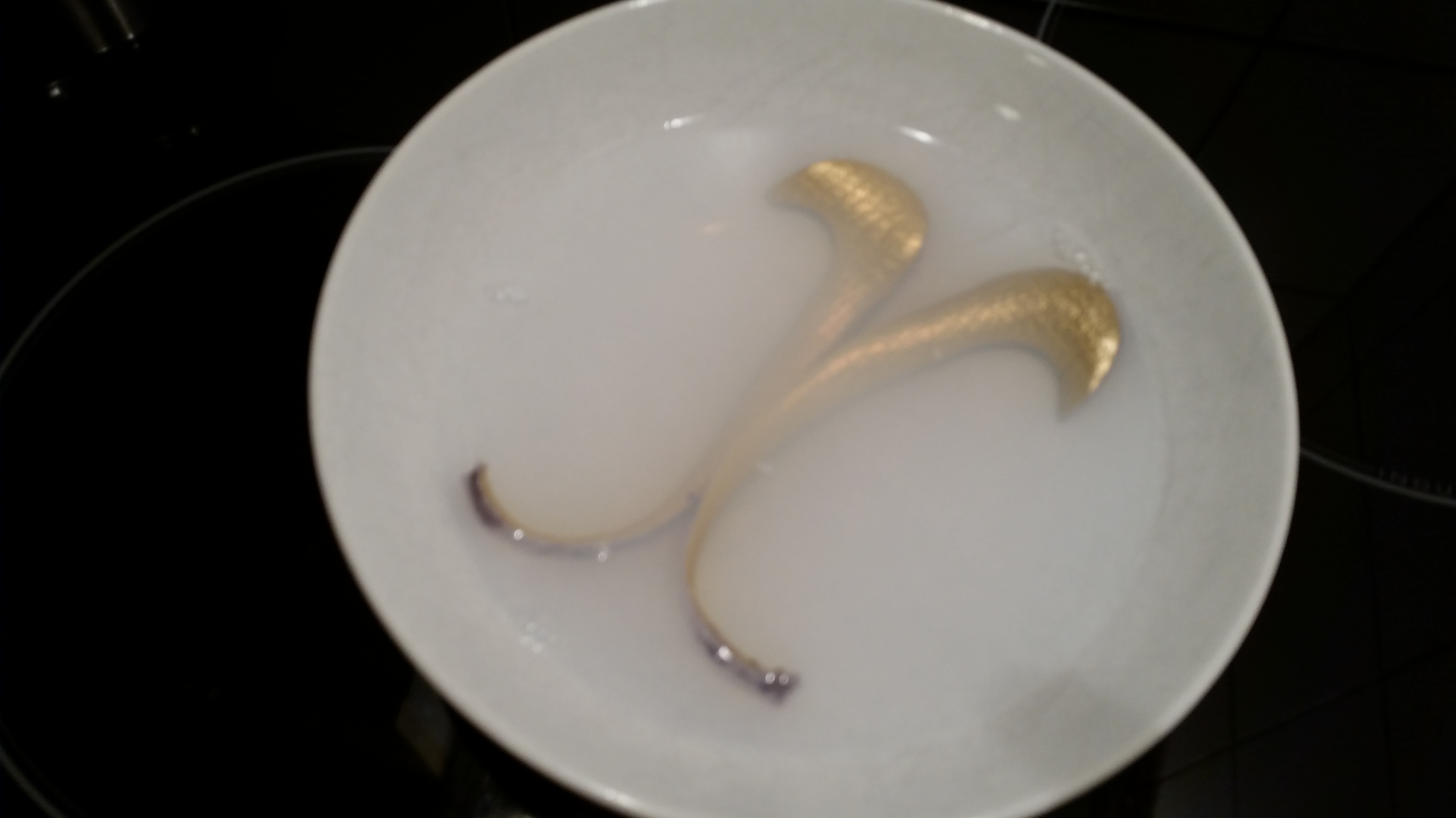

I am making the swooshes taking a bath of water and soap to remove the product that was on it all the night, tommorow i will let them dry and put them between two heavy books to get them flat again, i will probably have to cut a bit the swooshes.

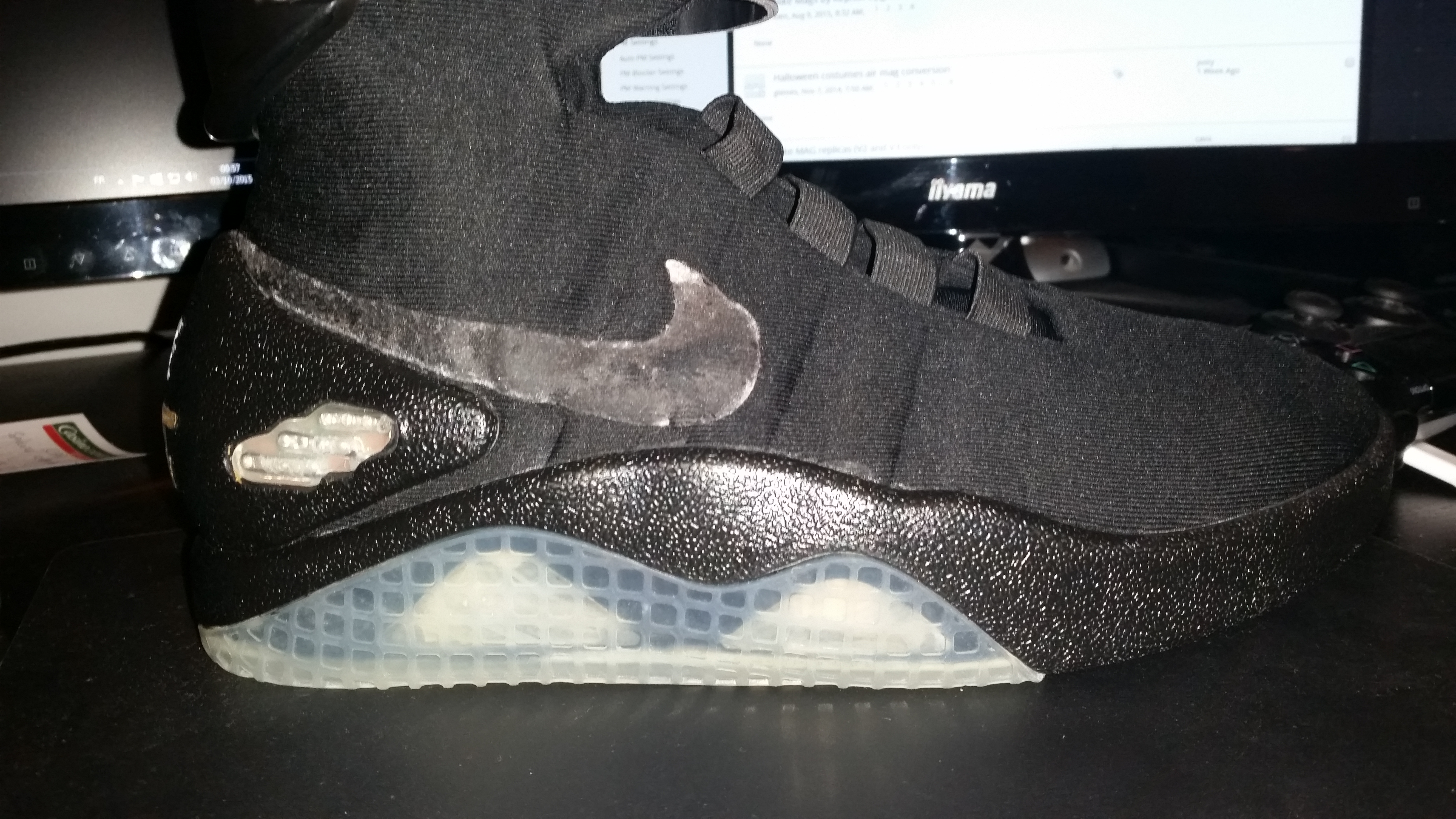

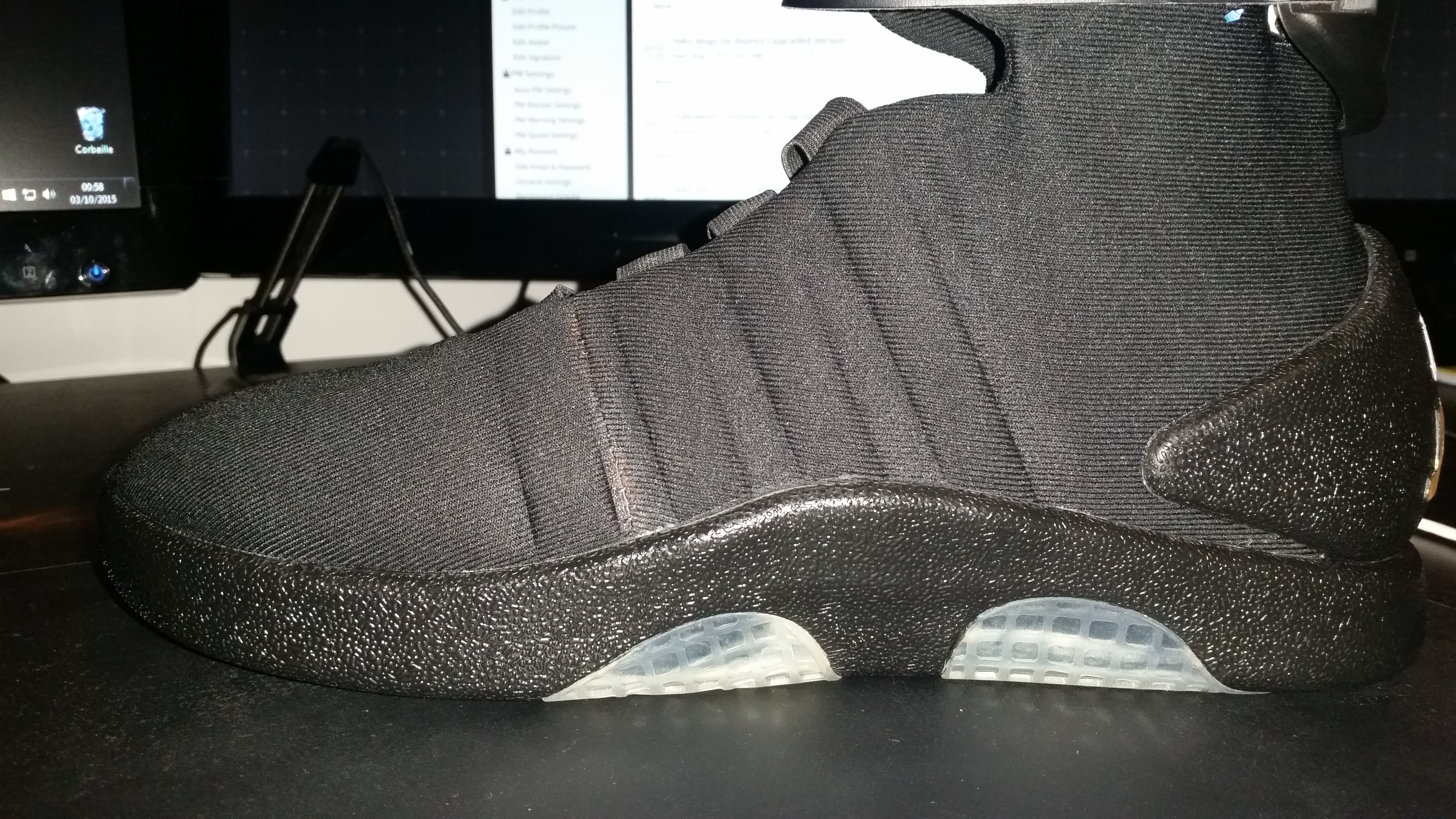

I just did apply a layer of Walk on Black from Angelus and this paint is the bomb ! It is really really perfect for what i needed it is a bit more glossy that the stock paint but it makes the shoes look like more "new" i will show you the pictures when both shoes will have had 2 coats of it. ;)

The painting of the soles went really good, the paint is a bit glossy but the rendering is just really awesome, i made cracking test and due to the fact that the peint is silicone, the paint don't go off and doesn't crack !

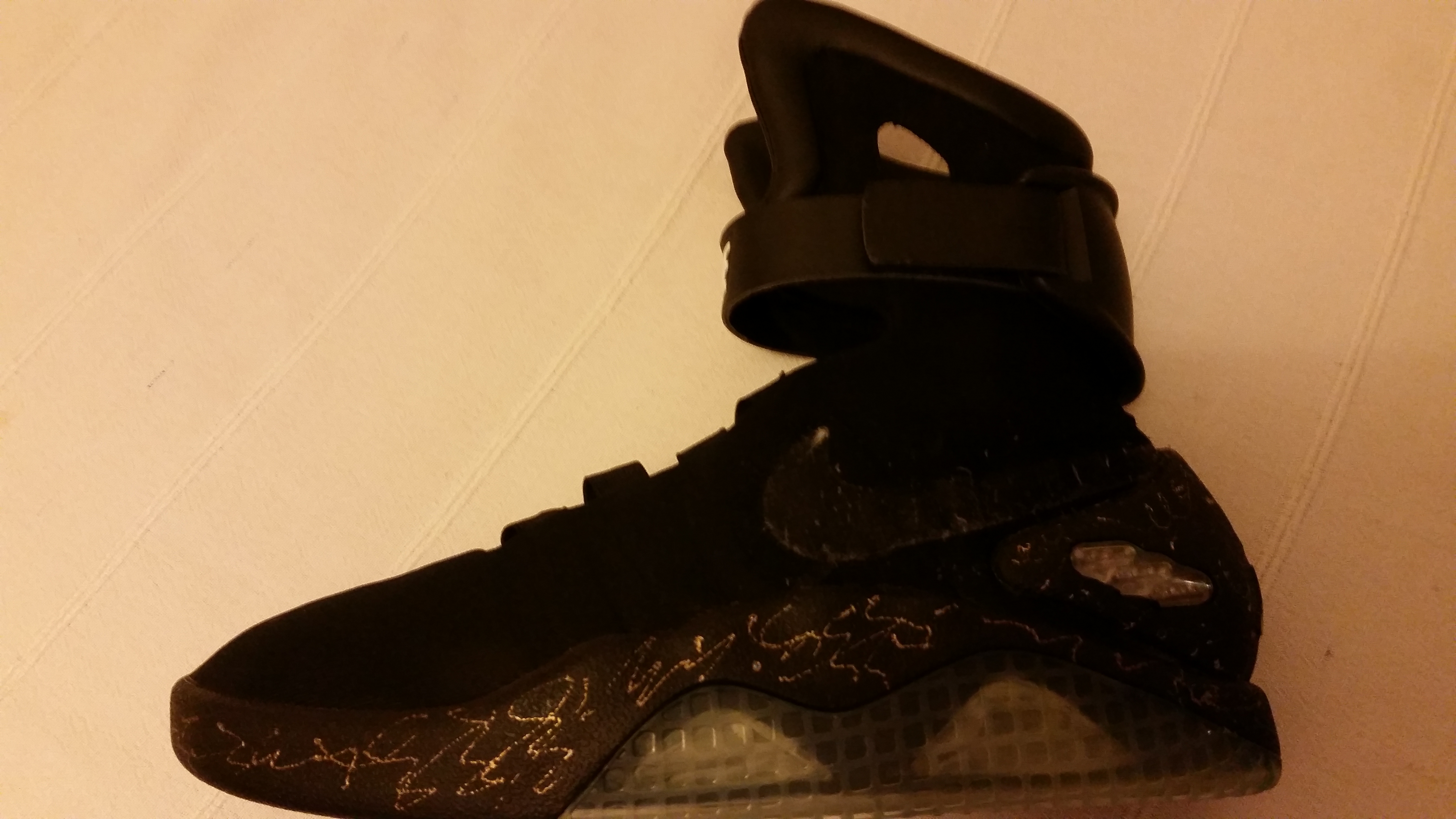

Can't wait to do the splatter now !
Here's the right shoe to give you a preview of how it looks.
I was thinking of not making splatter under the heelcup on the sole due that they will be wearing pair, the white splatter would get dirty too quickly when I would be driving, or you think I should still do the splatter on it to make it more accurate ?
This one @airair, only 2 coats were needed and it is really a dream to paint with.

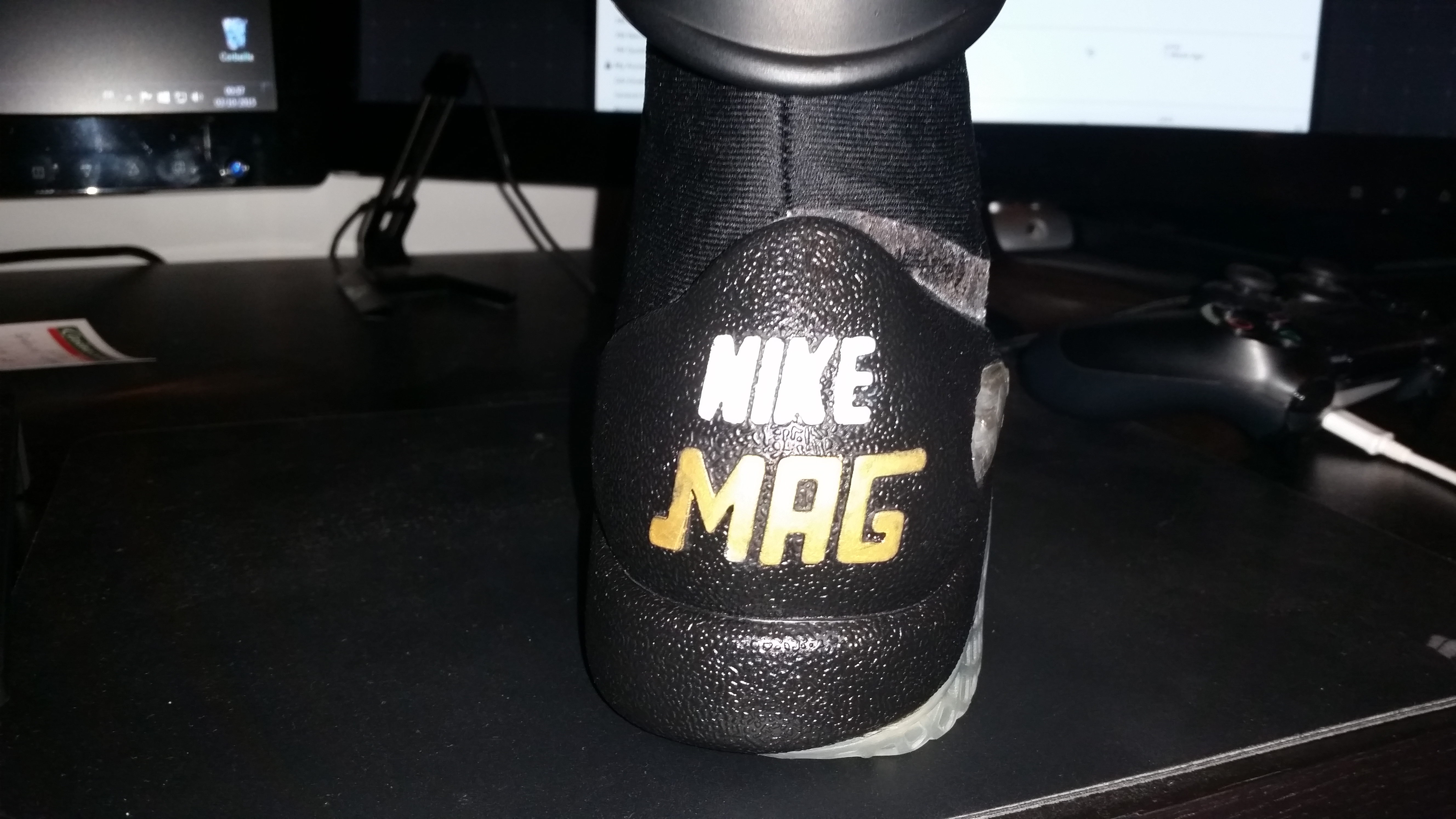

I had a hard time to paint tropical sun yellow the MAG logo, (15 slim coats), the paint isn't easy to work with at all and it tends to make bubbles, and lil hard paint parts in the bottle when it dries.
The weather isn't fine so i can't do the splattering for now, because i want to try it first on a cardboard to get the right technic.
Tommorow, i will apply a second big coat on the MAG logos, repaint the nike logo on the heelcups, redo a black coat on the heelcups to remove all the mistakes and gold paint that i can still see on it.
