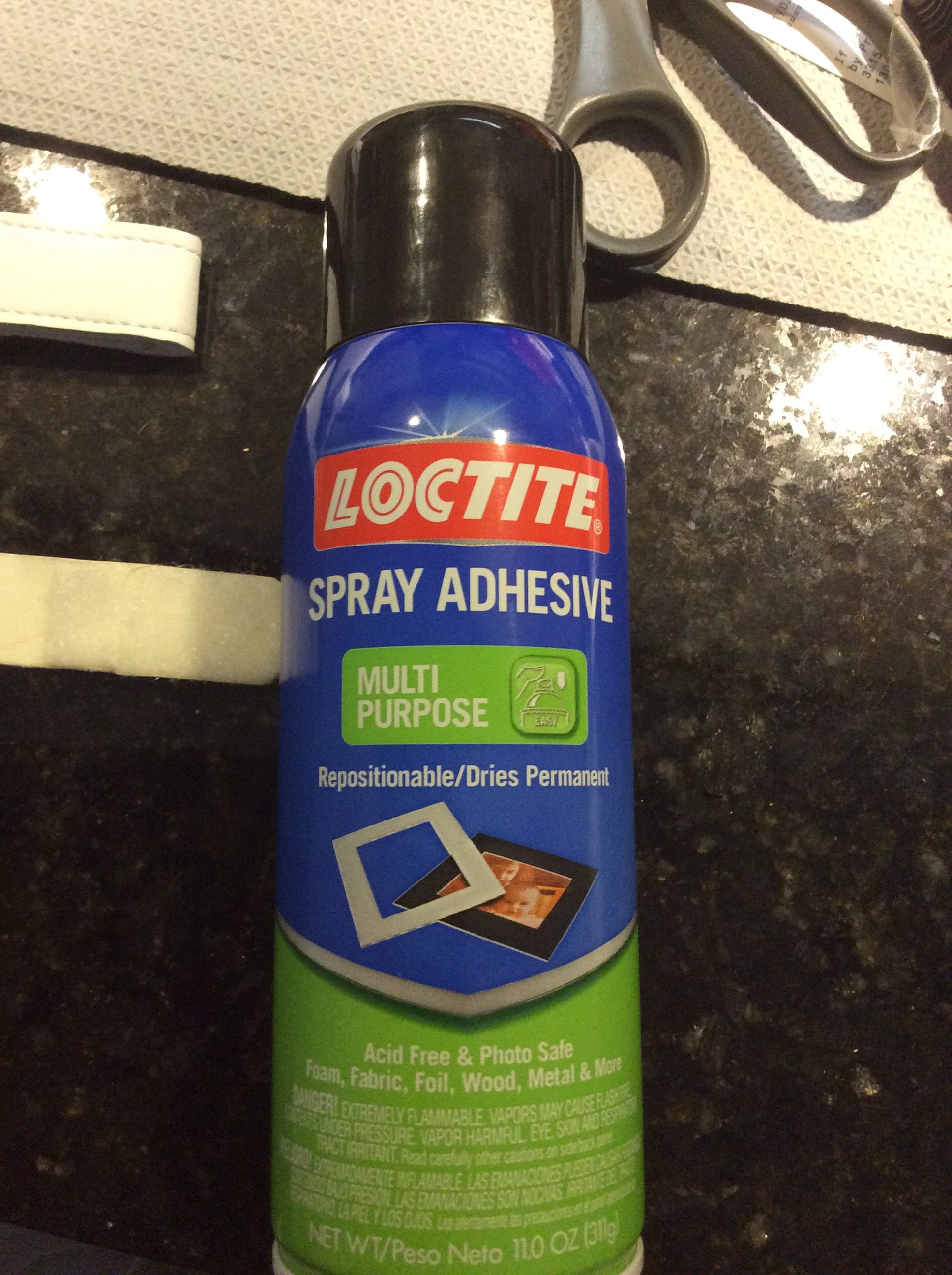

One thing I've noticed is that either I'm using the wrong glue or I didn't spray enough. It's been slightly separating in certain spots especially around the NIKE decal. Any tips?
Use a good strong contact adhesive (preferably clear as a lot are in yellow or green) and brush on both sides of the strap you wish to glue. Don't put too much around the where the Nike logo will be as when you press down, you don't want it to bubble and go over the exposed logo, but put a nice thin layer on both sides.
Let it dry for a bit (not sure, but usually a good 2 or 3 mins normally), then carefully you can glue the strap back, making sure you do it slowly and ensuring you curve the strap as you are glueing it down, and to prevent any seperation spots.
I've used this method and it works pretty much perfect, and have never had a seperation spot.
You are having the exact same issue which lots of people have, and that is that the spray glue is just not strong enough overall to stick the leather/faux vinyl together.
The spray is also messy and just attracts dirt very easily.
If after glueing, you find any of the edges are slightly seperating, just put some more contact adhesive with a thin piece of plasticard or cardboard, wait a minute or two and just seal the edges up.
Then once you've glued together, just put some pressure on the strap, put some books on them or something heavy and flat and after a few hours should be good to go.
This is the best solution imo, easy, no mess, and none of those seperation spots which ive seen on countless examples.
I've done so many using this method and even I was surprised at how clean they came out, like a factory finish literally.

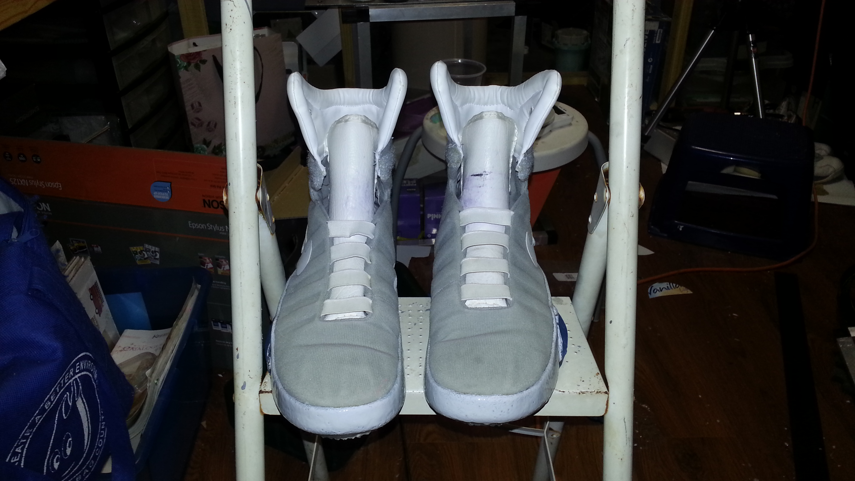

So not happy with the grey paint cracking and peeling, so I re-did my mid-soles with something a little different. I'll post the result in the morning after this has gone off.
