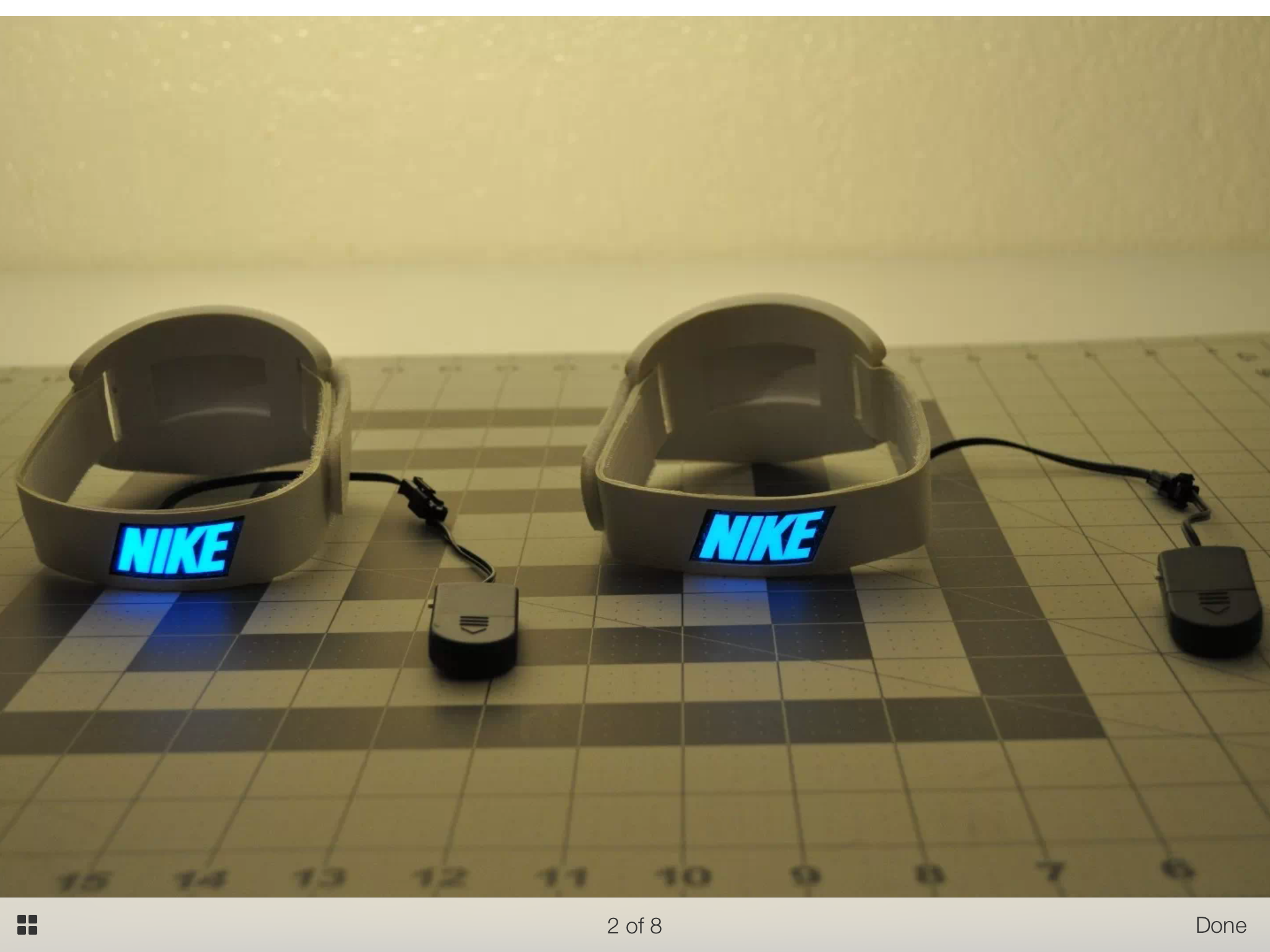

Have you guys seen the listing on ebay of that guy selling the Mag straps with the EL Nike for 200? What set up is he using? It looks so simple. I'd love to buy something that's ready to go like that kit.
Thats most likely Markpoon, he sells them for cheaper in the "project runs" junkyard section
I don't think the listing I'm talking about is Mark's. Here is a pic. image.jpg

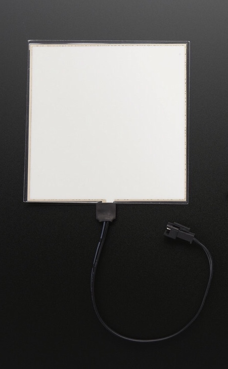

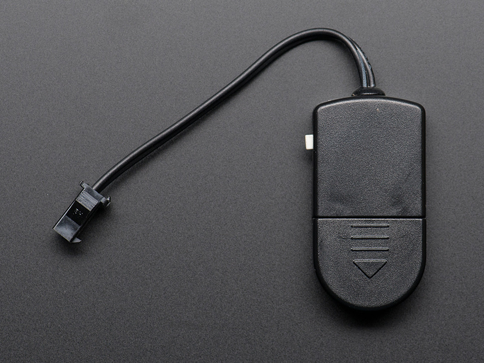

Would these two items be all I need to duplicate the setup of the listing on ebay? I know a cell battery is not very powerful but as long as it works, I'm ok with it.
You will probably have to store that box in the collar somewhere, but plus the attached NIKE sheet and you should be well on your way.
