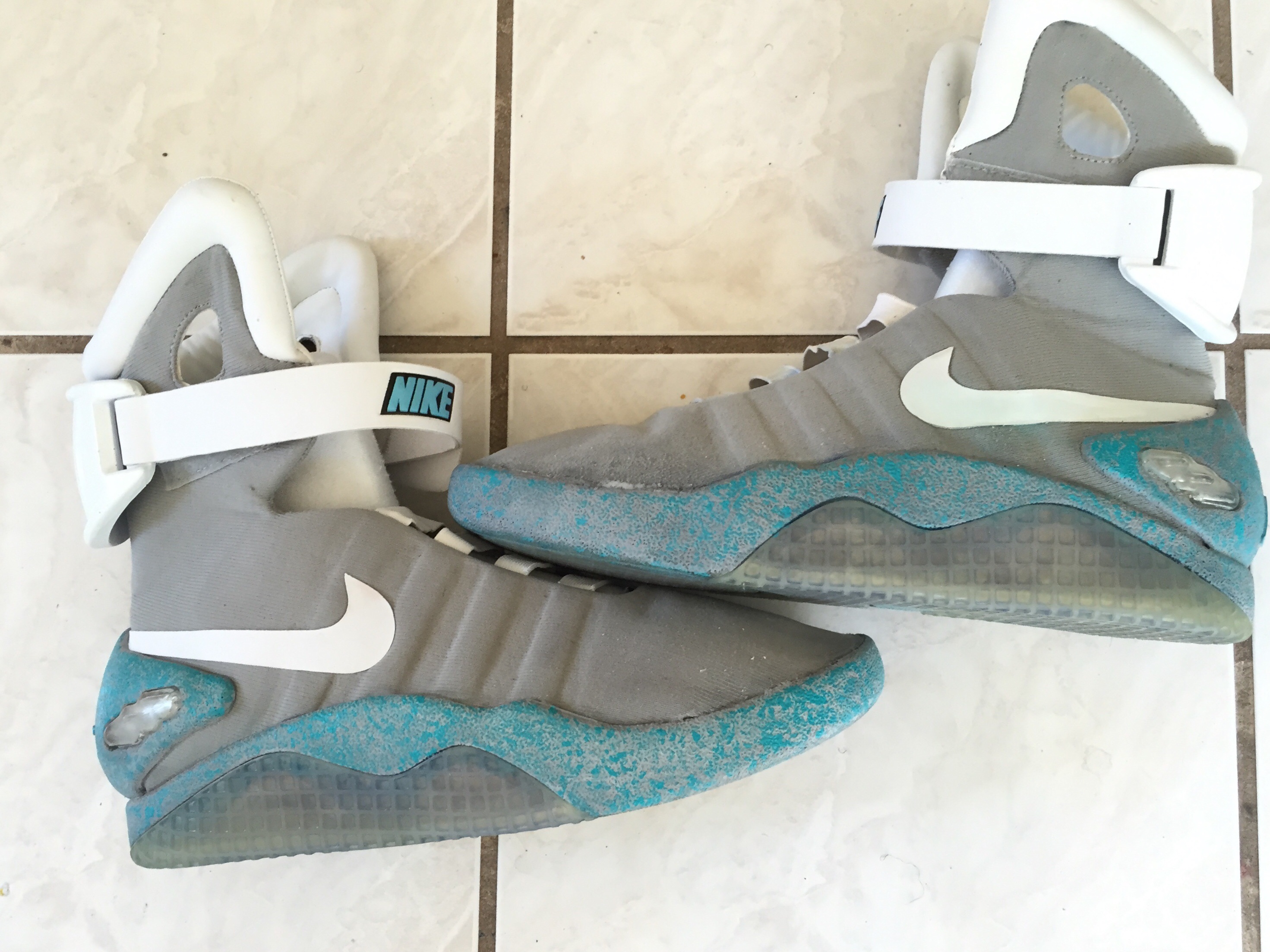

Hey guys, decided to post my latest updates to my V2s. Updated the splatter and midsole paint job and tinted to soles blue to prevent further yellowing. I know many guys here complained about the yellowing. All you need to do is just mix fabric dye (royal blue) with either water or sea glow

WOW This looks really good.
What grey did you use for the mid-sole?
What aqua (is it equal amounts of green and blue?) did you use for the splat?
Did you use a small brush to apply the grey or is it sprayed on?
As for the blue dye, I think that is a bit of band-aid solution as the soles go yellow right through the cross section. It will suggest that this blue dying will probably need to be done or touched up from time to time - probably at least every 6 months.

thanks bro! For the grey, I pretty much mixed it by mixing a 2:1 ratio of white to black, resulting in a slightly lighter grey. The splatters I did with a small paint brush. I twisted some onlf the bristles to allow more of them to be separated and give it a messy look. The color of the splatter is the turquoise color paint from angelus, which is pretty much a perfect match color wise. The default splatter and Mag letter color was really off, and the grey of the midsole was slightly off. As you can see, I'm basing mines more off the 1989 screen version and not the 2011 release.
as for the dye, it will hold on the sides of the shoe for at least a year. The bottom of the shoe should hold up pretty well too, as long as you don't wear the shoes in the rain. I have dyed sold before and it acts as a great barrier for yellowing.
The only thing I need to do now is swap the electronics or have someone do it for me and these will be the perfect Mag solution for me to wear
