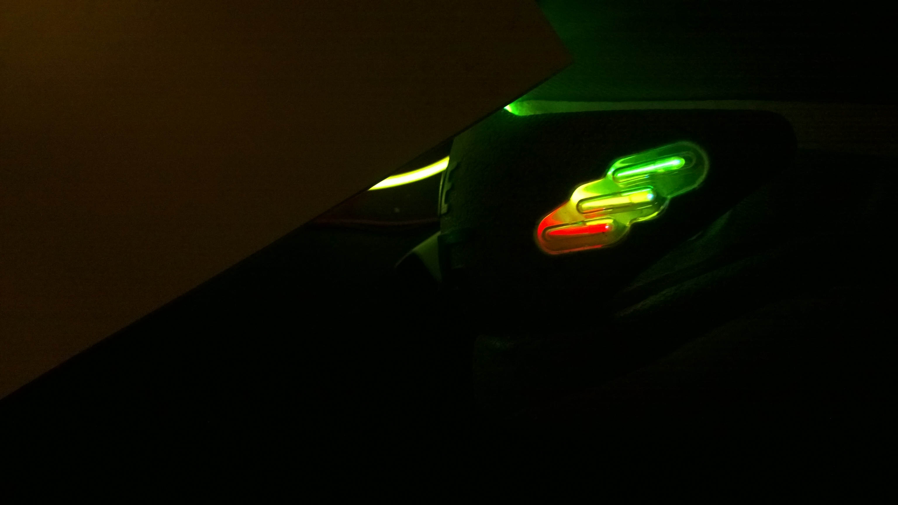

I've been experimenting with el wire to go in place of the red yellow and green leds. I first bought 3.2 mm standard brightness el wire and it looks pretty good. I just got some 2.6 mm ultra bright el wire but haven't had time to mess with it. The picture doesn't really do it justice.

Are those all one piece or separate pieces of EL wire?

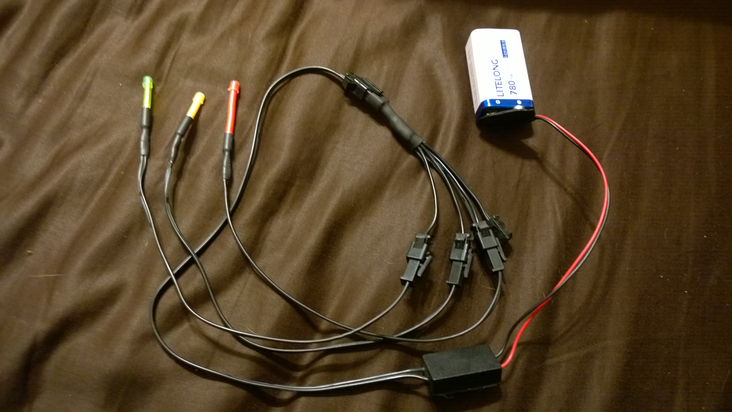

You can cut el wire, you just need to cap the ends and the el wire only has to be connected on one end. I'll try to get a pic of the setup when I get home but its just the inverter with a splitter to each el wire.
Fascinating developments! It's surprising that the LEDs are the power hogs, I would have thought the complete opposite since LEDs are supposed to be so energy efficient (relative to incandescent bulbs), and the EL panels are so big and are really the main part of the "show" on the shoes.

Mitas: Here's a pic of it out of the shoe. 9v - tiny inverter - splitter - red, yellow, green el wire cut to ~ 1" long. This is just my test setup, looks a little crude right now.

That looks ace! I actually think that thin strips of solid colour look better than the 'spots' of colour LEDs produce. This is clearly the way forward not only for insane battery life, but also looks and more importantly, reliability. The weak point of anyones Mags has always been the LEDs as they are on the ankle and flex too much. This is definitely a win, glad someones got the time to test this idea out!

It's pretty flexible and seems to be fairly robust. I think it will hold up well in the ankle bubble. I plan to use it instead of leds in the shoes I'm going to wear.
