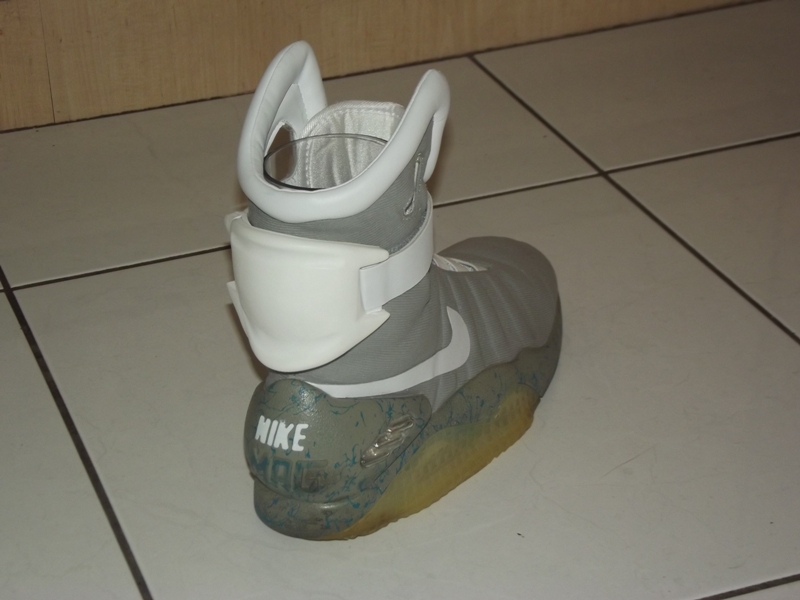

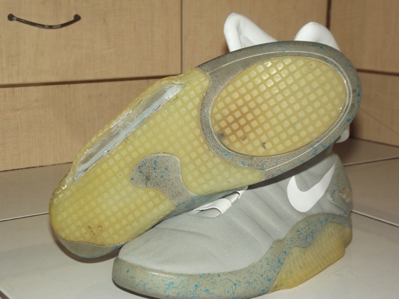

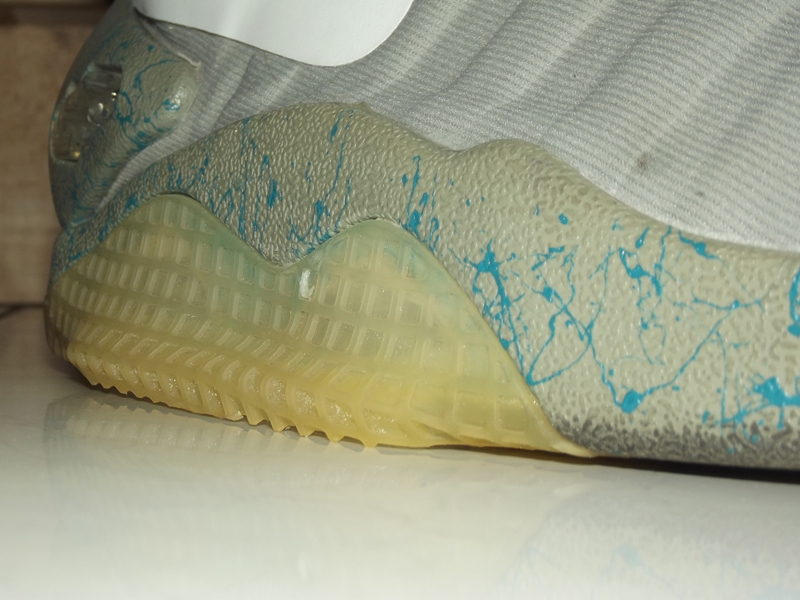

Looking at my shoes again and I want to attempt a small cut (the length of the lights) underneath the sole along that line that runs along the outer edge. I want to see if it is possible to add something inside there to bring the base of the sole out a bit - say 1/4". This should give a more closer representation of the "outrigger" soles on both the movie prop and the 2011 MAG and if this works, will make these shoes look very cool.
If it works, I do intend to take a cast but before I do, I will also add pyramid mat to the base.
And tonight I did this
That looks sweet man, What type of plastic or material did you put in to make it bulge? Great idea. :)
Thanks optiprimo :)
I used 3mm Poly-Carbonite because it flexes and cut out a wedge for each shoe. In plan (and that is how they sit in the shoe) they look like a really long D about 10mm wide.
I used a Dremel with a fine cutting wheel and used that line on the base of the sole as a cutting point.

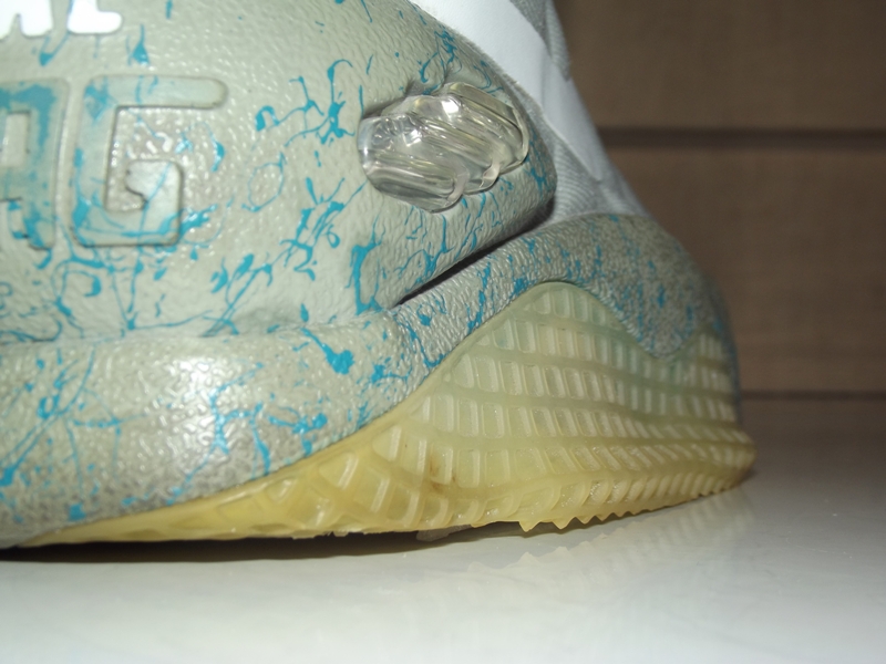

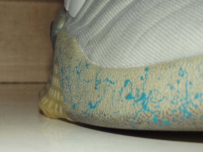

attachment.php

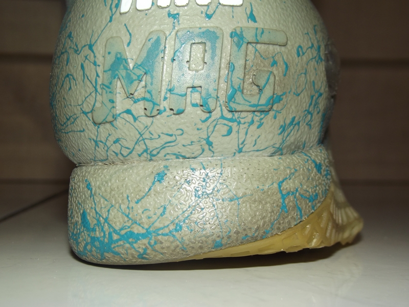

It is not quite the right shape as I think the RD has more lean, but it might be possible to get this if I can get the clear (wow how yellow are they now?) rubber to come away from the grey mid-sole.

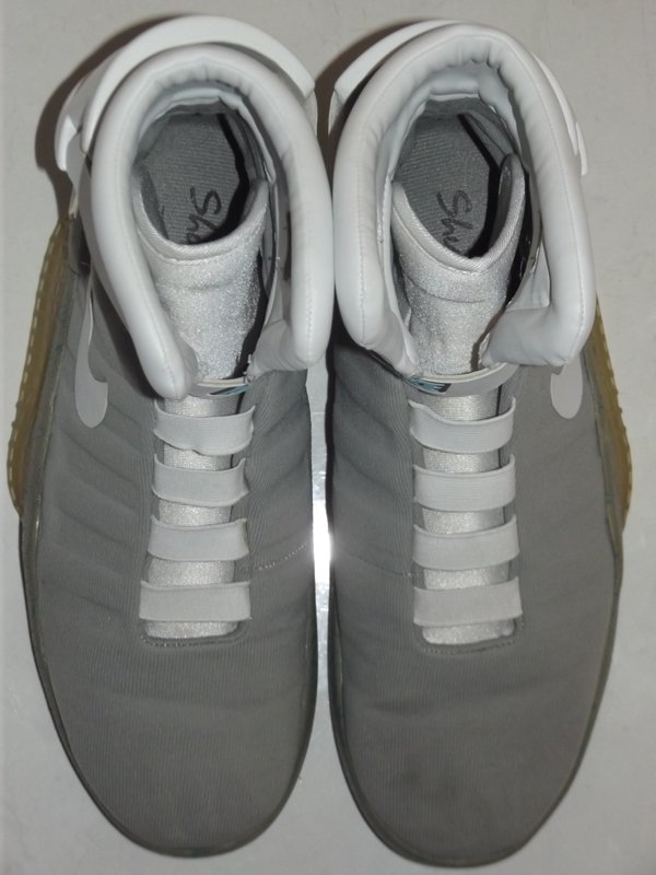

I'm still a little confused on what exactly you did and is the shoe still flexible in the middle?

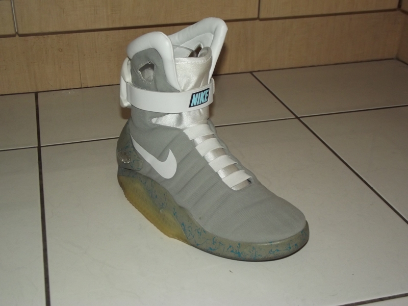

Hope this tells a better story.
attachment.php

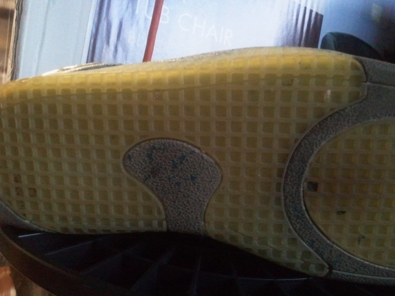

This is the look I want, just don't like yellow for the sole.

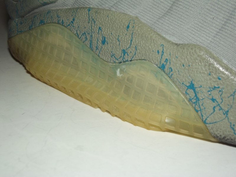

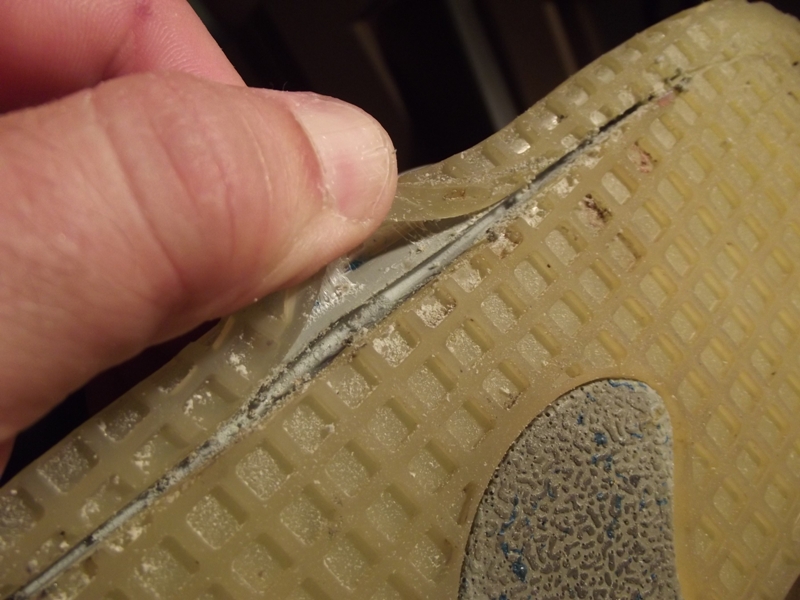

So using the fine cutting wheel, I sliced along the line you can see on the base of the sole. I marked to points so i didn't cut too far and then finished with a sharp blade.
From there, I peeled open the sole and worked the rubber away from the mid-sole.
I had pre-made my wedges and then kept working the rubber until I could get the poly-carb parts into the gap. So the grey you can see is the mid-sole and I have simply stretched the yellowing clear into a new shape. The polycarb will flex because it only 3mm think.
attachment.php
If you remember back to my last clear sole project, I used this pyramid mat as a mold which gave me a negative impression as the thread. I will be cutting and gluing this same mat to the base on the shoes to get a positive impression on the base of the sole this time. I also now have a vacuum chamber, so should be able to get bubble free casts.
