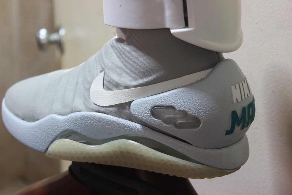

Hey man yeah, I actually unstitched the finger holes so i can put something/foam inside to at least make the 'wings' more rigid. Also made a 'draft' of a smaller swoosh because the v2 swoosh shape really bugs me. My plans are really at least to make the vamp come in the sole lower since i noticed that the vamp to quarter(sidewalls) of the v2 tend to go straight and high. Thanks! :)
Heres a pic of the swoosh, it kinda has a grainy texture feel to it though. Might need to find a smoother type of leather.
