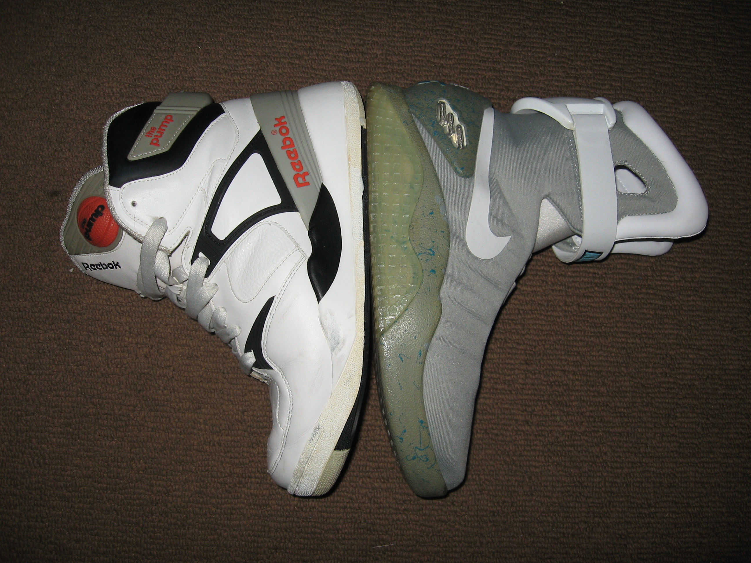

well I need a good project for the winter, and I think its finally time to pull the trigger on these and start modding them up. since you all have had pretty extensive experience with these by now, what size should I get if I usually wear an 11? I seem to recall they run a size small. they have no padding in them, and id prolly replace the insole and wear thicker socks for comfort, but I also don't want them to be loose around the ankle and rub either. so im hoping yall can help me decide between a sz 10 or 11? =)
Hey Lore.
I usually wear a US 10 and ordered 9.5's in MAGs.
They seem to run slightly big. With a pair of Ultrasport insoles over the top of the insoles they come with, they're pretty comfy.
(available from) - Footcare Shoe Products Ultra Sport Mens Insoles 1 Pair | eBay
though if you're in Australia (which your post doesn't say) you can get them from Woolworths or Big W.
If you want a size comparison, heres a photo of size 10 Reebok Pump Bringback vs size 9.5 MAG V2 replica. :)
Good luck with your mods! (I've been a bit slack and haven't modded mine as you can see)
