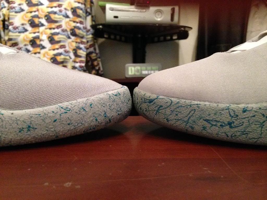

could you possibly post up a picture of your RD shoes side on touching toe to toe with the v2 one?
I'm trying to see how much bigger the grey toe area is in comparison

Like this..?
thats perfect.
how many mm do you think the front grey toe part is compared with the originals?
it looks like a few mm, not much.

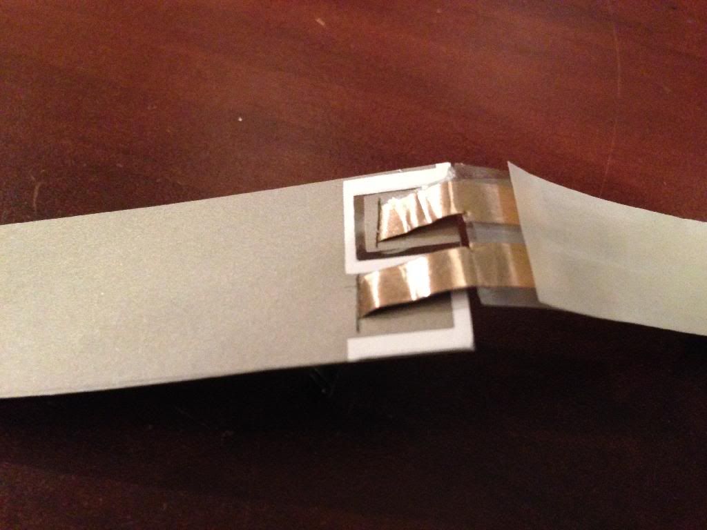

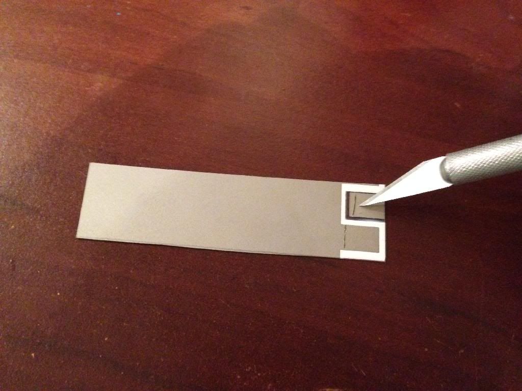

I think I have found a very secure way of attaching the wire tape to the EL panel without using solder or wire glue.
First cut small slits in the EL panel where the wire tape will slide through:
Next, cut the wire tape to fit into the slots and feed it through. Make sure there is enough to go very far through the slots and wrap over onto the other side.
Using a VERY SMALL amount of super glue or Loctite, glue the EDGES ONLY of the wire tape to the EL panel.

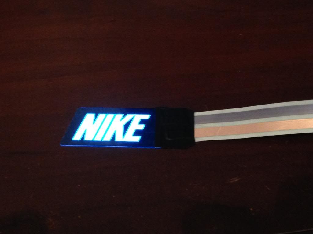

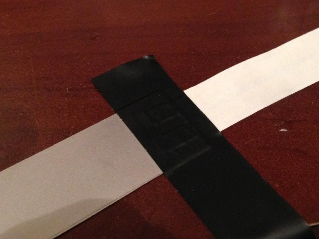

Cover this with black electrical tape and press down making sure everything is secure:
Wrap the electrical tape over to the front side and over the NIKE sticker you placed there:
Trim the excess tape off and light it up.
I have found that the tape can NOT come detached from the EL panel. It is VERY secure.

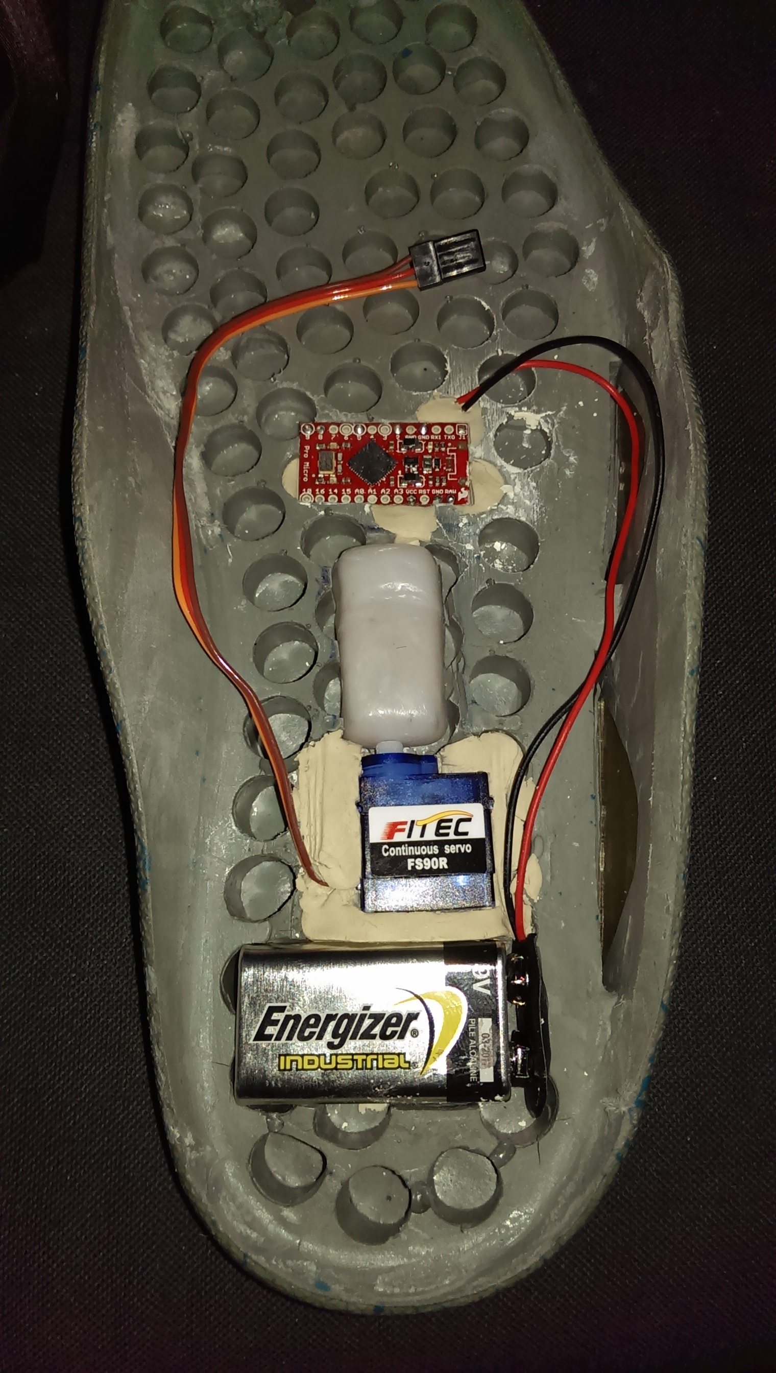

OK guys here is an update on auto lace project. I know I said I was going to wait till January but had a little free time so I did this. I fabricated an enclosure for the mechanics fitted a servo, battery, and board for fit and feel. Test shoes are too small for me but when put back together I had my daughter put her foot in and she could not feel anything under her foot so .... so far so good. IMAG0069.jpg
