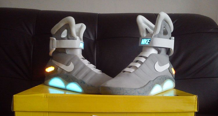

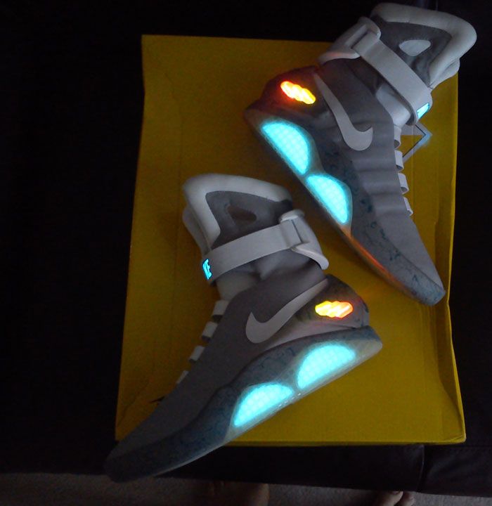

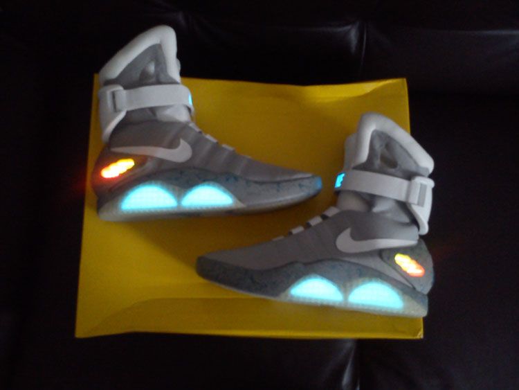

anyway, here's some pics of a recent conversion I did for someone.
WOW! They look very good. Loving that toe.
I wish I was brave enough to take to my shoes with a scalpel and some glue.

Wow, your recent conversion looks pretty damn good AirAir! The El in the sole is a nice shape, the toe looks slimmed correctly and the rest of the shoe looks super clean and professional. Nicely done!
Where do you buy your EL sheets from AirAir?
Thanks...
Thanks...
i bought them from ebay a while back.

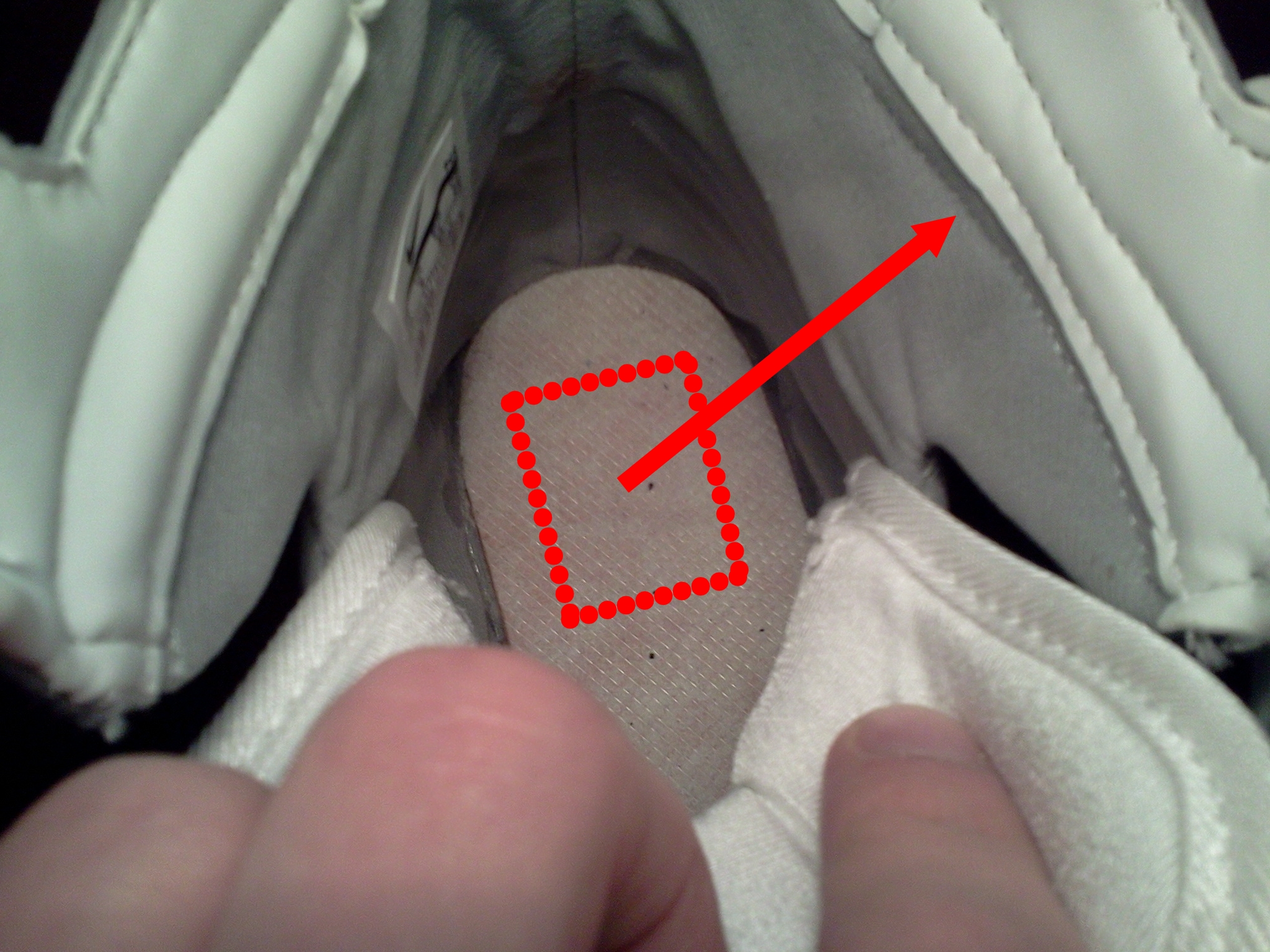

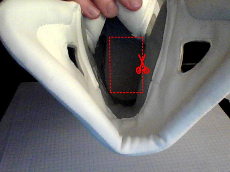

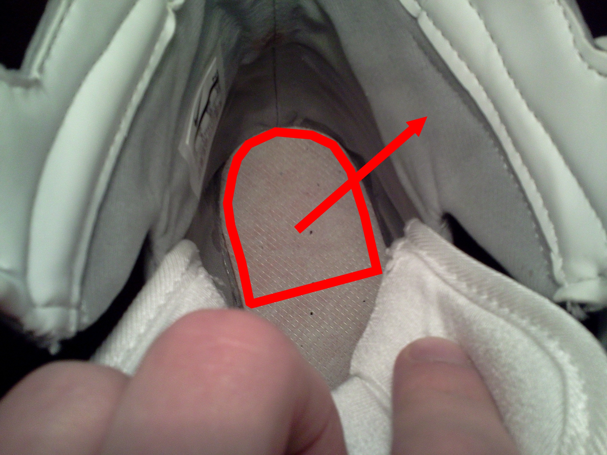

How can I remove that pink cardboard in the sole ? Do I have to cut a small part? :behave
I did some photos, which idea is better ?
Choice 1 ? 2 ? Or 3 ? Or other idea ?
Best regards. You're a good community. :cool

Xacto knife just cut it out like 1 but a little longer towards the tongue. Although it doesn't matter that much as it will be covered back up by the sole.
i would basically rip all of it out.
if you are doing toe modification first, it will easily come out.
I do the toe modification first, so i can easily access the cardboard and just complete rip all of it out.
and then try and remove as much from the edges as possible.
it comes out fairly easily if you are doing it from the front of the toe after you've opened it up.
cutting out a hole isn't really advisable, as the cables from the existing wiring are running underneath it,
especially from the sides and the back of the shoe.
