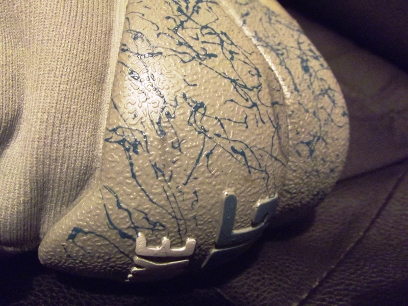

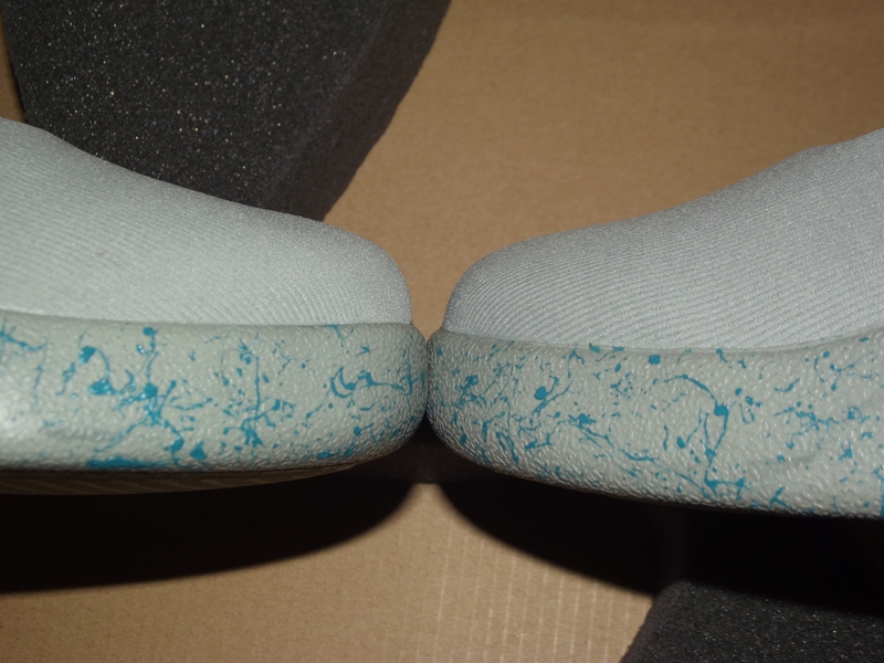

At least I don't have to re-do the splatter. How good is this for out of the box?
Yeah I am lucky. The only thing I can 'fault' with these shoes is the right set of Heel Cup LEDs has moved or not been placed properly. They all work, just the lights don't quite line up with the bubble. Other than that, they are very good and I am very happy to have these. I am still going to continue with my scratch builds though.
the splatter is not even an issue for these shoes.
i don't know why people are concerned with splatter. if you look at the movie shoes, the soles are actually light grey and splater is minimal, especially if you inspect the screenshots and reference images of several screen used pairs.
i don't know why the RD versions have so much splatter as though its an integral part!
if you really must though, i guess doing it by hand is the only option.
I agree. I think most people are trying to make these look like the RD's rather than the movie shoe. I like mine to be a cross between the two shoes. That's why I don't mind if they have the white/clear soles rather than the icy blue soles.
If I ever get around to my movie accurate pair, then I'm going to repaint the midsoles grey to cover up all of the factory splatter and do the movie specks. In the movie it's just mostly dots.
