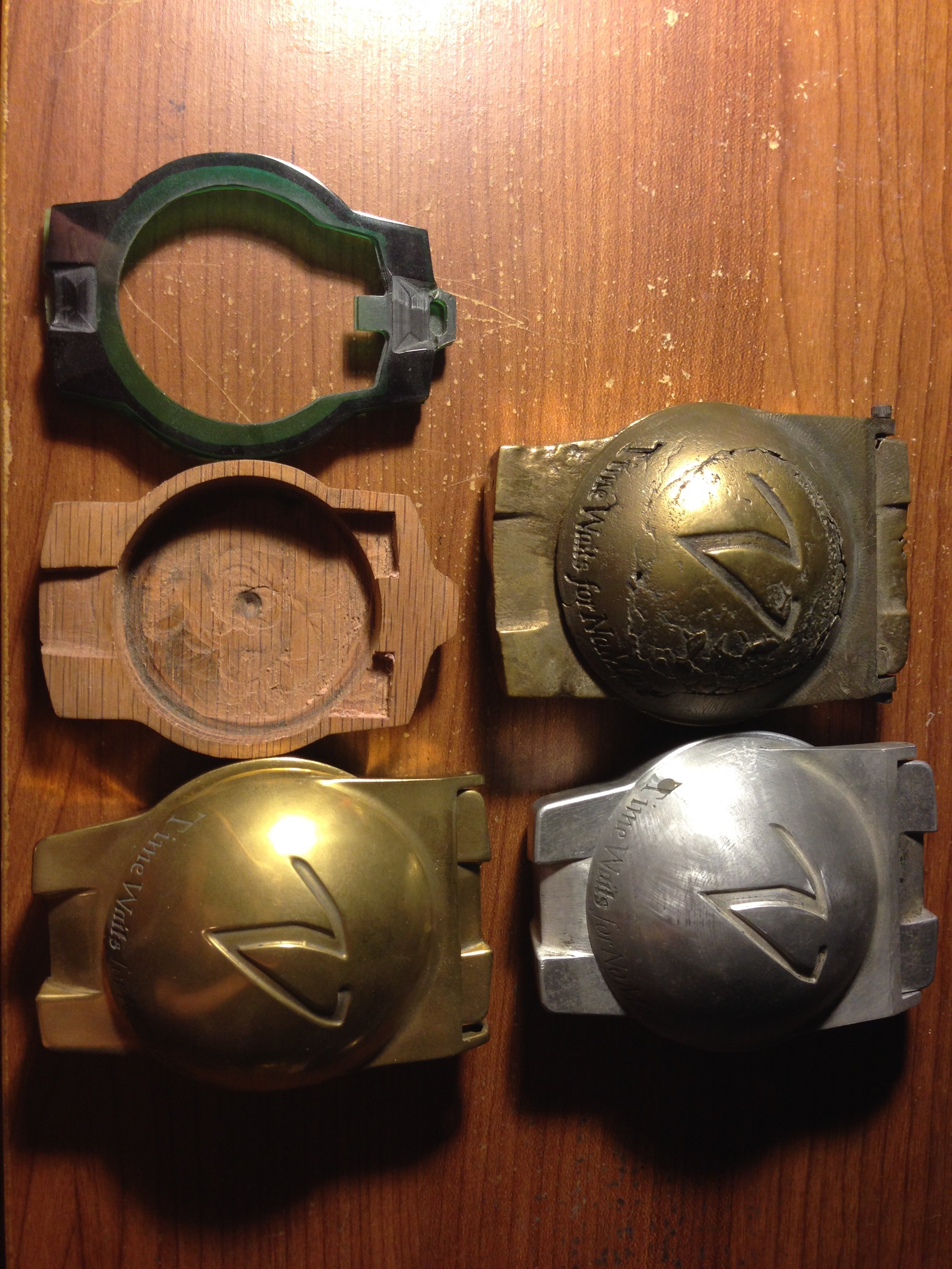

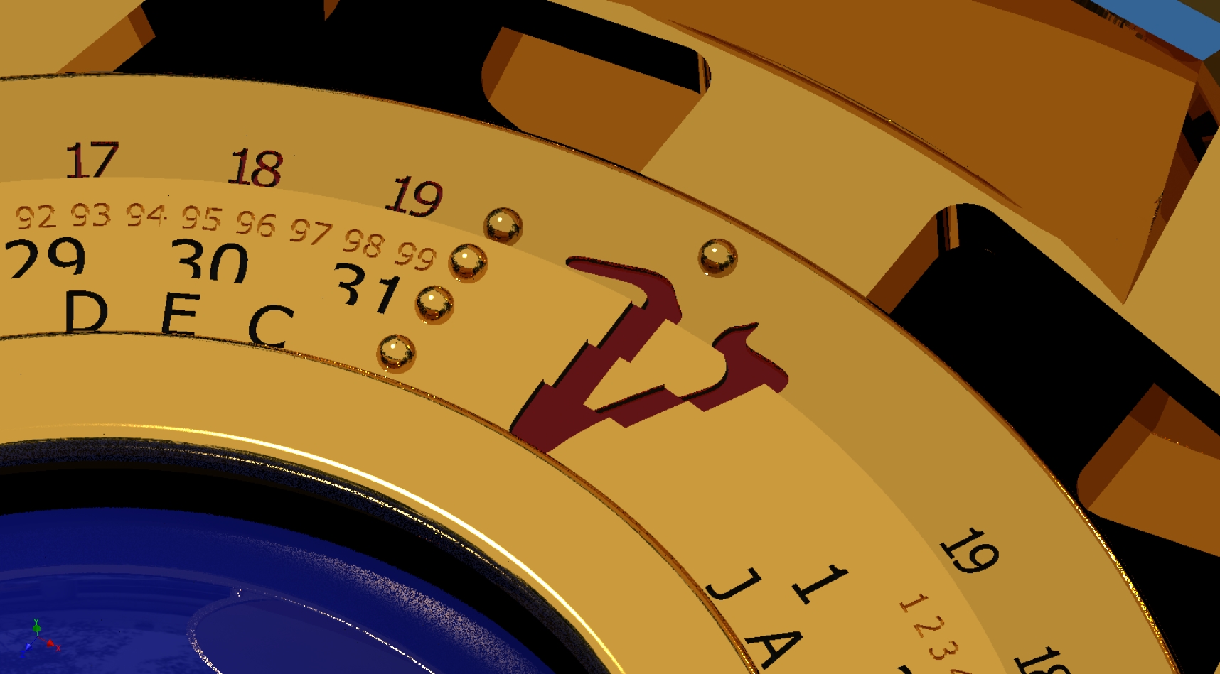

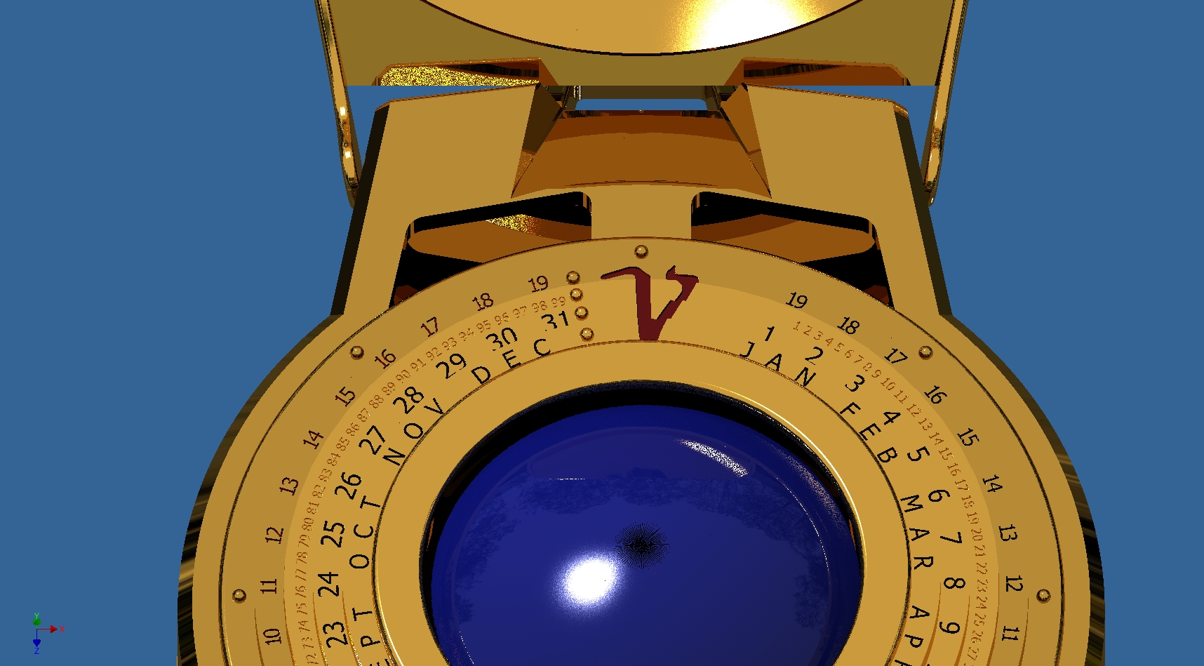

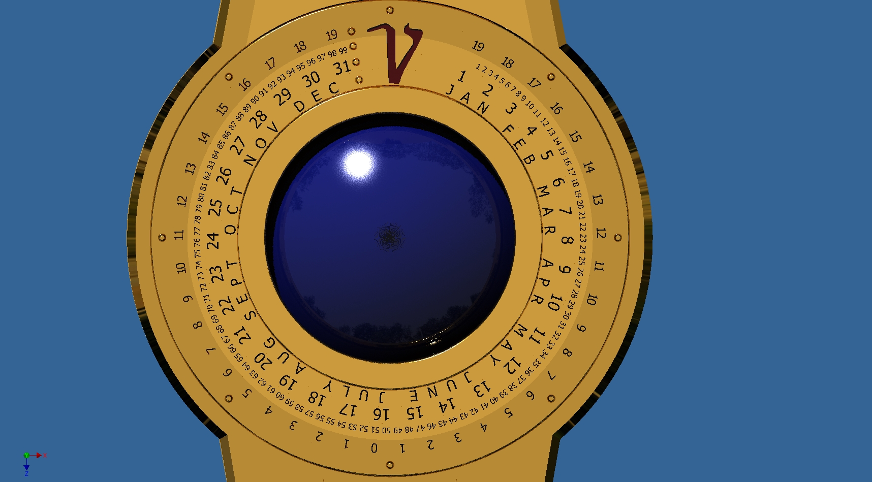

Fixed the distance between the numbers on the Century dial. Adjusted the spacing between all dial engravings when lined up. Placed rivets on base and dial assist locations. Also added a little color.
Hey Rob it really does look amazing!! A couple of things I noticed was when looking at the omni in the intro to Voyagers.It appears that the rivet after Dec should be a little closer to the C perhaps?? Also the numbers look excellent but if you can maybe take a look at the months I believe the letters should also be closer together now?? Just let me know. Thanks! :)
