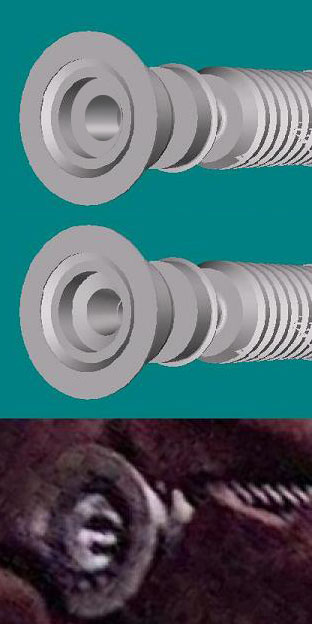

Howard - Can you honestly tell me you can see for certain that the interior piece is angled from just those few fuzzy screencaps?
It seems to me this is an awful lot of detail to assume without reference to back it up.
The size and shape would not function well as a reflector in the real world - not enough surface area and the angle is too shallow. To assume the front angle is one thing, to assume the inside taper as well takes even a greater leap.
To illustrate my point...
Below are two versions of the 3D rendering.
- The top one has a completely flat surface inside no tapers at all.
- The middle is Andres original.
- The bottom is the HD screencap
"However, the pictures we do have show evidence of either solder or glue blobs protruding from the rear of the balance pipe, pointing toward the prop builder’s use of something far more pleasing to the eye and yes, perhaps even exotic. "
For the record I'm not saying they used washers and bolt. I believe it's something like what you have in mind just without the angles (perhaps a machined down turntable weight?).
The solder or glue just indicate it was something that wasn't really meant to fit together. I highly doubt the designer was overly concerned with interior construction when the outside is so shoddy (wire holding the gear on?).
I believe you and Andres on the right track, but assuming too much because of what you want to see. I admire the dedication of both of you to this prop a great deal. I just think you've lost some objectivity. Even in your post above you're projecting yourself into the original prop maker's role. I wish the original builder cared as much as you or I, but I don't think they did from the visual evidence.
The CAD model isn't mirrored so it's hard to fully evaluate how well it's working at some angles, but as you can see in this early test of a very deeply angled reflector the reflection pattern shows promise.
Are these pics even relevant since most of what we see of the "deeply angled reflector" should be the side walls of the balance pipe interior?
The 3D model has a very shallow bevel to the front face of the piece.

3D comparisons:
These are about as 'kinda sorta' as my last ones, but the right hand comparison is growing on me--absent the grey 'blob' right under the hole (which doesn't integrate with anything else to date either), it looks pretty good.
Ultimately it's the geometry in the 'cloak' shot which trumps everything else for me. The enigmatic aspects of the screen caps just above 'feel' like angled surfaces, but I suppose they must be the result of other sorts of lighting or texture effects.
