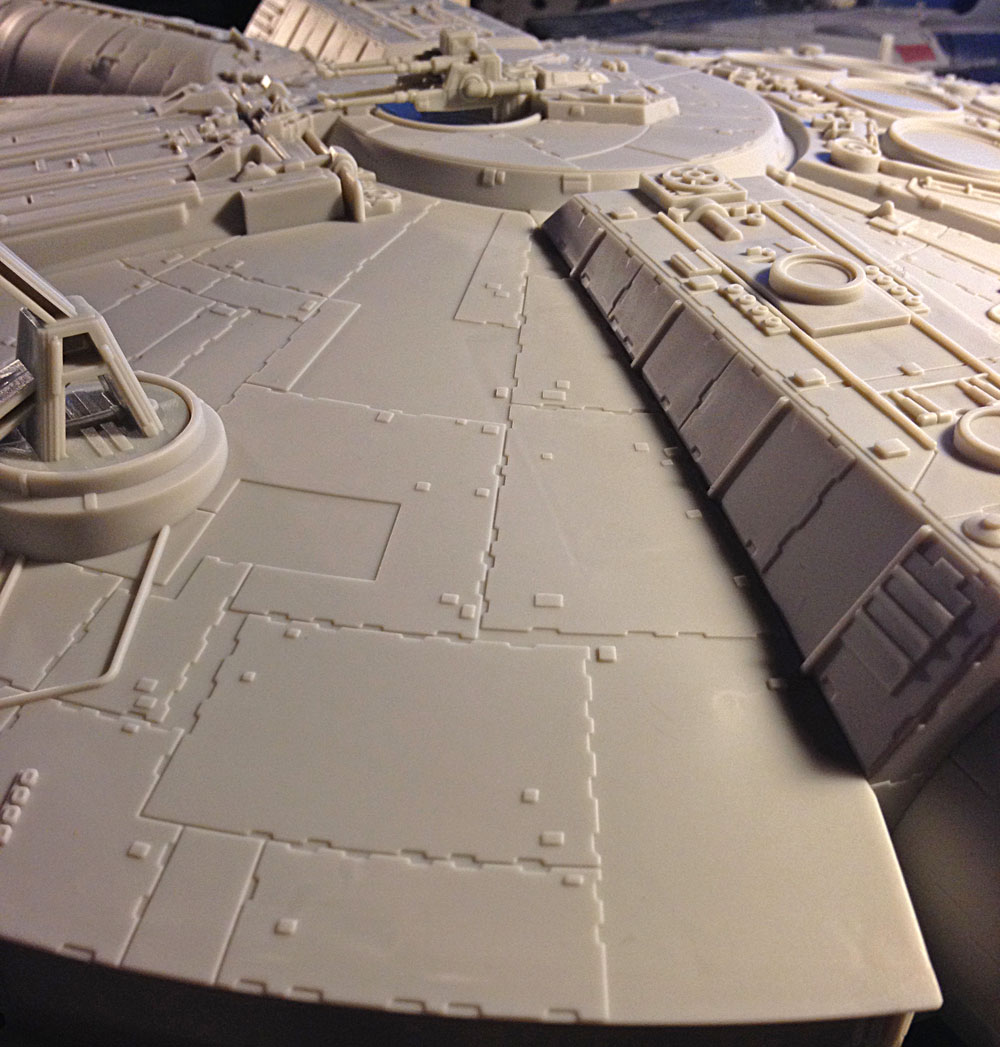

Has anyone else noticed that there is a missing piece of hull plating where EVERY sticker goes? Looks like I need to buy some really thin styrene to replace these panels and some nibblers to notch them. Also, look at all the notches along the edge of this beast that need to be carved out! Fun times ahead!

Definately noticed the missing panels. I was planning on doing the same thing with thin styrene.

Can someone post some pics of the missing (sticker) panels?
With Stickers
Missing Panels without the stickers:
J
I was going to cut down the radar dish to a more reasonable size,
I was thinking 62-63 mm, does that sound about right
Also here are some of the missing panels :)
Keep in mind that on the 32-inch Studio model Falcon there actually are some missing armor panels on the cockpit and cockpit tube. They are represented on this Falcon.

Kokkari, although there missing panels on some areas of the filming miniature, There aren't near as many as appear on this toy. They definitely left some panels off for sticker placement. I still think it's awesome, though:)
Robert
Oh no doubt bro! As I said in my post I think the only ones I can think that are missing on the 32" Studio Model are on the tube area leading to the cockpit and on the lower side/bottom of the cockpit itself.
