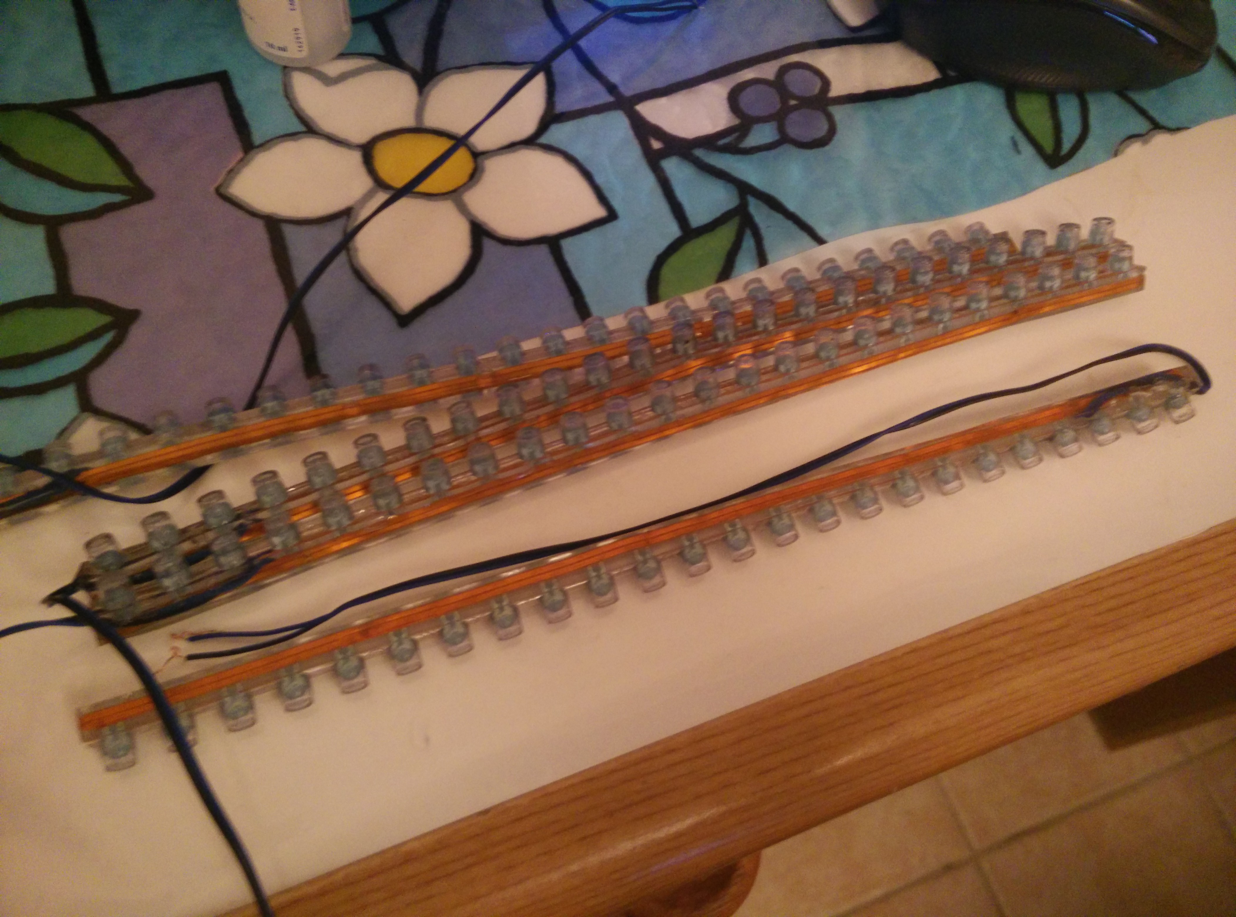

Hi Guys,

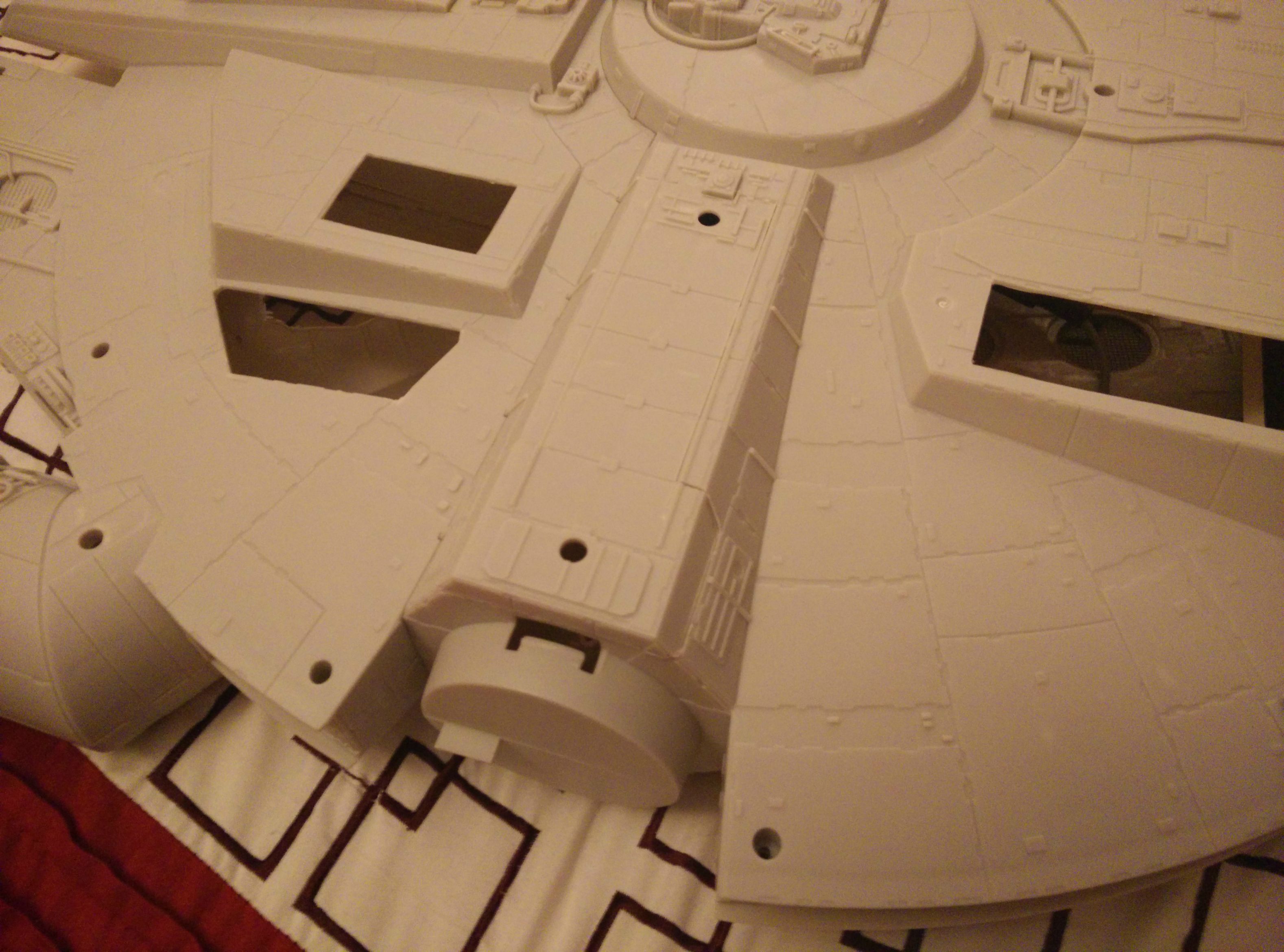

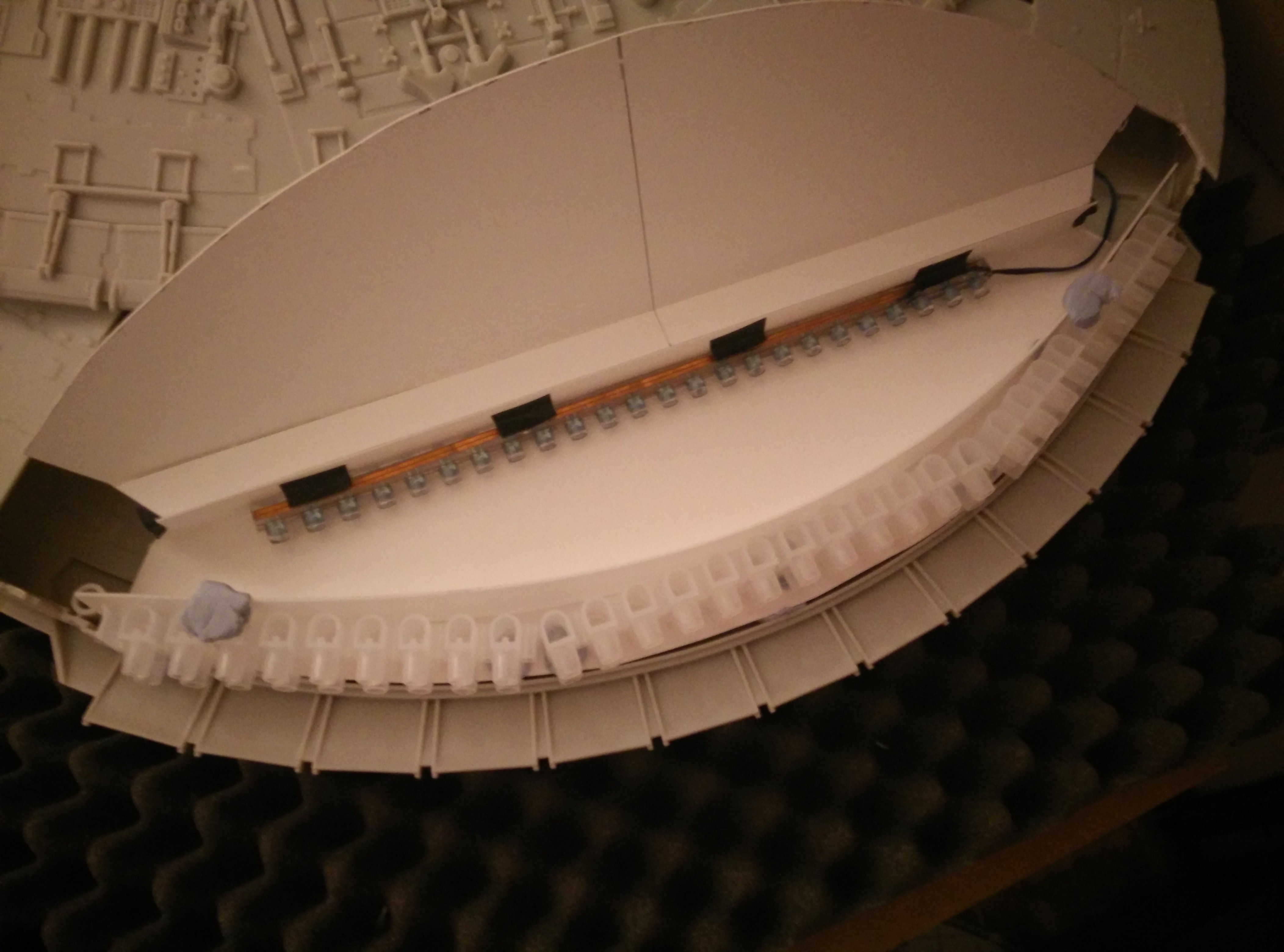

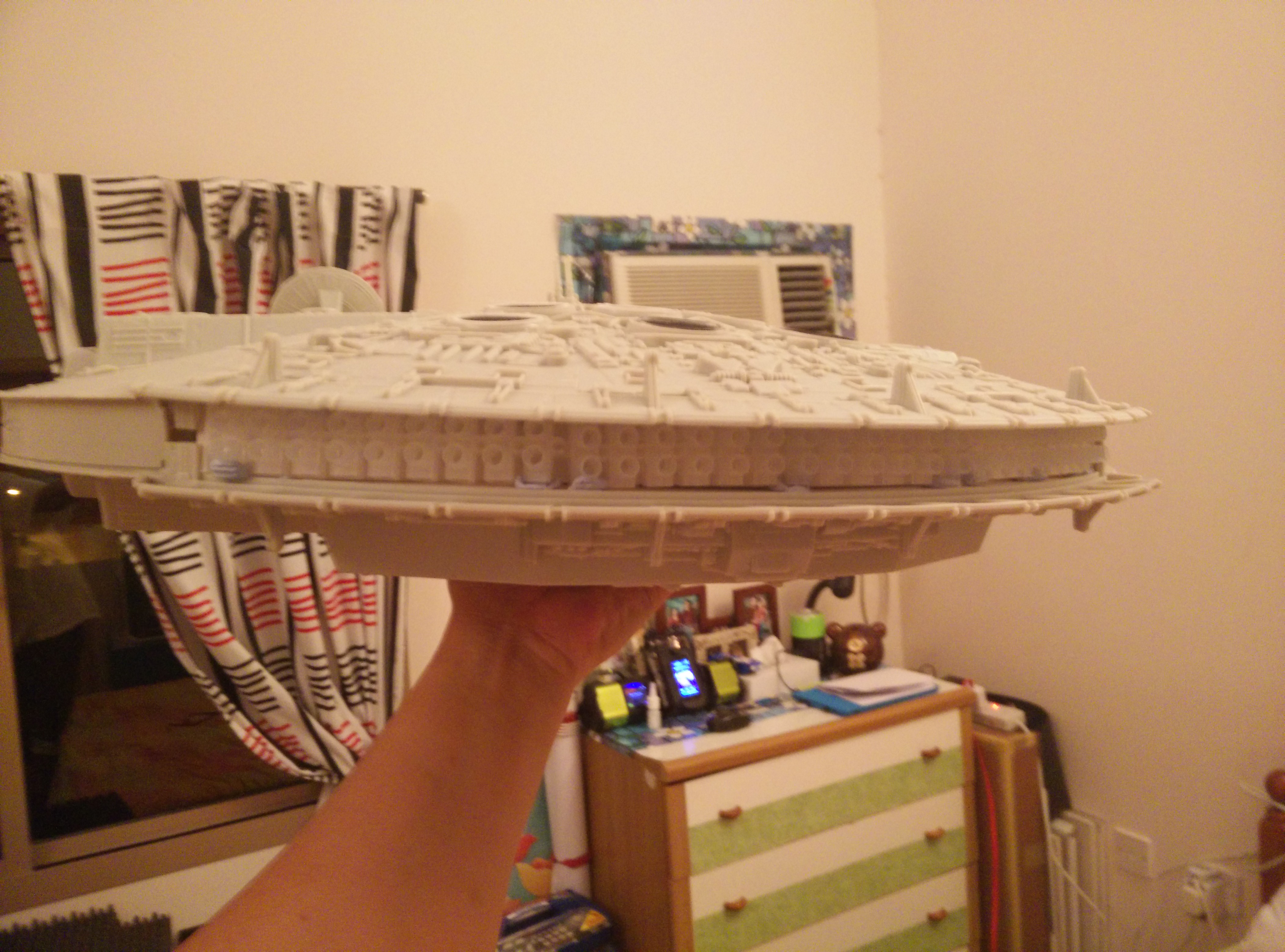

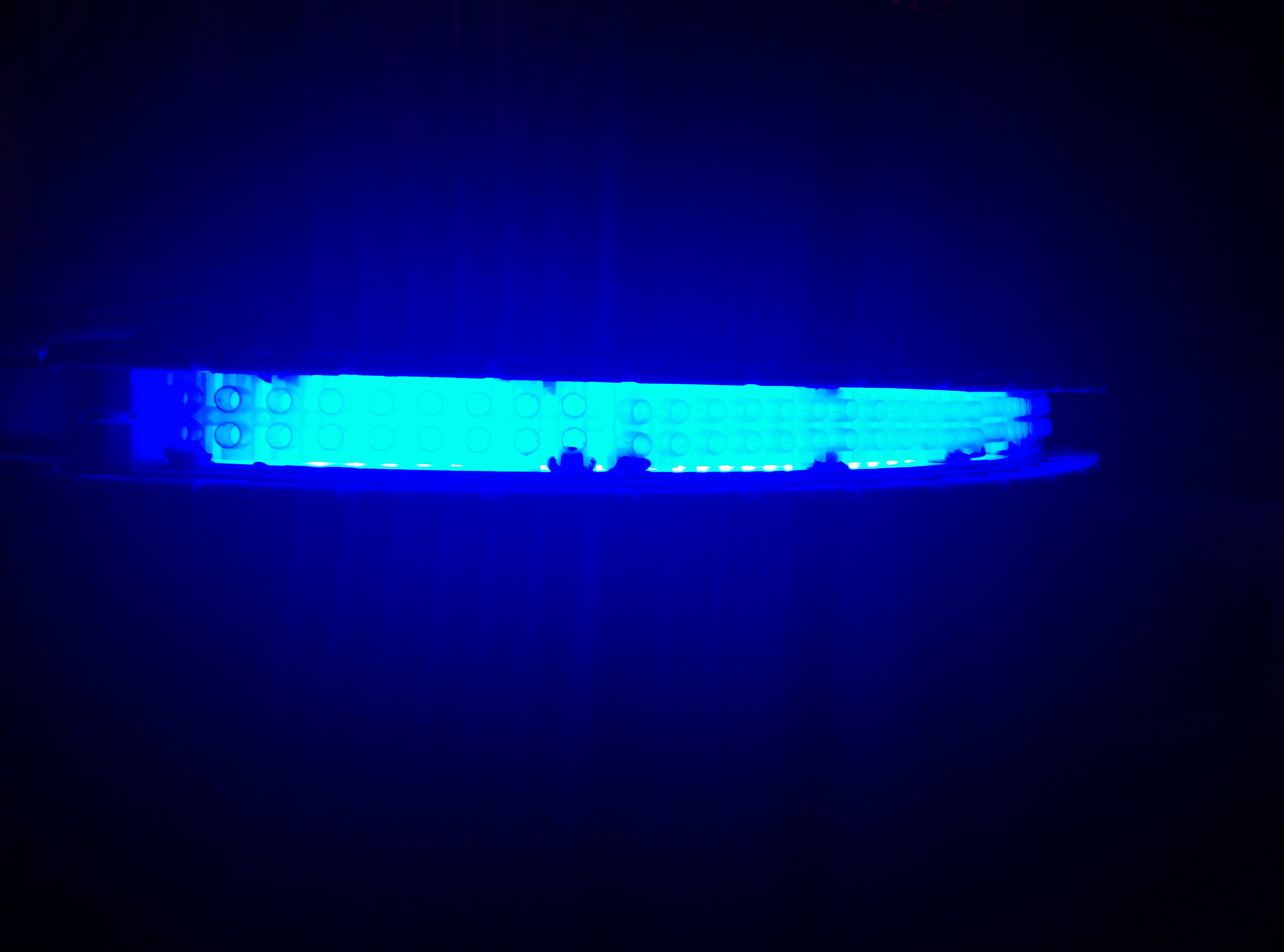

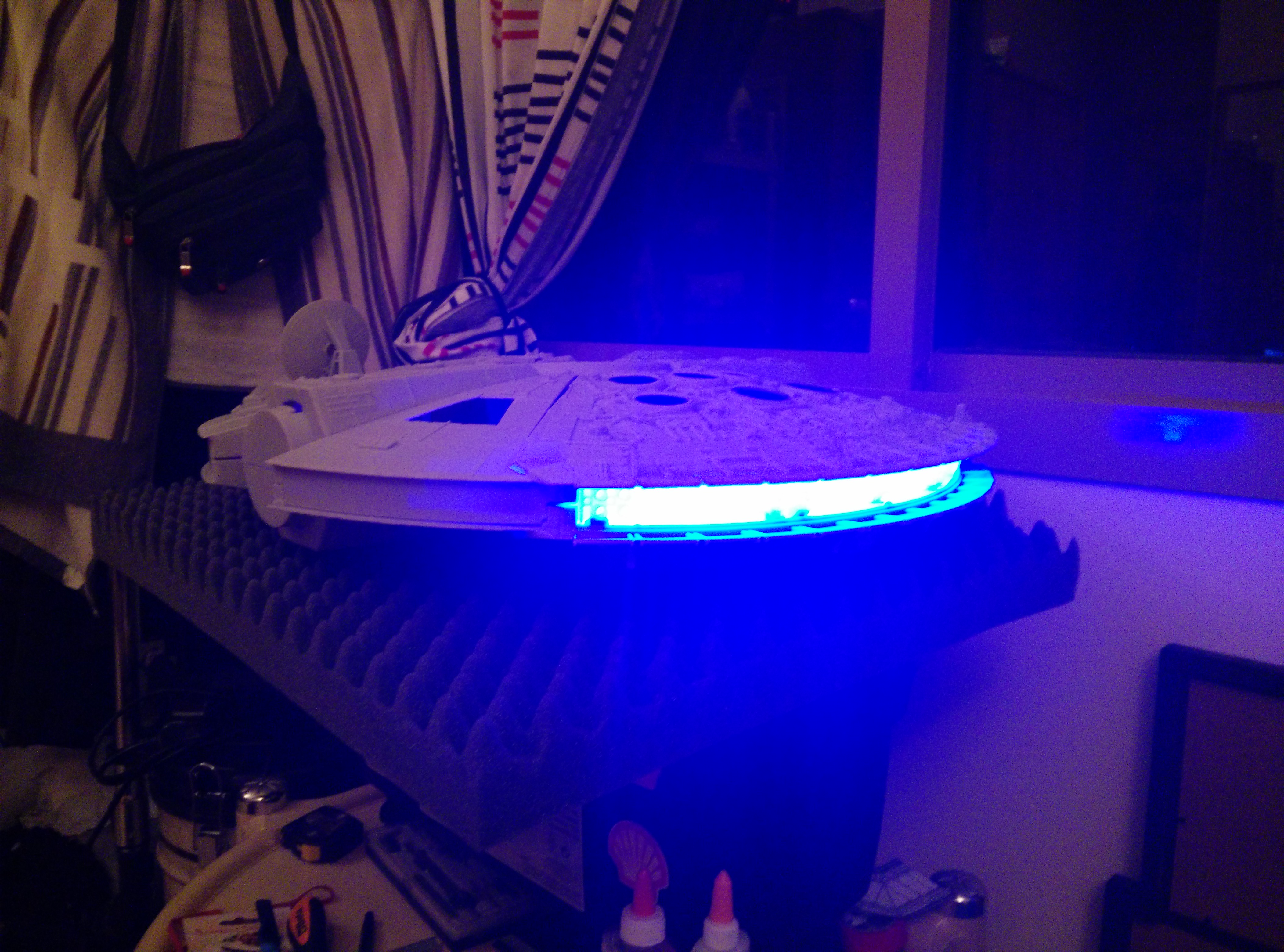

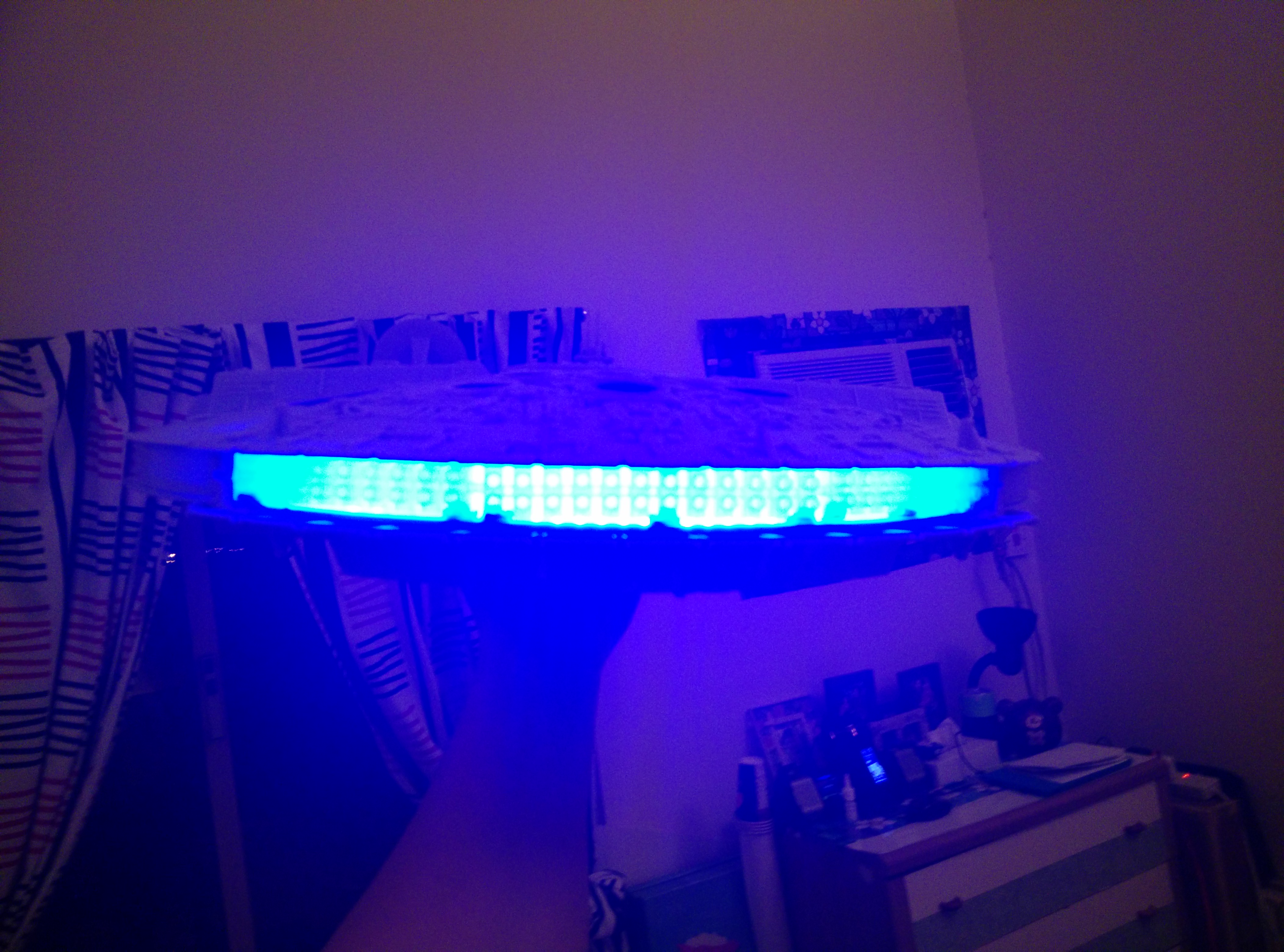

I tried the LED strips with the wire connectors in a mock-up fitting to see how it is.. Looks promising....
I got these 12V Blue LEDs from Ebay and I only use one strip. I also use a white diffuser strip between the LEDs and the Connectors to bend the lights and avoid hotspots. These are held temporarily by blue tack.
I can say the mock up trials is a success and I can proceed with the final version using styrene sheets.
The outer part is still not final as there will be the engine grilles that will cover those connectors.

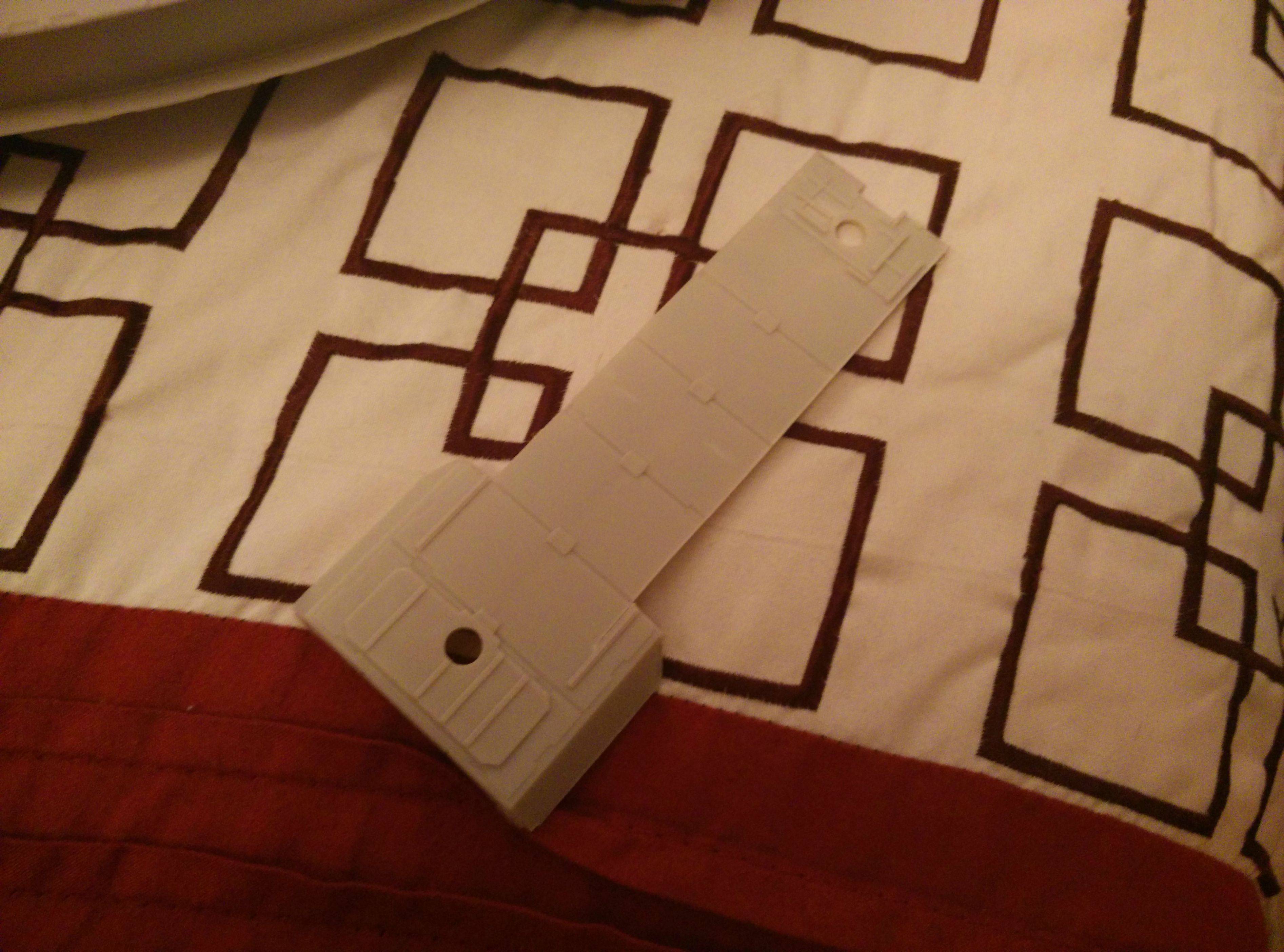

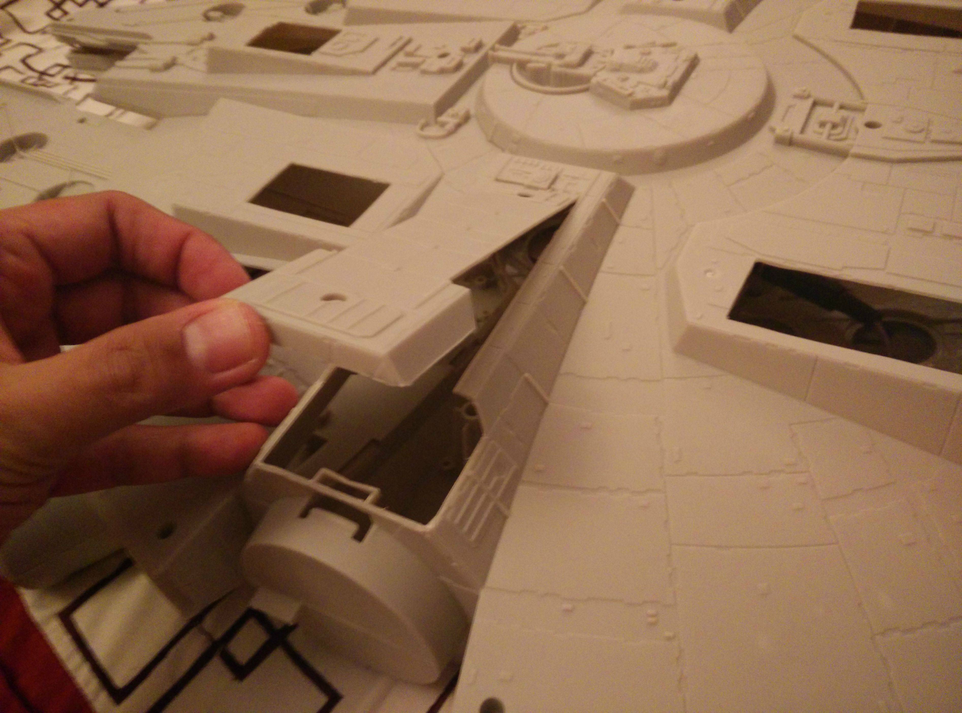

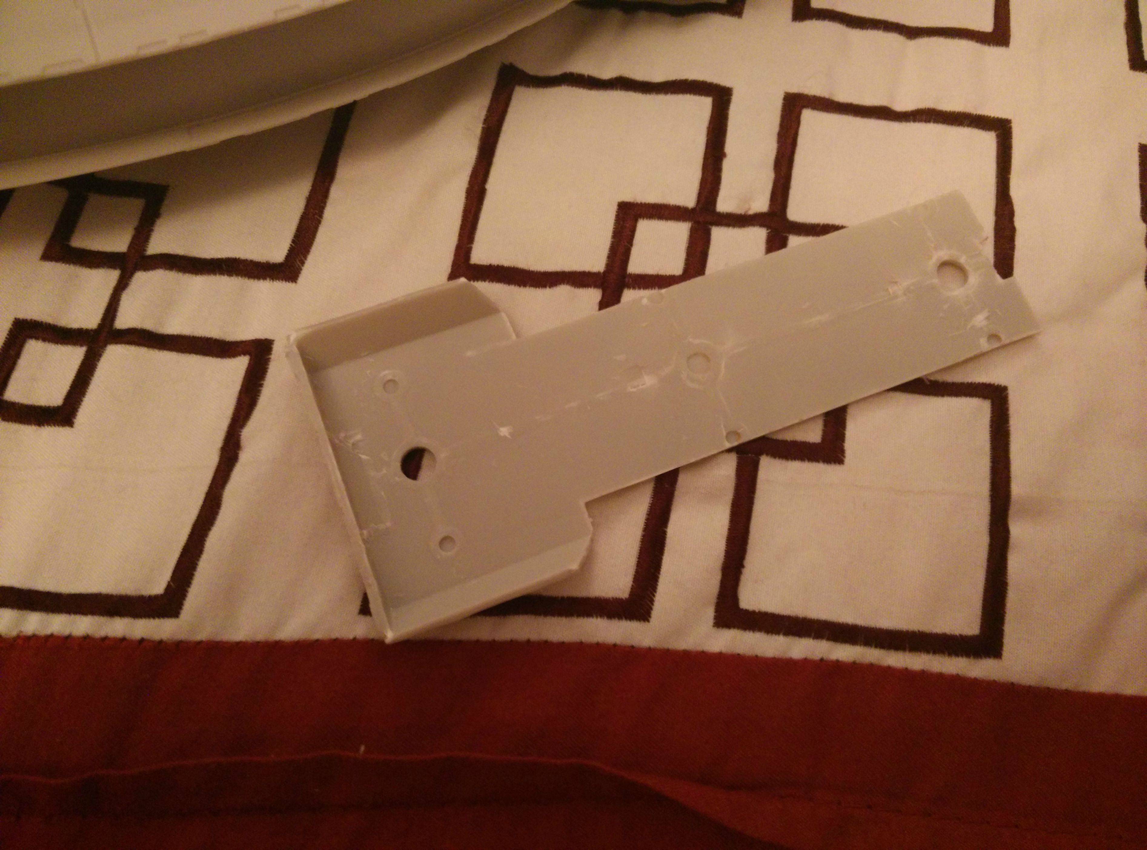

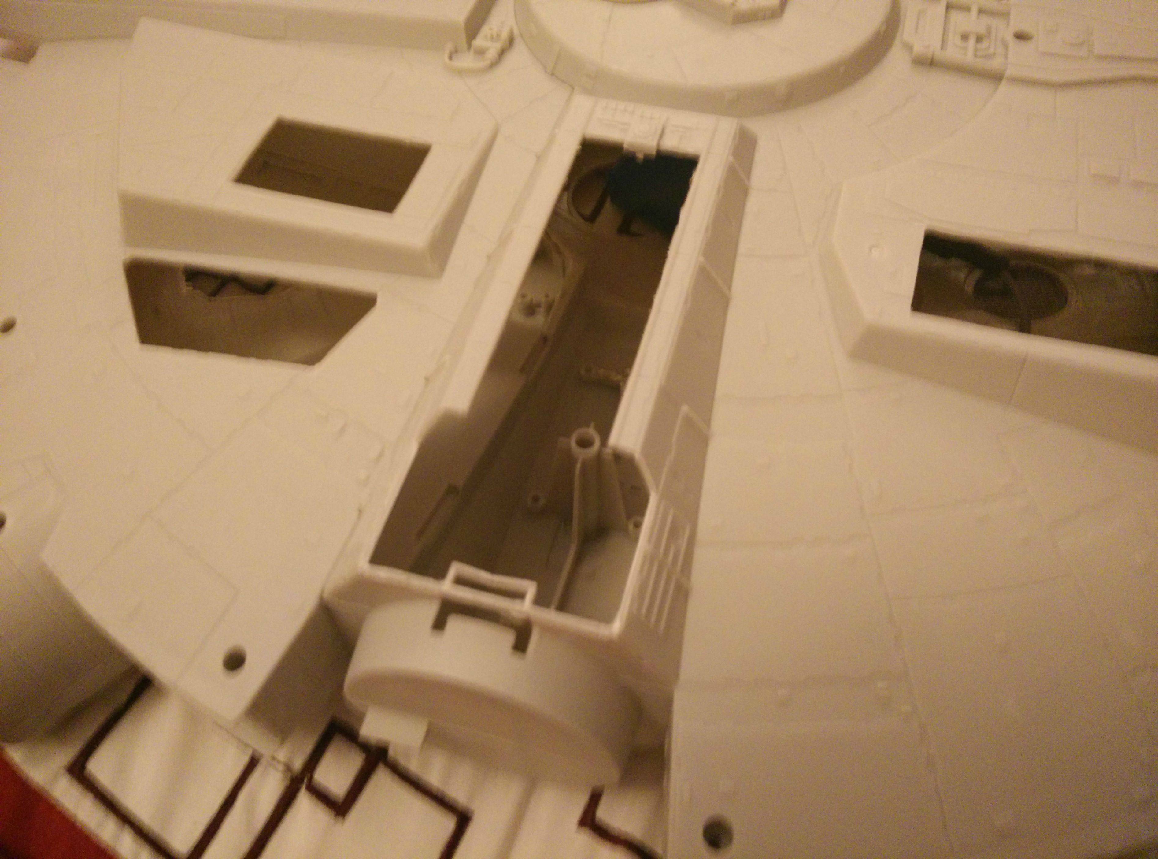

I've looked through all 84 pages of this thread and I haven't seen anyone tackle or support any ideas on the landing ramp yet. To be honest the ramp is scarring me to death. I know I can get the inner parts from Shapeways, but how to cut the ramp out nice and strait is something I don't know how to tackle. The dremel is out of the question because it takes out material and leaves a gap. The only thing I can think of is an exacto, but how to make this strait I don't know. I guess I can use a metal ruler as my guide, starting by scoring it first. Any ideas? Anyone tried this yet?
Hi kokari,
I tried that already and so far it good and straight. I outline it first with pencil then I use an normal cutter slowly scoring it. Repeating it several times.

Hi kokari,

I've designed the complete ramp. Now I've to resize it for the Hasbro.
Your approach is excellent. No fitting problems! I will do the same to get the exact measurements.

I found these really small brass hinges that I am going to use. I used them for the landing flaps on a Y-Wing I did and they worked really well. I found them in the doll house section at my local craft store. HaHa

Yes, this system is OK but the problem is the rotation of the ramp. There must be a gap between the end of the ramp and the hull. I've used a system on my MPC ramp that works, but is too big and it's impossible to hide.
Kokkari's small hinges can do the trick then, just need to carve small recesses on the ramp and ship to fit those hinges...

Hi Guys,

Hi Vac!
Yeah, I removed those metal connectors and just used the plastic shell. You still need to put a diffuser strip in between so the LED hotspots wont show.
I will still put the rectangular engine grilles on the outside as it is suppose to be... lets see...
