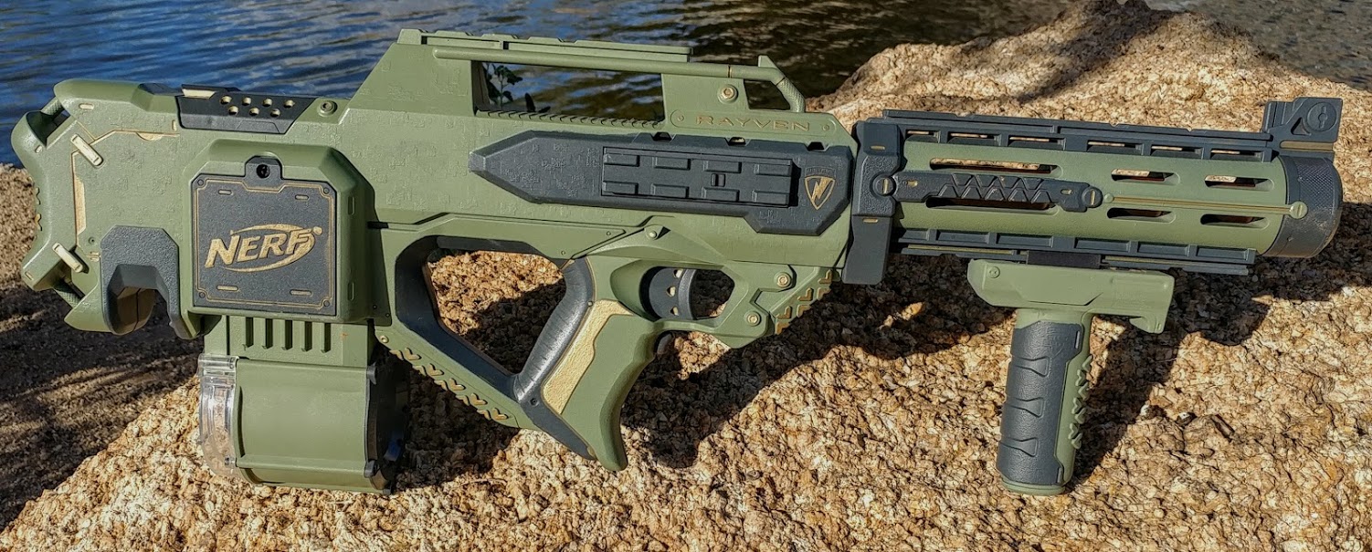

Day 4 of Risingsunn’s blasters shows off one of my favorite creations.

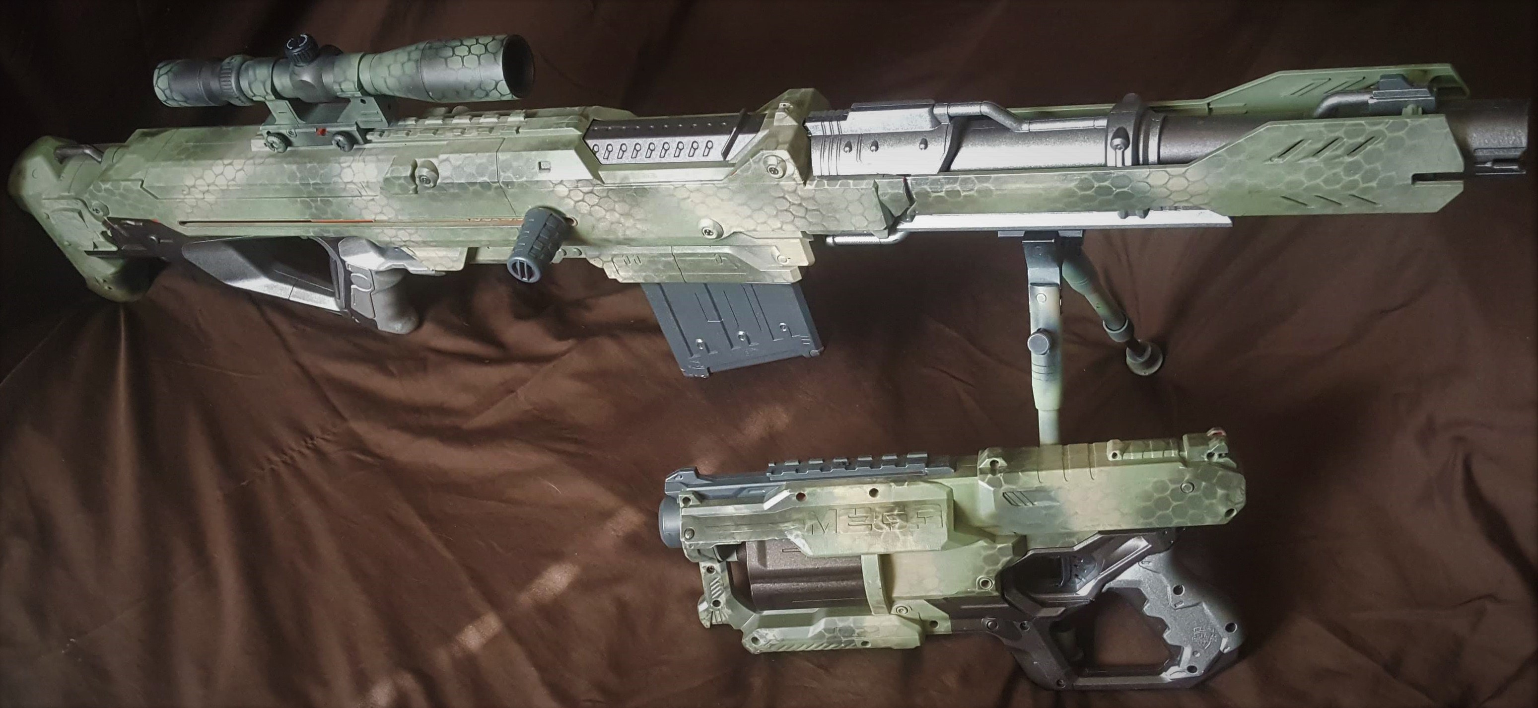

Nerf Product: Centurion rifle/ Cyclone Shock pistol
Accessories: Generic ebay Nerf Scope ($10)
Generic ebay metal bipod ($14)
Color pallet: Flat black vinyl dye rattlecan
Deep forest green camo rattlecan
Army green camo rattlecan
Khaki camo rattlecan
Satin Nickle rattlecan
Inspired by: NA/Original concept (or at least didn't see it anywhere else)
The Centurion rifle is an AWESOME looking sniper rifle that really needs nothing added to it besides a better paint job and a couple of more realistic accessories.
Rust-oleum offers a nice set of camouflage colors and I was very interested in trying them out. I decided to try a variation on of the scale paint job I did on the Demolisher. Turns out, it makes a great camo pattern.
The Nerf logo has been removed completely on both but the Centurion logo is there, just very well camouflaged. :p The MEGA logo on the pistol though was larger than most Nerf logos and I did not want to risk putting a hole in the side to remove it.
Hope you enjoy and have a good day!

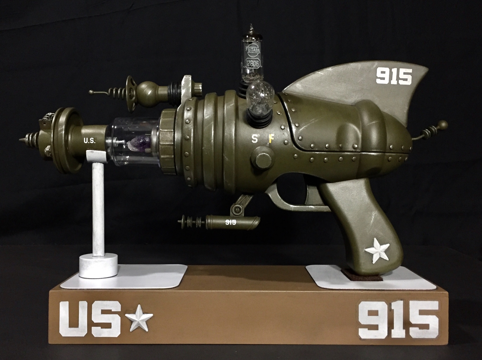

This is incredible! I absolutely love ray guns and you really pulled this one off well. Interesting to see it in military colors... and those lights really bring the whole thing together. Well done.

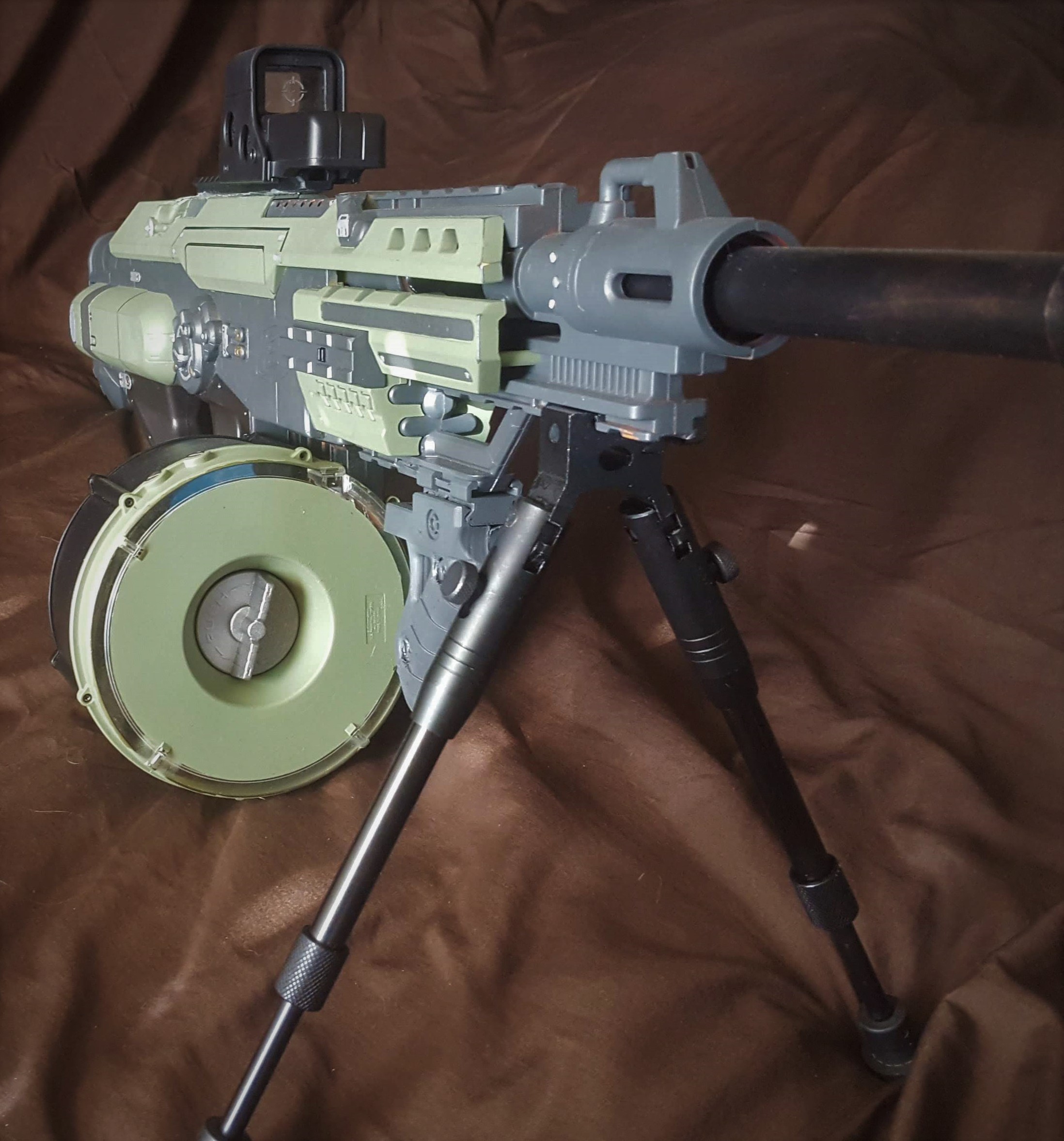

Happy Labor Day all!

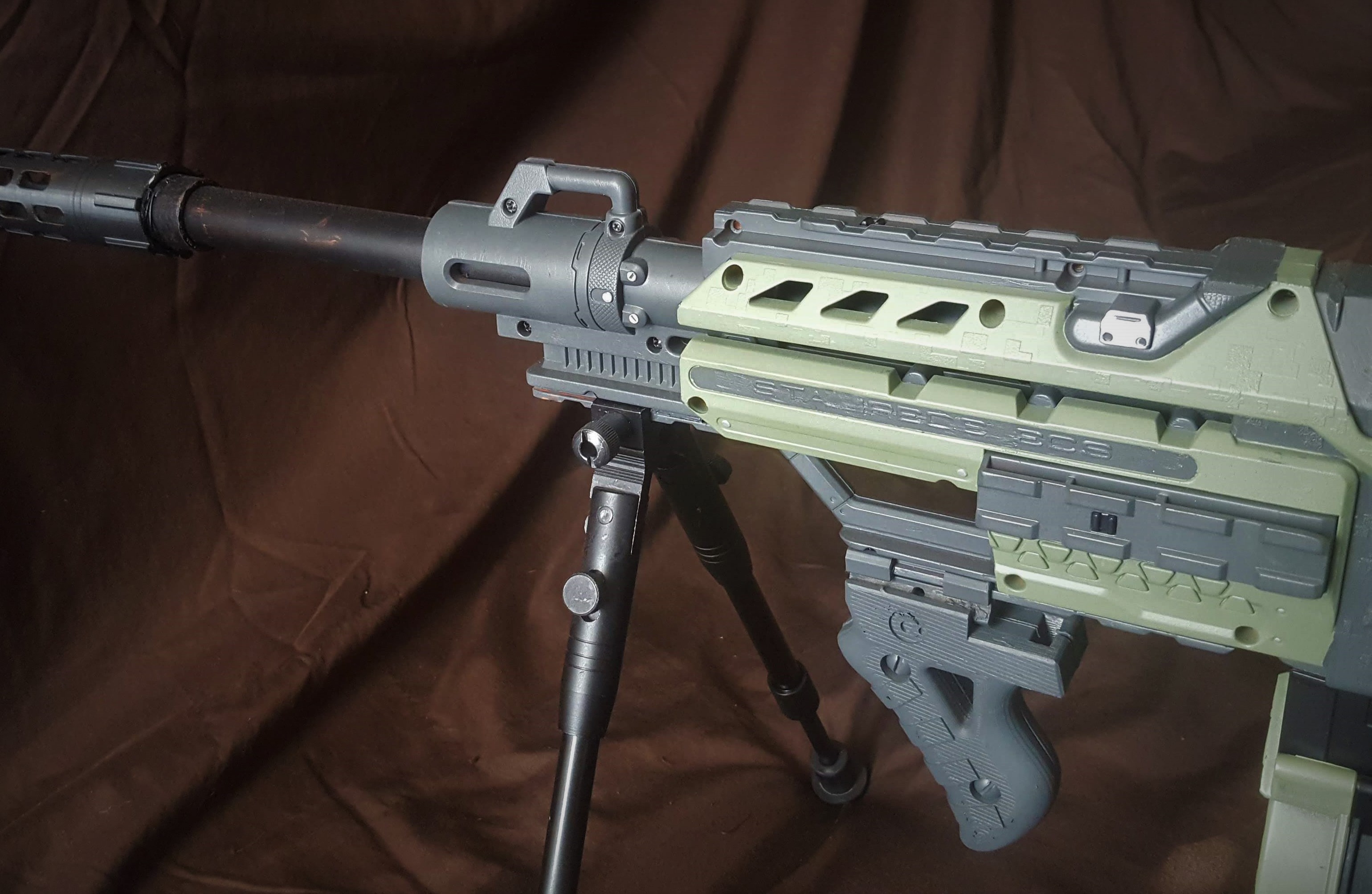

Nerf Product: Rapidfire
Accessories: Generic ebay red dot scope ($10)
¾ PVC
Nerf Dracogen Flash-Hider by Z0r4n Nerf Dracogen Flash-Hider by Z0r4n
Fore Grip by keizi666 Fore Grip and Stock Adapter for USP(electric) Tokyo MARUI by keizi666
G36 Picatinny Rail by Stinjin G36 Picatinny Rail (3screws) by Stinjin
Color pallet:
Flat black rattlecan
Satin Nickel rattlecan
Gold paint pen
Silver paint Sharpy
Black Sharpy
Inspired by: Unknown author (link found on google images but cannot find original designer)
This design was meant to be a Nerf version of a military light machine gun, Since I now had my Creality Ender 3 3D printer I wanted to start using some of the designs I found on Thingiverse.
Since I intended this to be a functional Nerf blater, I left a clear circle on the outside of the drum mag so that I could still see how many darts were still inside. Its a minor compromise between form and function.
I also removed the top handle/rail/sight with a grinder in favor of a smaller profile picatinny rail.
Now that I am looking more at these pictures, I REALLY should have gotten rid of the Nerf logo on this one, perhaps I will one of these days.
Enjoy!

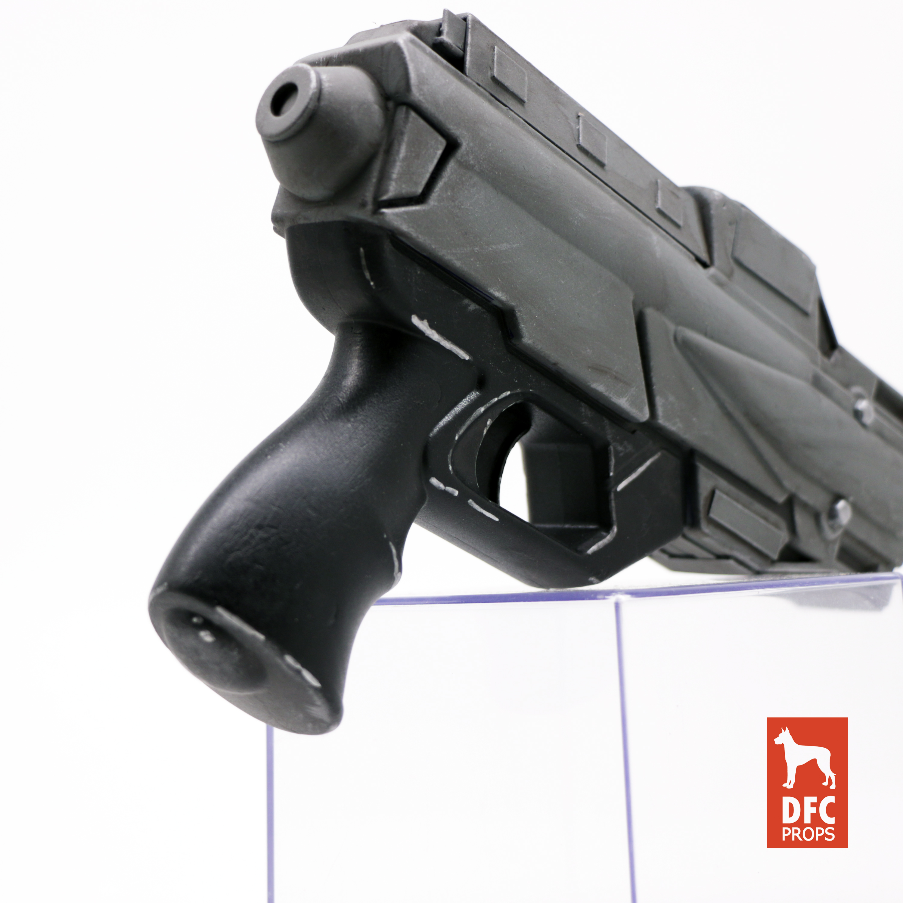

DFC Props

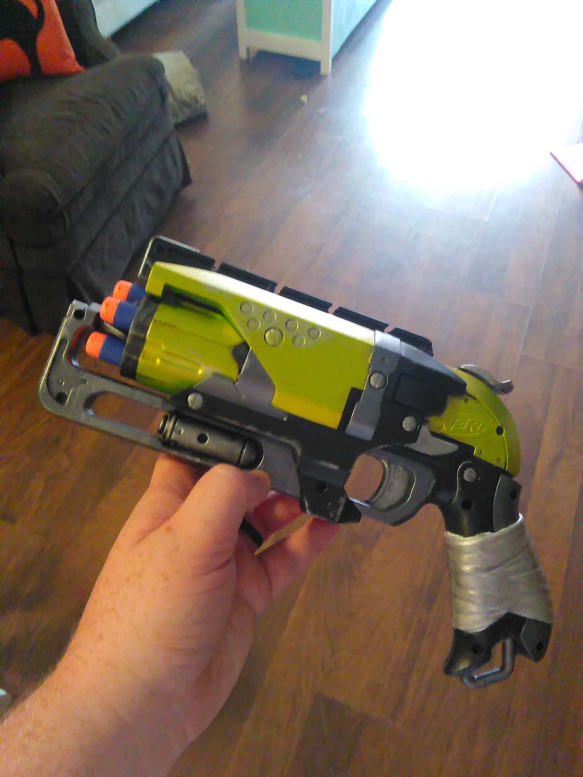

I've discovered that thrift stores are the best place to scour for Nerf guns. I got this Zombie Strike Hammershot for two bucks; I've collected an entire Nerf arsenal for less than fifty bucks total! I decided to finally customize one of these. Here's the before: View attachment 1058251
And here's the after:
Hmm... I'm slightly jealous. I rarely find Nerf guns at thrift stores near me. And if I do, they're really expensive (I mean they're priced higher than they should be... not as expensive as buying brand new). I have yet to find a place where they sell things really cheap. But that's great that you got all those Nerf guns! Nice job on the Hammershot. Love the color theme...
GhostWithThMost
Thanks! I don't know what the deal is, but every weekend I hit the thrift stores for prop stuff, and I usually find one new model every time. Mostly at a place called America's Thrift Store (I think they're a chain).

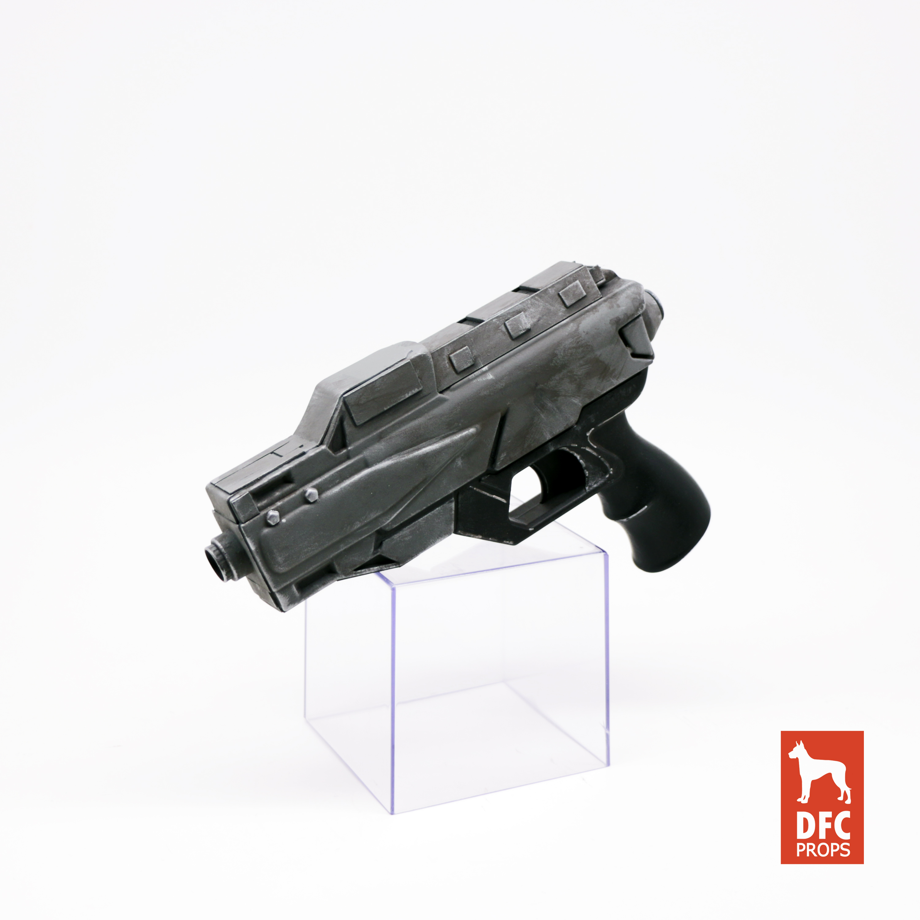

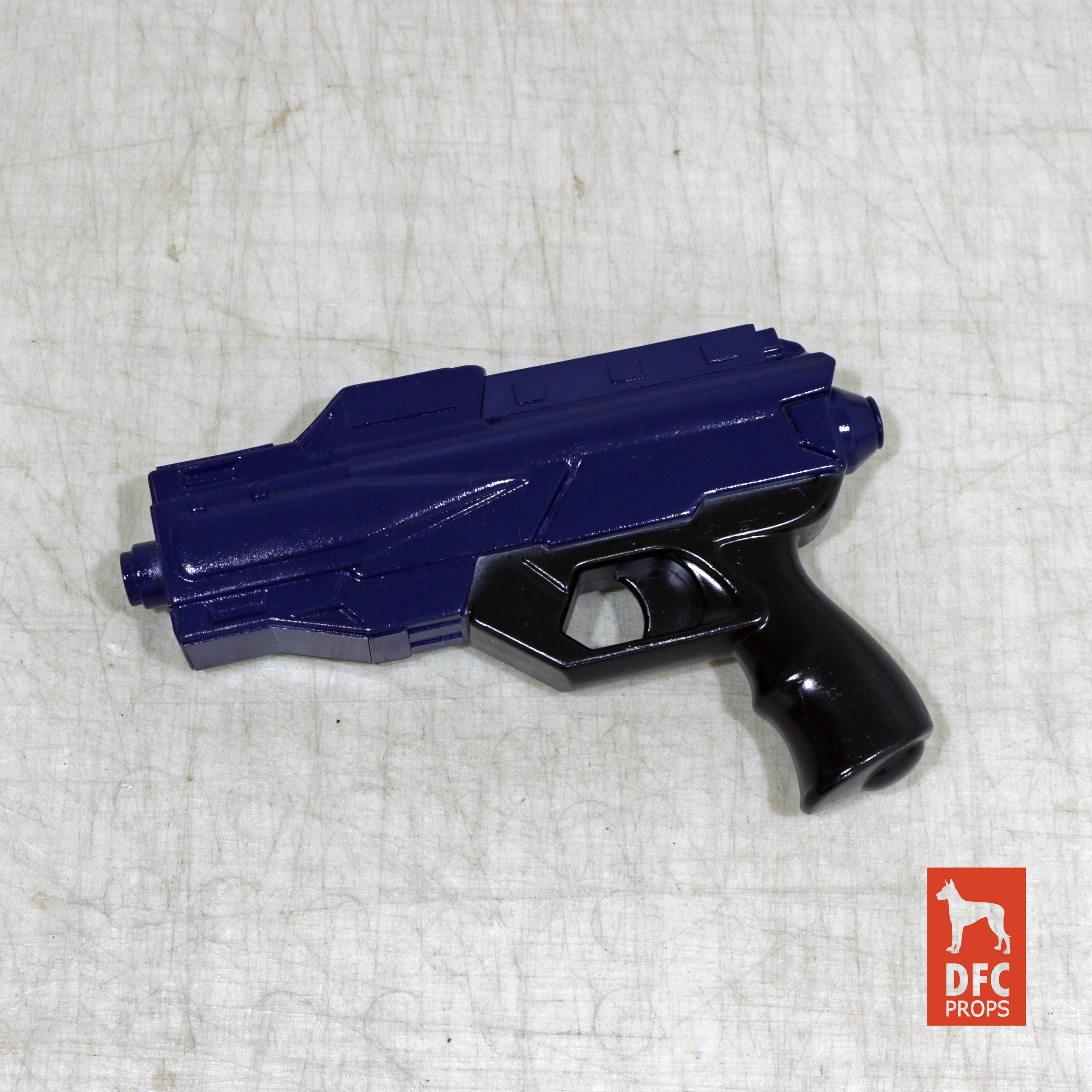

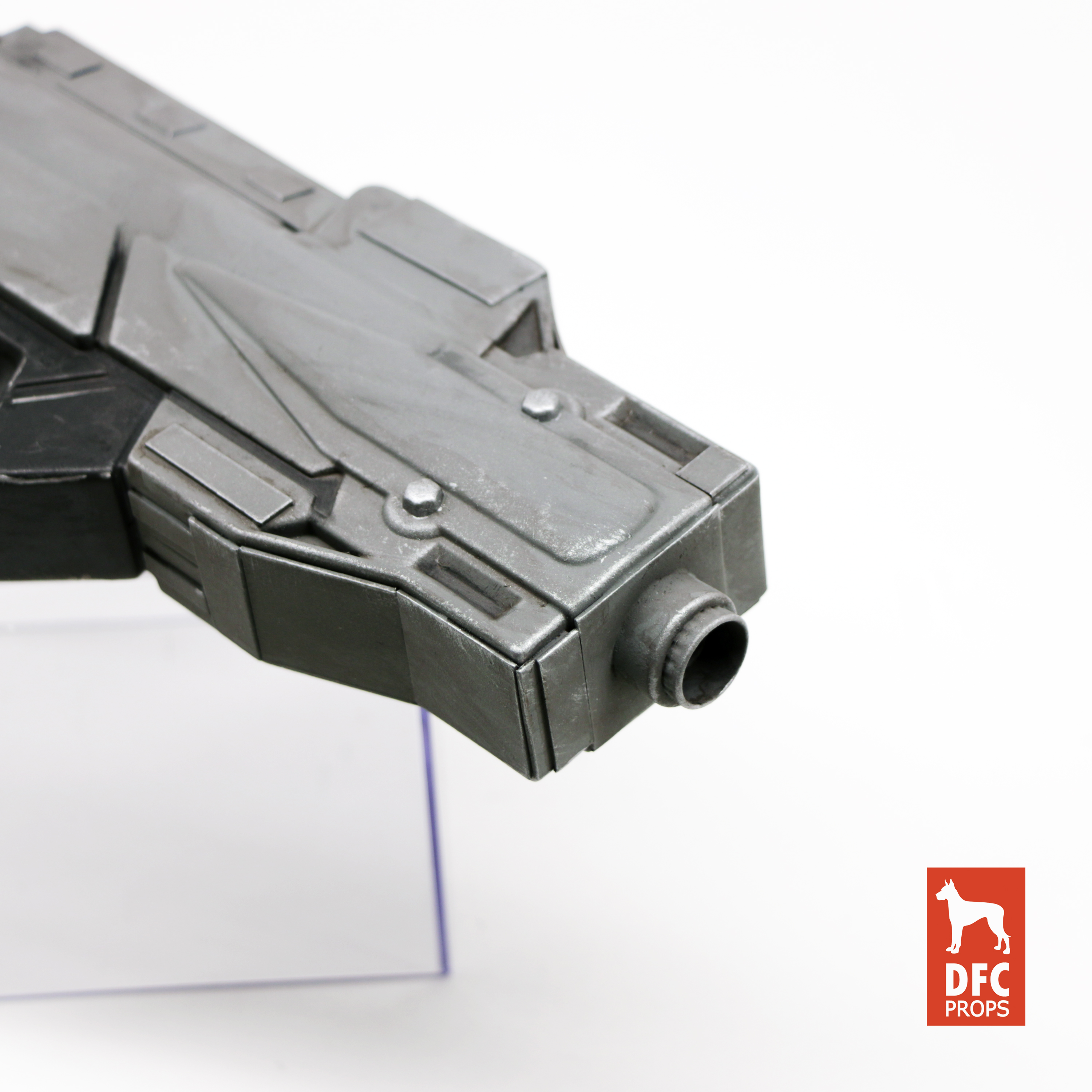

Does this count? It's not quite a "Nerf" gun, but it was a toy dart blaster. This was meant to be a relatively quick project, but due to some mess ups and not being happy with the finish, I shelved it for a while. It started from orange, then to navy blue, and finally to grey. Not the most beautiful paint job to date, but I'm pleased with the result.
CB2001

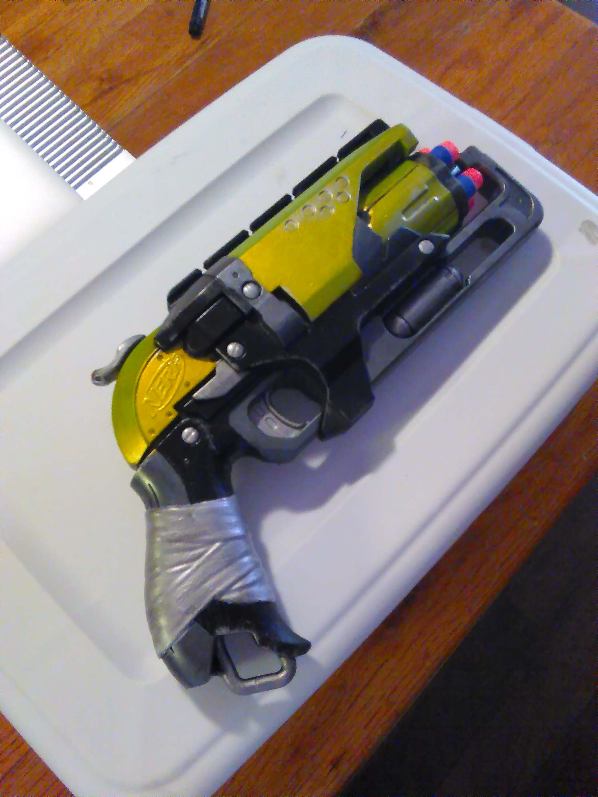

Just for fun, a Nerf maverick ,printed scope and muzzle brake along with some add on logo plates and 3D printed dials. Drilled out the magazine as well and truck bed liner for the grip. Dieselpunk style for a change. View attachment 1088294
Nice Maverick. I especially like the barrel holes and small piping. Good job!
