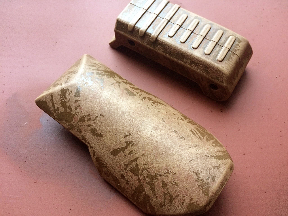

I think I've finally nailed the antiqued leather effect:
Four shades of brown, dry-brushed dark to light to get a suede-like effect, followed by a liquid latex mask around the edges and roughly following the lightest of the 'scratch marks' in the suede, and then a coat of gloss chocolate brown. Last step is to remove the masking film.
I thought the hardest part would be removing the masking film, but I discovered a new way of doing it that speeds up the process tenfold. Wiping the entire surface with a bit of blue painters tape picks up the latex really easily without marking the rest of the paintwork, unlike my previous latex removal process which was scratching it away with various tools. Time-consuming and very messy...

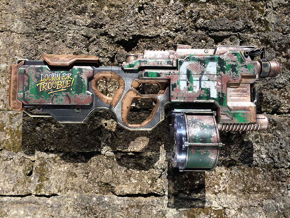

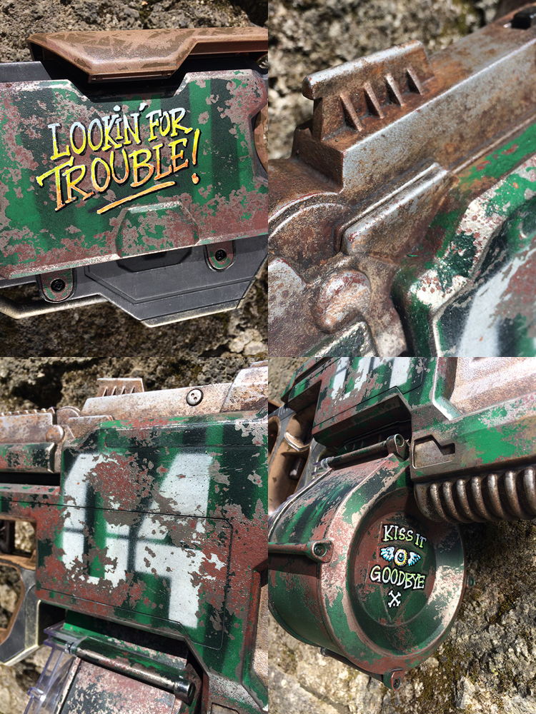

May I introduce my latest relic, a scavenged ex-service blaster I have dubbed "The Rearranginator".
Same ol' rust technique I've done dozens of times but with an extra wash on the bare metal parts just to see what would happen; the new antique leather technique outlined in my post above; and just for fun, some hand-painted graffiti, because when you find a blaster in the post-apoc wasteland, the first thing you do is personalize it ;)

That is excellent Vim! I love that paintjob. Any intention to slightly weather in the "graffiti"? Love the rust and the uber-distressed leather.
Out of interest, what you you use for priming? I know some folks use Krylon Fusion, but I'd like to find something I can airbrush on.
Thanks! I'm considering running a bit of fine sandpaper over it to give it a slightly more used feel, but I'm not sure what that will do to it... I'll just have to suck it and see :D
I use Rustoleum primers mostly, especially the rust red, and a White Knight Rust Guard SLS Etch Primer every now and then when I'm patching and filling prior to painting. I also use the Rustoleum 2X flat white as a base when I want a brighter colour. It goes over the top of anything with reliable opacity - even black primer. The 2X range isn't bad as a primer in itself, but even the flat colours can get a bit satin-ish if you accidentally get a bit heavy.

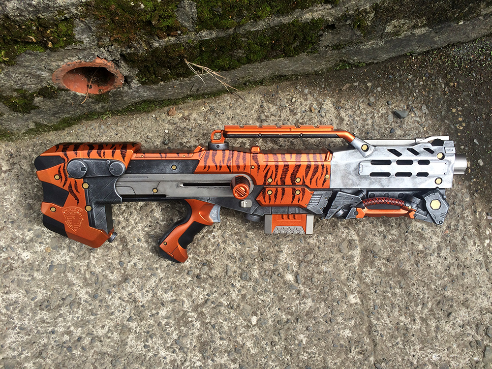

My February project ran a little over thanks to my exhibition taking up a bit of time, but better late than never.

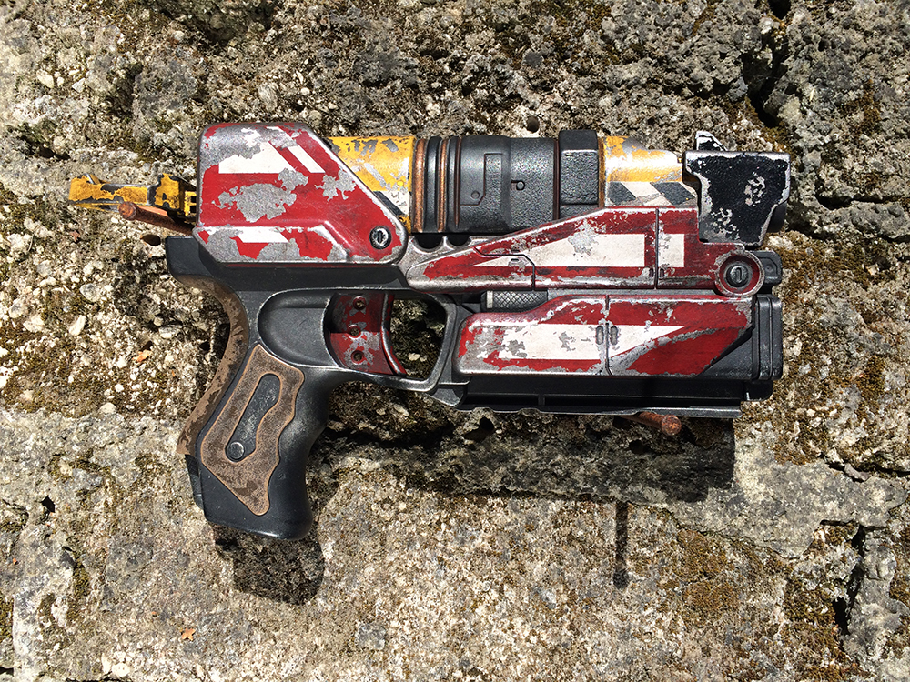

Introducing The Thumper, a custom-painted Nerf Switch Shot EX-3. No internal mods, but its simplicity means that upgrades could easily be implemented at a moment's notice. Or another barrel could be acquired to allow different strength shots dependent on the situation. Several could be modified to fire different darts, multiples, etc. and carried like magazines, but this is another project for another time...

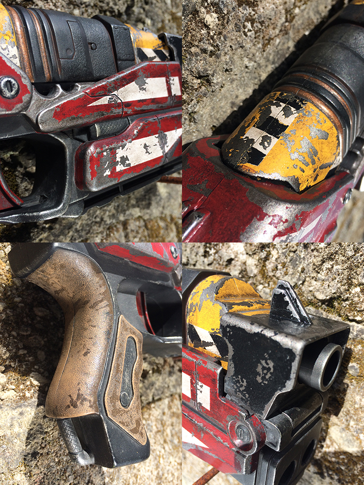

A fun wee blaster to paint, it's barrel-separation mechanism makes it easy to work a multitude of colours into it.
I had a bit of trouble trying to get paint to stick to the priming handle, so there's a spot or two to cover up later. I sanded, washed and primed it, but the primer stripped off entirely, so I went back and started on it again, but then primed it with an etching automotive primer. This seemed to work, so I continued over the top of it. It wasn't until I was removing the liquid mask that a hole began to appear. I pulled the edges away until it stopped peeling, so it seems that it's just the one spot where the etching didn't take. I might just put a wrap of some sort over it to hide it... I've test fired it a number of times, and the priming handle's bar hasn't shown any wear at all so far, which is odd, but hey - way to go etch primer!

Looks great Vim! Love the multiple layers of paint techniques you used. Especially like the suede leather look on the handle... you really captured that look. Did you use a liquid laytex for the chipped paint effect? I tried toothpaste on a recent project, but it left a sticky residue that wouldn't go away even after a wash with water.
Yes, liquid latex is the only way to go if you want to add more paint layers. Soap, toothpaste, mustard and tomato sauce are some of the other organic masks most often used, but they have a tendency to move when you try to put masking tape over them. Liquid latex (or masking fluid as it's sometimes called) has a very low profile, so it's easy to get good, sharp edges when masking up for secondary colours (such as the warning stripes and white panels on the Thumper). Tomato sauce and mustard can also stain the base-layer paint in some cases.
You still have to be careful though, as trying to reposition the tape can result in the latex being pulled up, which can spoil the effect. ie., the scratches won't continue across the different layers of paint. But it's also the best way I've found for removing the latex when the painting is done too. I used to spend hours picking and scratching it away, which also had a tendency to scratch up the paint as well (not a a huge problem when you want a heavily weathered look), but rubbing it down with a few strips of old tape will see it finished in minutes, and will leave the paintwork immaculate.

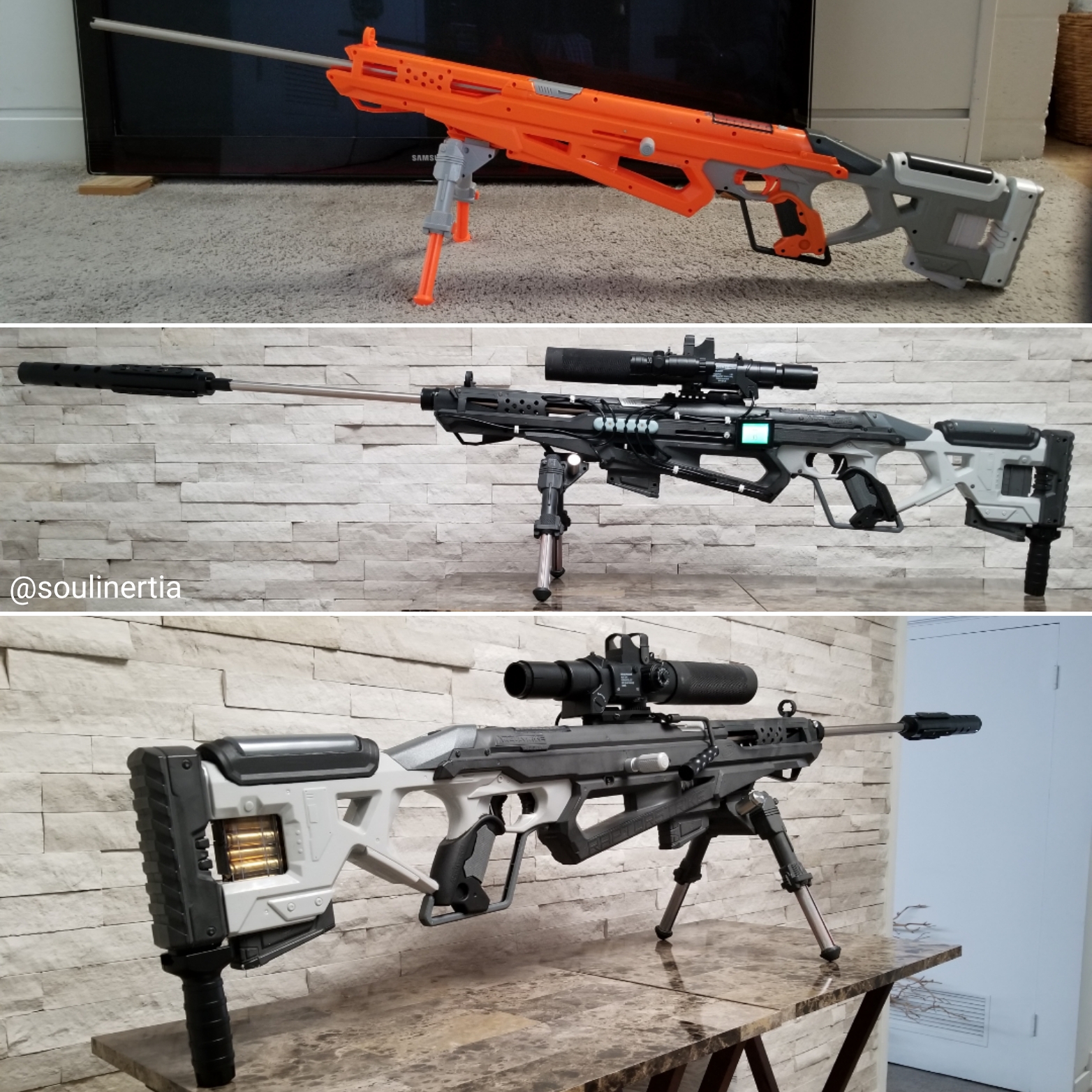

I really like that orange finish... it's got a metallic sheen to it, right?
It's still only about half way done. I'm going to weather the whole thing and cover all the nerf logos.[/QUOTE said:

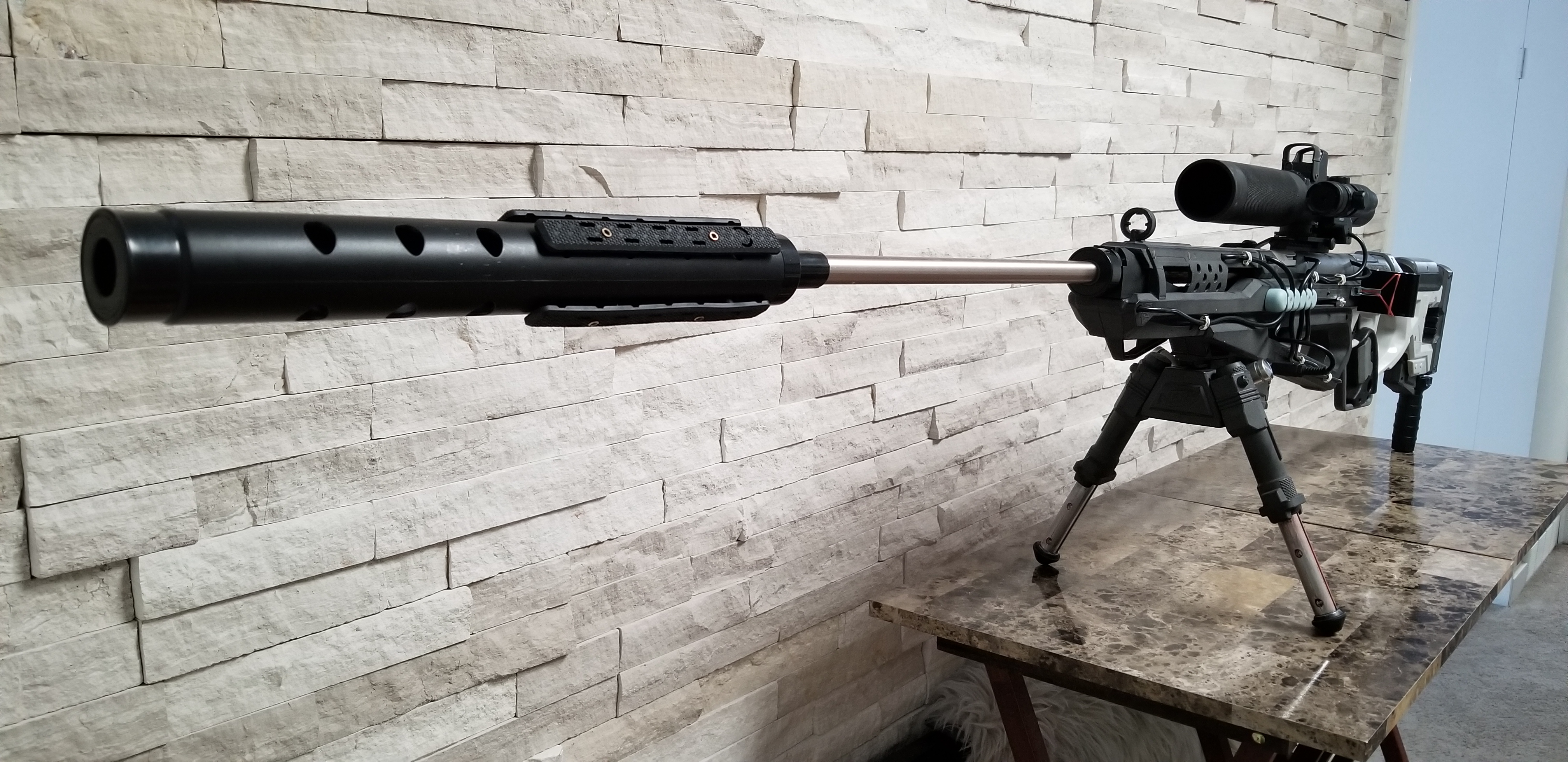

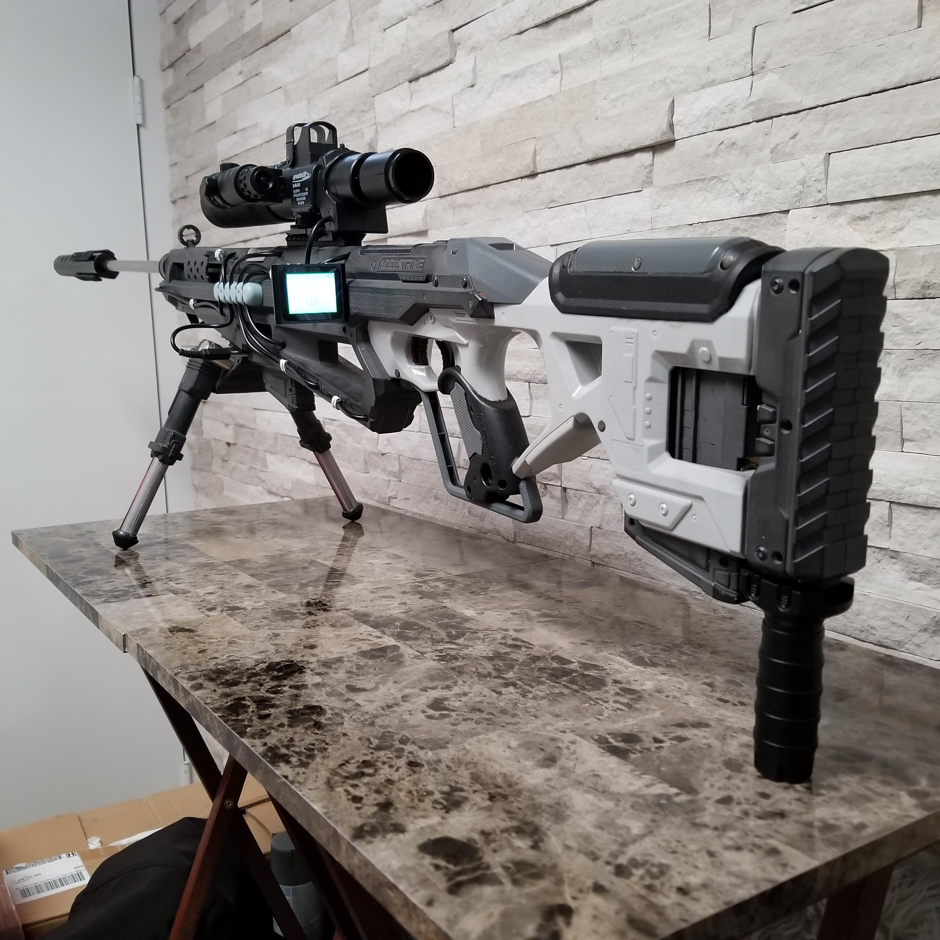

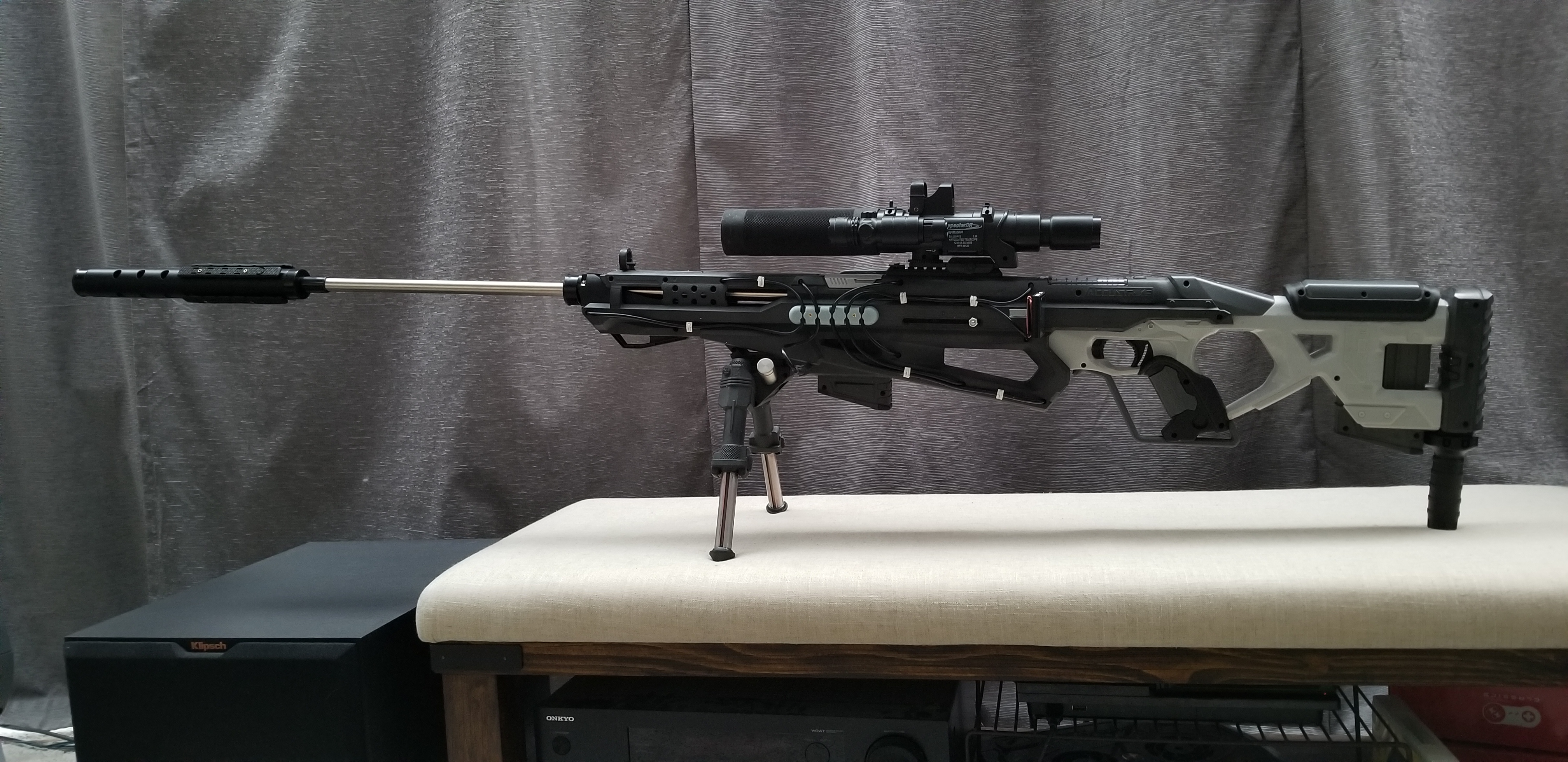

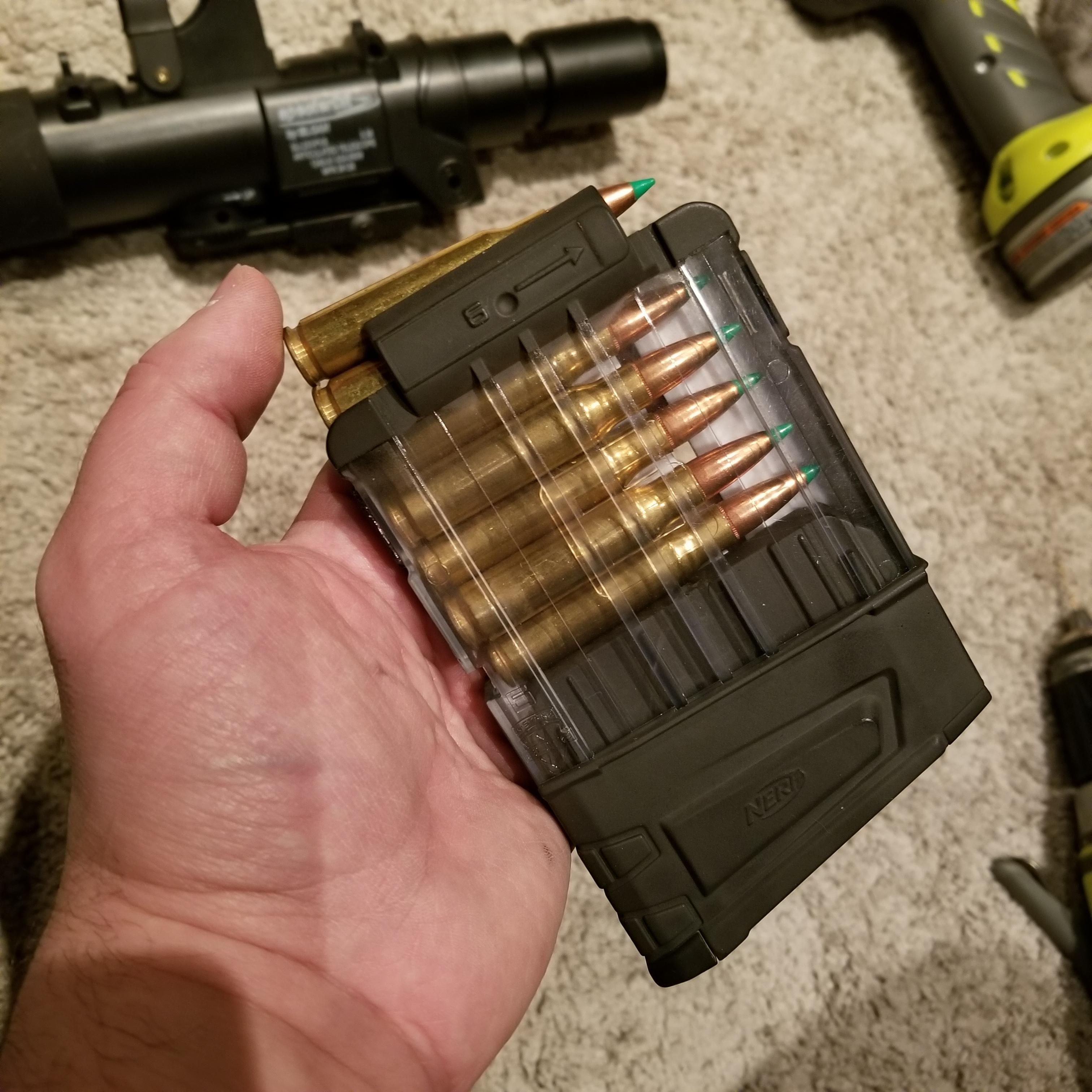

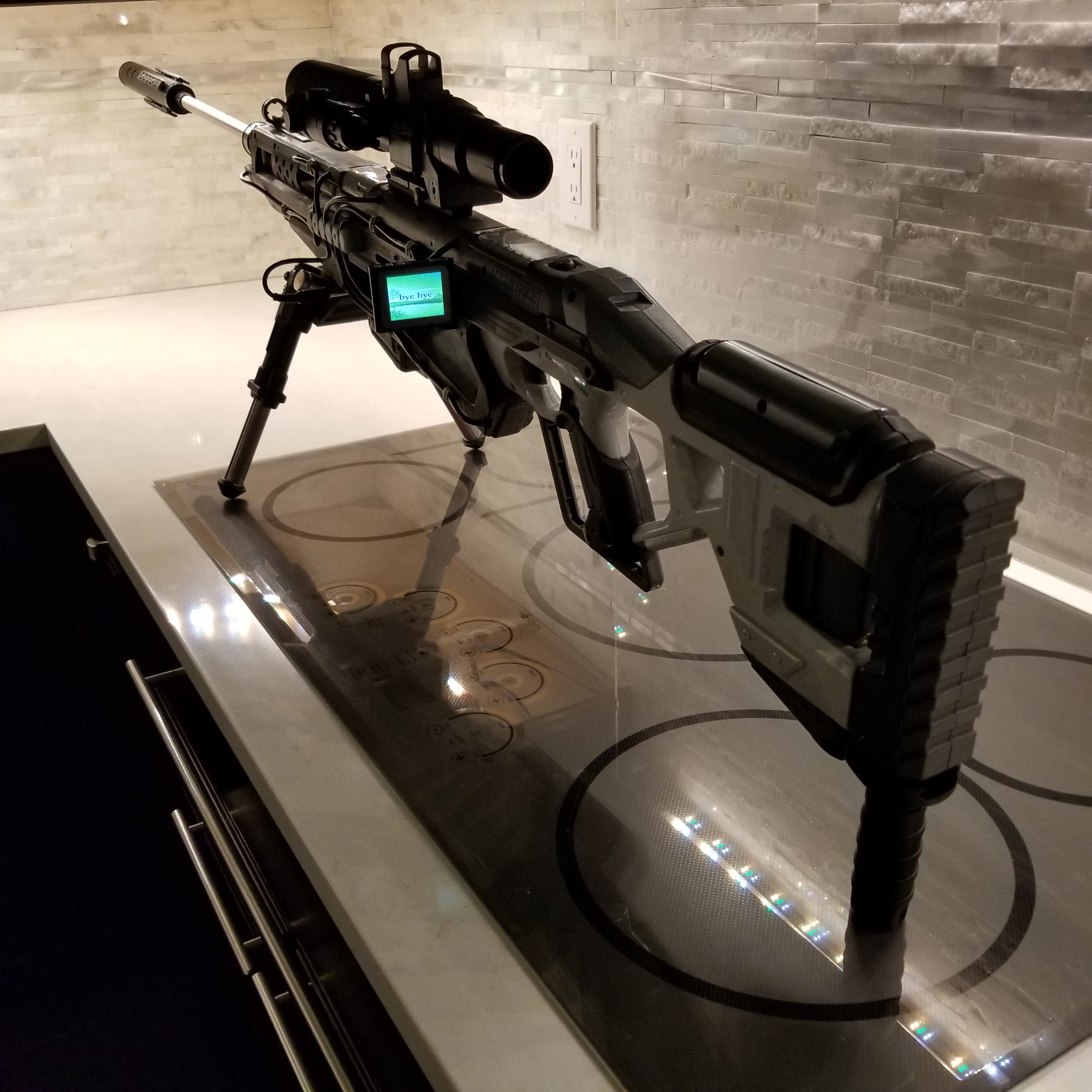

I'm a sucker for sci-fi weapons. This looks amazing! Love the color scheme, and the little screen you added is a nice effect. Are you using real rifle bullet casings? They look really realistic.
Nice job Vim. I dig the stripes (y)

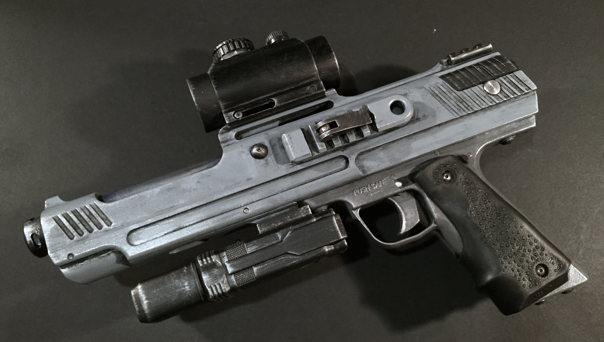

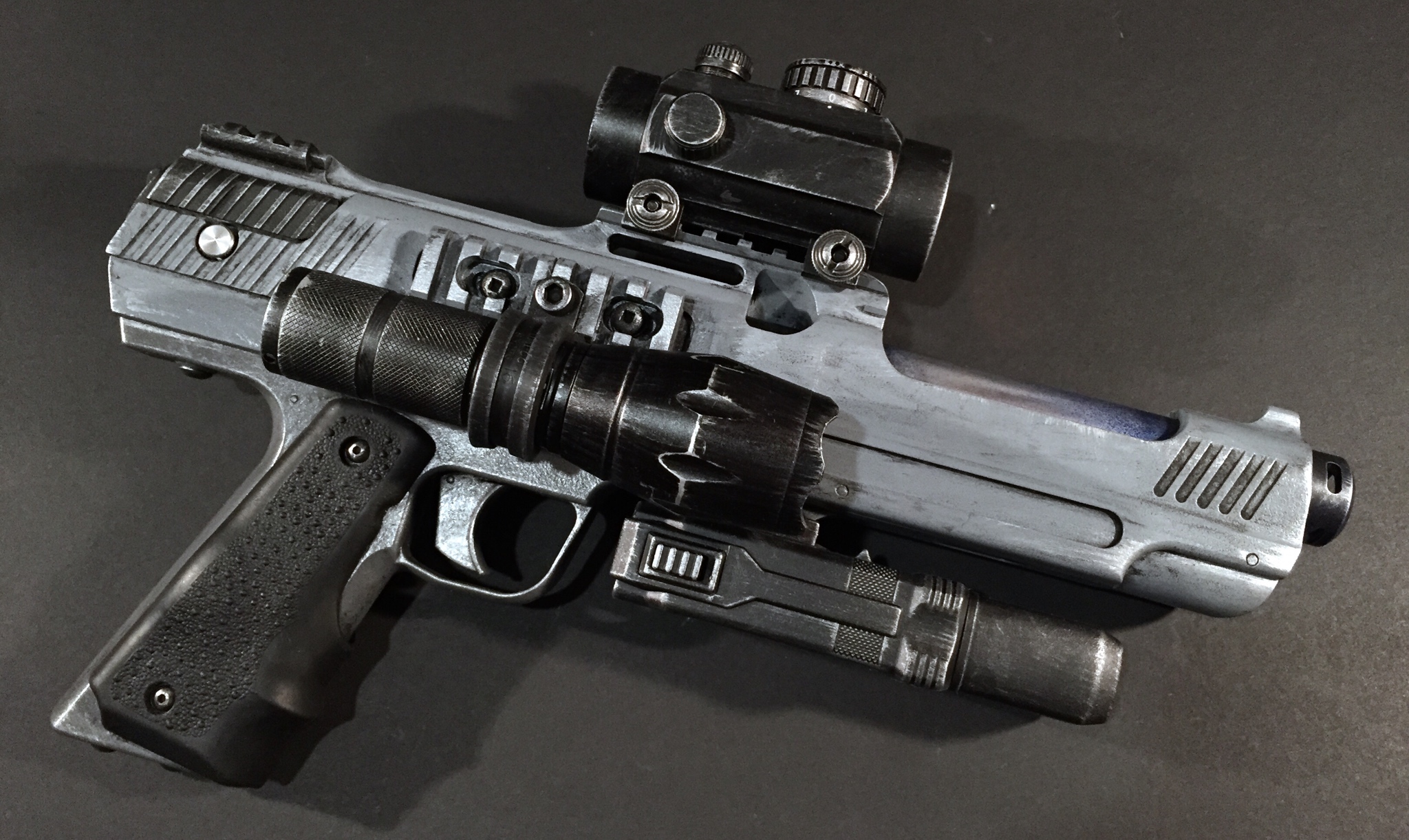

My latest . . .
Sorry... I don't know what happened. I quoted your post, but my comment didn't show up underneath it for some reason. I was going to say I really dig the finish and sci-fi feel. Looks great and I'm sure it'll look even more realistic when you weather it!
Nice touch with the tiny screen. Also, are those real bullet shell casings? They looks so realistic and shiny!
