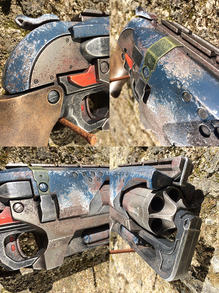

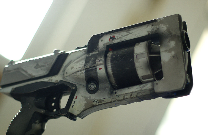

Spring has well and truly sprung here in NZ, the temperature is climbing steadily back into the double-digits, and once again the paint is flying. Can I get a Huzzah!?

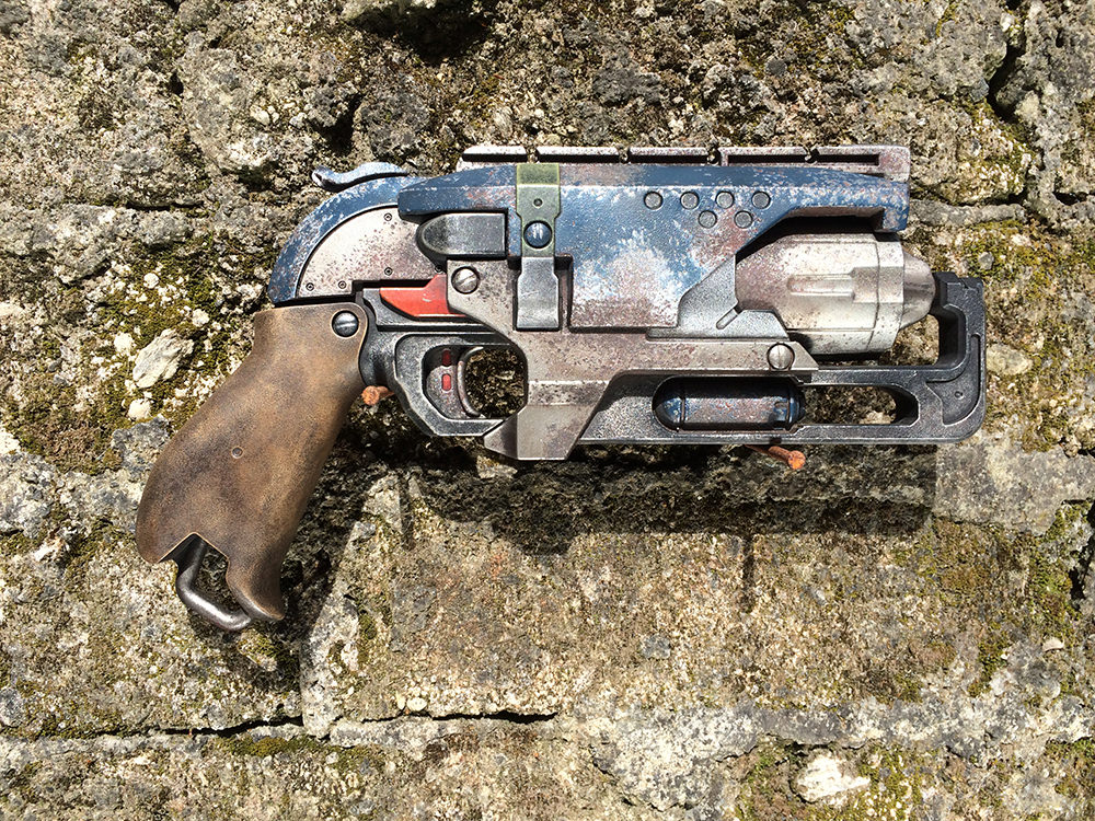

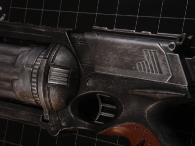

May I introduce to you, the Corsair; a WWII-era navy pilot sidearm, named after the Vought F4U Corsair aeroplane.

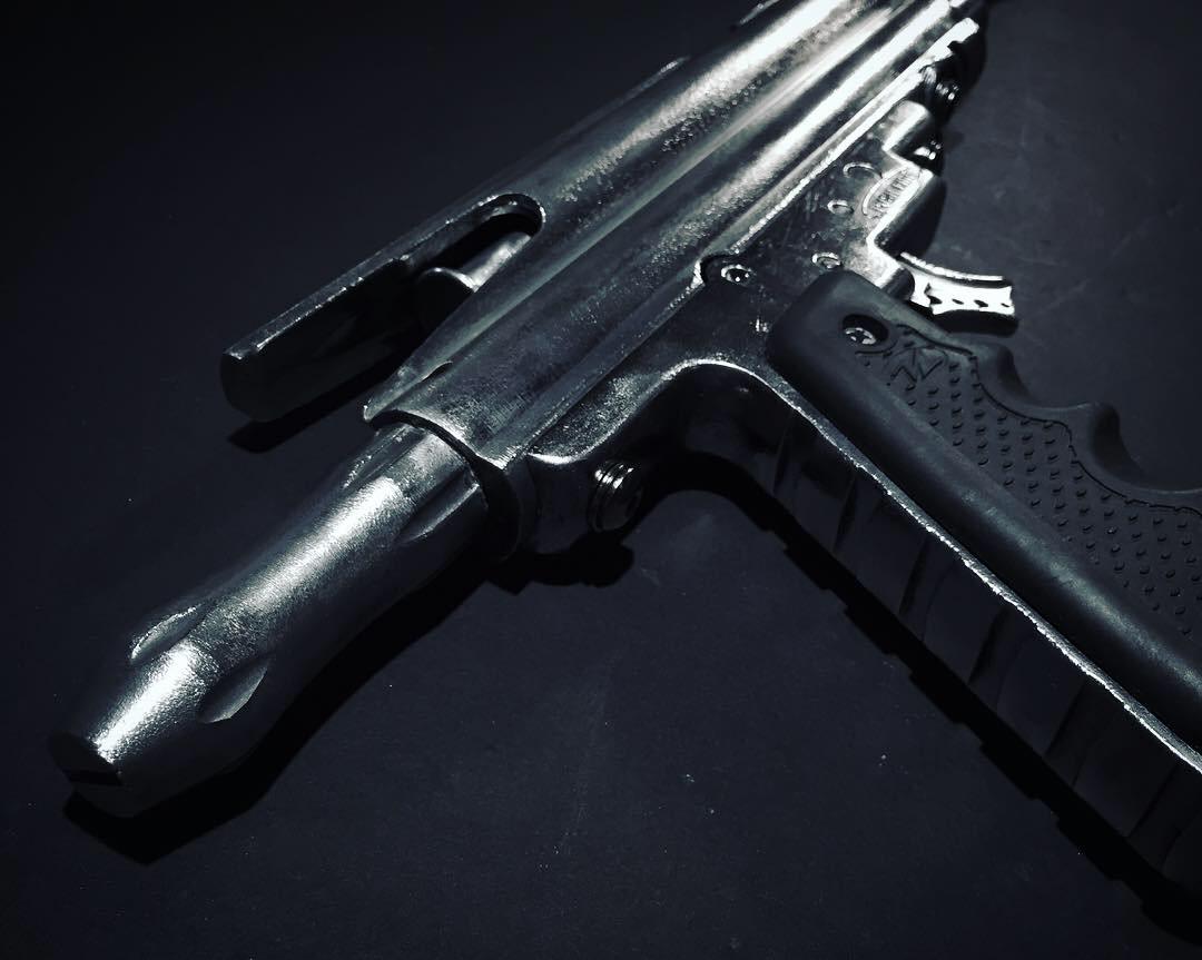

This blaster employs an experimental technique for the oxidizing of the paint as well as my usual corrosion techniques. It's achieved by leaving all of the salt used for the rust in place, applying more salt over the metal coat, and then spraying a light coat of white before the top primary is applied. The top coat is applied by spraying predominantly from a single direction (similar to the water droplet effect technique), in this case, from the top down. This allows the salt to act as a rough mask, allowing the white to show through the blue around the salted areas.
I had no idea if this would work or not, but I think I can mark the experiment a success!
Thanks for looking, and I hope you found something in this you can take away and apply to your own work.
Peace :)

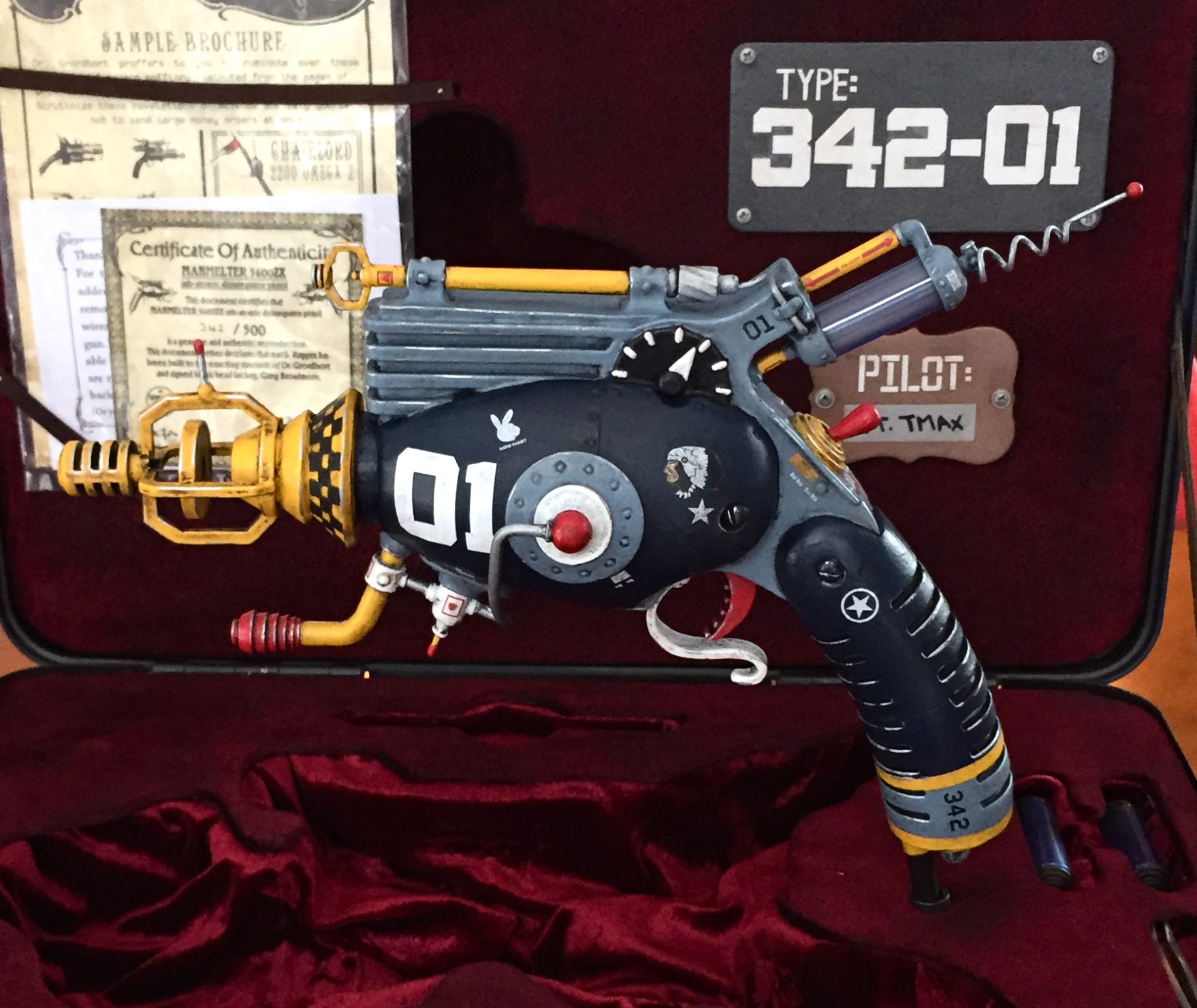

Bro, nailed it! Big fan of the F4U and I love this concept. In fact I did a custom Weta Dr.Grordbort Manmelter in the Corsiar paint scheme...
NZ colours of course! #represent #aotearoa #middleearth #proudkiwi
Keep up the amazing work! (y)

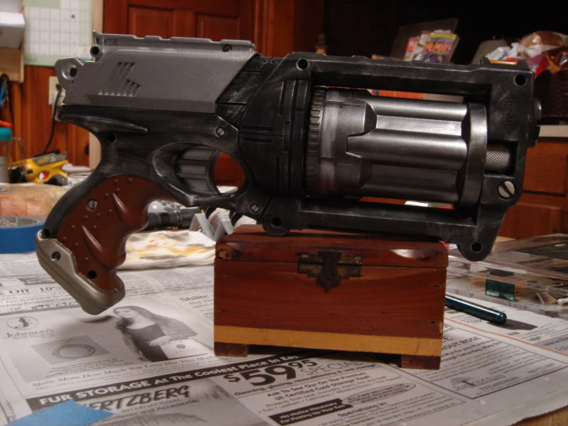

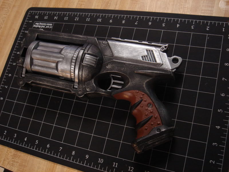

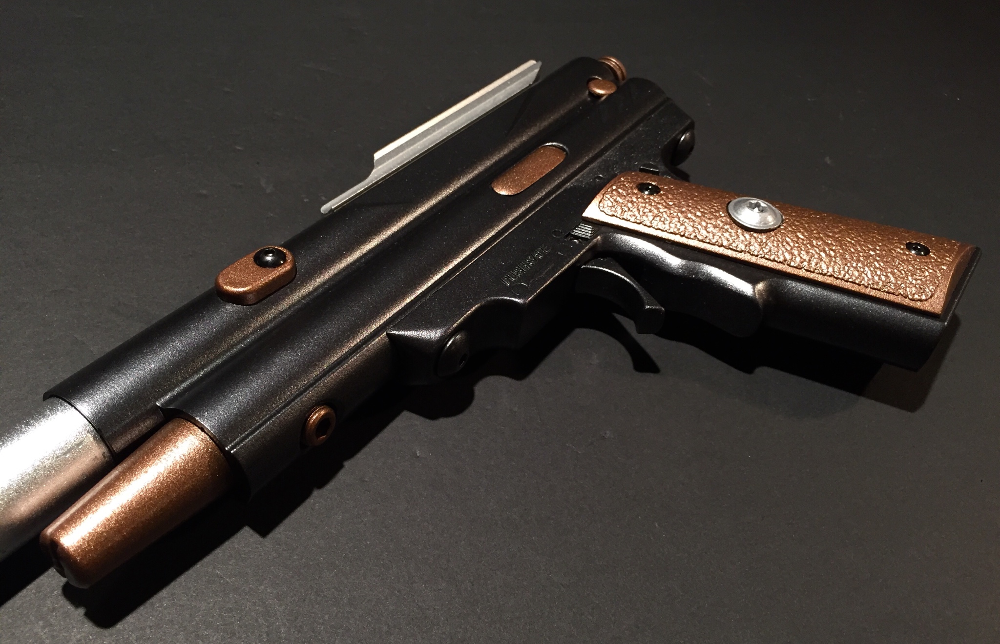

The leather effect you did on that plastic grip is amazing, how'd you do that?
Hi Kylash,
It's drybrushed with 3 shades of brown enamel (I just add a little more white to each successive coat) over the black undercoat, and finished with a dark grey spirit-based acrylic wash.

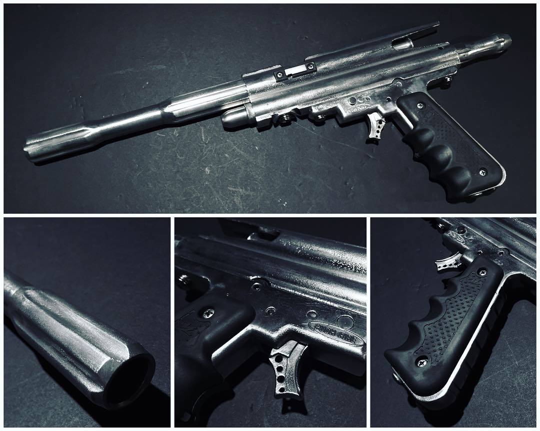

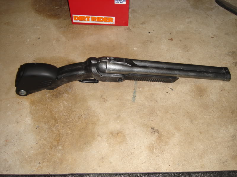

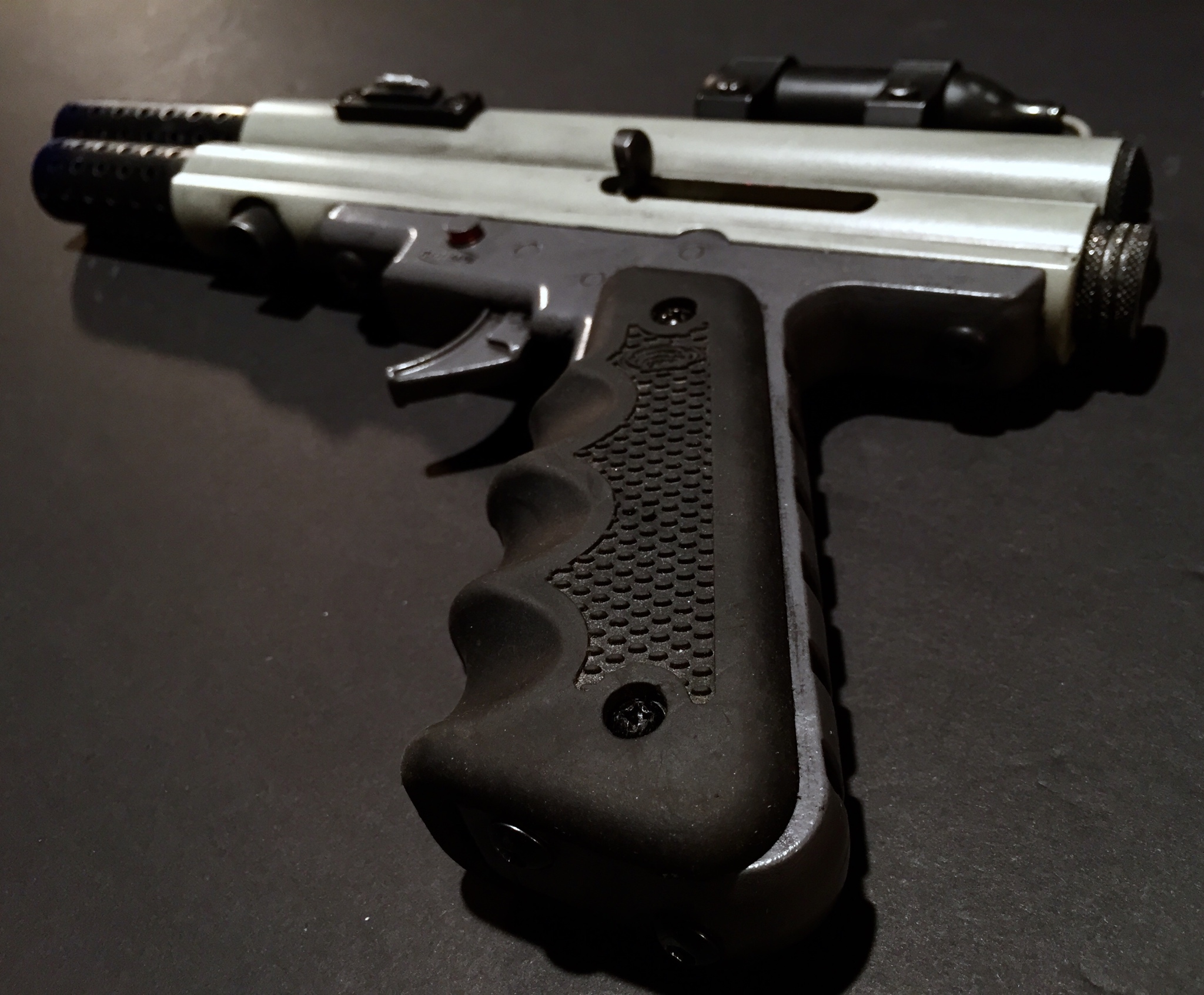

I know I have posted a couple of these before but here are some I have done:
This was for a customer that wanted one for his sons birthday. He had seen one I brought in to work and asked me to make him one.
One for me, that I ended up selling to the customer as well.
My first, I ended up giving to a freind for his birthday.

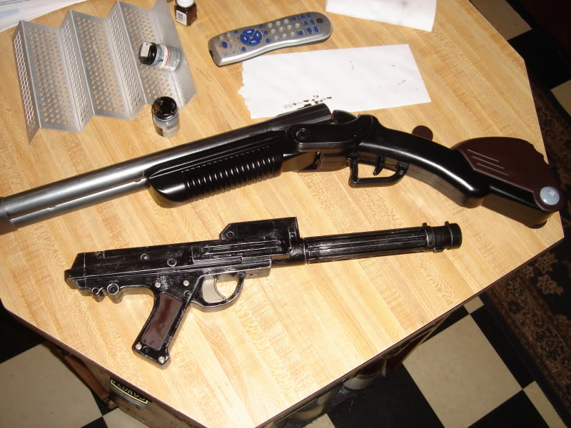

My RPF Secret Santa giveaway(2009), went to propologist.
These were quicky builds maybe two-three hours for both of them. A customer needed them for a Halloween party, and I only had one evening to crank them out
I just got two new Nerf guns and I hope I can tear them down and repaint them soon. Also looks like I have lots of brown, black, and silver paint. :)
I have that Star Wars Nerf Gun blaster too. Picked it up at a really cheap thrift shop for .25ct. lol I'll have to share some pics. I cut mine shorter and made a pistol.
Man, those are great looking builds. I love tearing apart paintball guns!
Did you glue or bolt the nerf scope down? I've had terrible luck with nerf scopes breaking off with very little use. I started using milliput, and steel stick to fix them in place!
Screws and glue! Lol. Was a mission getting screws through the gun body into the scope prior to final assembly, but worked out in the end. They are on there pretty good.

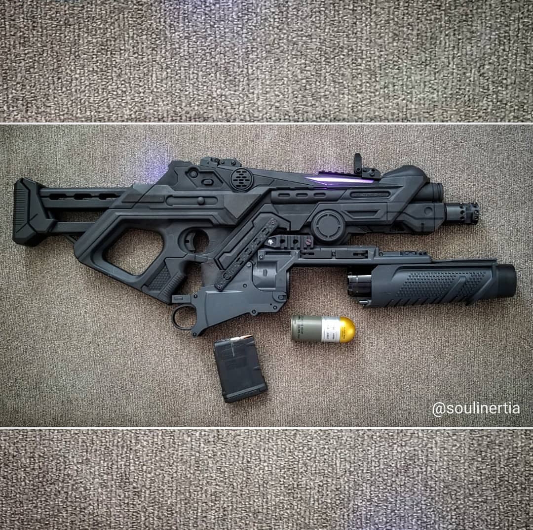

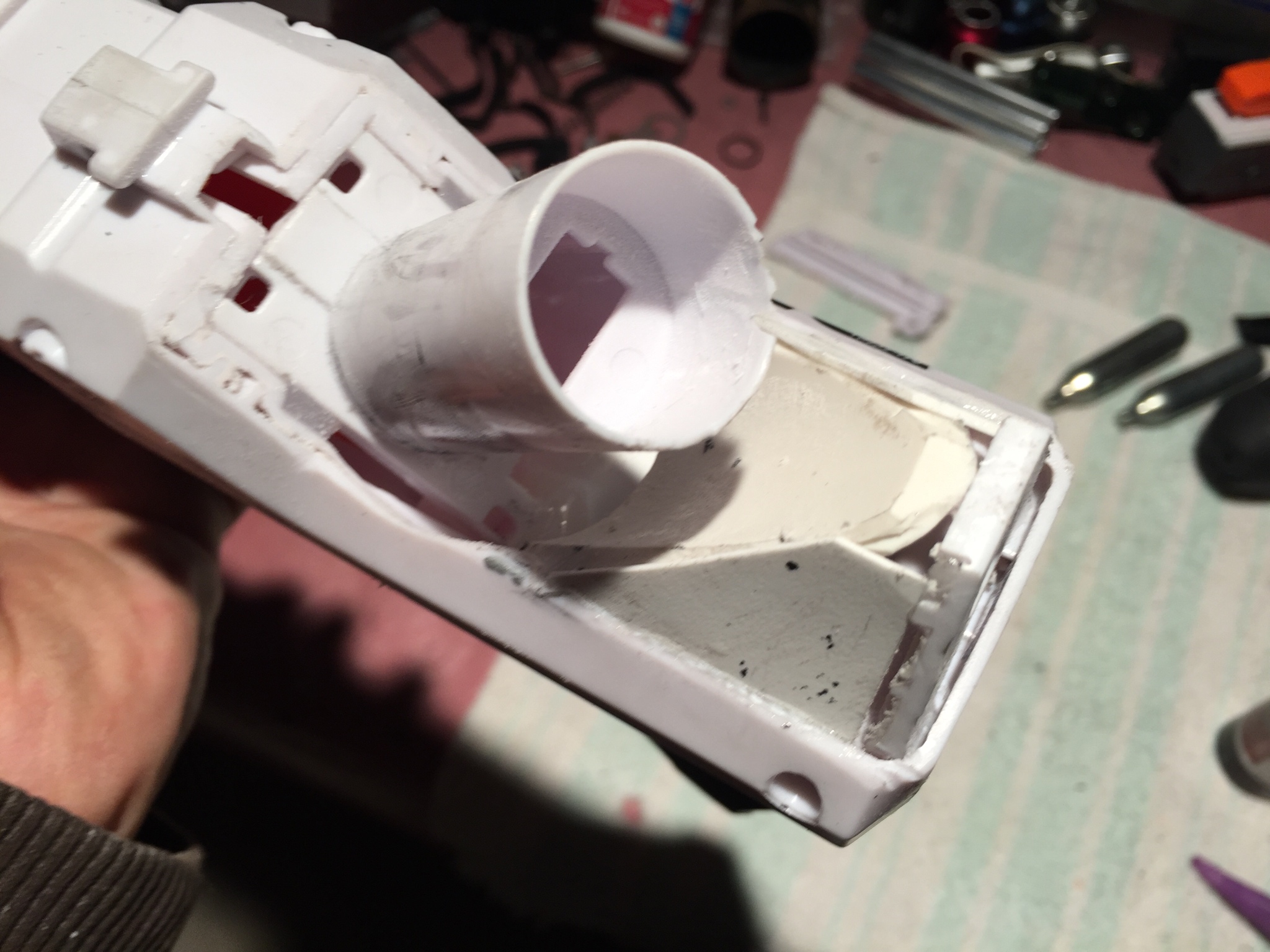

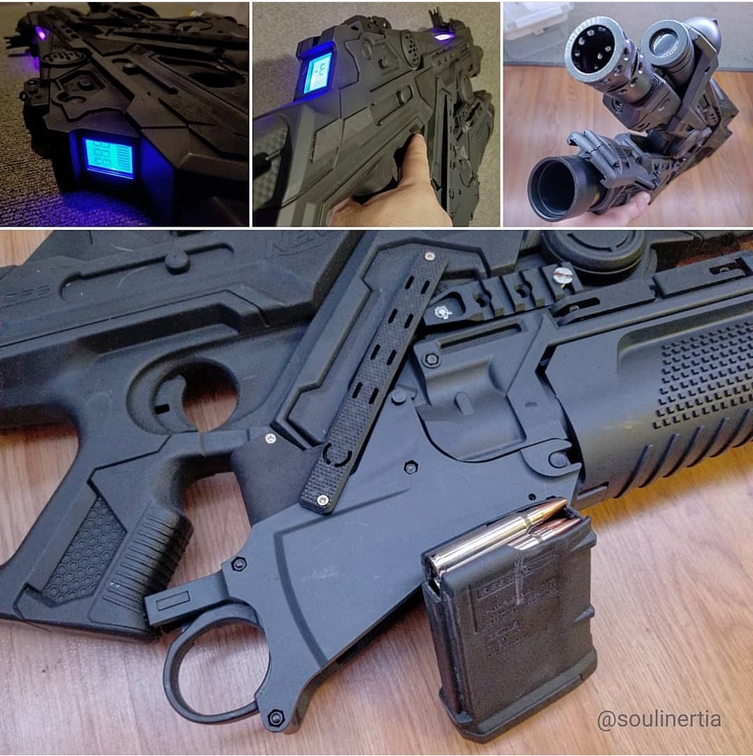

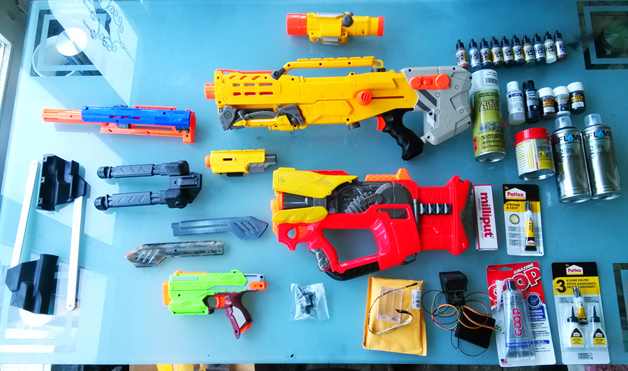

Thought I'd contribute...
These are the parts used:

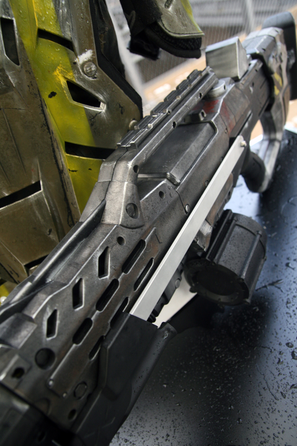

This is the result - The Carson Defense Concepts SRN-001 'Siren':
Detail:

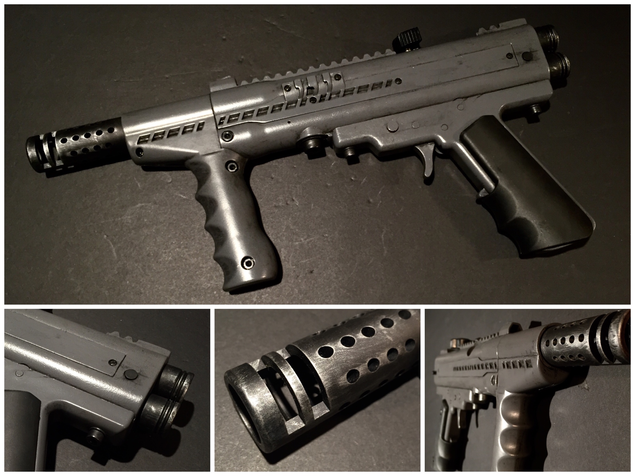

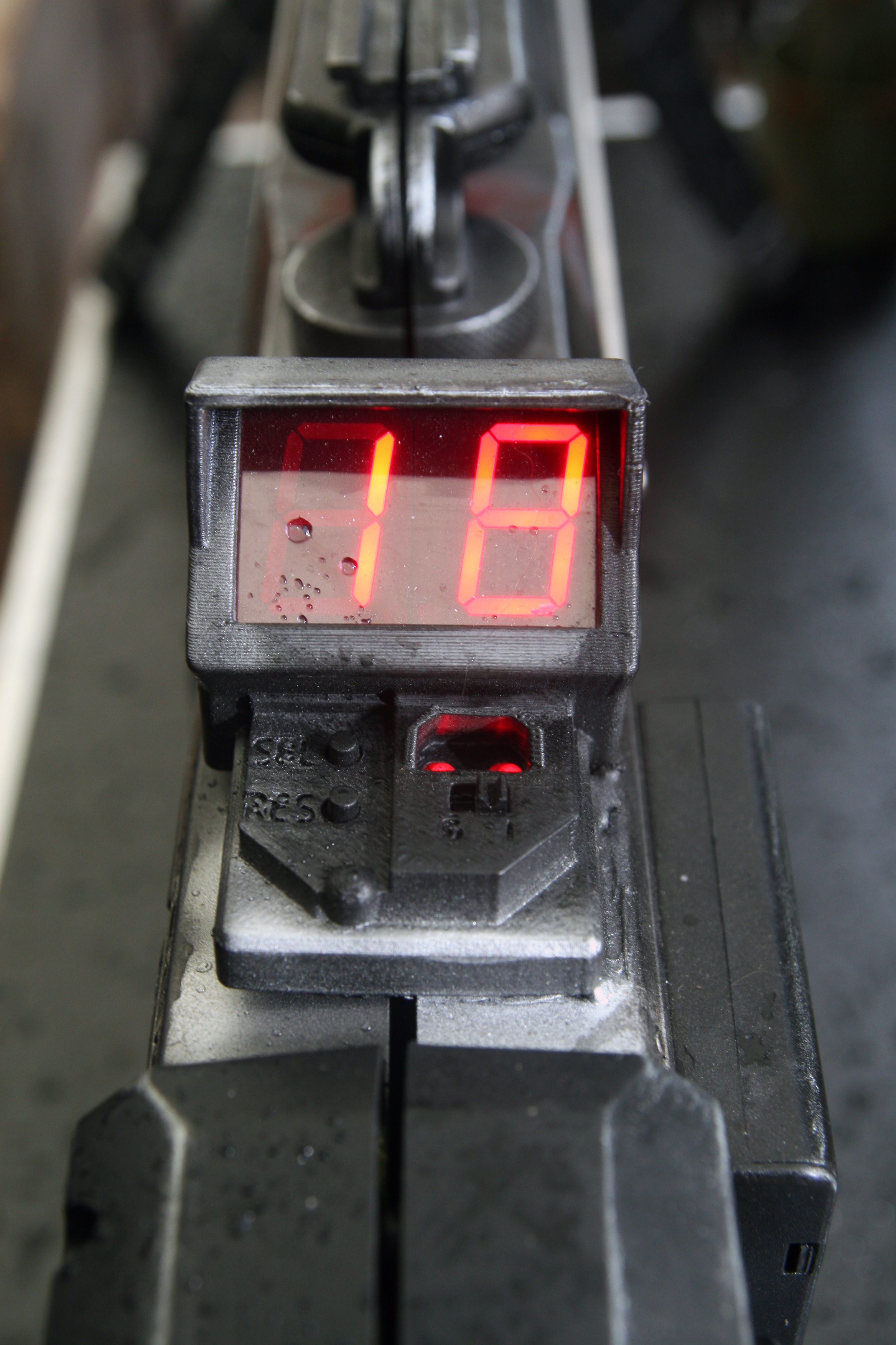

Working Ammo Counter:
Nice job. I'm sure you have a simple answer, but what did you use for the ammo counter? Small, programmed LED panel? Like the one you might find in a clock? Or did you use something more complex?

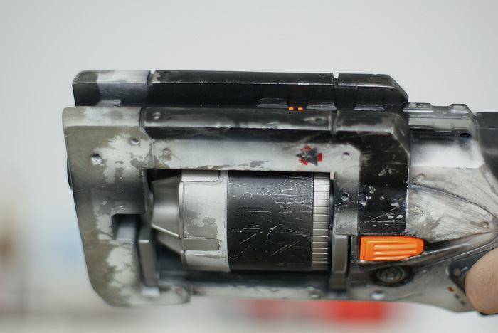

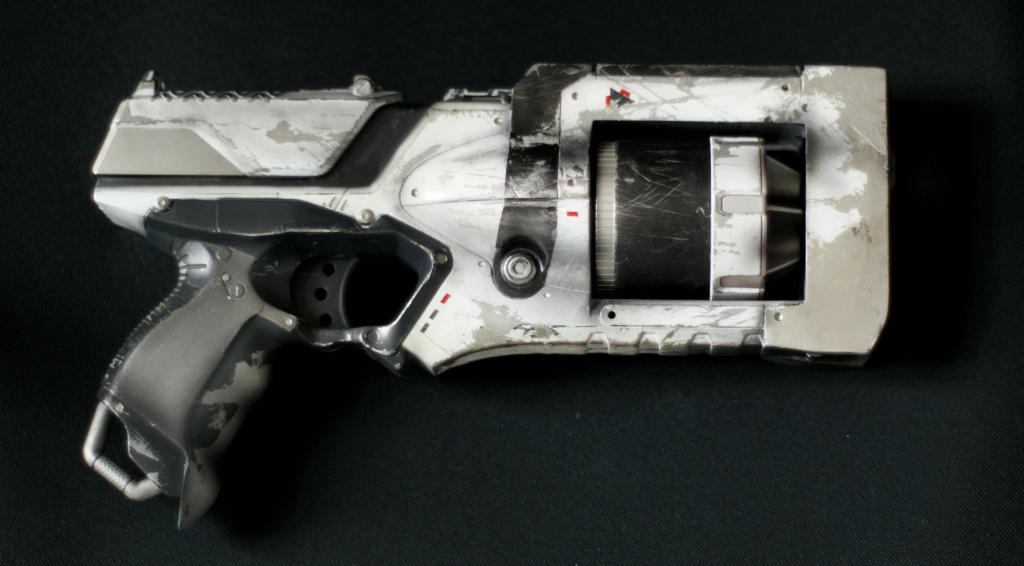

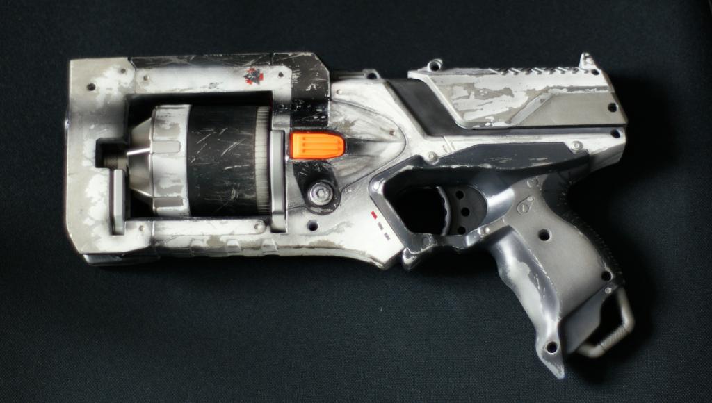

Hello again :)

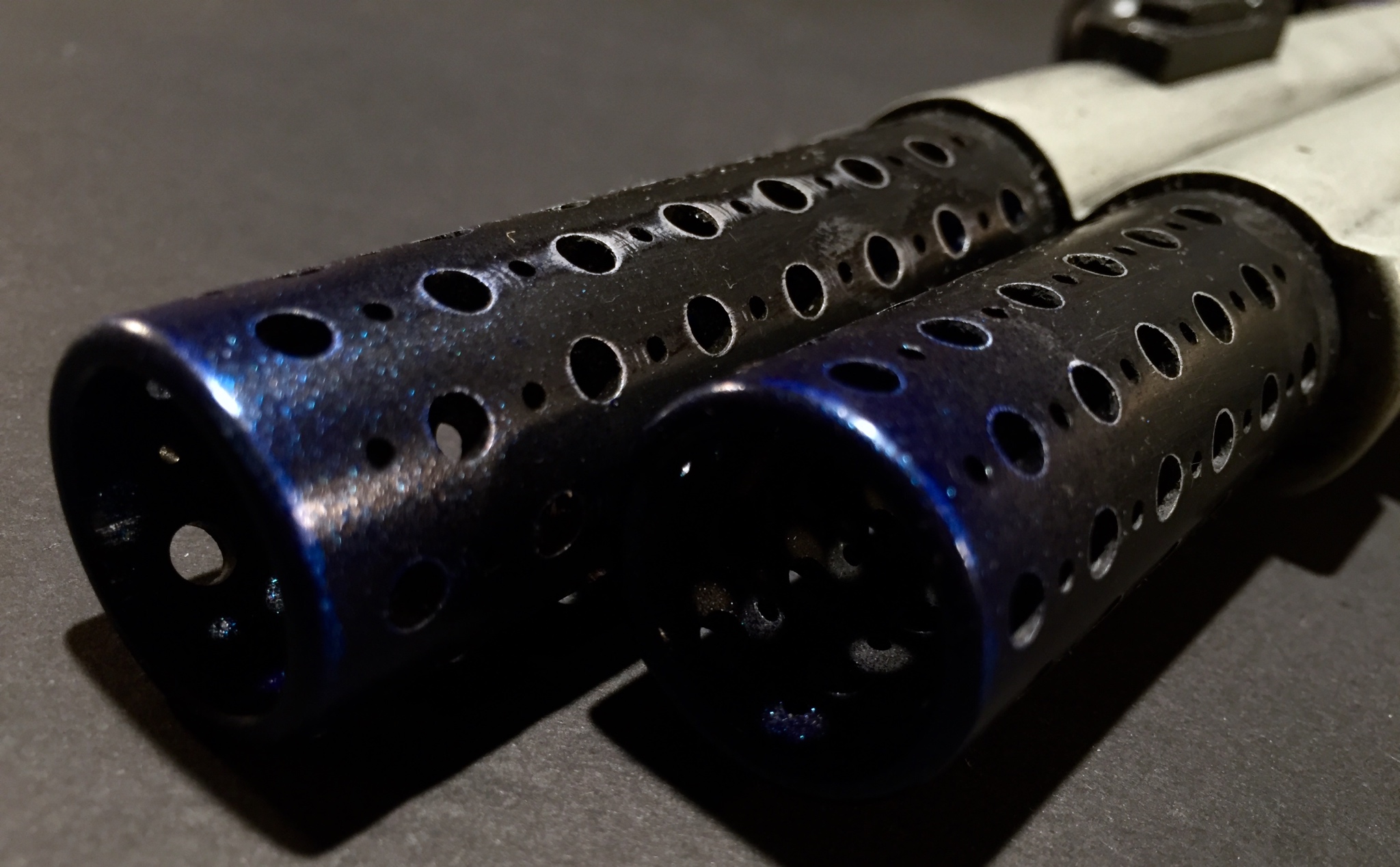

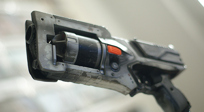

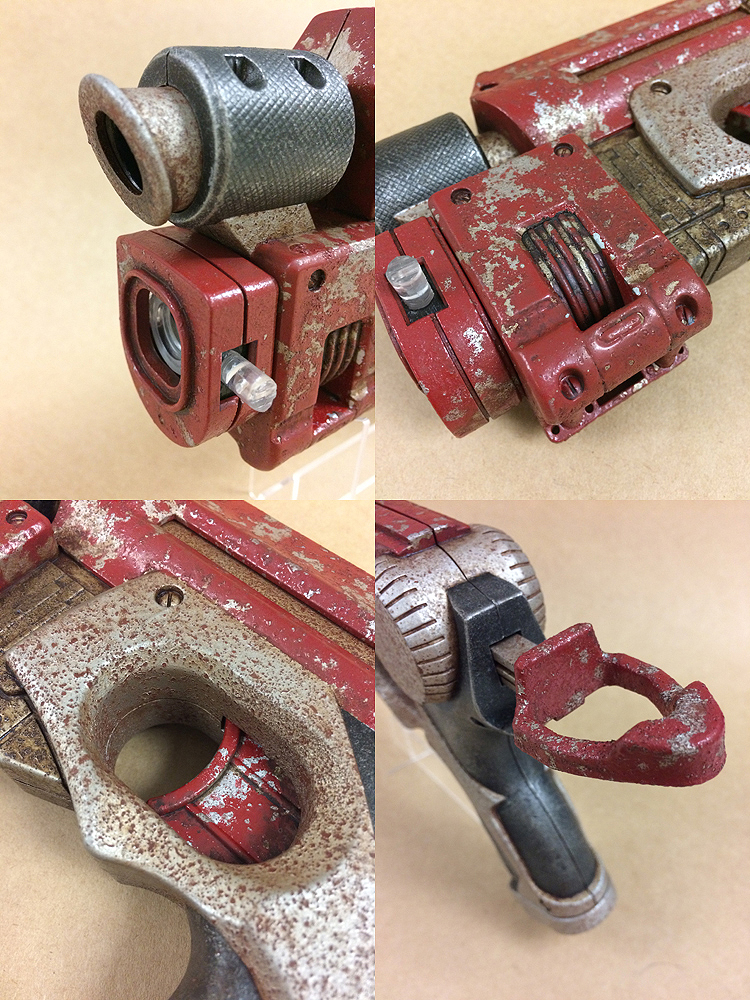

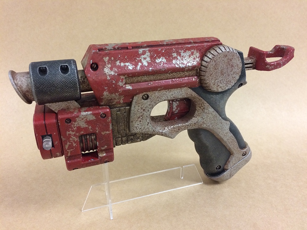

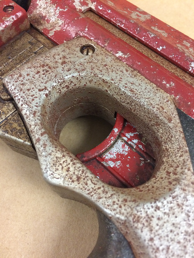

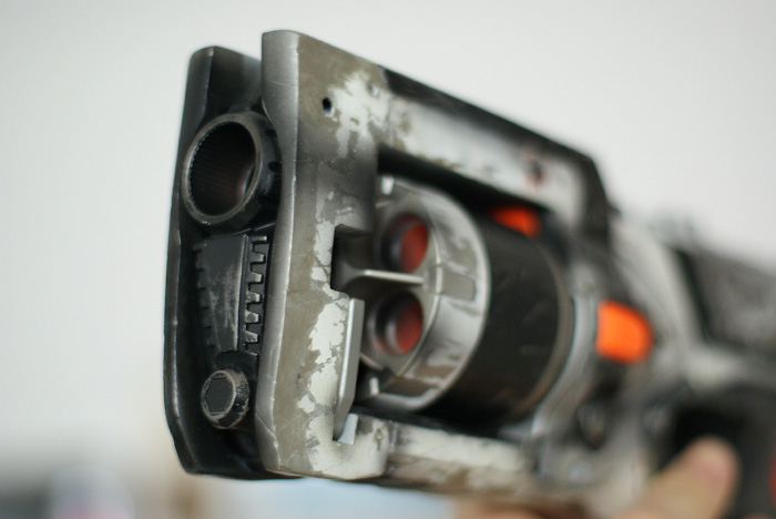

As an experiment, I decided to see just how far I could push this salt-mask rust look.
I started with an undercoat of rust brown, and then another coat on top of that, but while it was still wet, I sprinkled it liberally with sea salt from a grinder so that it set into the paint, and then a coat of matt aluminium on top of that. When the aluminium was dry I rinsed the salt away with warm water. The pitted, speckled look I was hoping for came through perfectly.
I then masked the bits i wanted red with tape, and then used rock salt in the usual way to achieve the chipped paint appearance (the more I think about this, the more I am convinced that I should have dropped the rock salt onto the aluminium while it was wet. That way it seems to give a much sharper finish, and as I found with the rust-base, it's also a lot easier to manage than the usual method of trying to affix it with water. Next time...), more masking and a bit of dry-brushed matt black for the handle and the muzzle, and finally, all of the aluminium and red parts got an all-over wash with a combination of rust-brown and grime.
Alterations to the bodywork include; the rails (mostly) removed, the dart holder was chopped out, and the redundant iron-sight from above the muzzle are all gone. I also filled in the logo roundels and the grill in the back of the grip for extra streamlining.
Another relic dug up from Nerf's past! :)
Amazing job on the texture and paint! You have really mastered that technique... I need to try it on my props. I recently made a flame thrower and I wanted it to look really worn/rusted/banged up. My rust didn't turn out so well. I ended up putting too much acrylic paint on the surface (no texture at all). After lightly sanding it, it looked a little more convincing. I'm going to try your method next time.
