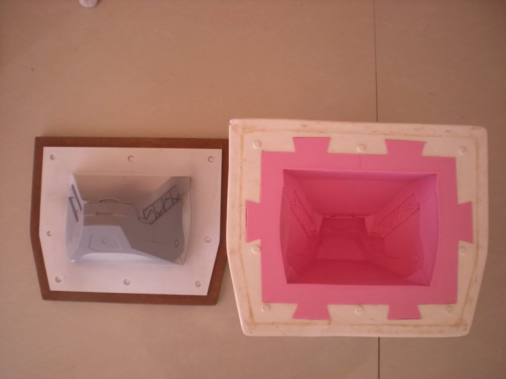

Your molds are interesting.
Is there only silicon touching one side of the part face? Is the other side just your gypsum cement/plaster?
I've never seen a mold like that. Is there a chance that the resin might stick to the plaster or do you just coat that part in mold release thoroughly?
Looking at it again right now is this just a open face mold and the white stuff under the grey part just a styrene base put there for molding against. Is the silicon brushed on?

Hi Nick
I took a couple of pics of the mold of the main helmet part to describe how I did the molds :
Pic 1 - The main part of the helmet blocked off with styrene and mounted on a piece of MDF with alignment keys drilled into the styrene base.
Pic 2 - The main part of the helmet covered in a layer of clay. The clay will be removed once you've done the mother mold and will form the cavity you pour your silicone into.
Pic 3 - The clay covered part covered in plaster to form the outer casing or mother mold. Please note that this pic isn't the pic of the clay covered master I ended up using, but should give you an idea as the process was exactly the same. Initially I intended on making a 2 part mother mold but decided against it and went with an easier 1 part mold instead.
Pic 4 - This is the result once the clay is removed and the silicone is poured into the mother mold. I brushed on 2 thin layers of silicone just to be sure I didn't trap any air and filled in the areas I thought may form air pockets before pouring the silicone into the hole on the top of the mother mold. The shape and thickness of the silicone mold depends on the shape and thickness of the clay described in pic 2.
As to your questions about resin sticking to the plaster. I thought I would just use some shrink-wrap wedged in between the silicone mold and the mother mold an let it drape down the sides of the mother mold. This should form enough of a barrier to protect the mother mold from resin sticking to it. A thick layer of release agent probably couldn't hurt either.
I hope this answers some of your questions.
