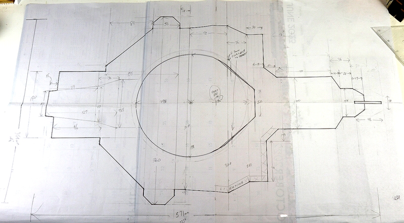

I worked out dimensions and drew up a pencil sketch. 22.5” (571mm) long and 14 1/8” (358mm) wide. The thickness is to be decided……

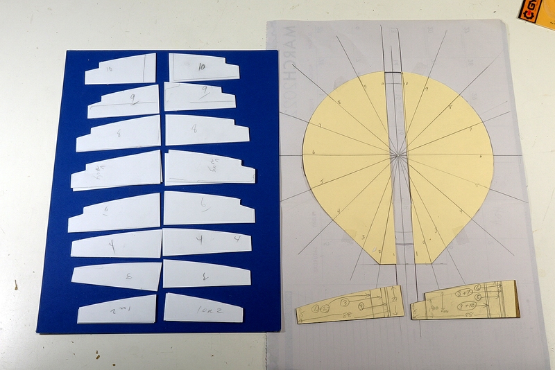

I broke down the ship in to individual sub asemblies. I began with the saucer section on top, an obvious Millennium Falcon theft. I made templates from manila card, then I traced those onto styrene.

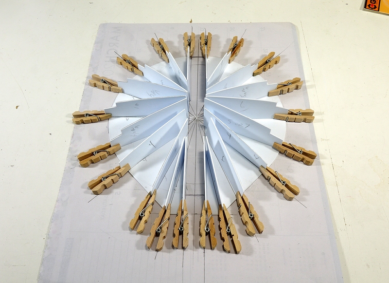

Began gluing in place onto two separate styrene bottom plates…..I'll explain the reason for two plates later..

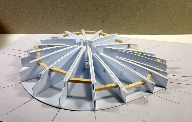

When that dried, inserted wood spacers…

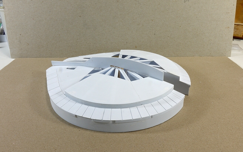

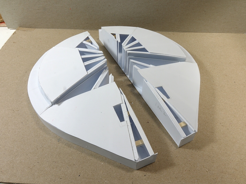

Began skinning the outside…

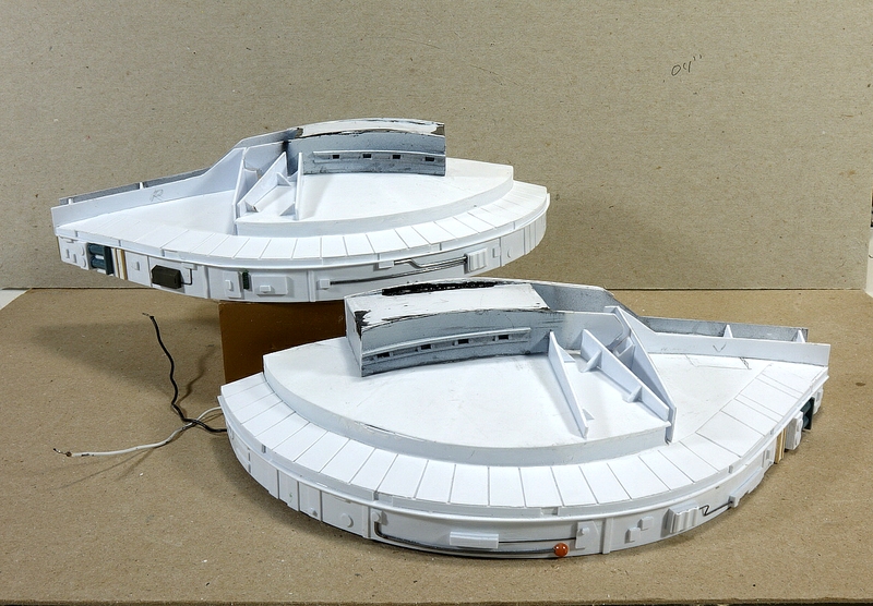

Some minor panel detailing….

Beautiful Carl!! I will be following this build for sure. I love your use of detailed layout drawings. That's definitely something I should look into doing for my builds.

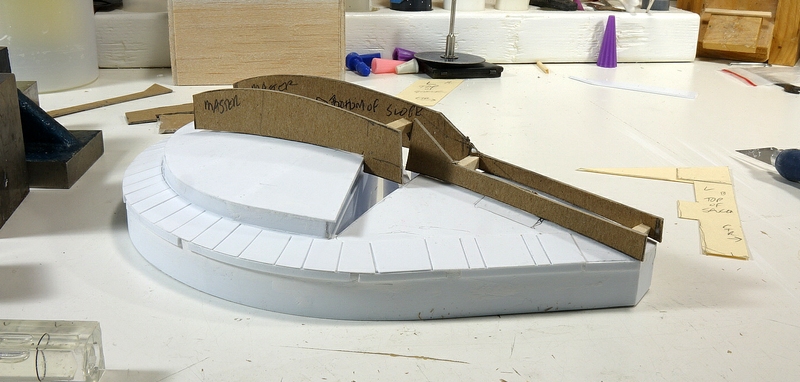

Working on the saucer crew/control area using card templates for checking shapes.

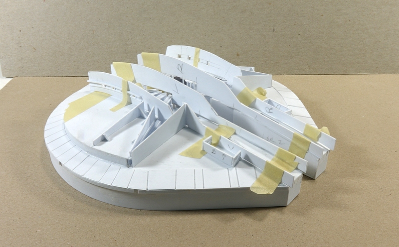

Establishing the roof lines.

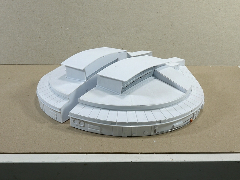

And finished off the surface panel detailing.

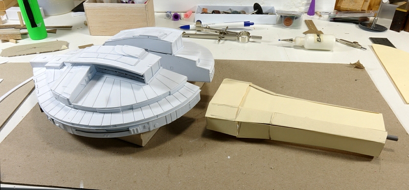

Moving up to the bow, or the “nose” next. I built a mock-up of manila card to refine the shape, length and width.

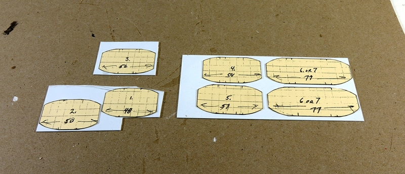

Made templates for the 7 bulkheads.

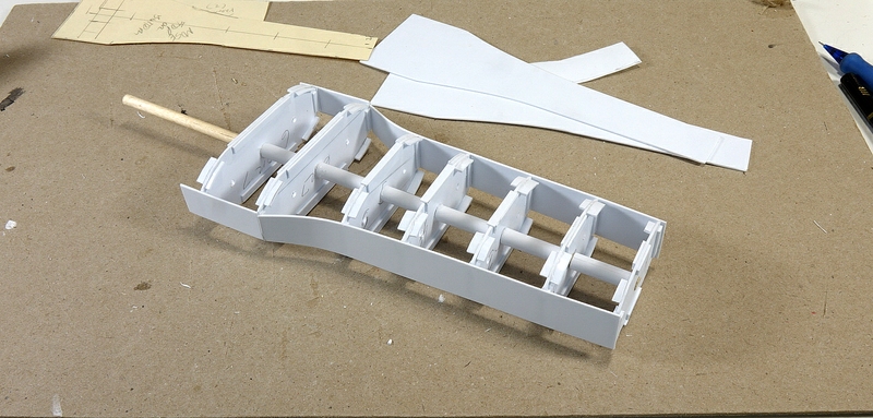

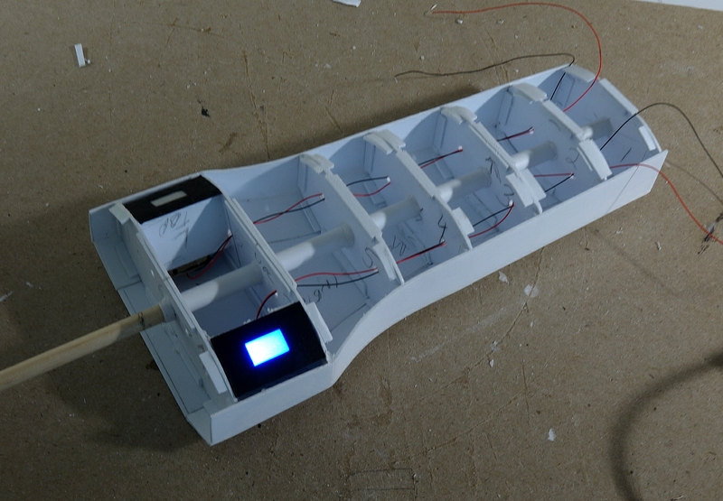

The bulkheads were cut from styrene, then I used a 3/16” (4.7mm) wood dowel as a spine.
Started to skin the exterior....

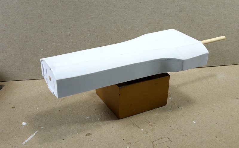

Sanding and trimming and sanding…..

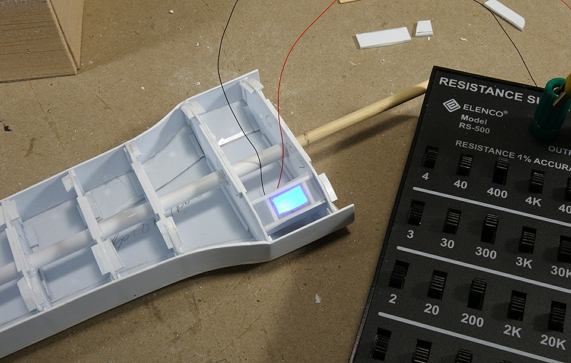

I wanted 2 blue 0603 LED lights on the top, so here, I am experimenting with size and shape.
I am using a resistor substitution box to adjust brightness. No guessing on values needed.
I installed a black cardstock "mask" around the perimeter to suppress any light leaks.
