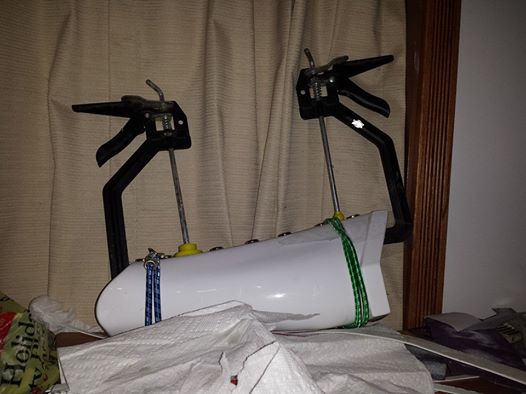

Been struggling with these calfs! They are not easy. They dont have the overlaps on the front side so you have to allign the to halfs perfectly when gluing and pray it doesnt move when drying. I actually took the whole thing apart and redid them.The cover strip i tried to allign it best I could still looks off to one side but i noticed the edge that goes along the top is longer on one side then the other.
I got frustrated and bought a crap ton of magnets and bungie cords to help keep the two halfs from moving.
Finally came out about as good as its going to get
Gluing the cover strip now on the first calf

Also I ran into a problem...I noticed the calf armor is just about the same length as my actual calf. Which makes it ride over my knee slightly and is digging into the bottom of my foot...any suggestions ? I'm thinking im going to have to attempt to trim the bottom so it fits better. As it sits now it will be very hard to walk in with it covering my knee

Really proud of the way this came out....Still have to make a cover strip for the back but the front is basically done. I left some excess cover strip hanging from the bottom. I'm guessing im going to have to trim these a bit on the bottom so it fits my left better so for now I will leave it be. Going to have a buddy look at it for me and see what I should do to correct the issue
Looks like ti came out nice!
You are right about the trimming required. You can also make U shaped cutouts on the back on top of the shin and the bottom of the thigh where your knee bends, this will allow you to move more naturally without pinching the crap out of your skin there.

Just picked it off and used my thumb or a wash cloth to rub it off...It eventually comes off and doesnt leave any scratches. Also once im finally done putting everything together I have some plastic scratch remover/polisher that im going to use on the whole thing
Yes, E6000 just comes off with a rubbing finger. It hold things together awesome if you wait for it to dry, and oddly enough you can rub it off with a finger! It almost defies logic.
As far as cleaning up the plastic after the build, look for Novus 1, 2, 3. Most times you only need 2 and 1, as 3 is for big scratches, 2 is for fine scratches and 1 is polish. If you run #2, then #1, it will shine up really nice!
