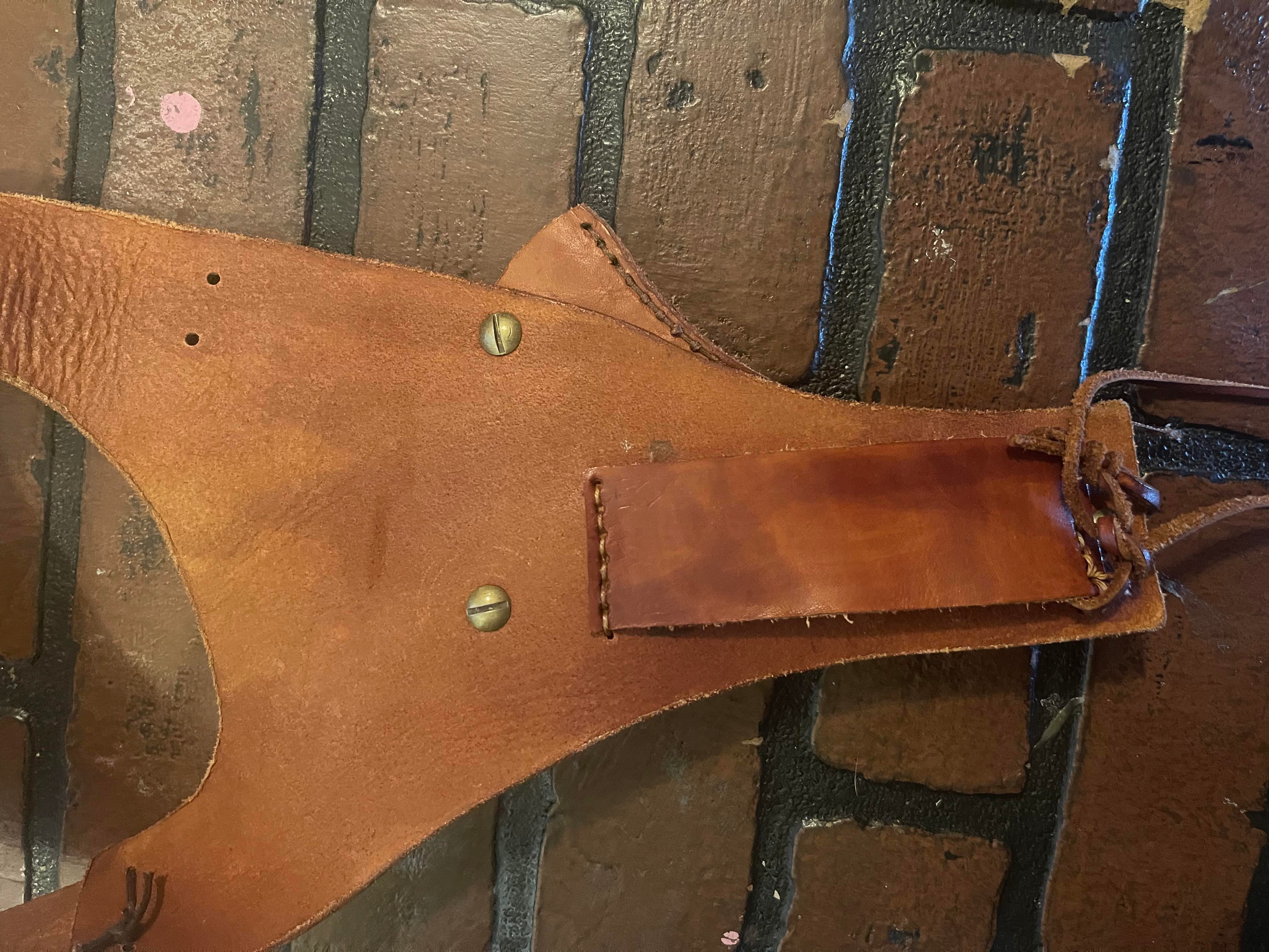

This is what originally got me interested in the subject:

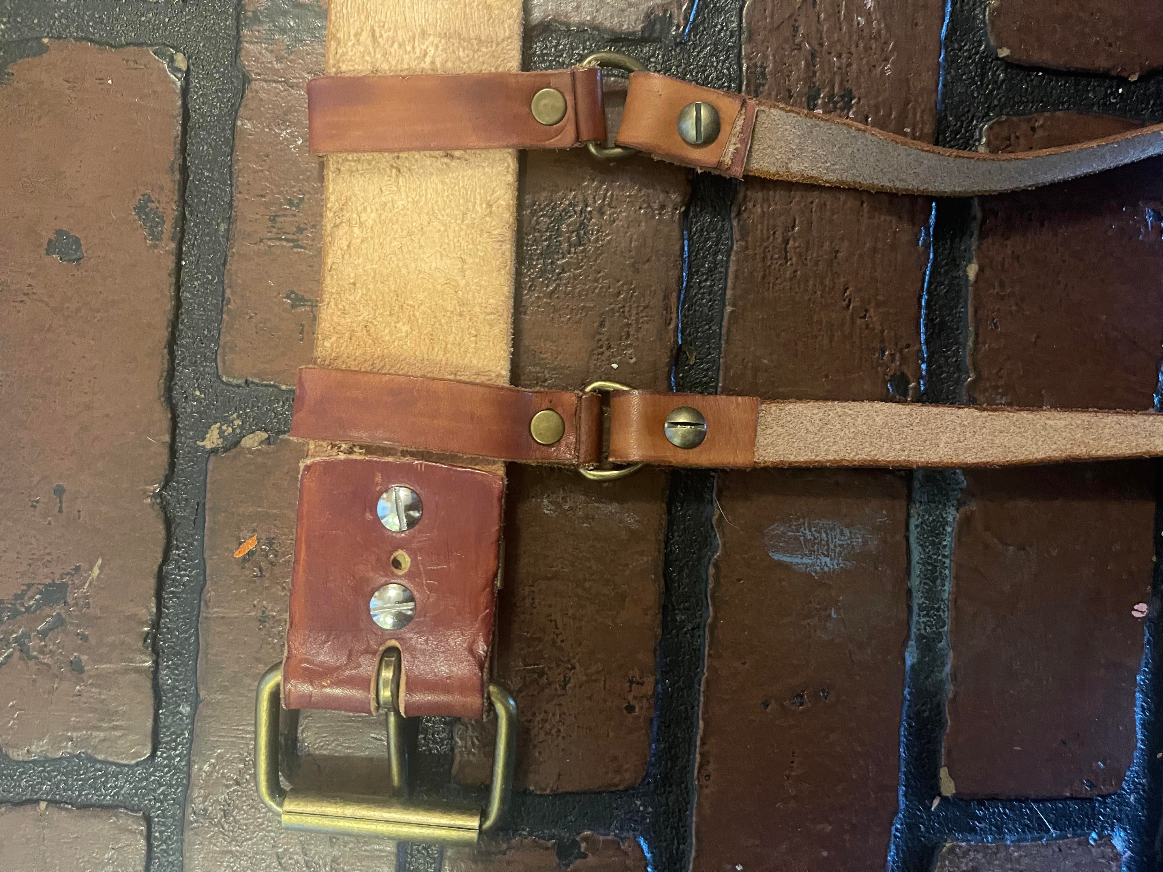

Quick pic of some of the hardware and straps because some folks have asked. It's just a variety of rivets from Tandy. Some domed Chicago screws.
Front of the back with domed Chicago screws (More info on Pattern)
Back of the back with domed Chicago screws (More info on Pattern)
Back of the belt with how I attached the single strap that goes across the body.
The Shoulder strap (Which i did not include in the pattern since it seemed very basic and I was lazy.
Front of the belt with D-Ring and brass bar / belt holder I made.
