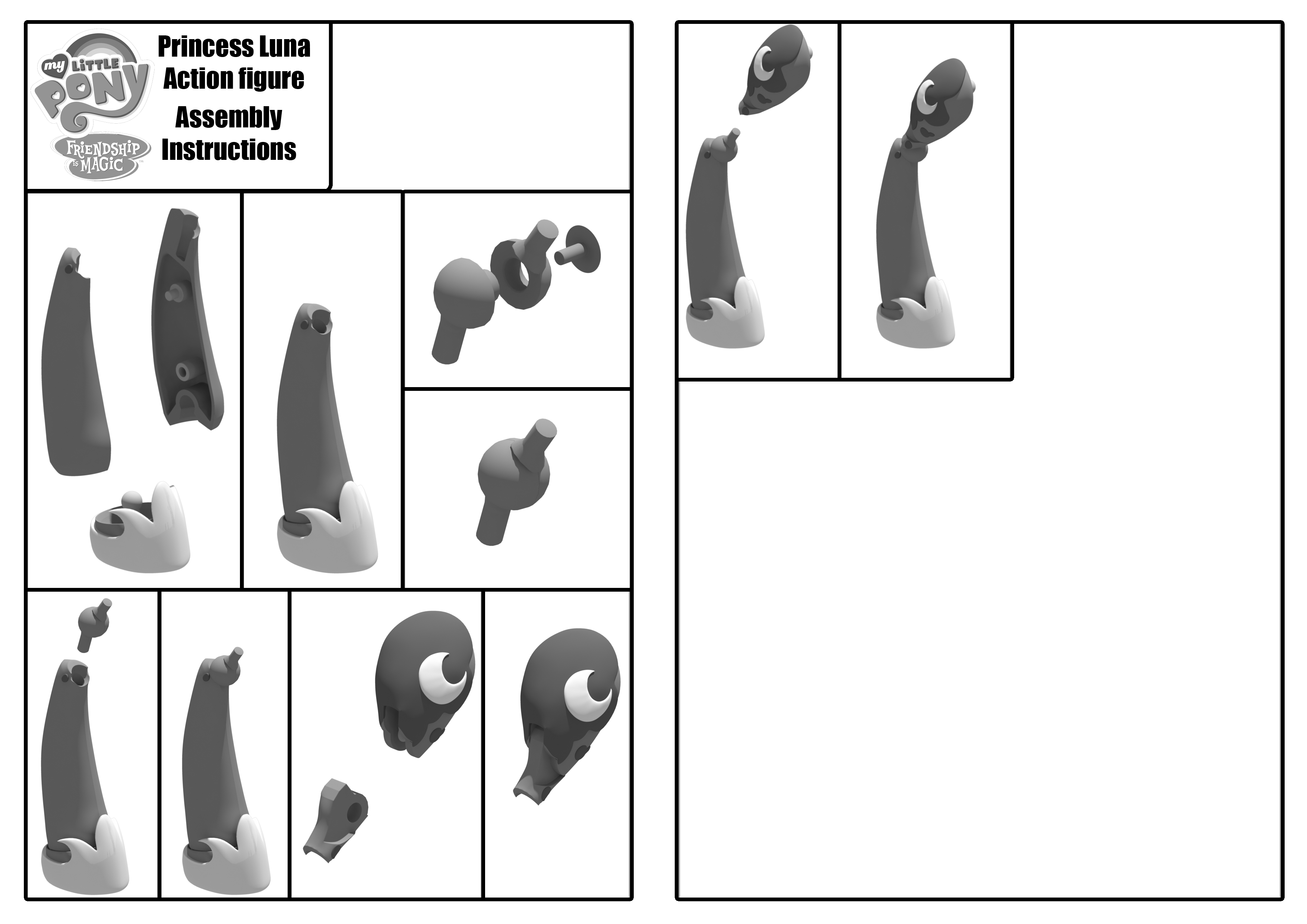

While i'm waiting for the casting supplies I went ahead to start on the assembly instructions for the kit version of the figure.
I'm still going to add dotted lines page numbers etc. These instructions will be printed and send along with the kit version of the figure and will also be posted online on my deviantart account for those who get the completed figure and want customize it or something :p

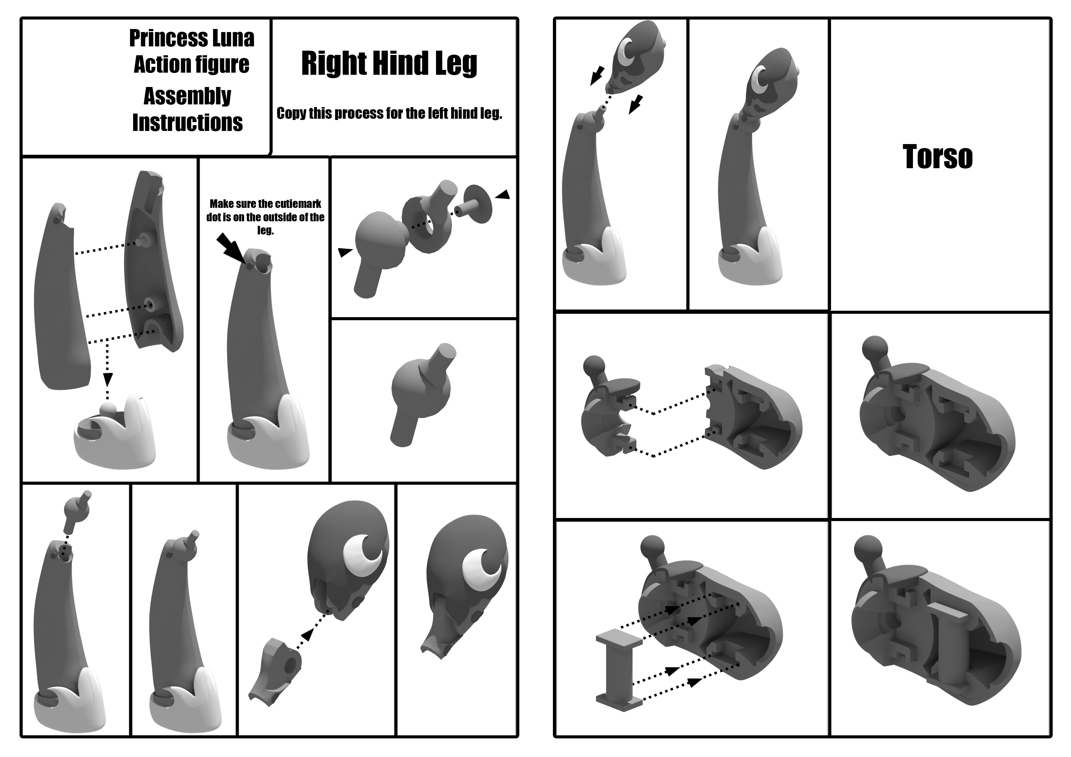

Also yesterday I promised an update on the Instruction booklet. Sadly i only managed to finish the first page. in anycase here it is.
I'll try to finish the rest when the molds are curing.

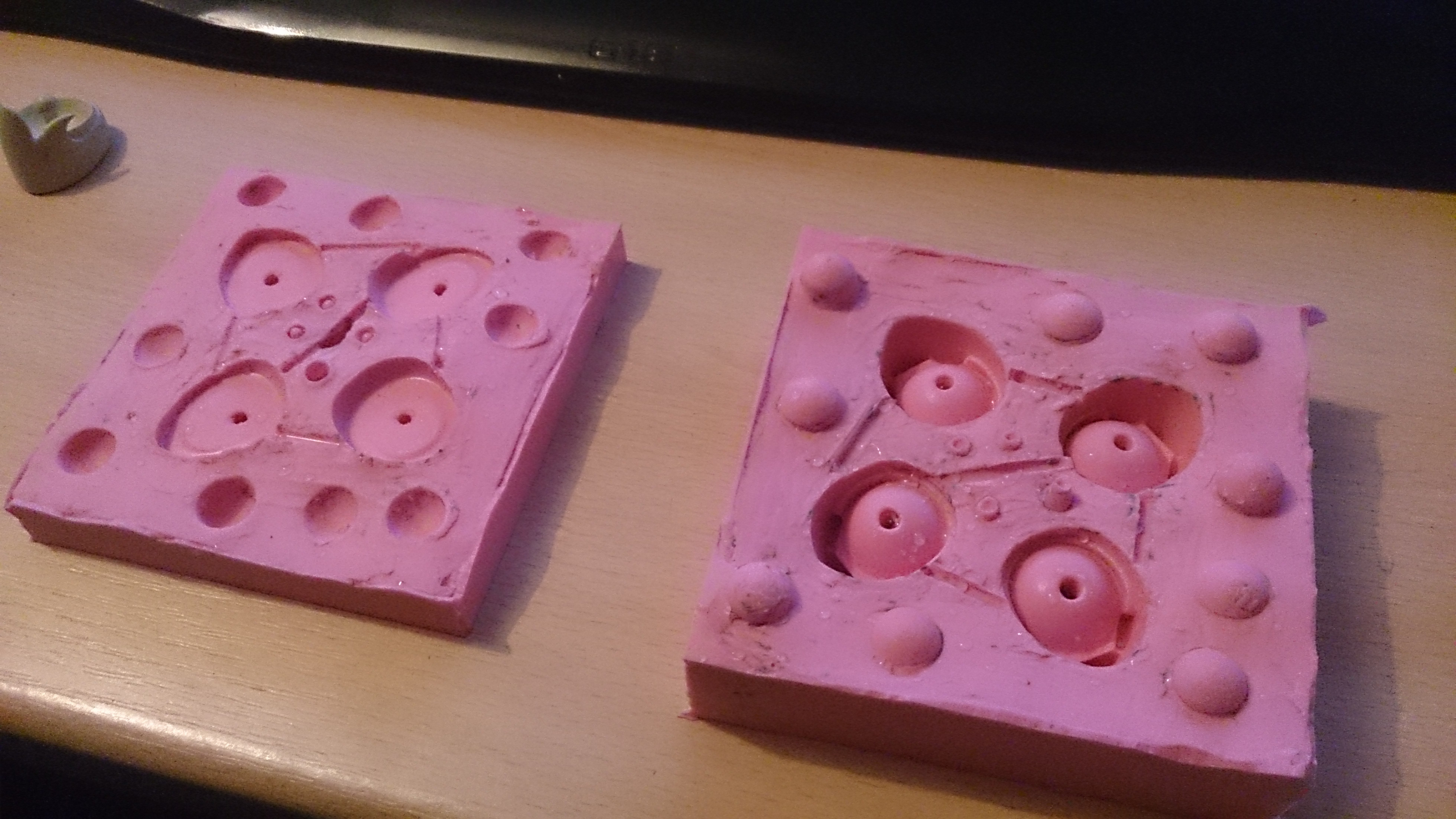

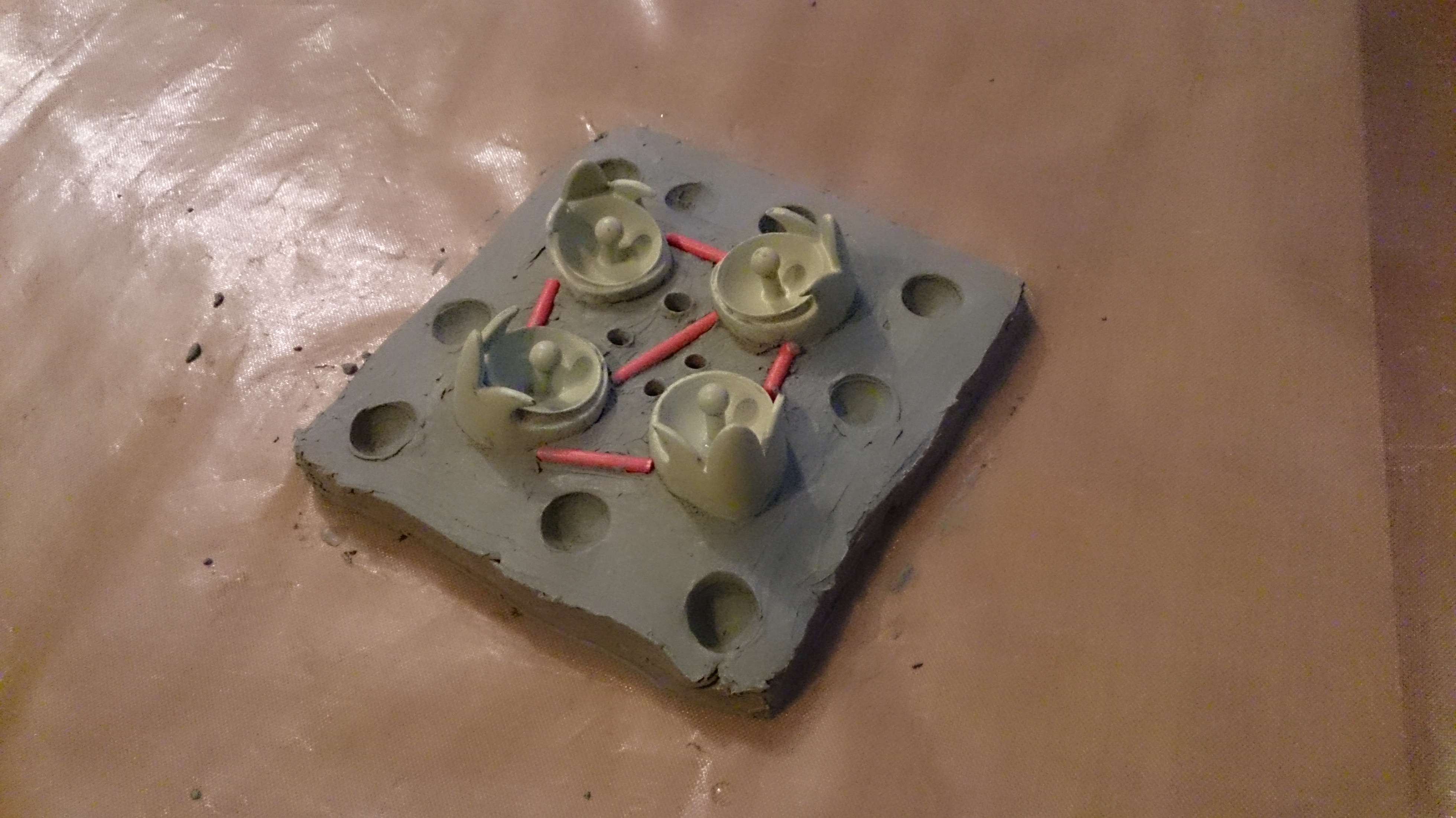

Ok part one of the two part mold is done. i could probably have made the surface of the clay bed a little smoother but all in all in turned out pretty good for my first ever silicone mold
one thing though. it's a nightmare to get the remaining tiny bits of clay off the mold. can anyone recommend a good way to get plasteline clay off?

well so far everything is not well. I've tried casting the feet using the mold in the pictures above but it's full of bubbles in major structual areas especialy around the ball joint.
I've dusted the mold with mold release and talc. i tried turning the mold upside down and spinning it. but it's no use. I think i may need to make a new mold for the feet :(
Have you used a vacuum chamber?
No since i can't afford one i hoped i would be able to get decent results using just regular casting. i guess i was wrong :(
the bubbles are so big that the ball joints just break off during demolding
I never tried it for this kind of mold but I had some luck using a plam sander (without sandpaper) on the side of the mold to remove air bubbles in concrete molds.
