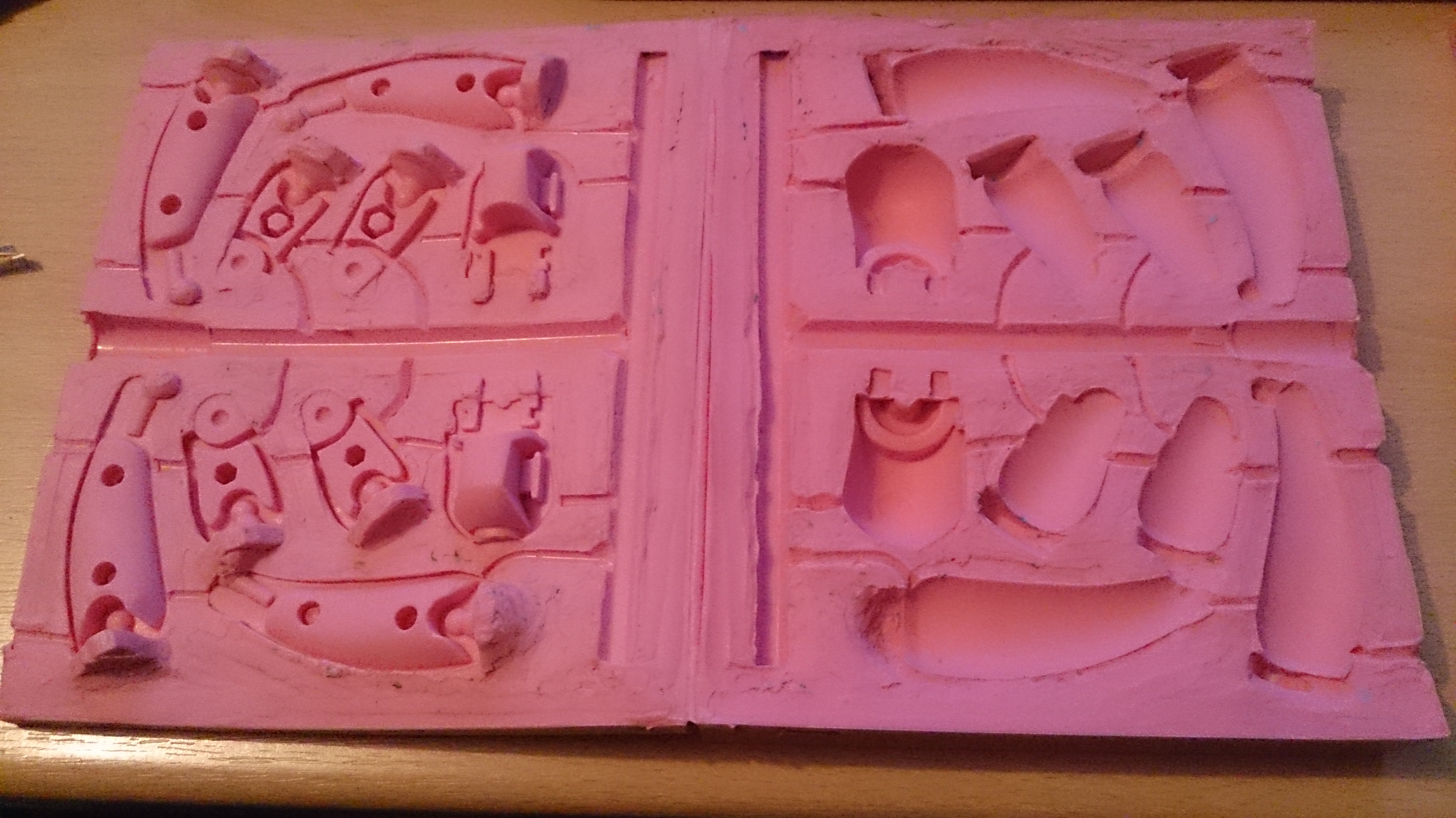

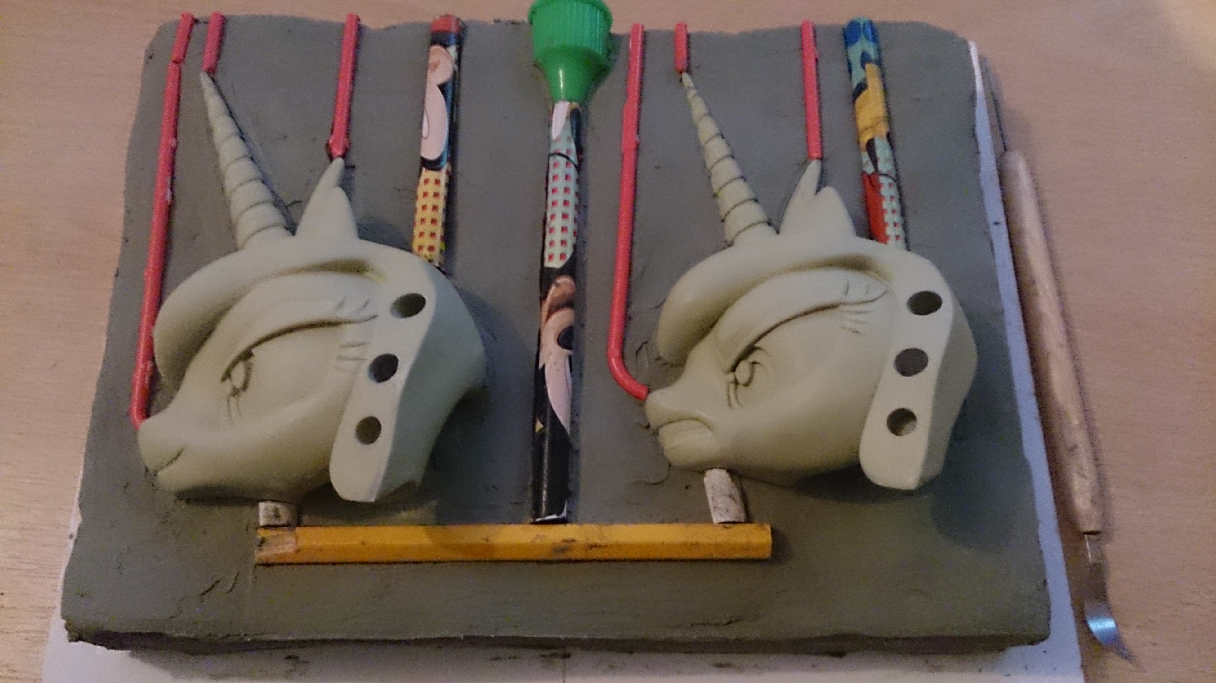

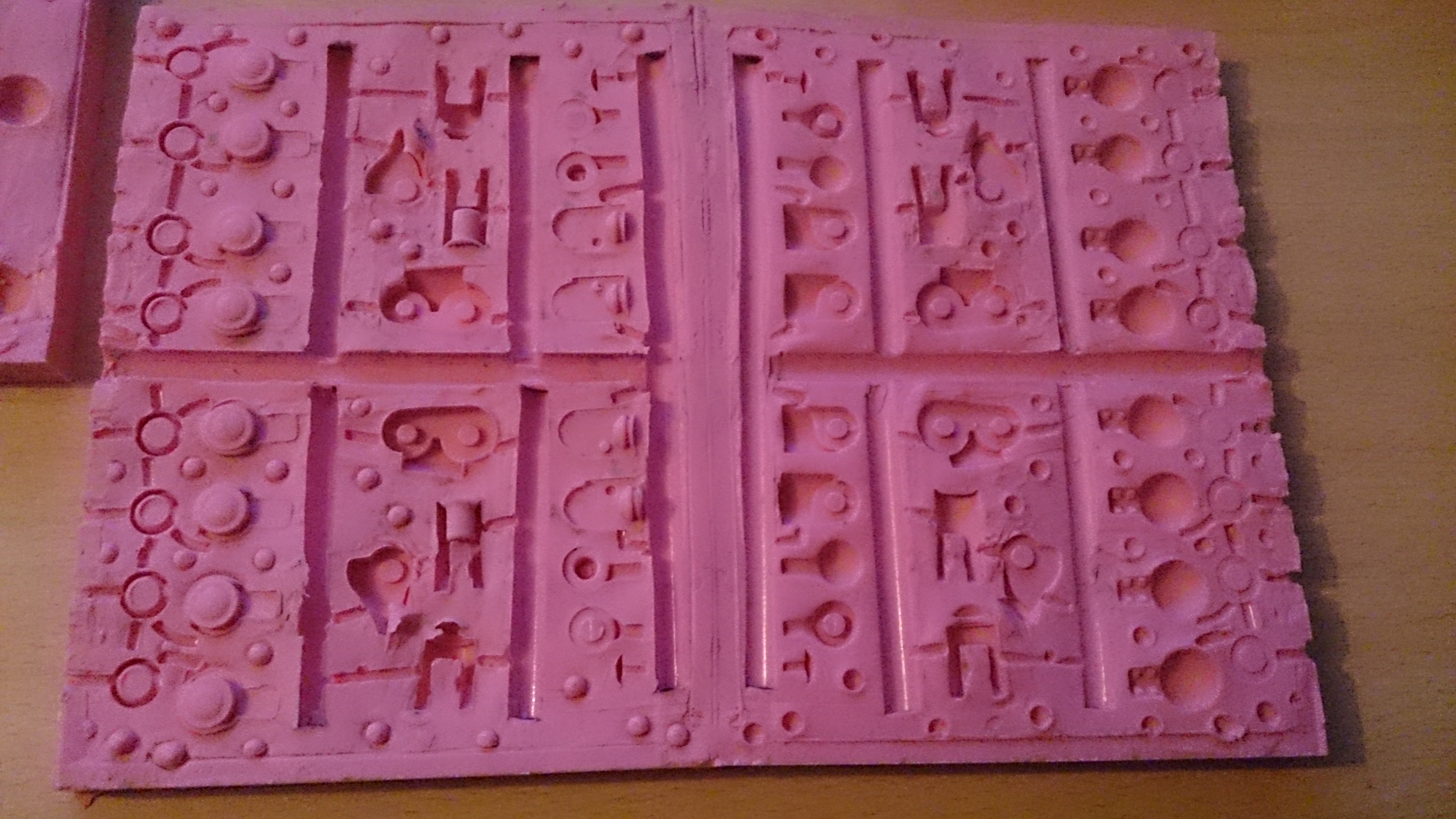

In the meantime here's a quick update on the molds I have so far :)
This one is for the lower legs and torso.
These are the front legs, ball joints and a few others

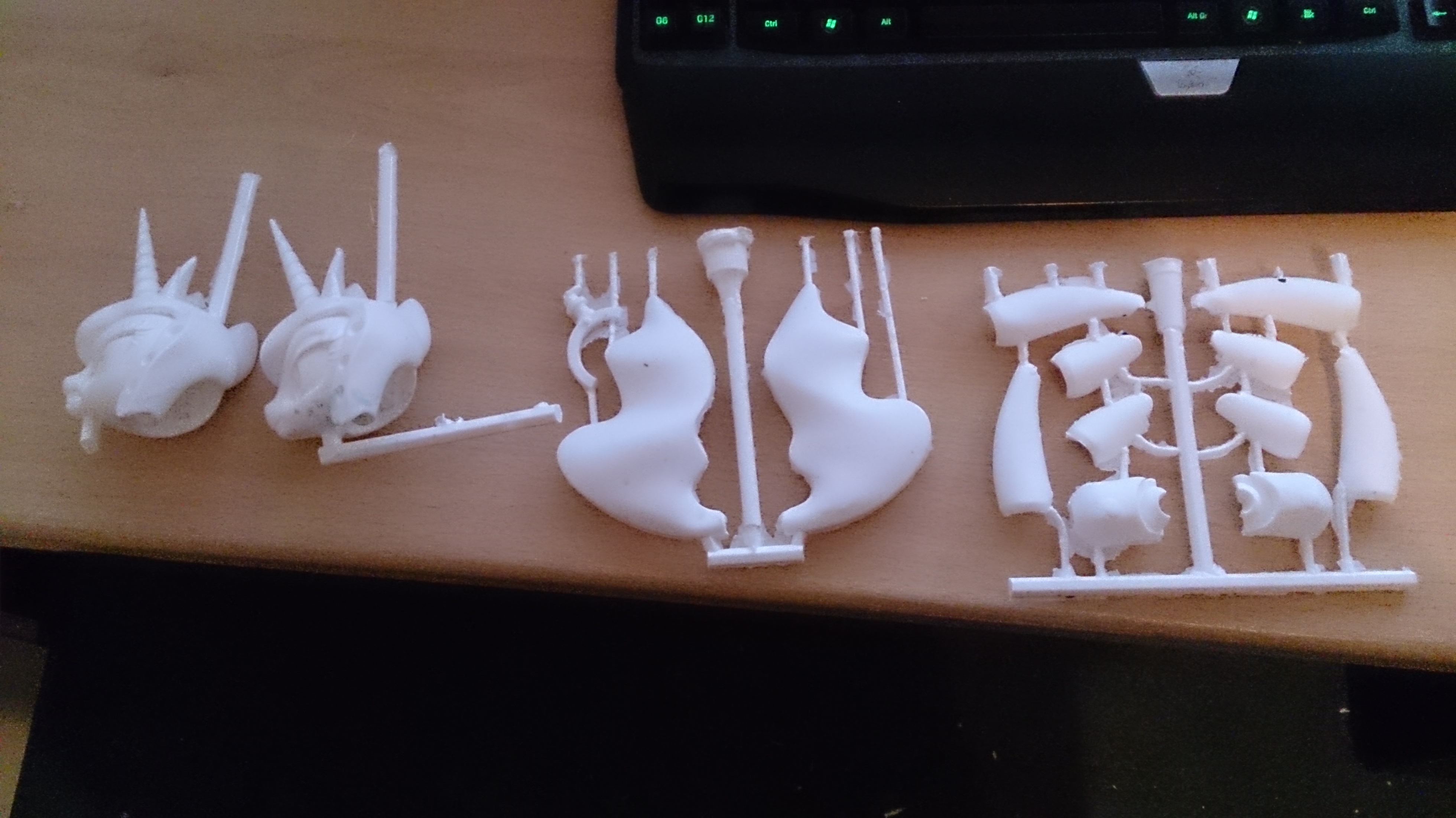

I've finally managed to get good casts! the trick? Rotate the molds constantly while the resin is curing. (so borderline rotocast)
I'm getting a near 100% success rate with negligible air bubbles, even on the molds with tiny parts.
That said i am still missing 4 molds and i have to remake the molds for the feet. since that mold was just not salvageable.
I've got more silicone on the way (my third 10 lbs bucket) so the rest should be ready next week! Motivation is back with a vengeance
Here's a set of completed sprue's

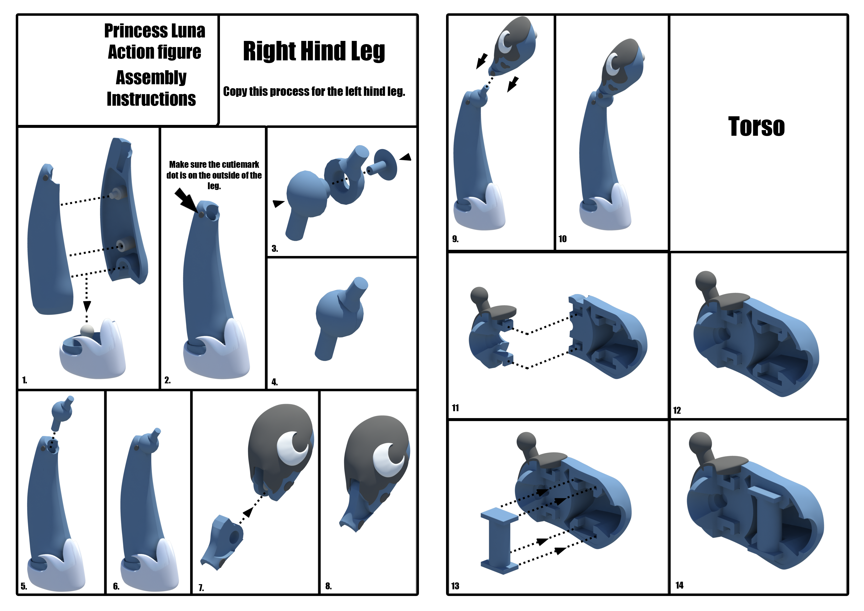

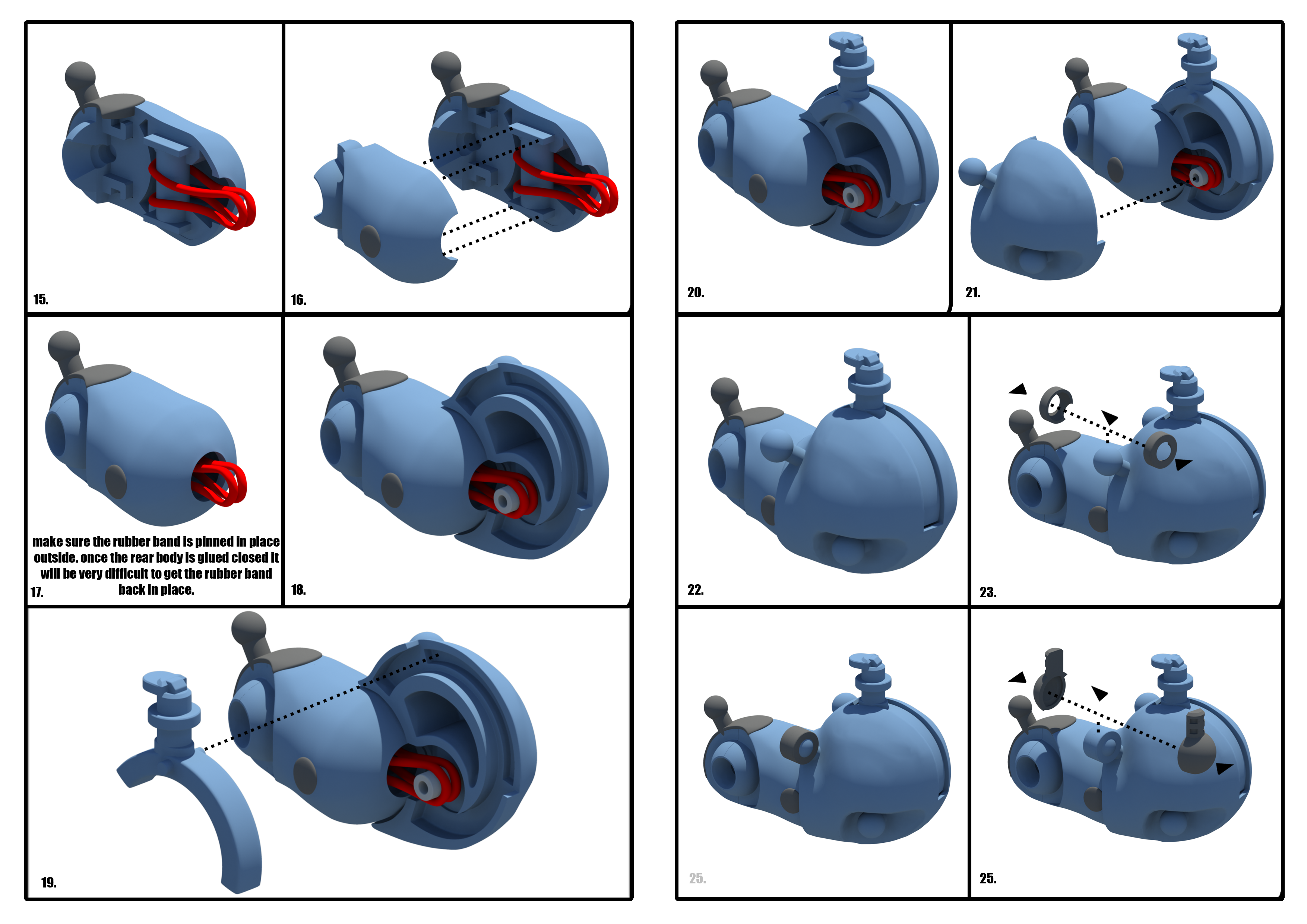

I've done some more work on the instructions. i'm also painting one of the new heads just to get an impression of what the final thing will look like :)
here are page 1 through 4 which will come with the kit version of the figure.
