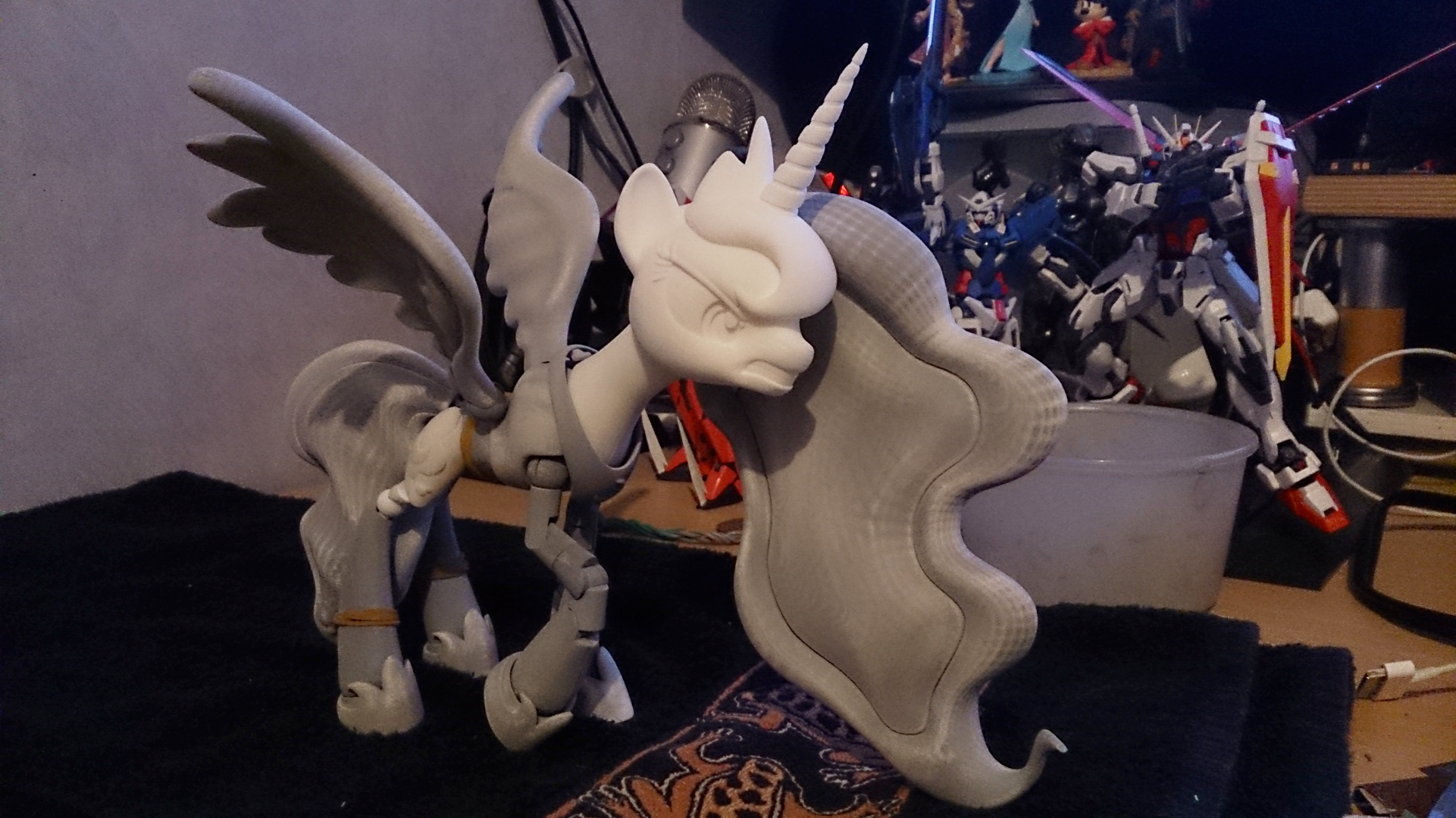

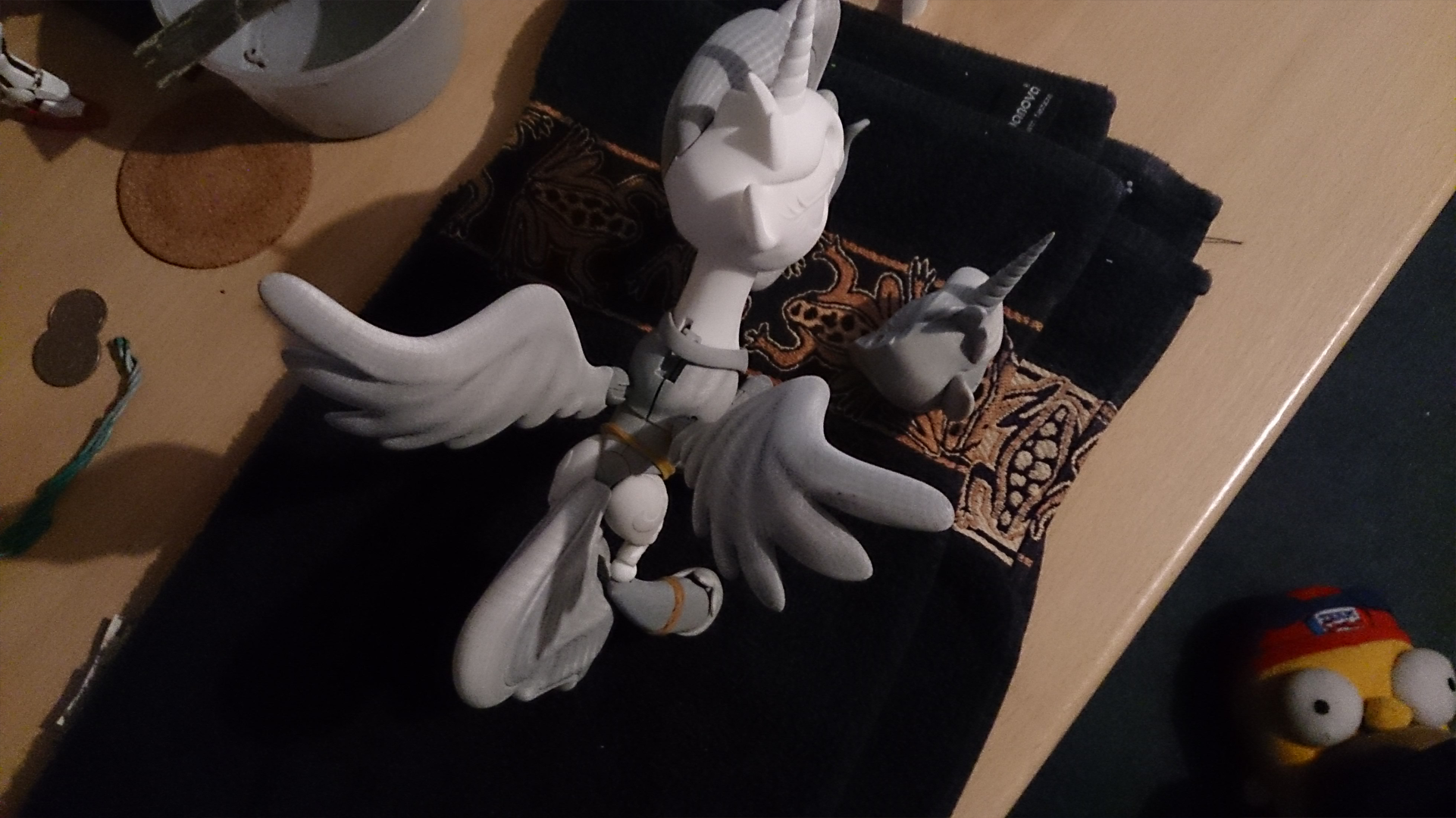

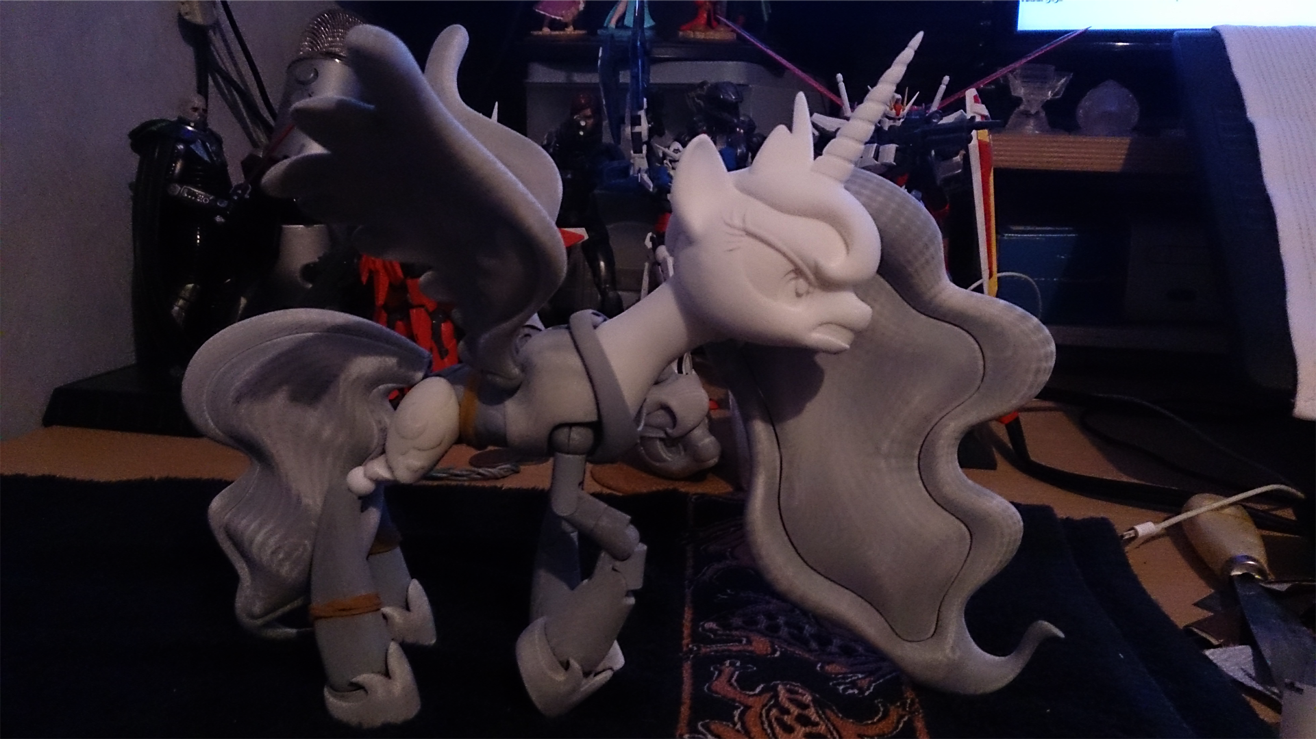

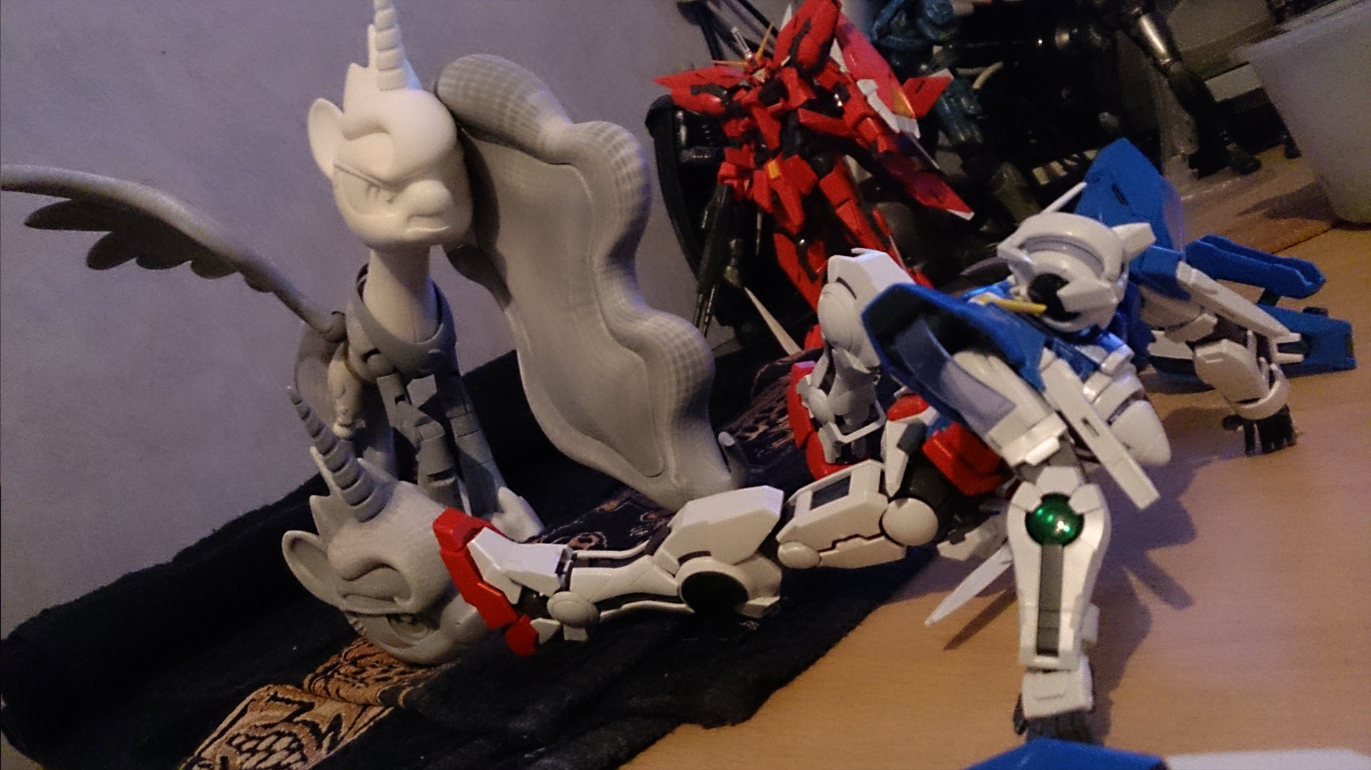

the first set of replacement parts arrived today along with luna's angry head and i re-assembled her again for a new set of a pictures :) still got quite a bit of sanding left to do as you can see. the white parts are the replacement pieces and the dark grey pieces still need to be sanded. the tail the mane and the feet have all been finished as has the neutral head.
without further a due
and just for fun don't **** of luna!
I apologize for the poor quality of the photo's. Once the figure is ready i'll get a set of professional photo's made of her so you can see her in her full glory rather than in crappy phone camera quality
Ok the last set of replacement parts are in and they work beautifully. that means i'm done with printing. all i need to do now is sand the remaining pieces smooth. thicken the joints so they have a bit more friction (in the photo's it was a miracle i got her to stand up on her own with how loose some of the joints are)
once she's completely smooth i'll order the mold silicon and resin and we should be good to go.
Expect to see the details and order info up at the end of this week :)
