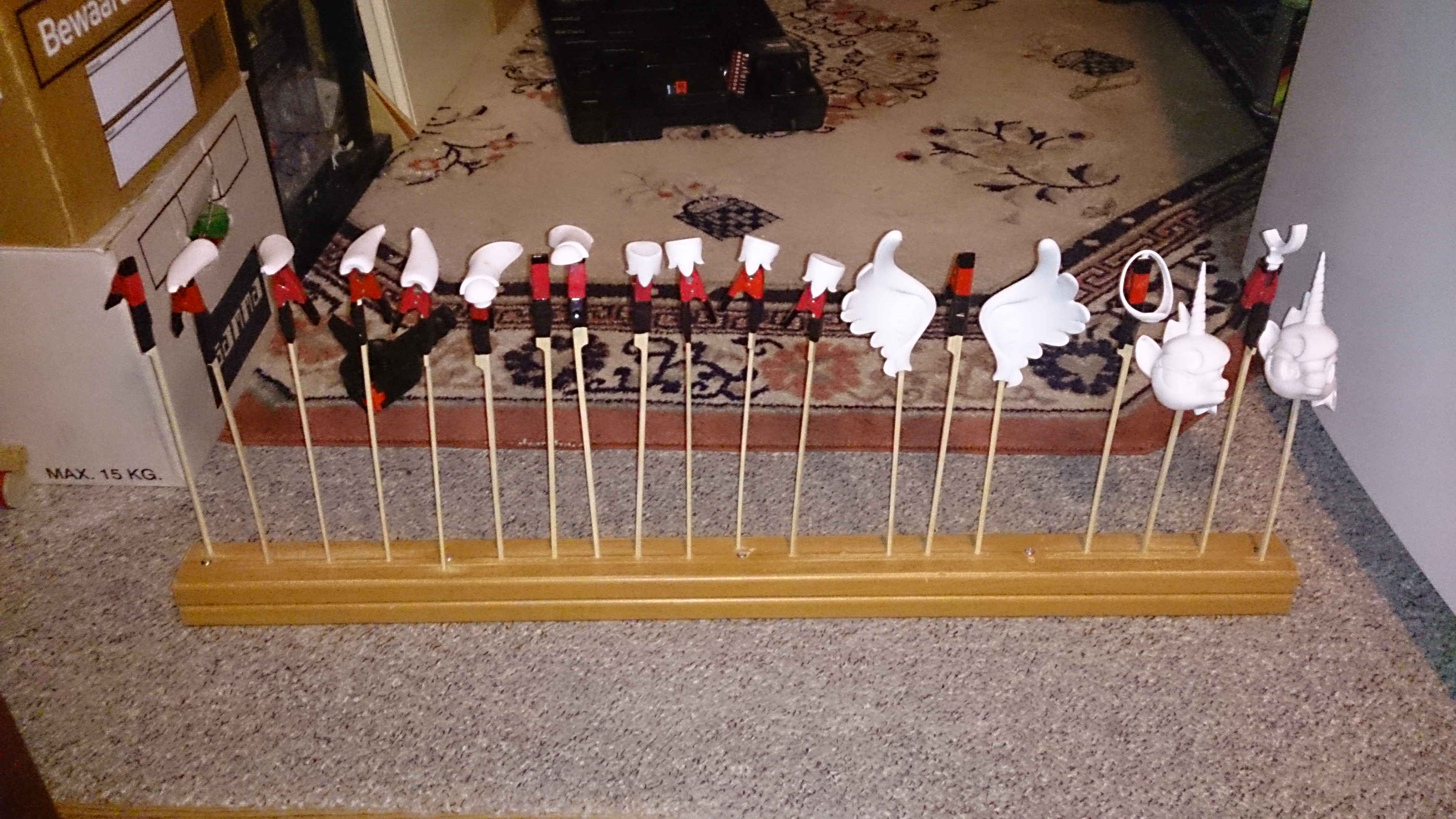

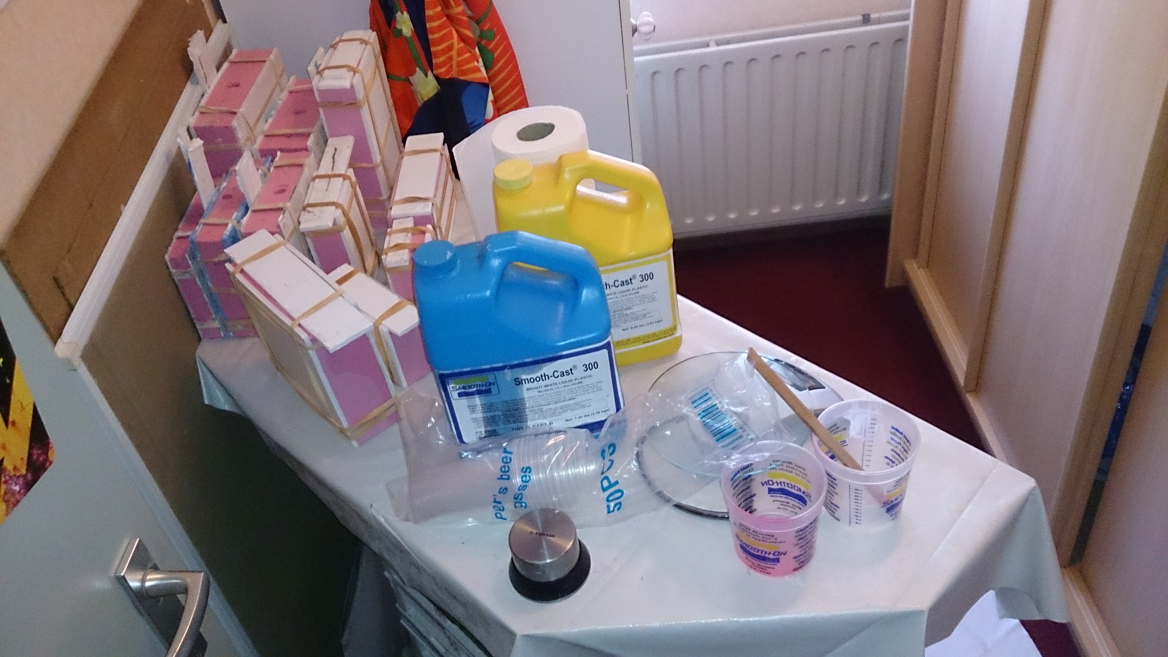

Ready for a day of Casting :)
it seems i've run into a slight snag. when i cast some of the larger parts. and i mix a relatively large amount of resin together. it tends to start hardening before the 3 minute pot life is over. does anyone have any idea why this is happening?
You're mixing too much. Urethanes cure through an exothermic reaction (heat) the larger the amount, the greater the heat - therefore the faster a gel or cure occurs. Try mixing small batches to fill one or two molds at a time.
Wow, ok. What's the gel time? Maybe spend less time mixing? I'm not saying mix poorly, just learn to mix more efficiently.
the msds says 3 minute pot life. and 10 minute demold. its smoothcast 300 however it doesn't always happen. and i mix for about 5 to 10 seconds. but it tends to only happen with molds higher than 100 ml. but sometimes even those are fine. it's really inconsistent
Hate to say it, but that sounds like a bad batch. Are you measuring by weight or by volume? I know it says by volume, but sometimes the MSDS will include a weight measure as well. I tend to trust measures by weight over volume, but the kind of inconsistencies you're describing sound way too erratic for simple mistakes in measuring. Is it really hot inside where you are pouring? I wish I could come over and help. :)
*facepalm* I am an idiot. I've been mixing 1A:1B by weight when i should have been mixing 10A:9B by weight or 1A:1B by volume. i should have read the technical bulletin a little more closely.
