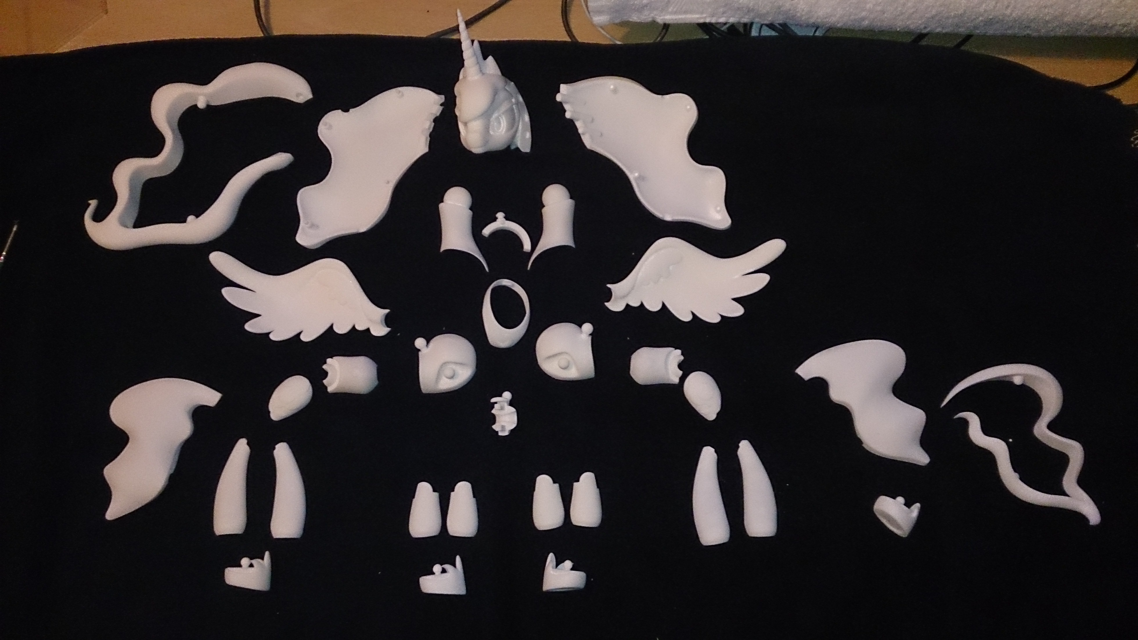

It has arrived!, well some of it anyway. there has been a mixup and i'm missing over half the figure. most of the missing pieces are of the front legs and the midsections of the rear and all of the balljoints.
i'm trying to find out what happened but the stuff that did arrive turned out beautfully.
here's a sneak peek.
Here are the parts i have right now. in total there are 35 pieces missing. i'll keep you guys posted as to what happaned to them.

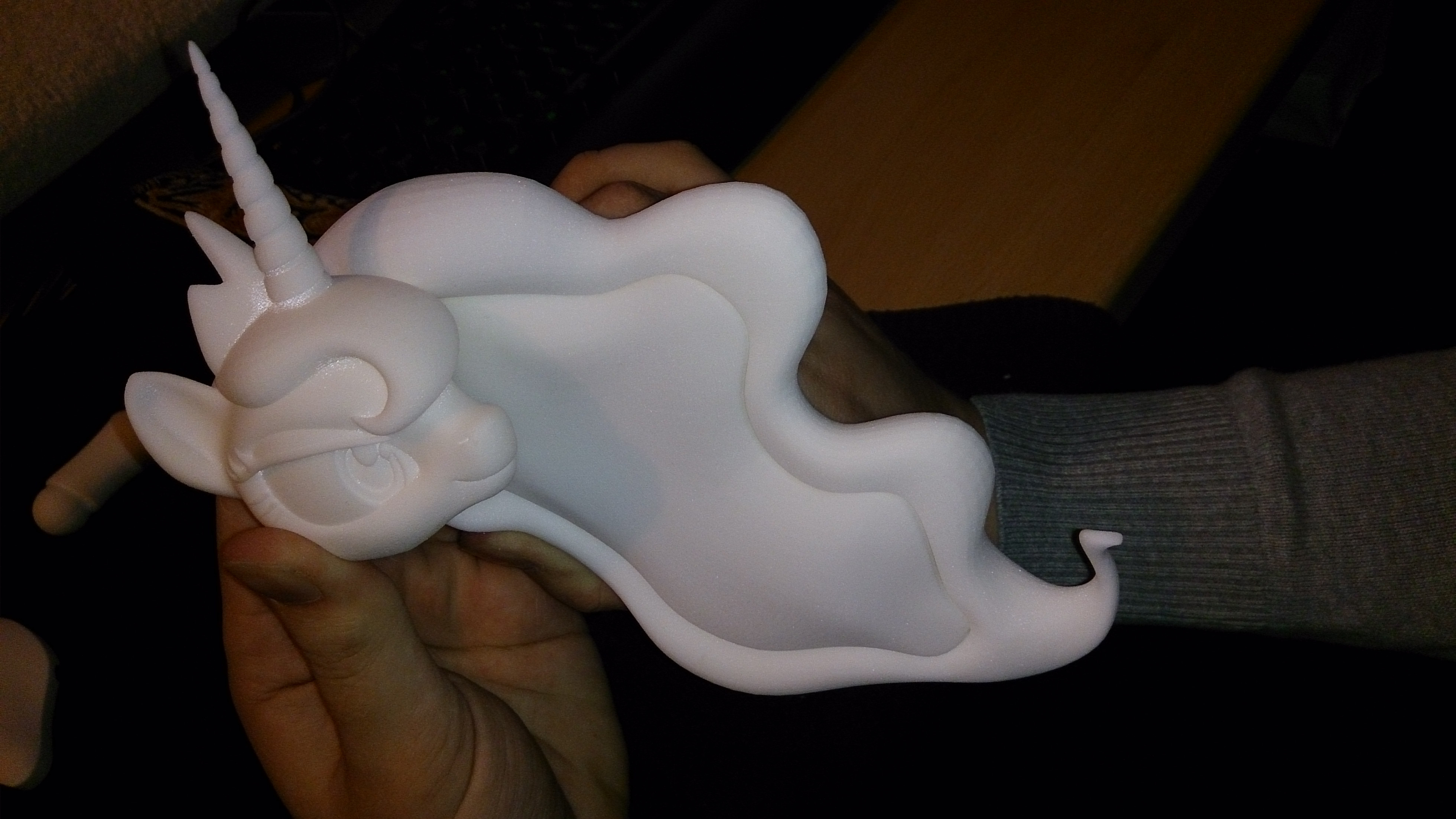

That looks surprisingly good. I can barely see the build lines. I wonder how this compares to Shapeways in the same material.
Something went wrong with the printer who was going to do it for me the day i announced that it was going to the printer so i've had to divert to another print service and in this case that was shapeways. so that is actually a shapeways WSF print and i am really pleased with the quality.
That looks really fine and smooth.
It looks that way in the photo but that's just an illusion because it's big. and the details are big. That head is about 4 inches tall not counting the hair. (I have freakishly large hands) it's not smoother than the average WSF print. but it is smoother than a WSF print I got 3 years ago. So their machines or at least their handling of them has improved significantly
Shapeways now has the option of 'polished' WSF, which is a nice improvement over the unpolished stuff.
Indeed but that is a random subtractive process. Since I am going to mold this figure i'd rather that i myself decide which parts get smoothed and what gets chipped away. Since they just toss the pieces into a vat with smoothing stones and let it vibrate for a few hours.
so I'd rather maintain control over what gets smoothed etc myself. These prints are rough unsmoothed WSF.
