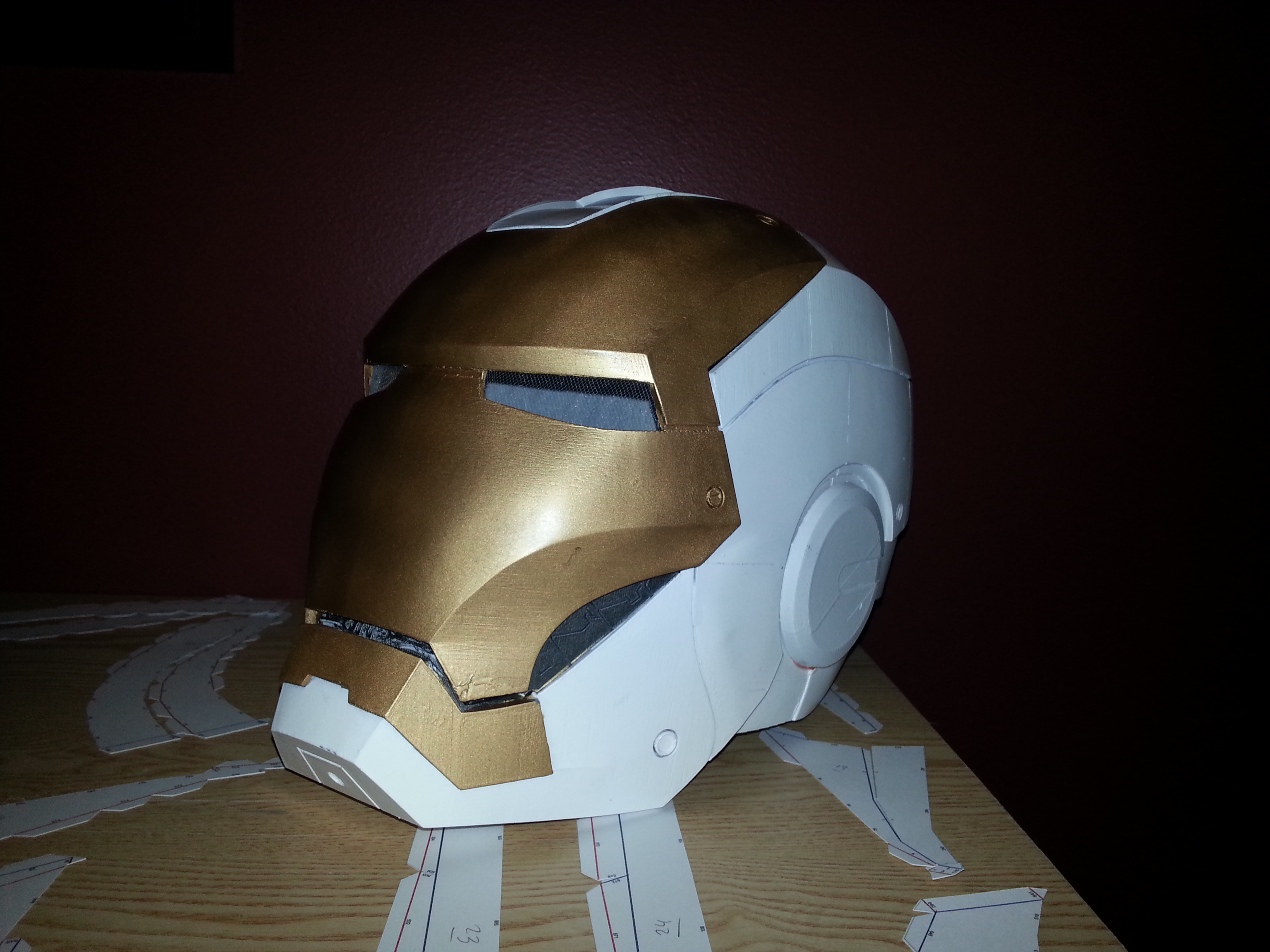

Finished smoothing out to a decent degree and primed and painted
Could've spent a little more time puttying, but it looks decent enough for what it is :)

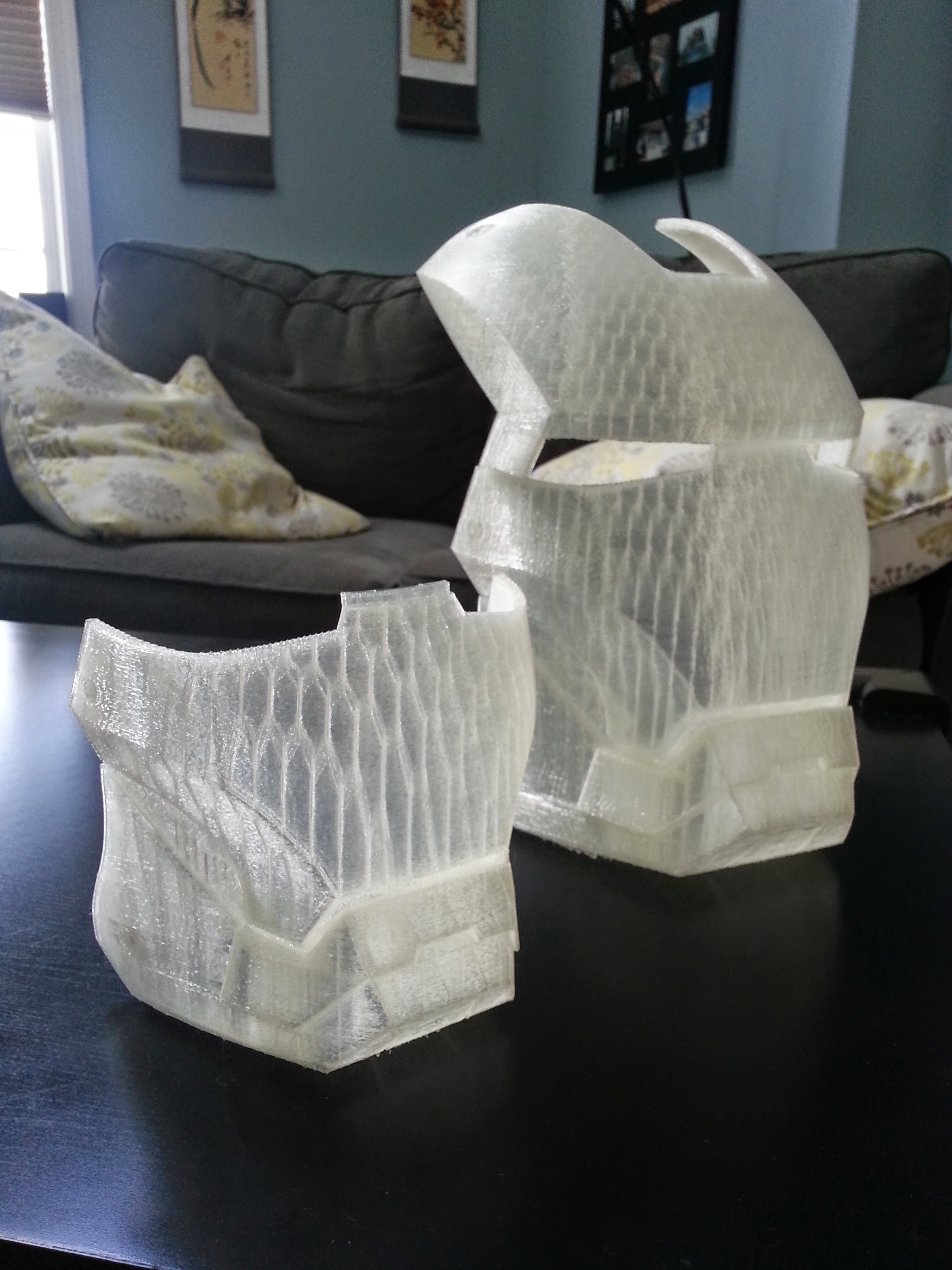

This was my first print that was alittle too large so I played around with some paint.

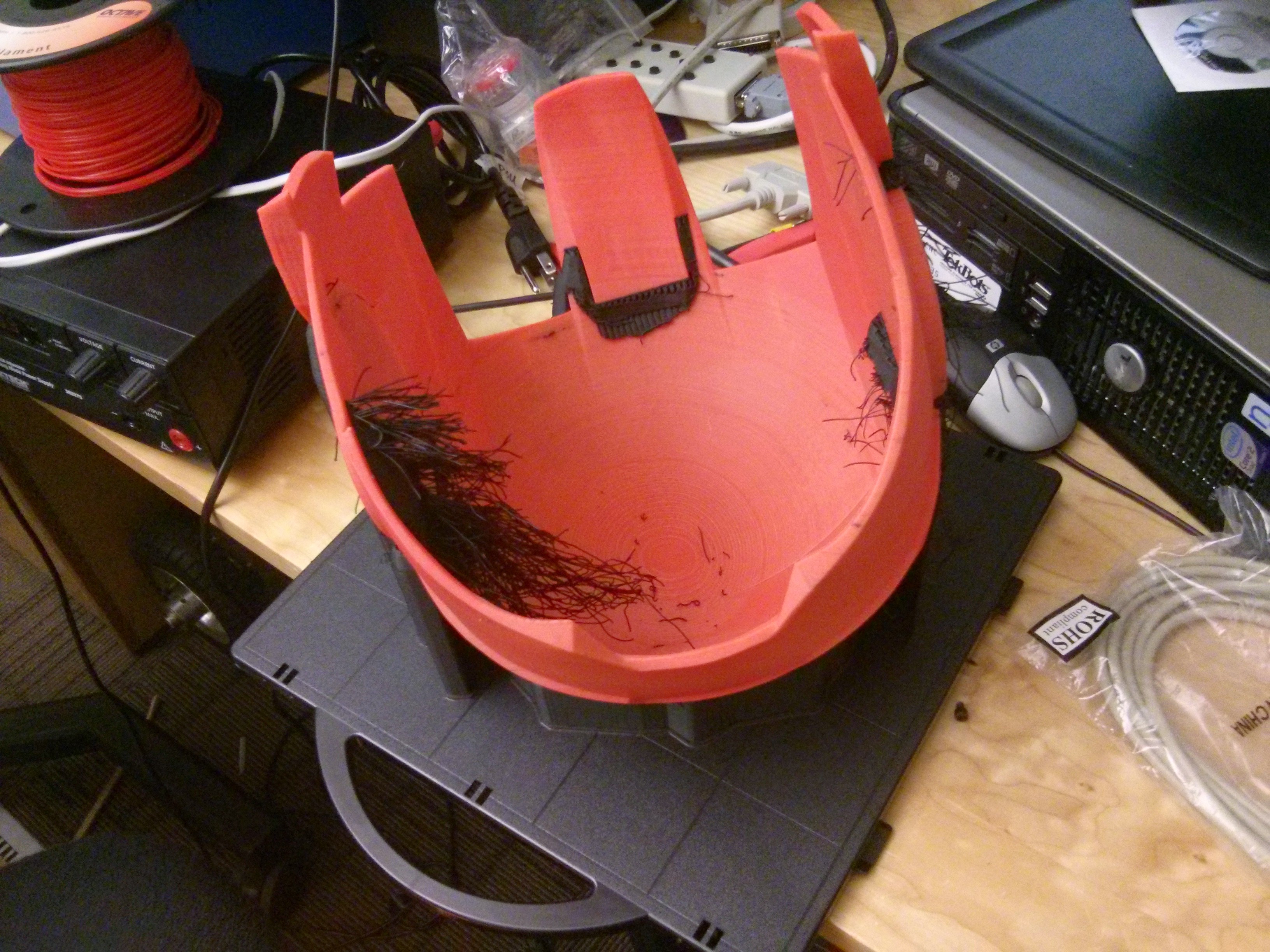

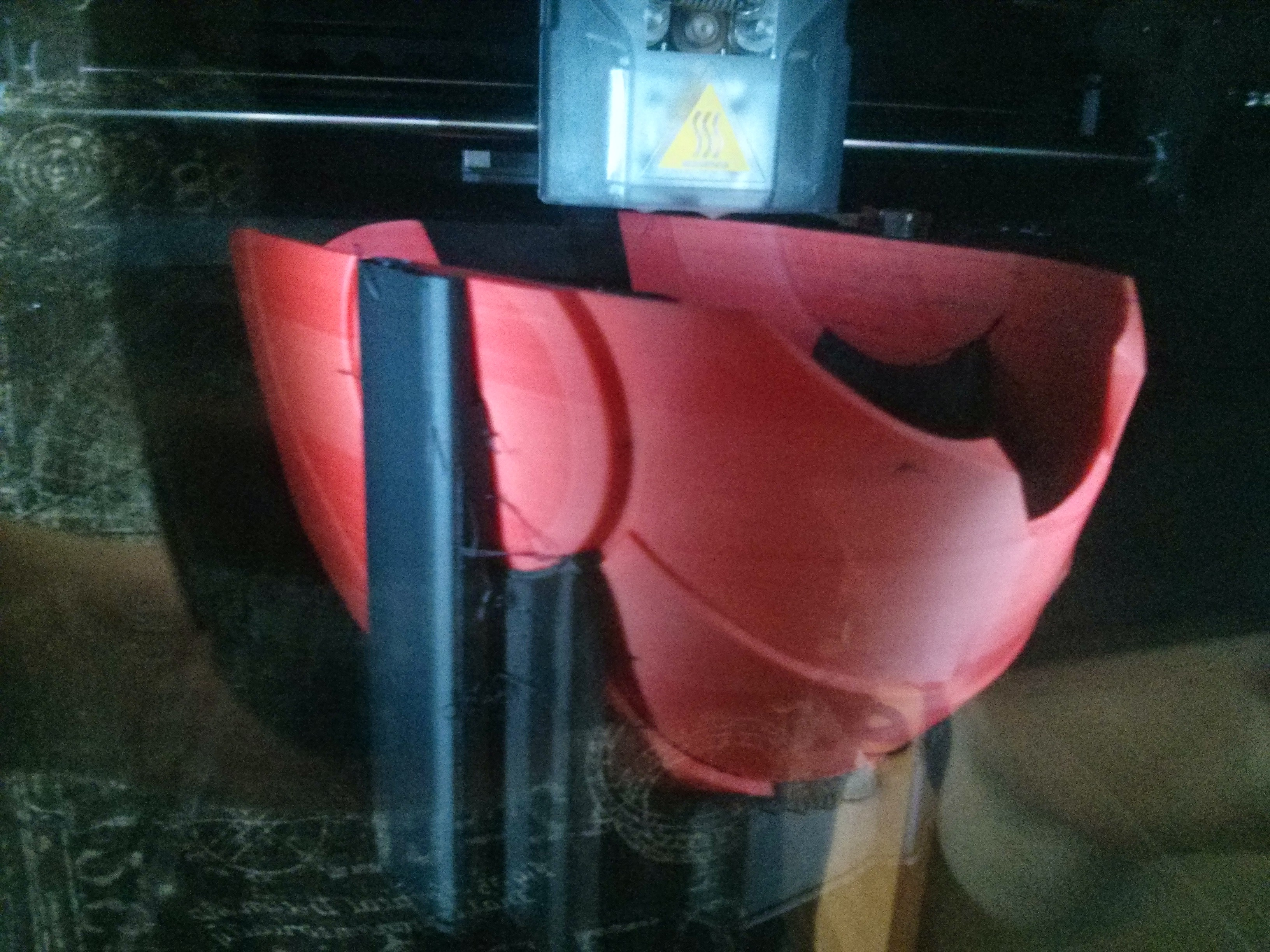

Printed the helmet out on the Stratasys Dimension BST 1200 at my school in three pieces (faceplate, chin, and the main head) as given in the first post. For the most part everything turned out pretty well, except the main body printed with gaps where the lines travel around the head. The middle section was still attached to the bottom solidly thanks to the ear pods, but the top part came off when I removed the support material. Nothing that some superglue didn't fix, just thought I'd mention so it can get looked at and maybe fixed. There was similar gaps in the faceplate for the top and bottom sections, but they seem to be holding up just fine.
I also ran out of red filament when printing the chin , so there is a small part missing in the cheek area (would have had enough if I hadn't scaled the faceplate wrong the first time and printed out a 3/4 size one). I may use the paint booth a friend of mine has and put some nice paint on it to finish it off, but for now I'm content to leave it be for now. I just need t ofigure out how I'm going to fit the pieces together in a way that I can take it apart easily.

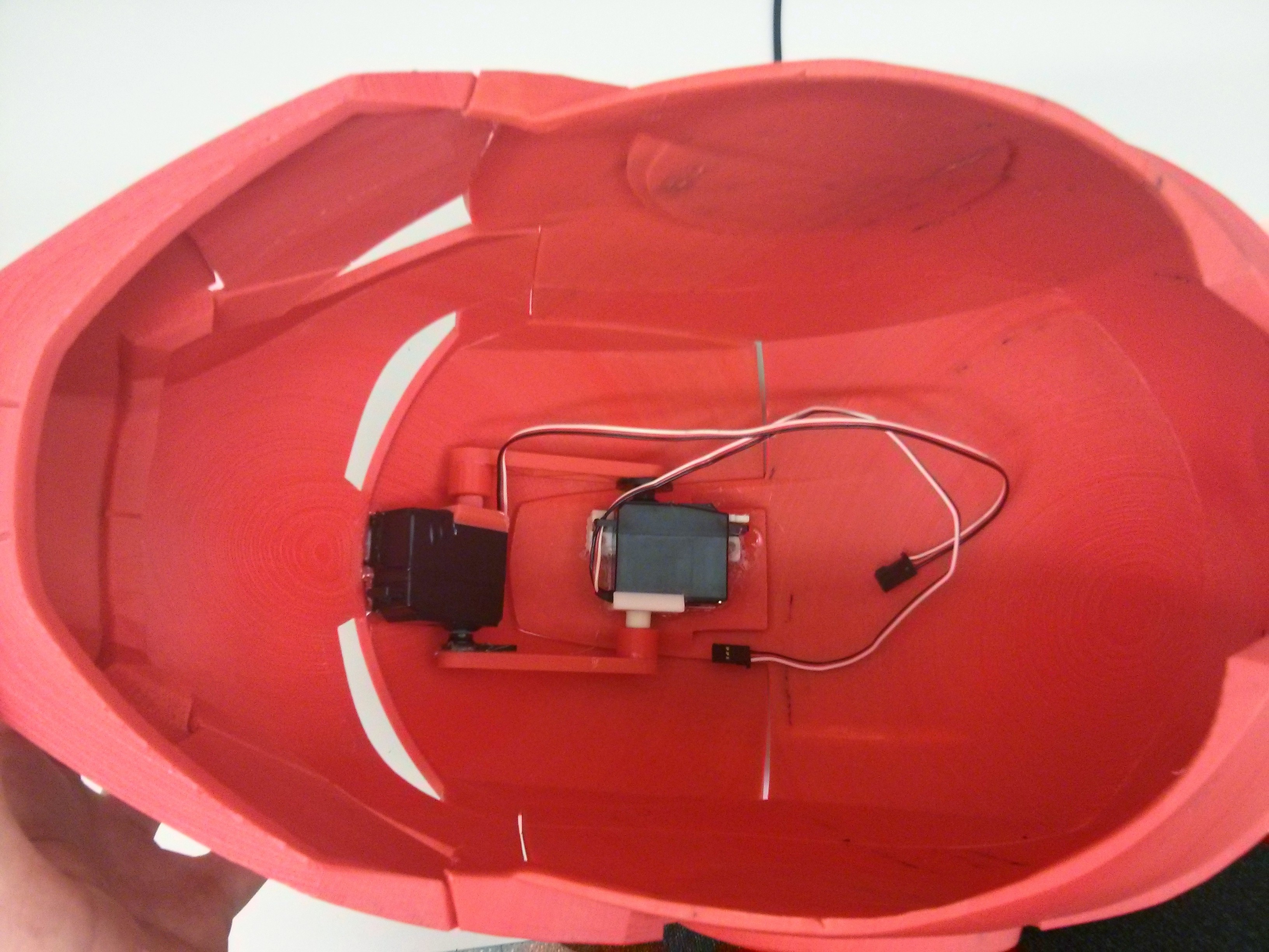

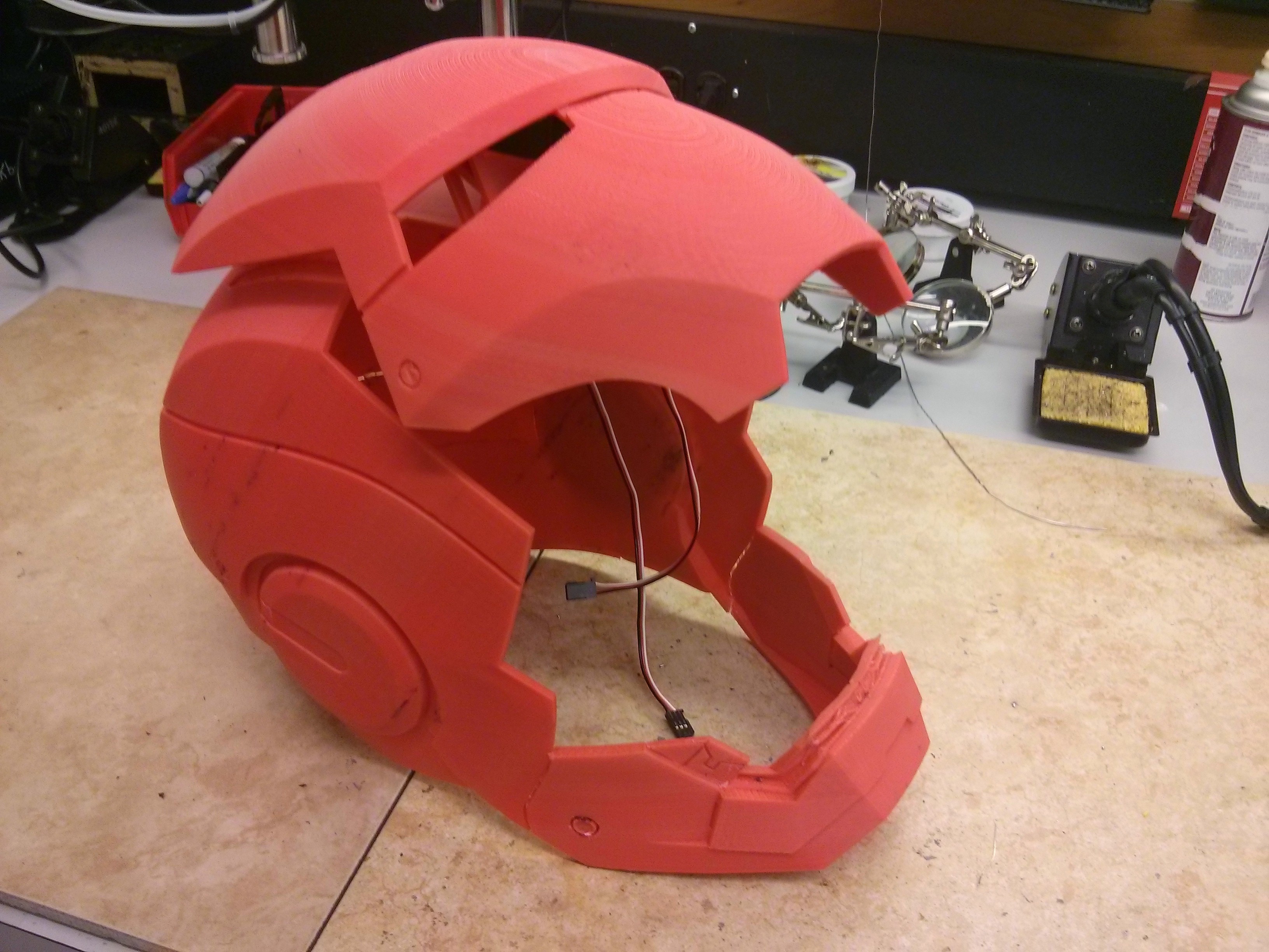

Decided to work a bit on my helmet over Memorial Day weekend, motorizing the faceplate. I started with these servo brackets that I found on thingiverse and made some quick arms up in SolidWorks. The 3D printed arms work fairly well considering everything, and I like the look better than the thin metal arms. Right now I just have it hot glued in there until I figure out the permanent setup. I'm thinking I might design my own bracket that slots into the inner portion of the top vent on the main helmet, but I'm struggling to come up with a design that would work with a range of scaling on the helmet and still fit a standard servo (will probably have to share the original file in a couple of formats so people can change to fit their helmet). Also planning on running the servos with some flavor of Arduino just so it is easy for people to replicate, I'm a fan of the Teensy 2.0 but the pro mini might be the better way to go since it is cheaper ($10 on Sparkfun).

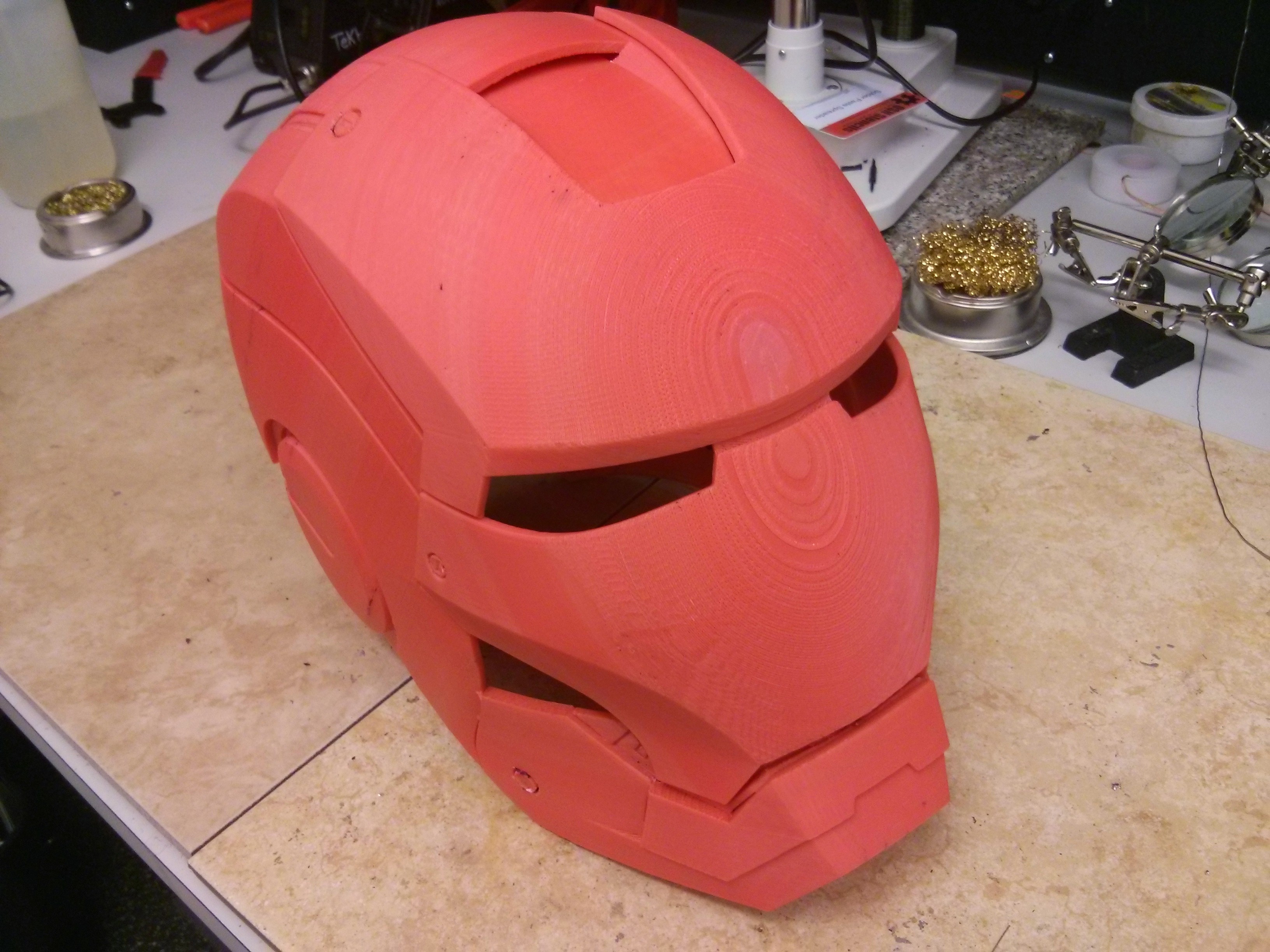

Space wise the servos actually help to make the helmet fit me better, and it doesn't really work unless I've got a tshirt or something stufffed in the back behind my head. But as it is my ears are pressed against the side and the plastic drags on them when I put on or remove the helmet (there is a small lip along the bottom that I particularly hate and have had to file down. Also I would highly recommend hollowing out the ear pods in a later revision, they are by far the thickest part of the helmet and as they are there isn't room for speakers or anything in the helmet unless I use a bluetooth headset or something). But part of that is just the result of having dumbo ears that stick out :p
I've also noticed more gaps between the faces than I originally thought as well as the jaw not lining up perfectly, I will try to find time to get some good photos to post. I'm not sure if this is from a problem with the files or if it was something on my end when I scaled them.
Would it be possible to get some screenshots or something of the information that describes the inner curves of the faceplate (forehead area) and the top of the helmet (specifically that inner portion of that intake vent)? Right now the servo brackets are only touching on their edges and it would be nice to be able to match the curve.
