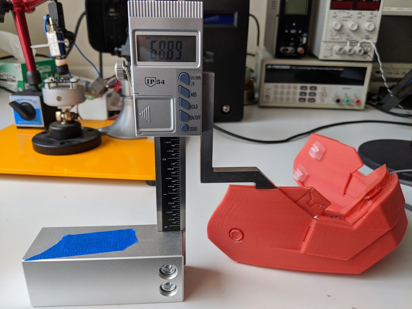

I've just measured the weight of the V2 helmet pieces that I printed years ago in ABS at 100% infill, scaled to approximately 178mm ear-to-ear on the inside of the helmet (measured with a telescoping gauge and calipers, some sanding has been done so it may have been 180mm to start with). I printed the helmet in three parts: the faceplate, jaw, and the rest of the helmet.
Printed at 100% infill with ABS, helmet scaled to ~178mm ear-to-ear
Faceplate: 161g
Jaw (see note below): 103g*
Helmet: 511g
Support material is not included here. Parts were printed using high impact polystyrene (HIPS) material for support. The helmet required a significant amount of support (no easy way to estimate it but it was certainly less than the amount used for the model material).
If I had to ballpark it my intuition says it was probably in the neighborhood of 200-300 grams of support total. You would be able to use much less if you print the helmet in smaller parts.
* I ran out of filament when printing the jaw (I suspect that my "1kg" spool included the weight of the spool). Print height measured at 68.89mm
The keen-eyed of you may have spotted the plastic clips that are attached to the inside of the part. I've left those in for the measurement above since it would give a closer estimate to a real part. For anyone who really wants every last bit of accuracy possible, a single clip and double sided tape together weigh 0.6 grams (there are 4 clips on the jaw).
TL;DR - My recommendation is to buy more than 1kg. You don't want to commit to it and run out like I did. You will also likely want to print brackets and hinges that aren't included in the helmet design.

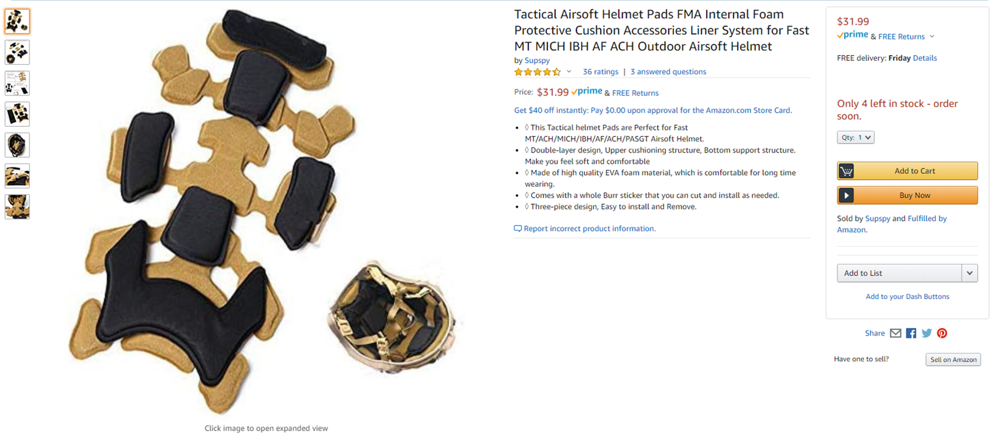

I've recently bought a foam helmet liner kit from Amazon for just over $30 that was originally intended for Airsoft helmets: https://amzn.to/3au2tvD
Since links break, here's a screenshot of the Amazon page for the future (GLHF if both are broken, it wasn't hard to find by searching for "helmet liner")
