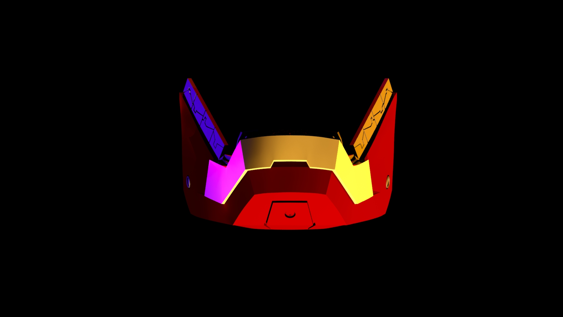

And a quick render of the faceplate on my yet to be finished helmet inside of Tony's shop :)
http://www.4shared.com/download/Slfg0uOu/helmetrender1.jpg?tsid=20130809-042318-63ea3c04
and a render of the exact STL file you are getting
http://www.4shared.com/download/f2Y3oWel/faceplateSTL.jpg?tsid=20130809-042340-be9a4b32

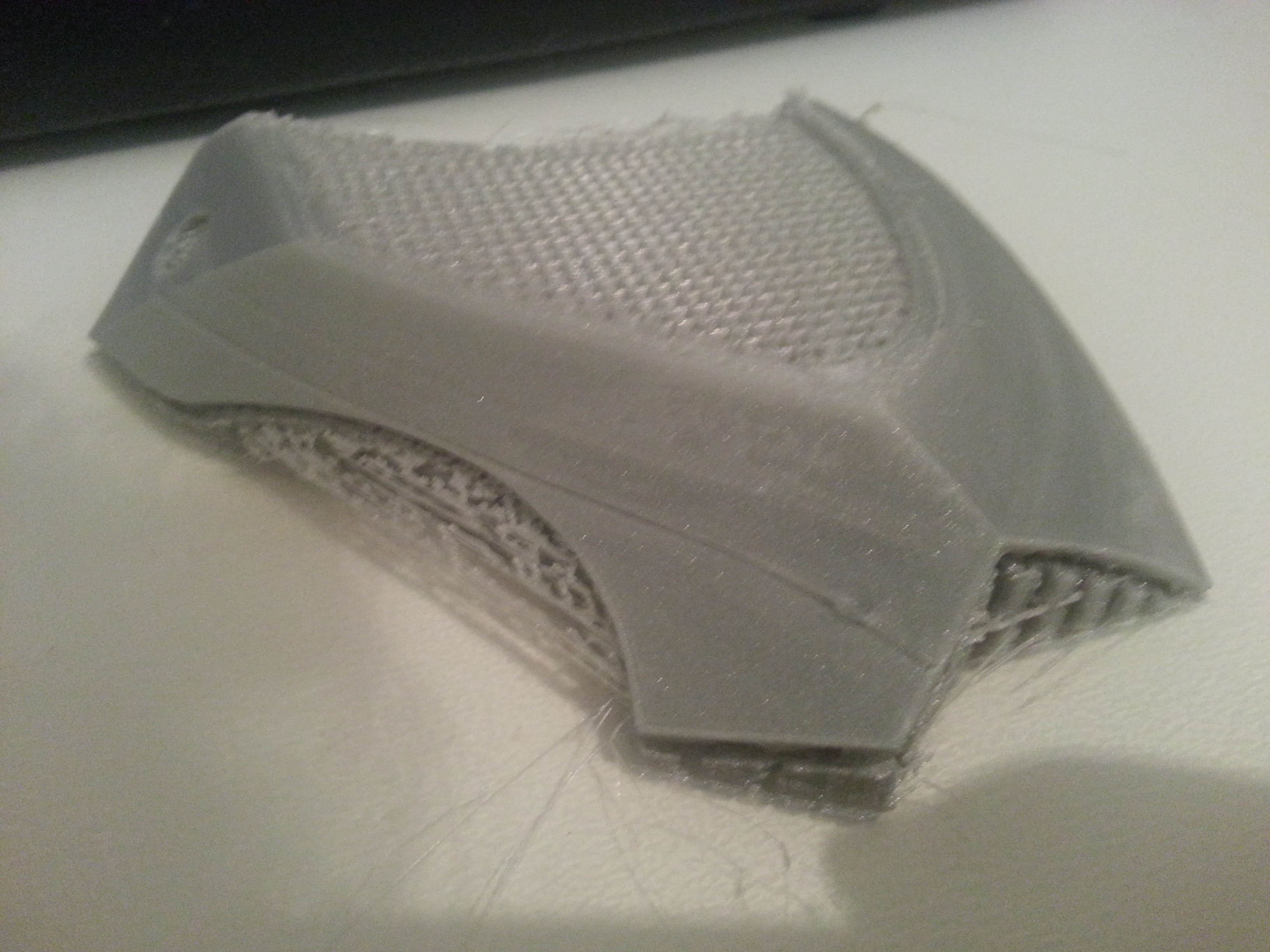

The main problem to print this is the size of the model, it's too big for a "home printer". Even in a professional printer the helmet may need to be printed in several parts. Also the number of polygons is very high, my computer froze trying to slice the entire faceplate, but that was before I did the automatic repair with netfabb so maybe it was that...
Also, due to the size of the parts, they take many hours to print, this last Saturday I tried to print 1/4 of the faceplate (the right cheek, from the chin to the eye) and left my printer unattended... I came home to a clogged extruder and a piece only half printed
I placed the part horizontally, so the ratio between support structure and actual print was pretty bad... next time I will try to print the faceplate in vertical, even if I have to divide it vertically in several places, this will help if one or two parts have a problem, so I won't have to reprint a big part.

SWEET! Thanks Ballanux! Although that print stopped and the extruder clogged, this all actually looks quite promising. It looks like the lines on the faceplate are very sharp and the curves are right. Do you have access to netfabb pro? Because I've only been using basic and there are a lot of repair features unavailable in the edition.
But yeah! Good job! Like i said before, maybe you should try a PLA print with the helmet at about 1/4 scale? just to see how things print out? and then you probably would not need all that much support structure either!
